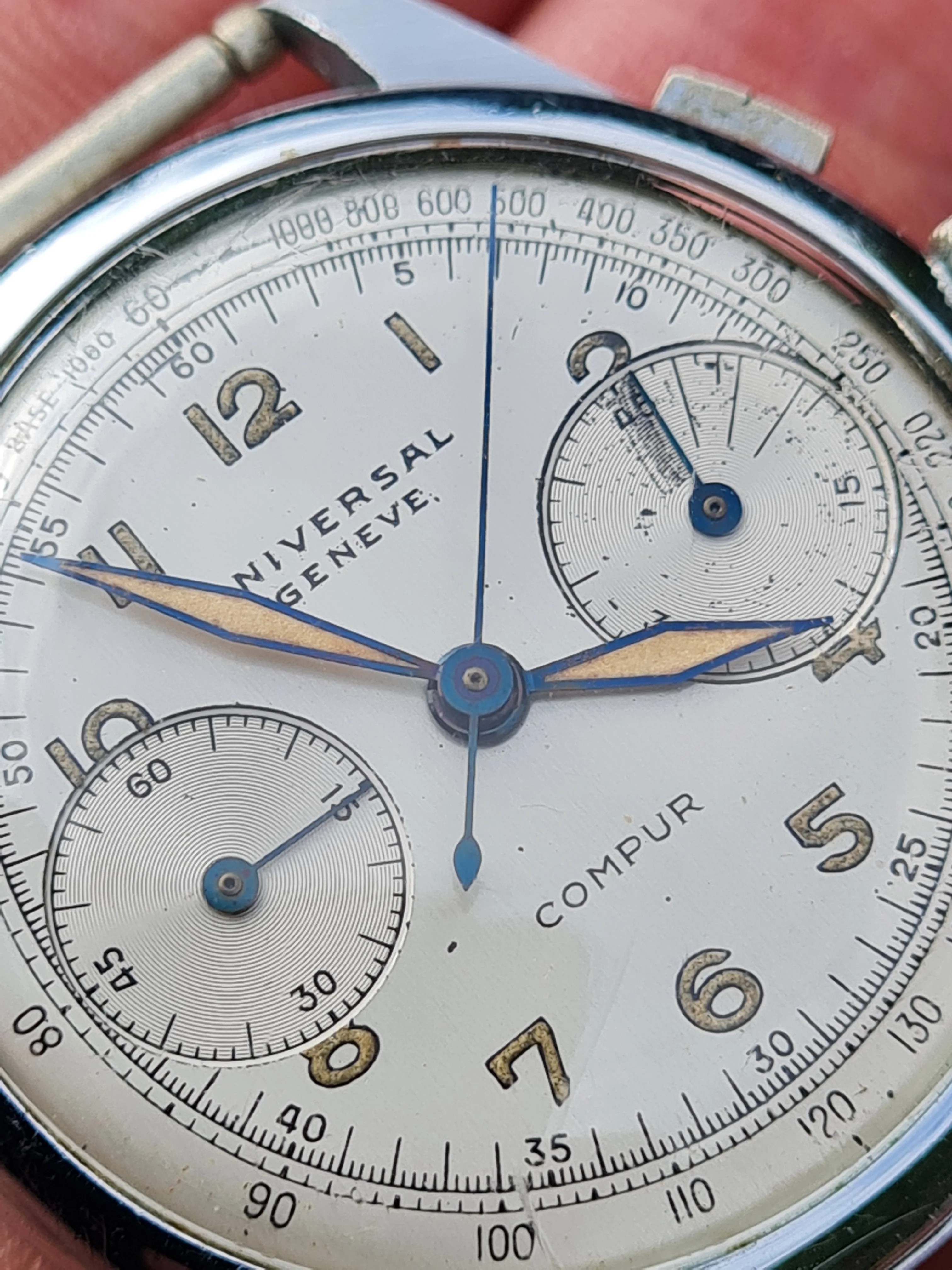

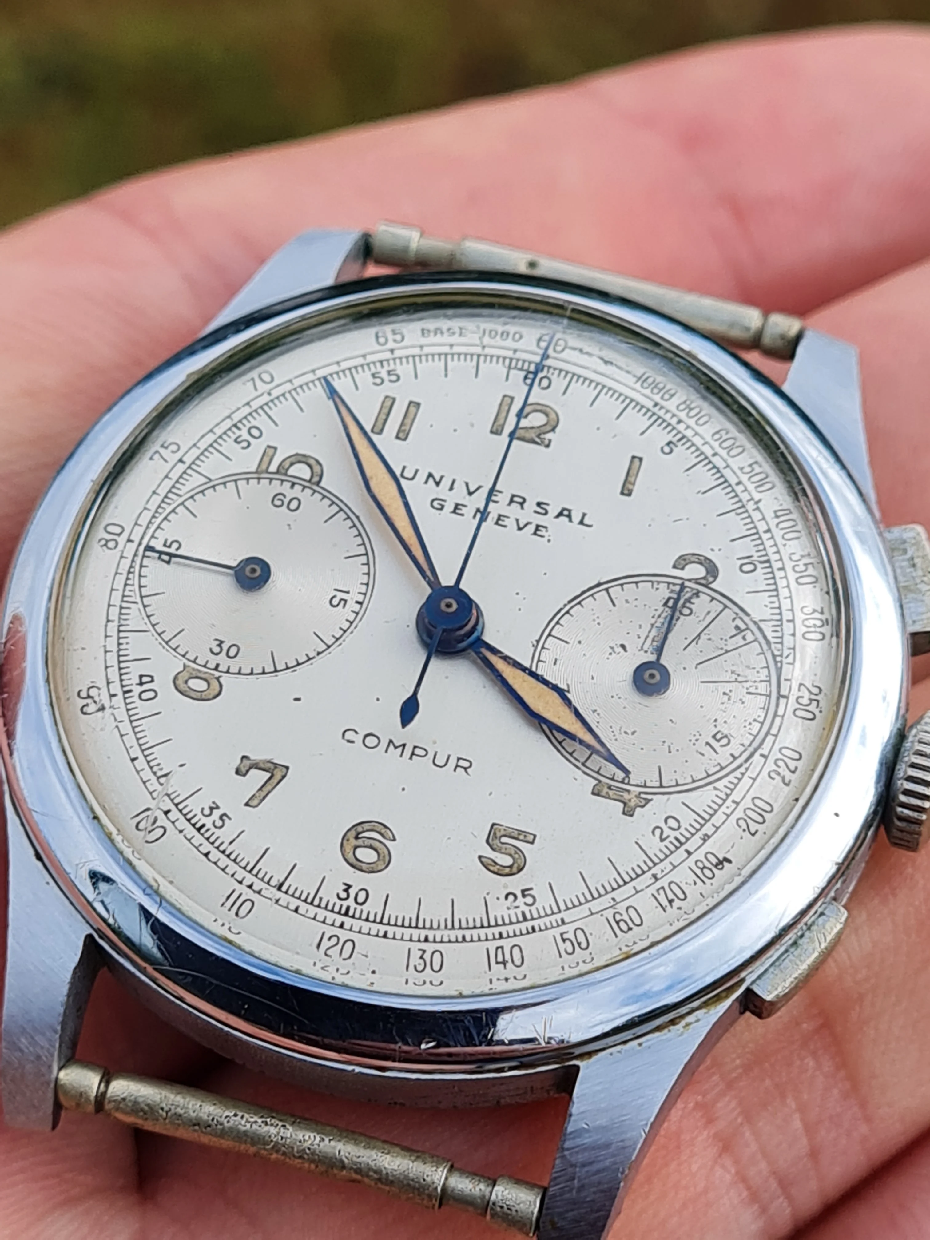

Hi,
last week I found a nice 36mm UG Compur in a www. flea market.
Condition seemed very well, seller was nice, so I picked it up.

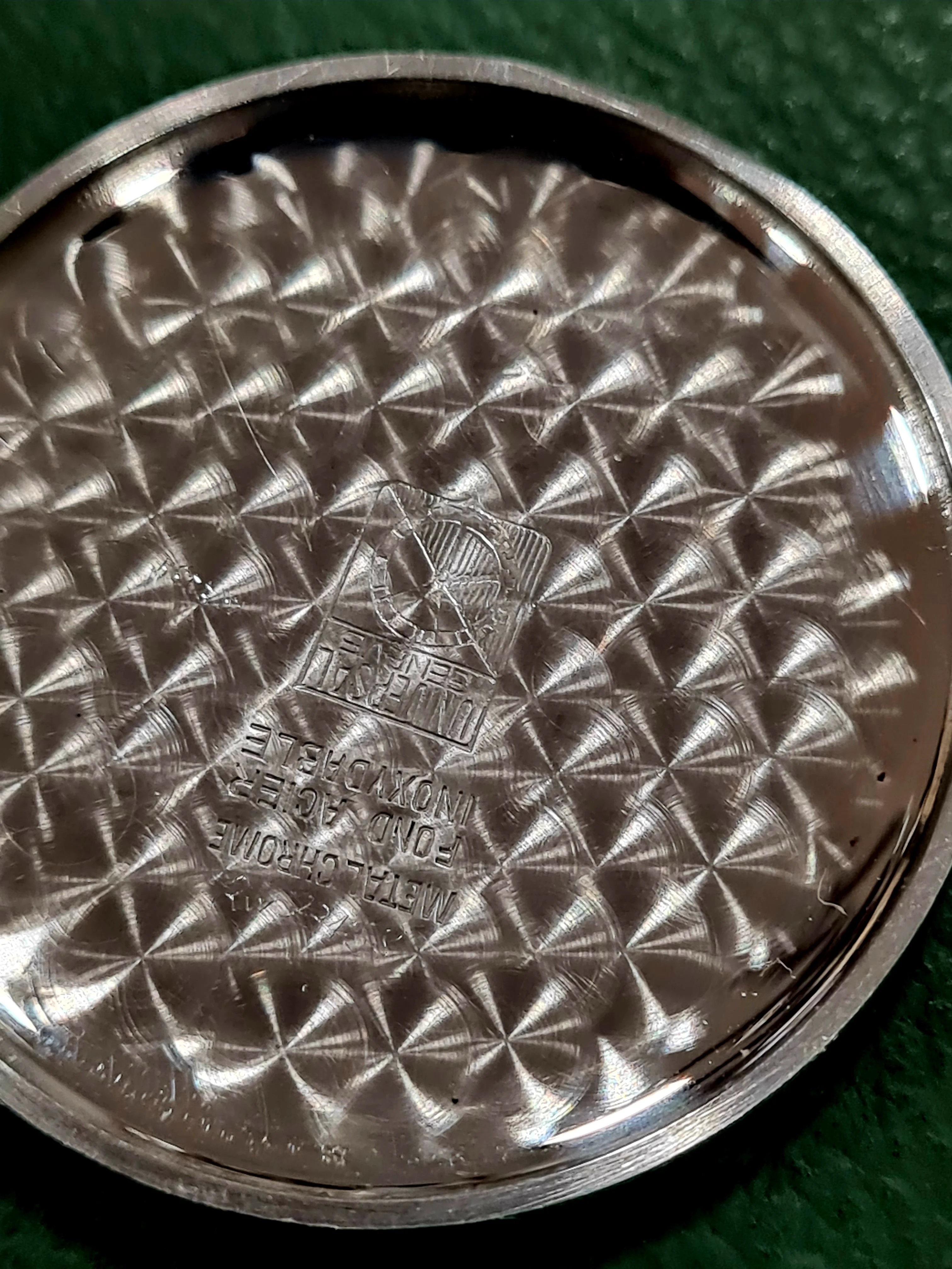

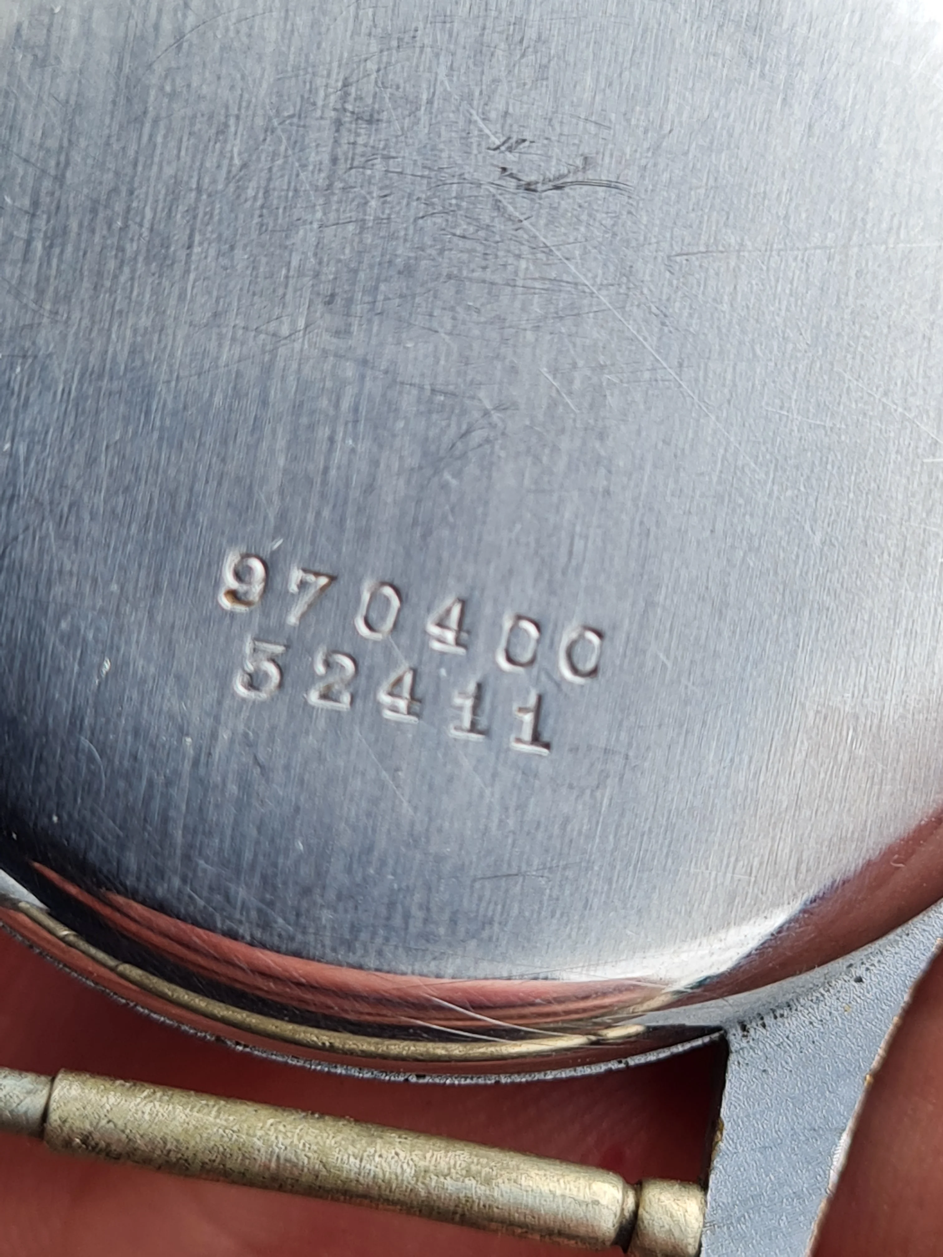

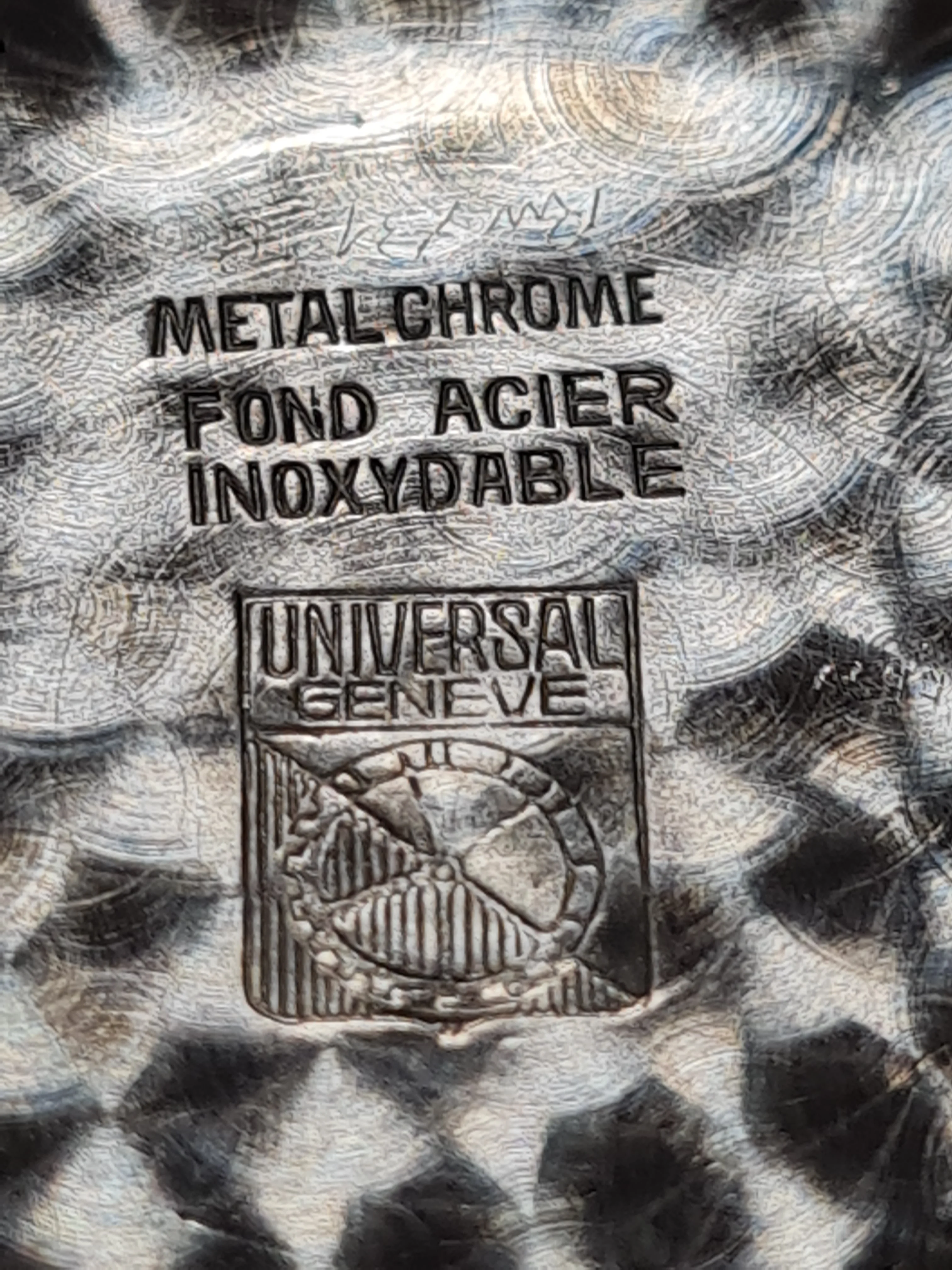

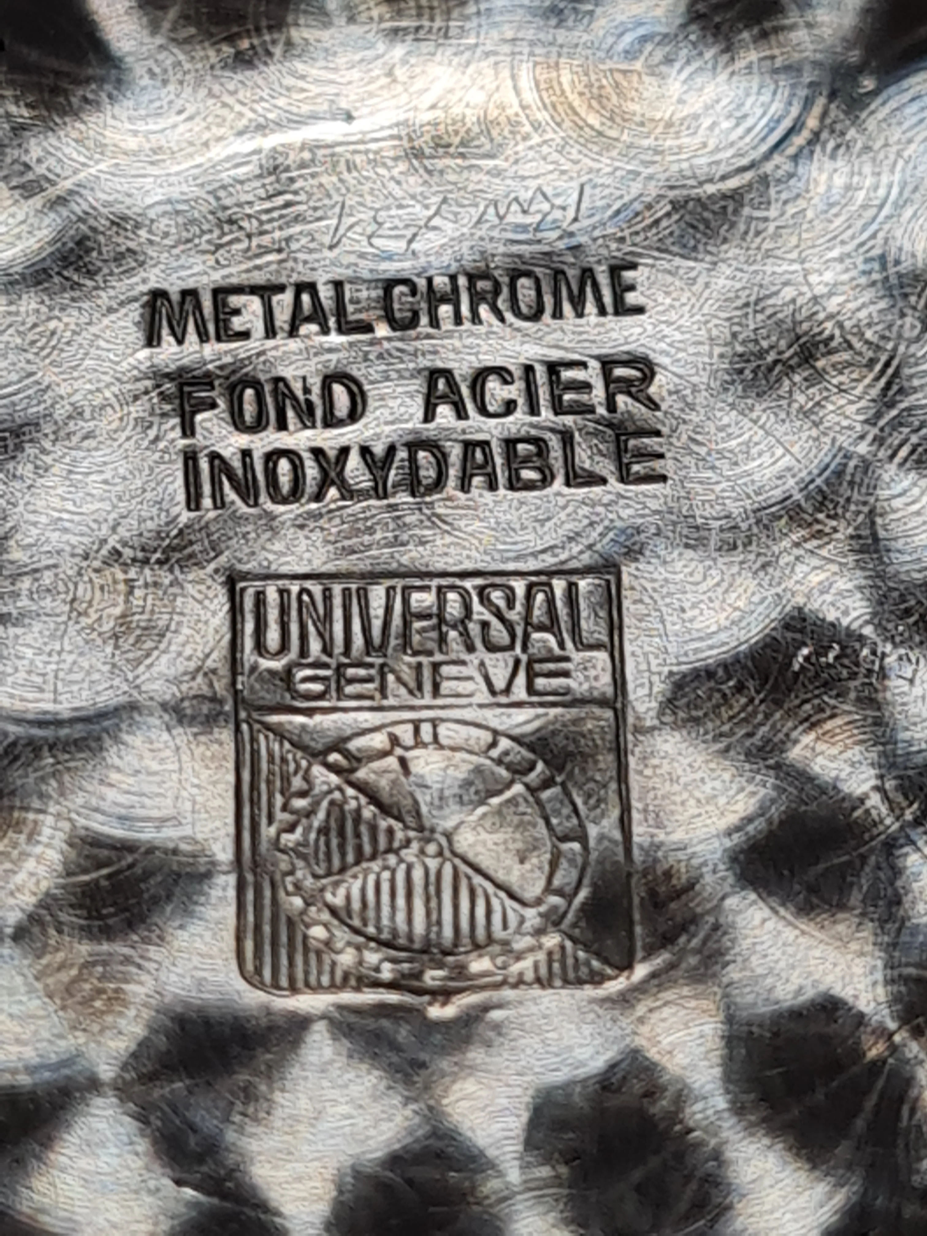

Because I not know Universal Geneve chronographs very well, I did not recognize, that the first number in the reference suggests, that the case is chromed (in this case, I guess nickel-plated and chromed, only back and perhaps bezel should be steel).
Always thought, that only the Berthoud or UWECO have that kind of cases.

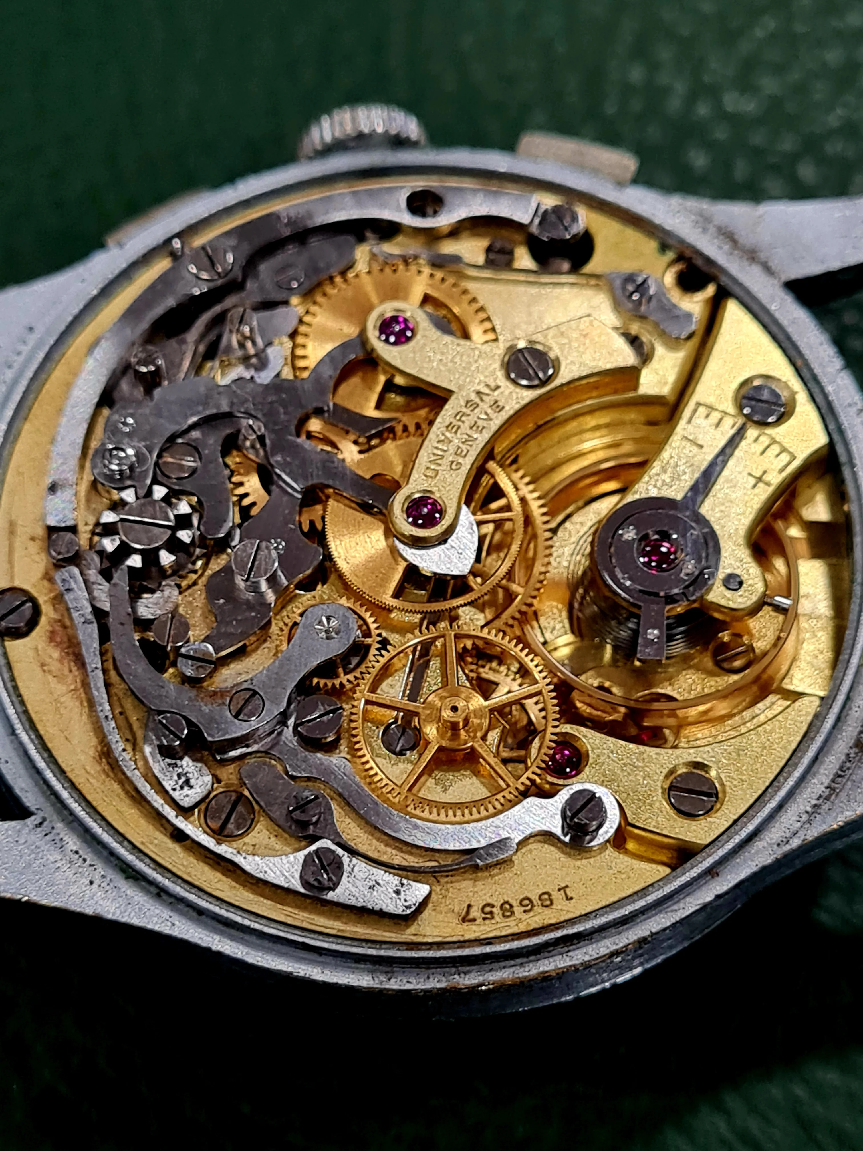

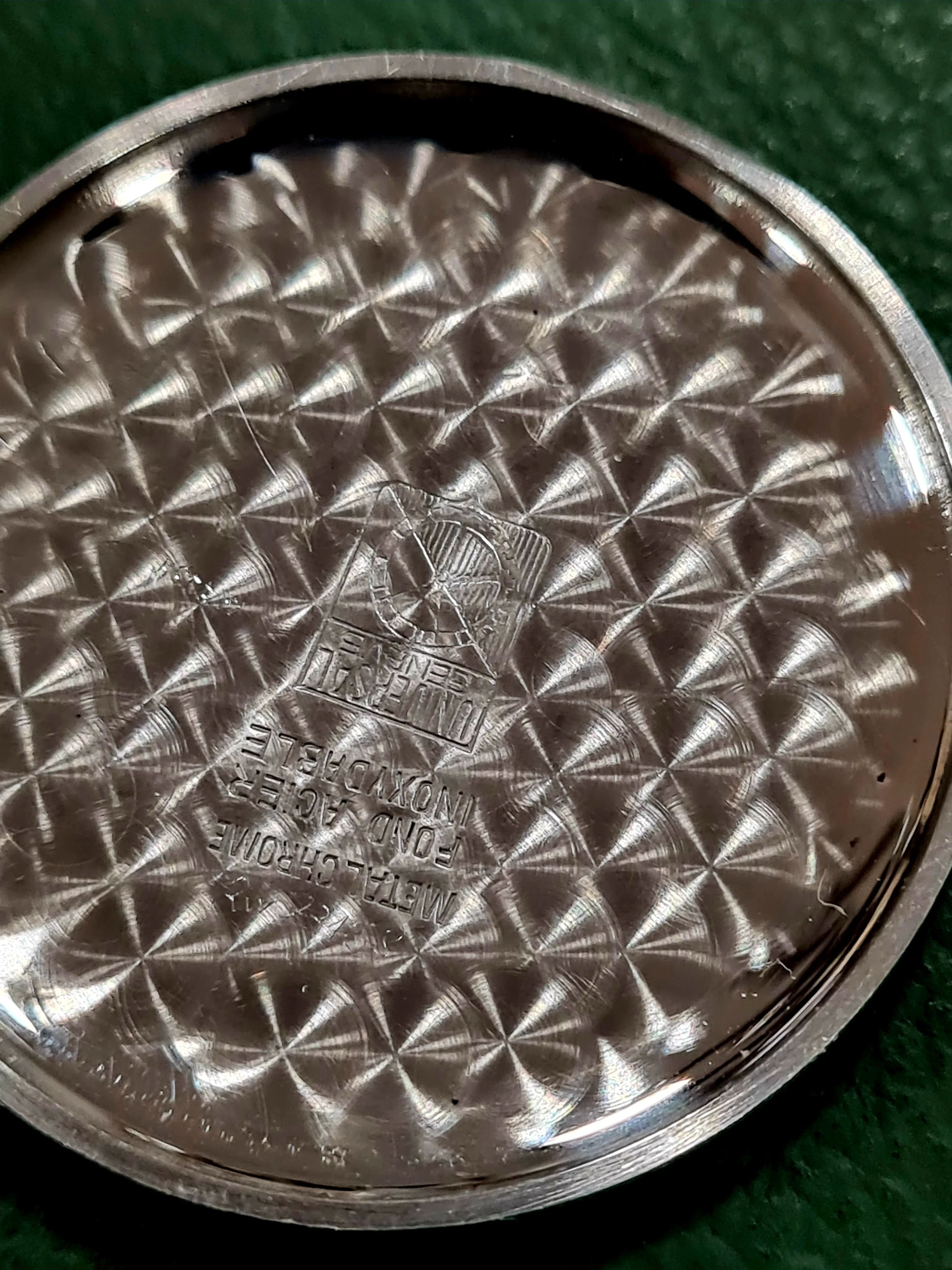

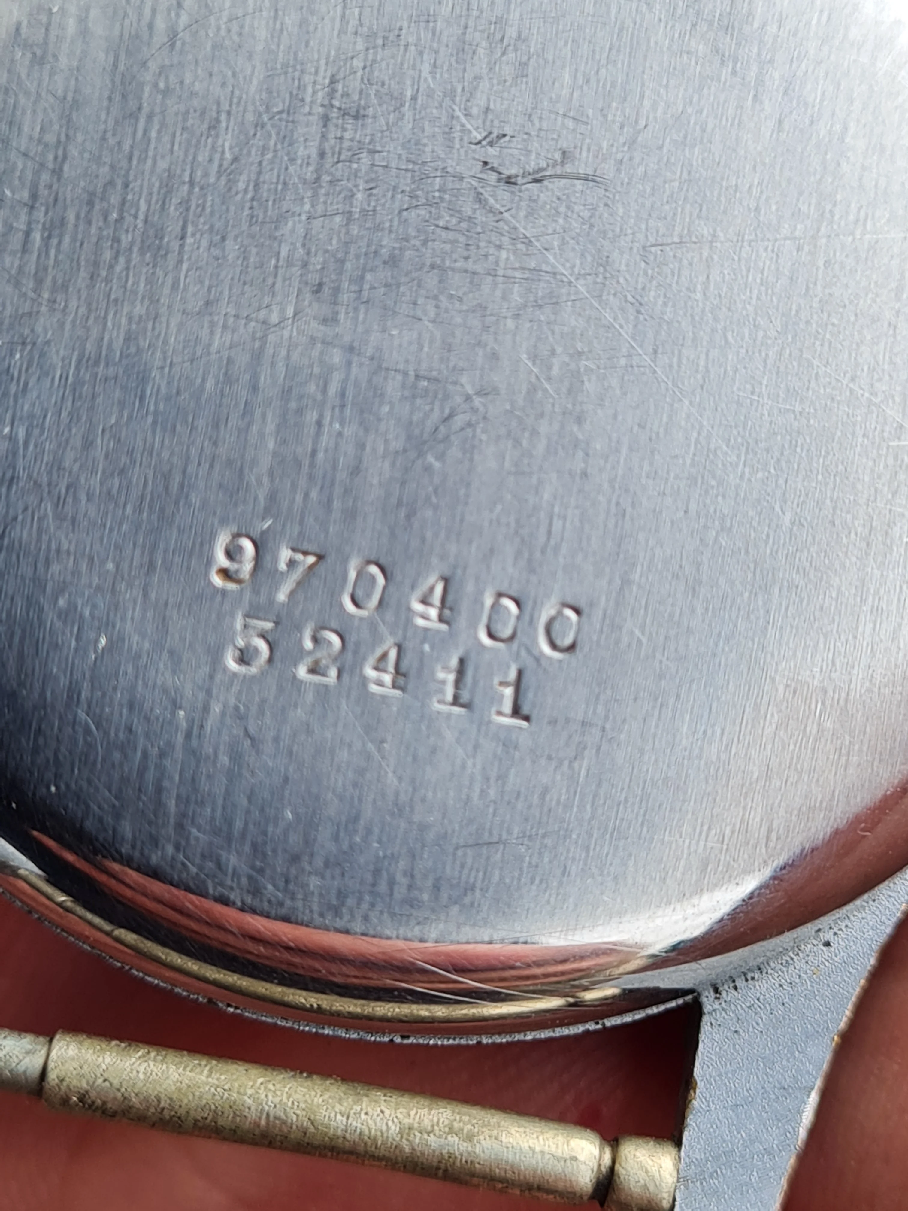

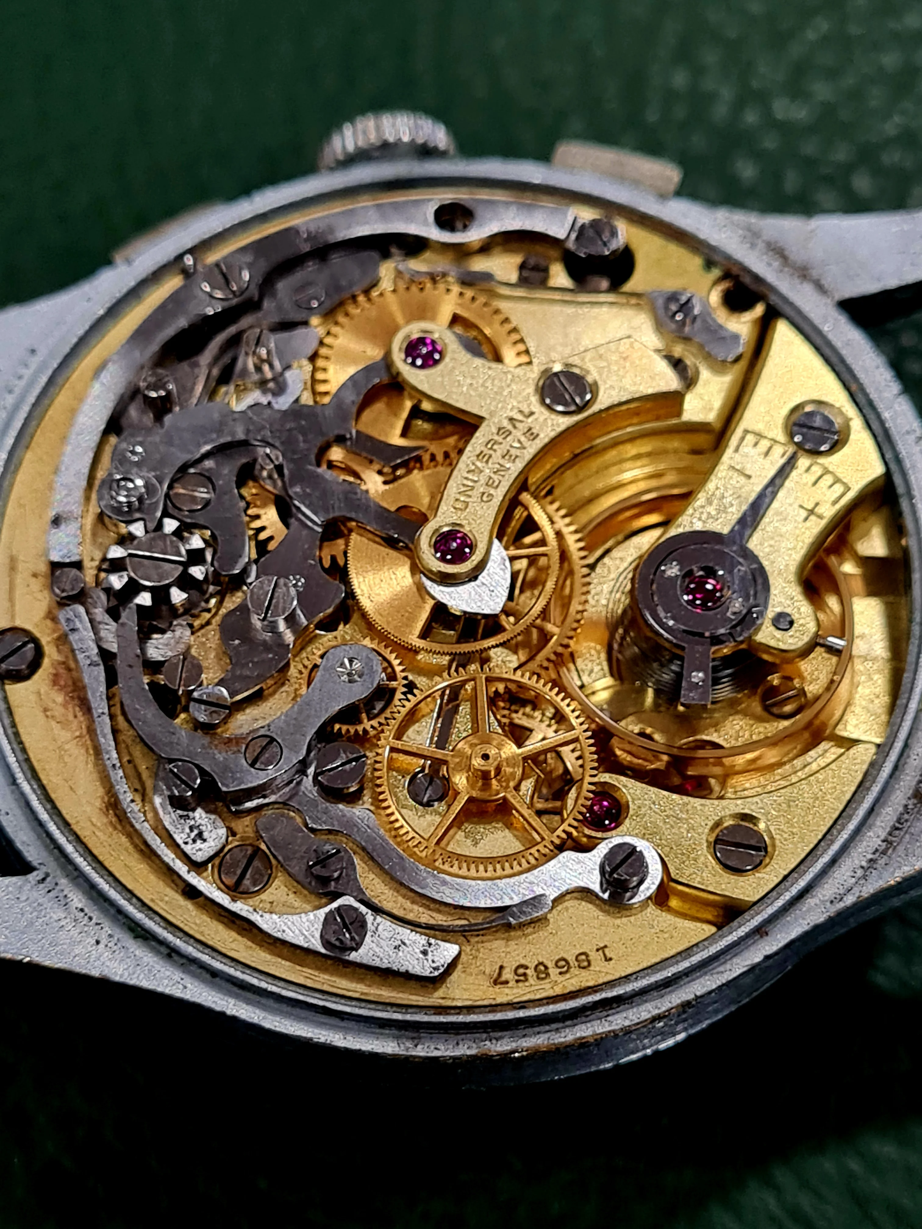

After I picked it up, I opened the caseback and saw the Universal Geneve 385, I guess.
But without "385" engraving.
The movement runs and it will get a service.

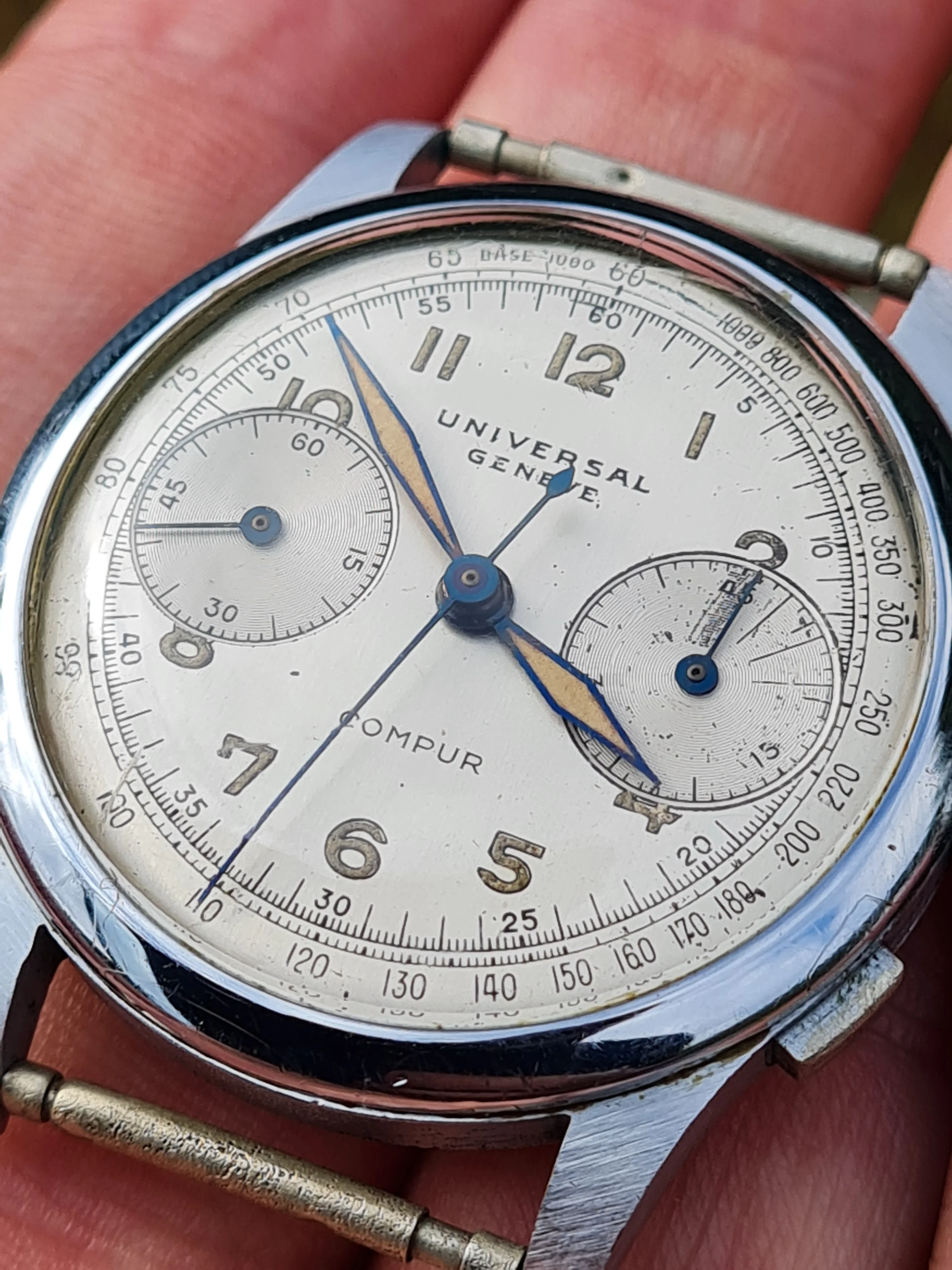

The lower pusher is a little bit sticky, but works.

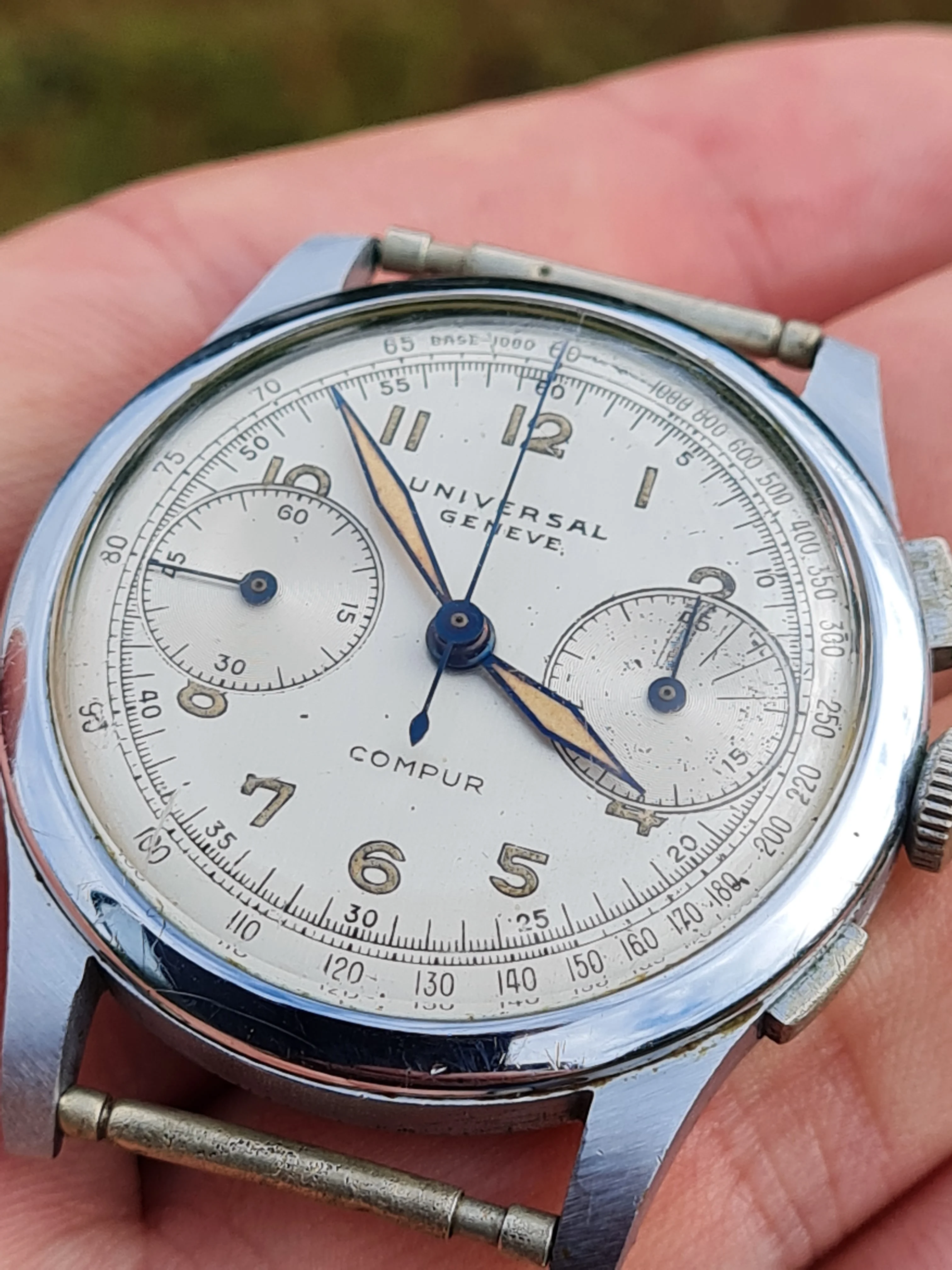

My watchmaker told me, that it for sure is possible to re-chrome the pushers?!

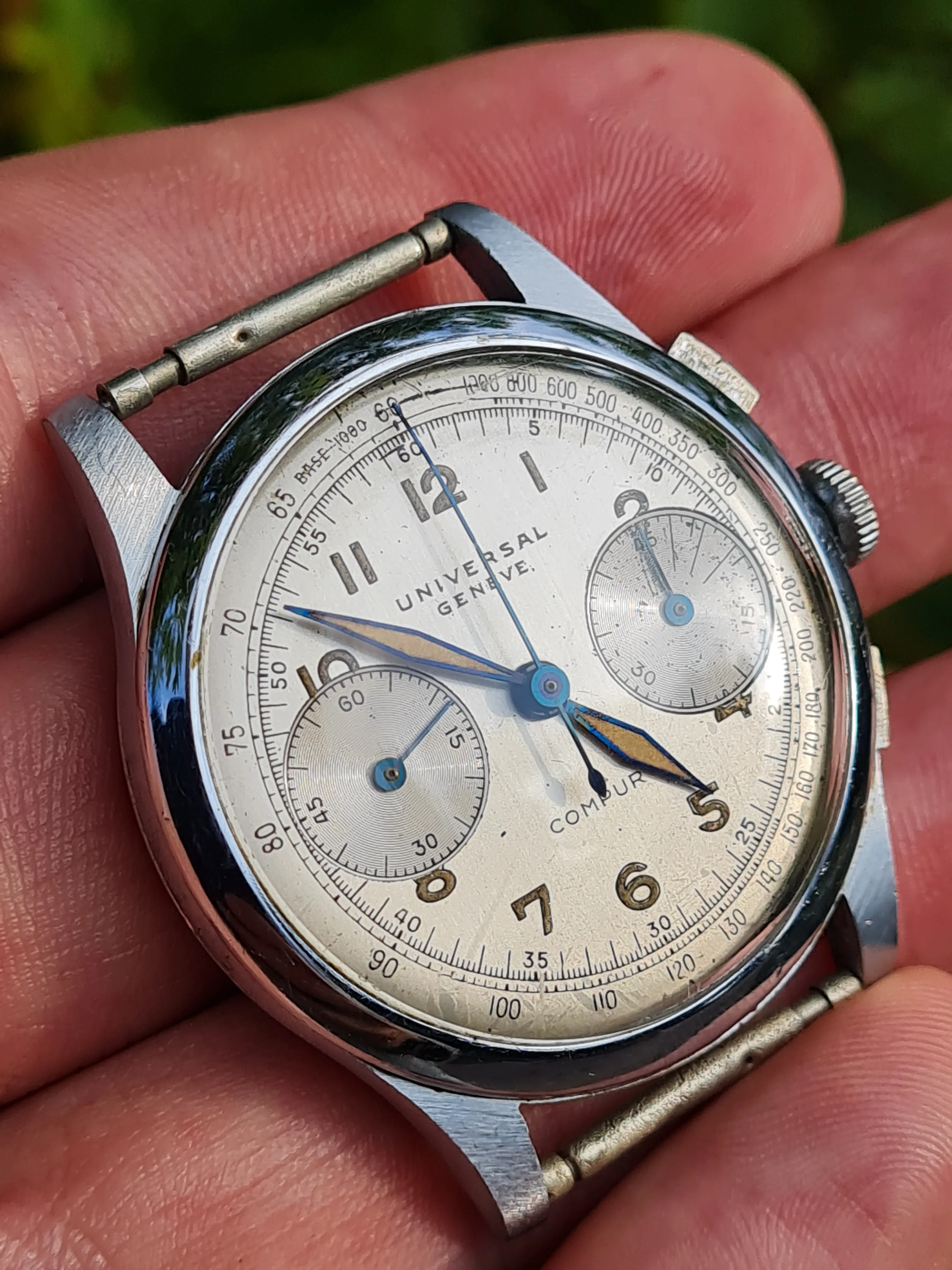

Otherwise, the watch seems to be in good condition for its age.

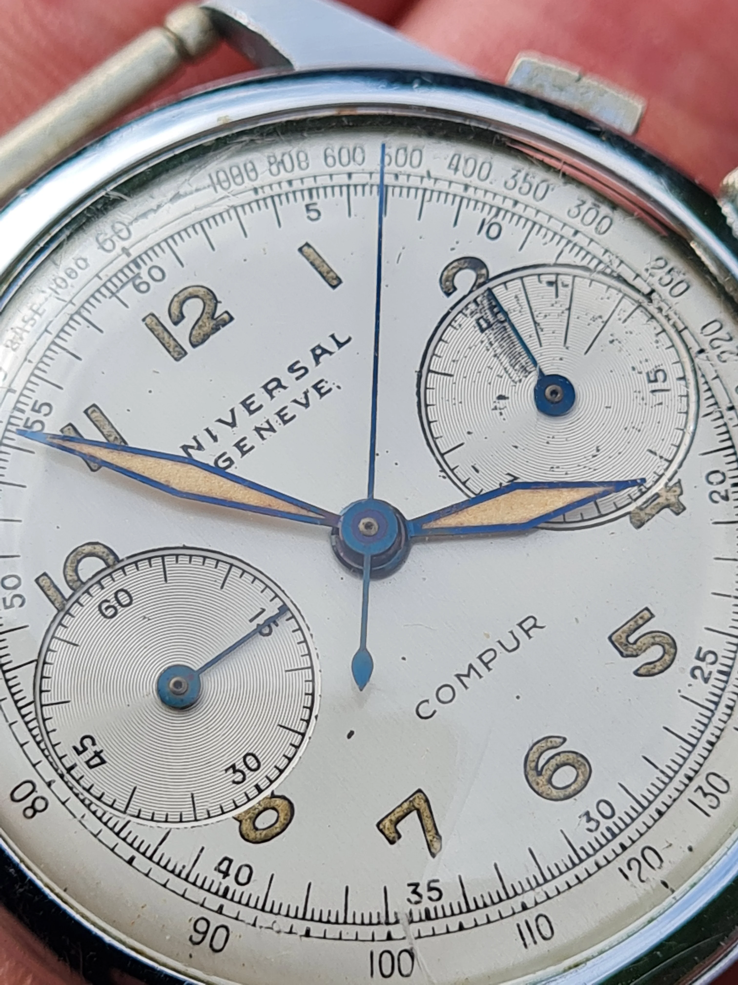

Has some dial issues under the hand of the minute counter, but that's no problem for me.
The hands and dial have genuine radium lume (should I fix the lume of the hands from behind?).

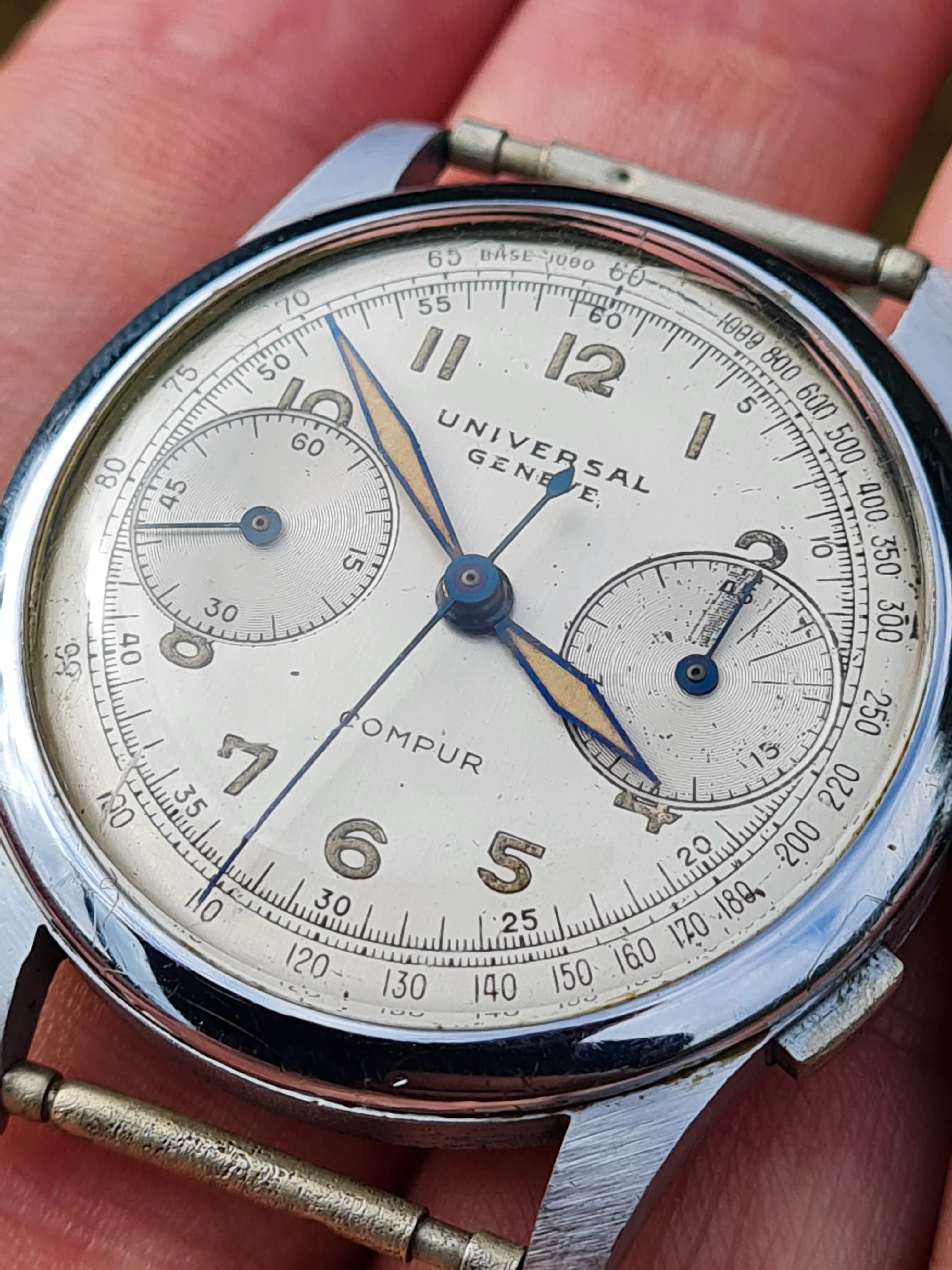

Overall, I am very satisfied with the condition, but what would you do to wear it and prepare it for the collection?
Pics:
Thanks in advance for your help.
Best,
Peter

Nice catch!! 👏👏👏👏👏
I would do just a service and immediately on the wrist! 😍😍
6,903
10,766
I would really not bother replating the pusher. In the end it will look to new
153
155
Yes, just keep as is
Looks quite nice as is.
Re plating only the pushers will look out of place IMHO.

O.k., seems like a clear statement.
So, the watch will get only a mechanical service.
Thanks at all for the help!
The movement number is correct though so the movement it original to the watch (and most probably a 287)
32411 and 32412 are interesting references. Not mentioned in Sala but quite large batches. I think both references will have been made in 425 pieces

Do not allow your watchmaker to talk you into swapping out the female spring bars. Clean and lubricate. Take good care of em because they are almost impossible to find in this size.
304
2,383
Thanks for all the informations!
Very interesting news.
Have to find the differences between UG287 and 385.
Female spring bars on such watches were new to me.
I saw them on gold watches, but not on this chronographs.
At the first visit at my watchmaker, he told me, that there is no problem to get new spring bars for it, but he is no Universal Geneve expert.
So, good informations!

Beautiful watch, great condition, don't touch it aside from a service ! It looks perfect that way it is, congratulations!
12
19
Amazing piece, real eye catcher when i saw it comeby 🤩
44
42
Great find, no way I would fiddle with those lovely hands. Case and pushers present well too in these photos, i like the signs of it’s age.

Thank you all for your good advices!
The UG is still with me and one of my favorites.
Serviced 4 months ago and left all as it was....
