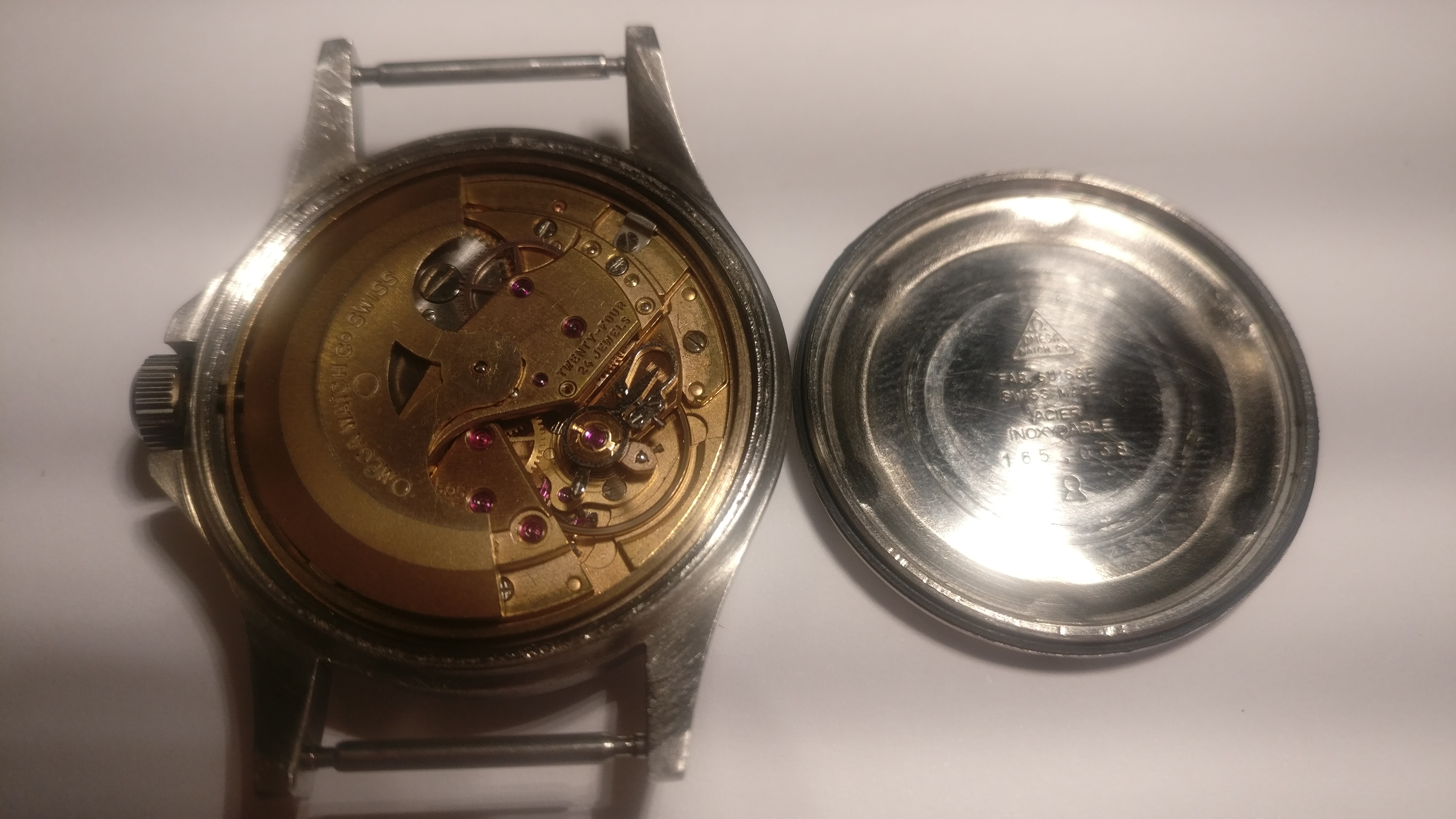

That does not look a good watch as it has some issues already pointed out and the movement looks poor.
After getting the proper bracelet, I wore mine a lot in 2017 but now I hardly wear it and will probably sell it this year but I'd need to service it first and am very busy. It's a manual, no date and there is a picture here. If it's of interest, let me know and I'll point it out to you if I get around to listing it.
Cheers, Chris
Hello Chris
Thank you for your reply. I still proceeded on that watch after I found the right crystal and crown on Ebay. Like you said, the movement of the watch looks to be in poor condition, I probably need to have it serviced as soon as I get it. Cheers!
Yuze

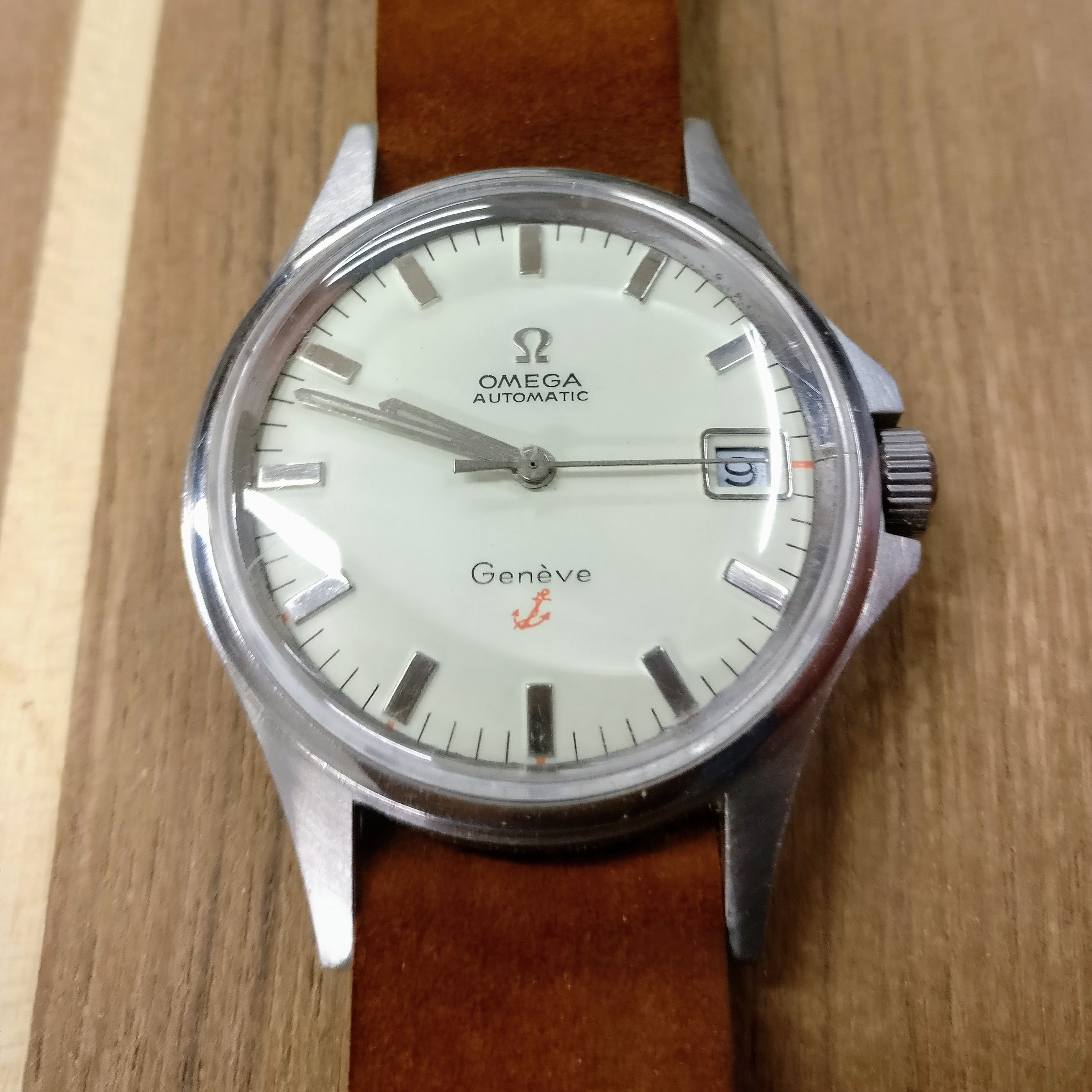

Hi there,
I've recently purchased an admiralty but I've never seen a dial or hands like this one.
Any ideas?
Sorry to say, I don't think that dial ever was an Admiralty dial. The markers (style and layout) are not ones I've seen on an Admiralty nor are the hands. Regardless of it's origins it's been refinished to it's present state.
10
It all seems legit even to the point of the orange markers still being present at the hour marks bit I agree, the markers and hands are not original.
10
Do you think it's just a refinished dial? Or something more sinister like a fake?
13,506
31,844
Not a fake but it's not an Admiralty dial either, just a random Omega dial refinished to kind of look like an an Admiralty dial.

Haygarth-I suggest you leave it as is and just enjoy it as a daily wearer. It looks like an authentic Admiralty case, back and movement from what I can tell from your photo. The dial, hands and winding crown have been replaced. Someone put a lot of time and effort in restoring your Admiralty and it's cool to imagine the stories it could tell. If you end up getting hard core obscessed about this particular model (like I did a year ago when I started this thread), you can pick up a more "collectible" example with the specs you feel are most desirable (short lugs, hands and dial combo you prefer etc.) in time by watching the used market (eBay, forums etc.). It took me exactly one year to learn about them and accidentally find my favorite all around example so it's not exactly an unobtainable grail watch if you know what I mean....just my ten cents....
