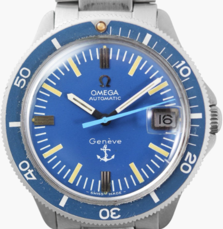

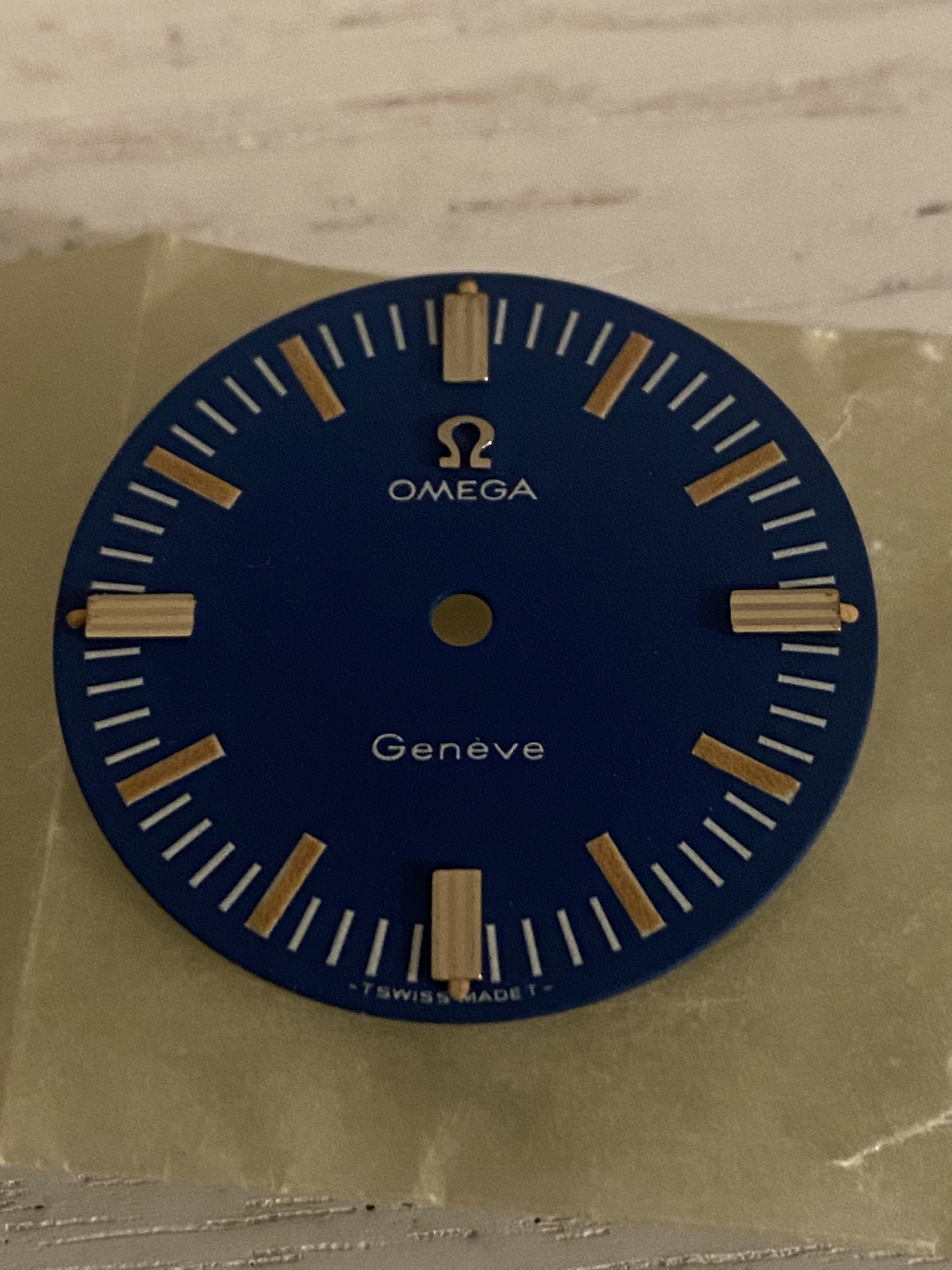

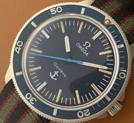

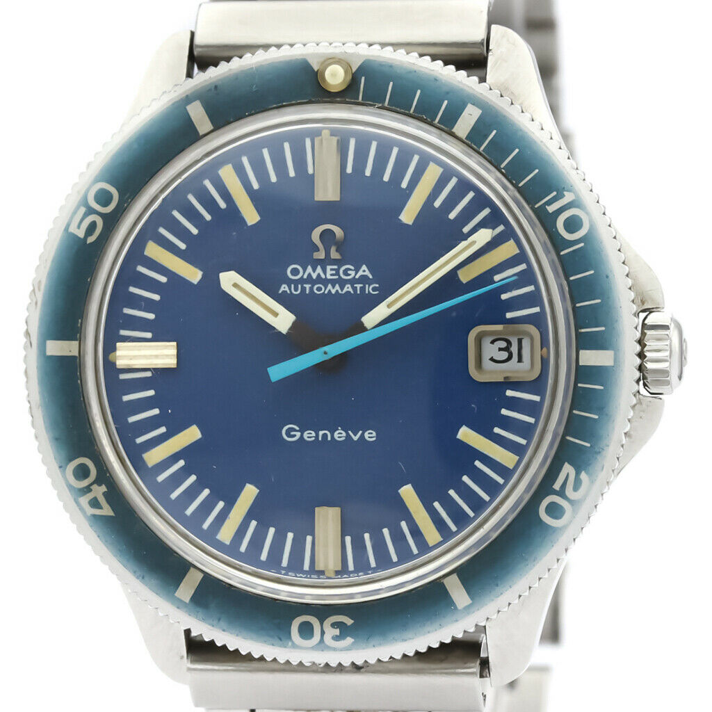

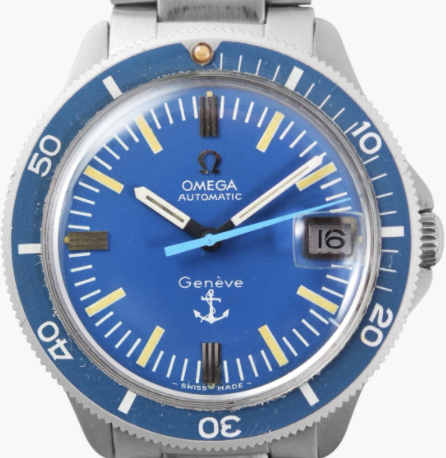

Replacement crown, replacement 12,3,6,9 hour markers. Seller stated in the item description
Seller thinks it's original.
4
Seller applied silver markers to 12,3,6,9
If you cross-reference with other blue diver admiralties, its 3 metal stripes for each marker, not two ( that ebay listing)
Other than those applied markers the rest of the dial should be original...
The vintage watch market for omega admiralty line is filled with tons of frankens 馃檨
273
443
Not much information about these online.
You're right. I see most of them have 3 markers in corner, and not two..

Check out this hot mess that was just listed: https://www.ebay.com/itm/233732192632?ul_noapp=true
Pretty sure I've seen it listed for sale before.
I'm pretty sure a no-date version of the automatic reference doesn't exist.
Edit: The caseback is for the auto version with date, so full on franken here. 馃ぎ

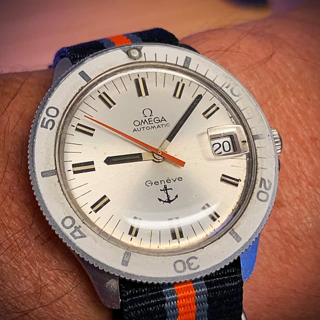

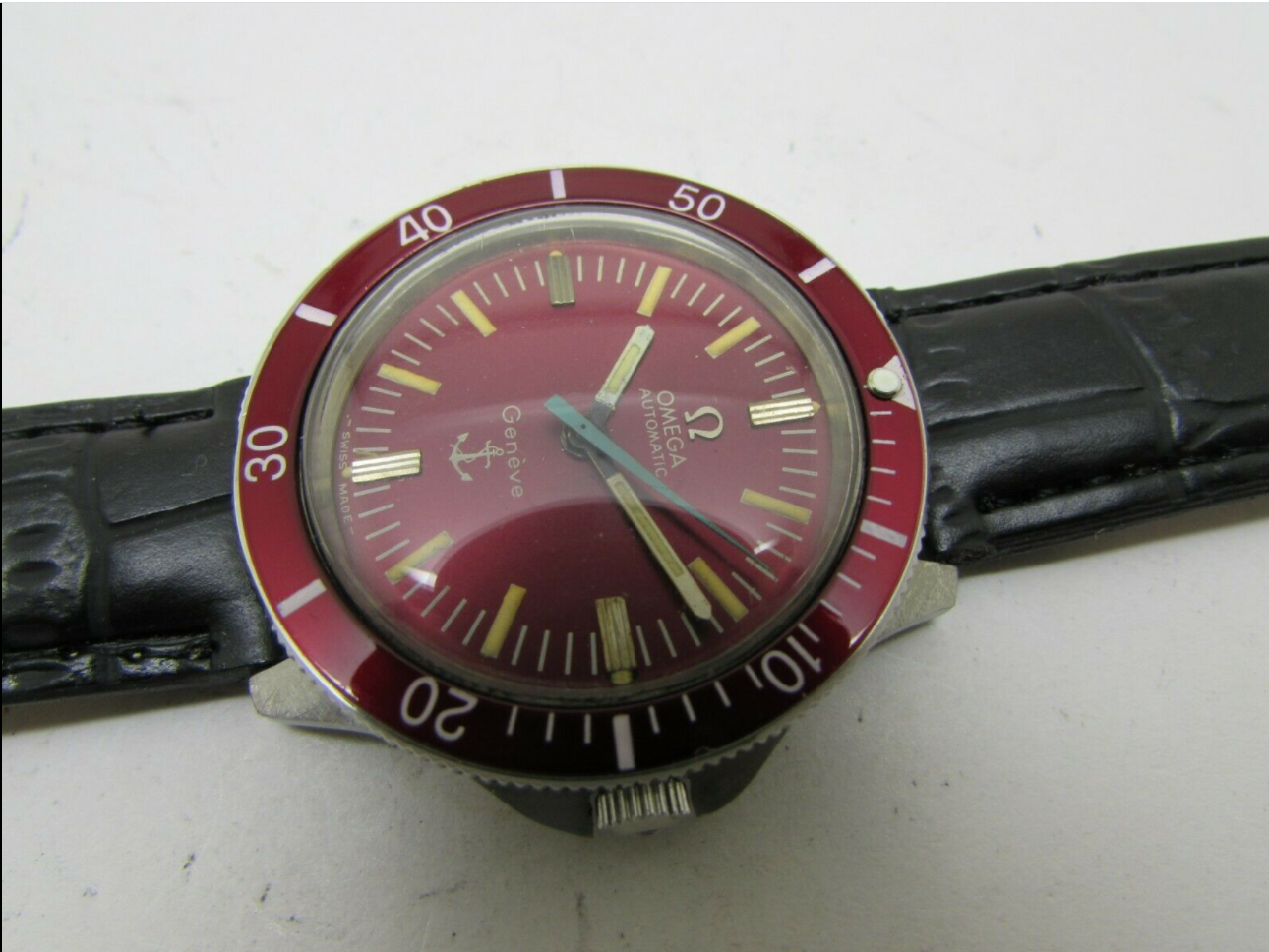

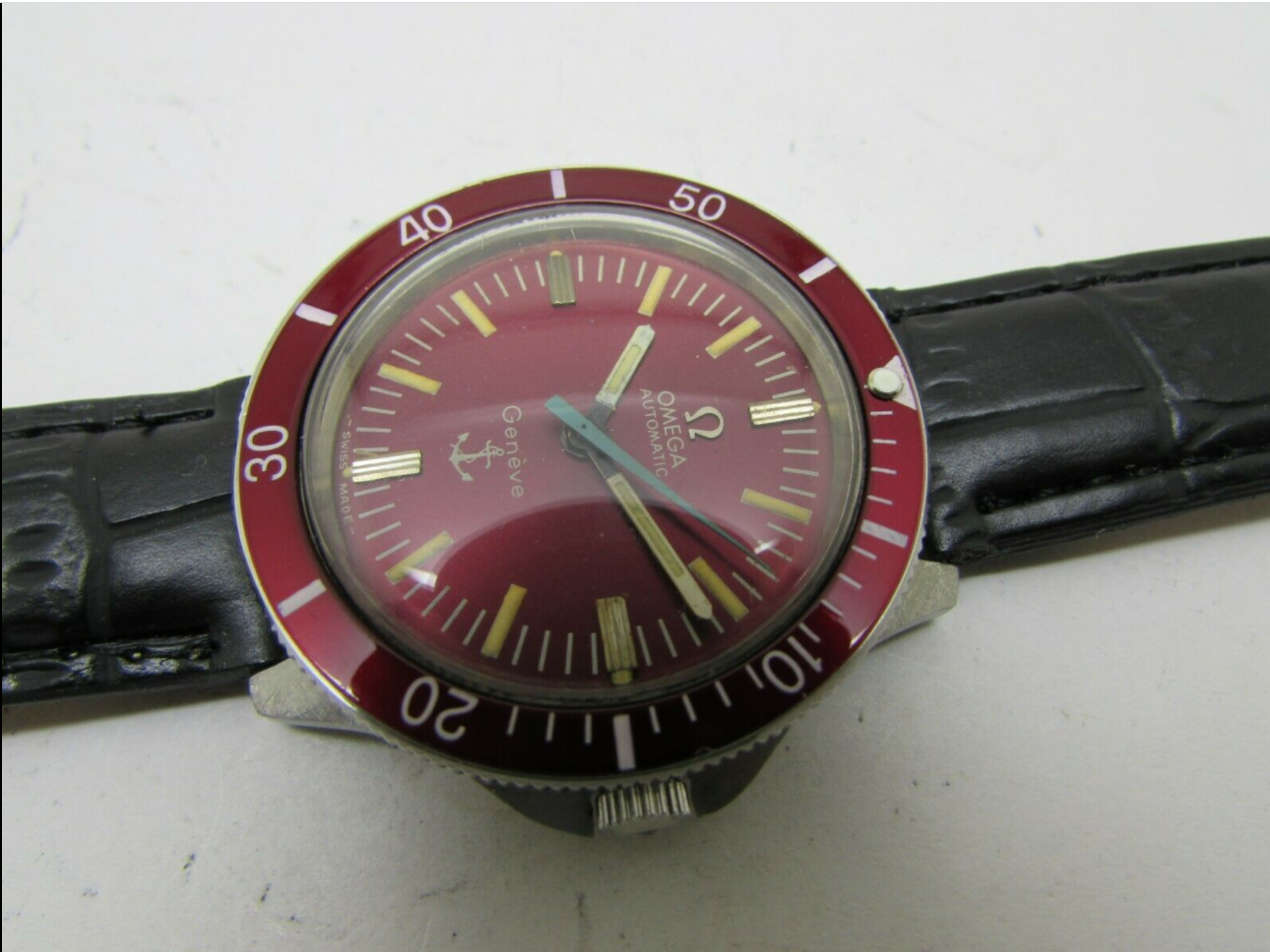

I also have a red dial but cant find it at the moment.
Thank you, concerning your hypothesis I don鈥檛 know what to say.. non anchor dials are quite common..
233
178

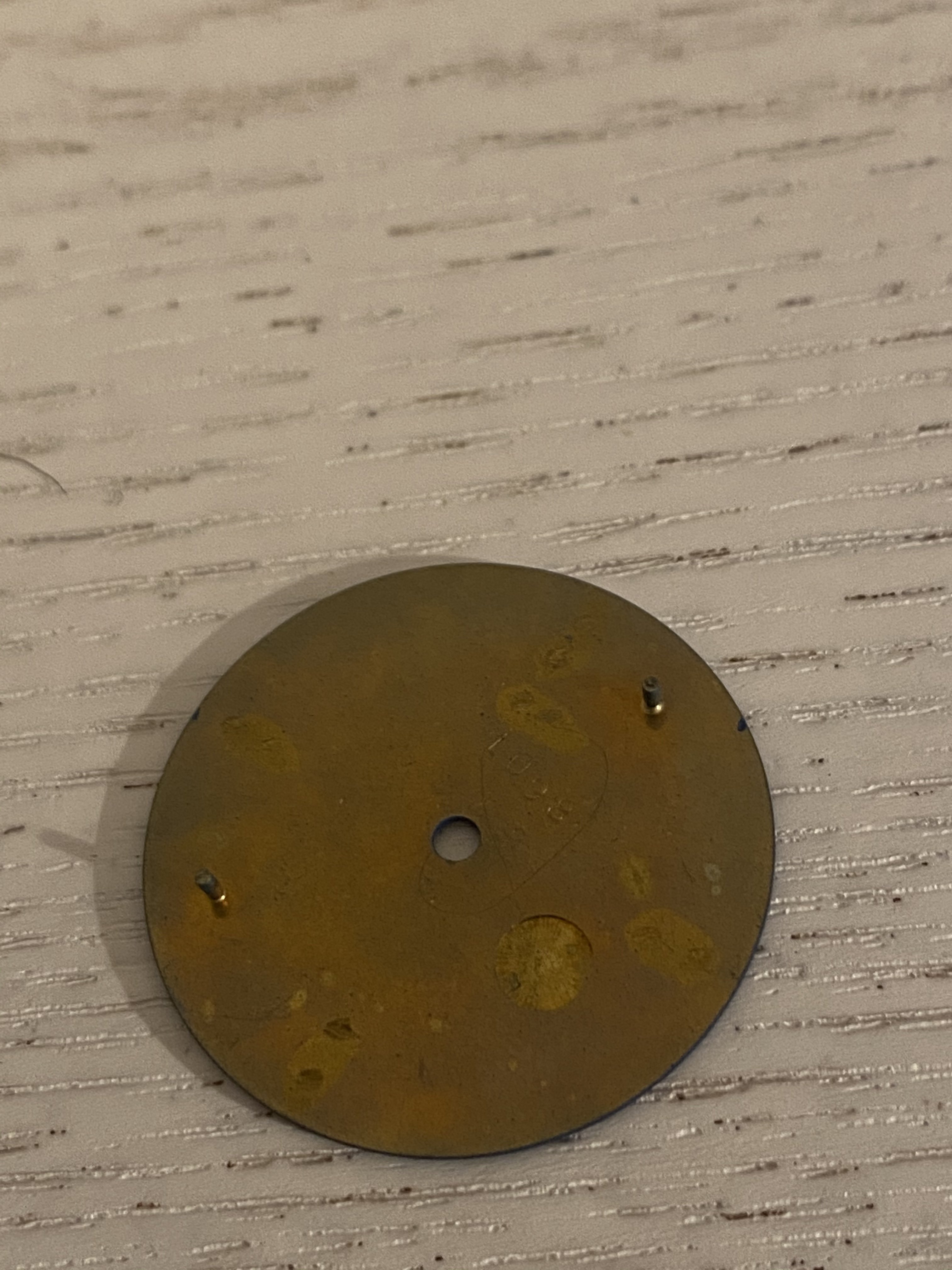

Non anchor dials are quite common but then again so are NOS parts for the Admiralty line in general and i鈥檝e never been able to figure out why. A few years back i also purchased some NOS admiralty diver cases and when I asked the seller where they came from, he told me they came from an Omega service centre in Hatton Garden that had closed down. Im not trying to undermine owners of non-anchor admiralties and say they have frankens but its just an observation.

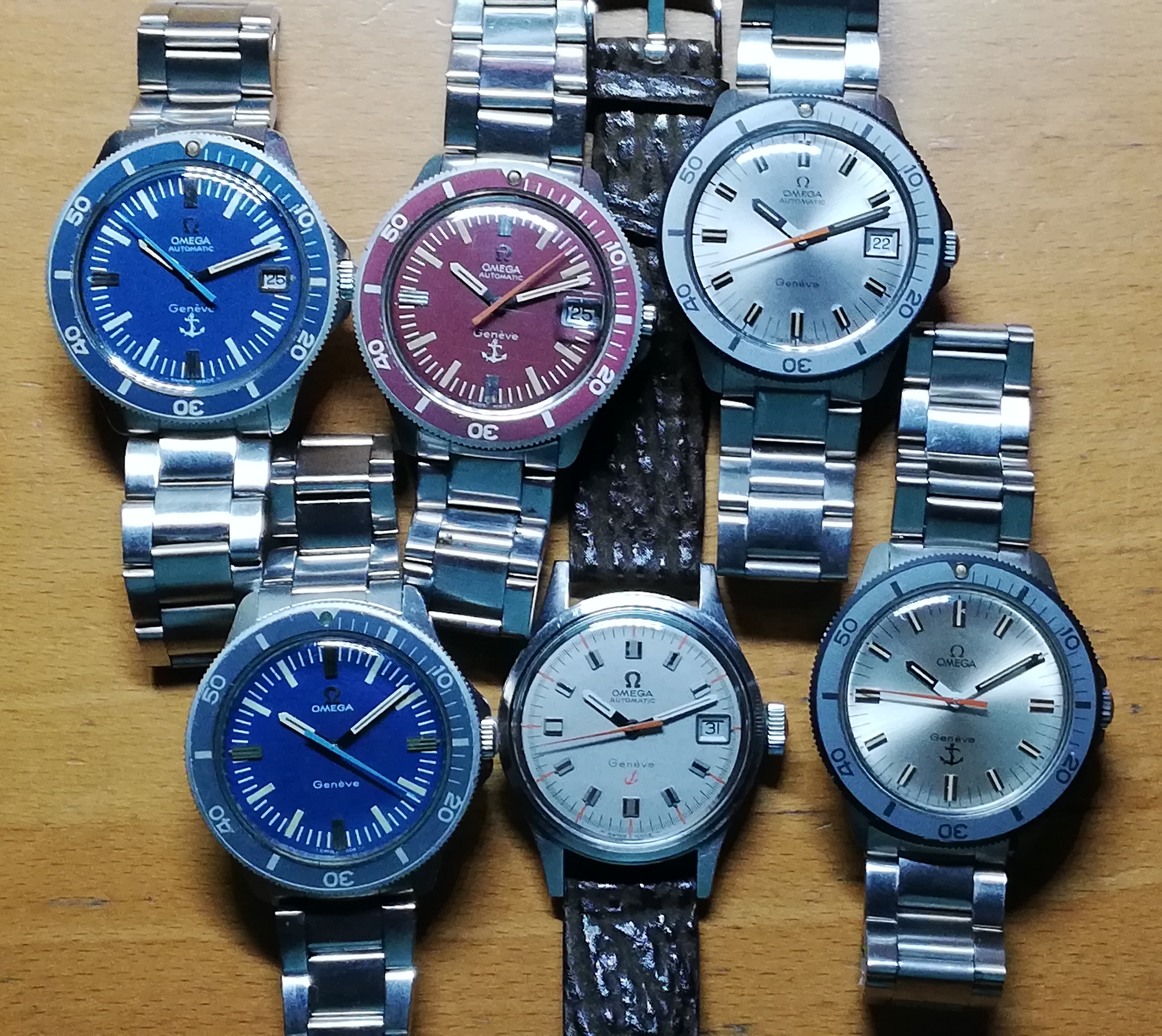

Hi, I've the 5 divers for a long time and got the other one last week.
I did'nt realize that the 1168 bracelet won't fit and that I'd have to find a fixoflex...
Is there any other ss bracelet that would fit?
Or a place to source a fixoflex ?

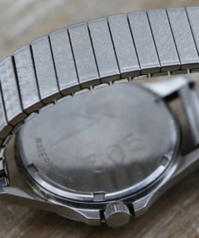

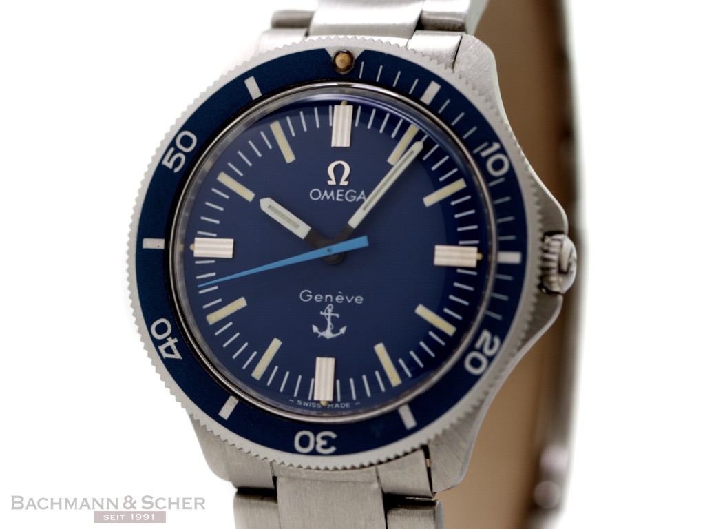

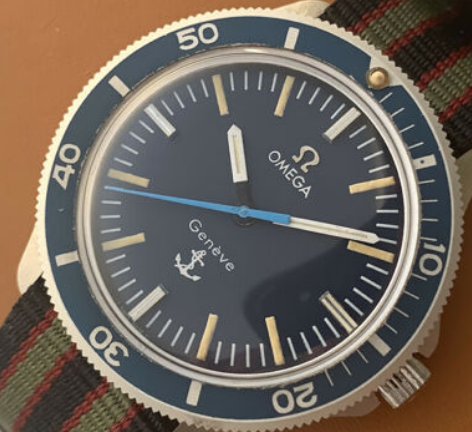

This 166.054 just showed up as 'NOS' which I find hard to believe. But do you see anything wrong with it ?
The case look sharp, the marker at 9 looks faded comparing to others or this might be the light?
The crown looks like to have to the small logo which is right?
I asked for better pictures, so we will see.
https://www.ebay.com/itm/Omega-166-054-Nuovo-Nos-New-Vintage-Watch-Sub-Diver-Orologio-565-Ancoretta/324376945642?_trkparms=aid=111001&algo=REC.SEED&ao=1&asc=20160908105057&meid=4a92ff8c79cd403ab69ab80986a20c6c&pid=100675&rk=1&rkt=15&mehot=pp&sd=324376945642&itm=324376945642&pmt=0&noa=1&pg=2380057&brand=OMEGA&_trksid=p2380057.c100675.m4236&_trkparms=pageci:bd5abfc7-296c-11eb-961b-ea1694adf4e0|parentrq:da2e206b1750a4821d8f6cfafff0f846|iid:1
I believe it was NOS since it has the price tag with matching mov number.

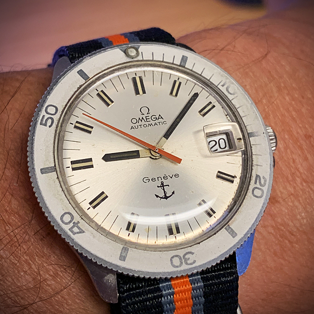

I don't know how I missed this thread, so glad this watch gets some well-deserved attention.
Ahoy, mates! Ensign Bakelite, reporting for duty!
Ref. 166.054
Cal. 565

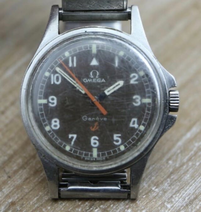

This one popped up for sale in Australia this afternoon. It appears to be another Queensland Rail issued example.
1,322
1,826
could make for a nice restoration project at the right price.
