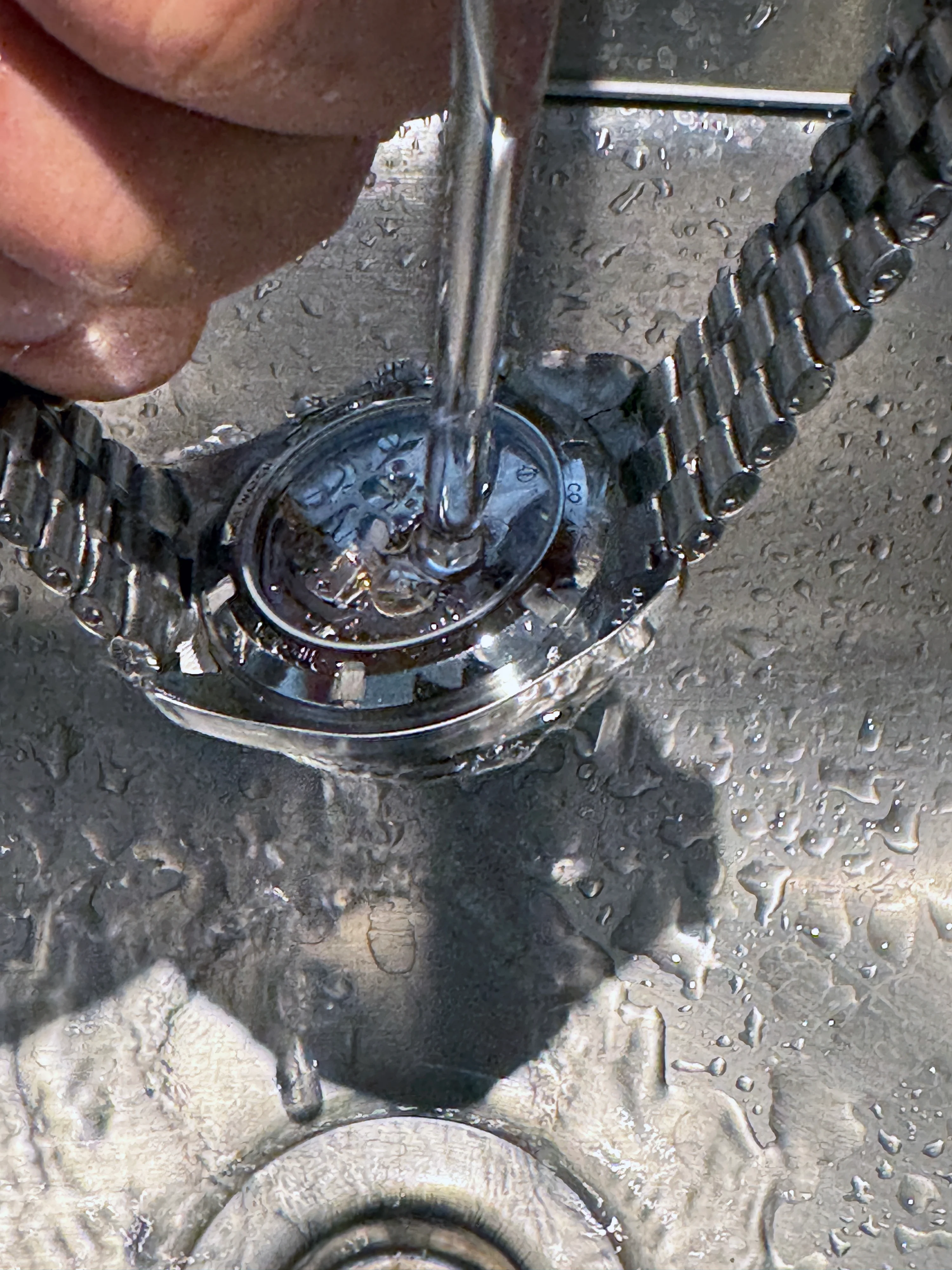

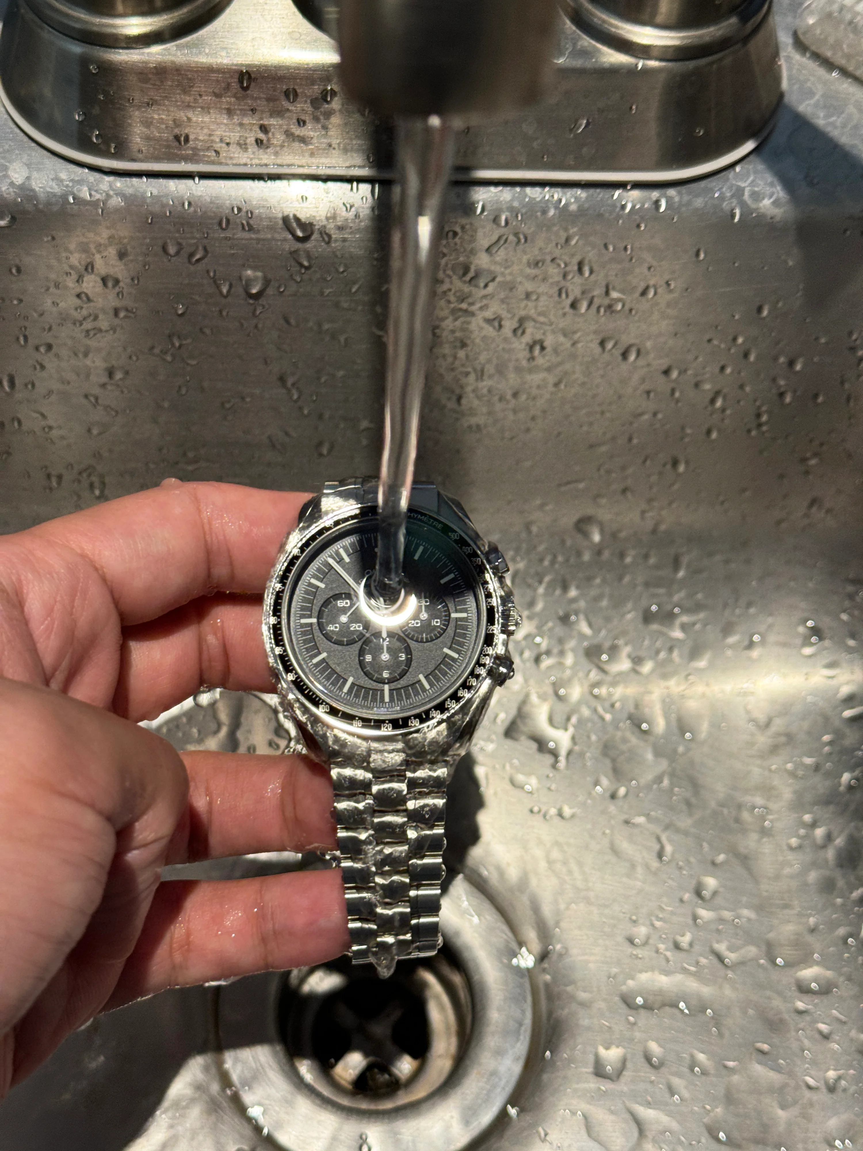

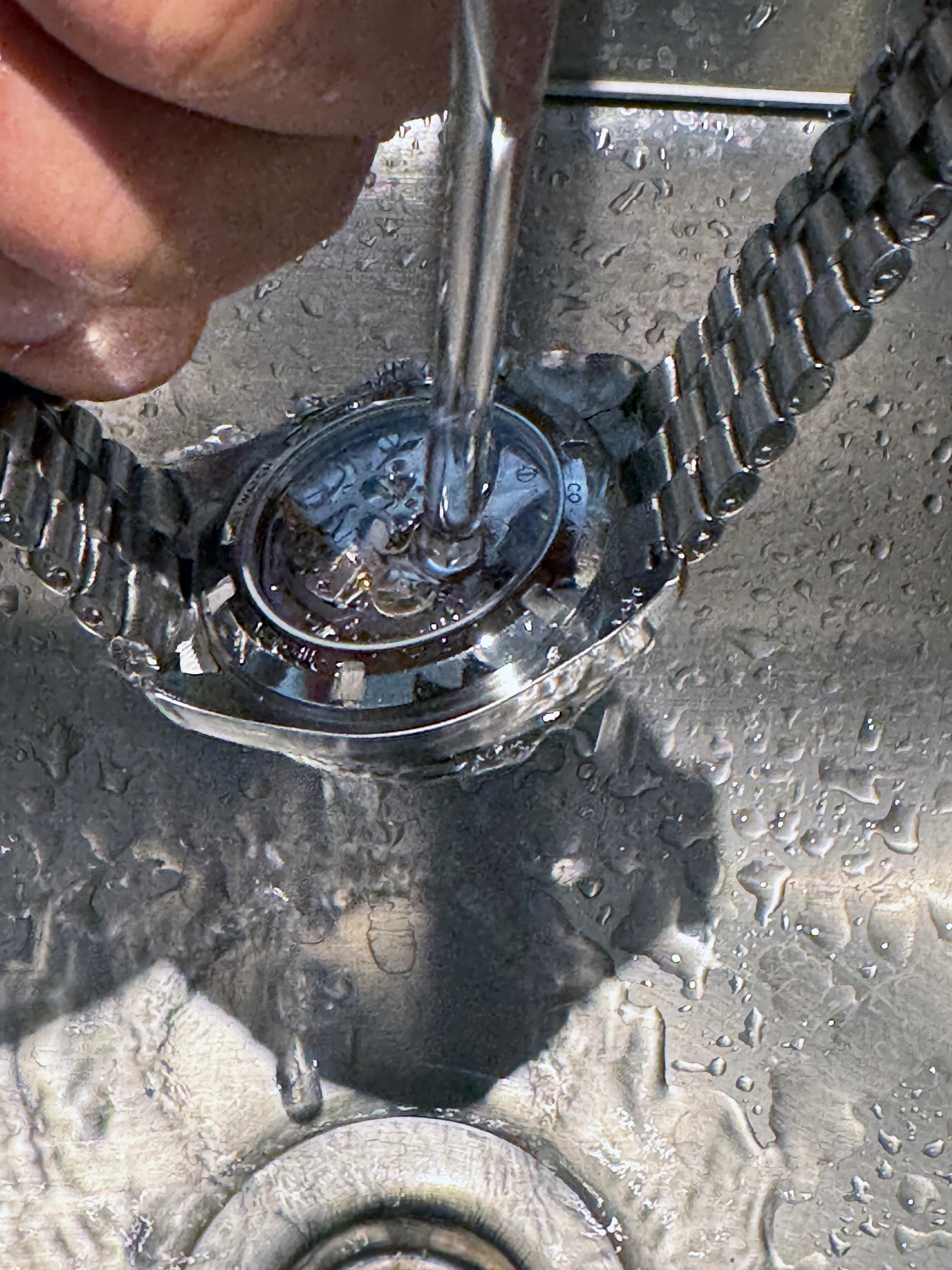

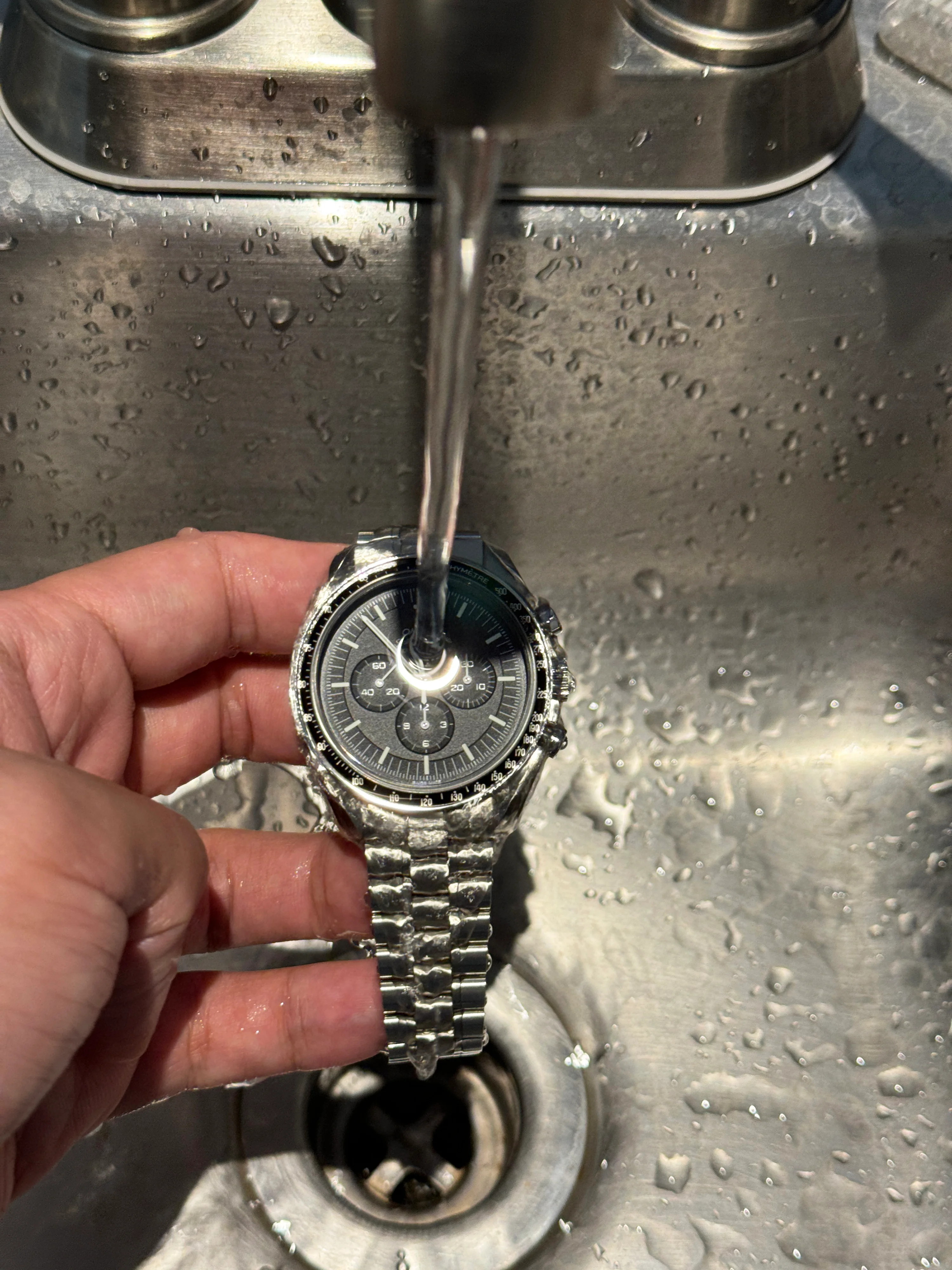

It's a modern Speedmaster. Just rinse it in water. Use a bit of dish soap and a soft toothbrush to agitate the debris & gunk if rinsing only is insufficient. Wipe off with a microfiber cloth after.
Just don't wind the crown or operate the pushers until everything is fully air dried.

Unless you know the state of the seals I wouldn't put it under running water. The other suggestions are good to get the gunk out from around the crown and pushers.
15,218
44,690
Right! Ask me how I know!
