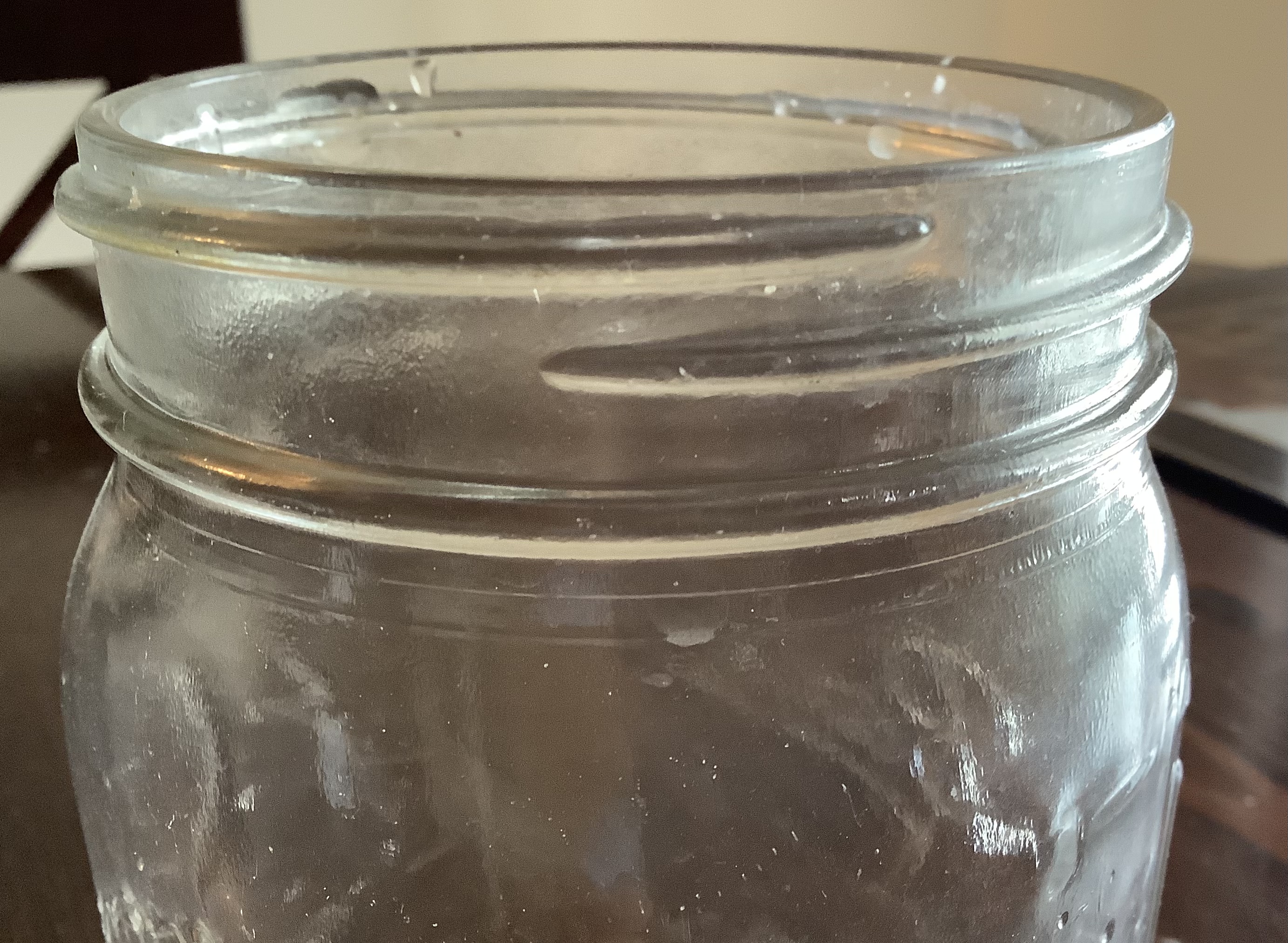

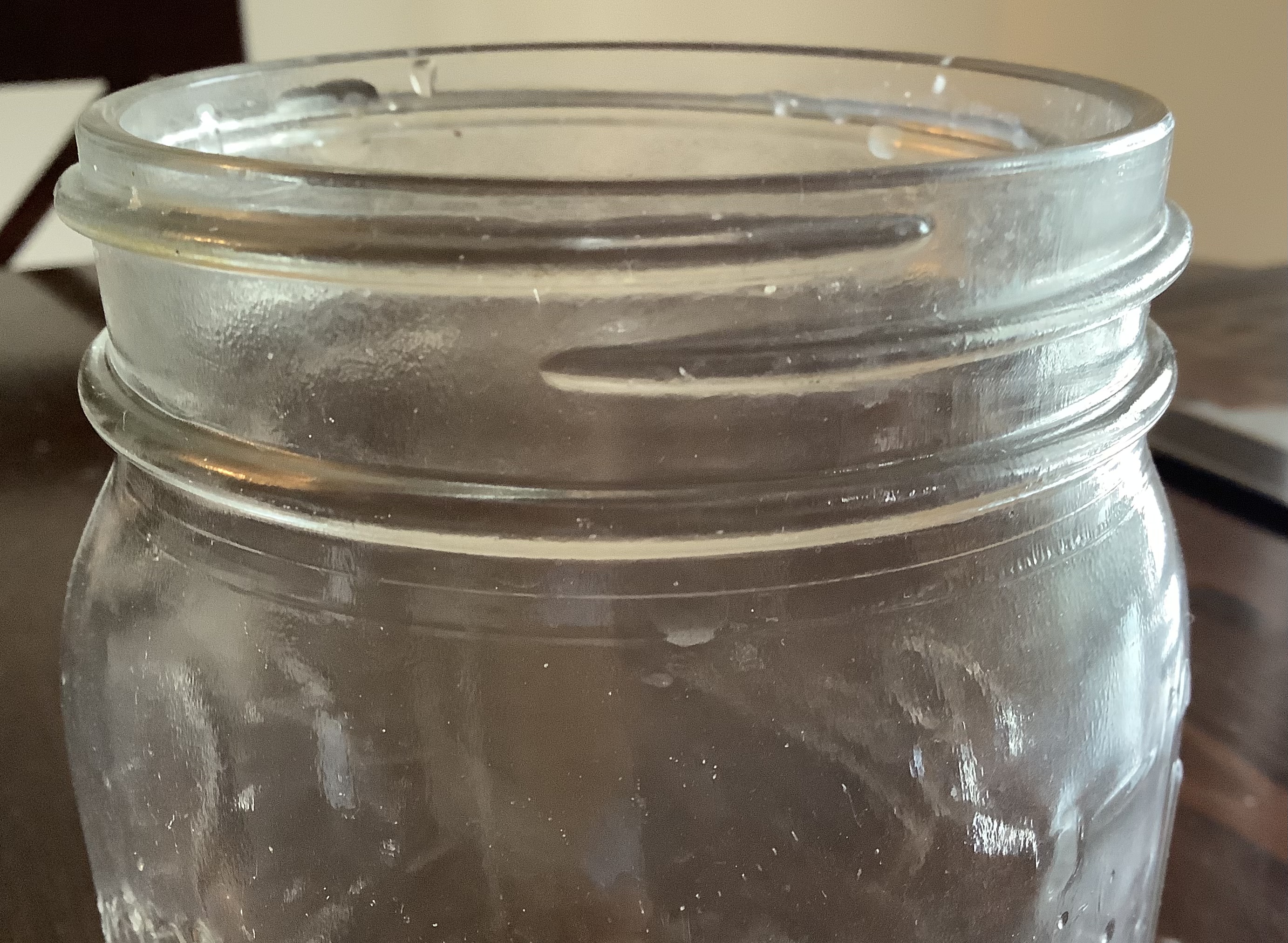

Now, I don’t know anything about how these are engineered, nor the correct terms, but it seems like all thread interfaces have a notch, as noted below, in one of the mating surfaces:
I’m guessing if that spot is 180 degrees from where you start your turn, it might be tough to catch it on the first try. Although, maybe on crowns, there are a few of these spots to catch?
No, there's just one "notch" or start to the thread.
If it had 2, it would be a double start thread, and it would screw down quite differently. If you want to see an example of a multi-start thread, look at a bottle cap from a plastic bottle:
This one is a triple start thread.
