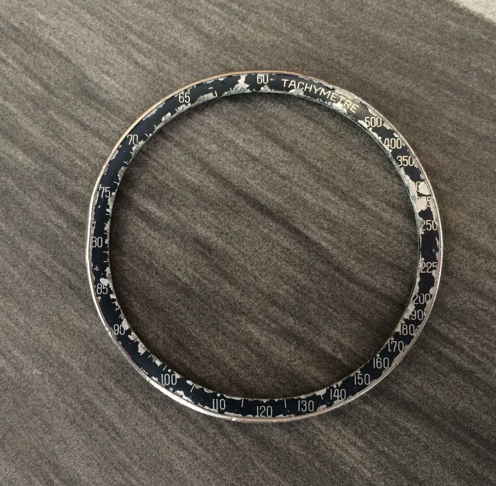

...enter the 'meteor' bezel...
_57-jpg.120329
Its like 'spider' dials and eBay-ruined 'tropical' dials.

^^ Awww, but you can still time a VW Microbus with it, assuming a fair wind at your back.
