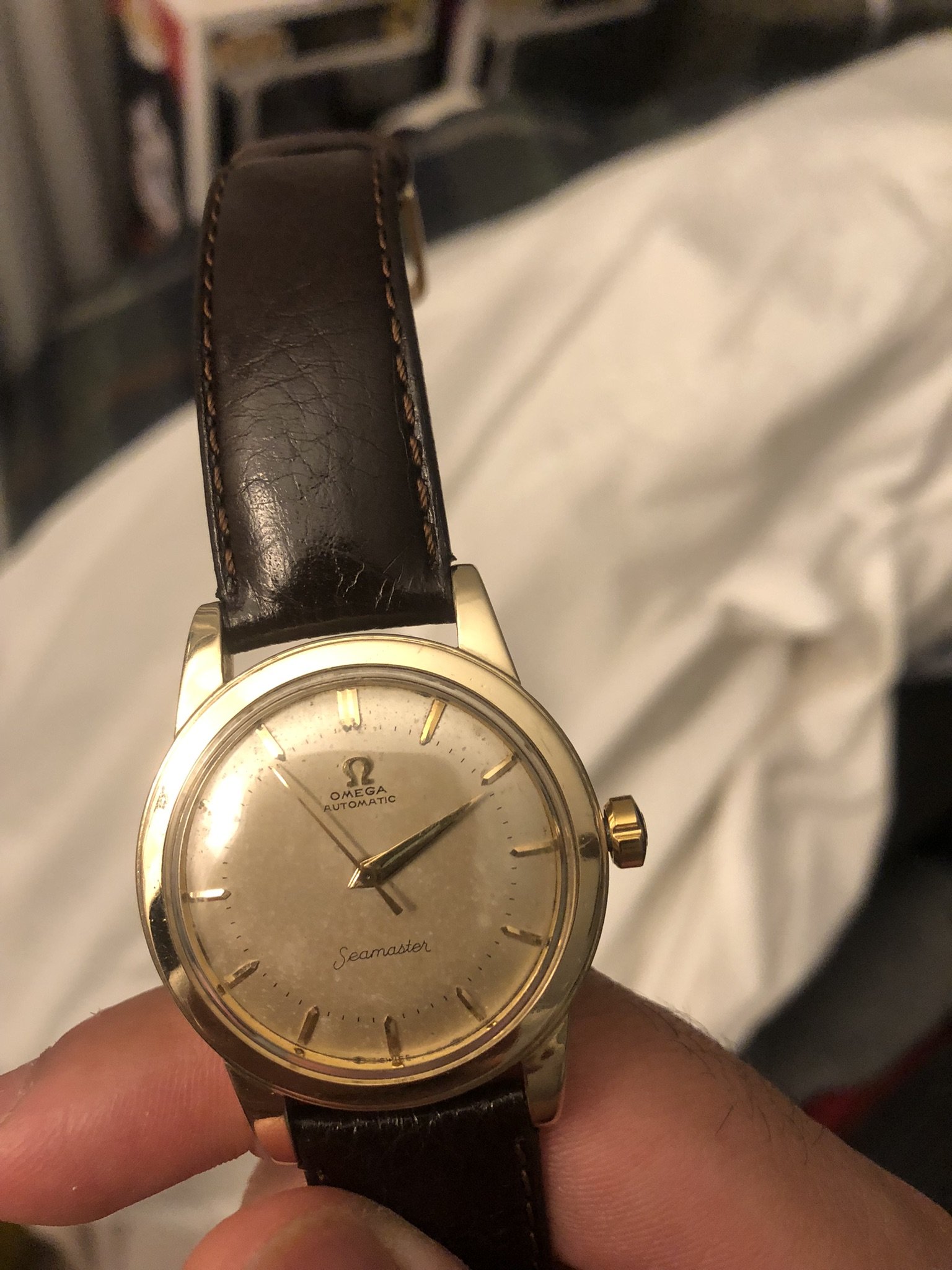

I have this Seamaster bumper that has gunk at the edges between markers 12 and 1, 8 and 9, 5 and 6, and 6 and 7. The local watchmaker wouldn’t entertain the idea of cleaning those spots and said to leave it alone. Is he right? I plan to change out the old hands at some point with a different watchmaker. Should I tell them to clean it then? Don’t get me wrong, I love the patina the watch has developed, it’s just the dang gunk that’s got to go.
Yes.
9,352
78,244
The problem, and your watchmaker probably explained this, is that using any cleaning agent or abrasive will inevitably irretrievably damage the dial.
Your photos are not sharp enough to see what the gunk between 5 - 7 is nor the condition of the hands.
Yours is a seventy year old watch and the likelihood of your finding age appropriate hands that would not look out of place is minimal.
As the medics say, “First, do no harm”.

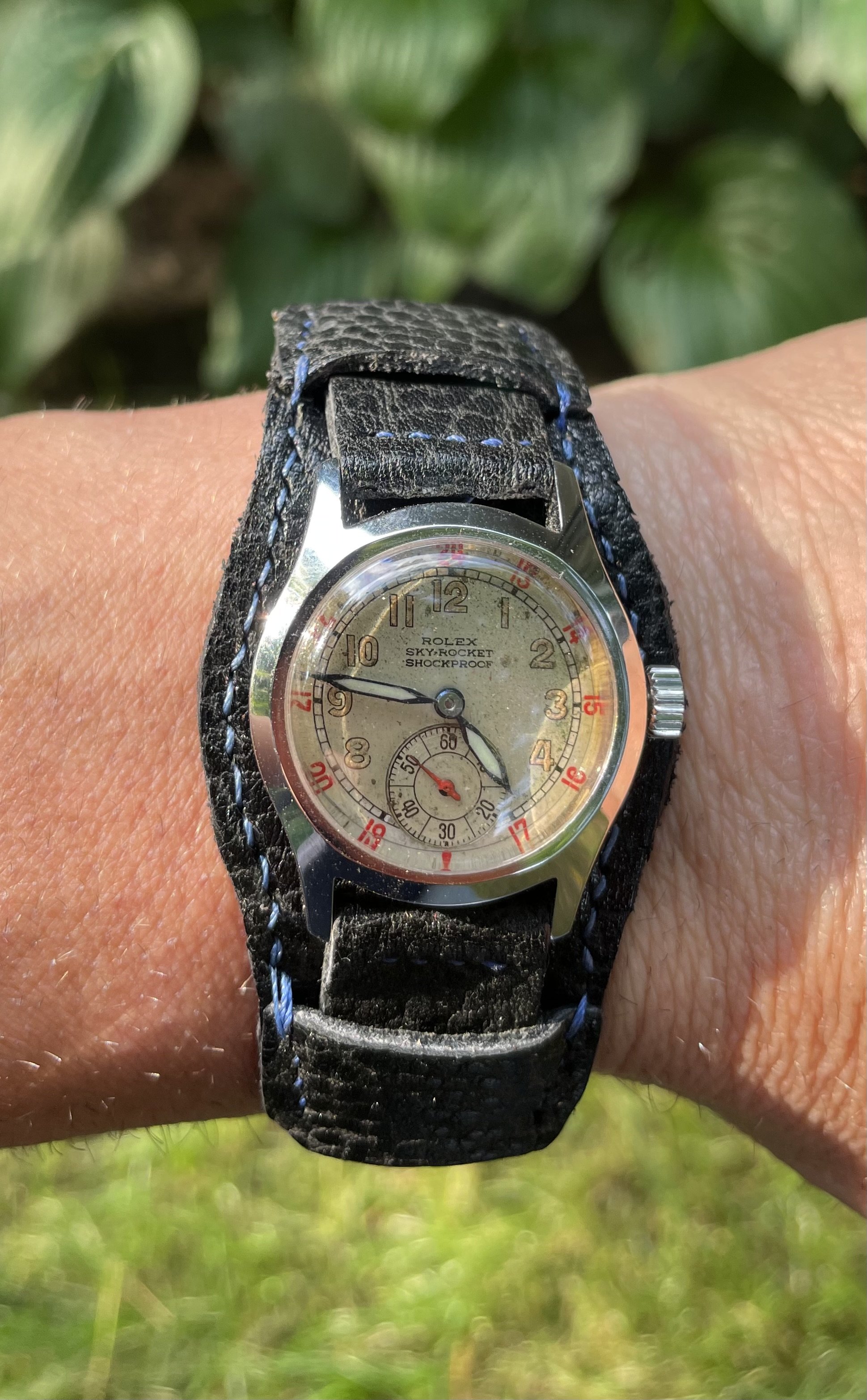

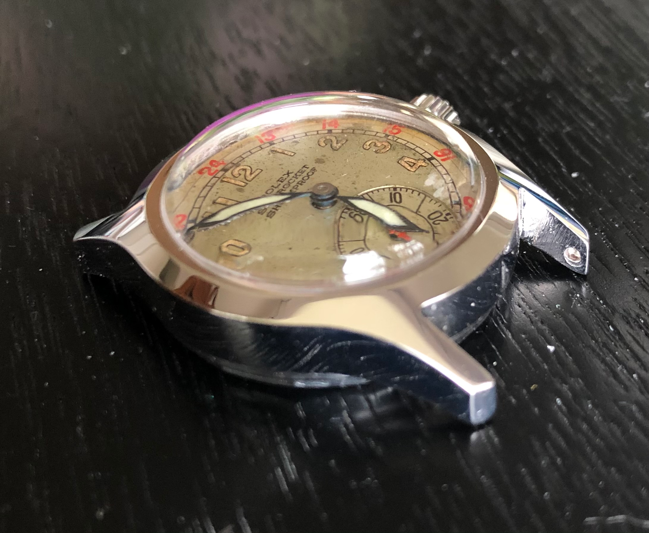

@Canuck gently cleaned the dial on this watch if I recall correctly. But he is a second or third generation watchmaker.
Honestly, he didn't explain any of that -- he just said no. The gunk just seems caked along the edges. I've been assuming it would be an easy clean up. He's a watchmaker that I met at the mall who has experience servicing old omegas. My watchmaker, who I bought the watch from, runs a small store. He has decades of experience servicing Omega watches. I haven't brought the question up to him. He sourced out the proper hands for me and I'm set to meet him next week -- maybe I'll ask him then.

Generally speaking, it's not a good idea, and we certainly can't tell based on those photos. Your watchmaker can take a a close look when he has it apart.

Why are you changing the hands? And learn to love the gunk. Comes with territory

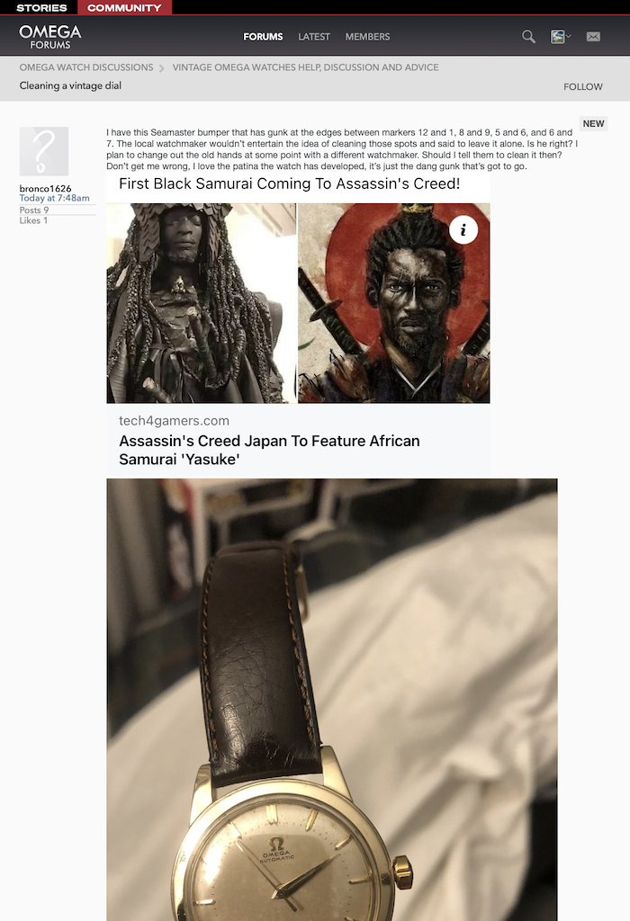

Anyone else seeing this?
Yes, but I just redid my authentication.
Yup. As Dan says, it’s quite bizarre as it’s not an ad. It’s a jpeg the OP embedded into the post for some reason.

Im changing the hands because sweeper hand is slightly bent downward and slit in mon/hr hands experiencing a little rust. Watchmaker had era specific parts and said the 1 year warranty covers the repair. Lol shame on me for wanting the watch to look a bit cleaner. If y’all are gonna nitpick my post, forget I asked anything…

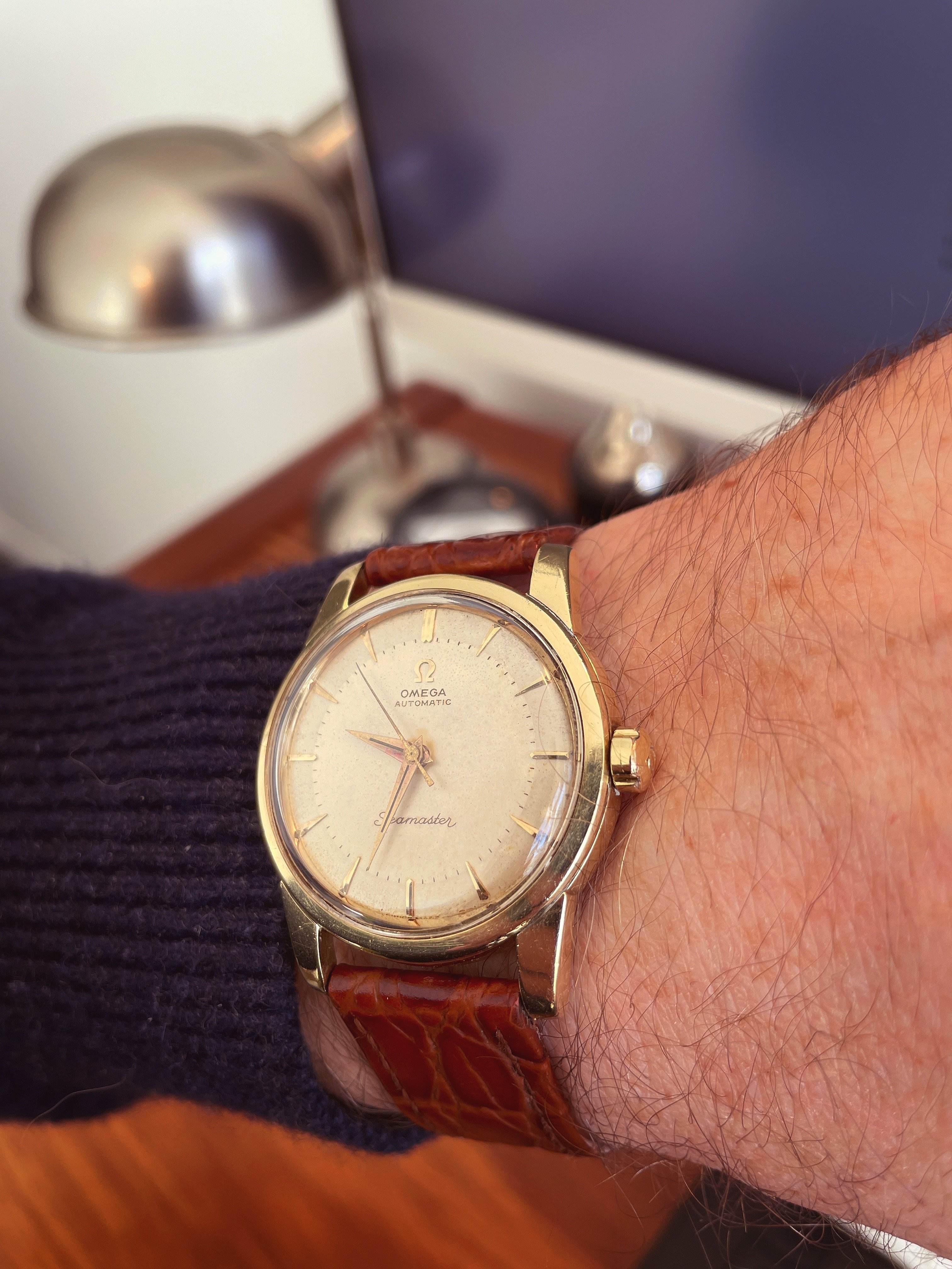

@bronco1626 I have a very similar Seamaster and always considered the hands to be original, are they not?
