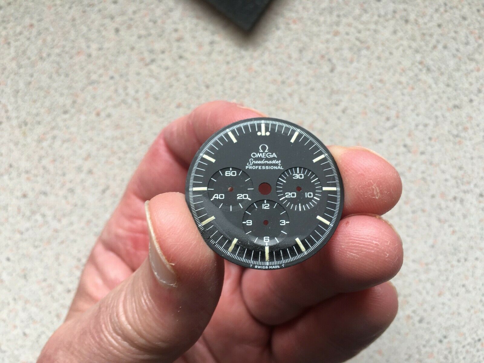

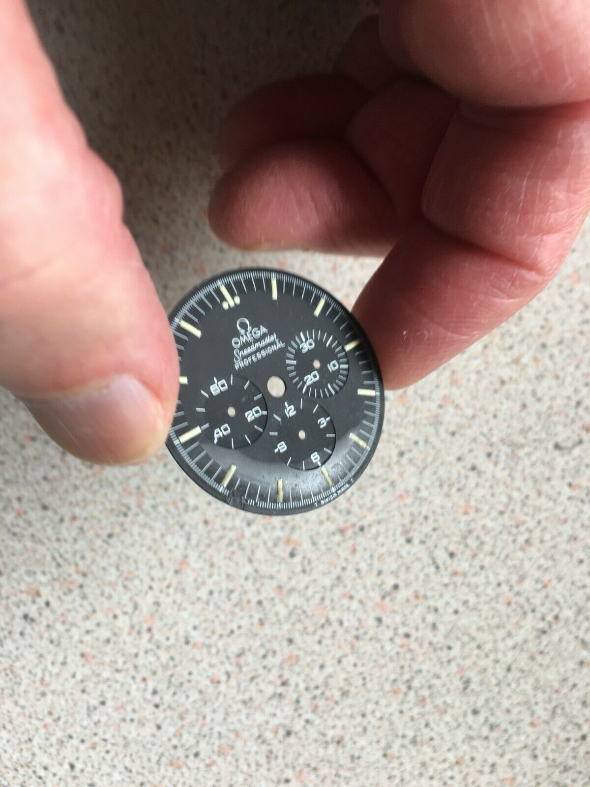

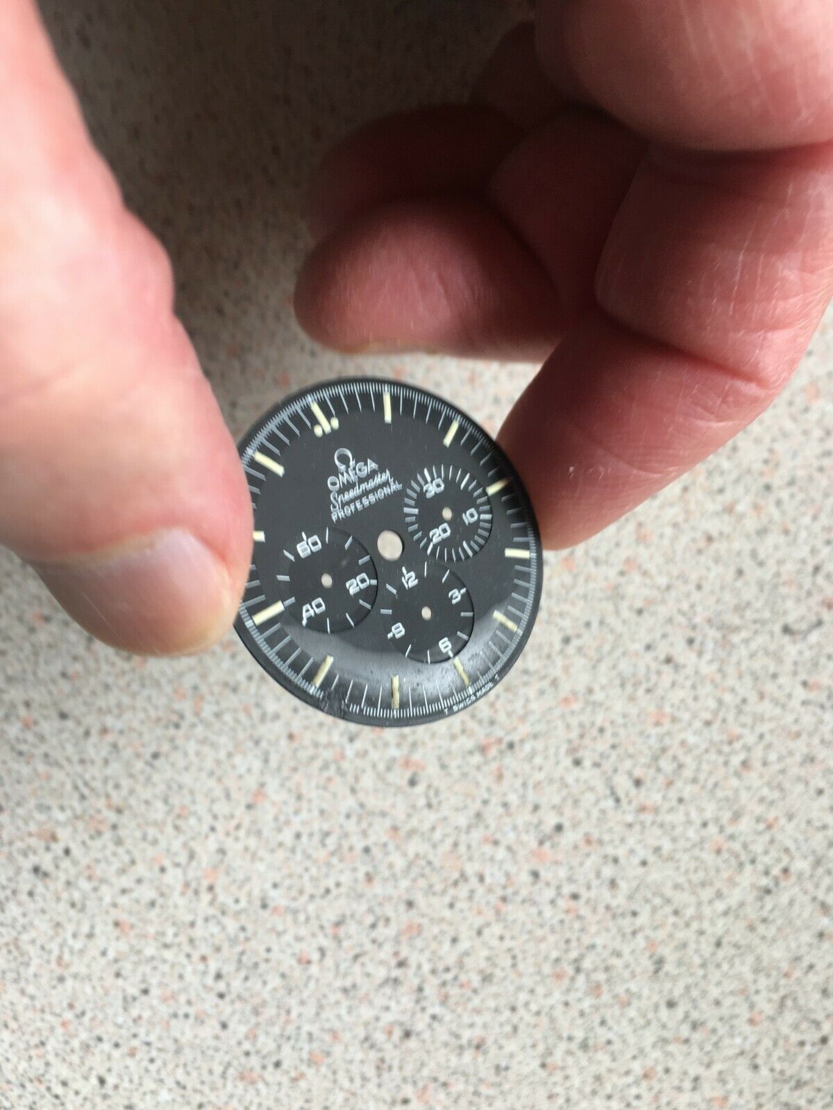

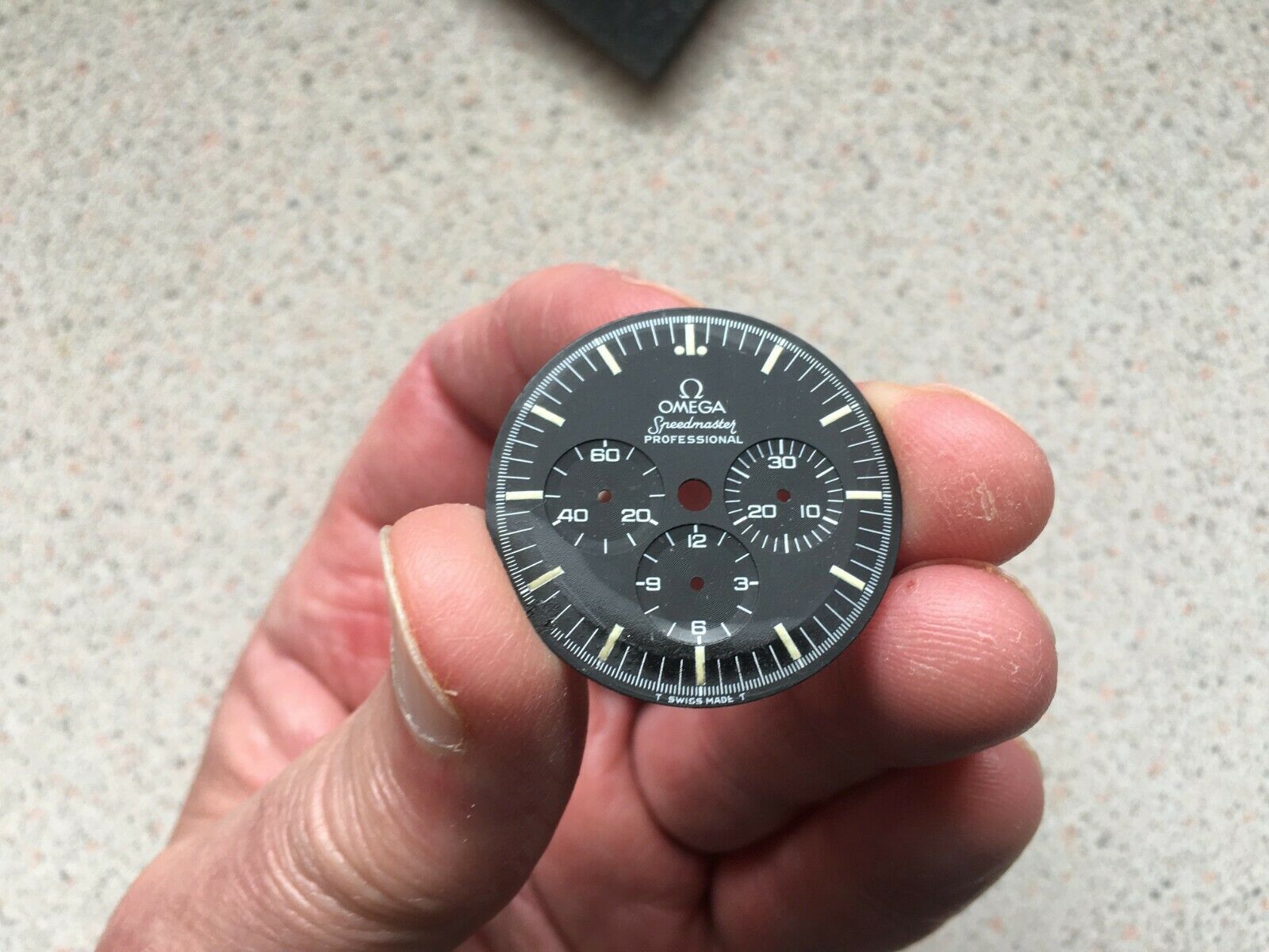

Hi All
I’ve got a Speedmaster dial that seems to have some oil (?) round the lower part. As you can see there's a slightly glossy sheen between 5 and 9.
I wondered about either a a q-tip with a pure solvent (lighter fluid fuel?) -- but then thought that might strip the paint / print / lume. So then I wondered about Rodico magic green putty.
What would you do?

I recommend not doing anything yet, especially Q tips and rodico!
It requires expert examination under correct lighting, a high power microscope and experience with these dials.
Edit: I STRONGLY recommend.

A wash with/in plain water is all you can try, otherwise follow @JimInOz instructions. Any brushing, even with q tip will leave a chance for marks, any solvent will affect the paint. If it turns out to be an easy to desolve layer then an absorbent paper could do the trick. Paper under the upside down wet dial.

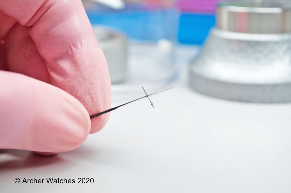

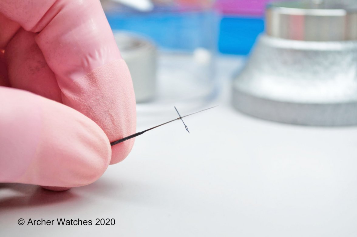

I recommend not handling the dial with your bare hands to start
(Picture stolen from google who stole it from Archer) Thanks @Archer 😉

Take it from someone who trained how to clean paintings, unless you know what you are doing, you can get it REALLY WRONG, REALLY FAST. The whole trick to cleaning something is to take off what you want without affecting anything else. Unless you know what it is that you are taking off, how can you choose the right solvent ? Unless you know what paint is on the dial (oil, alkyd, acrylic etc) how can you choose the right solvent? To complicate matters, the paint on the lumed indices and the printed indices are bound to be different from each other and everything else.
I suspect the "oil" was added to saturate the chipped paint so that it would blend in.
You bought yourself an interesting challenge. I am curious to see how it turns out.

Because it's possible that the "oil sheen" could be a film of lacquer separating from the dial paint.
Using Rodico (an adhesive) would probably lift the lacquer off in places, doing further damage.
The FIRST thing to do is find out what it is and what's causing it.
Then remedial action can be considered.
