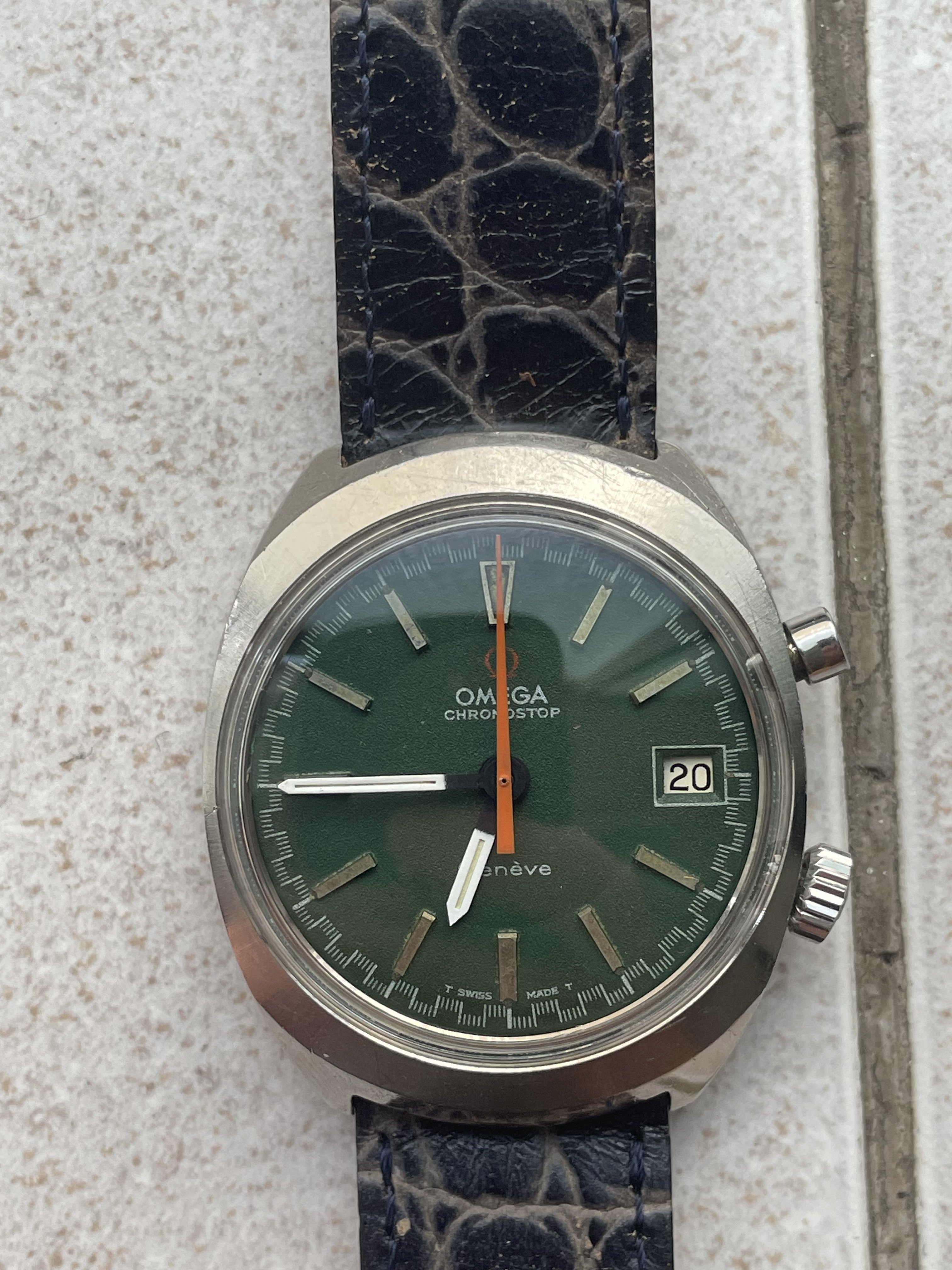

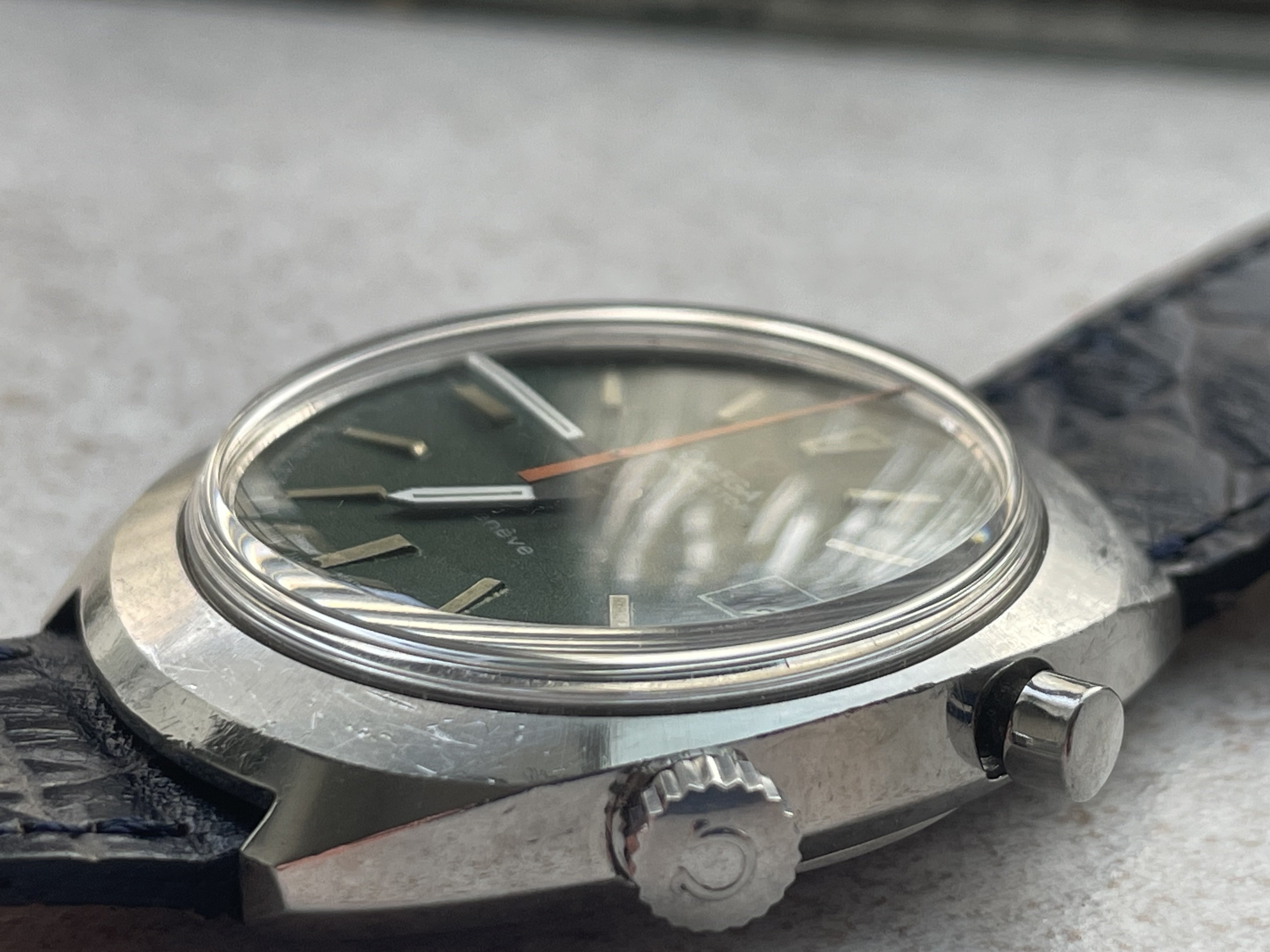

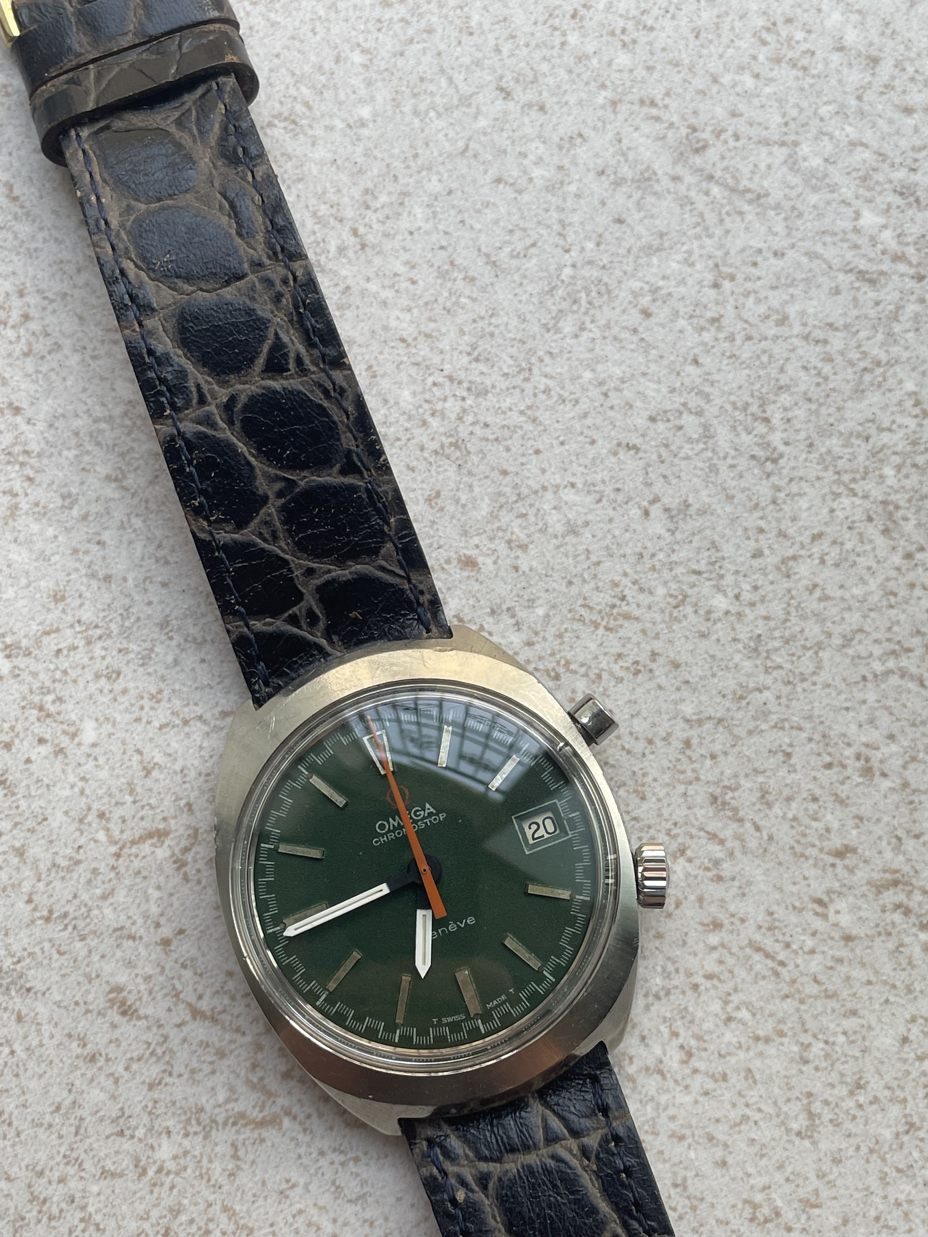

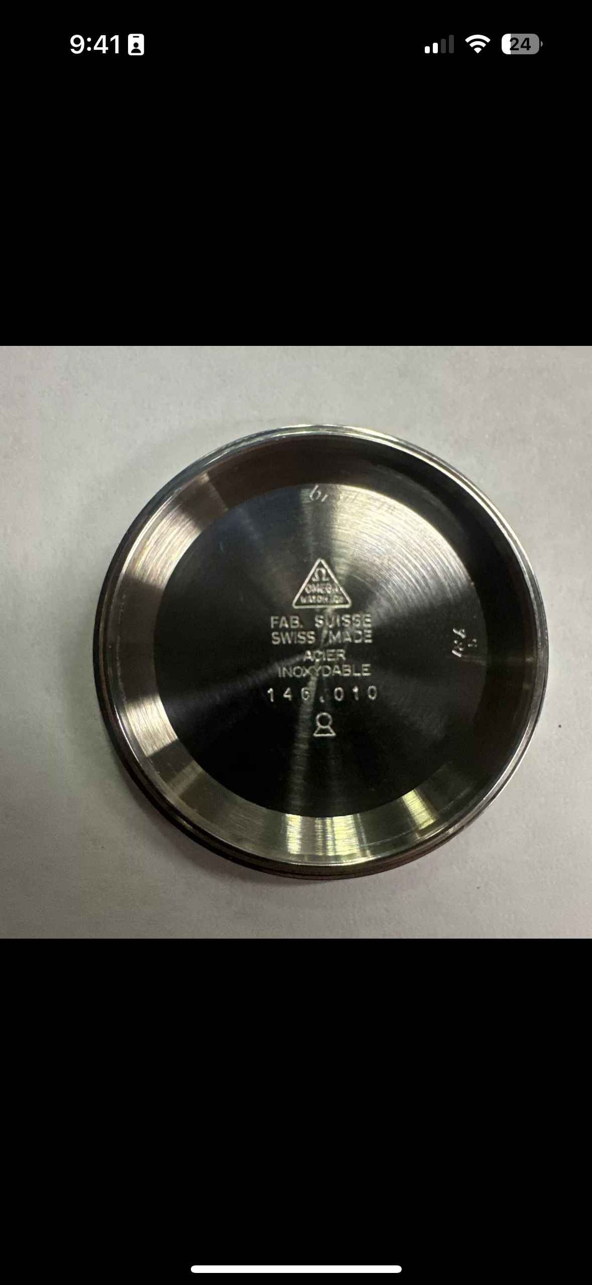

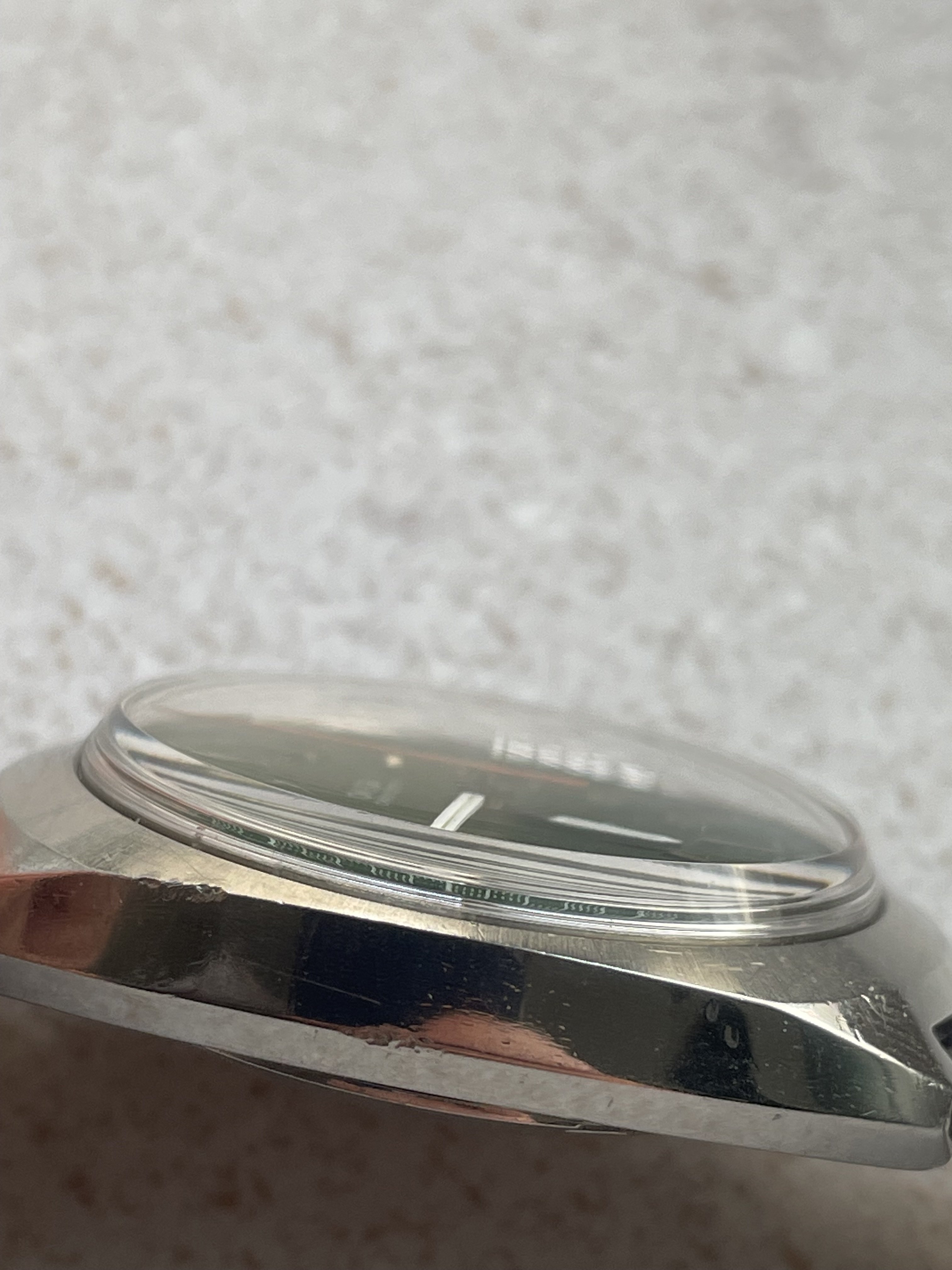

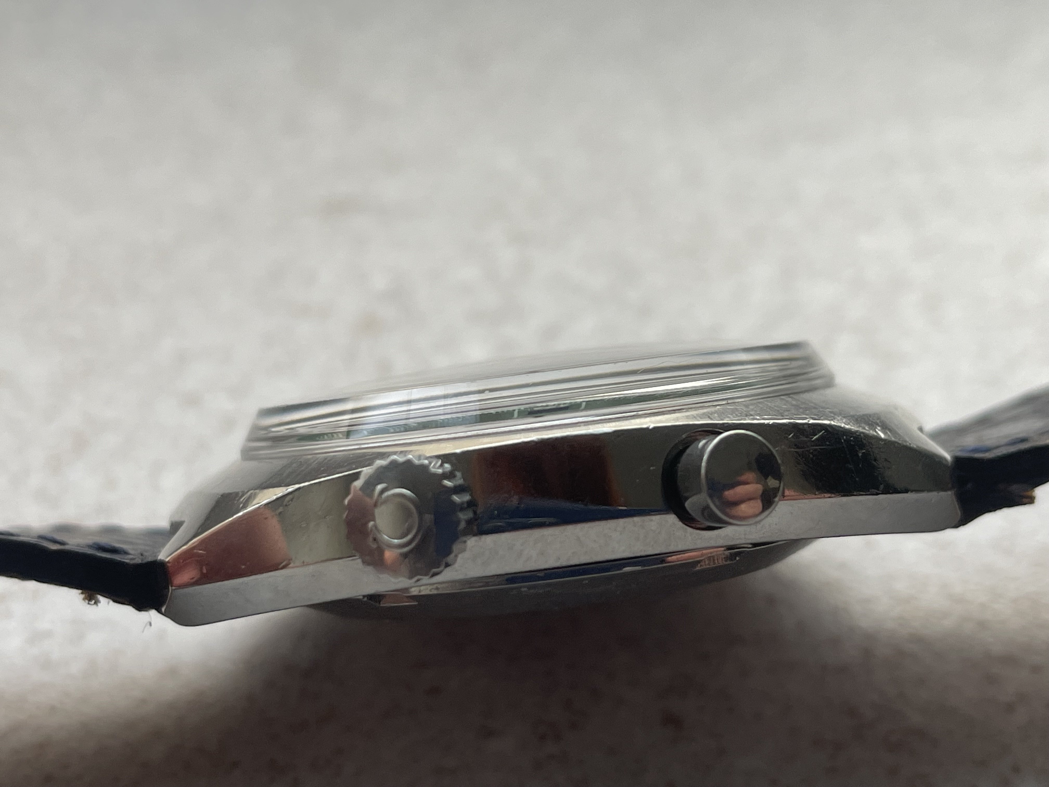

Hey everyone,
I just purchased a 146.010 Chronostop (although I think it's actually a 146.009, and the caseback is a replacement, as it appears to be a '69, and has normal dial, not the 90 degree rotate), and the crystal looks to be a generic domed replacement vs. the flat original.
Does anyone have the reference number so I can try to source an unscratched, and hopefully a NOS Omega replacement?
Thanks in advance!

I found a forum post for a 145.009 that says a NOS crystal would be PZ5142, is it same for the 146.009/010?
254
401
Omega PZ5142 ,
i have bought an aftermarket replacement part from Gleave & co . and it was very good .
when i searched for one about a month ago i saw 2 NOS original ones for sale on Ebay but they weren’t cheap .

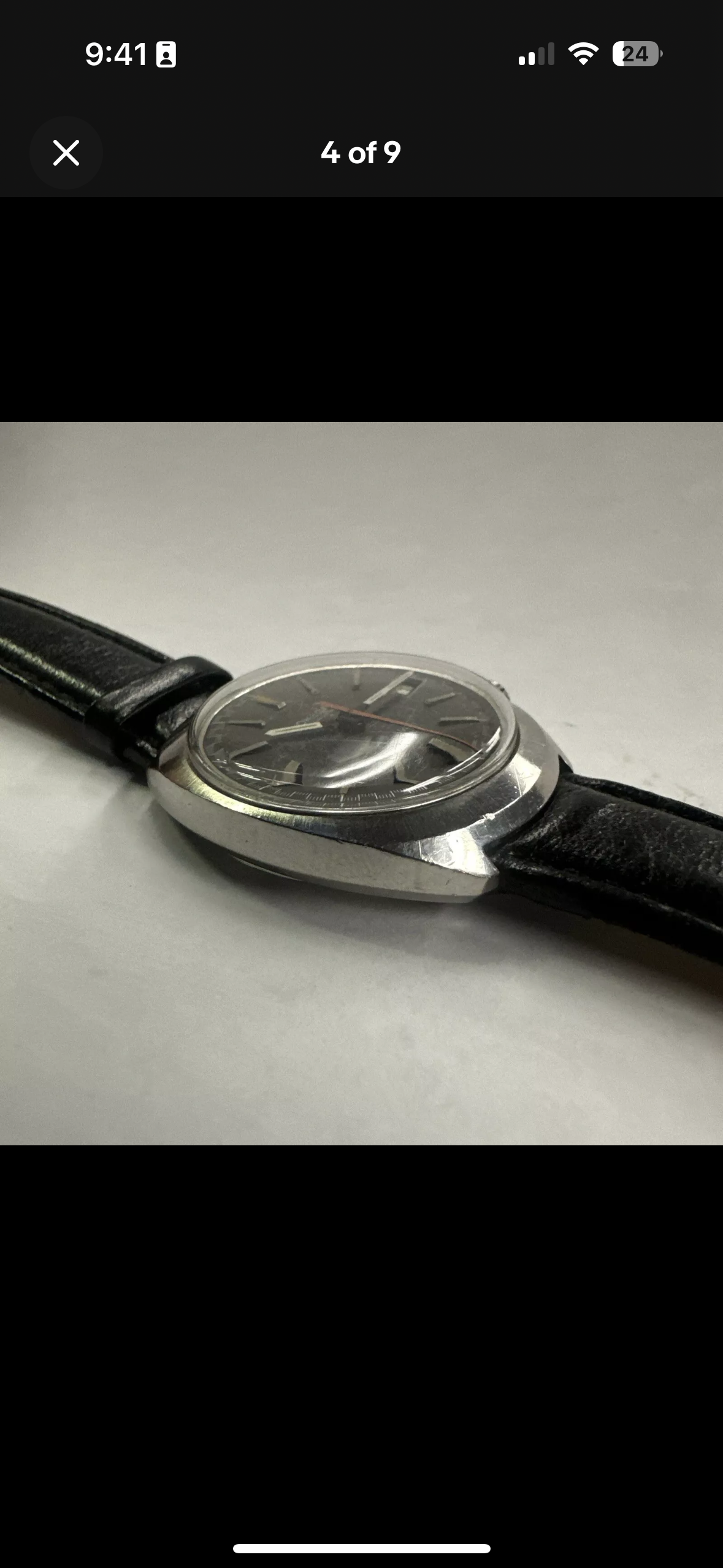

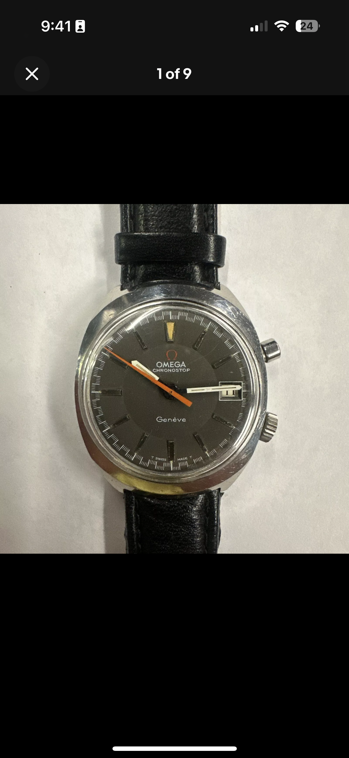

that sounds like a fair deal for a NOS , i do think the photos dont match to the item on the list .
i would suggest contacting the seller to assure that it is an original omega and not an aftermarket .
