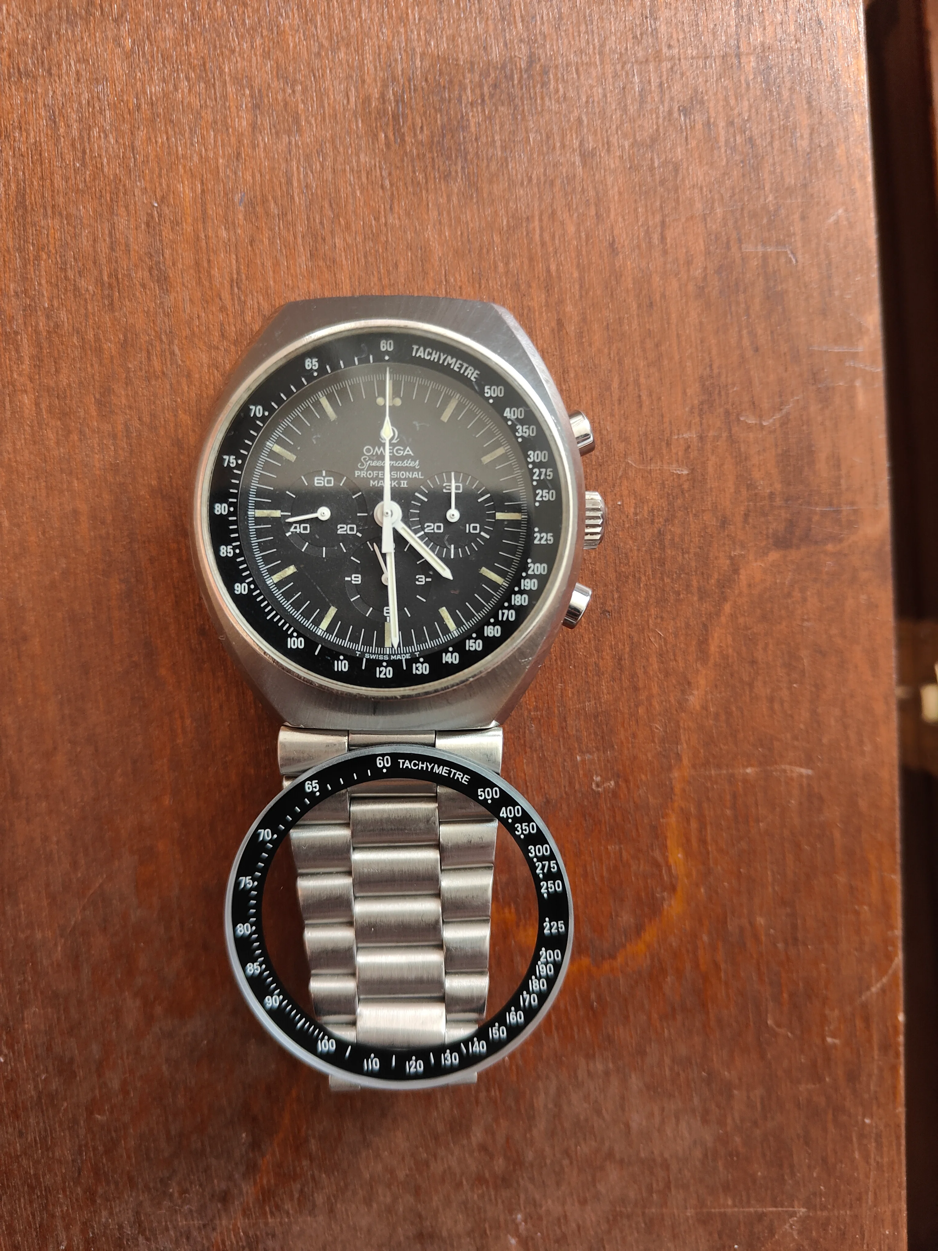

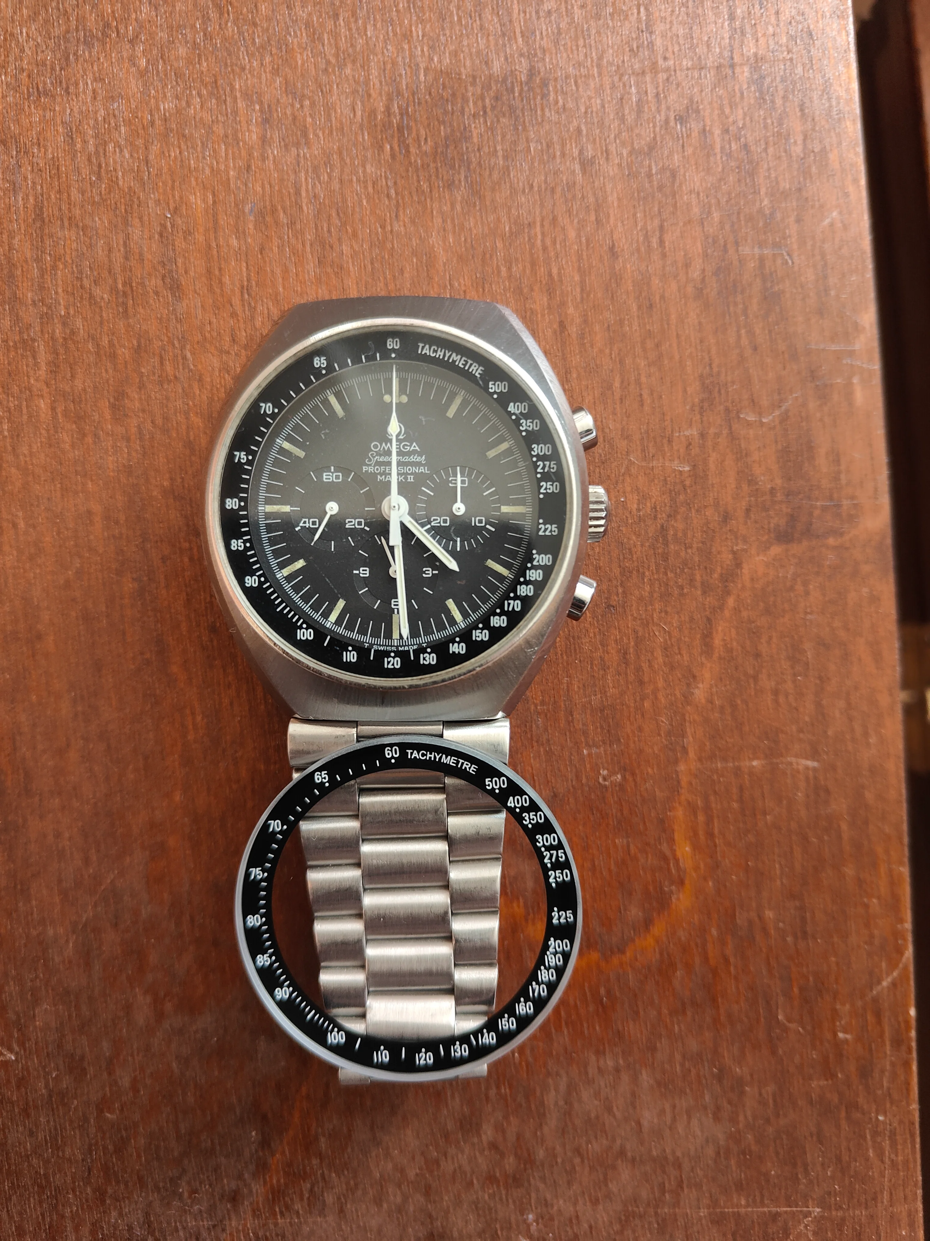

I have this replacement crystal for the MKII which looks slightly different from the one that's currently on the watch.
I'd like to get some help in understanding whether the new crystal is correct before I go through the effort of replacing what's already on the watch.

What I mean by different is:
  • The font size and type in the word TACHYMETRE is diffferent. On the new crystal, it's short and wide.
  • The font size is different in the tachy numbers. The numbers look taller and slightly wide on the new crystals.
  • The tachy dash marks on the new crystal don't extend all the way to the inside of the crystal.
  • The tachy dots between 500 and 140 are positioned differently relative to the tachy digits.
  • There's a dash mark on the 140 that's not present on the old crystal.
I purchased the crystal from tmwatchco on eBay.
I hope this adds a bit more detail.

You have a good eye for detail.
You may have an original crystal on the watch ATM, or you may have a service replacement.
Like watch dials/hands etc, genuine Omega service replacements are not always identical in form to the original, but fit and function are.
Service crystals are manufactured to a specification, and that may not go into fine detail so different batches may show variations.
The one from TMWATCHCO looks completely correct to me.
