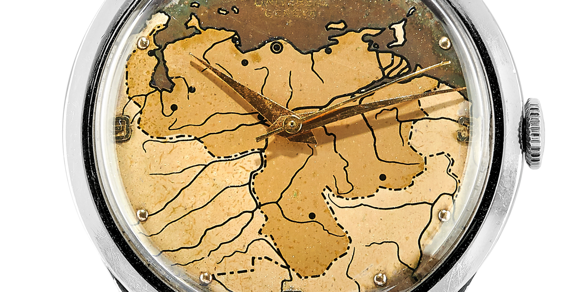

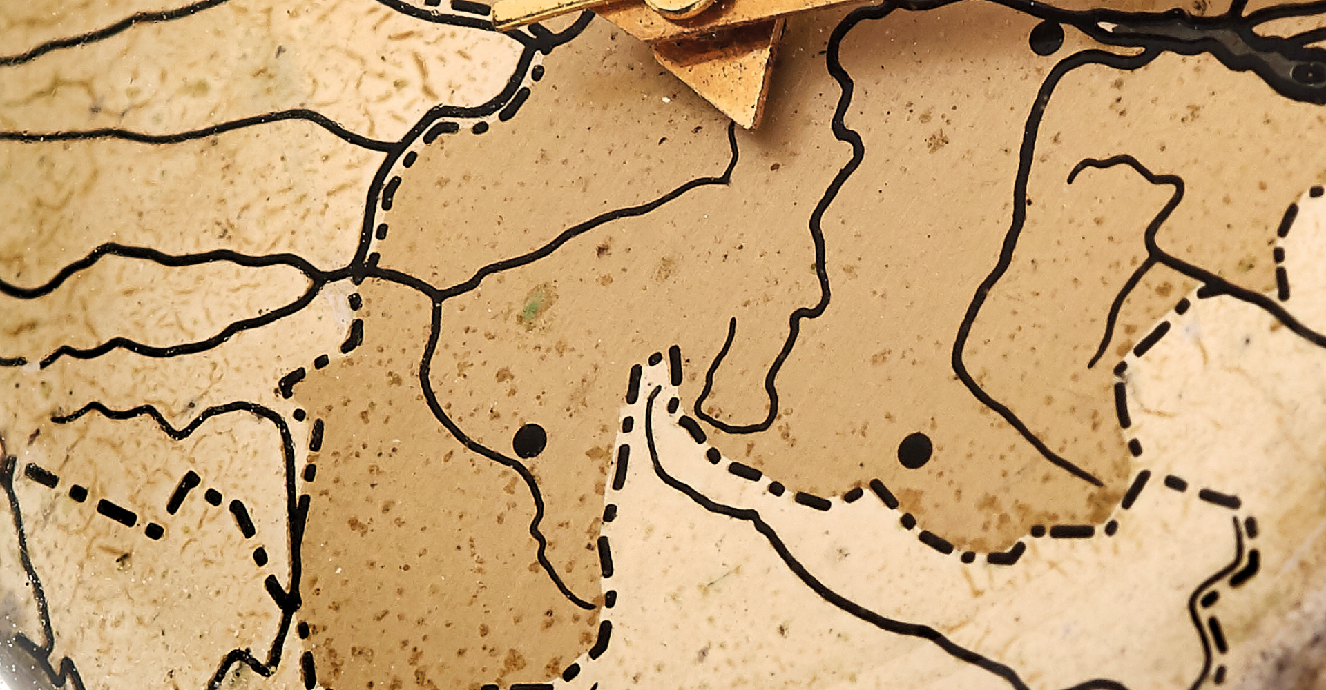

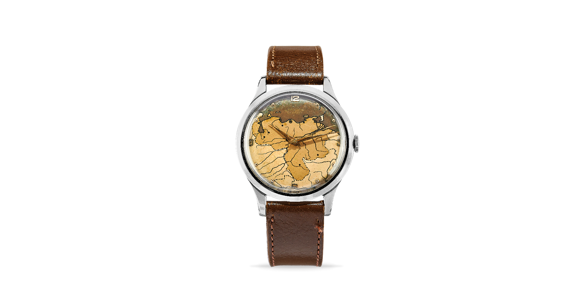

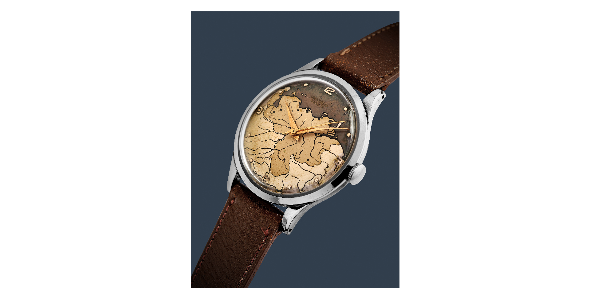

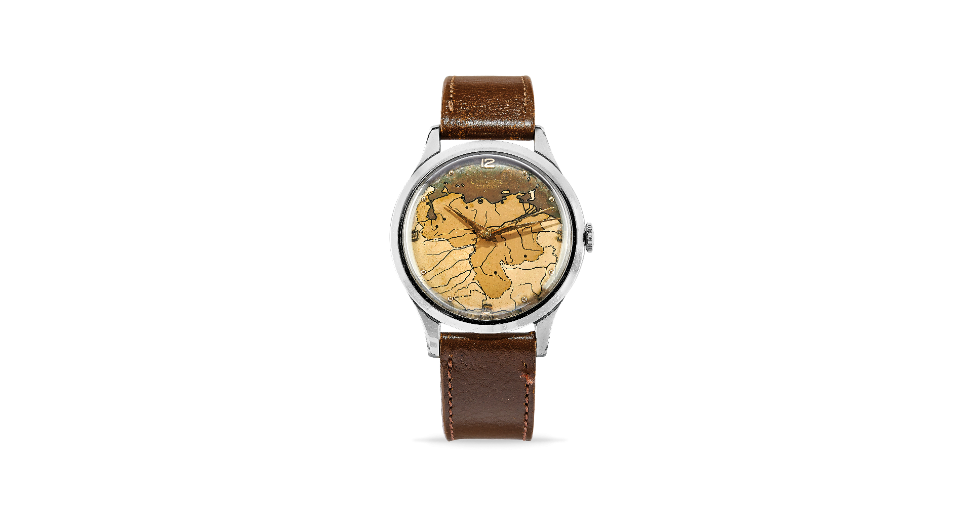

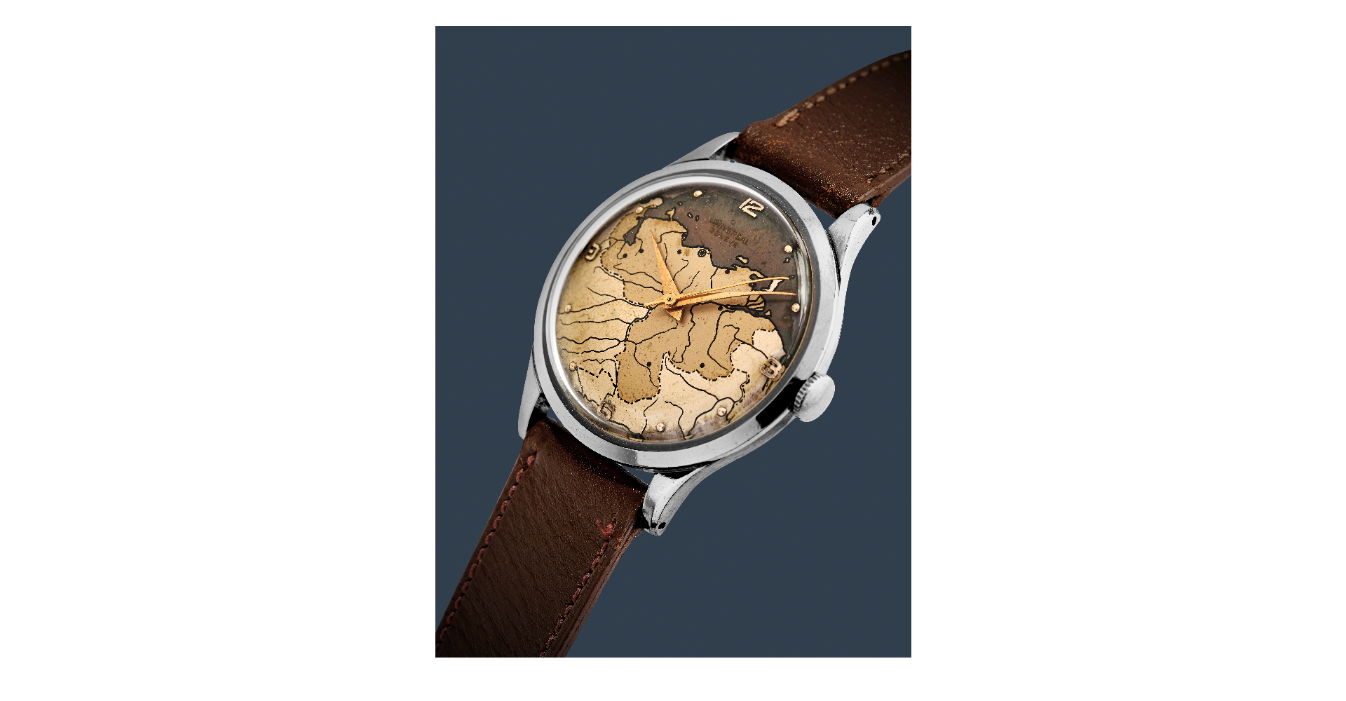

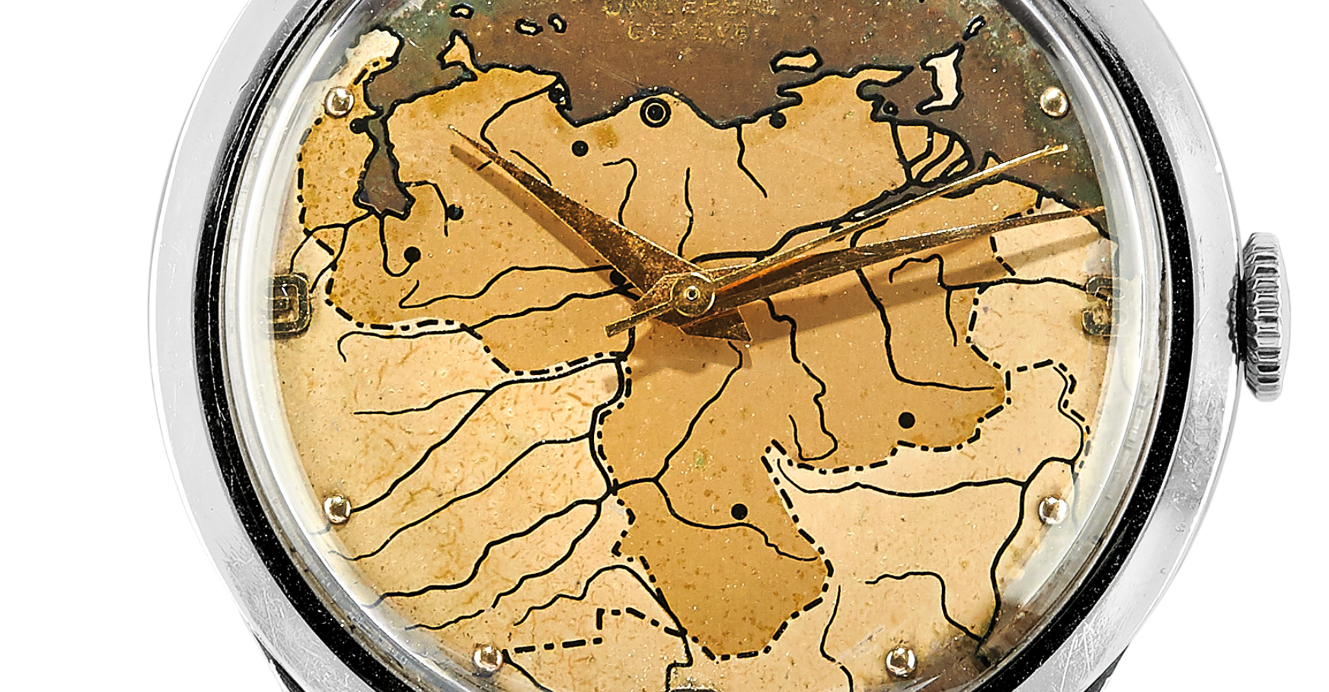

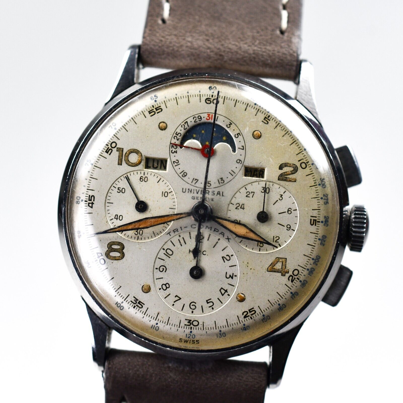

UG with HPC signed dial with a map of Venezuela - pretty strong evidence for the Henrique Pfeffer Caracas theory.
This is the second of these dials we've seen in recent years. The other also appeared on eBay and was eventually sold at auction recently. Annoyingly the HPC text was not present on that other dial although it is possible that the text was present and has disappeared over time as it's not very clear on this latest example either.
https://www.ebay.co.uk/itm/334278133752
3,278
14,261

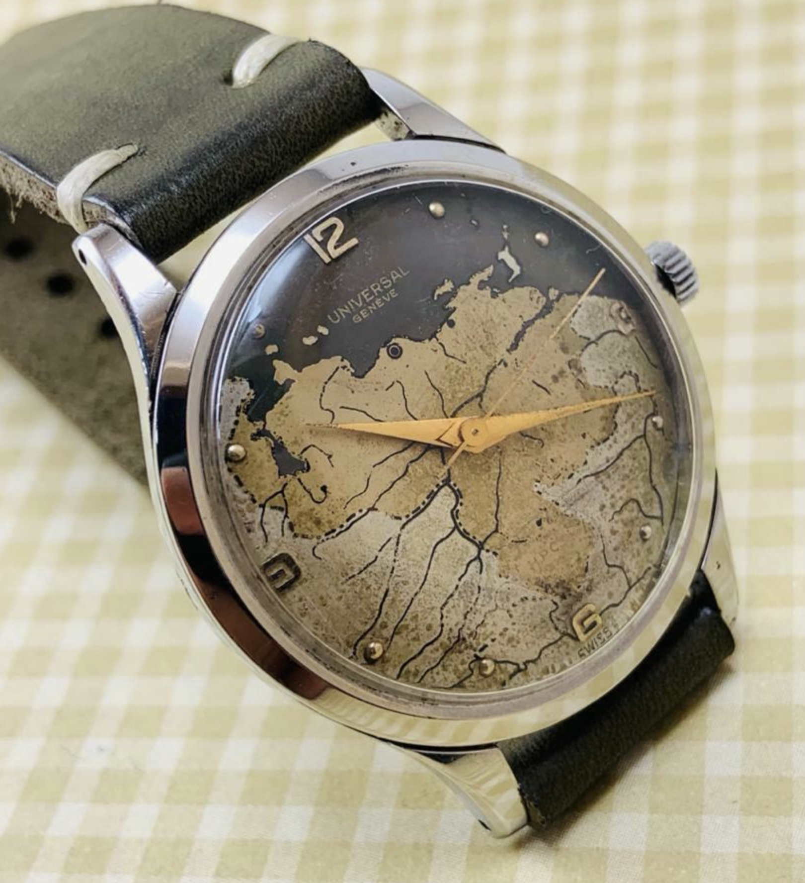

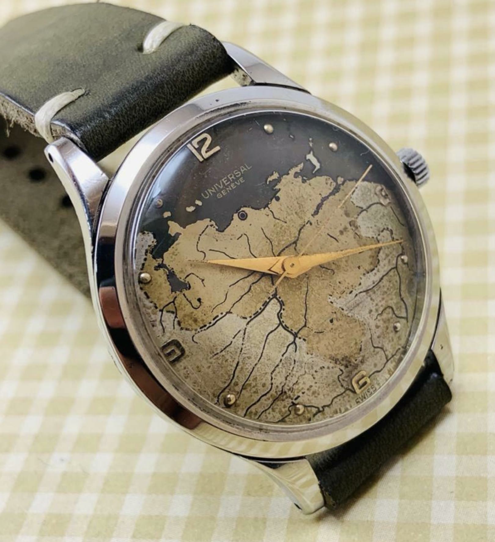

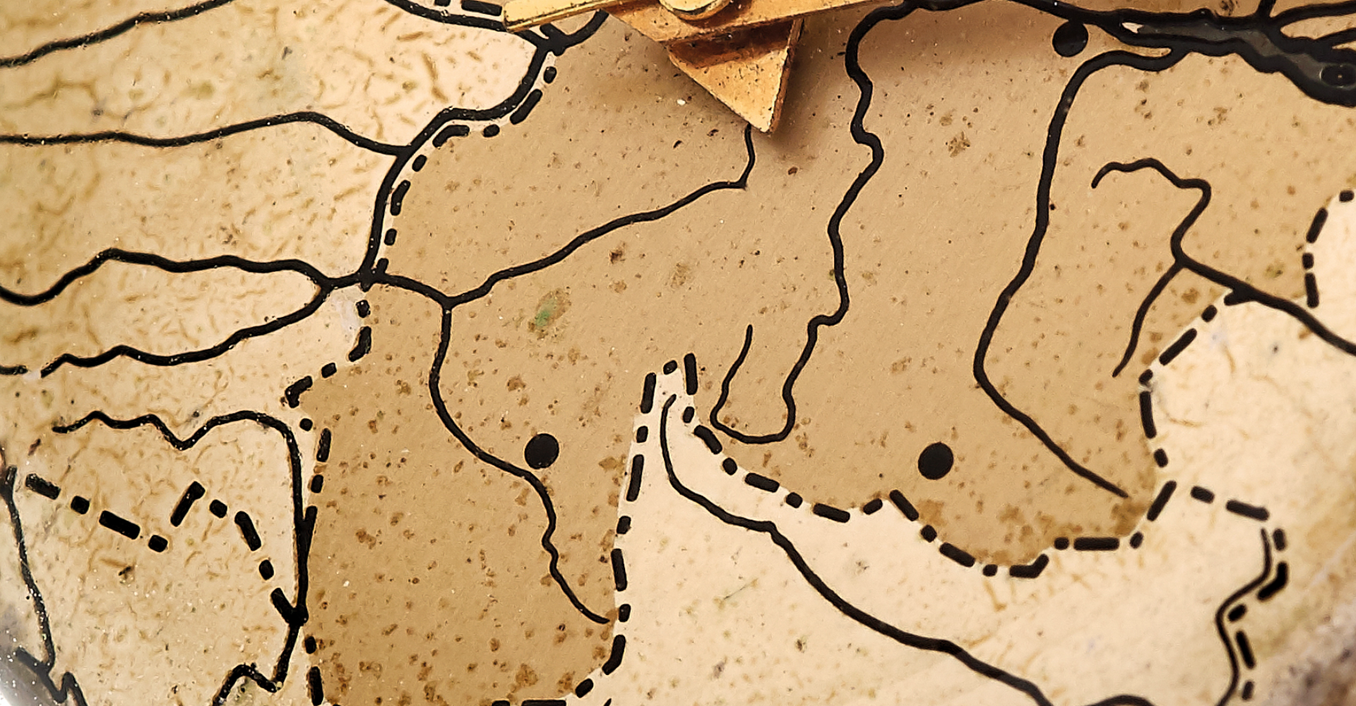

For posterity, here is the other Venezuela dial:

Thanks! Sadly, I can’t find any evidence of HPC on the other dial.
As a keen supporter of the Caracas theory, here are my entirely biased thoughts:
- If the HPC text had been a later addition by the retailer, it would presumably have been added on top of the lacquer and therefore be less robust (explaining why it’s very faint on the dial on which it is present) than the original UG text
- Finding HPC on any dial with a map of Venezuela is pretty strong evidence, if not quite a smoking gun, of the connection in my view. I’ll eat my hat if we find a map of any other country with an HPC dial.

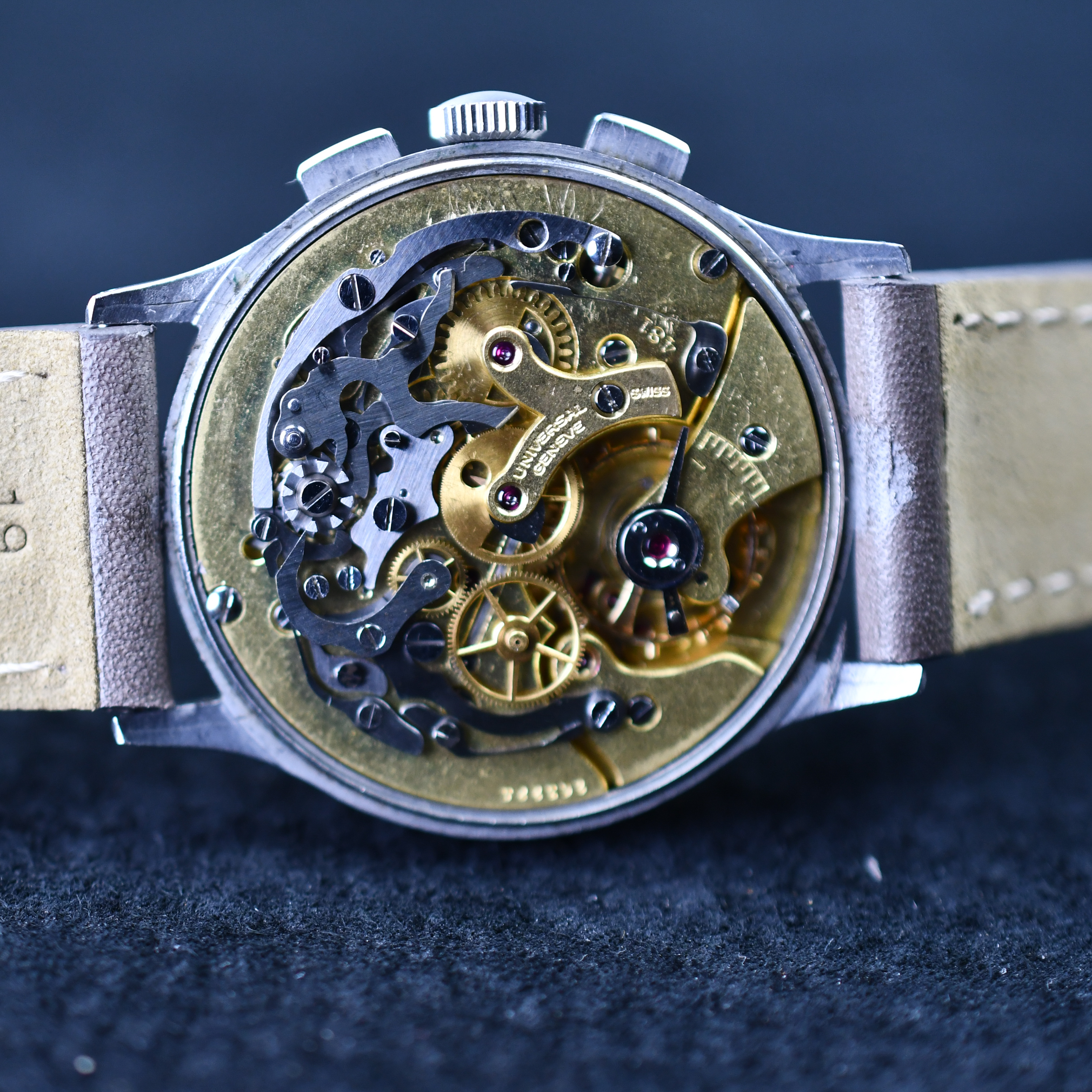

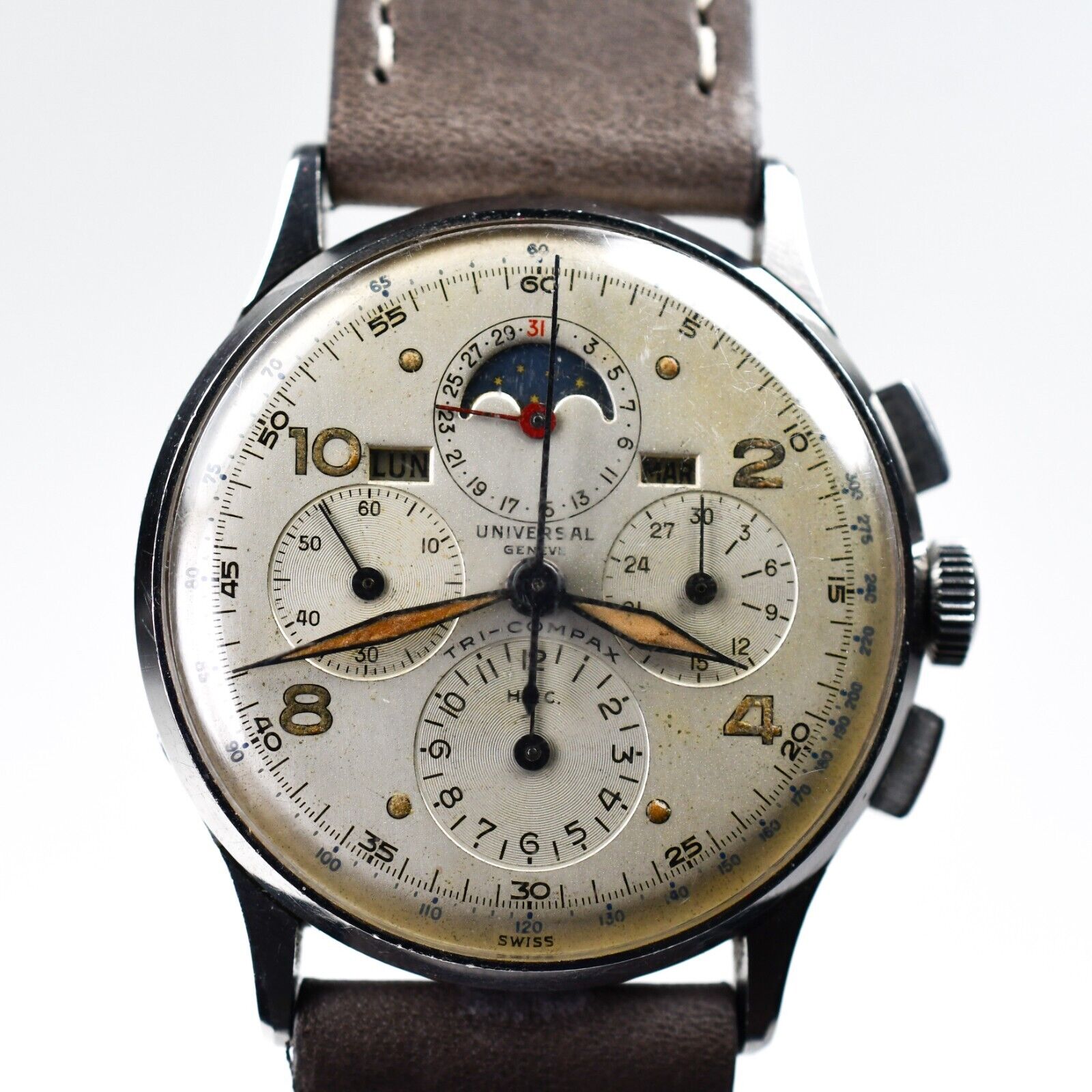

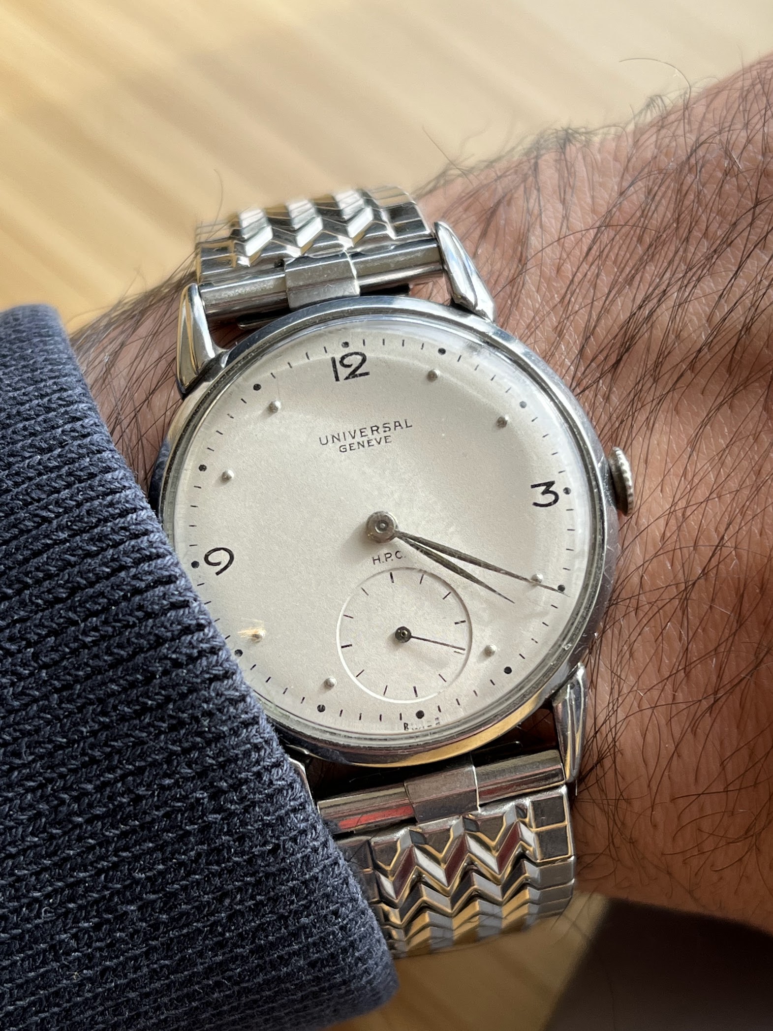

A lot to read here. I was in the High Precision Chronometer camp before but after reading this thread I think Henrique Pfeffer Caracas makes more sense.

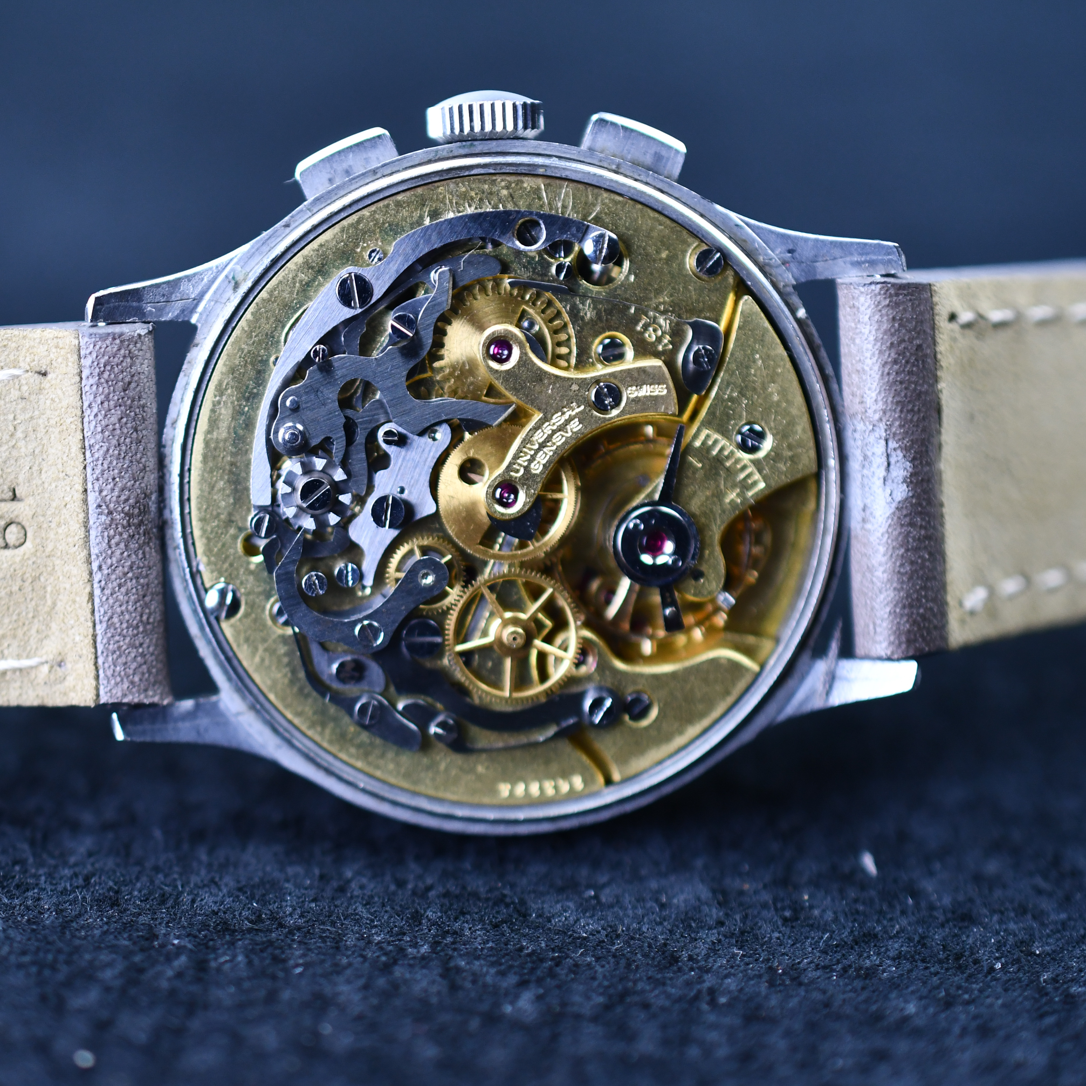

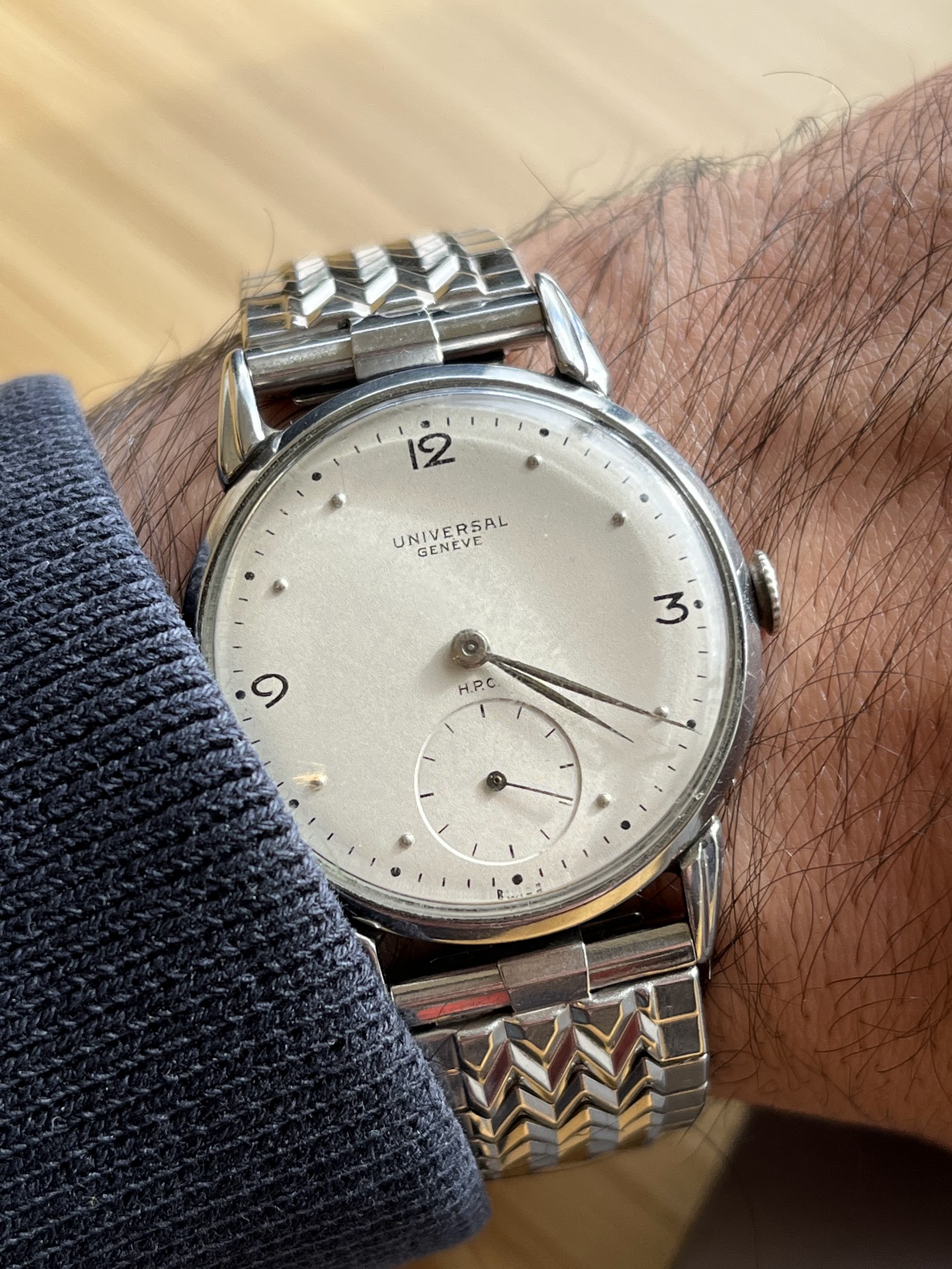

Here's mine. No indication of chronometer on movement.

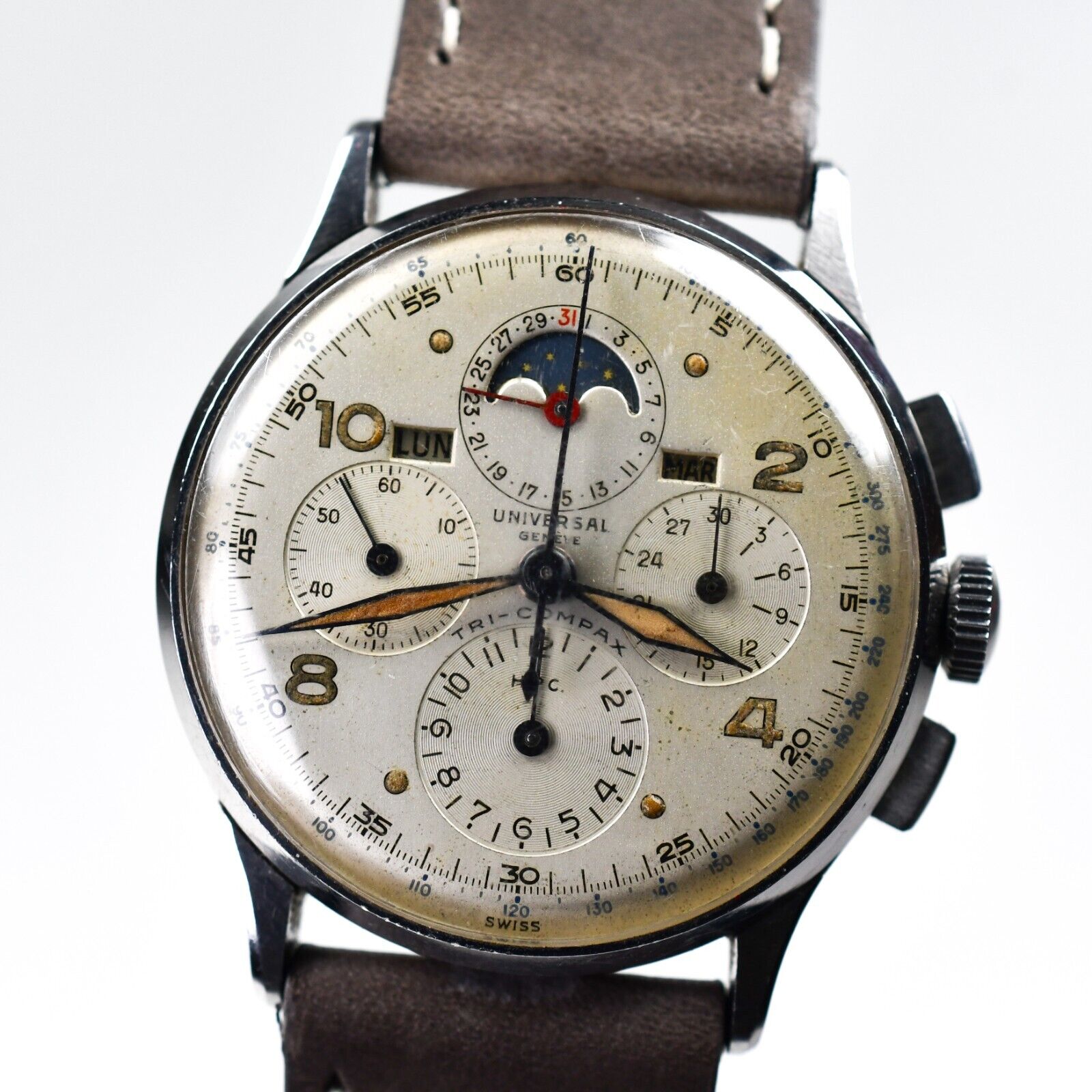

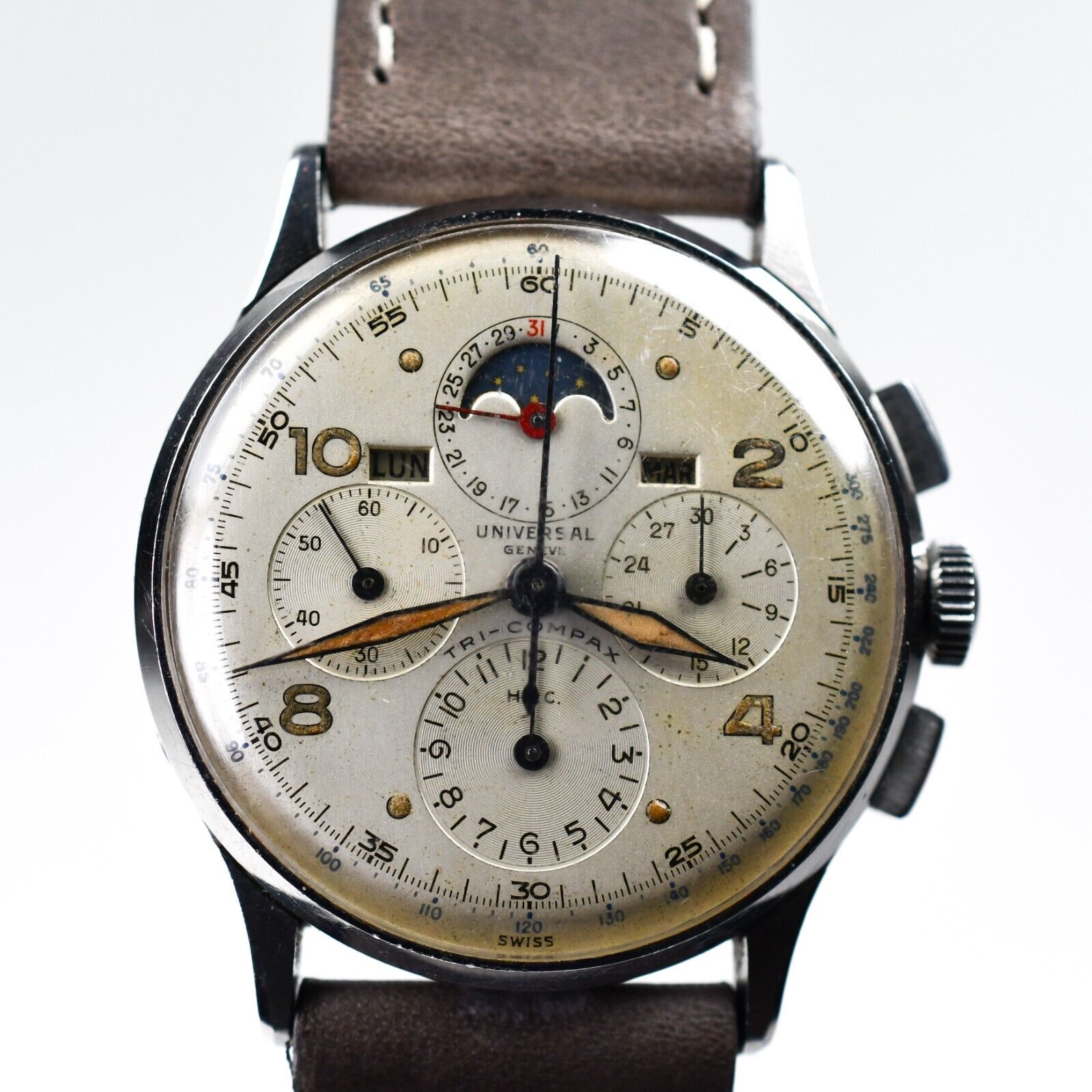

Here's a cool HPC Tri for sale on ebay, seller says the case reference is 22242 and case serial 1107160
