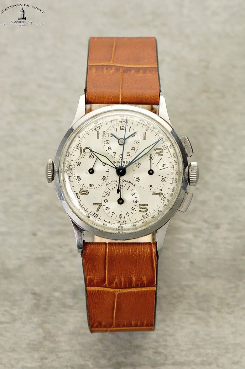

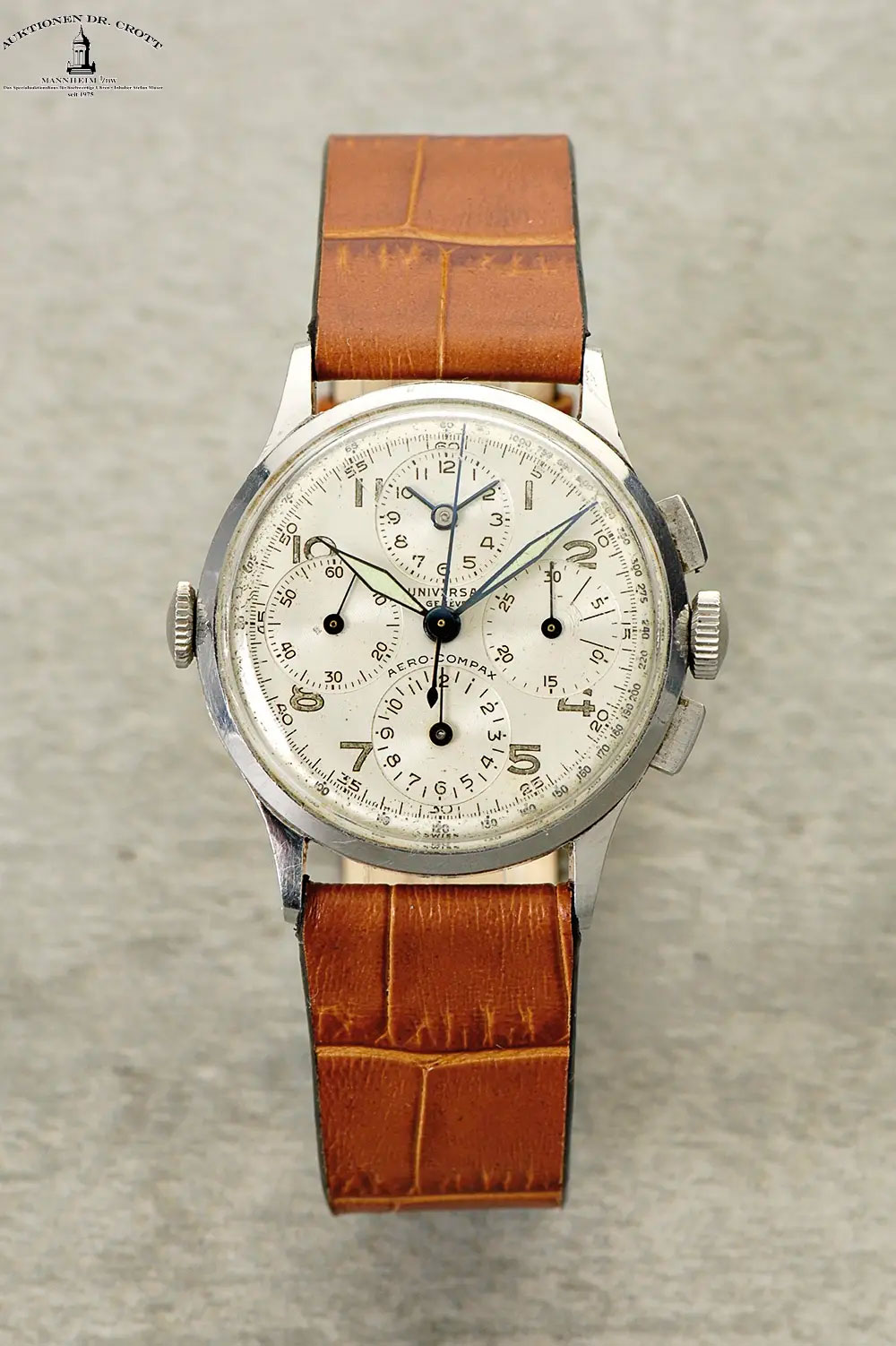

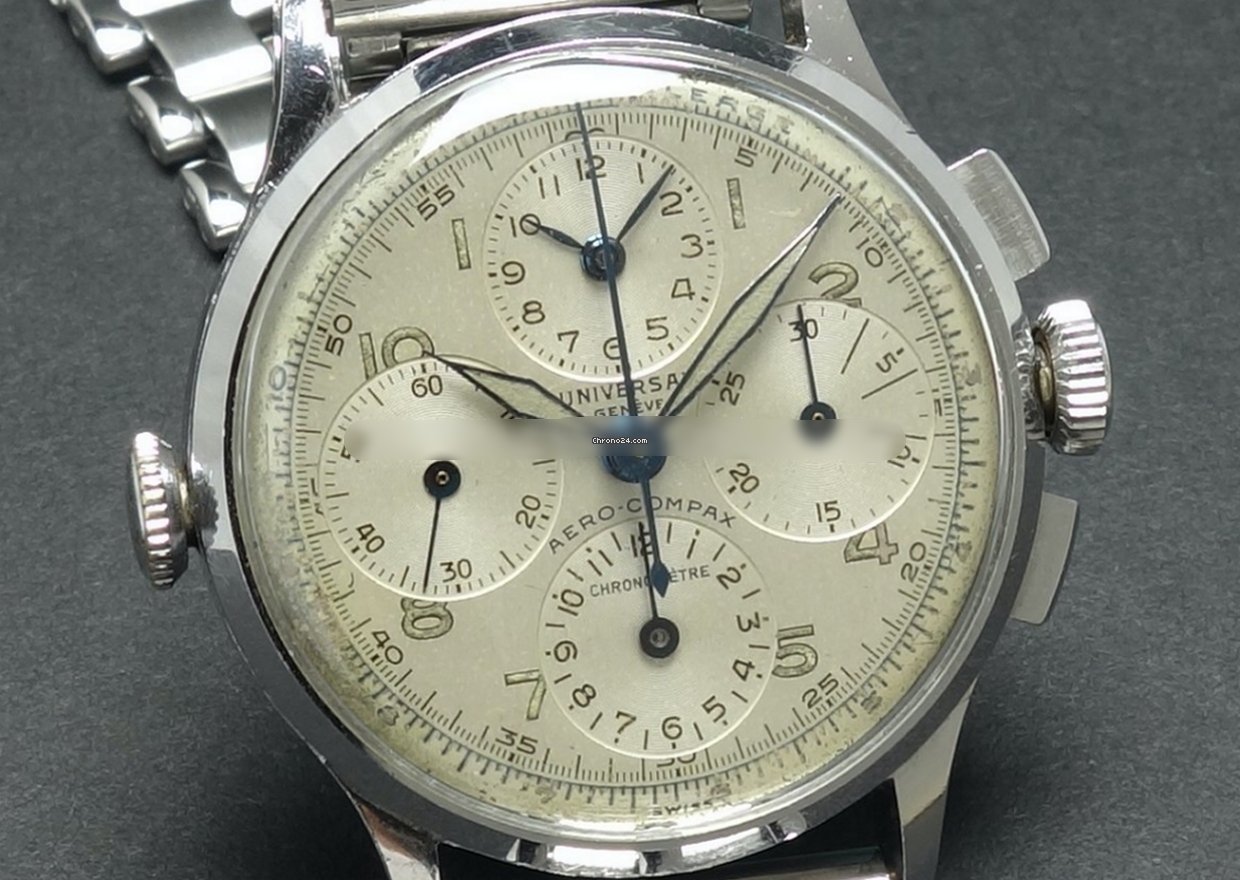

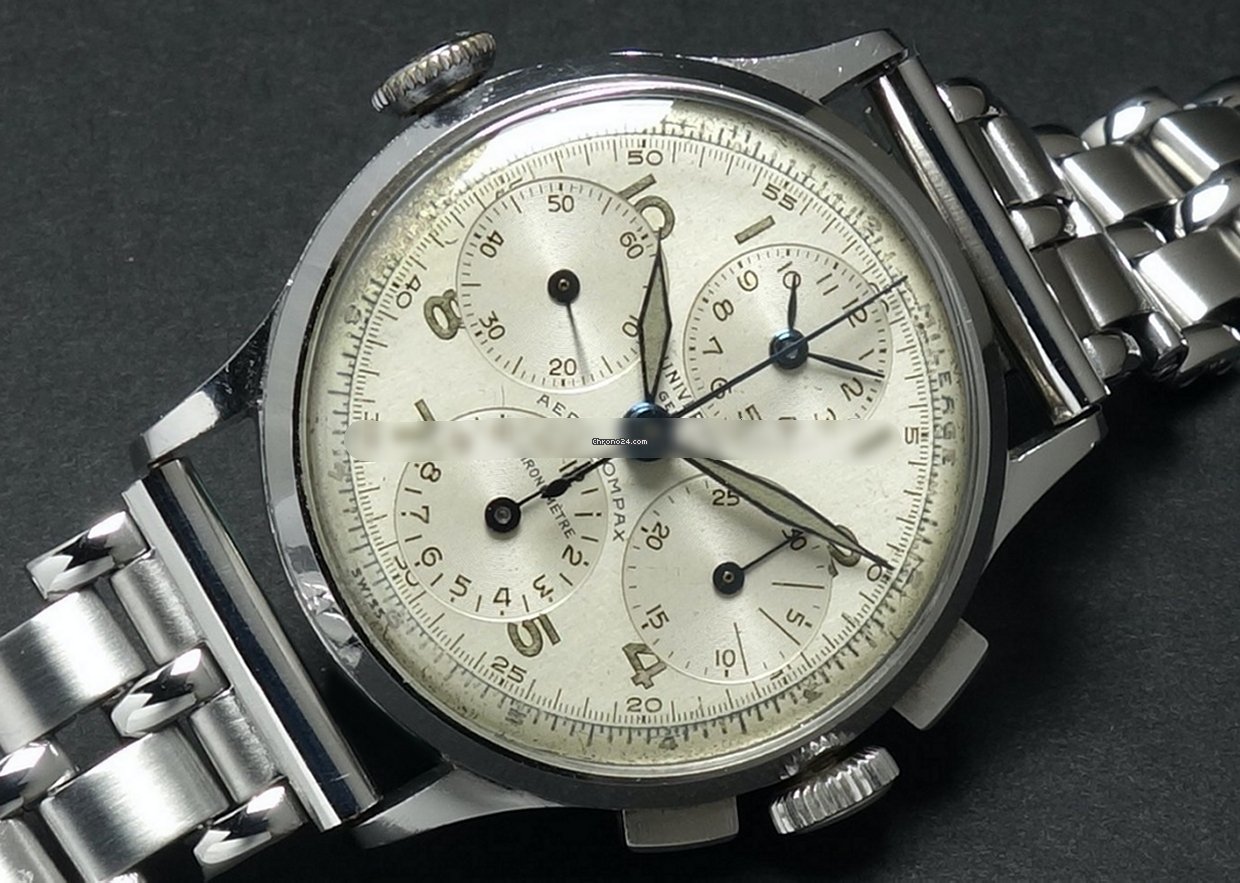

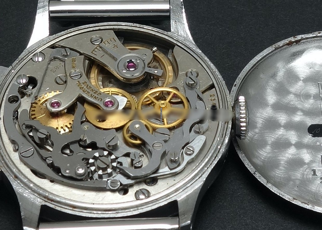

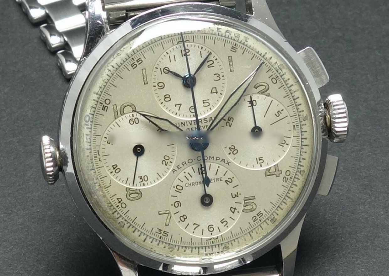

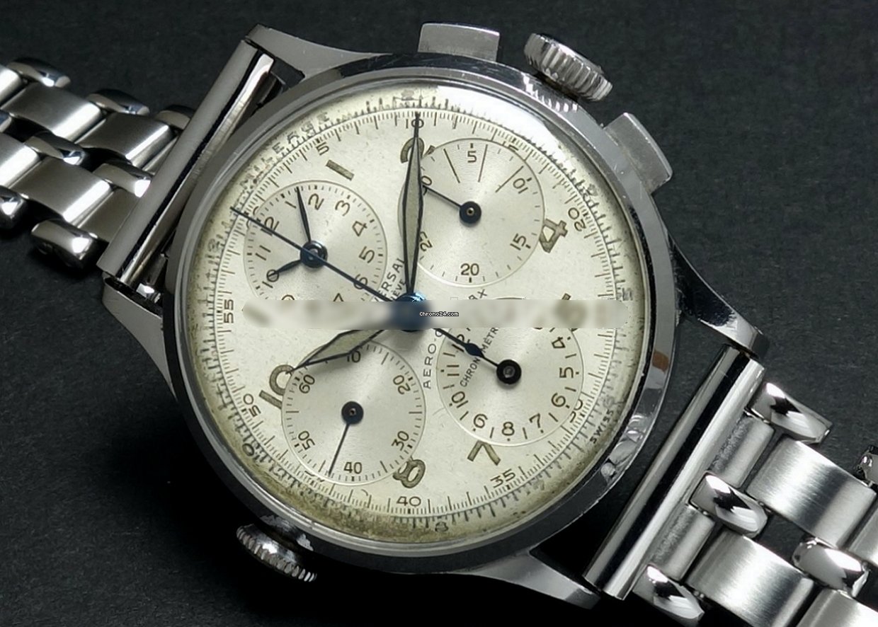

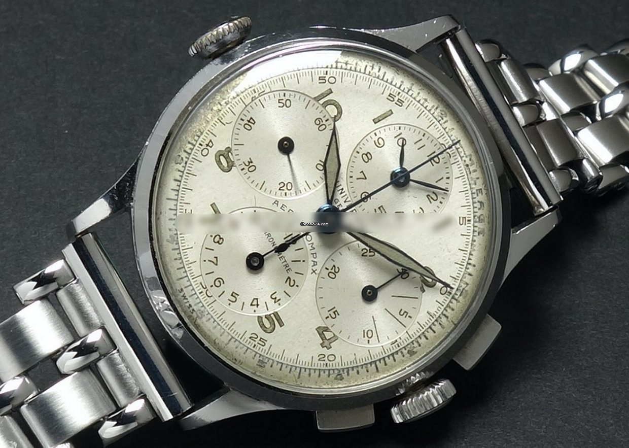

To my knowledge, we've not yet seen a 'chronometre' marked chronograph that we agreed was correct. I also don't think we've seen any chronographs with 'chronometre' dials in any advertising; we've seen time only 'chronometres' and chronographs with 'HPC' dials.

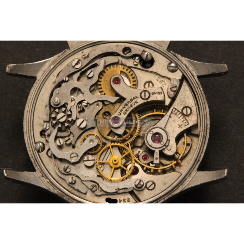

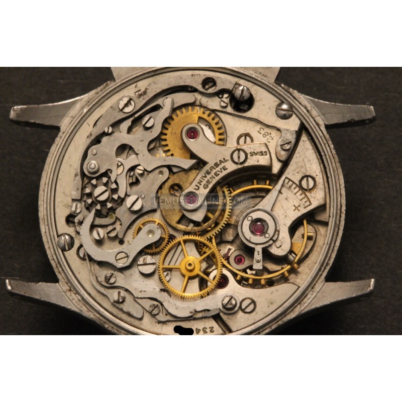

There does not appear to be any markings on the movement that would mark this Cal 283 as being anything out of the ordinary. There is a number marked on the movement but they all have that as far as I can tell.
I'll stick my neck out and say that the 'chronometre' text is more likely to be a later addition than it is to be original.
3,721
8,557

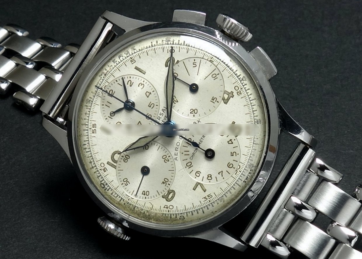

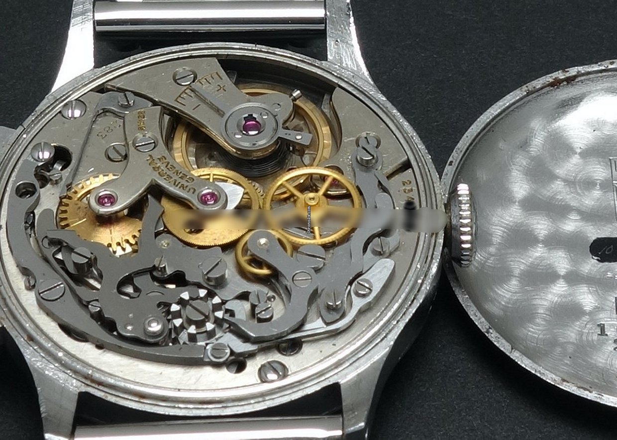

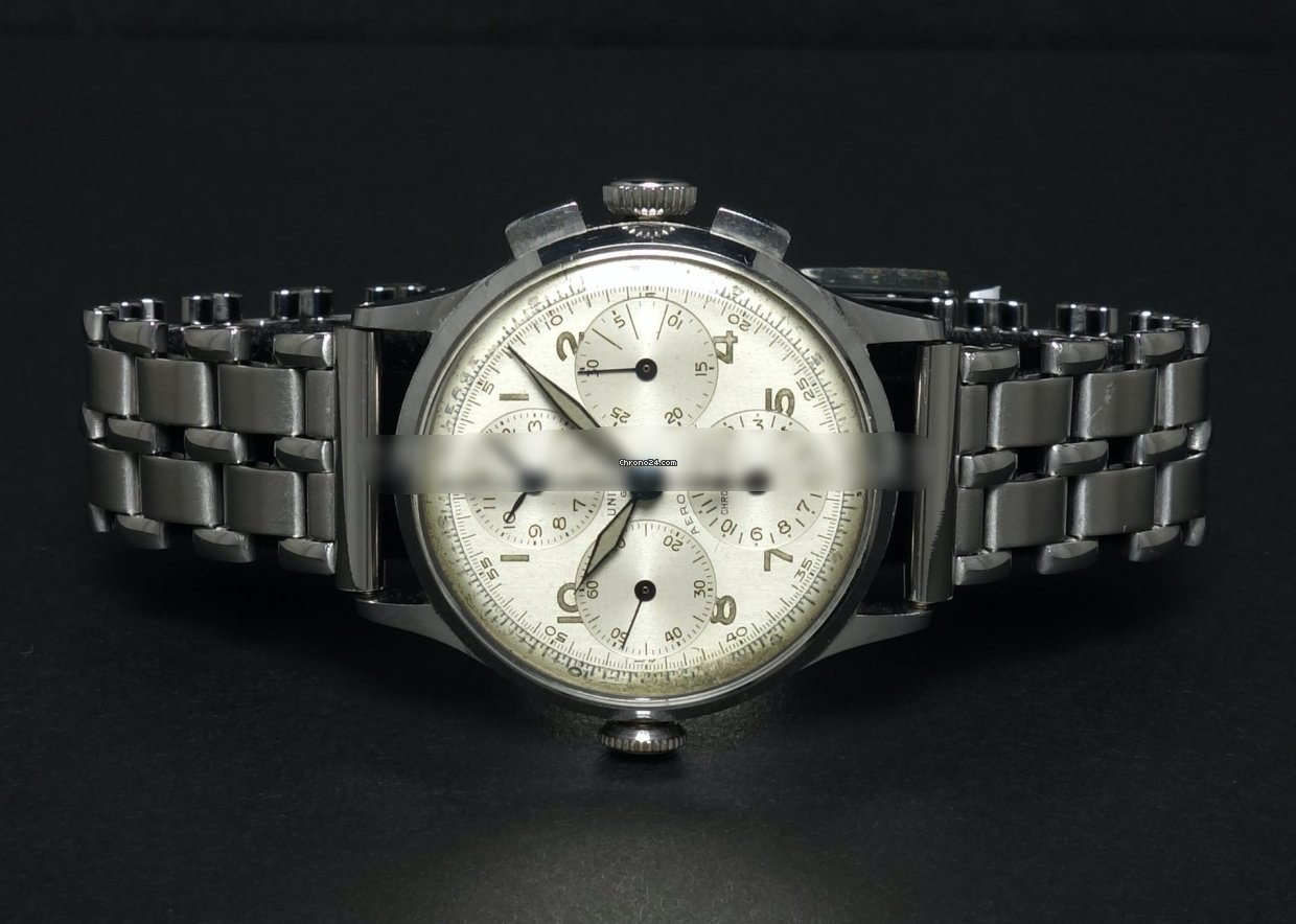

I've had a few Aero that were cal 281, not 283, and they both said unadjusted, so I thought the lack of unadjusted might mean something on the above example. However I'm seeing other examples of the reference above for sale (22285) which also do not have unadjusted, so I guess it doesn't mean anything. Here's another example of a ref 22285 dial and mvmt.
I don't have any explanation for the above example. Text could have been added, or not, the whole thing remains a bit of a mystery IMHO.

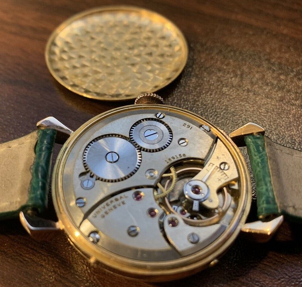

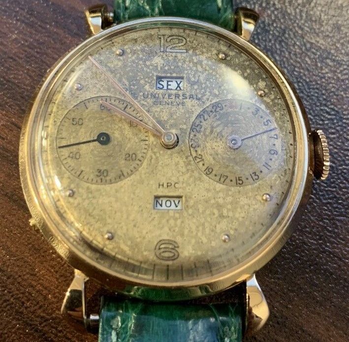

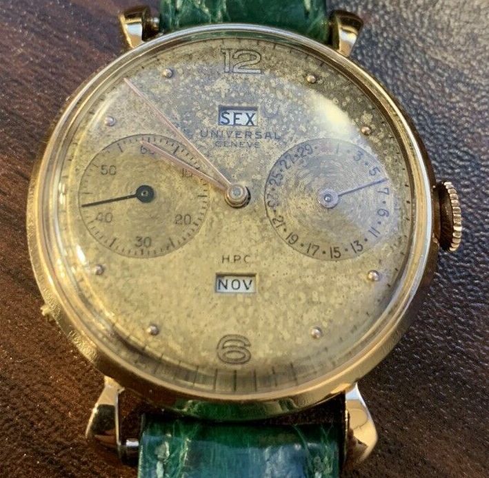

https://www.ebay.com/itm/264927598593

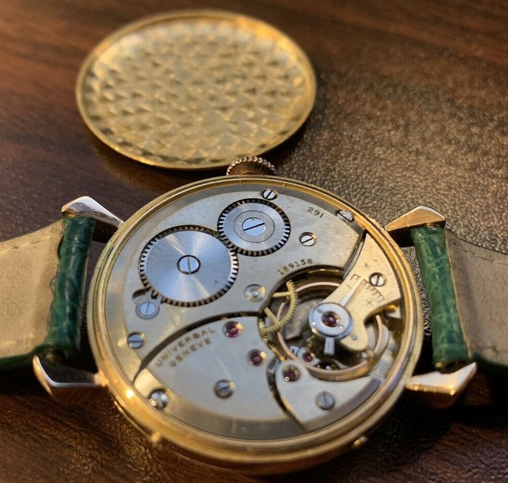

An H.P.C. marked 291 Calendar.
With a numbered movement.
Interesting but I think quite a high proportion of these movements were numbered (some randomly selected examples linked below).
I don't claim to have any chronograph expertise so I'm afraid I can't offer an explanation as to why.
It doesnt seem to be in line with UG chronometre number either (those are very high numbers...)
Interesting, I鈥檓 Glad to have found this thread. I ended up being the highest bidder on this watch it鈥檚 unfortunate about the case back not being original but still can鈥檛 wait to see it in person.
https://watches83.com/en/universal-...g-watch-cal-291-complication-collectors-.html
https://www.catawiki.com/l/17607533...eel-mm-35-moonphase-caliber-291-men-1950-1959
https://www.hqmilton.com/timepieces/43z1xp02/1940-s-universal-geneve-calendar-moonphase-21312-6936
agreed, all the cal 291 that I've had (a bunch) were numbered, so in this example above, I don't think it tells us anything, and the mystery continues......
