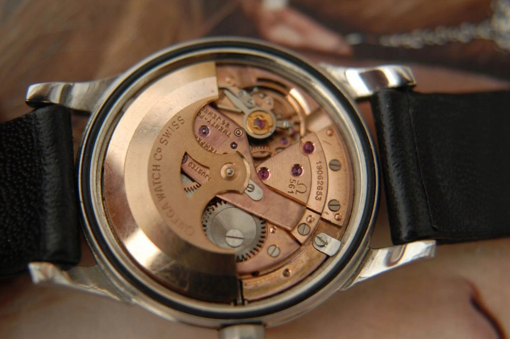

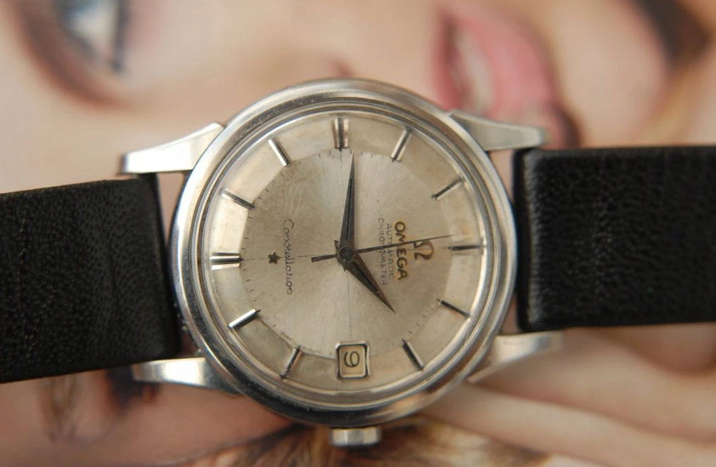

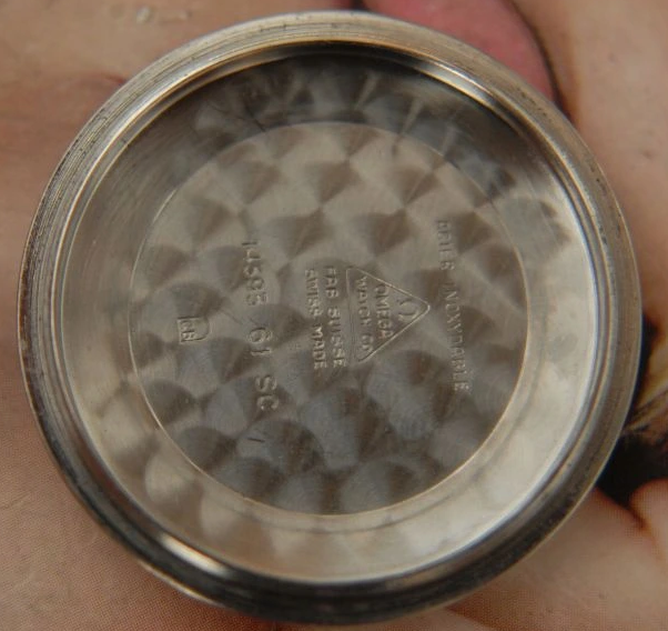

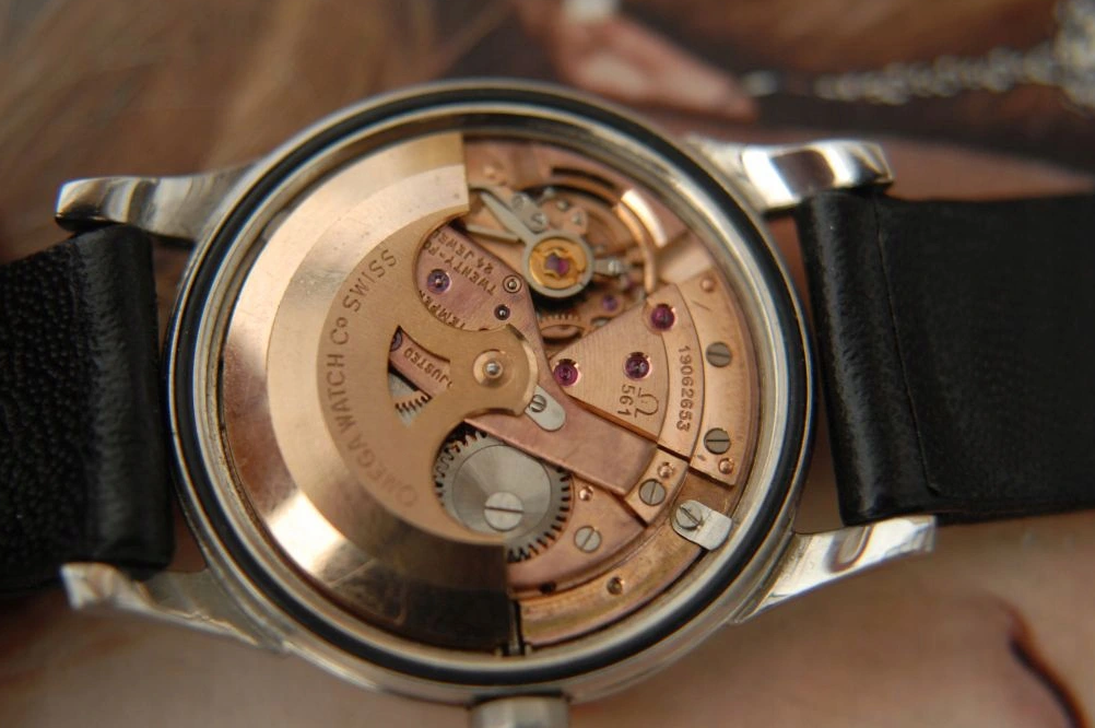

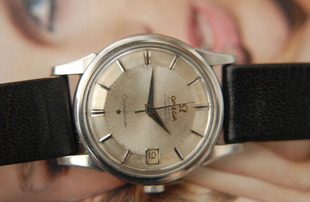

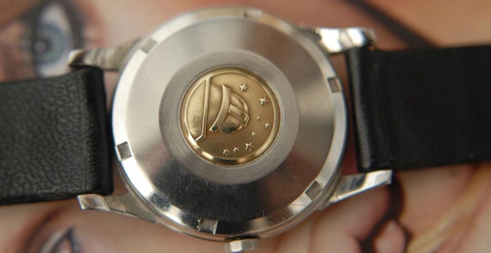

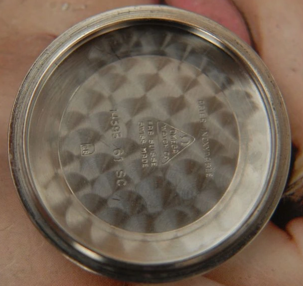

1) Omega Constellation 1961, listed as "original state, never renewed".
movement: 561
movement serial number: 19062653 (just noticed this seems to be a 1962 sn. ?)
model: 14593 61SC (not sure about all the digits though, picture not of the greatest quality)
photos named: 'Constellation 1' to 'Constellation 5'
I've just noticed this is apparently a 1962 watch, despite being listed as 1961, so probably a no-go.

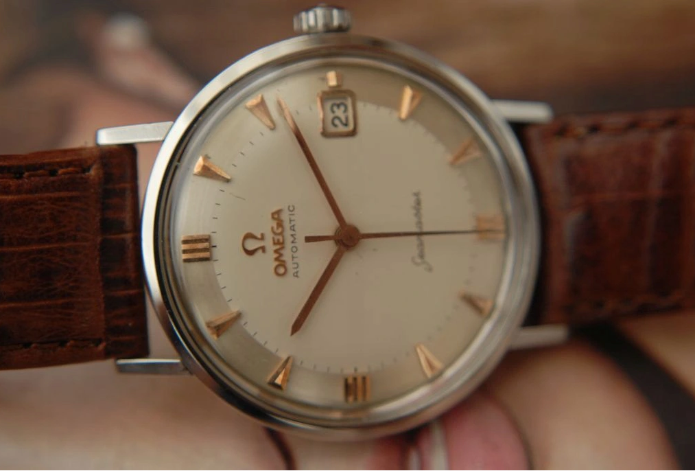

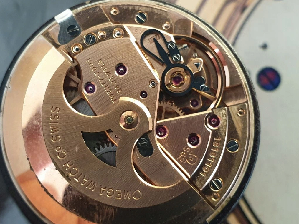

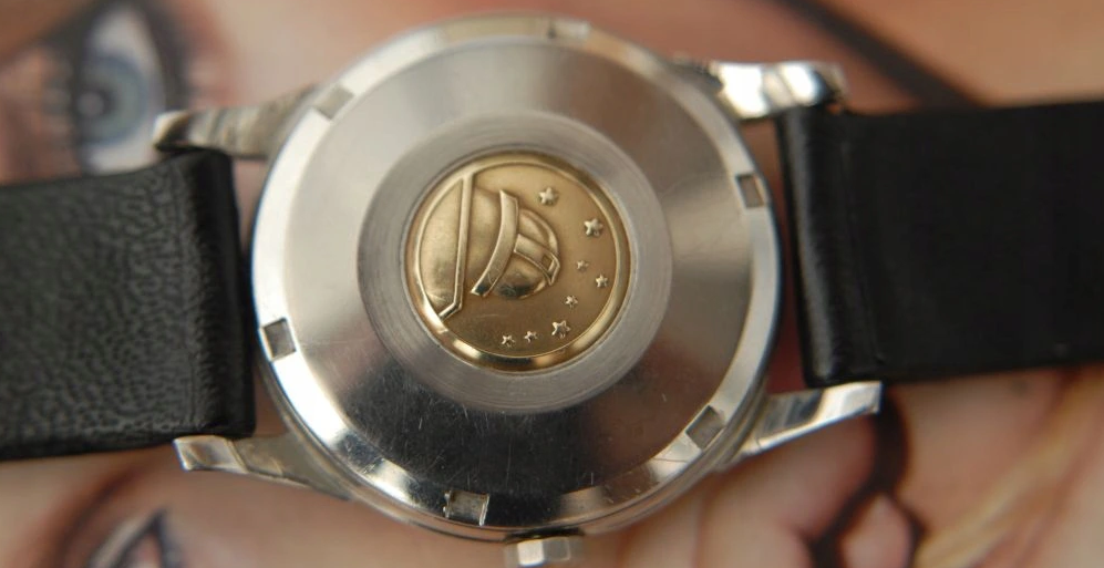

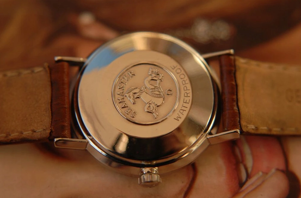

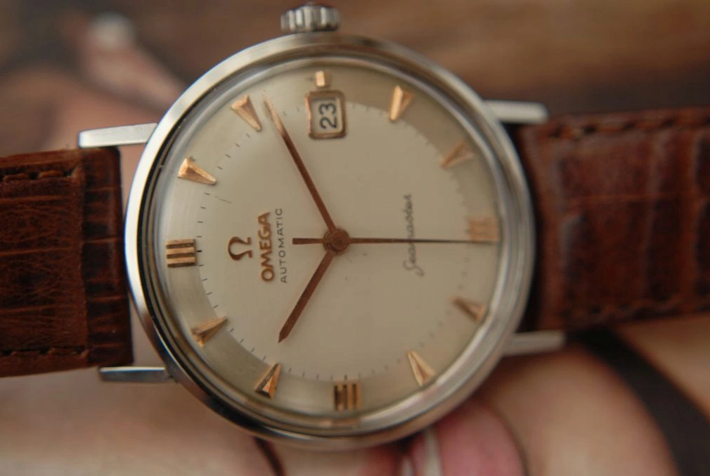

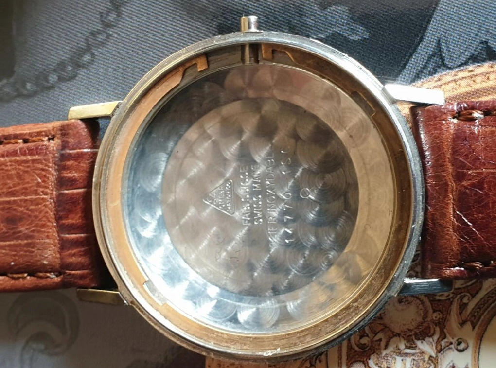

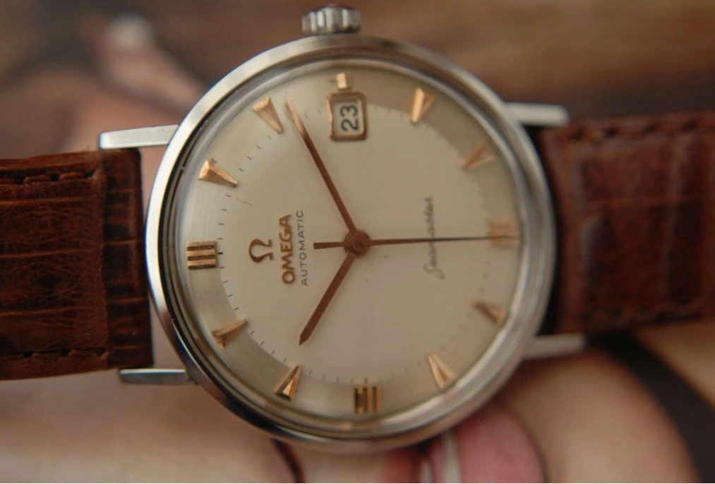

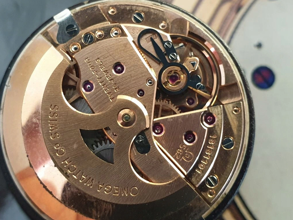

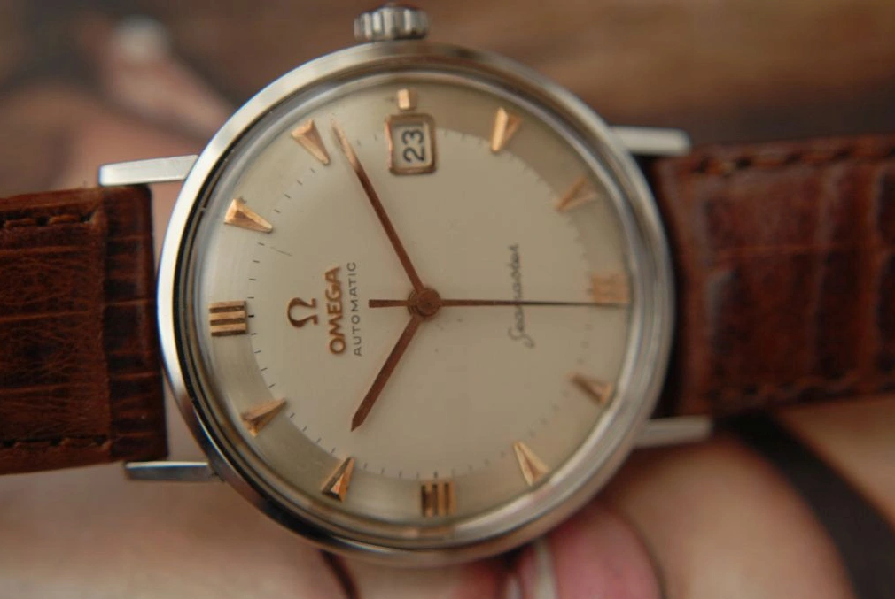

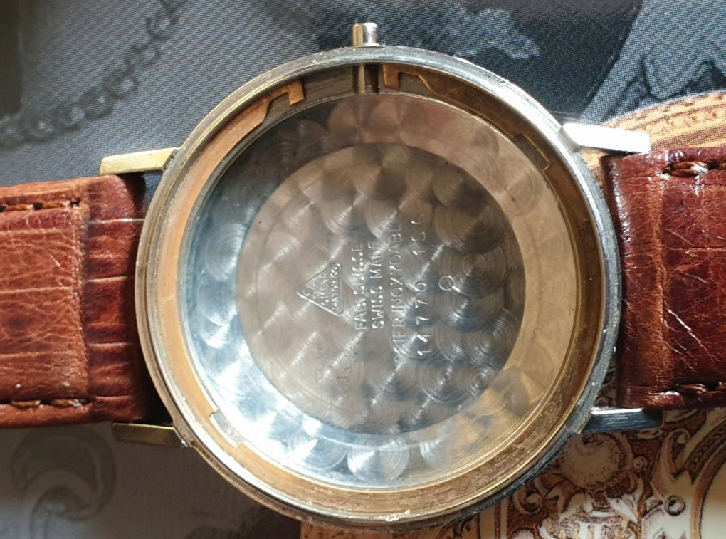

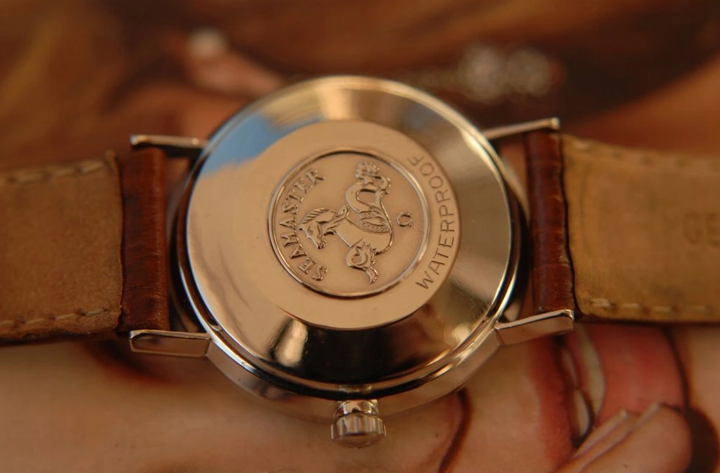

2) Omega Seamaster 1961, also listed as "in original state, never renewed". I spent a good hour looking for a watch with identical dial on the web and couldn't find one that would have the cooper-coloured hour markings shaped that way.
movement: 562
movement serial number: 18181101
model: 14770 1SC
photos named: 'Seamaster 1" to 'Seamaster 5'

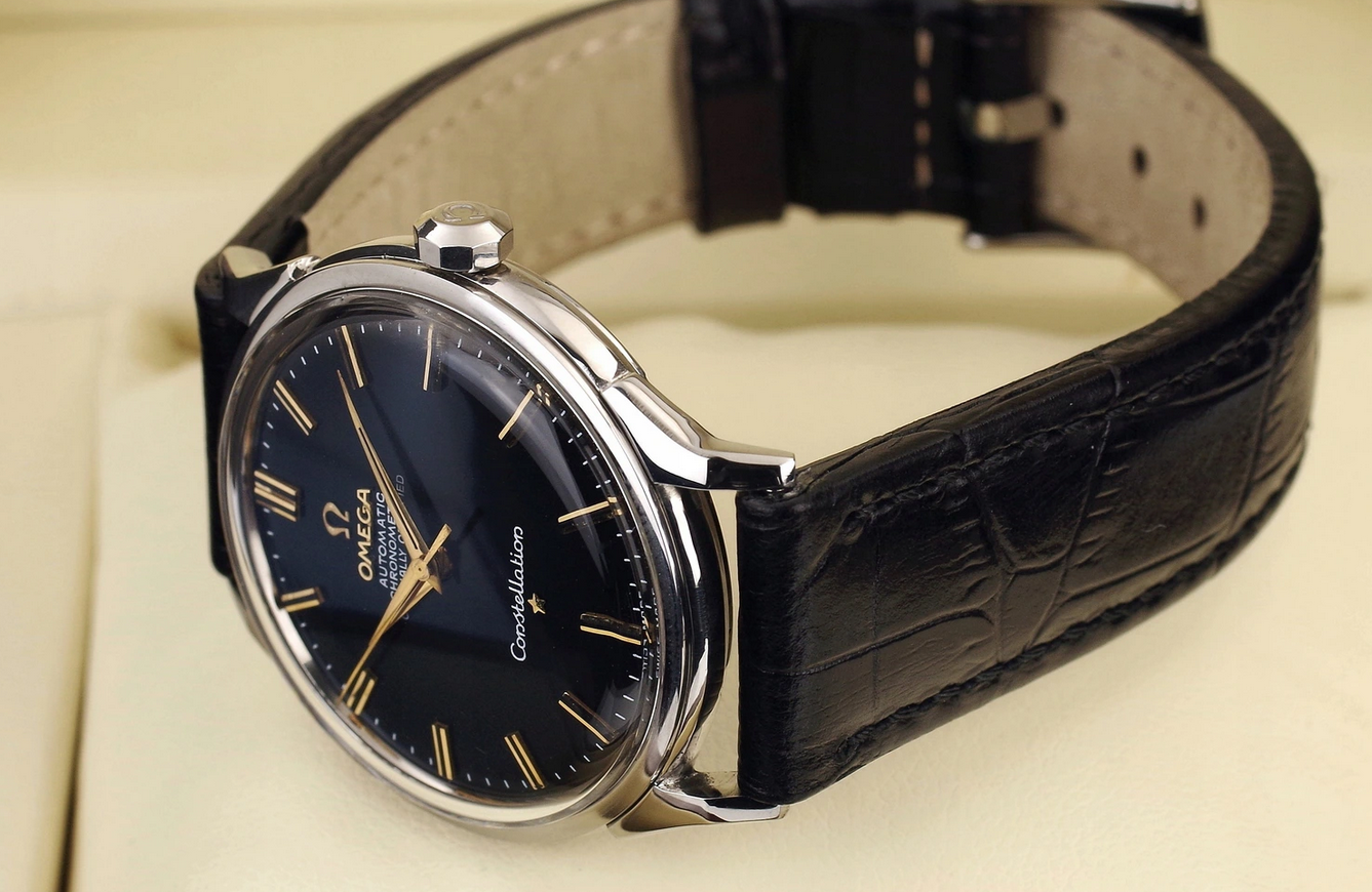

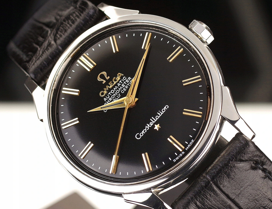

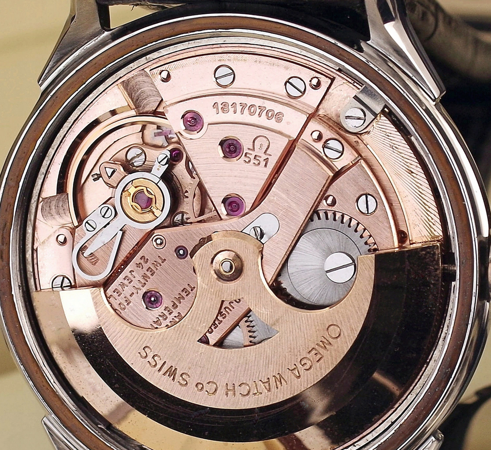

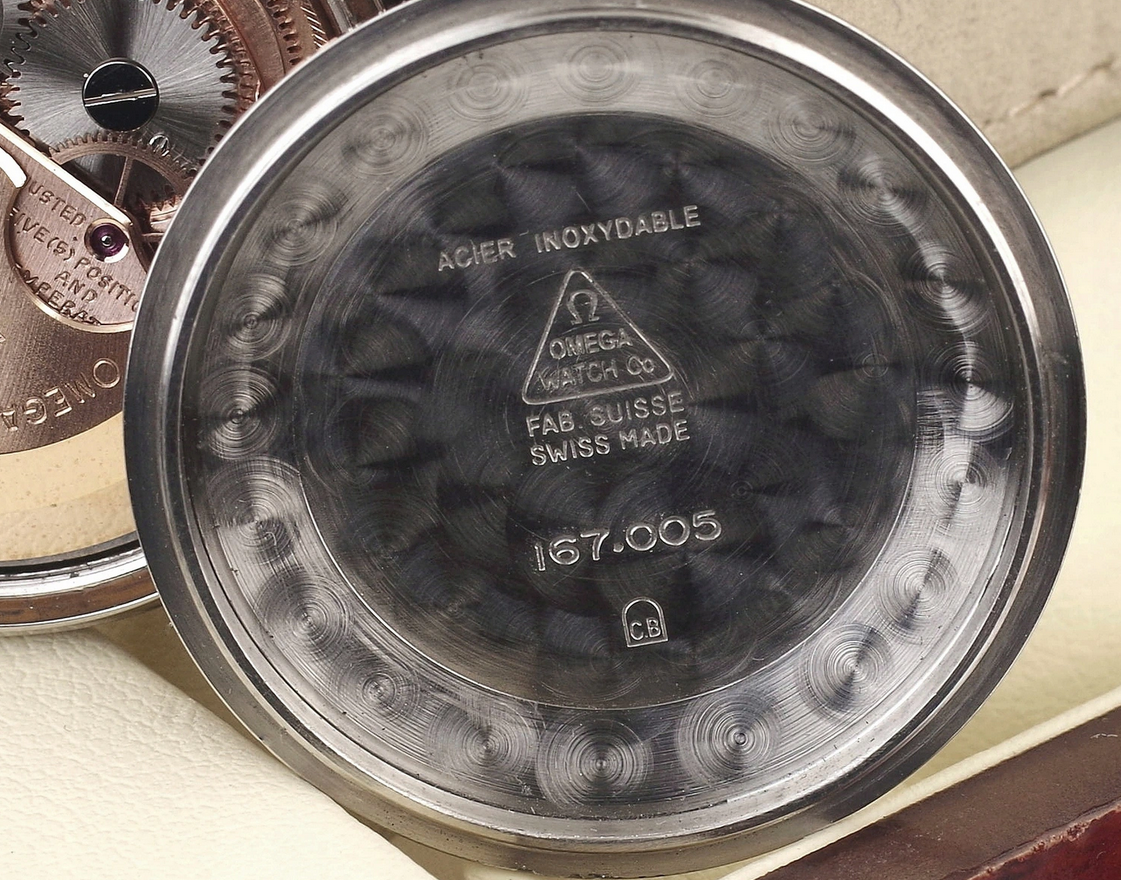

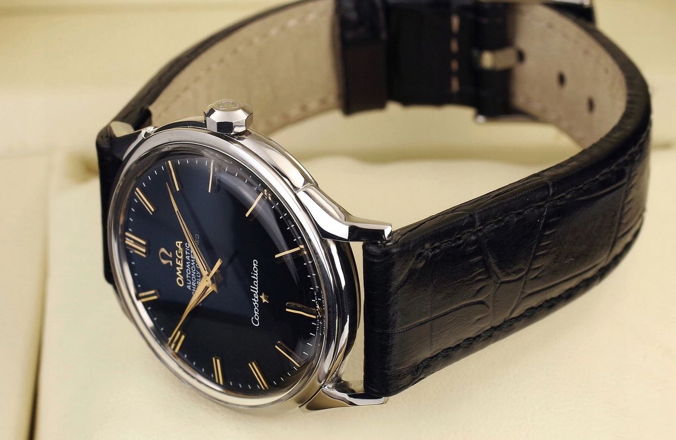

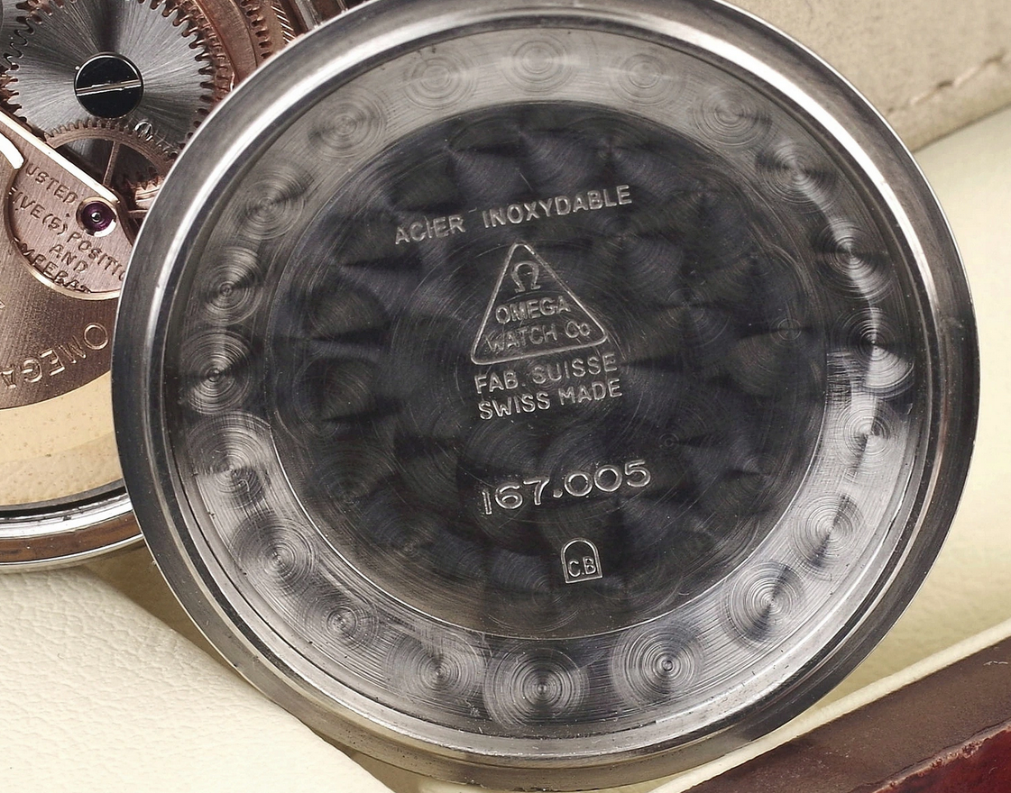

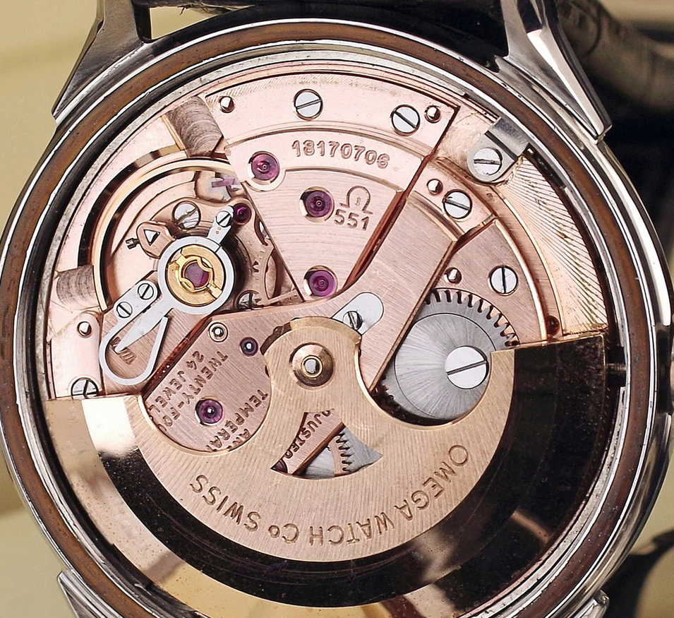

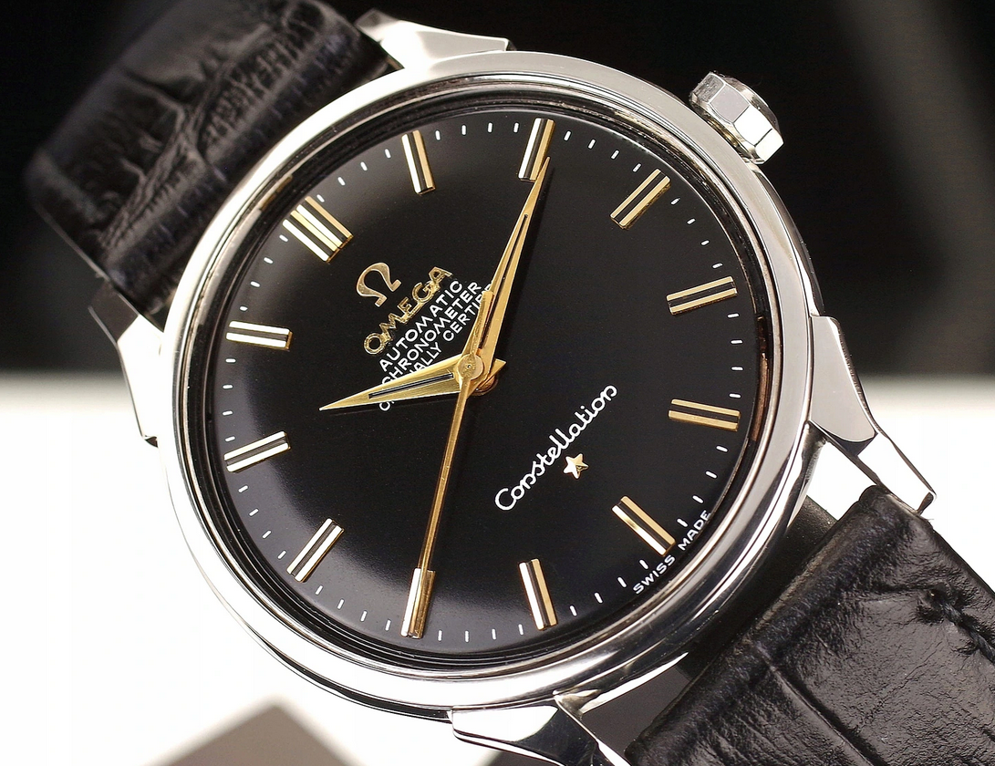

3) Omega Constellation 1961, listed as "professionally renewed". Again, I was unable to find an Omega from that period with this same exact dial.
movement: 551
movement serial number: 18170706
model: 167.005
photos named: 'ConstellationRedone1" to 'ConstellationRedone4'.

I’m no expert by any means, but the Constellation looks to have a new dial/redial. I’m sure someone more educated on here will correct me if I’m wrong.

The Seamaster also looks suspect with uneven spacing on the minute track. Look at 49, 51, 54, 56.

I would pass on all three. Constellation number 1 (the 167.005) is a redial as nearly all black dial vintage Constellations are. Constellation number 2 (the 14393) has a dial that is in very poor condition. The hands on the Seamaster are generic replacements, I think, and I would need to see better photos of the dial to make a better assessment. Sorry to rain on your parade, but I would keep looking. It was a smart move on your part to seek advice before buying. I wish that inexperienced buyers would do so more often. I recently sold a vintage 1961 Seamaster on this forum that was in lovely shape. Wish we had crossed paths then!
1,534
3,248
The Seamaster is a bit of a puzzle - I agree the hands are incorrect for a Seamaster. With no lume on the dial or hands and the applied Omega, I am wondering if it began its life as a Geneve - just a thought.
@gbesq that's great to know and a red flag for the private seller who claimed both his watches (the poor condition dial Constellation and the Seamaster) are both untouched and in original shape. The redone Constellation is from a dealer.

There are two issues with redials. The first is that the quality of redials is highly variable depending upon who is doing the work. Some redials are very, very good. Some are, well ... not. And a poor redial will ruin the aesthetic of the watch. The second problem with redials is that ANY redial - good or not so good - will significantly devalue a vintage watch from a collectible perspective. Most collectors have no interest in acquiring a watch with a refinished dial. The primary reason to buy a vintage watch is to acquire an authentic timepiece in as close to its original condition as possible. Redials make that goal impossible since the dial represents the most valuable part of any vintage watch.

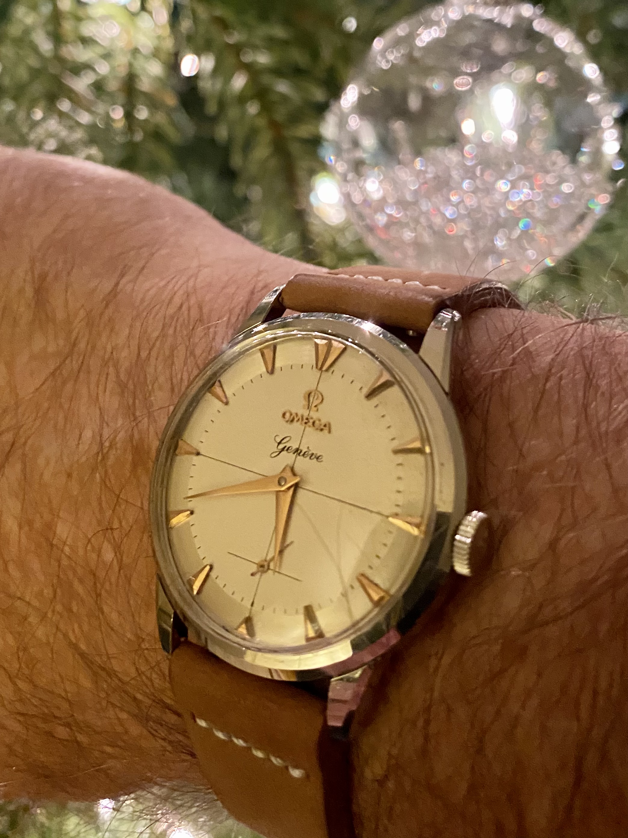

1. Genève 2903-17, cal. 268, link
