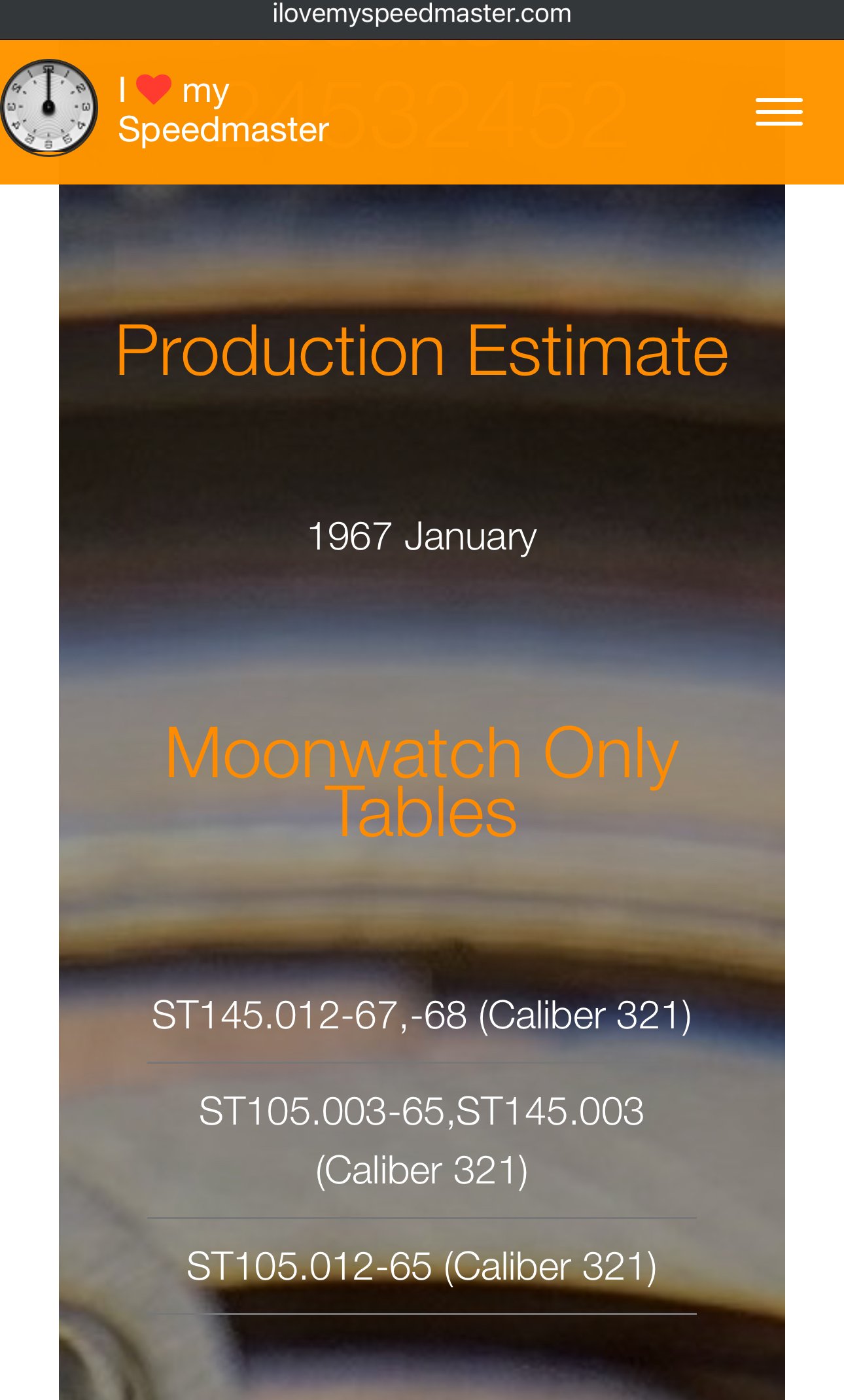

Use this: ilovemyspeedmaster.com
https://www.ilovemyspeedmaster.com/productiondateprediction/
20
16

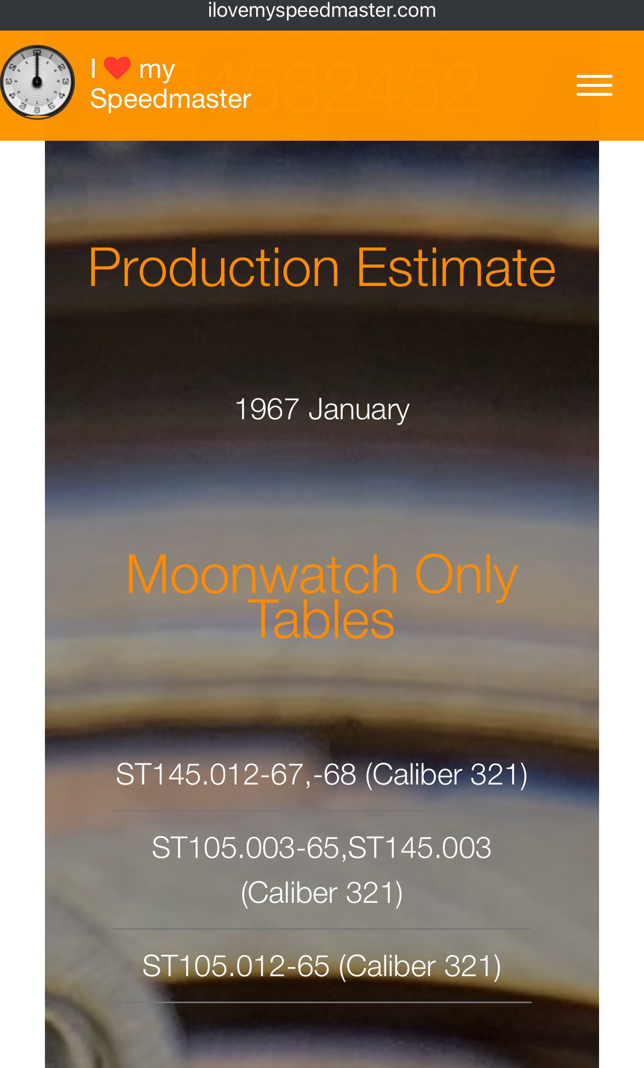

@pdxleaf
thanks for sending that site - this is what I'm getting. Think that looks good if I read it correctly!?

@pdxleaf
Respectfully, that's for you to decide.

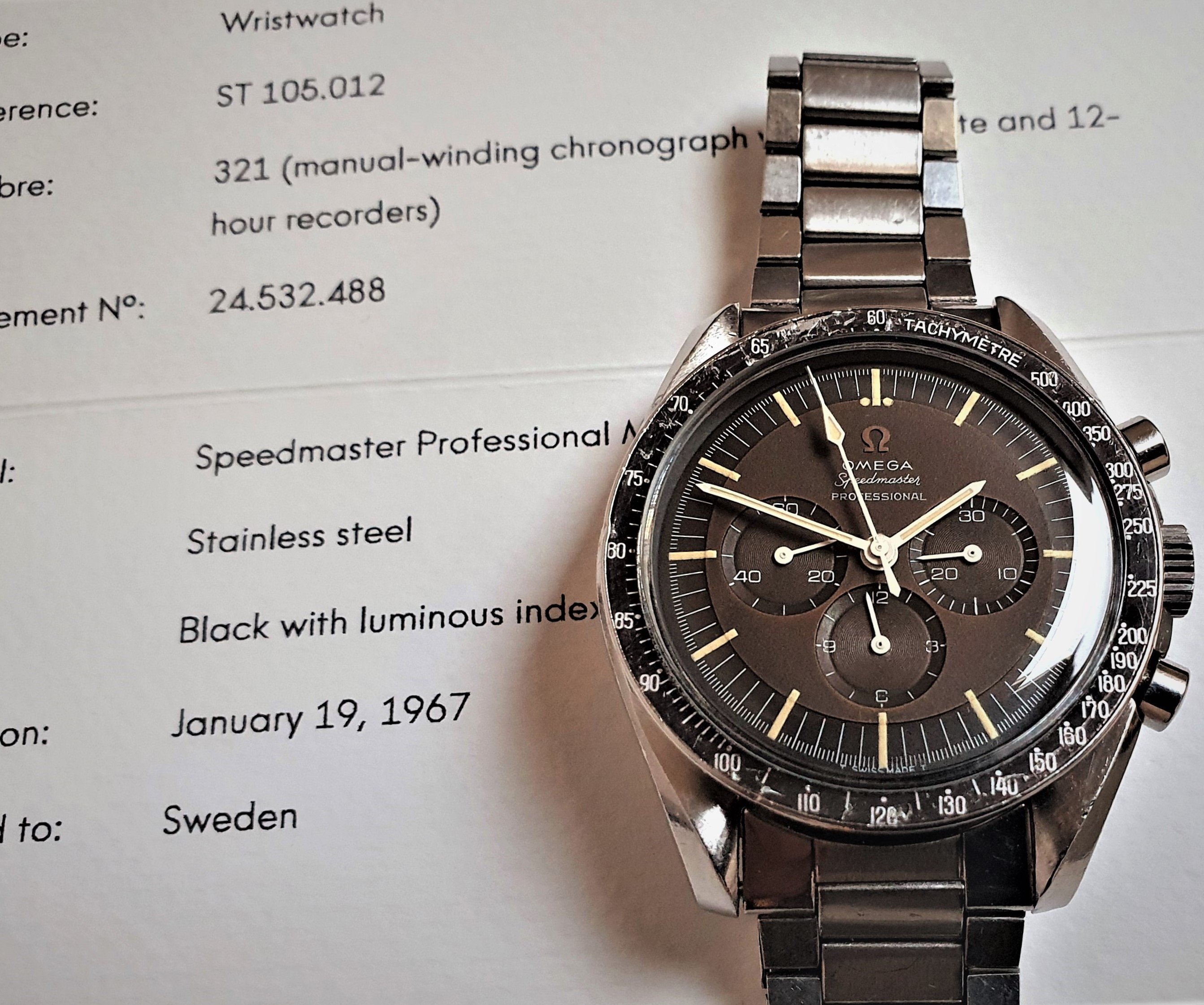

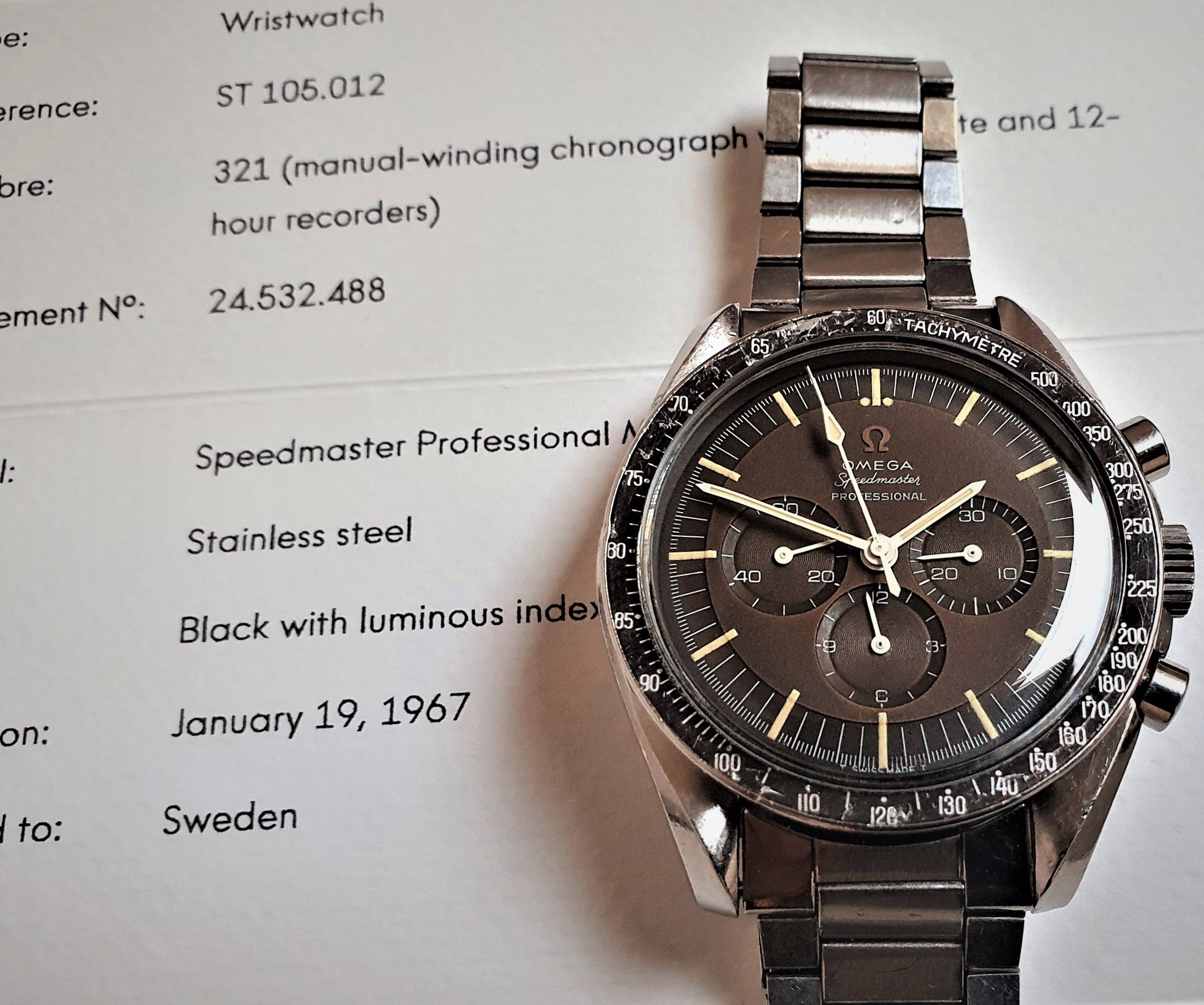

For what it's worth (as Extracts don't state sub-references), I have seen two 105.012-65's with a serial in the 24.531xxx range. Hence, both outside of the stated ranges in Moonwatch Only, but possibly correct. Given the late delivery date of this particular piece ('67), I'd say it's very well possible that it is indeed the correct case back.
The comparative rarity of the 105.012-65 versus the 105.012-66s (which it would be otherwise), provides further justification for it to be a correct 105.012-65.

Apologies for the tangent down a rabbit hole but here goes...
At first glance, Jan 1967 seems late for a 105.012-65 model but I suspect there’s may have been some overlap in 1967 with the -65, -66 and 145.012-67 models. Note like above, when you use the ILMS birthdate query option for various 1966, 1967 or 1968 months it doesn’t give a clear return for the -66 model (indeed I think it is only mentioned on one single month) suggesting either not enough data or a fuzzy transition between models. Another thing to consider is that a good proportion of the -66s are CB cased with the extra lug facets, this aren't seen here adding further weight to the Jan '67 date being OK for a -65 (unless it was a HF -66 with a swapped back that is, but I think that less likely).

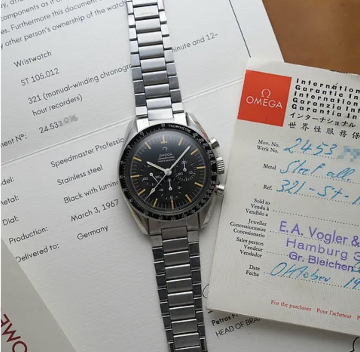

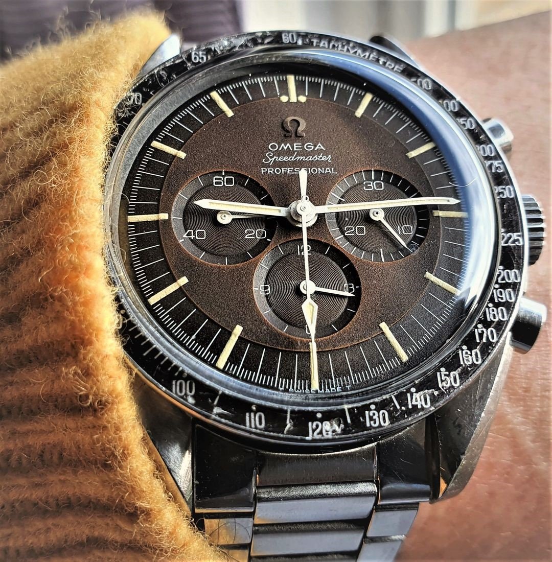

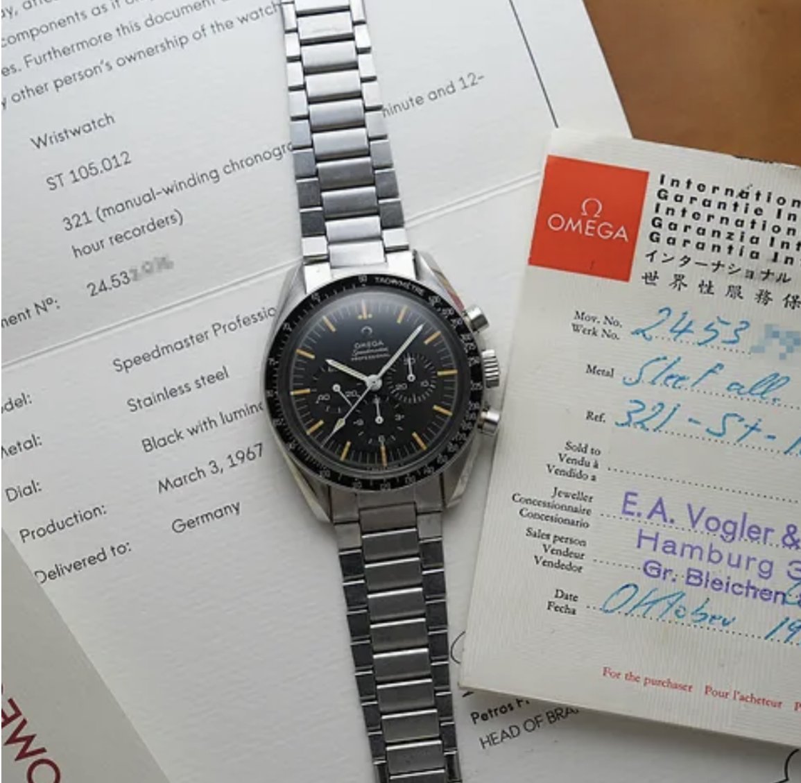

I went down a rabbit hole a few months back trying to figure out if a 105.012-65 I bought with a 24,537,xxx serial and spaced T dial was correct. At first I found a lot of threads here that made me think it was wrong. However, after reviewing this in depth review on/by chronoholic (who I believe is a member here), I concluded it was likely correct. Here is a relevant excerpt:
“As we’ve all learned, the most common dial variant observed on the 105.012-65 is the ‘B2. Close T’ Speedmaster Professional dial, while examples of the 105.012-65 reference produced at the very end of the production run in early 1967 (24.533.### - 24.537.### serial range) can exhibit the ‘B3. Spaced T’ dial.”
So it seems like -65 production ran well into 1967. He has a nice full set listed in his store as well with a 24.53x serial with an extract listing March of 67:
Here is mine, which has similar lume:
761
913
Spectacular watch!

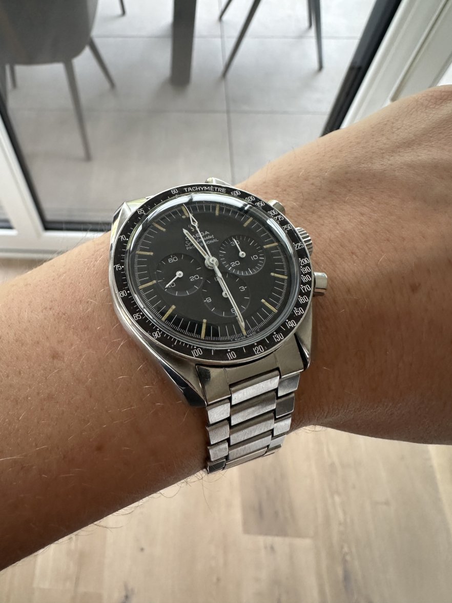

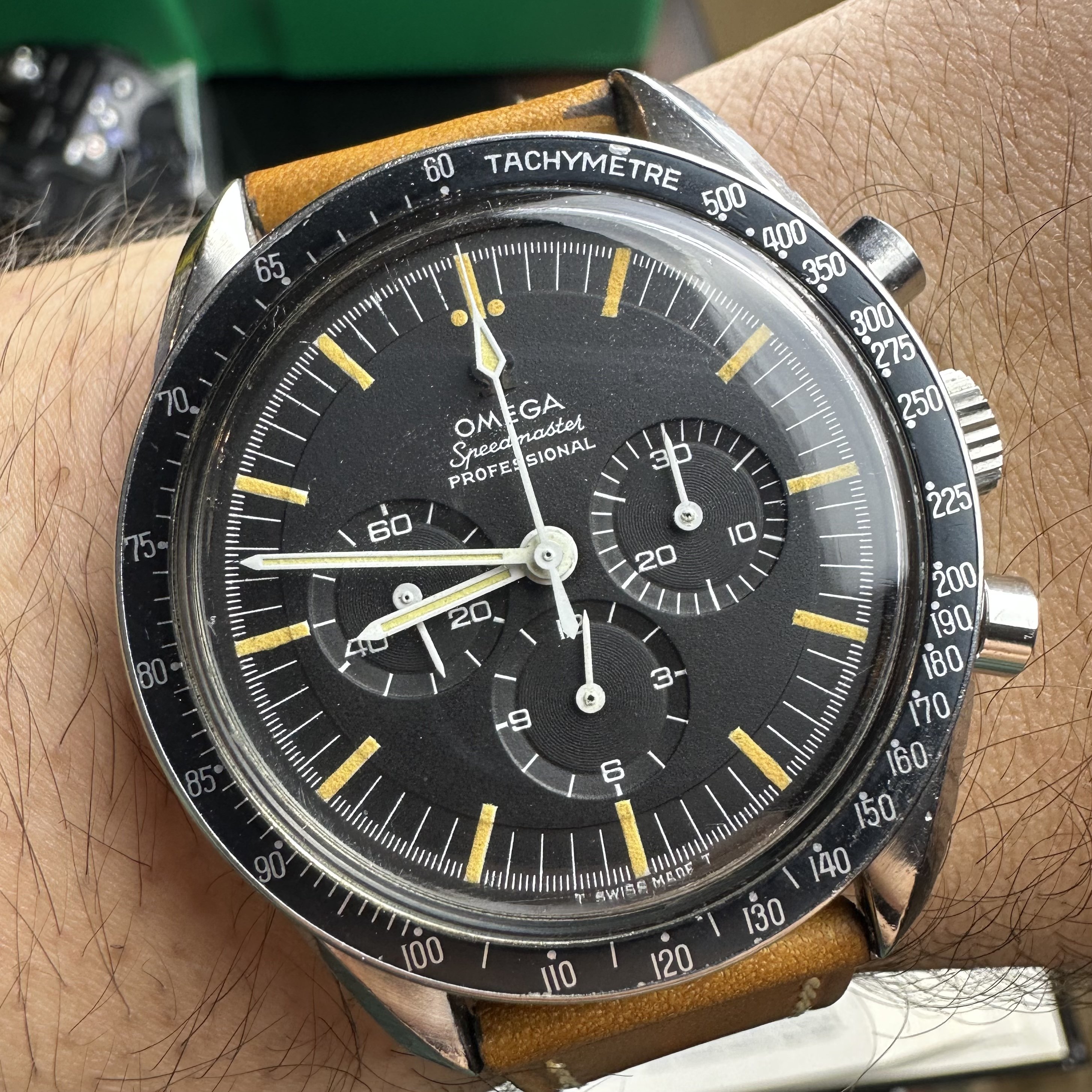

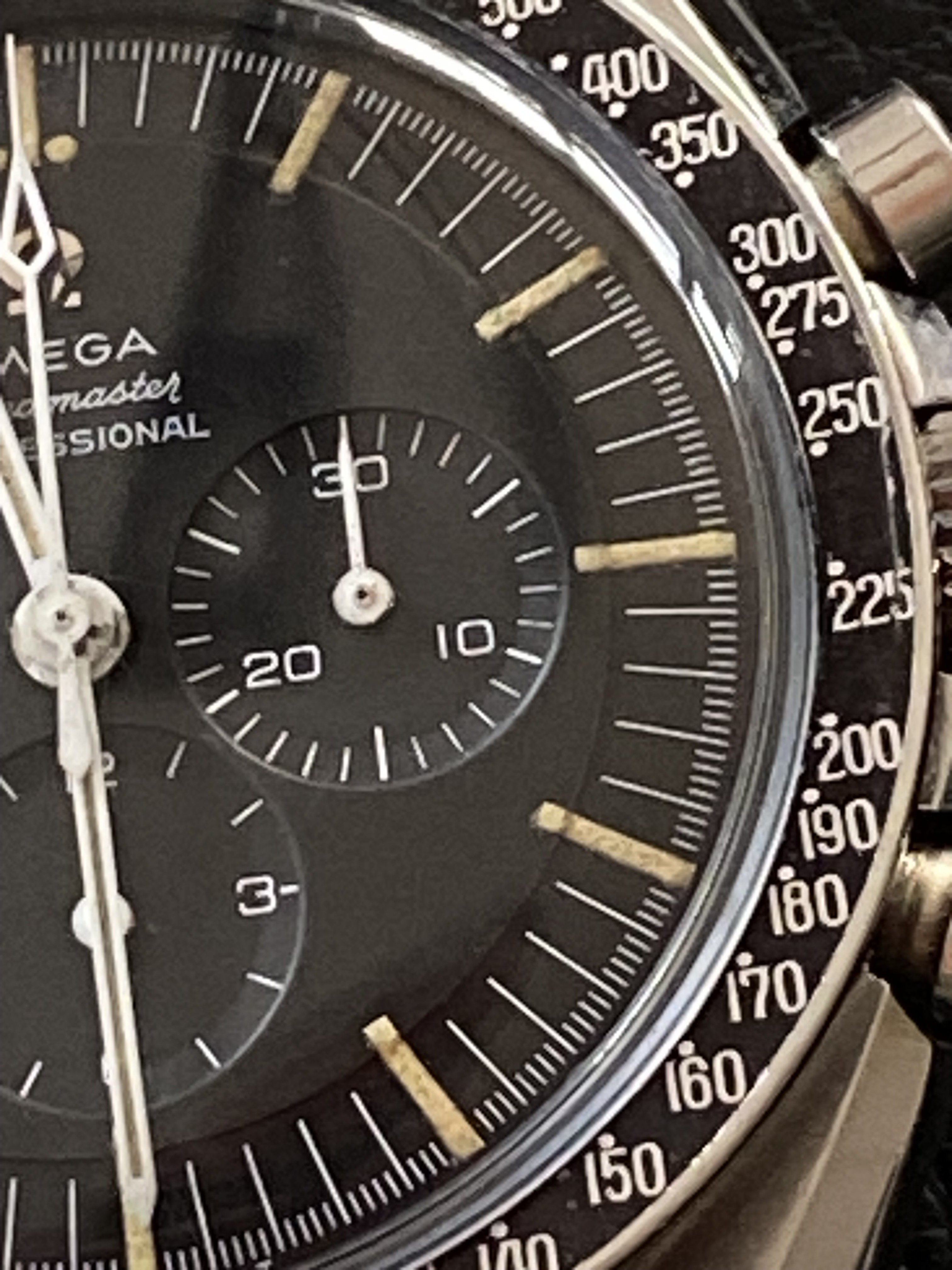

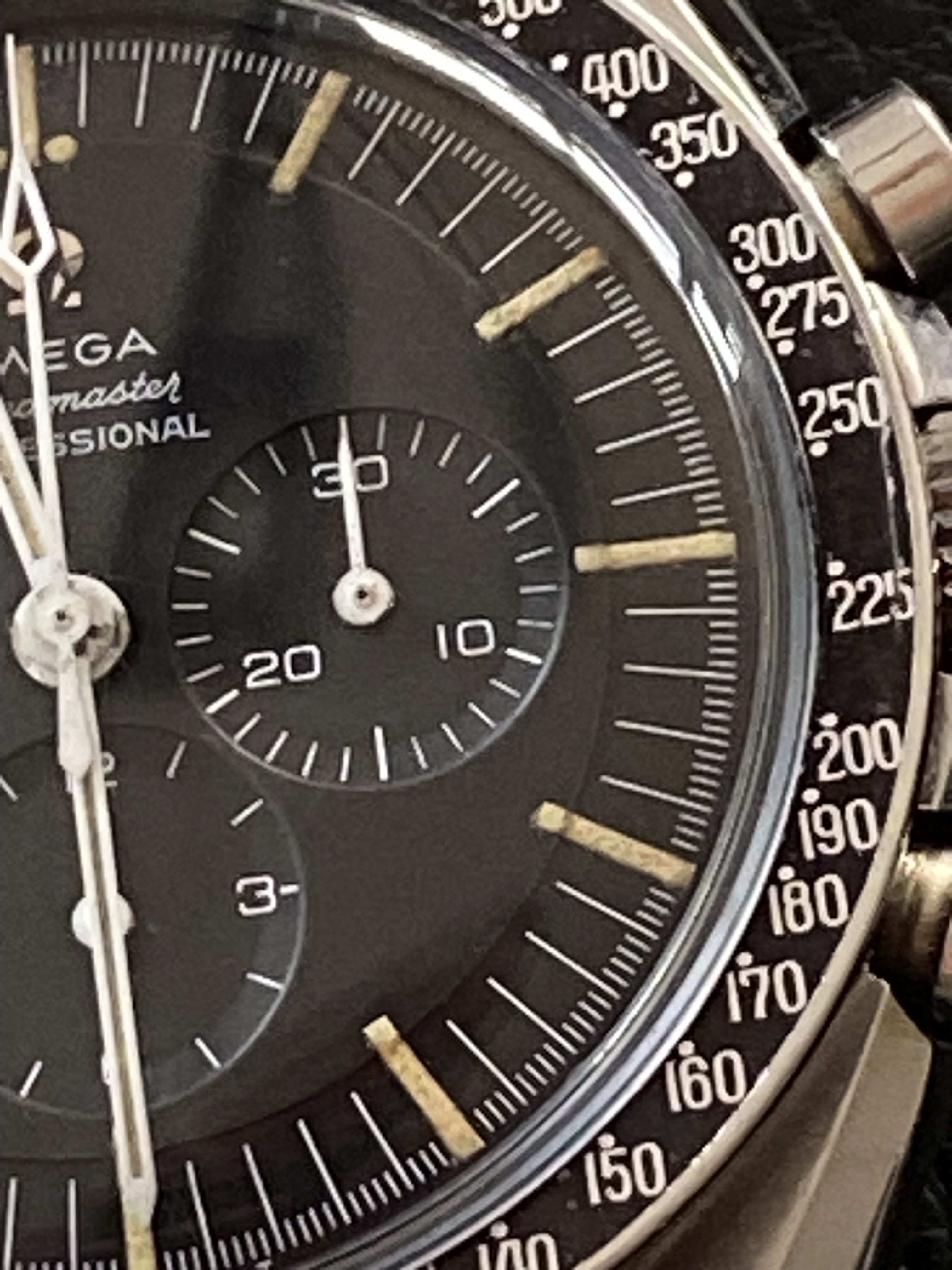

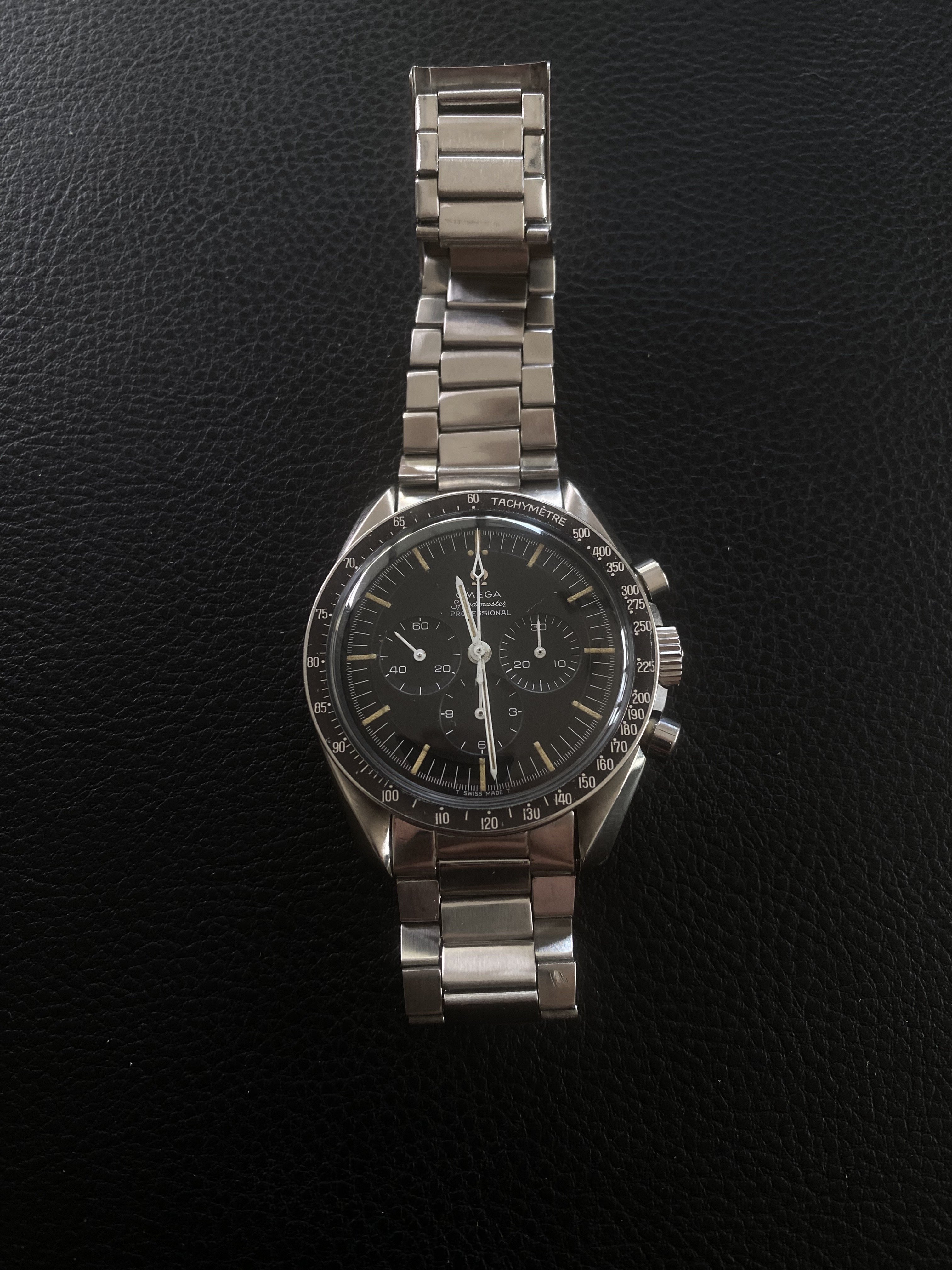

Hey everyone,
I decided to go ahead with the piece from Belmont and it just got delivered (to my parents house, I’ll pick it up on Friday and can send more photos). Have two pics attached that they sent. Initially thought there might be a scratch on the dial above the 30, but there’s just been a hair haha - as to be seen in the more zoomed photo.
Thanks to everyone for all the great help - wouldn’t have changed my original one without the feedback on here, but obviously very happy that I did! @pdxleaf @ibis888 @Aludic @Davidt @SOG53
