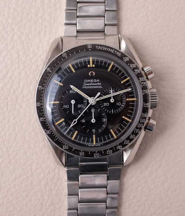

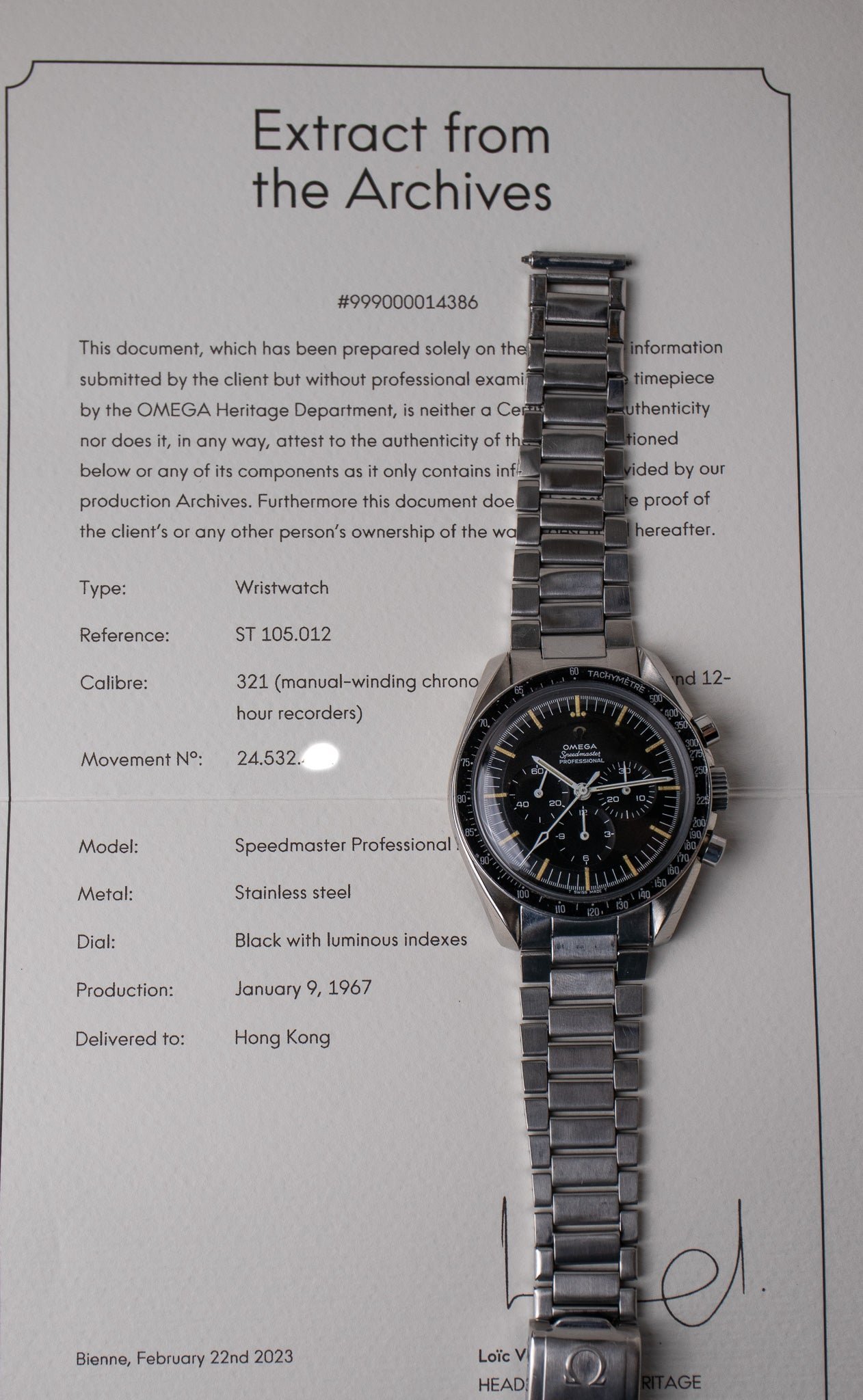

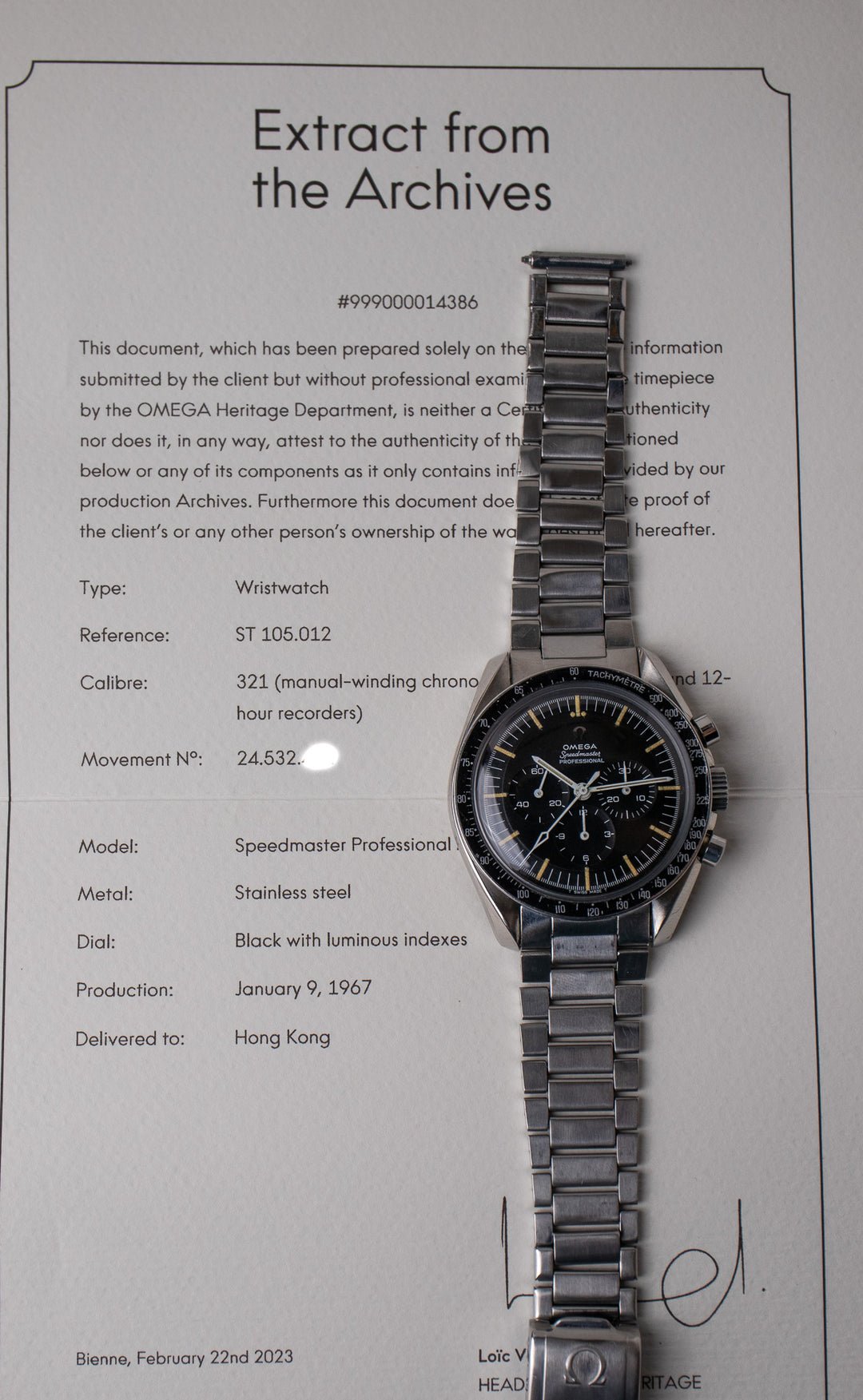

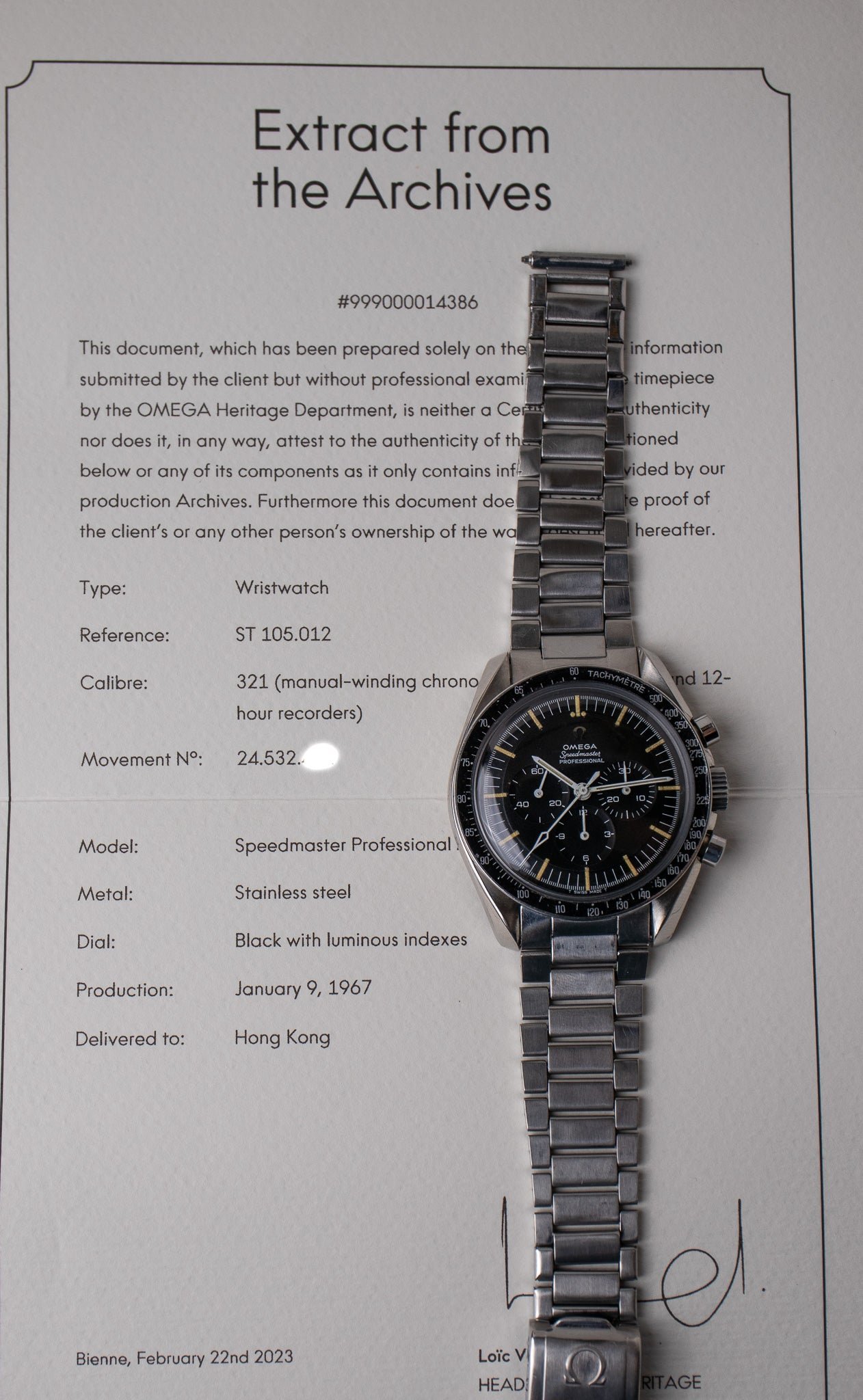

Also just got this one sent with a price of $10,000.
Does everything look correct here? Happy for any feedback 😀

The photo is not focused enough to determine the condition.
A photo of the movement is always helpful, as well as serial number, and a sharp photo of the case showing multiple angles.
The missing lume from the chrono hand would bug me, as well as the chipped paint from the center of the hands. Not earth-shattering, more a matter of personal taste, as there is usually something that is less than perfect that you have to live with, which each person feels differently about.
The lume color is attractive, but the photo is not sharp enough to determine if it is original or relumed.
The bezel looks in good condition but the photo isn't sharp enough for me to tell if it's real (not saying it isn't, just that i can't tell.)
That's about the best I can offer. See what others think.

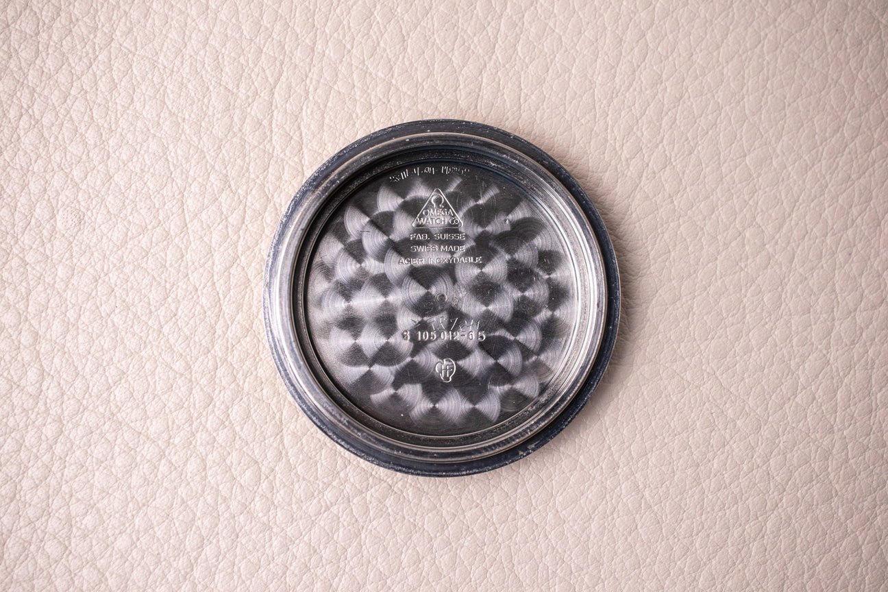

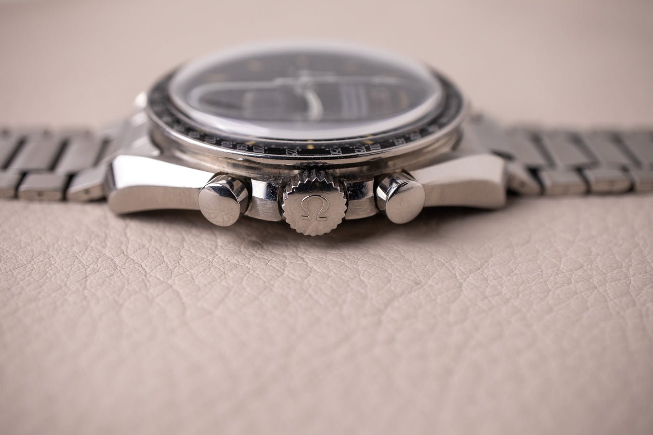

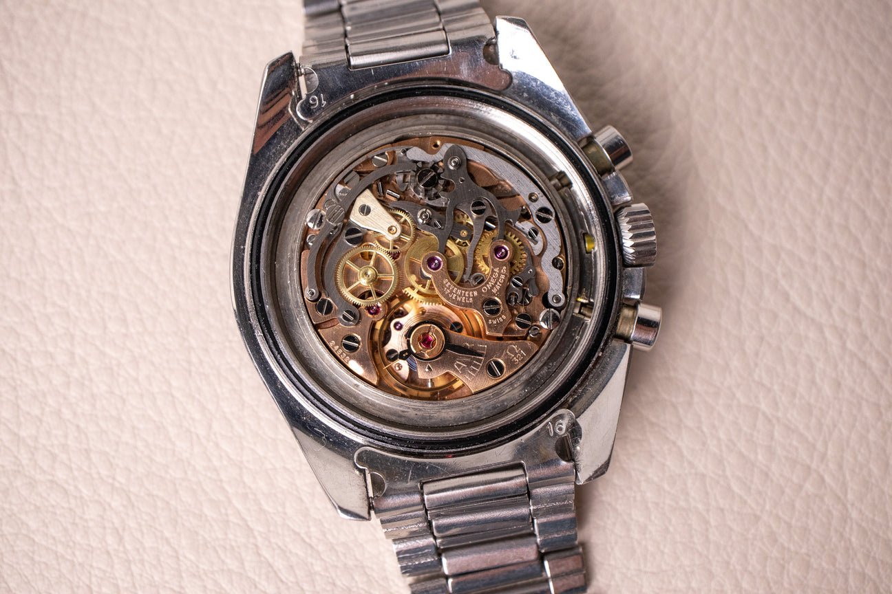

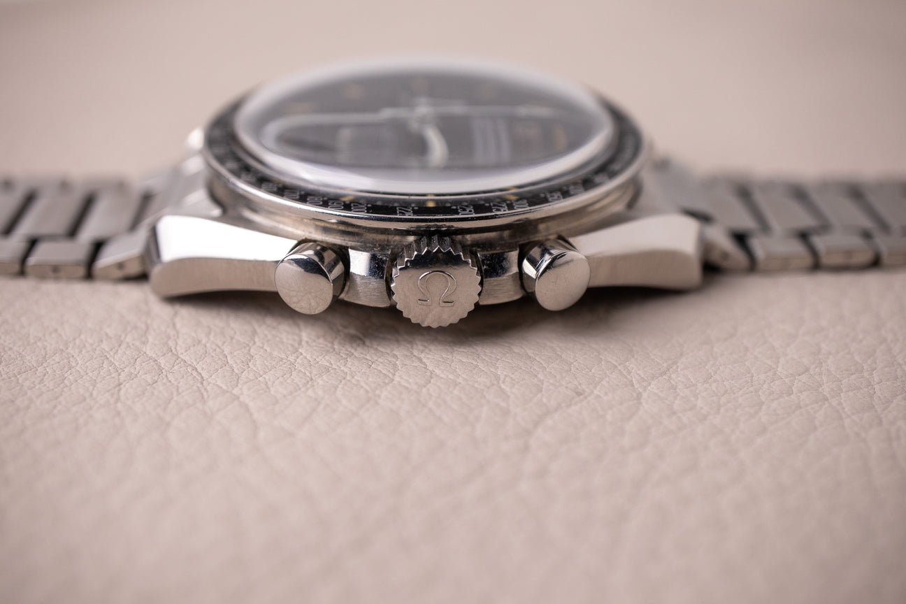

Thanks so much @pdxleaf, it's so extremely helpful! I know I want that reference, but definitely don't have the knowledge/experienced to immediately recognise all these little things.

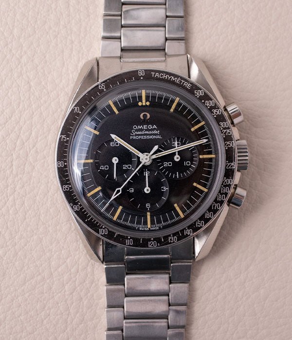

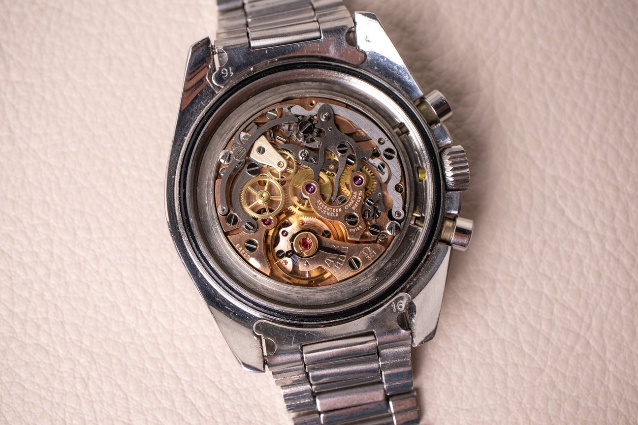

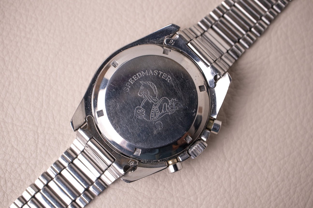

Here are a few more photos - similar to mediocre quality, but at lest some different angles..

Nice that you received an extract. From where I sit ot looks correct. The movement has been serviced a few times. Fair price

About the other one discussed above; that looks like a watch worth studying more. Correct at first glance and fairly priced, especially with that 1506 bracelet coming as part of the package. Given the chance to buy that one, I’d be tempted!

Greetings from Paris (on a vacation 😀)!!!
We all love the 105.012´s, and the 65 is one of our Grails.
I don't understand if you have been offered the watch (not the Chrono24) or you have bought it?
This one looks very promising, but to help you with a correct assessment,
more, better and sharper pictures are needed.
The dial could be very nice....Some darker spots on the lume.
And the hand seems to match the watch.
A nice bezel, with only a few marks, but sadly - a scratch at the 225-275 markers.
The chrono hand needs a re-lume, and maybe coloradjust the white missing on the hands (if that bothers you?).
The watch has the correct pushers which is very important and a correct crown.
I think that the case has had an easy polish. But in a nice condition with some visible brushing.
A nice 1506/16 bracelet, maybe a little tired/some stretch.
The movement looks very nice, and serviced a few times.
Always nice to have an extract.
But more detailed pictures are VERY important!!
If the dial and lume are nice,
with no scratches, marks, oilmarks or other blemishes then the price is very reasonable.
Good luck, and we are looking forward to your pictures!

$10k is a fair price for that watch in my opinion (for whatever it's worth). Especially with the bracelet and extract. It has the correct B1 "dot diagonal 70" bezel and the short and fat pushers. The hands and lume are a little tired but in an honest way, I think it speaks to the character and age of the watch. That part is up to you though, the price will be much higher if the lume was in very good condition.
Tough to tell if there is any dial damage or not...

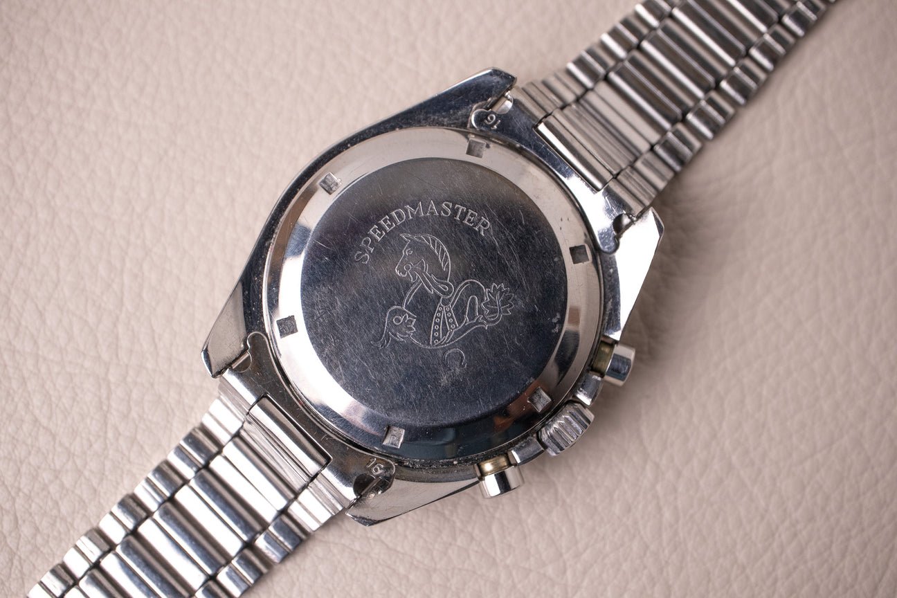

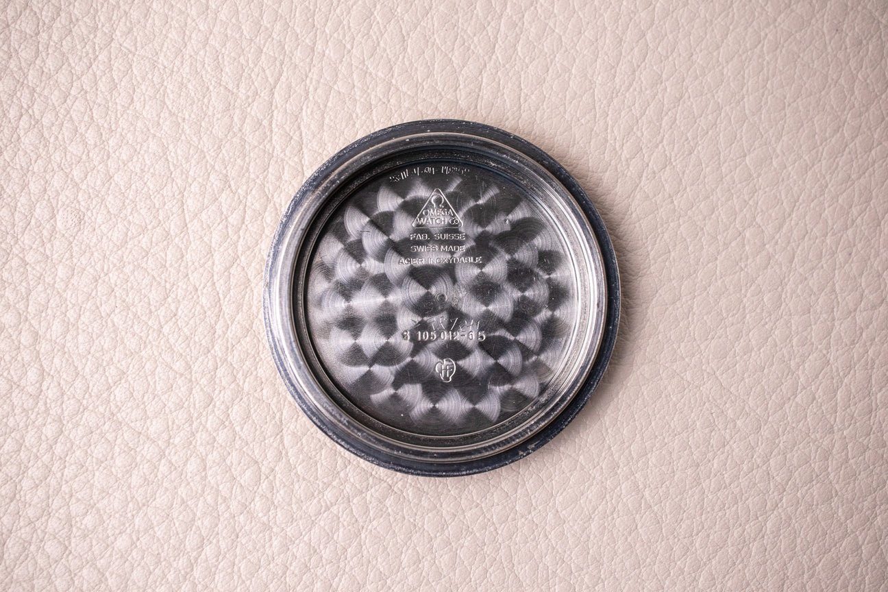

Any chance you have a picture of the caseback to see if the double bevel is still visible? A key feature of the -65s.
January 1967 is near the end of the production run of the -65s.

@ibis888 photo of caseback attached, happy to hear your thoughts on it 😀

I’m no expert but I think it’s going to be tough to find another -65 around that price point in that kind of condition. Assuming no dial damage (tough to tell from photos) seems like a great, honest watch.
I’m saving up the funds for a -65 or -66 and would certainly be very interested in that watch if I was ready to buy.
Make sure you factor in a service in the near future.

Well, it looks like there is some minor dial damage. The seller states that the dial is in great shape with one patina spot. It looks like it is on the 9 o'clock side of the running second sub-dial (on the edge). Looks like an honest watch at a very fair price, even factoring in that patina spot in the dial, the slightly softer case and a little stretch in the bracelet. Good buy, imho.
Good eye. It could just be some floating lume from the chrono hand, which wouldn't be permament. But he should pay as if it's damaged, especially as you noted that the seller pointed it out.
