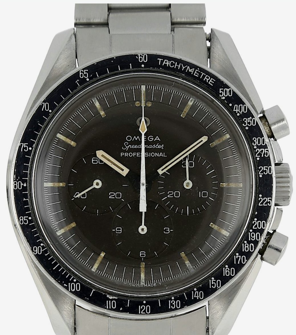

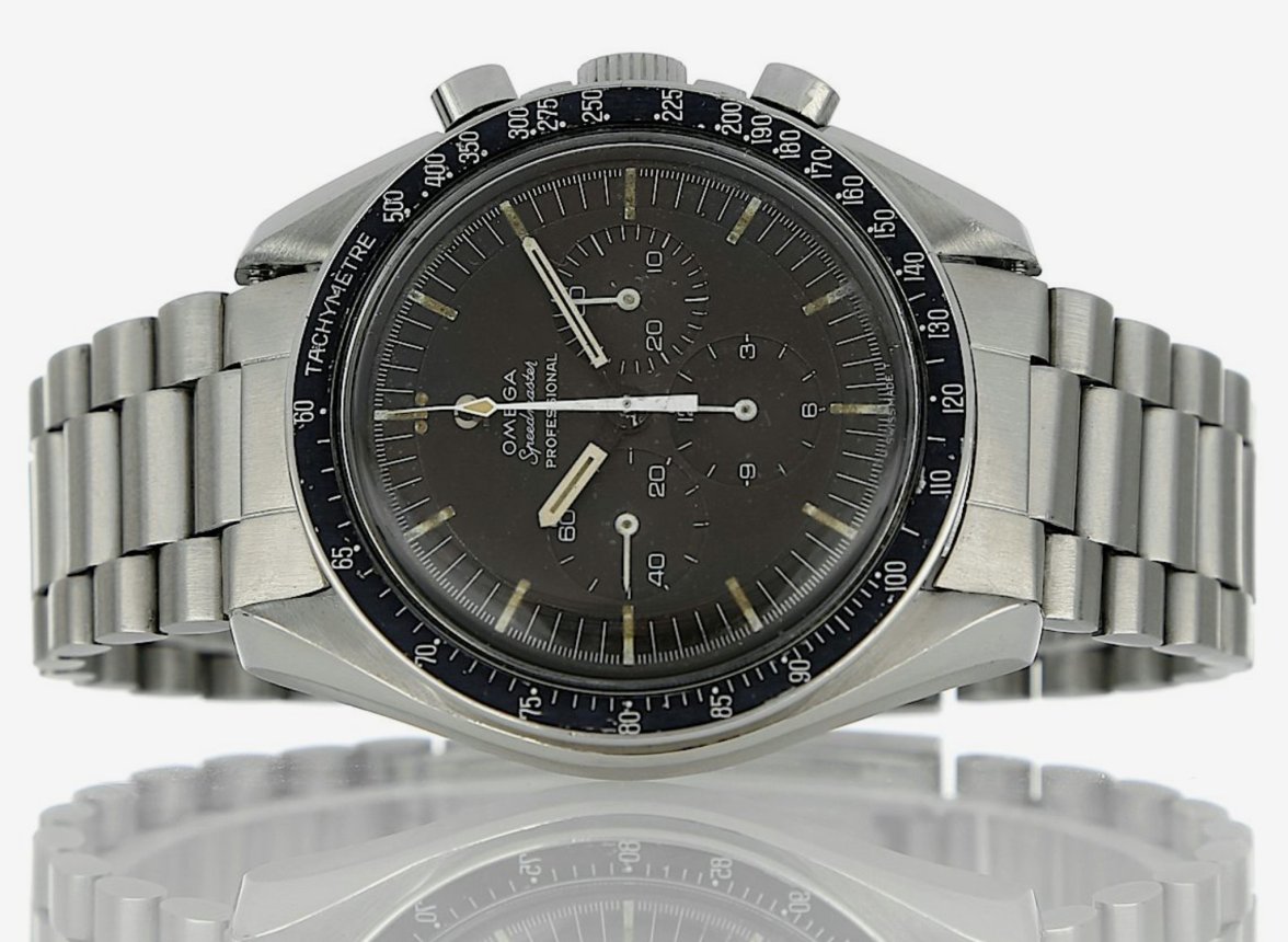

I recently bought a 105.012-65. Generally very happy with the condition, but only now I realised that the minute/hour-hands are shorter than on other photos I find of the watch (and shorter than on most Speedys in general).
Has anyone seen such shorter hands before? Is it likely they have been replaced at some point?

Yes hands are replaced, these belong to another Speedmaster model iirc the mark series.

They’re incorrect. From a mk4.5 I think. The chrono hand is also wrong

The watch will of course need a service, you could have the hands replaced at that time if you can source a set (try the WTB section of this forum and make sure you get the correct "tear drop" chrono seconds hand).
The bracelet is also not original to the watch but a later model (still valuable).
At least the pushers are correct, one of the best features of the 105.012 compared to later speedmasters.

Just my opinion, but at the price listed (8,900 Euro?) I would return the watch. You can do a lot better for the money, particularly on the private sales section of this forum.

Whether this purchase was a mistake, is all relative to the price you paid. The watch does have correct pushers and a DON bezel which appears to be in fairly nice condition.The lume on the dial is in poor condition along with the incorrect hands. Do you have a photo of the movement? Please share if you do.

Hands aside, the dial is not in great condition. As your knowledge/taste evolves, you may grow to not like it so much. A re-lume could improve the lume plots themselves, but the dial itself isn't in good condition either. And again, not for this price point. Best of luck!

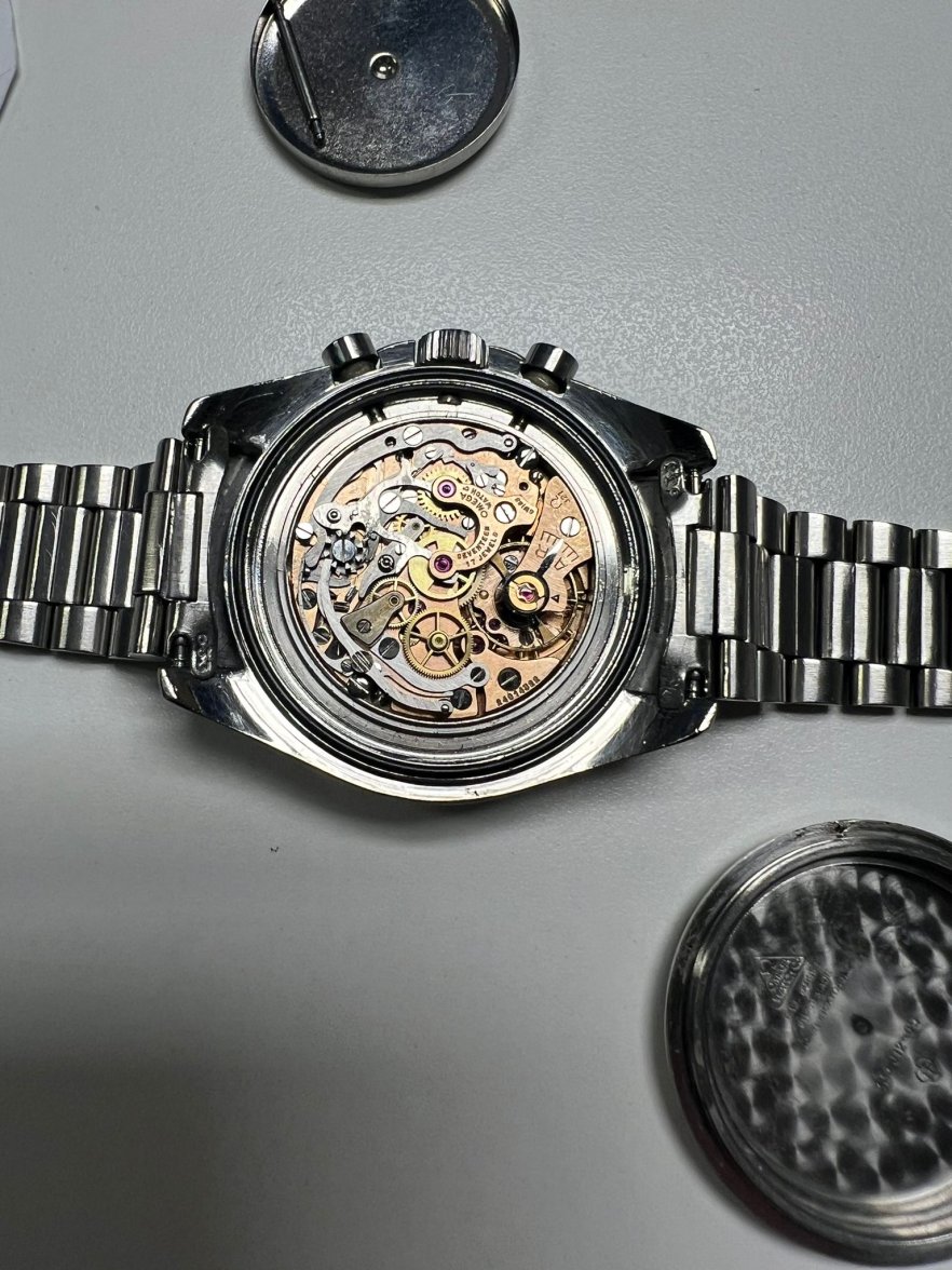

Photo of movement attached

The dial would bother me more than the hands. You can find hands and have them aged/relumed if necessary. The dial however, is not attractive to me. The plots are dark green rather than the nice yellow you see on the good examples.
As your watch collecting eye is refined I think you’ll like this one less and less, especially at that price.
Id also return it.
