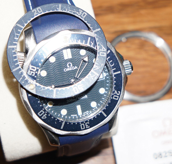

A 2561.80 (see attached photo), midsize bond quartz. It ends up in the ocean, worn when I'm working on engines and my bike, etc, generally gets scratched to hell. Also, the insert was uniformly faded. Before asking, all genuine replacement parts.
I got my hands on a replacement midsize bezel from a more recent SMP--the tracks were of a different size from the original, so swapping the insert and keeping the original bezel was necessary. Perfect fit. Unlike the Speedy inserts, the SMP inserts (at least the ones I tried) are possible to separate without special tools--though the case press would certainly work for separating an SMP bezel/insert if it was tight. Placed by hand, locks in well (no chance the insert could be removed with bezel still on the watch!).
