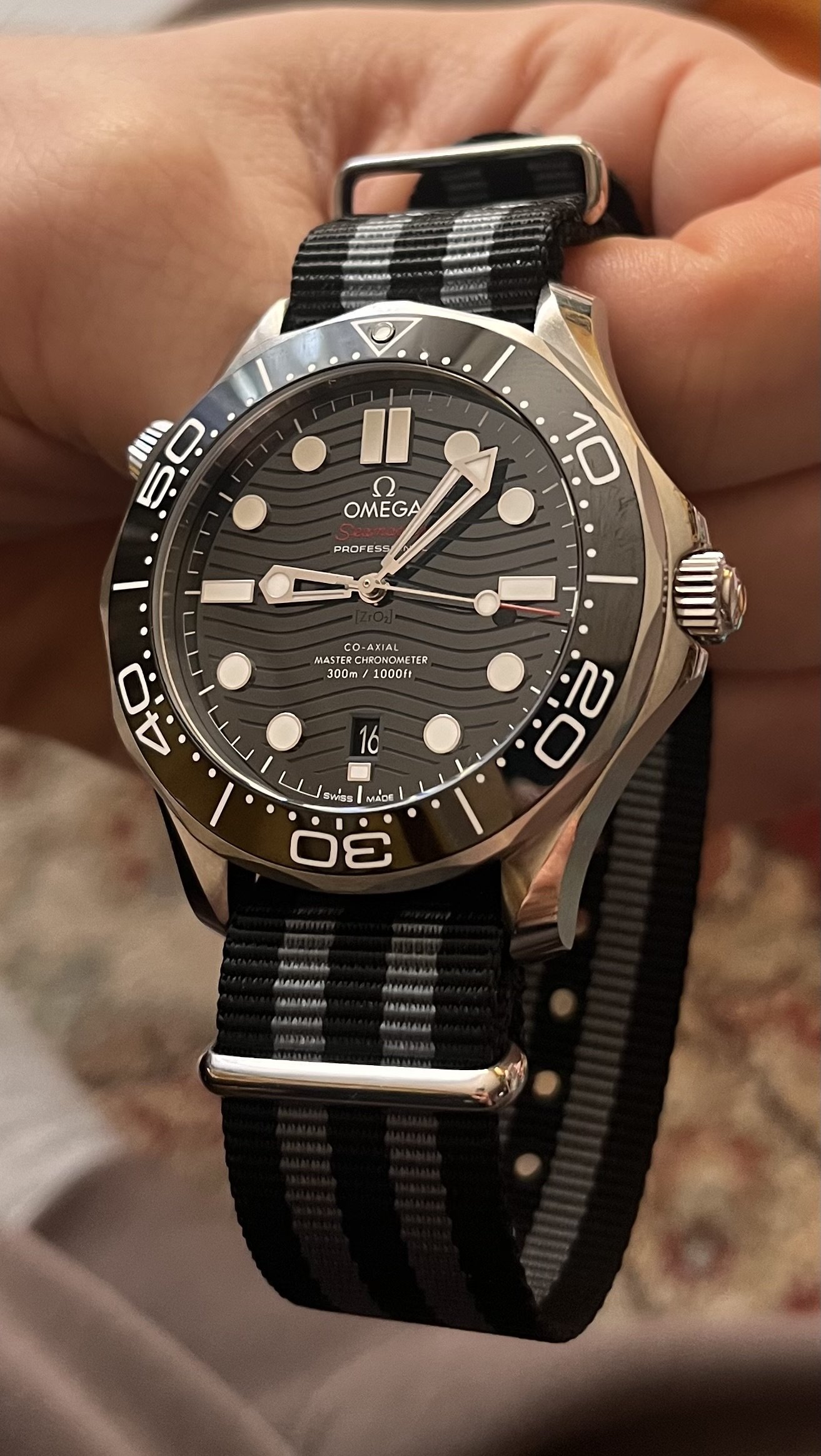

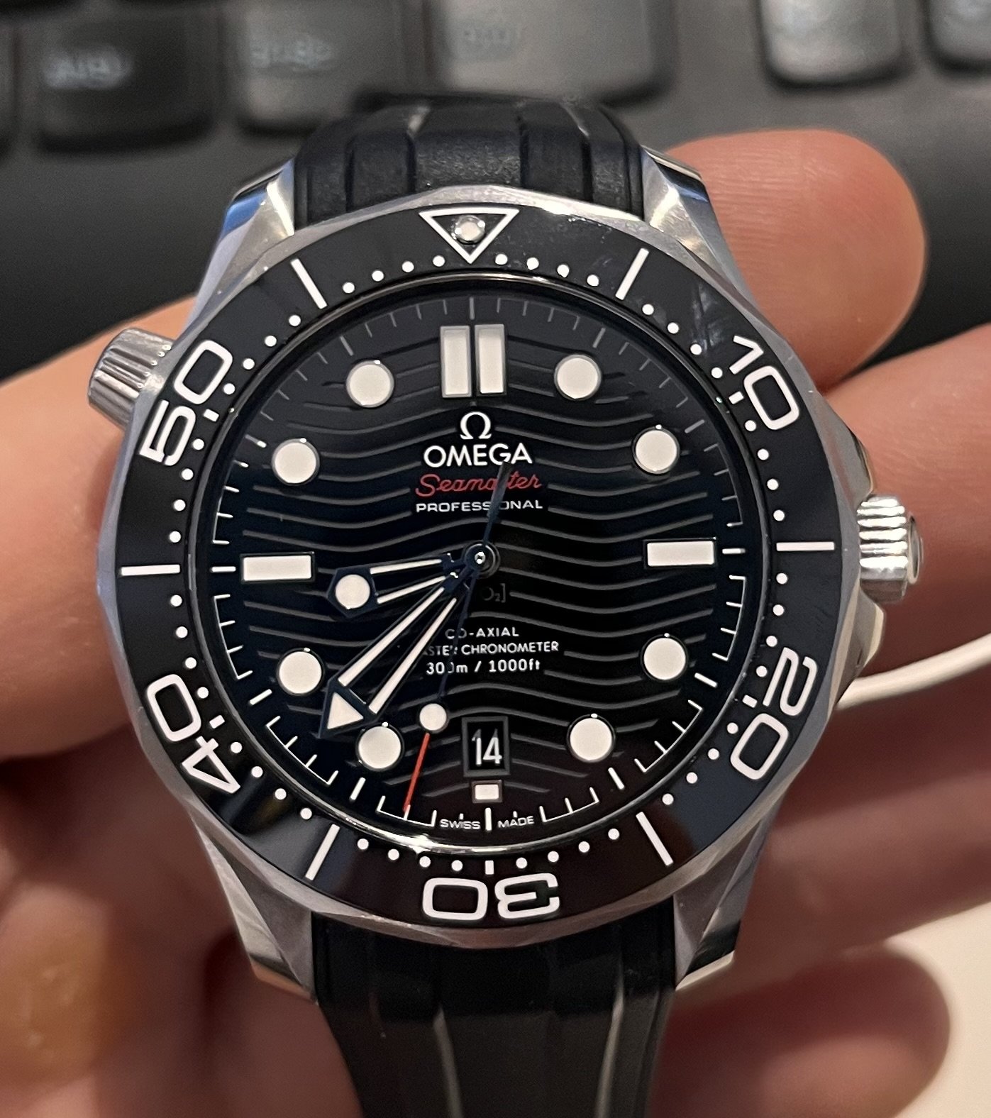

Hi guys,
its my first post on this sweet forum 😀.
I have two omega seamaster 300, one is 2019 and the second was bought 3 months ago. I called the boutique about my new watch because i noticed some changes (the lady told me my watch is 4th generation of smpc). It seems that they make bigger crown and the bezel facture engraving is a bit different (less deep). I noticed also they changed ceramic ball bearings on the rotor and put the steel one, for now its less noisy than my older model. Do someone has the same steel bearings ? I am wondering when they changed it. My serial number starts from A... so it was produced from the new production but saw some smpc with number A0-20000 with ceramic bearings.
kind regards

Sir I' ve got last question. Does the omega make a bit bigger crown and the shorter crownguards after august 2023 ? Its easier to wind it by hand and easier to screw down now than the previous version i've had.
30,292
78,209
To answer that I would need the exact reference you have...

210.32.42.20.01.001 4th gen. The crown works better on new one and it’s seems like it have a bit different placement/or different angle of crownguard. It’s easier to screw down then my previous one from 2019 year. I saw photos of summer blue diver 300 and it look very similar to it.
30,292
78,209
Well, there have been 2 difference case references for that model.
055CCZ009260, which uses crown 069STZ009292.
And...
055Z016872, which uses crown 069Z016784.
The first one above is the later case - no information on when the change was made, but there have been two different versions, so it's quite possible this has changed between your last watch and this one.

thank you for help. Mine is from the 08.2023 production (steel bearings) so that will be the answer. Serial number was A07… so it was the new production. Thank you one more time for answers and informations 😀.
Ps- can you check it exactly if I tell you whole serial number ?😀
30,292
78,209
Not sure it will tell me anything specific with regards to the case. The Omega Extranet is primarily for identifying spare parts for repair, and it assumes that I have the watch in front of me, and can simply look inside the case back to determine what case it is. I doubt the serial number would just give me one case number, but if you PM it to me, I'll try...
