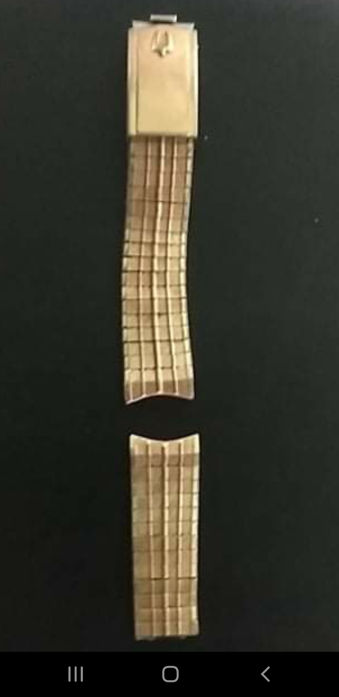

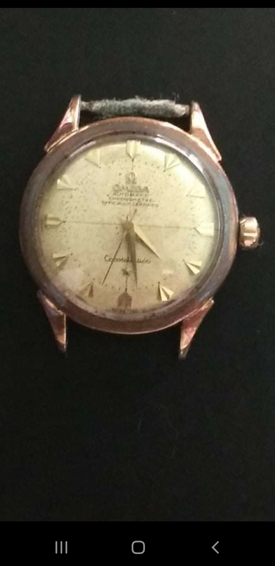

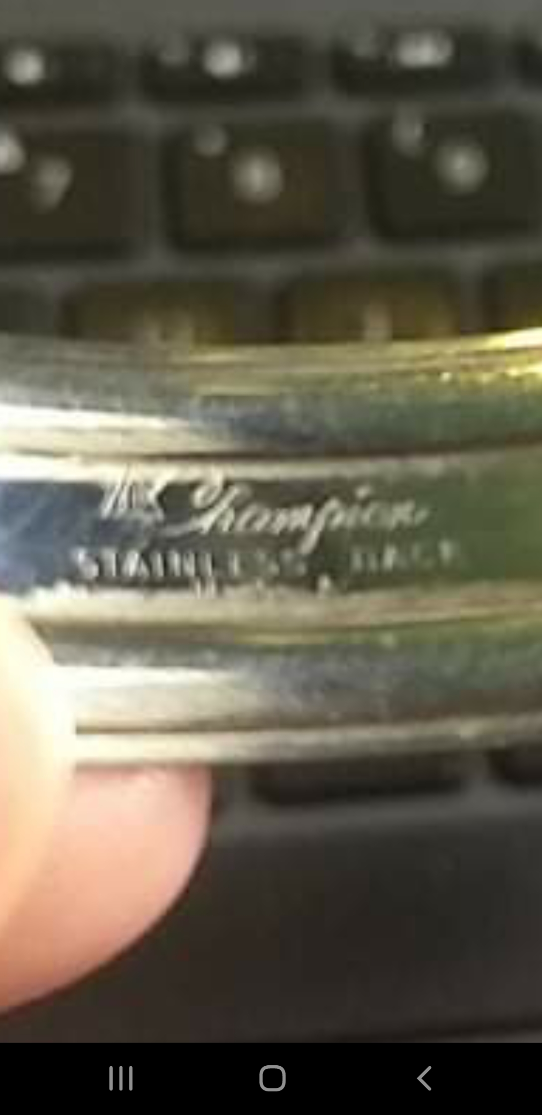

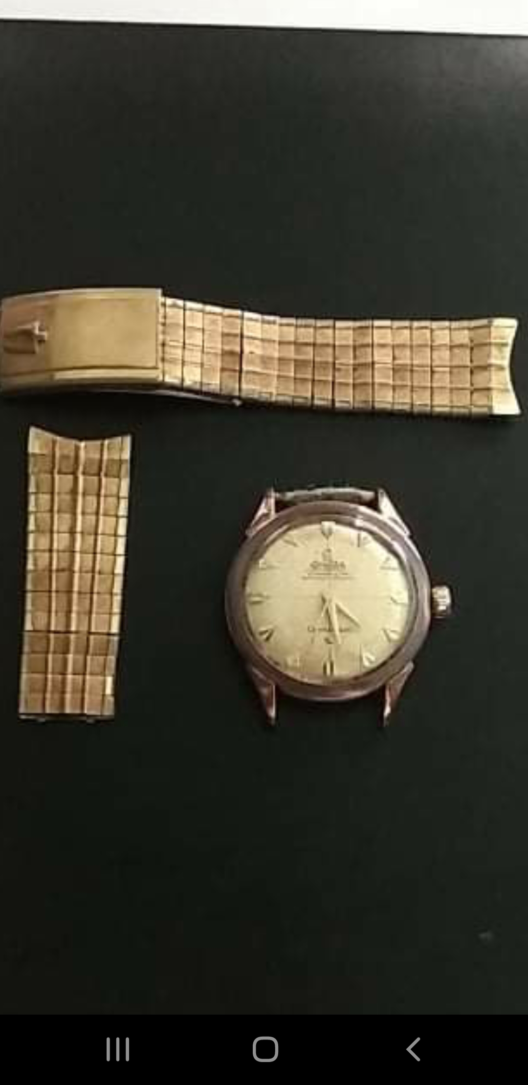

Were Champion bracelets ever offered by Omega as an accessory to the Constellations? I always thought this bracelet on my dad's watch was an Omega, and was recently surprised when my brother sent a picture of the marking inside the clasp!

First of all, that's an Accutron bracelet.
But, second, Jacoby-Bender did indeed make bracelets in the United States for Omega. I own one myself. It's co-branded.

And now- have your brother send a picture of that Connie.
16,305
45,025
Oh- and it just occurred to me that it is possible that your father’s Connie may have 18mm lugs but he just threw a 17.5mm Accutron bracelet on there because it was available- and just lived with the gap. Best to measure the lugs with a caliper to know.

It was common practise in the mid 1960s and 70s for watch manufacturers to produce (for example) brand marked buckles which would be fitted onto bracelets in the destination market. That is what I suspect happened in the case of the subject J B Champion bracelet. Domestic bracelet, imported Accutron part fitted to the domestic buckle.

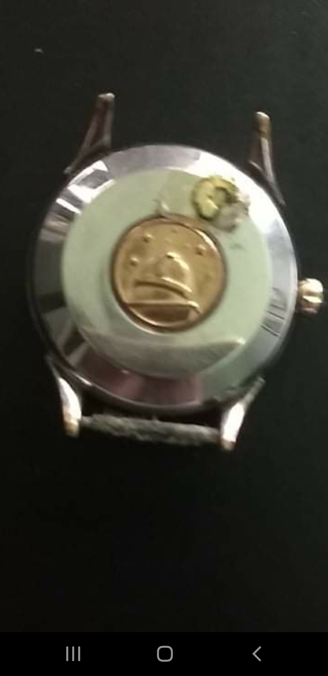

Thank you all, your comments have been much appreciated! So is it even possible that the Connie may not have the correct size lug to properly fit 18mm spring bars? Those may indeed be a pain to locate! I'm afraid that I can't count on my brother to measure the lug width correctly, considering how difficult it was for him to even get a picture of the markings inside the clasp, lol.
The watch was gifted to my dad by his father in law (my grandfather) shortly after passing the bar. I had always hoped to inherit it after he passed, and my brother located it while coming across an box containing some of my dad's personal effects during a major renovation of our ancestral home. It no longer runs, and my brother describes a rattling sound when the watch is shaken, indicating something loose inside. Needless to say, the tropical humidity has also not been kind to it, but I can't wait for things to get back to normal so I can finally get it in hand and have it repaired, running and restored!
