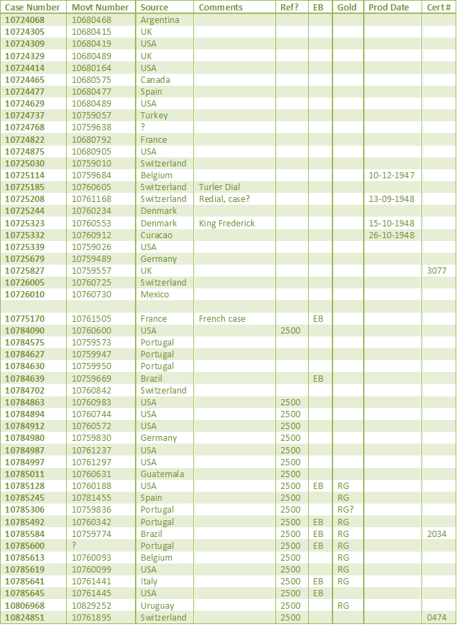

Here is the latest table update. I have added a couple of new 2500s and corrected some mistakes which crept in, despite my best efforts. There are no new revelations, but the idea of two batches of 2,000 each is still holding up.

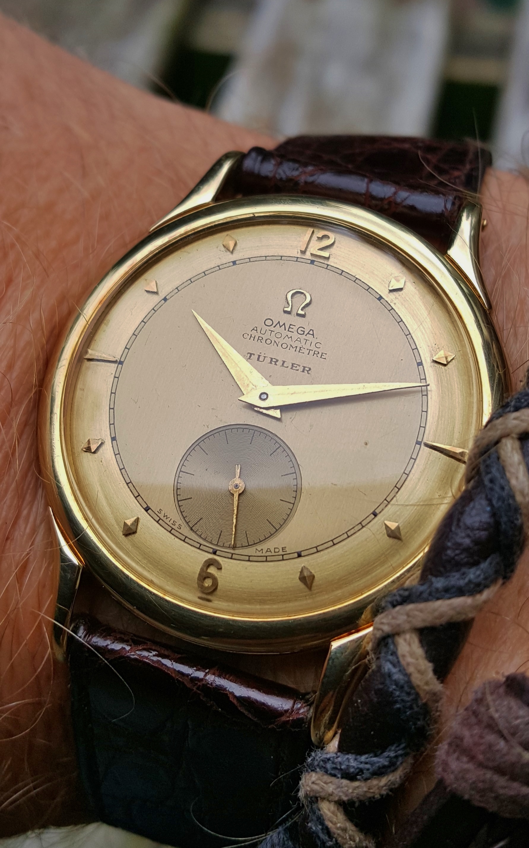

Here麓s my new arrival for the chart. It has a non engraved case back. Also it is signed Turler on the dial so I think I can safely assume that it was originally sold in Switzerland. Case number 10725185 and movement serial 10760605.
753
1,314
Really nice example. I'm going to have to wear mine again today 馃榾 Is that the first example in the table with a retailer signed dial? Interesting that they decided to mark a limited edition piece with their own signature. I wonder what % of watches Turler sold they decided to sign? Possibly all of them???

Yes - two 2500s in two weeks, which has been quite exciting. I have updated the Table accordingly and there are no surprises - both the new additions sit in the first section of my table and neither of them have the 2500 case ref engraving, as I would expect.
What I really need now are a load more Extracts from the Omega Archive giving the production dates. Then they might make more sense of the table.
Regards, John

What a beauty! That is about the sharpest bezel I have ever seen on a Centenary. It has now been added to the table, and sits in the first tranche of Centenaries which do not have the 2500 reference engraved in the caseback. Can I ask the country of origin?

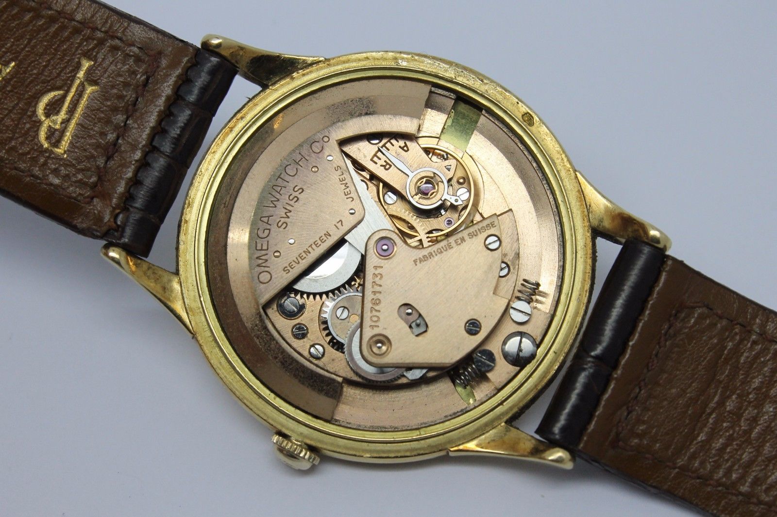

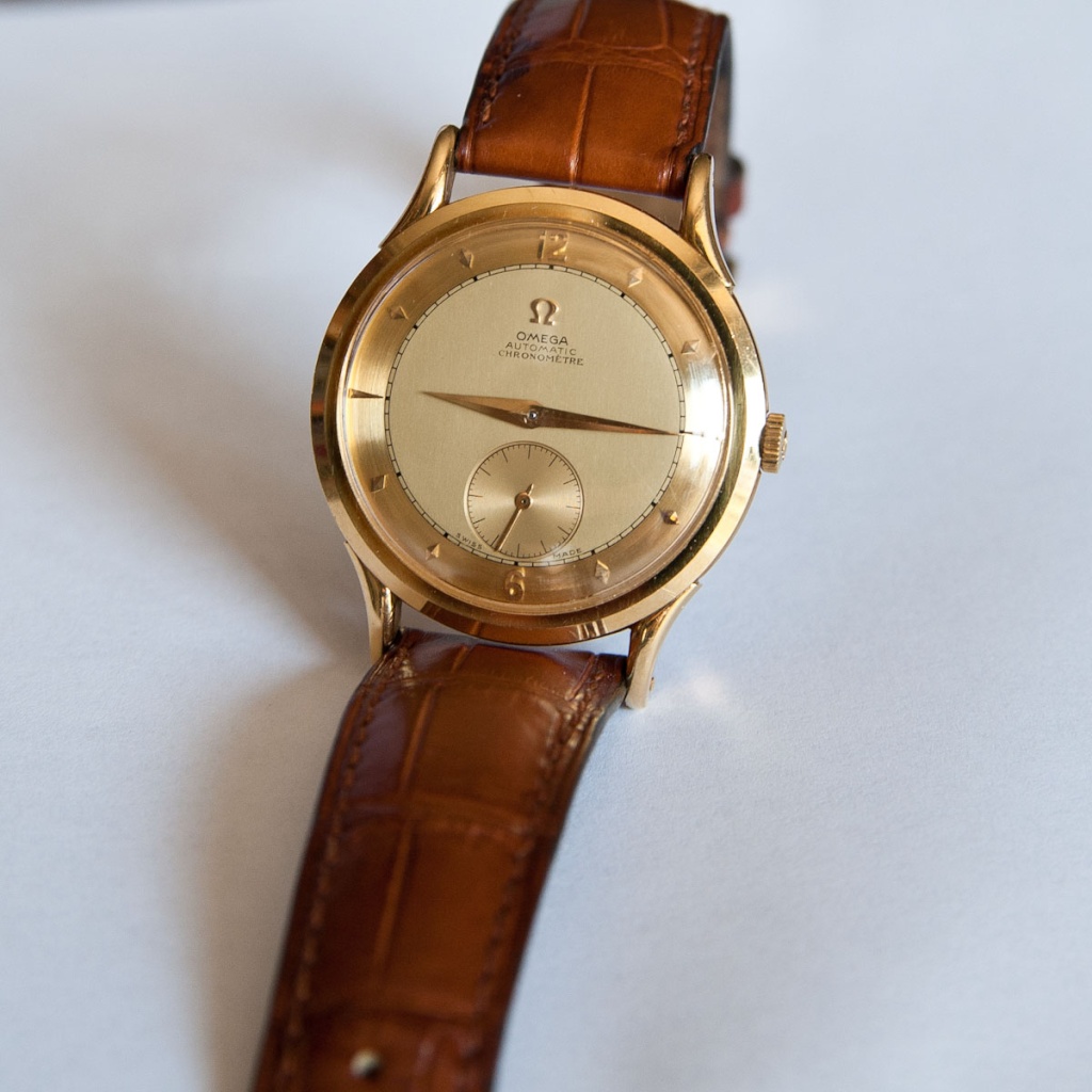

Hello - here is another to add:
Serial: 10761731
Caseback number: 10824907
French market version retailed by Hermes - see photos ...
