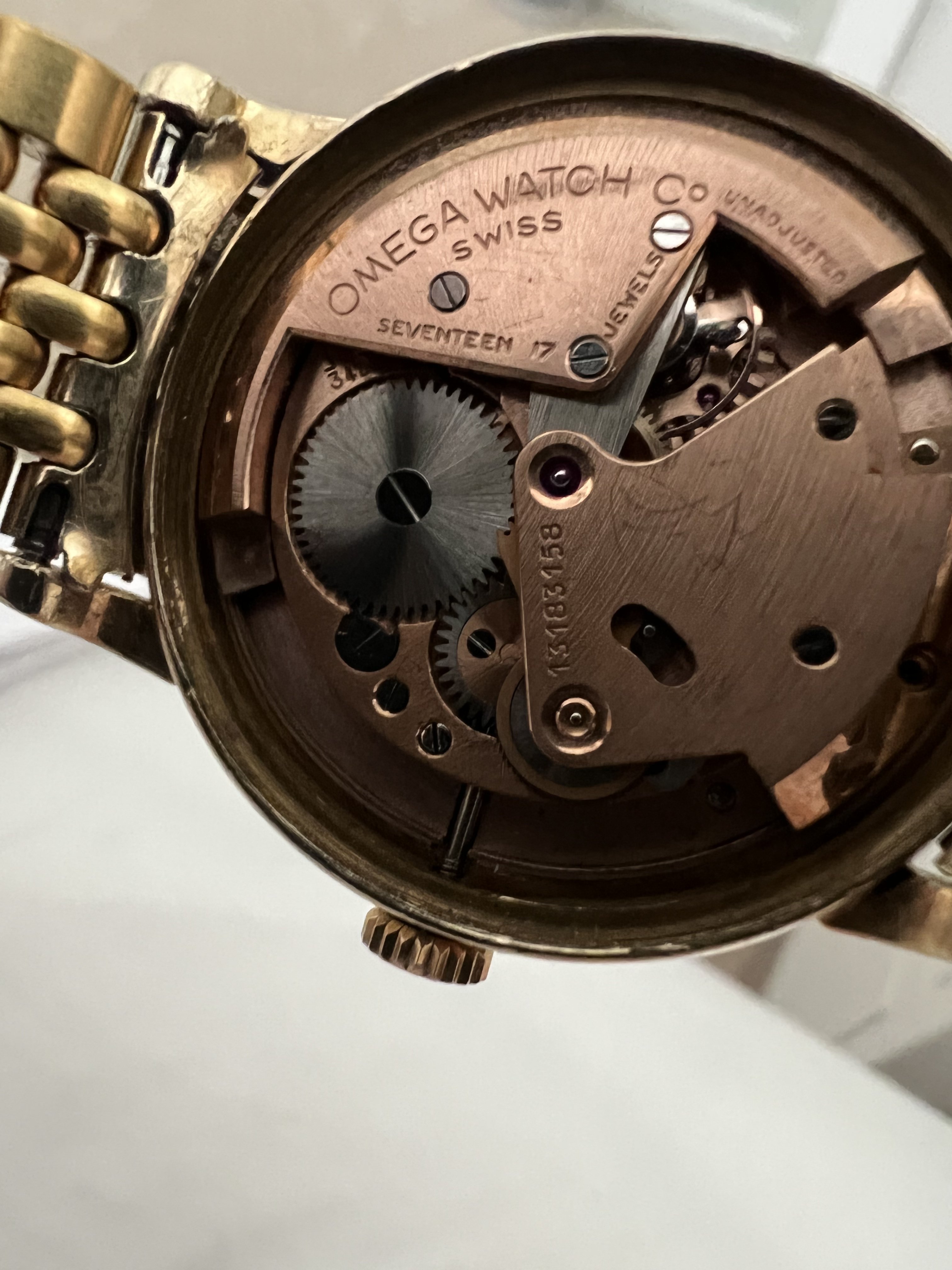

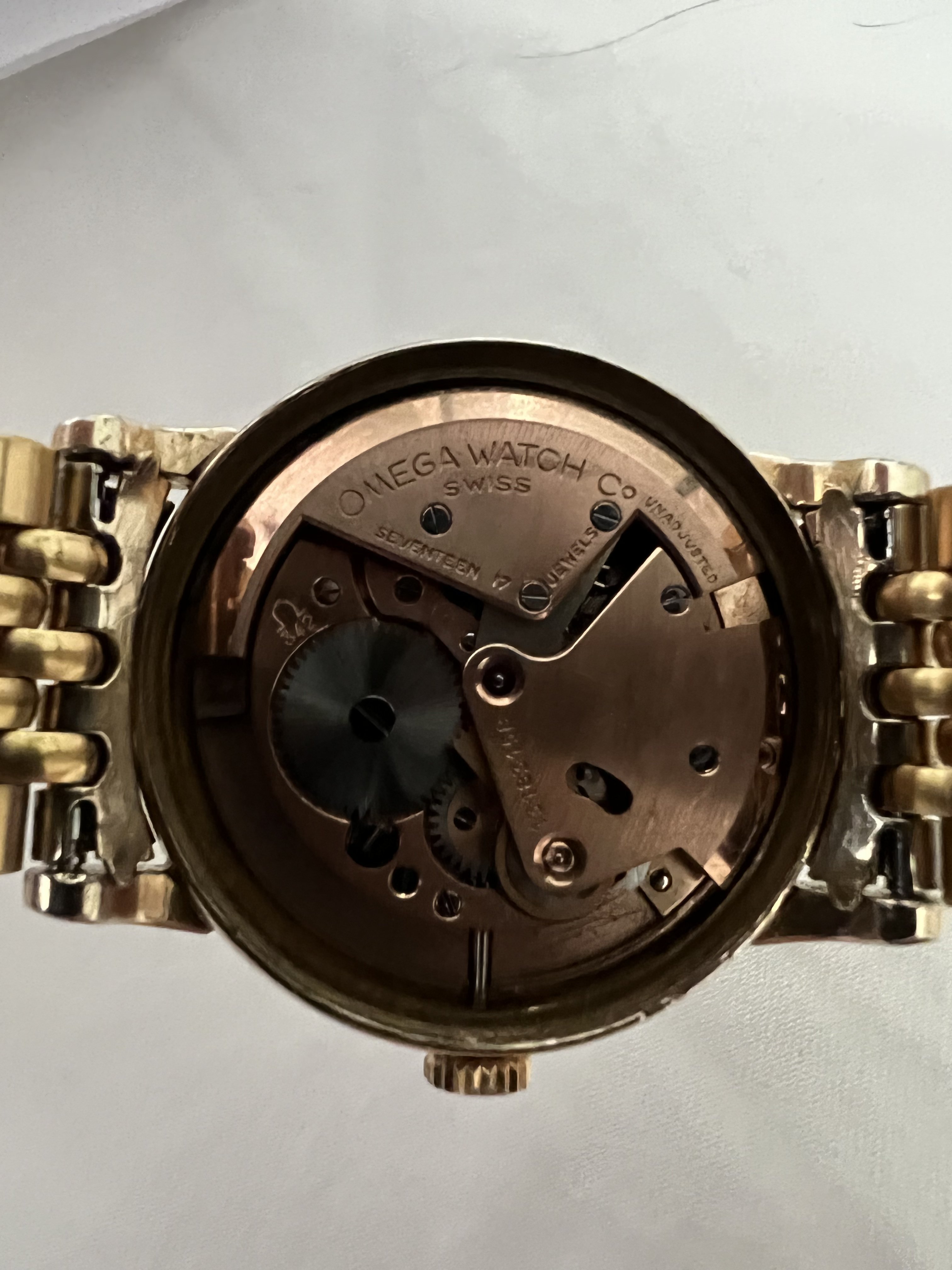

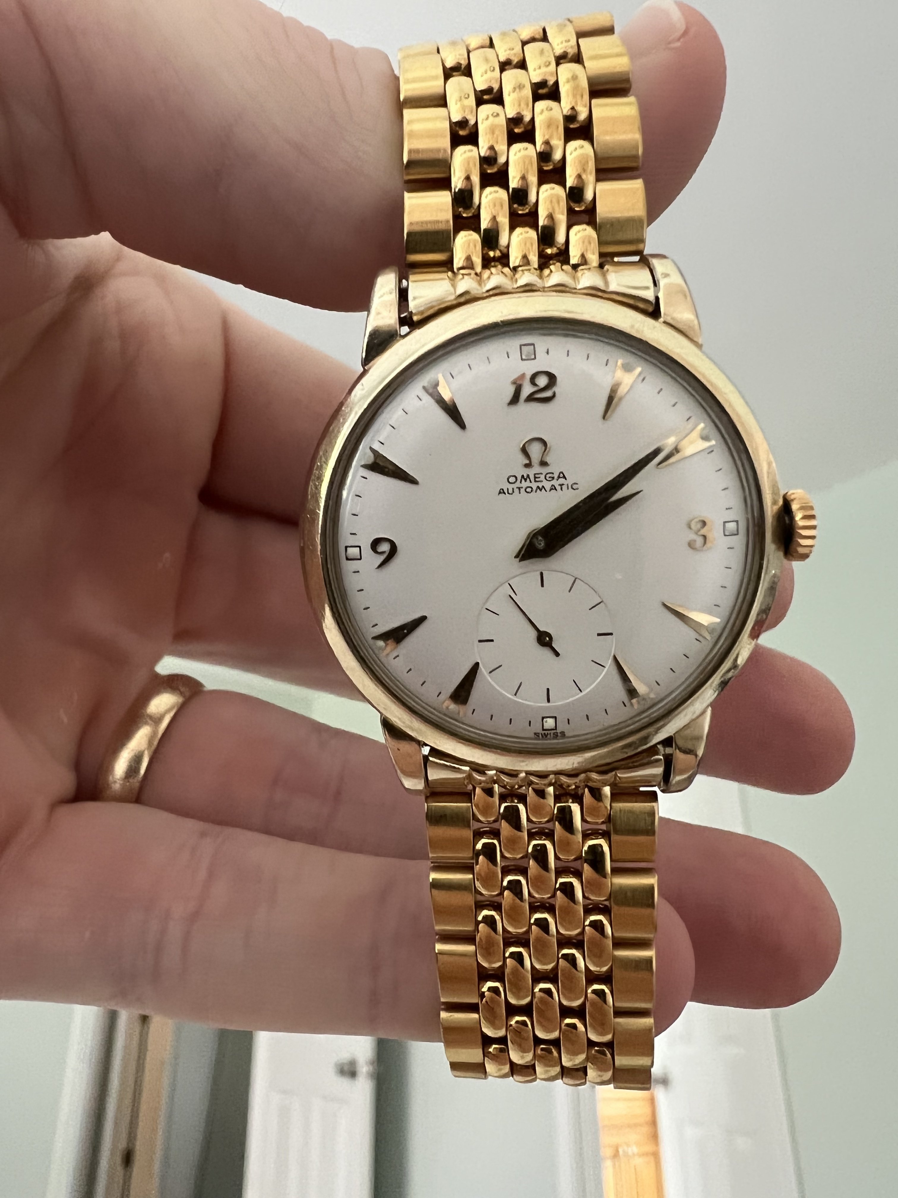

Hey everyone. First post here as I’ve been slowly developed the watch disease (obsession).
my first post is in regards to a vintage gold omega that my wife just lost the caseback on…..so I can’t figure out the model or reference number so that I can try to replace the caseback or buy a new case. Any guesses? Thanks a ton. We sent it to omega in Switzerland and they just said sorry we don’t have any replacement parts

Diameter? Any hallmarks?
I just measured. Do you measure case size by the edge of the case or dial? Case seems 31mm from edge to edge (on sides not lugs). What is an example of a hallmark? Sorry ha!
24,836
55,256
Case diameter, excluding the crown. I'm not sure the 31mm is correct since the movement should be 28.5mm, and the case looks to extend 2-3 mm further on all sides. Are you sure it's not 33-34mm?
Hallmarks would be a stamp on the case or a lug giving information about the gold content. It could tell us whether the case is 14k, 18k, etc., and perhaps whether it is a Swiss case or if the watch was cased locally in a different country.
mag yea you’re right. Seems about 33mm. I took the bracelet off, no hallmarks anywhere.
This is the closest I’ve found that makes me feel like it’s a “bumper”? Seems like there is a distinction between the normal font numbers and a cursive flair type numbers. Is it worth trying to order a caseback for a very similar looking watch and hope it can push in or would it literally need to be the identical model

Yes, it's a calibre 342 bumper automatic movement, but that doesn't tell you the reference number of the watch/case. Many models used that movement. The applied numbers on the dial are called Breguet. But again, that won't help you determine the reference of the case. You would need to focus on the details of the shape of the case/lugs. And the size.
4
thank you. I think I figured it out…. Omega bumper 2491. Think it’s worth paying for a $400-$600 watch to steal the caseback off of or try to find an alternative?

What you could also do is register for an account at
You might find a case without a movement. You don't care much about condition, just that you can steal the caseback.
And "worth it" is truly your personal decision, as it mostly is the case if you own and like the watch and plan to keep it "forever". Some ask when it's a watch they don't care about and plan to sell, that makes it a completely different discussion.
If the case is gold, I can't imagine you could possibly buy one for that price, especially given the current price of gold. Gold-filled, yes. Regardless, you would want to find one with a dial and/or movement in very poor shape, ideally not working.

Was it a snap on back or screw back?
Similar 33 mm used 3 types of backs. Screw on, snap on and two piece screw on (back with a thin ring that fits around back and screws down tight)
Once you know the type of back. You Google search Omega 33 mm Automatic bumper and look for a similar case to see the back
Or just buy a used case and maybe a used dial (yours may not work)
