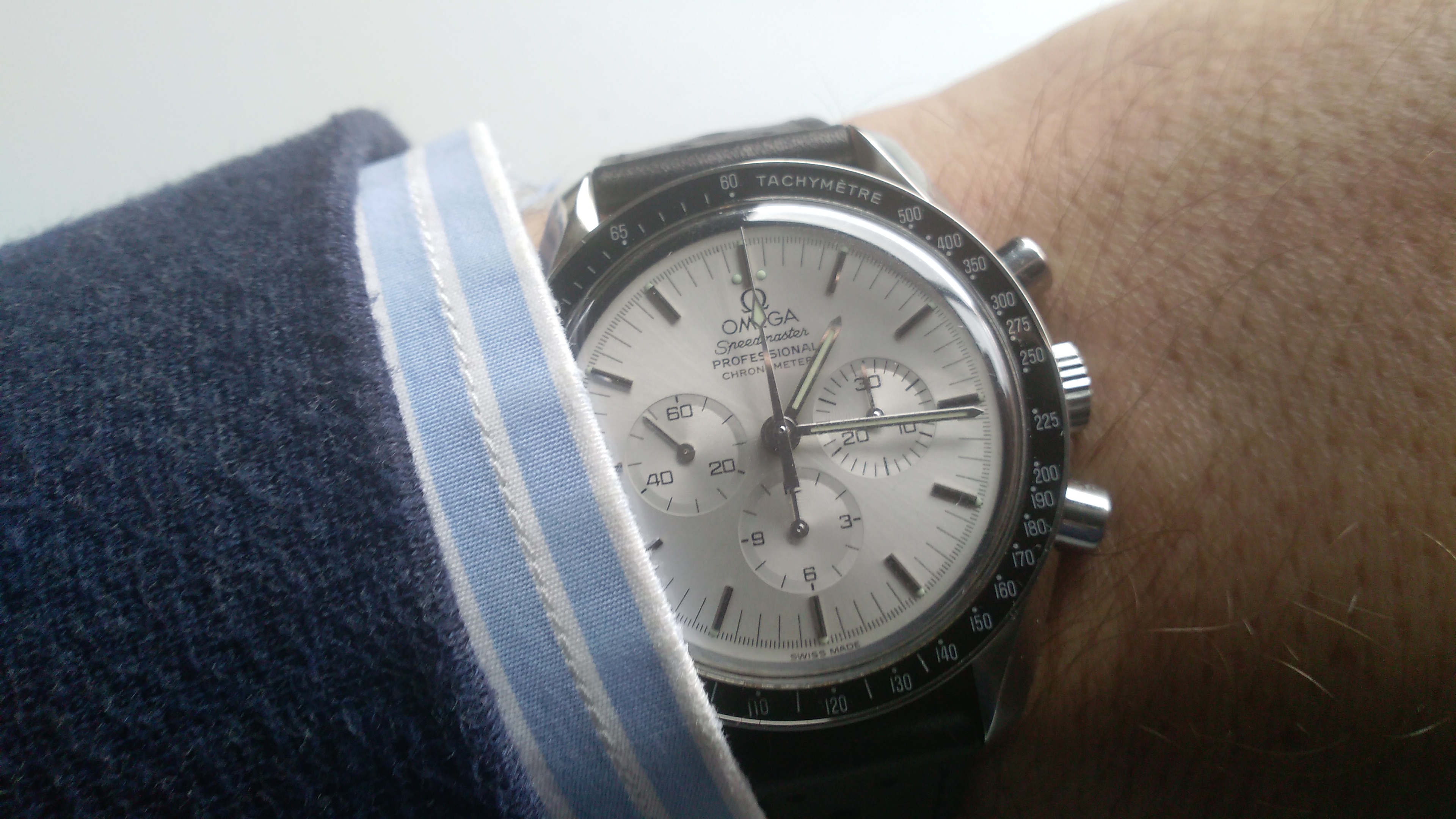

There is a model from 1994 (Apollo XI 25th Anniversary) with silver dial, very similar to the new canopus silver dial. It was also a white gold case Speedmaster, but service dials were manufactured and can be purchased in different websites. You can have some info about this model at Fratello:
https://www.fratellowatches.com/speedy-tuesday-omega-speedmaster-chronometer-white-gold/#gref
Those service silver dials and set of hands can be purchased here:
https://www.swisslimitededitions.co...nniversary-w-g-apollo-11-silver-dial-148-0062
You can always build a Speedmaster Mod taking a 1861 Speedy as a donor and changing the dial and hands.
I love mine...
407
709
I love mine...

Thank you!
This looks pretty nice.
But I guess the objective issue will be similar to modding the new speedy with the Canopus dial.
Watchmakers might not like the idea.
Thing that I understand, although I’ve seen other watches with dials swapped, just for aesthetic reasons.
Anyway, yours looks great.

Thank you! I think the most difficult task is to source the dial and the set of hands. An Omega certified watchmaker can source them directly from Omega but he wouldn't like to do the swap. One Omega certified watchmaker even told me that he understood me but he was not allowed by Omega to do these modifications. The easiest way is to buy them from these websites and then ask to a good and independent watchmaker to do the job.
