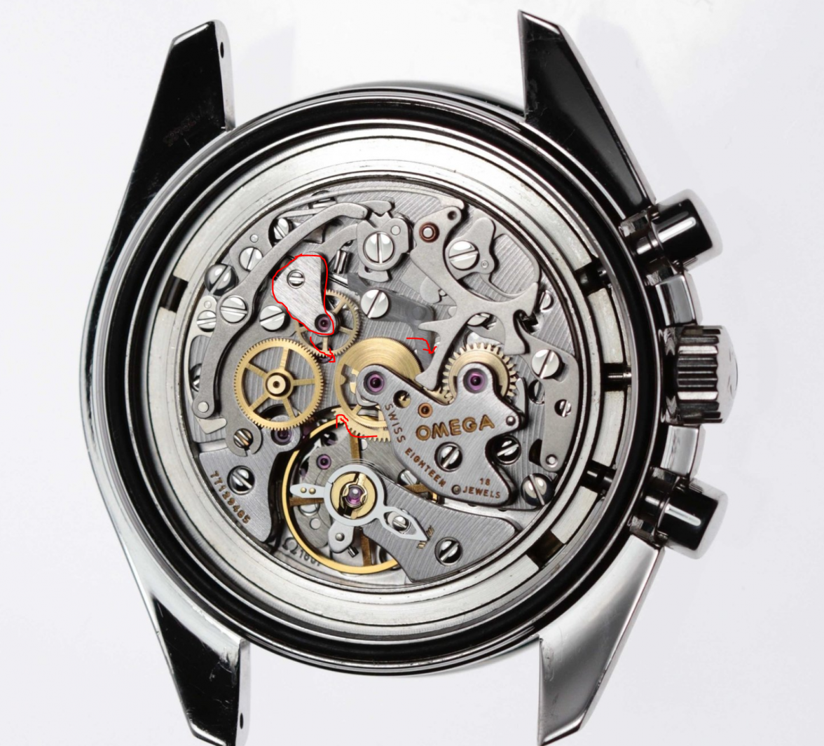

I learned from an Archer post on the difference. But basically very quickly there is horizontal and vertical clutch. Speedy 321/(1)861 are horizontal clutch because this guy moves in to engage the chrono wheel.
In vertical clutch there's a wheel that's dropped from the top to the bottom that starts to run together with another wheel that is already running all the time. Hence in vertical clutch there's no additional wheel the chrono needs to risk wearing out by engaging. In horizontal, a new wheel starts to run so there's wear.
Also in the speedy, the wheel that goes to engage is shaped a but pointy so that it can engage the chrono wheel and isn't really optimized for constantly running.
