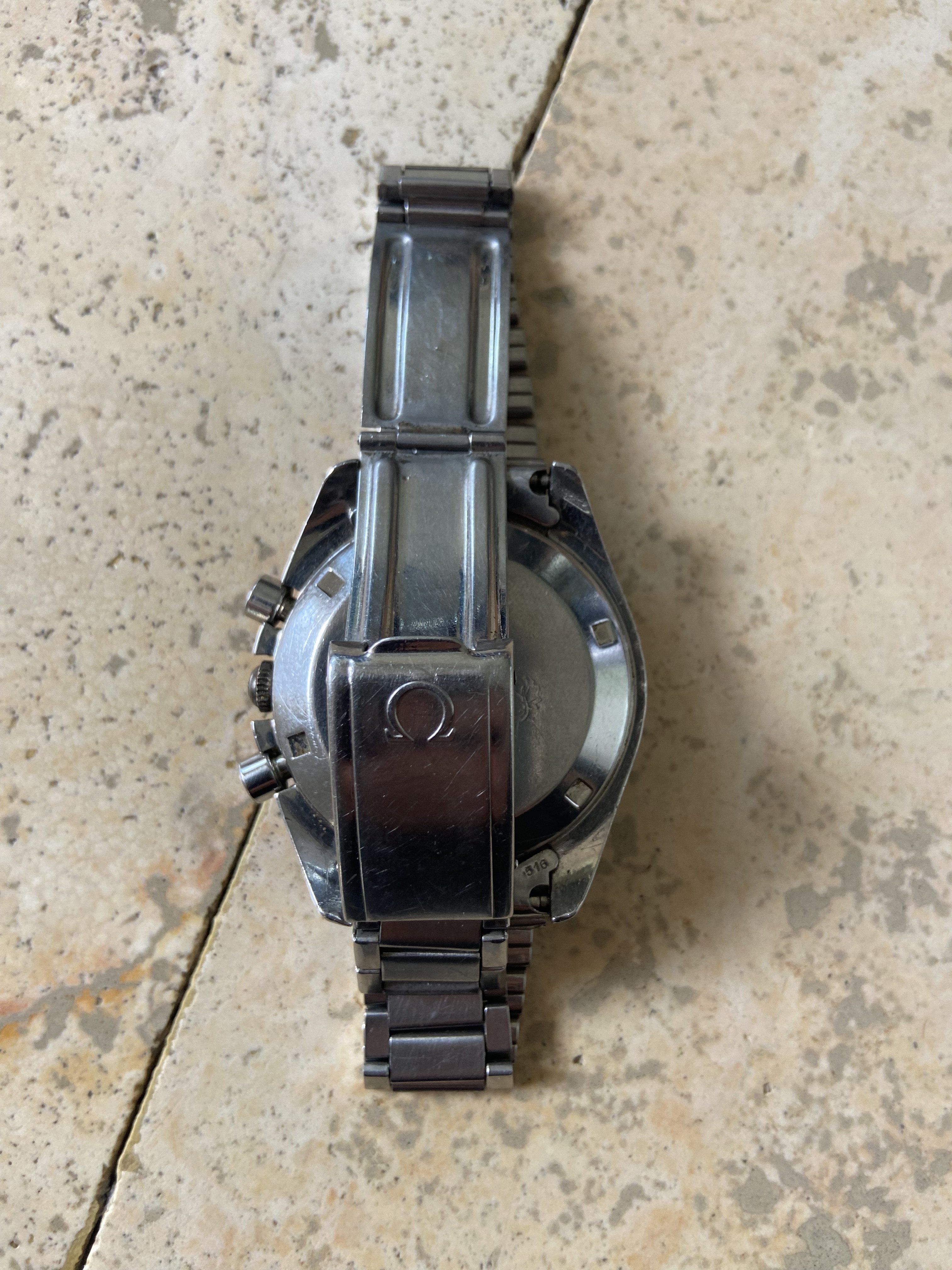

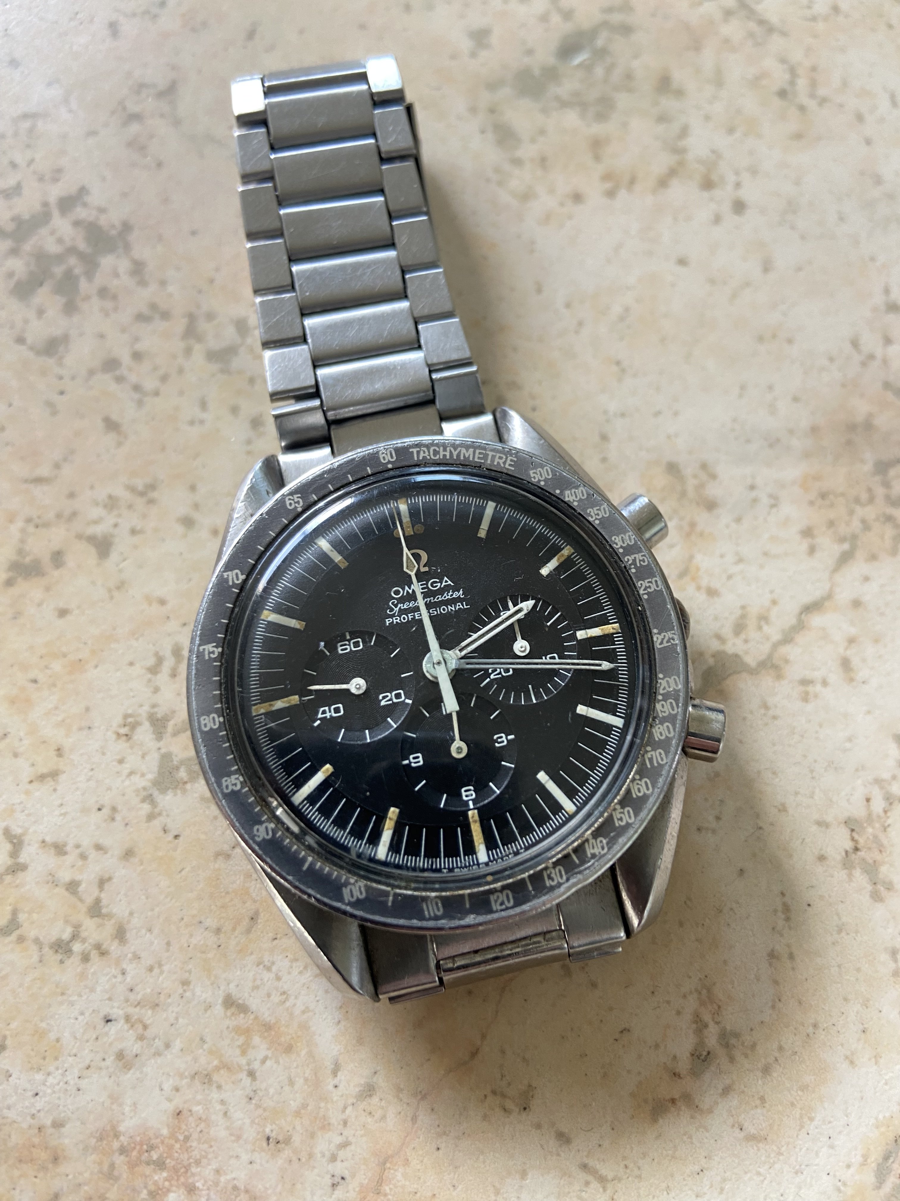

Can you help me identify this speedmaster
5
My grandfather bought it as a present for my father in Switzerland. That’s the only thing I know about it

Probably a 145.012-67. Bezel, crown and maybe some other parts have been replaced. Nice but not exactly in the best condition.

Without spending much time looking at the finer details, it’s going to be worth at least $4500. Likely a bit more.

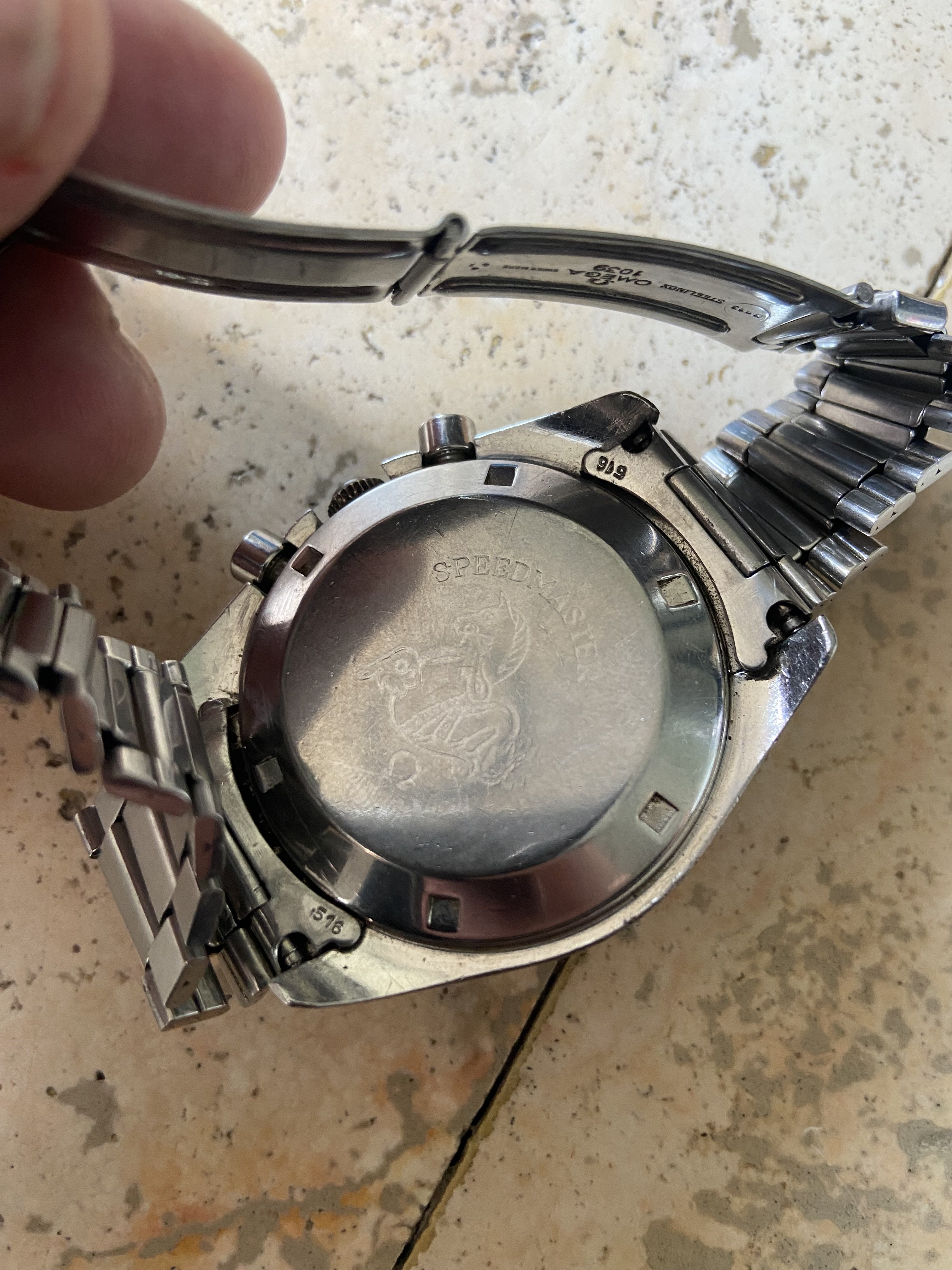

A decent watchmaker could open it up for you to see inside. If so, get a note of the caseback number, caliber number and movement number. Don't try to open it yourself, you'll just most likely damage the watch. The watch value would increase a good bit if you could find the original paperwork. If you find it, buy an Omega box and sell with that. In addition any servicing details would help. Stress to new buyer that it's been a one owner watch.

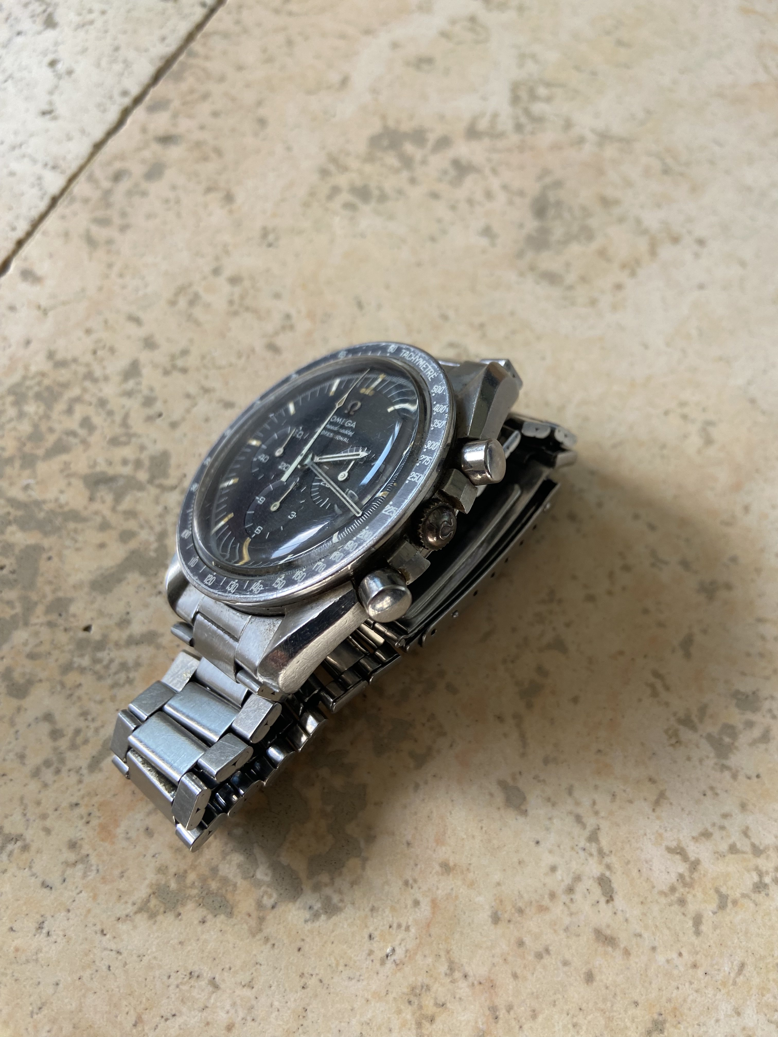

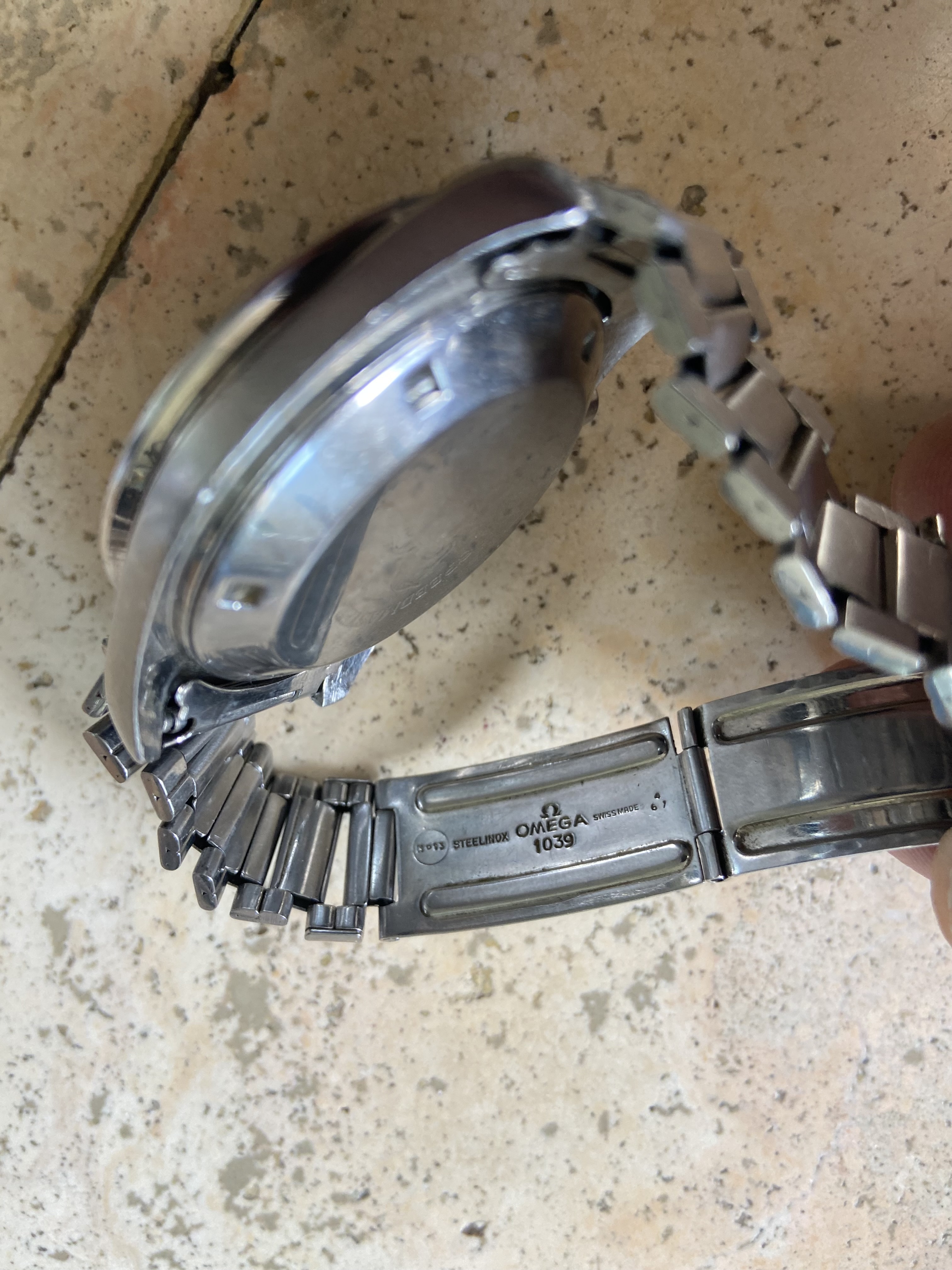

Torifer, if you go to the below link, you will see an example (a fine example), of a pristine 145.012 similar to your father's watch. You could use this as a comparator against what you have.
There are immediate differences as others here, have already pointed out, namely;
1. Bezel (that's the outer black ring), should be a base 500 DON bezel.
2. Crown (I believe should be a 7mm example??)
3. Chrono hand (Seconds), yours looks to be a service hand (I could be wrong on this as there are other examples that show the square-ended spear)??
4. As for the bracelet, with yours being 1039/516, appears to be correct for period, however just be aware that variants do exist so, it isn't fair to say yours is 'not' original in my opinion.... (others may have better advice, or in fact disagree with me??)
I tend to lean toward 'padders' suggestion of a dash 67 variety.

I also tend to lean towards it being a 145.012-67, I can even see the 67 date code on the blade of the bracelet. Interesting that so many parts were replaced on a family piece like this. Usually DON bezels were swapped out in the last decade or so because they became so valuable.

a very nice piece, I would love to have a family one like this one, a good relumge of the hands and tritium indexes with a revision, and I would wear this heritage as is afterwards
