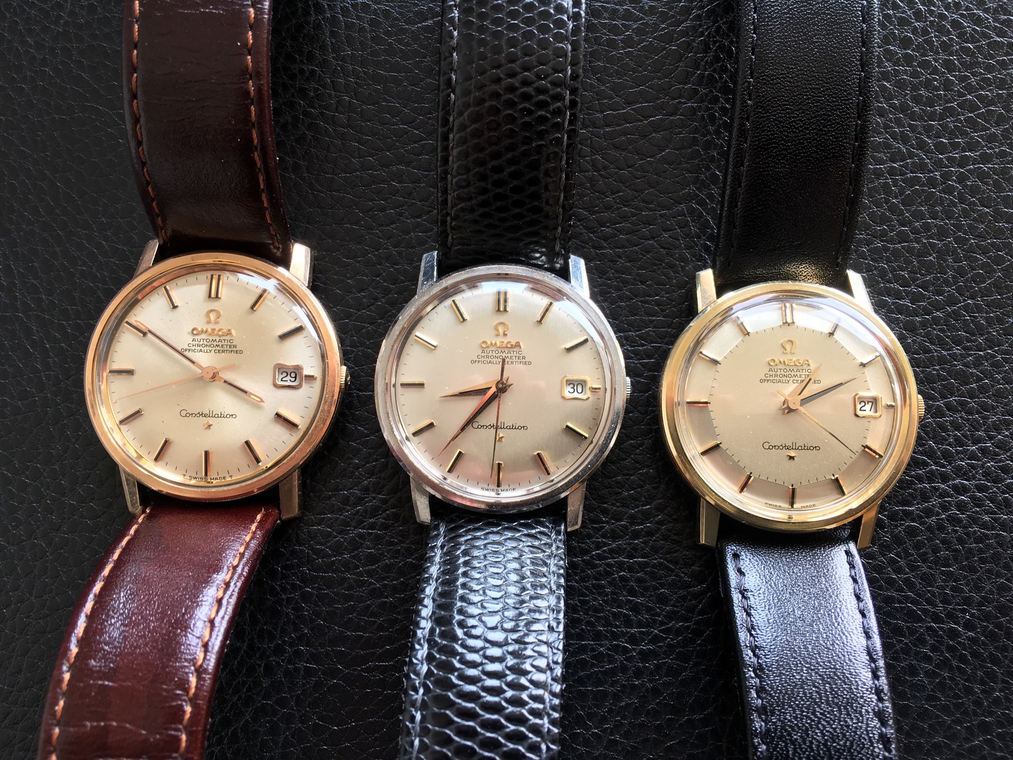

As you're buying for an enthusiast and have a budget of $1500, the top of the line in the day was the Constellation and, with careful buying, you might get one in your price range and fully serviced. If not, keep a quarter of your budget back for a service/parts and be careful as many people say their watches are serviced when there is no real proof. There are many of these so, look at some images on google to see which model appears. Look for calibre 561 watches as they are in your era (sixties) and you'll find a lot.
Oddly, this one came up fairly close to the top and I bought it many years ago so, I've used it as an example. These are dog-leg lugs, pie pan dial and are some of the most desirable - this one is a fair example but, it'll give you an idea.
Good luck and if you find anything, post some pictures here so it can be reviewed.

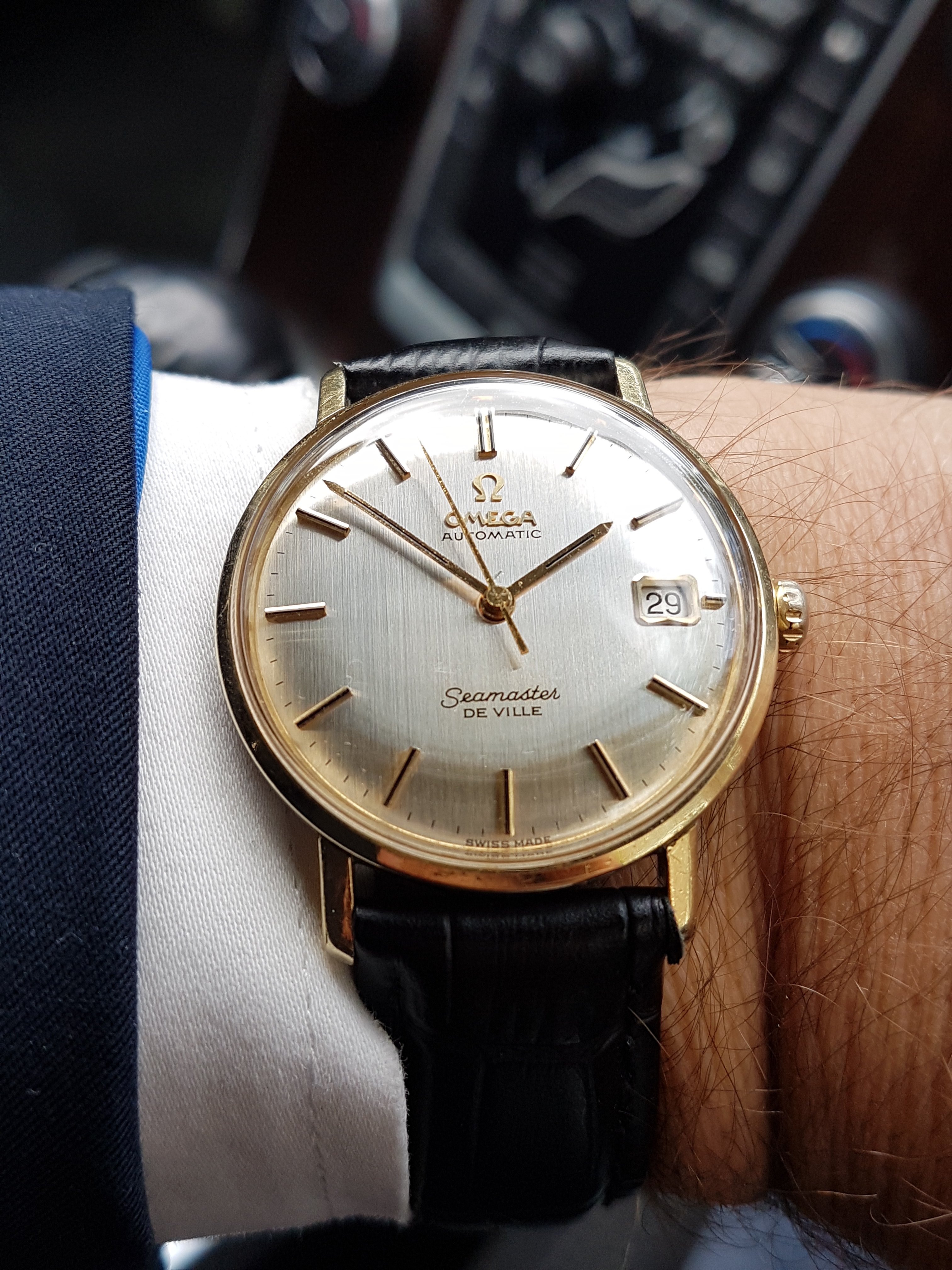

If you look at retail prices, I’m guessing ‘he’ probably thinks that a 60’s Omega costs all of your budget and more.
In the Connie line - as the De Ville is the desired style, might I also suggest the round cased 168.010 (generally with a cal 564)
As above, it may take a while to find a good one but should be available well within your budget if you don’t go the retail route.
They come in dome dial (more De Ville-like) and pie pan.

Very nice! I really like the simplicity of this one and would be perfect but am unsure about the pie-pan dial
Nice to see this thread has solidified somewhat while I've been away.
There's something that you're forgetting in this quest: you are buying this as a gift. No matter what you choose, I promise you that the recipient will prize it because of that fact. The amount of thought you are obviously putting into the watch will make it special no matter what. So, don't be too worried about ticking every box you have on your list. While I apprediate and applaud the fact that you are trying to fulfill all the requirements you think the recipient has, I can promise you that whichever watch you settle on will be perfect.
Now, to the watch itself. The De Ville range, on the whole, was the entry level watch from Omega. Seamasters (along with other tool watches) were either mid-range or tailored to a specific job. The Constellations have always been Omegas top of the range offering. Many first time buyers opt for the De Villes thinking that they will cost less than other offerings and be a great place to start before moving up to Seamasters and similar. However, when you're buying vintage, the initial cost of any piece doesn't really bear on the current value nor other considerations such as service costs.
Frankly, I would strongly suggest you look at Seamasters having read your list of requirements above. You certainly have the budget to get a good, serviced, example.
