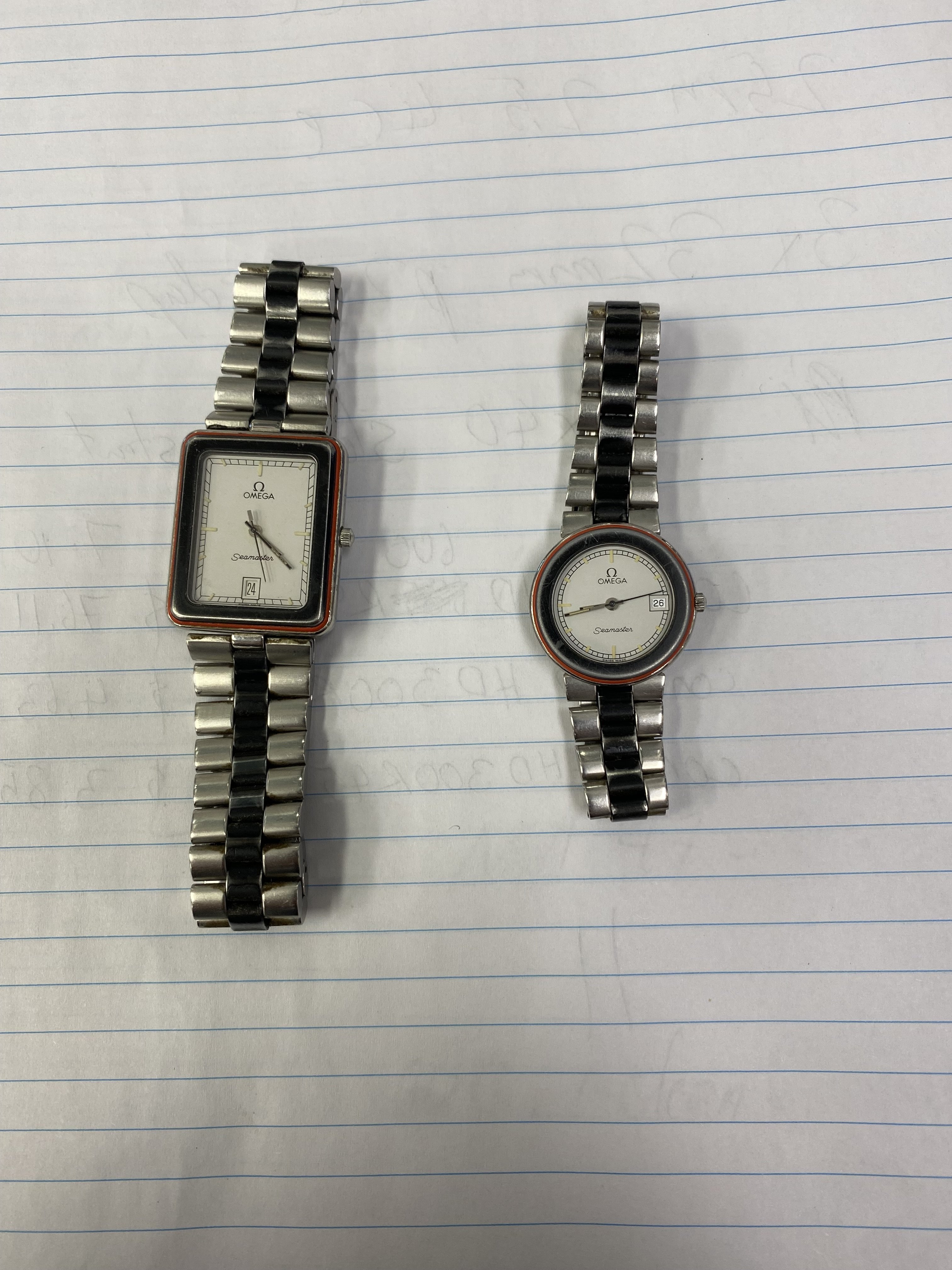

My parents left me these and have always been curious as to what they were because I could never find anything on them, can anyone help?

If genuine. Reference number on inside case back. Maybe 70's/80's models
Bought at the same time. Different cases, but similar design

I'm not convinced.....

Going to have them restored, I’m in Brisbane can anyone recommend someone?

Before you say yes. Make sure they’re real

Based on the pic I posted (no thanks for that.....) I say that they are fake anyway...

they were verified at the dealer but thanks for the input

So what are the references? As in: share the info you got…

These are ‘80s models. I lived near Canal St in the late 80s-2018 and have never seen a fake of an obscure 80s Omega.

my parents bought them on the way to the olympics 1984 so that would make sense, I opened the back of them and it had serial numbers that didn’t make any sense so never really looked anymore into it unfortunately. would have been good to know

They are real, i love seeing pairs like this, but know that in auctions they fetch $400 ish as a pair
So maybe the logical thing to do is to just get new batteries for them, as they are Quartz

They're both real, Omega issued many "His'n'Hers" combinations.
They are from a low point in Omega history, although the quartz movements were high quality, the rest of the watch was of a lesser standard than models from earlier times.
The gents watch is a reference 396.1004, just a plain Seamaster Quartz, so it's a bit disingenuous of TWD to advertise it as a Mariner.
The asking price is also ambitious for a well used quartz watch from the 1980s.

hey Jim I really appreciate the feedback and helpful information!
Also not taking such a condescending approach like the few 1 or 2 people who decided to put there opinion in
