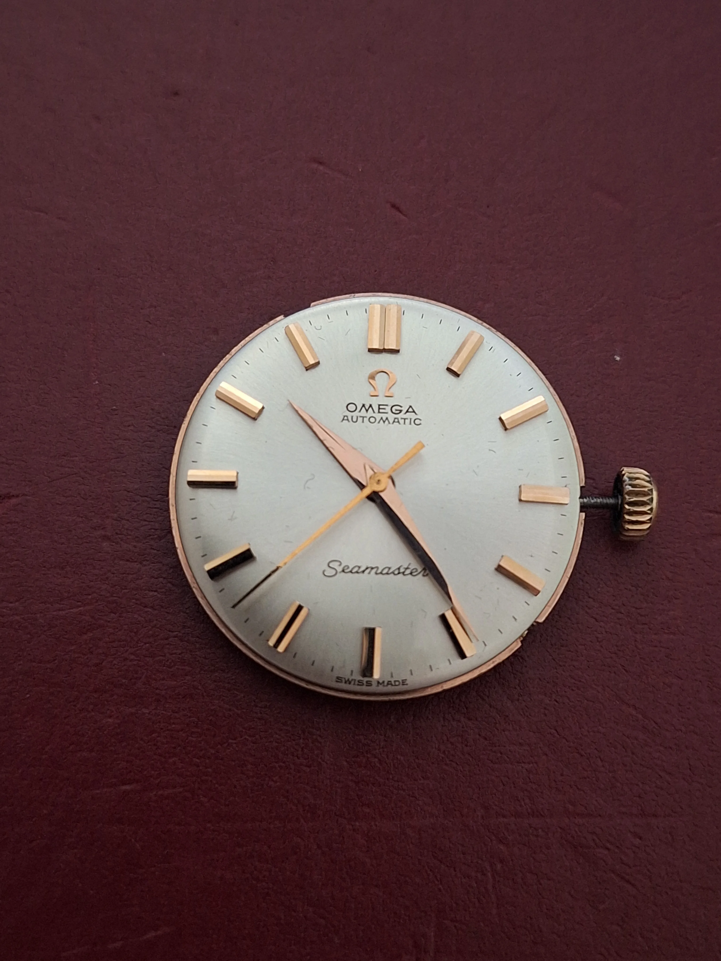

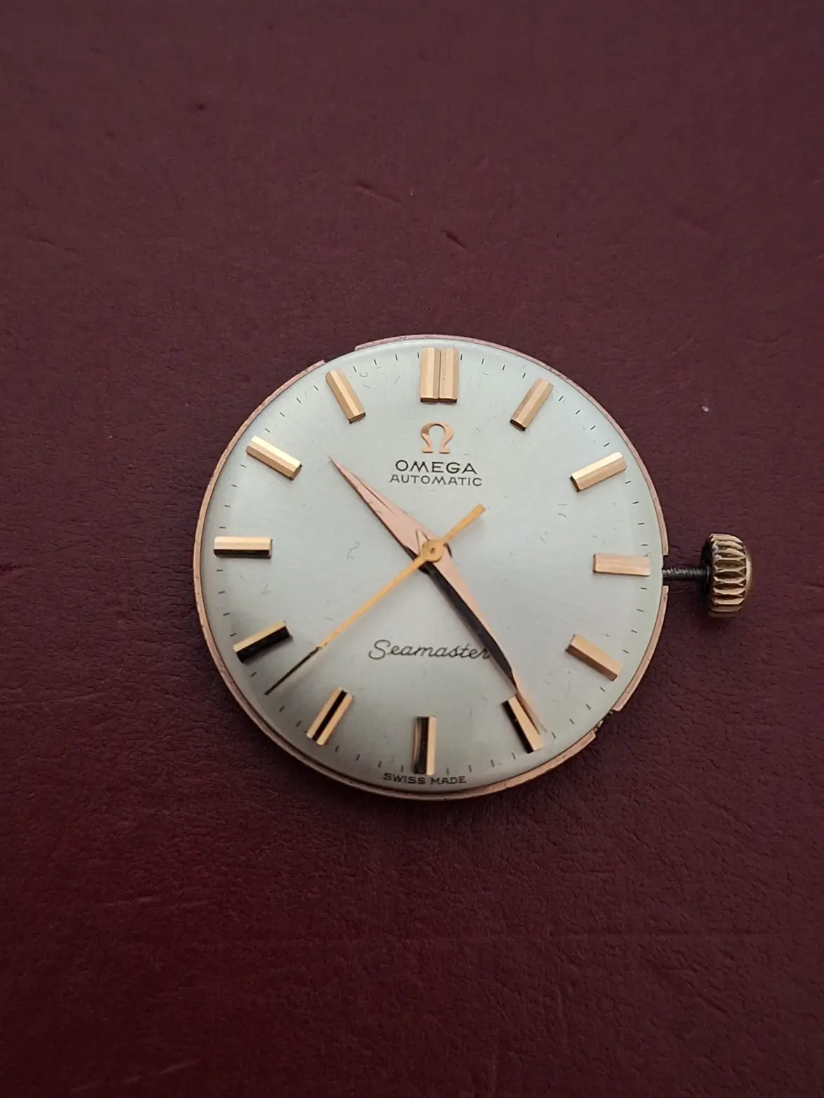

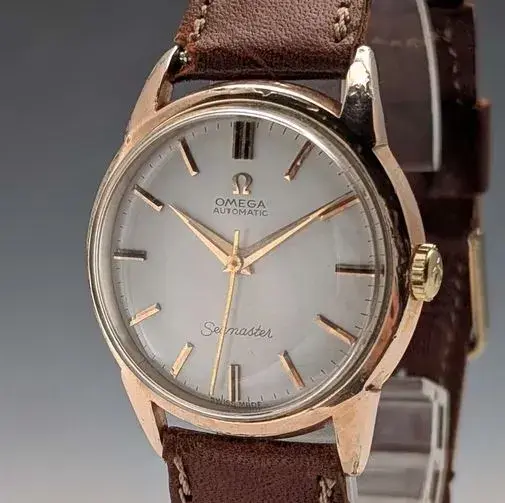

I bought this 552 movement ages ago as a donor for parts for my 1967 Seamaster 300. Never needed any so it is intact.
With a rather nice dial and rose gold baton markers and hands. Obviously a Seamaster.. I can read the dial. But can anyone point me to the particular reference?
Many thanks in Advance.

Hi!

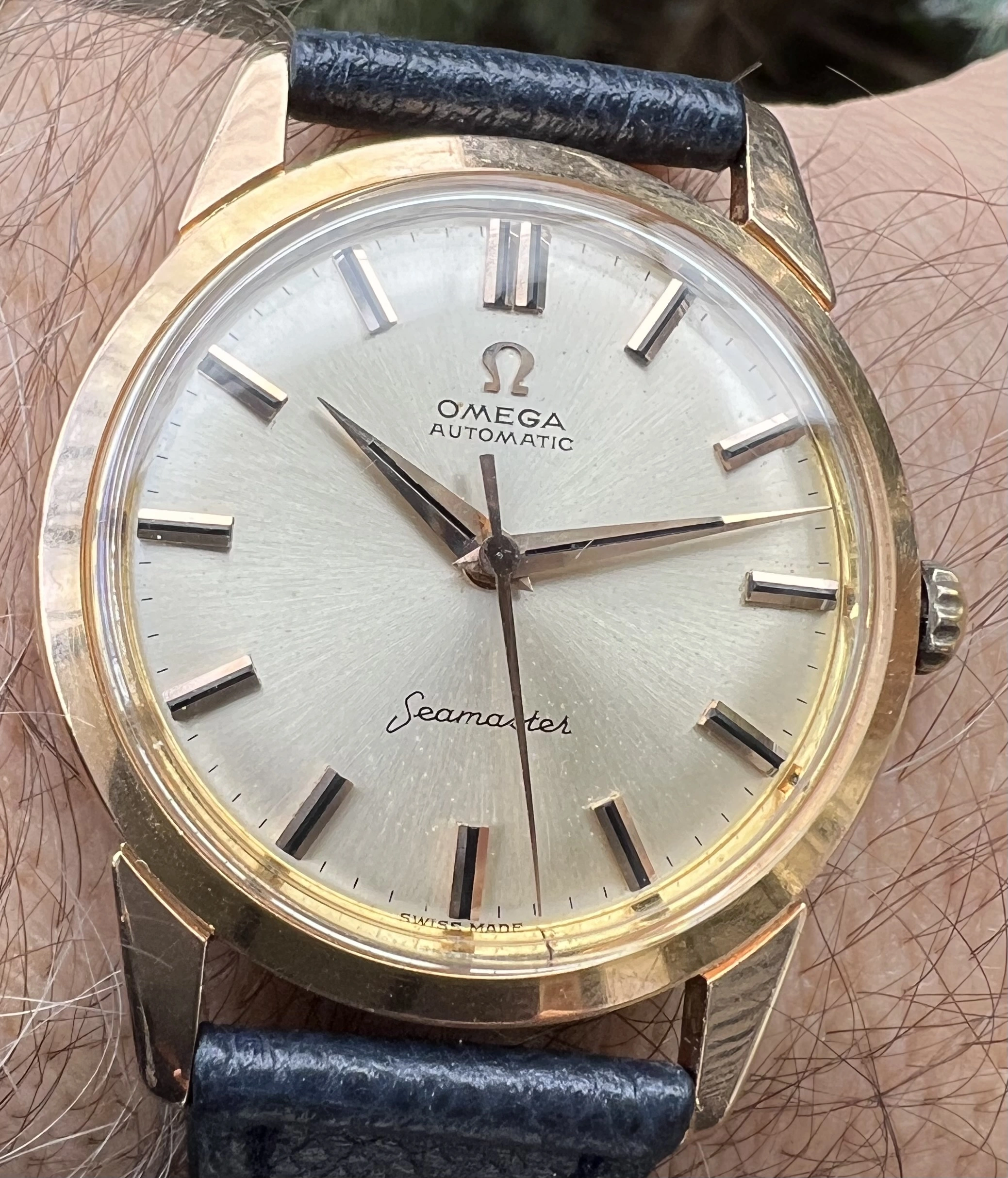

To me it looks like the reference 14704-3 as in this example.
Or maybe a similar variant of that.
What do you think?
What do you think?
Thanks, Looks like it might be the one, is that rose gold?
17
3
to be honest I don't know. Just found the picture via google lens search - although, the hands look a bit off and the crown is different.

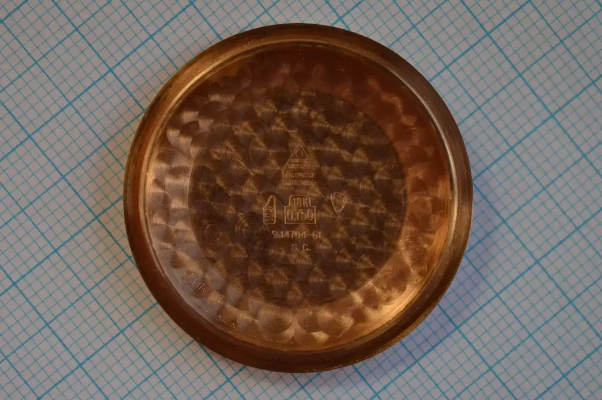

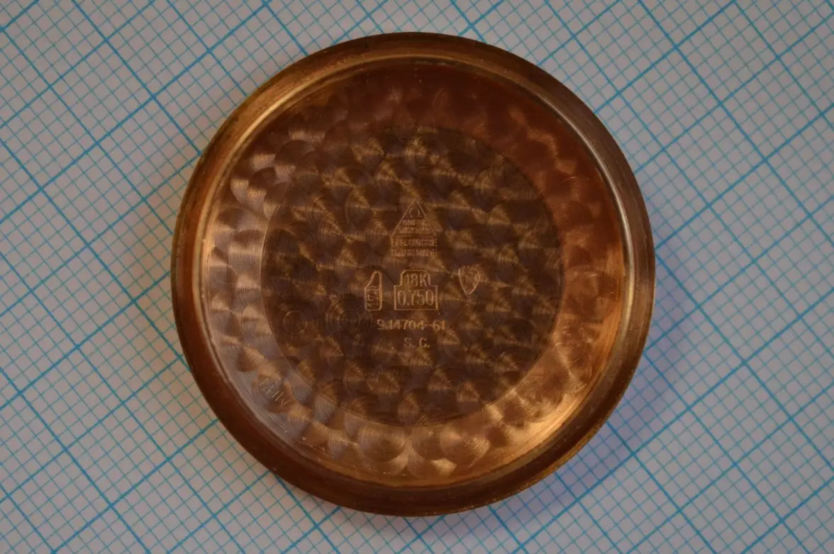

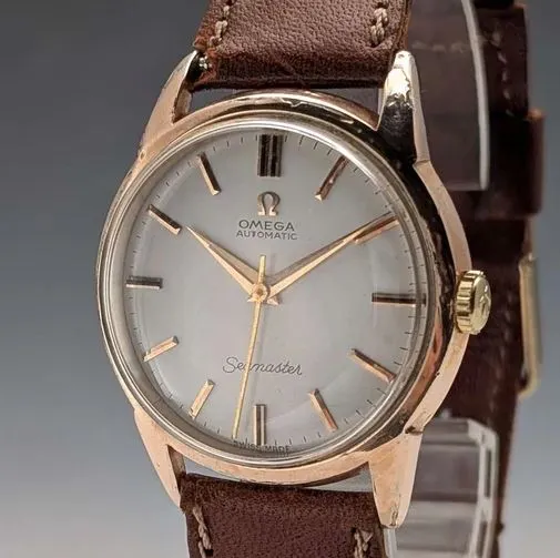

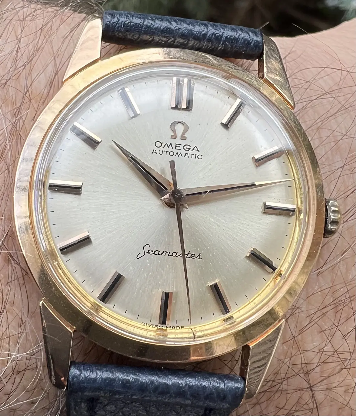

Here’s a 18k rose gold 14704-61 looks similar but they made so many different dials for many references. Movement cal 552.
The case for yours likely was scrapped 😢
You need exact dial measurements to be sure.
Probability of finding case would be very low.
