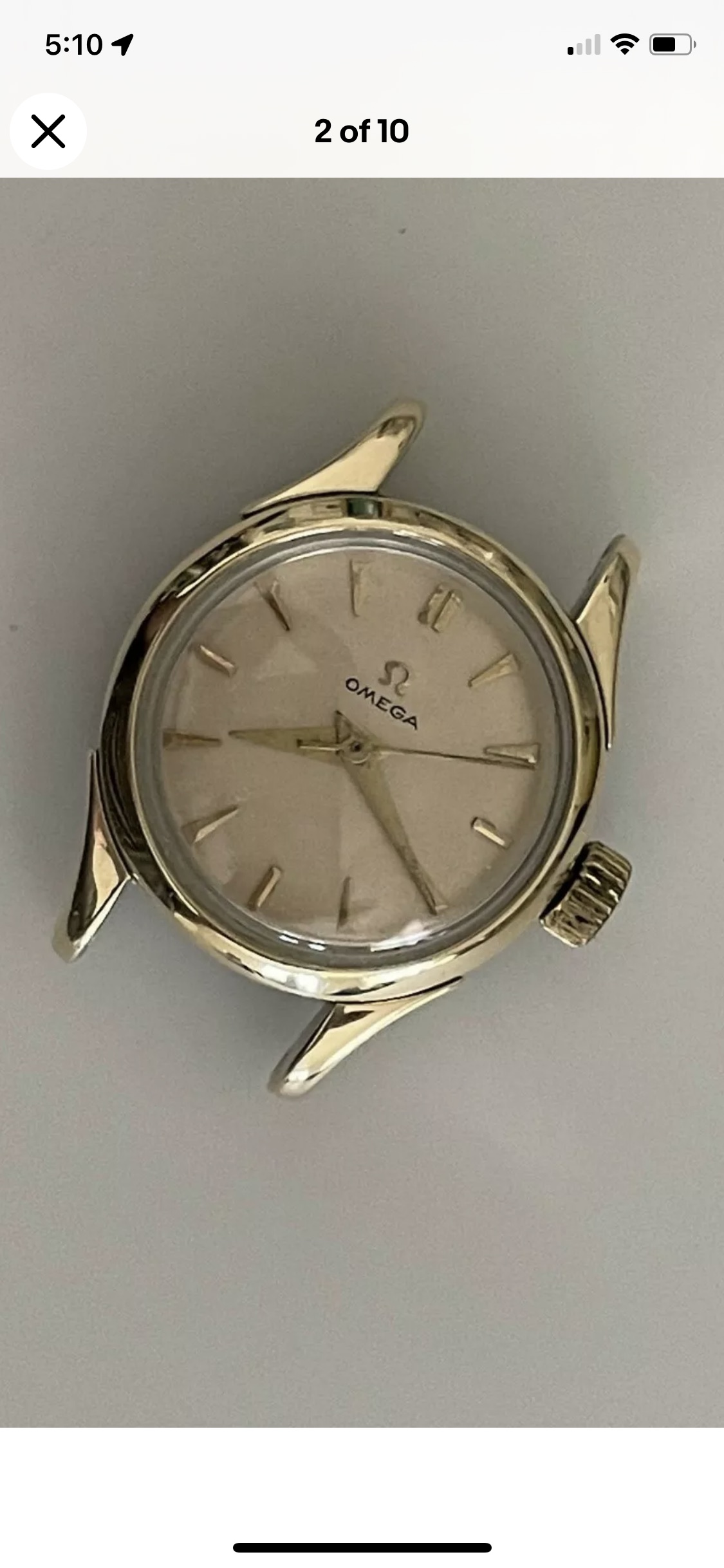

Can anyone identify this watch
6
I purchased this vintage ladies Omega cal. 252 but cannot identity the model. Any help would be appreciated. Thanks.

Is it the angle of the photo or is that the largest crown that I've ever seen on an Omega watch?

There reference will probably be inside the case-back if you have it opened.

I think it’s a non Omega replacement crown. Going to replace it with an original if I can find one.

I've found that the crowns on ladies watches seem bigger in proportion compared to the men's references. It's one of the visual cues I use when deciding if the seller actually listed the size correctly 😁

It doesn’t have the Omega logo on it and looks a little bit off in shade of gold compared to the case. I’m just trying to figure out what model it is. I’ve been unsuccessful even with the case back reference numbers.

The numbers on the case back are as follows
2696-27SC
2572
Sounds like a dual reference case-back. Since the OP watch has center seconds, it is likely a ref. 2696.

Thanks. I appreciate the info.
