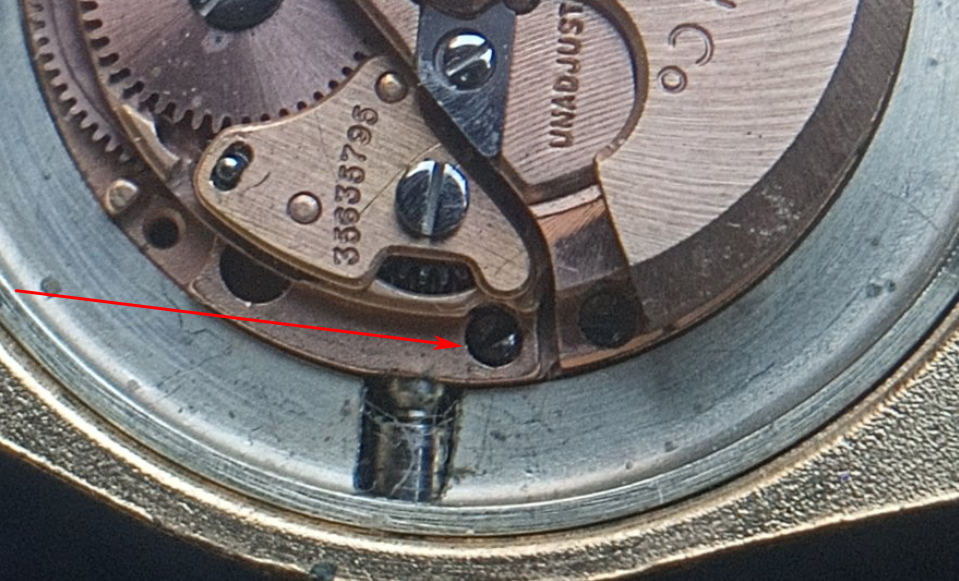

Thank you everyone for your help,information and suggestion. Your advice gave me a starting point of what to look for. Along with that and reading a couple of articles on movements I was able to find the problem and fix. My watch works great and is keeping perfect time!!!

Ope never worked on one. I am very careful when I open one. I just read up on how they work to try and pinpoint a no thing and noticed if I held it over my head with the back off the half circle part was making it stop whenever it swung around to the wheel. So I took an extra soft baby tooth brush and very lightly gave it a brush in case there was any dirt then took a toothpick and dipped it in some 3-in-one oil and lightly applied. Then manually swung the half circle around a few times to disperse the oil and wa-la it works!!
25
3
Would have been easier if I could have figure out how to remove the stem so I could take it out of the case. Still looking for that info
You've got spunk!
So the rotor was interfering with the balance wheel, or perhaps some debris between the two. Where did you apply the oil?
That was my interpretation also. Not sure this will be a long-term solution, but no harm in trying.
Under the half circle
Under the half circle( sorry the rotor? Half circle is stuck in my head lol) just a teeny tiny bit then moved it around to oil all of it a bit. 3-in-onea awsome..it's like the franks red hot of lubricants..I put that s**@# on everything
The rotor rotates around the center axle, but does not touch anything underneath it, so there is no reason to put oil under it. That oil can't do any good, unfortunately. However, the rotor isn't necessary for the movement to run, so hopefully things will keep going for a while, even if you need to wind manually.
