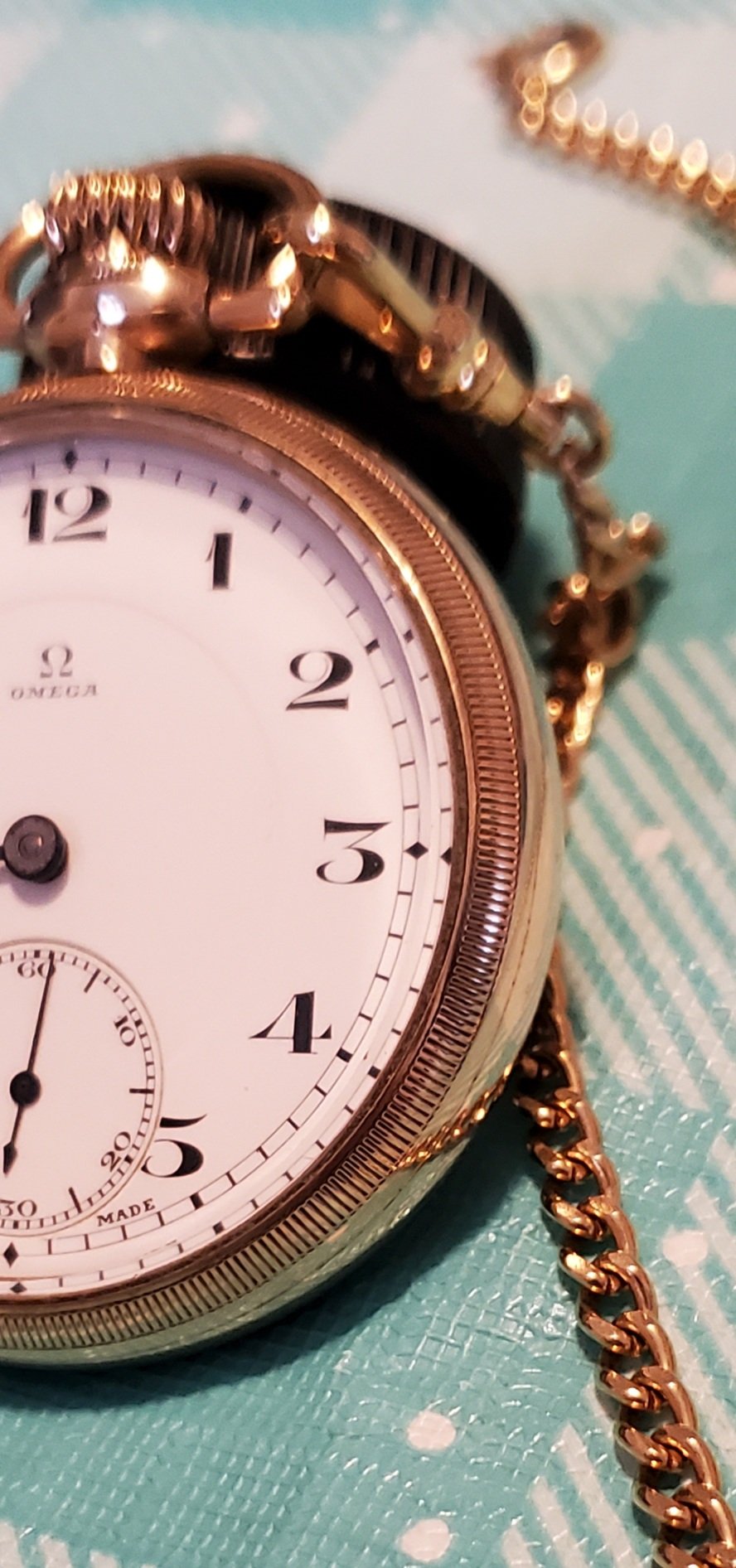

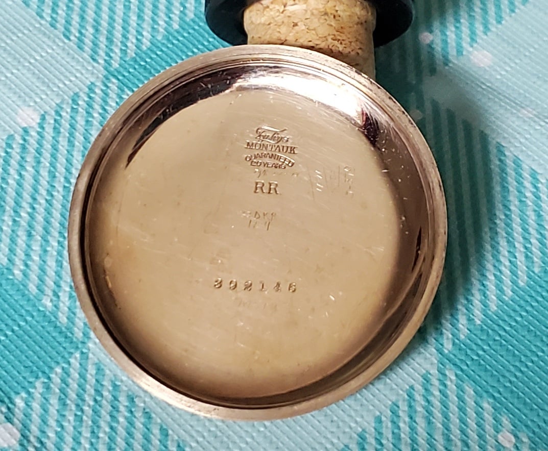

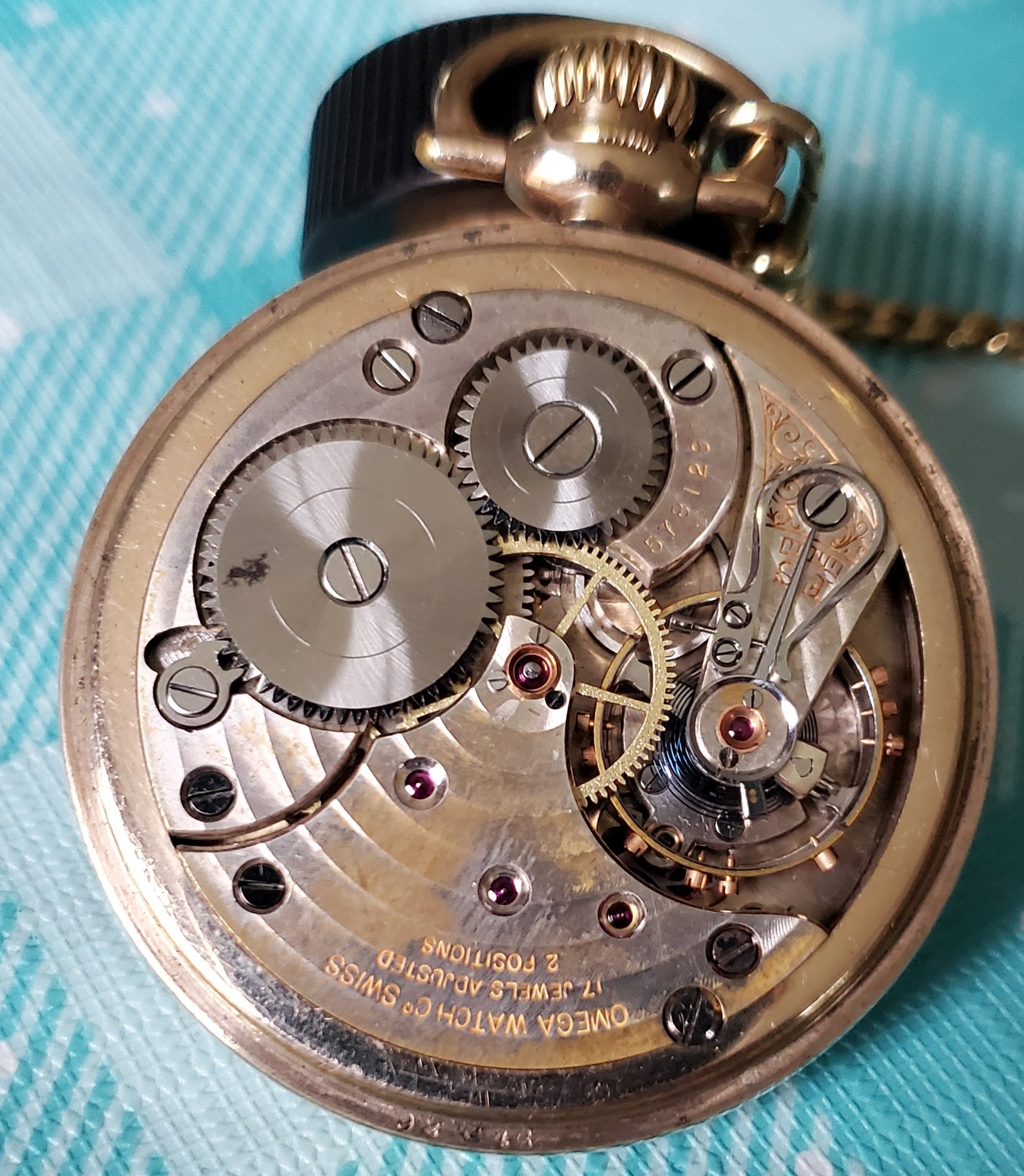

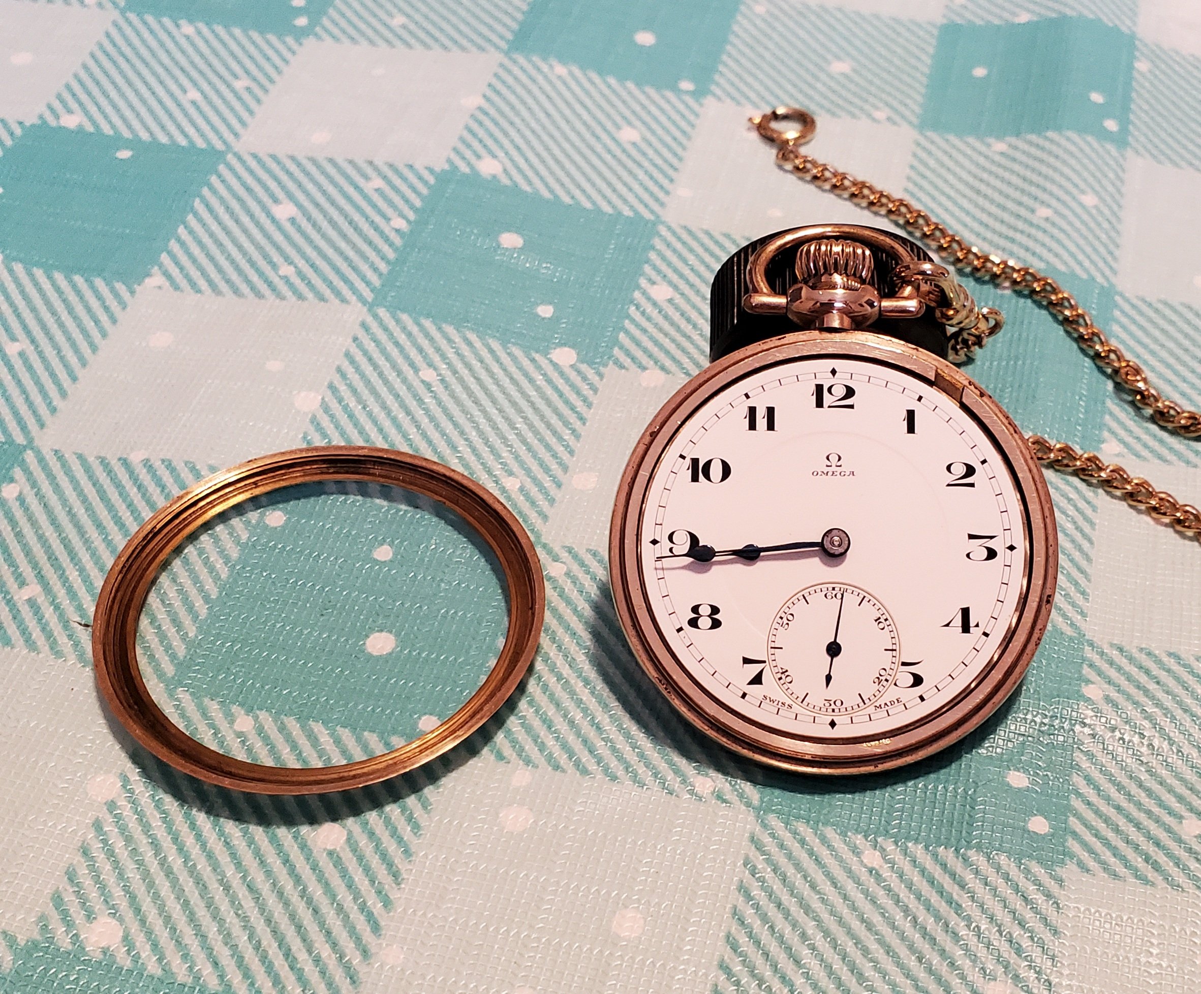

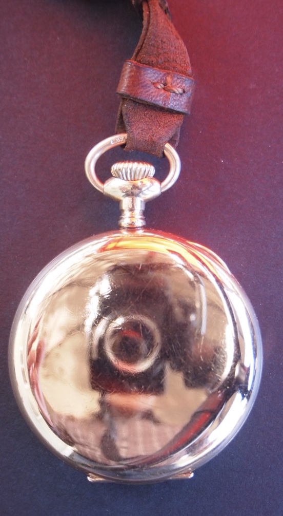

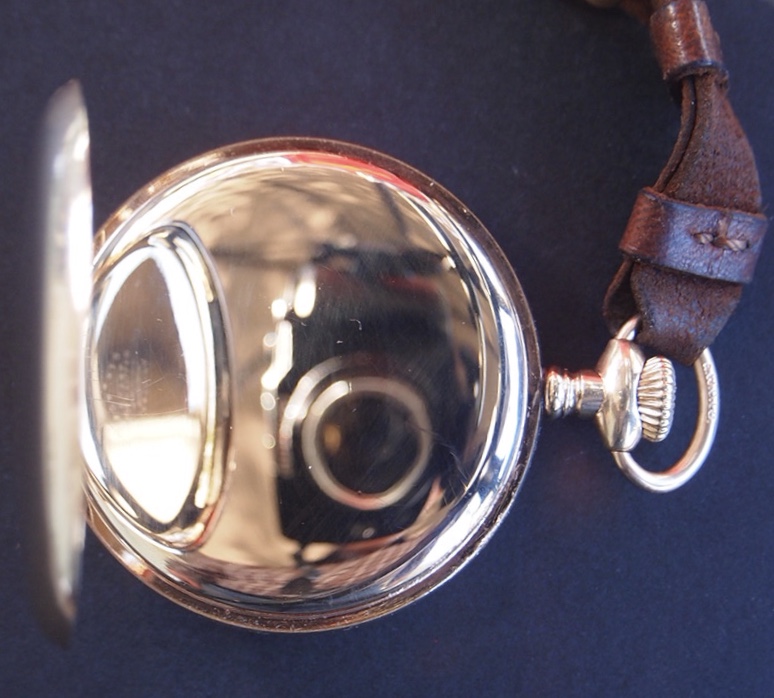

Here is the watch that my son-in-law is getting. I don't think it originally came in it's present case but that won't matter to him, as it is not all that collectible. I gave my daughter a nice Omega wrist watch when she graduated from university and he really wants a pocket watch, so this will match. I picked up a vintage 9k chain from my local jeweler that will go nicely with it.

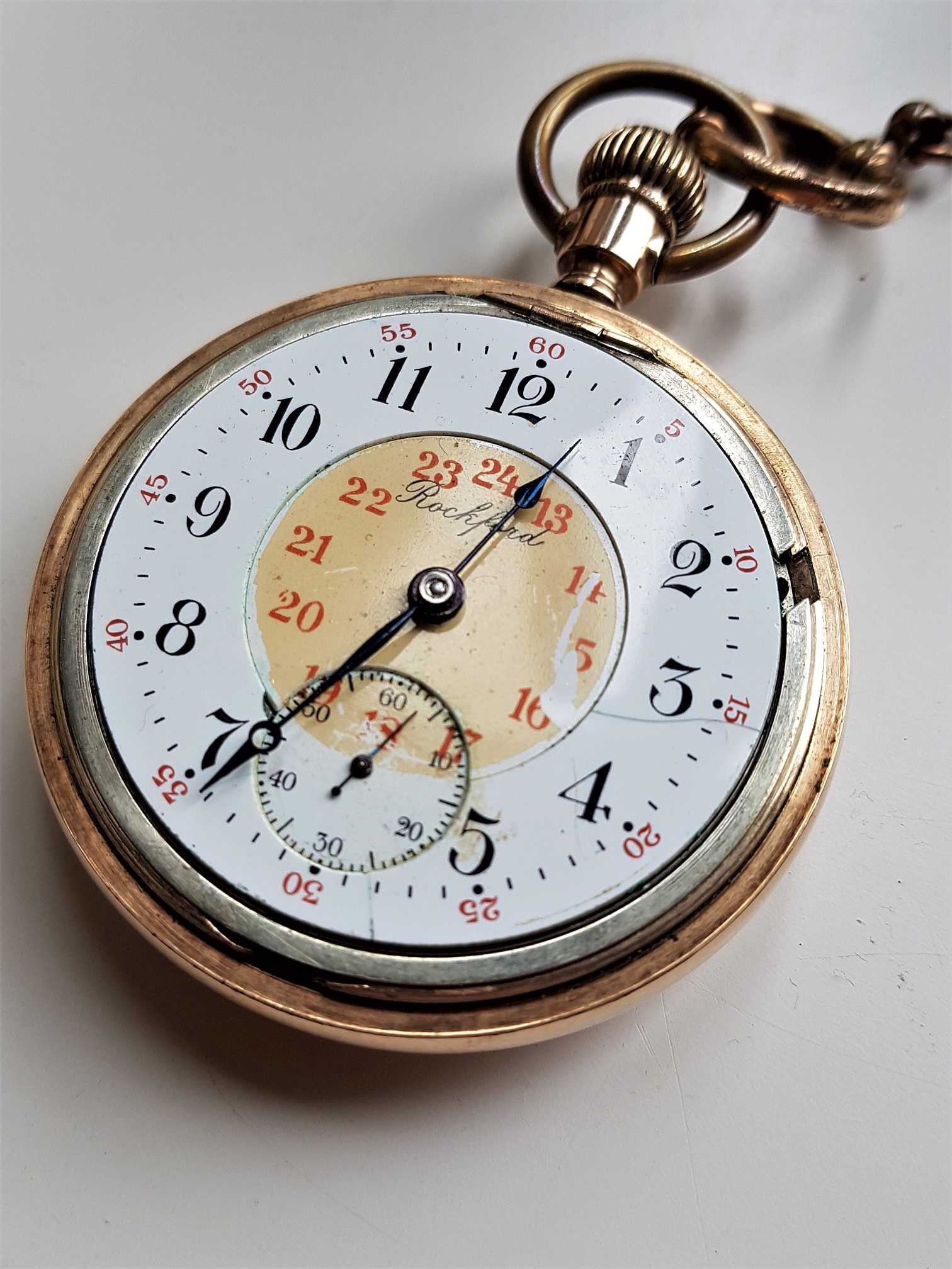

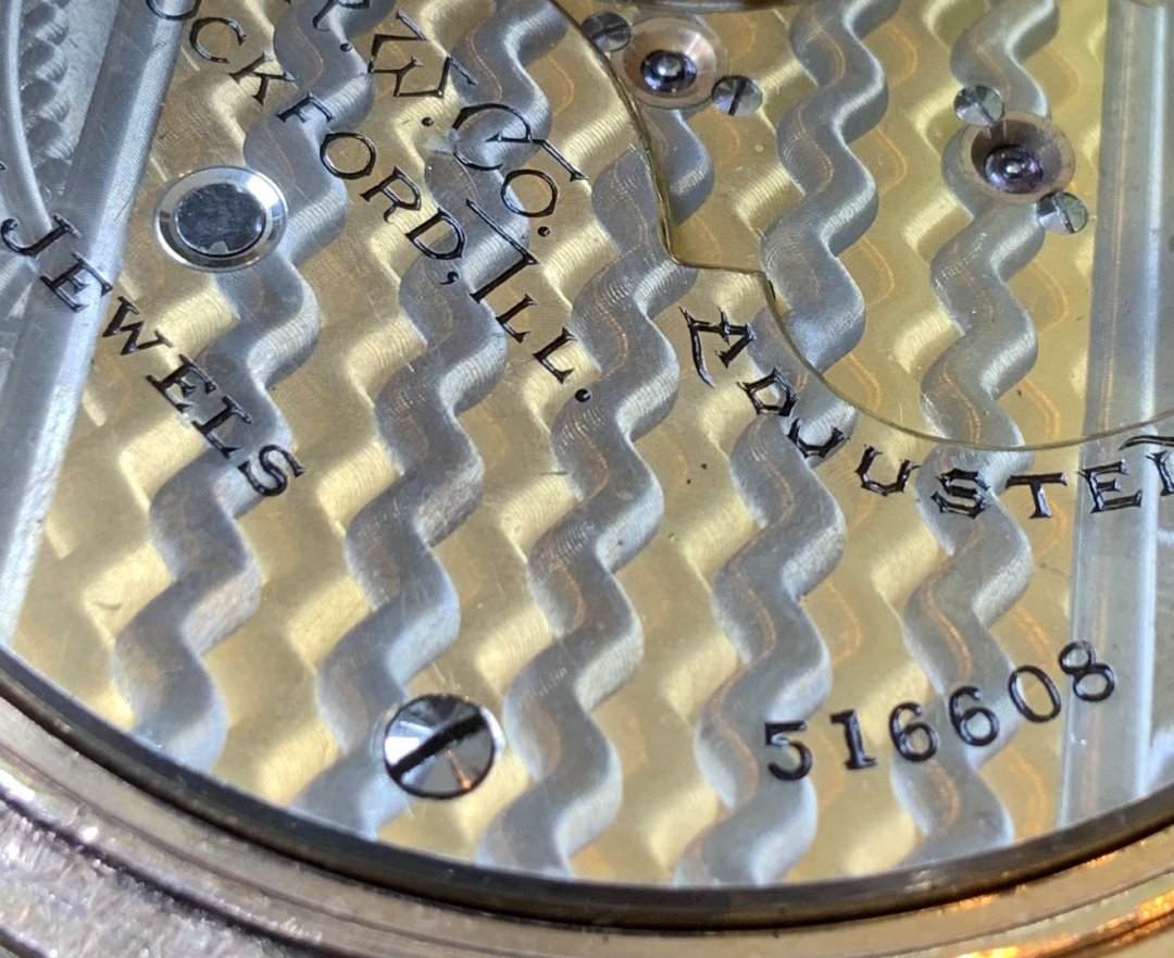

Another one from the little collection: Rockford, grade 938 from 1912.
I have a soft spot for Rockford, no one else made better or more dramatic two tone damascening on the movement. It looks 3-dimensional from some angles. A nice and uncommon watch. I have a couple of Rockfords, this post made want to go and find them.

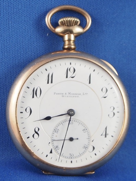

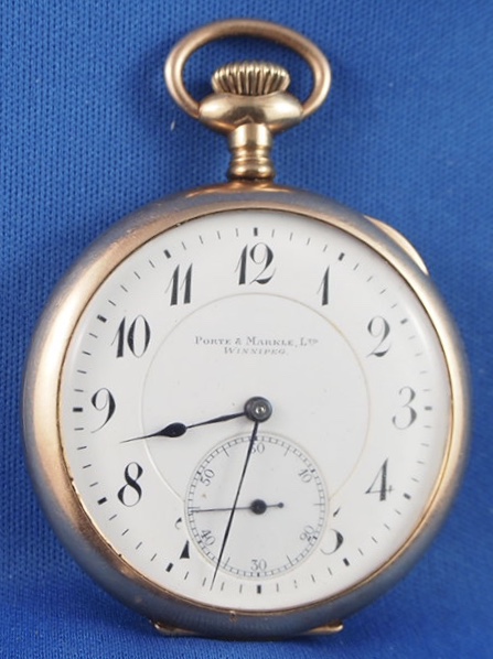

I bought a watch today. I went to a automobile show and shine about 50 kms south of here. I spent almost two hours hunting down some friends I knew would be there. One of them had three watches with him that had been given to him. Two I didn’t want…..one being a 19th century English key wind, and the other being a 7-jewel junker New Haven ladie’s watch. The third one, I liked.
It is about a 17-Ligne (16-size) private label watch, dialed for the jeweller/watch inspector Porte and Markle, Winnipeg, Manitoba. Swiss movement, Canadian case, double-sunk vitreous enamel dial, adjusted to 5 positions, temperature compensated, 21-jewels in gold jewel settings, patent regulator, double roller, blued steel Breguet hairspring, nicely finished., gold filled case in excellent shape. I told him I was interested it it. He said, “all three, or no go”. So I told him I would take the two off his hands for nothing, but we needed to talk price on the third one. He told me he was giving them to me. So I told him the private label one was worth $100.00 to me. He told me that would be fine, but he would just give the money to the guy he got them from. So I upped the ante to $150.00……..$100 to the other guy, and $50.00 for him. Deal done.
Porte & Markle were major watch merchants and railroad watch inspectors in Winnipeg, Manitoba, about 108 years ago.. I believe they were bought out by Henry Birks & Sons in 1913. I suspect my new watch had been a loaner, given out to a railroader whose railroad standard watch was in dry dock for repairs.This watch has had little wear.
Thomas Jeffares Porte partnered with George Markle in 1907 to form Porte & Markle Jewellers. By 1913, when they merged with Henry Birks and Sons, they had 5 stores. So this watch has to be 110 years old, at least.

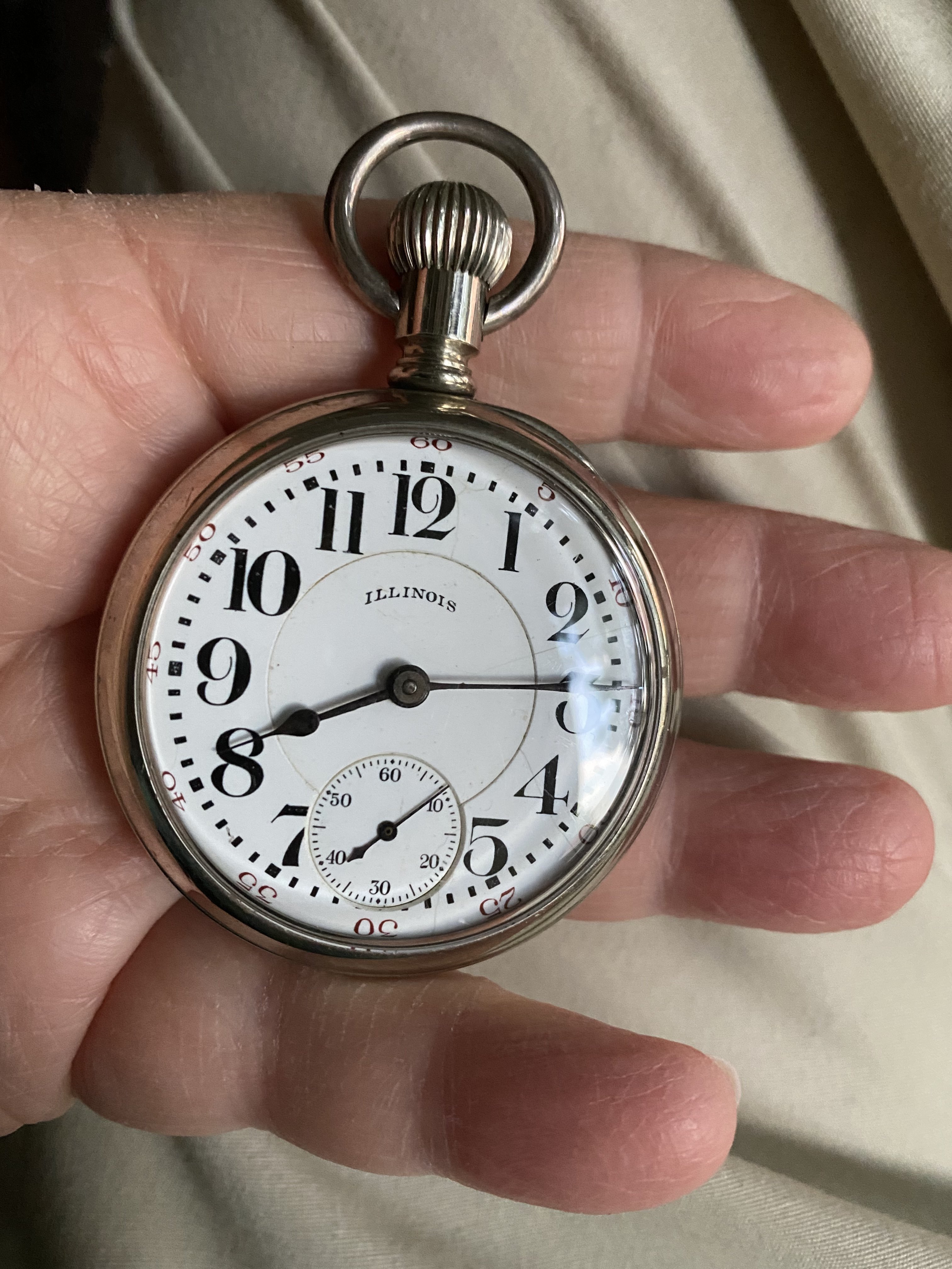

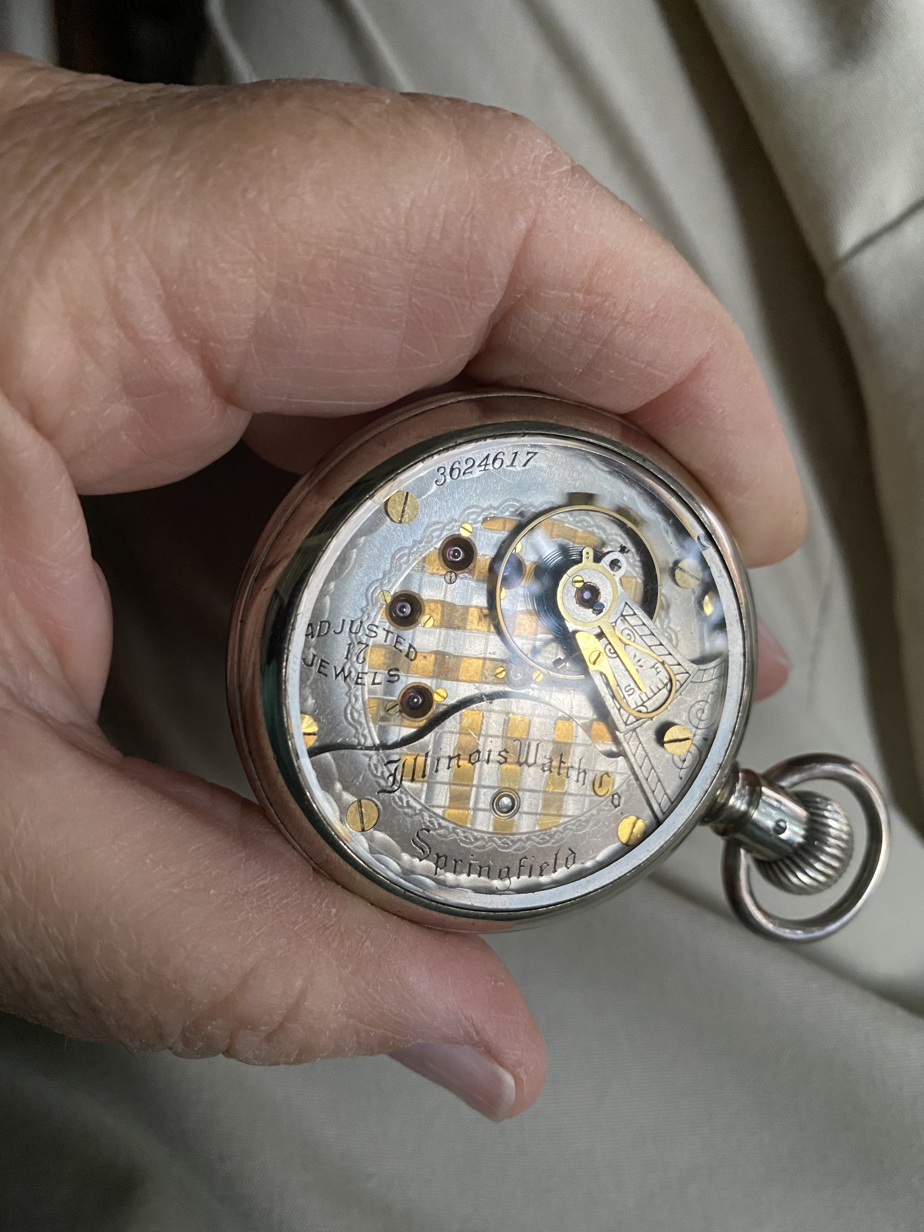

Illinois made nice two tone movements
checkerboard
18s model 6 grade 89
17j
1920
Display case
a nice high grade workingman’s pocket watch.
Not RR grade,(& being mindful of Canuck’s admonishing in the past, “for the US”)

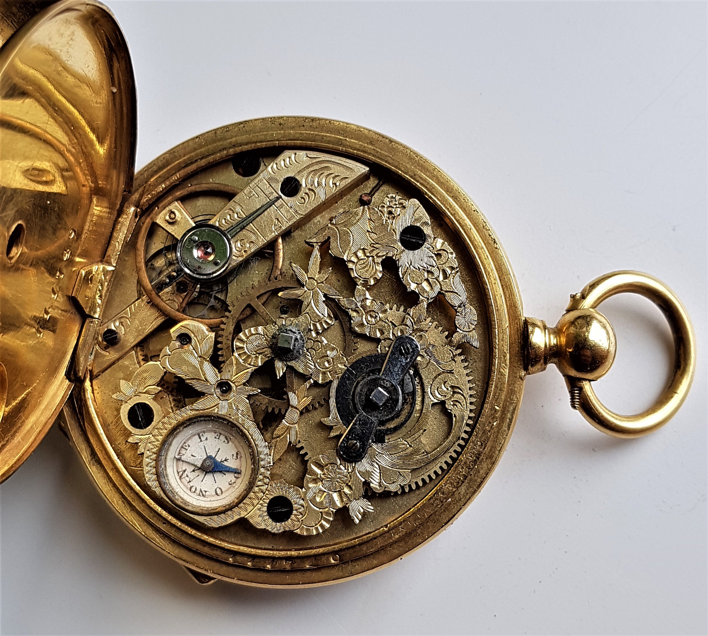

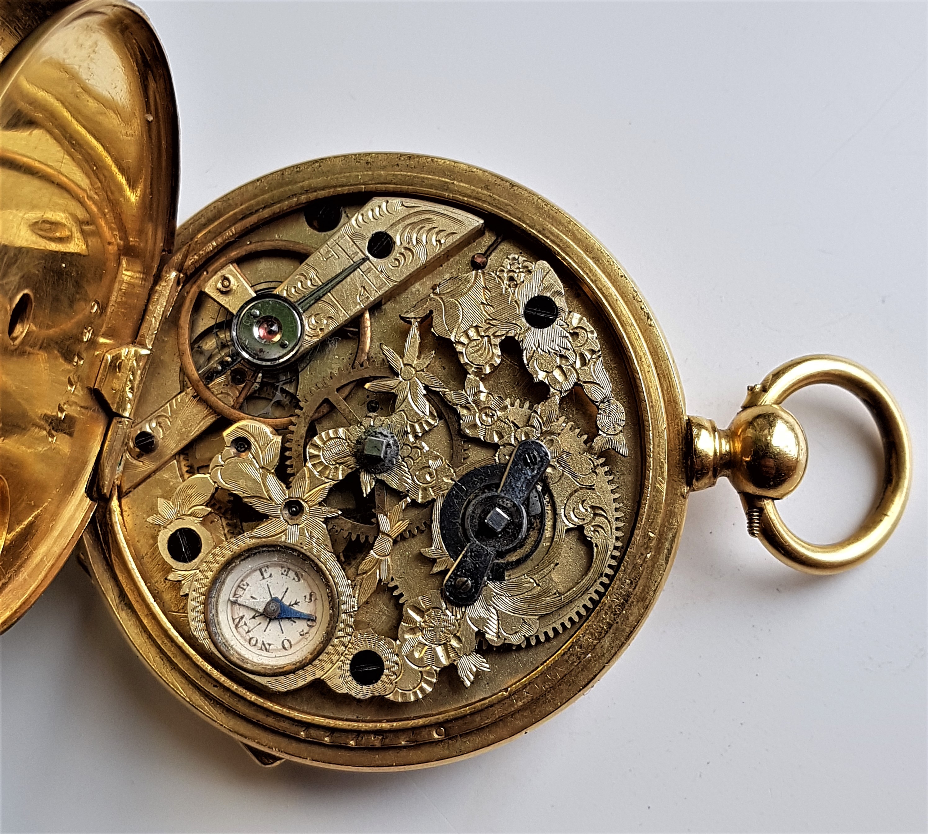

Thhis watch is from my fathers collection, I am trying to research it. Claming to be made of one M J Tobias of Liverpool, I´m not so sure it ever been anywhere near this mr Tobias. But I can be wrong. Apparently there are a lot of Swiss made 19th c copies at any case. Still a nice pocket watsh.
If anyone has further information pleas let me know.
Yep! Cylinder, zoom in & notice center wheel, 3rd wheel, 4th wheel, escape wheel, [ Hum, No Pallet! ] Balance wheel.
Prior comments hit the mark good.
But, it is unique with the hand engraved top plate.
The compass has an interesting feature. Let put a magnetic feild in the watch!
Kinda makes a person wounder about Tobias watches. In their days must have been highly regarded for counterfits to be made. Like Rolex.....etc. today I have seen a few with the Tobias label at NAWCC shows.
As stated also that it could have been sold through a family member of Tobias.
At this stage, put under a glass dome on a library shelf.
Cheers! Mike

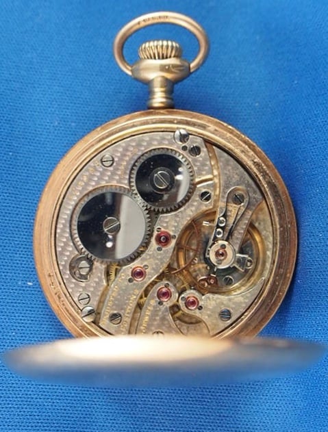

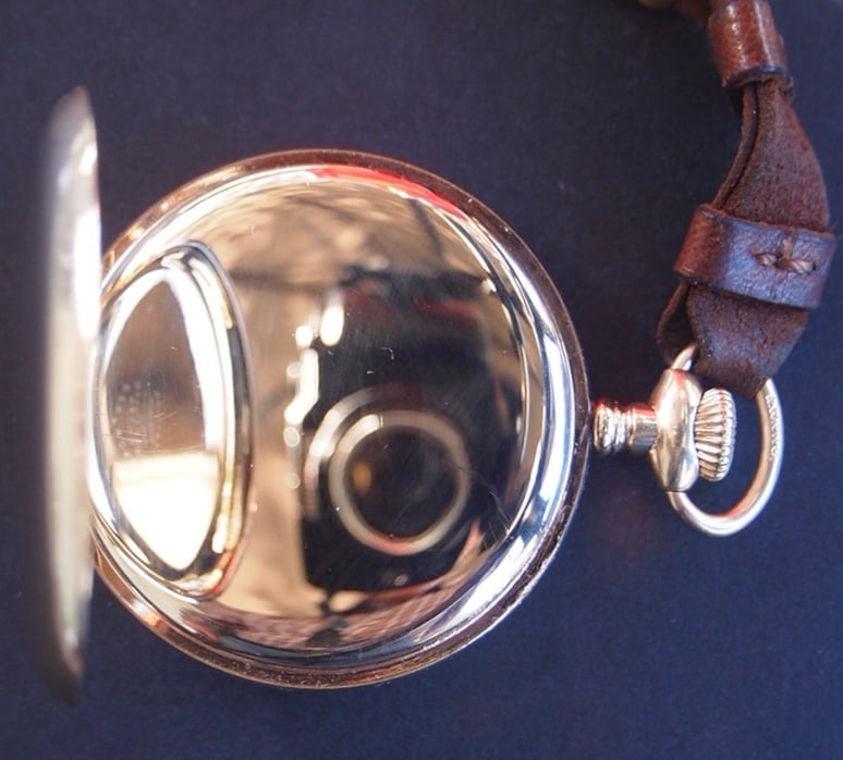

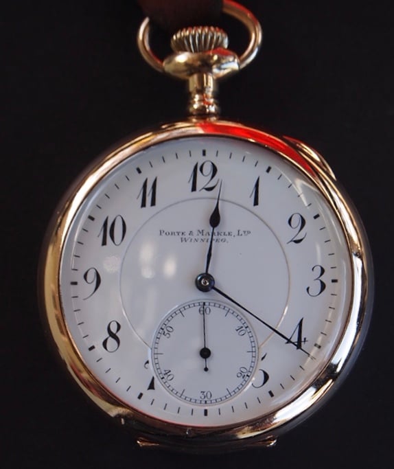

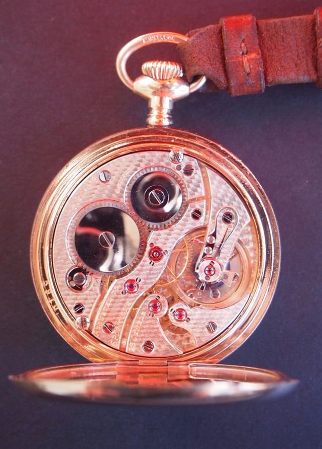

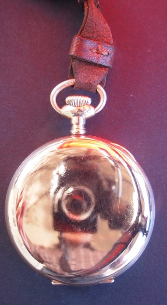

More on my newly acquired Porte & Markle pocket watch. After servicing it. This watch is truly a stunner! It is shown on my @Dave K miracle braid leather lanyard.
8,881
62,896
^^ Outstanding example of a pocket watch, I always like seeing screwed down jewels.
Great damascening, too.
15,997
48,115
This watch is marked 23-jewels. Legislation was enacted decades ago, during the era of the 100-jewel watch (75 of which did nothing, and were fitted only to avoid fraud). This watch would not meet modern standards regarding “functional” jewels. Cap jewels on most watches act as thrust bearings, and where they are used, the pivots beneath them are conical, so the tip of the pivot contacts the cap jewel. On this Porte & Markle, there are 4 cap jewels (three of them circled) that are only there for decoration. Beneath them are standard plate hole jewels, and square shoulder pivots. In fact, this watch has only 19 actual functional jewels when the modern definition of a cap jewel is used. These cap jewels appear to be held by screws, but the cap jewels are not removable! Never saw anything like this before.

Still mighty pretty and elegant looking!!

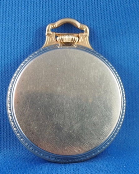

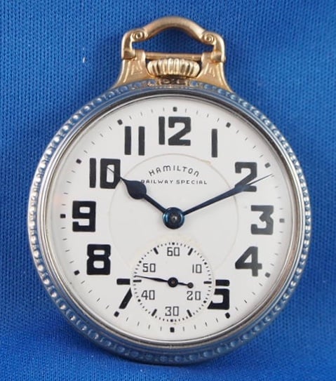

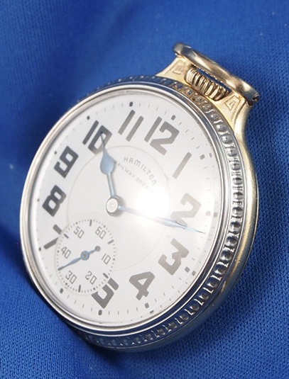

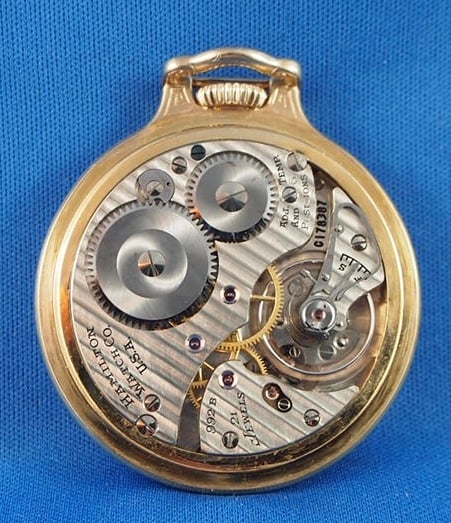

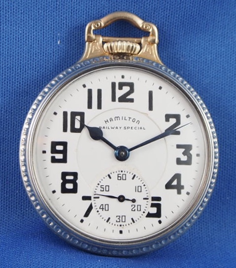

This one was sent to me for a repair estimate. It needed a mainspring, glass, repair chipped enamel dial, recondition. I wasn’t certain I would get the repair, so I showed it in the condition before the repair. The case is likely not rare, but it is unusual. It is a style # 3 Hamilton case, steel back and bezel, gold filled case ring. I may have seen one other of these in all my years of collecting. The double sunk, 12-hour vitreous enamel dial has “boxcar” bold black enamel Arabic numerals. The movement is a Hamilton 992B. The watch has only had one previous repair. Produced circa 1947. Instead of the usual acrylic “unbreakable” crystal that is so often used in a repair like this, I had a NOS domed glass crystal, so that is what I fitted. Not as shatter proof as plastic, but that is what it had when new, and they look much better than plastic. Here is the skinny on it.
https://pocketwatchdatabase.com/search/result/hamilton/C178387

Well that’s interesting!
i have my Grandad’s watch, a 1905 Longines private label watch purchased from “Thomas J.Porte,Winnipeg” when he was setting himself up to start a life on a land grant in northern Saskatchewan after landing here from Sweden.
My dad spent most of his working life on the railroad, much of it in and around the Thunder Bay/Winnipeg area, so the information is welcome!
