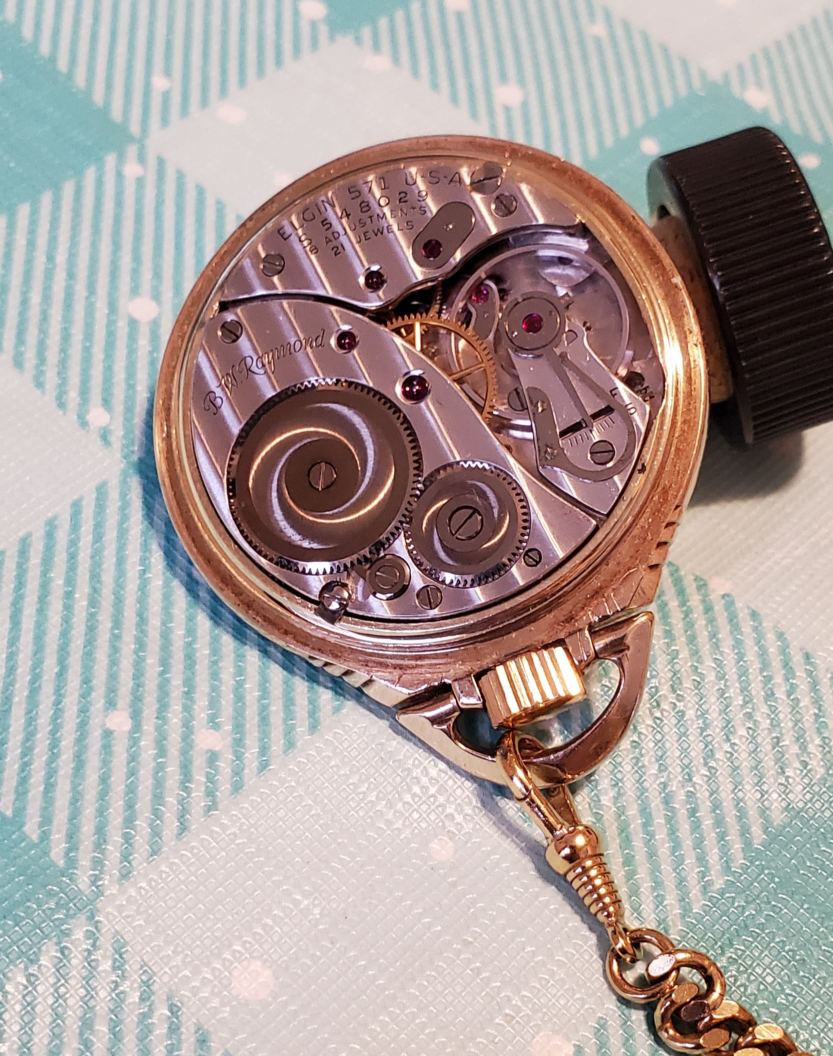

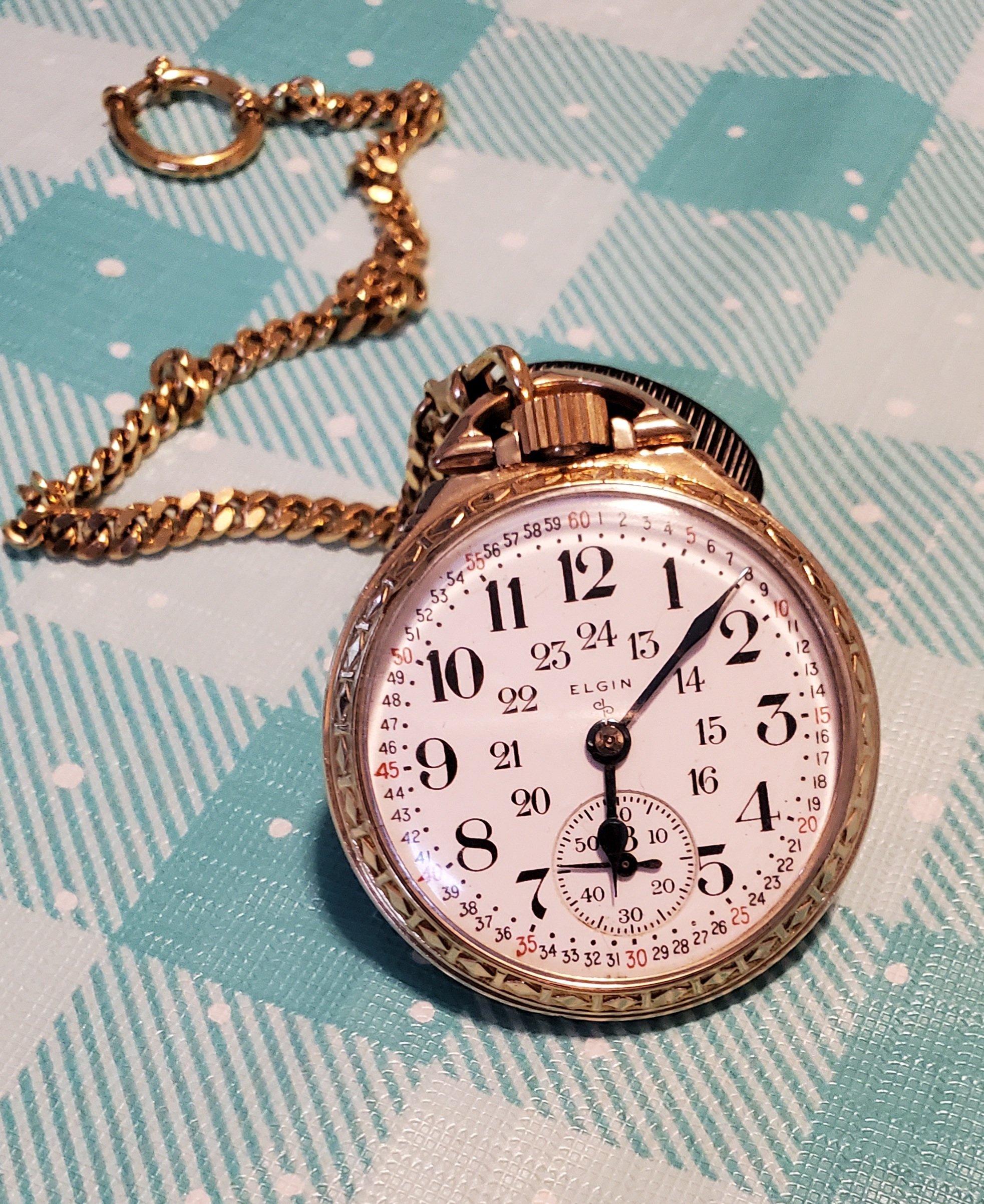

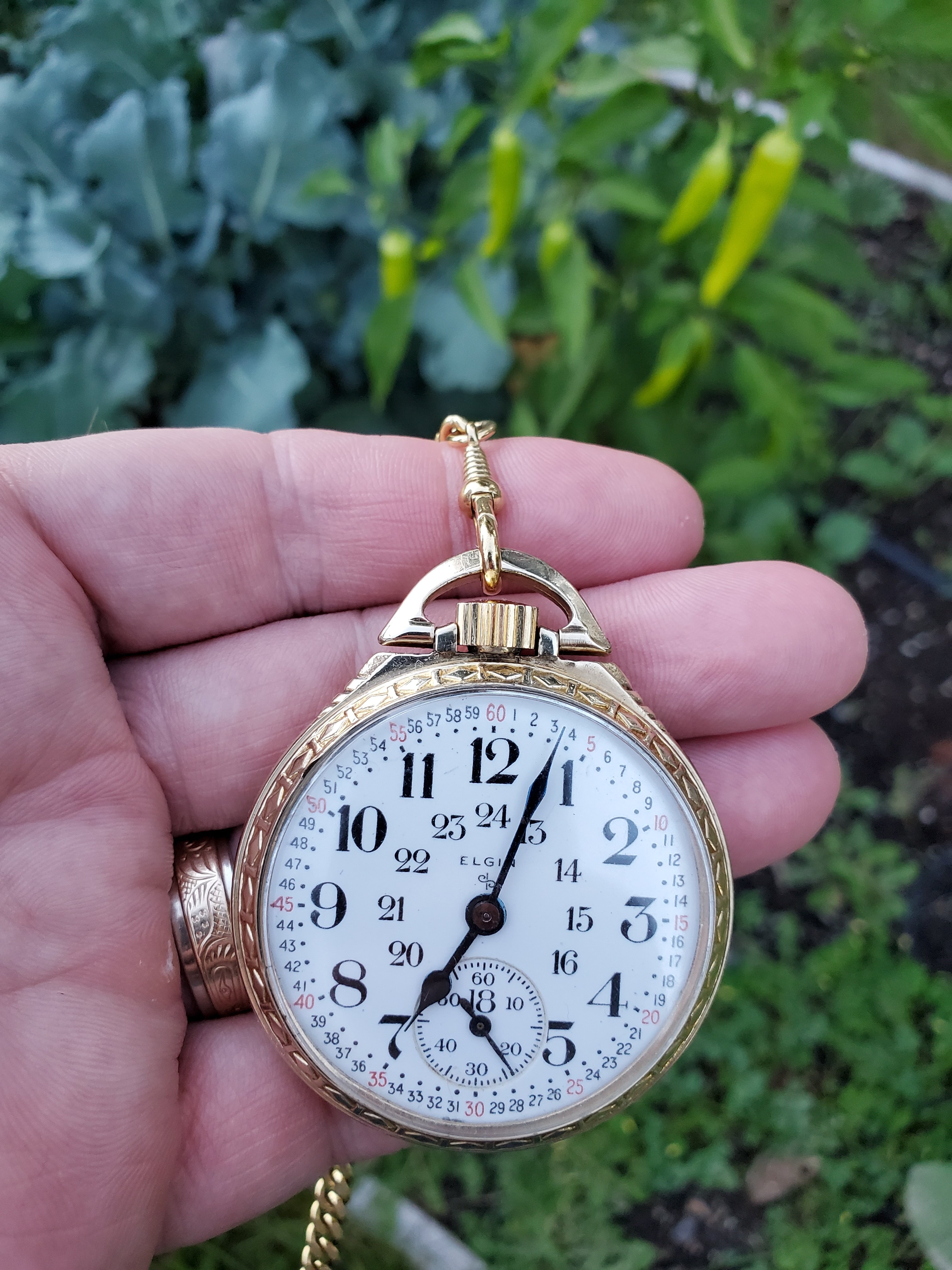

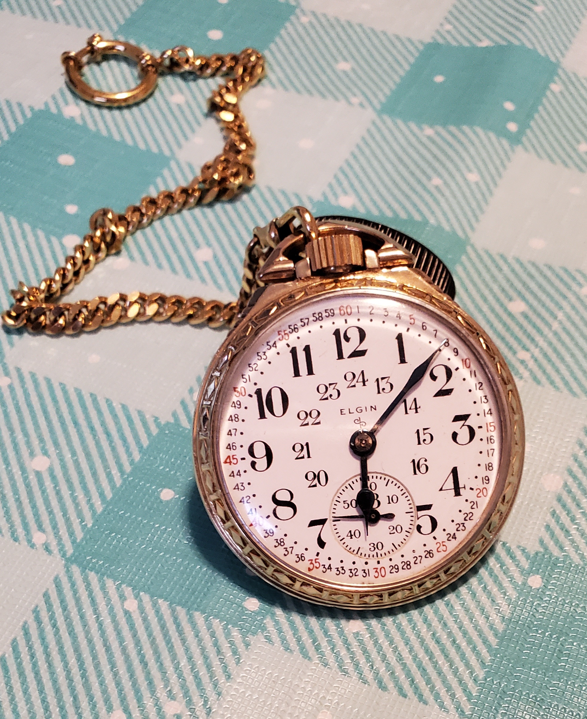

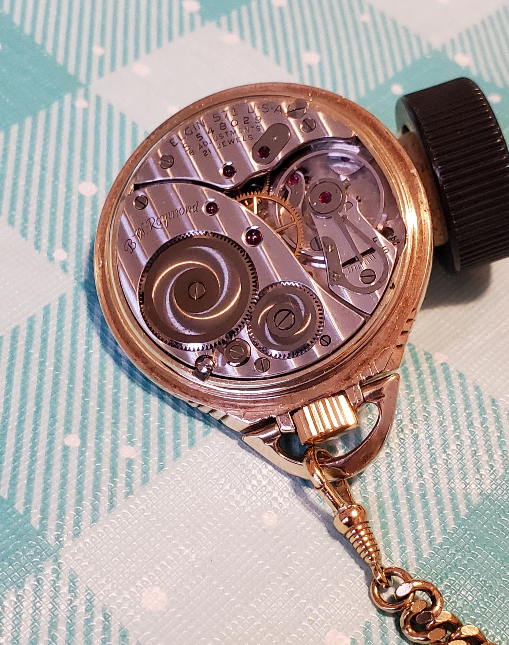

Here is my latest purchase that my watchmaker showed me while I was picking up a few watches. I think it is late 1940's or very early 50's Elgin 21 jewel, 8 adjustment, B.W. Raymond. It is fully serviced and keeping time within 1 sec per day since I got it a week ago.

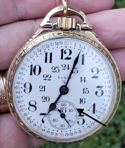

Beautiful, I love that dial. Do you know, is it melamine or enamel?
Here is the skinny on @amcclell ‘s handsome Elgin.
https://pocketwatchdatabase.com/search/result/elgin/S548029

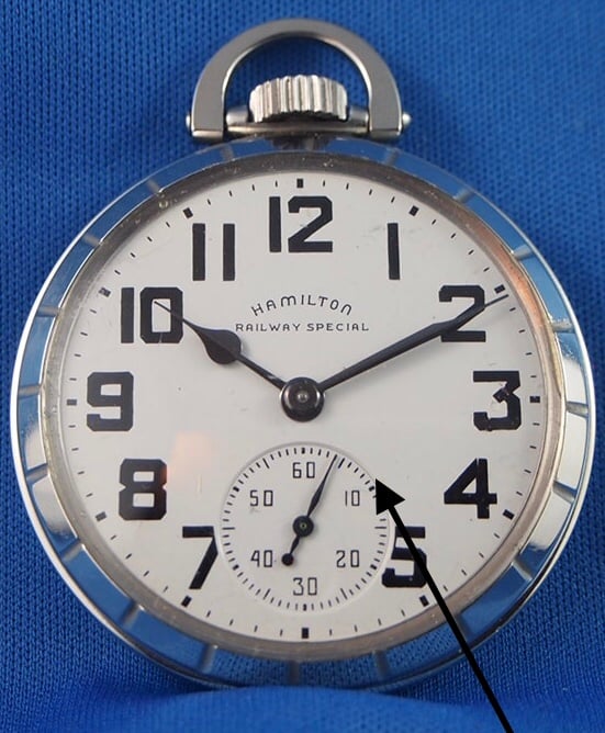

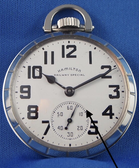

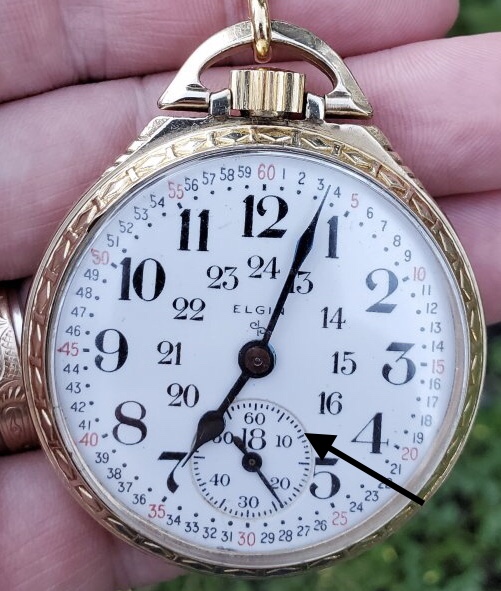

The dial is vitreous enamel on the Elgin. I have included two pictures in this post. One is of the Elgin dial with a callout, and the other is a 992B with a melamine dial, likewise with a callout. First, look at the colour difference between the two. I have never seen a melamine dial as pure white as the Elgin dial. The lustre on the vitreous enamel dial is called a VITREOUS lustre. The lustre on the melamine dial is called a WAXY lustre. Secondly, the arrow on the Elgin dial points to a clean, crisp, sharp delineation between the dial and the seconds bit. The seconds bit is a separate dial, inserted into the dial from behind, and soldered in place. That edge might have a slightly granular look, because a hole had to be cut into the main dial to accommodate the seconds bit.
The dial on the Hamilton was stamped in a die, leaving a depression for the integral seconds bit. The callout points at an edge that looks sloughed, or lacking the clean, sharp definition around the seconds bit on the Elgin.
First, the Elgin.
Second, the Hamilton.

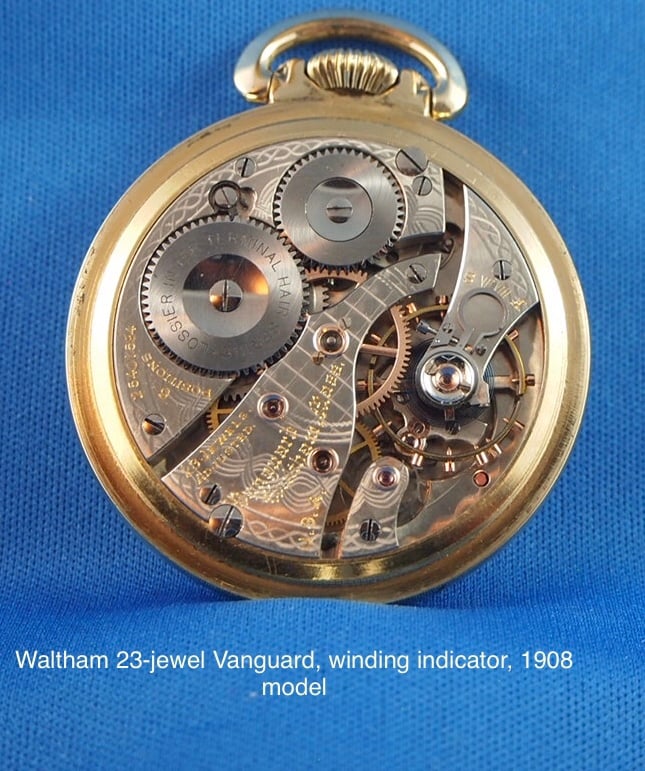

Thanks, that information is much appreciated! I was quietly seeking a Waltham Vanguard with power reserve indicator, or a hamilton 992 but saw this and the condition was so good that I couldn't resist.
15,997
48,115

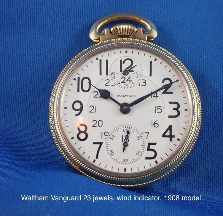

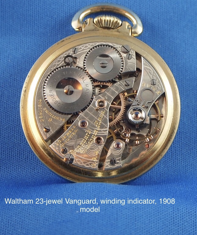

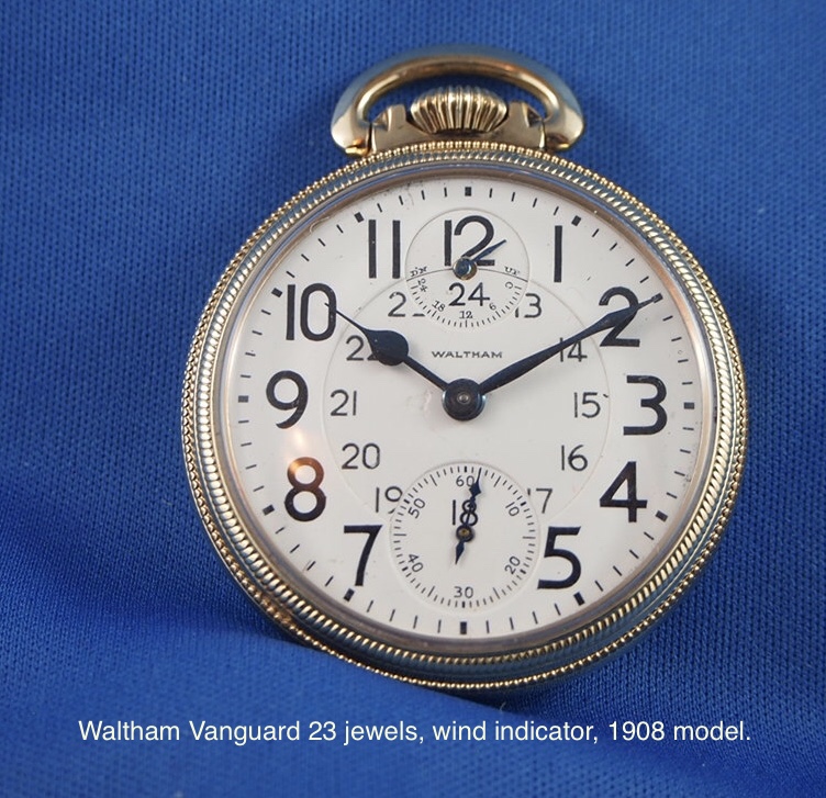

@amcclell ,
You’re looking for one of these.

That's the one but with the Elgin, I am now good for pocket watches.

There are several Vanguard indicator watches currently listed for sale on line for between $1,200 to about $2,500. However, most collectors would be quite happy to settle for your B W Raymond. I have one myself, but not as nice as yours.

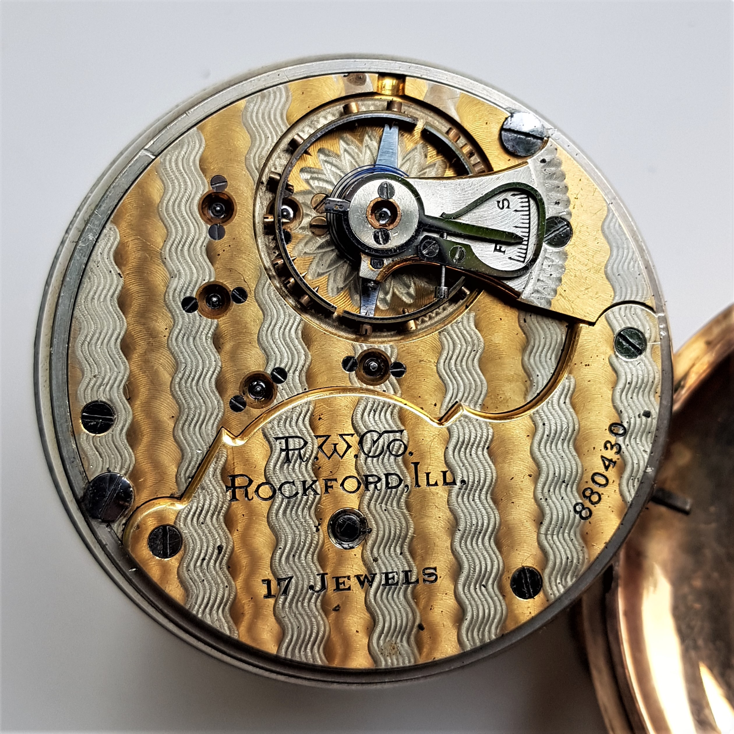

Which brands were more likely the "working" watches?

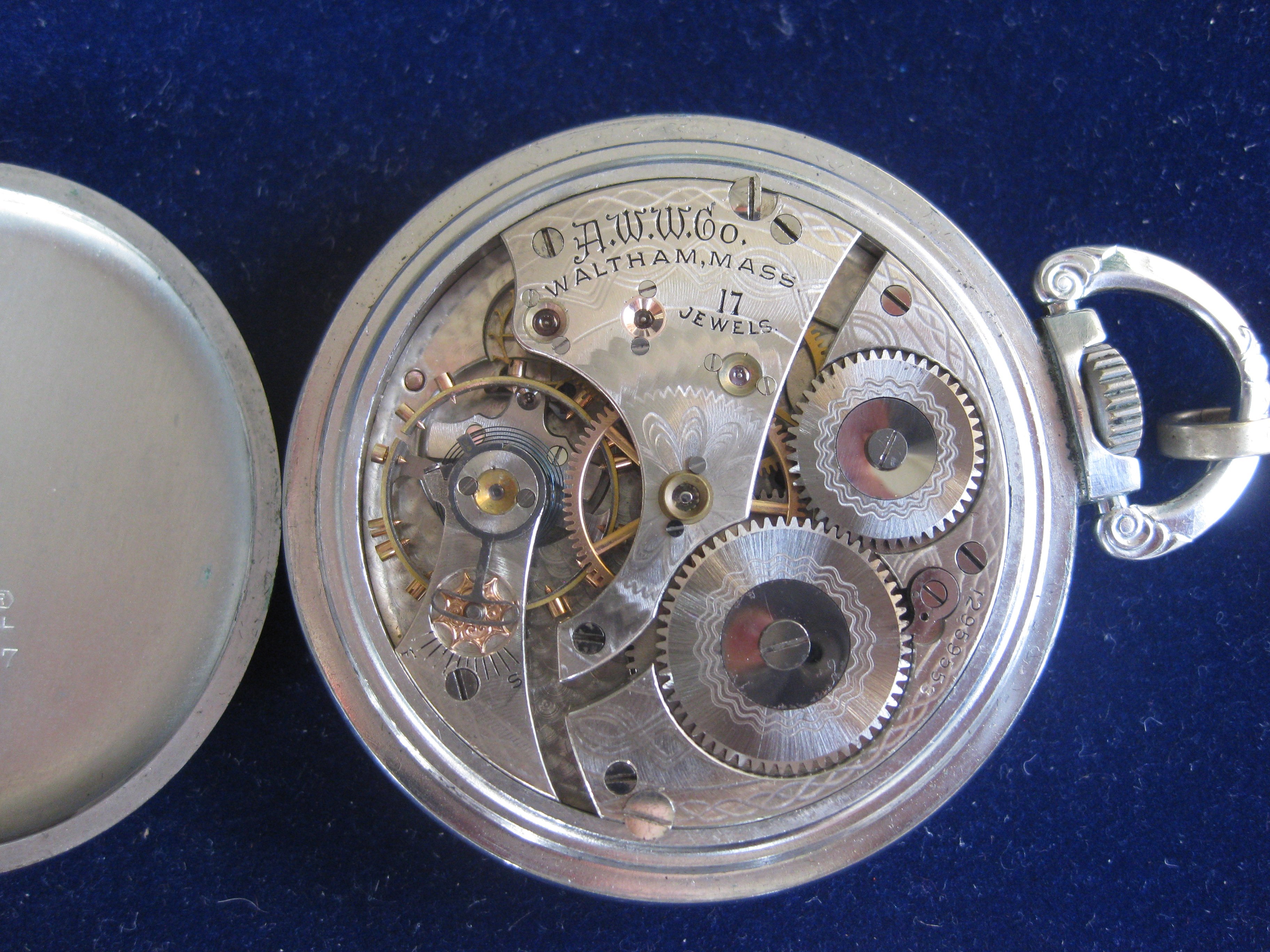

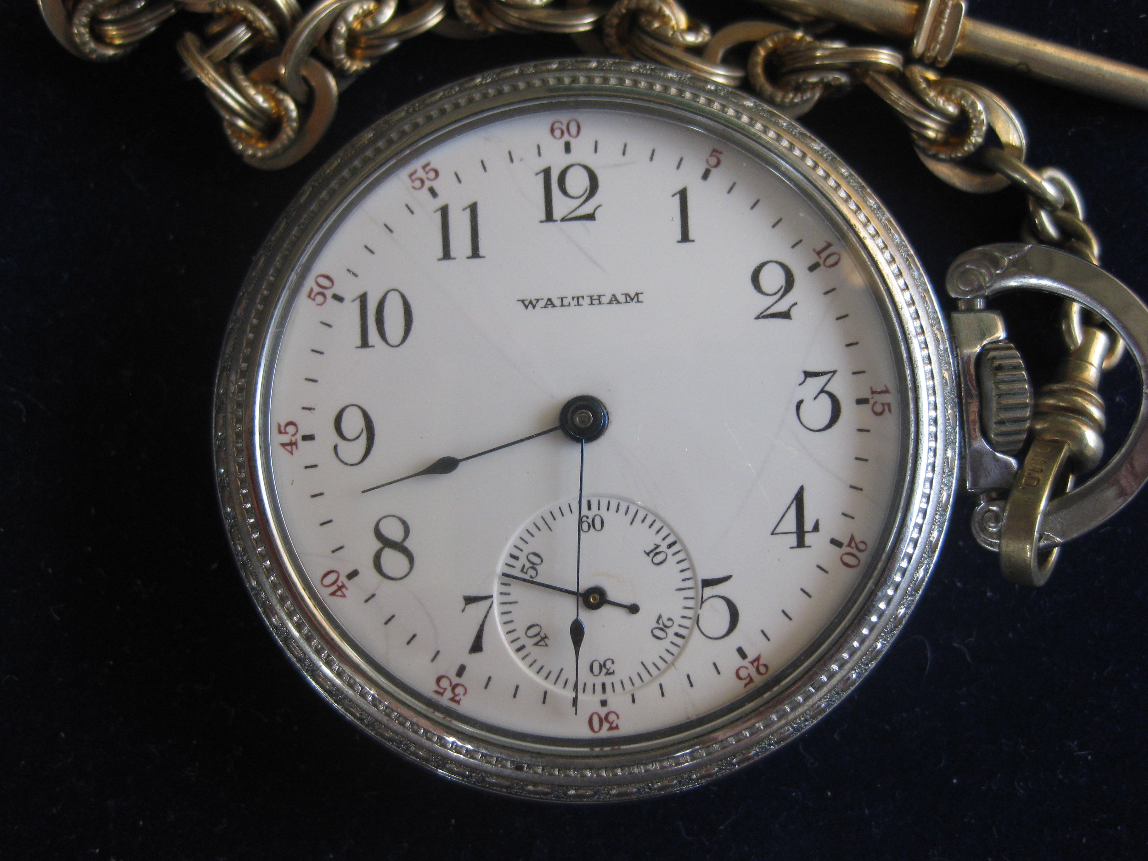

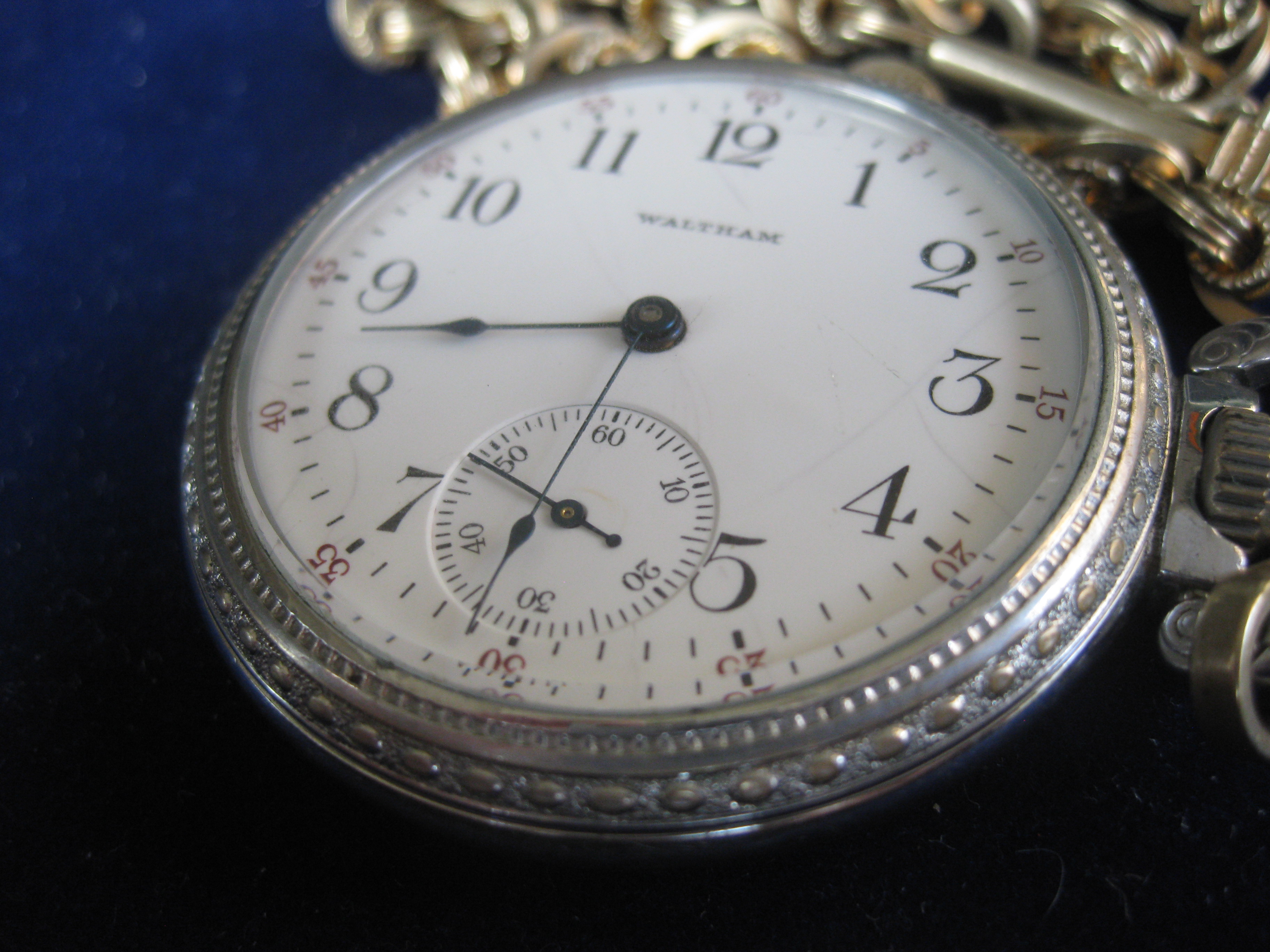

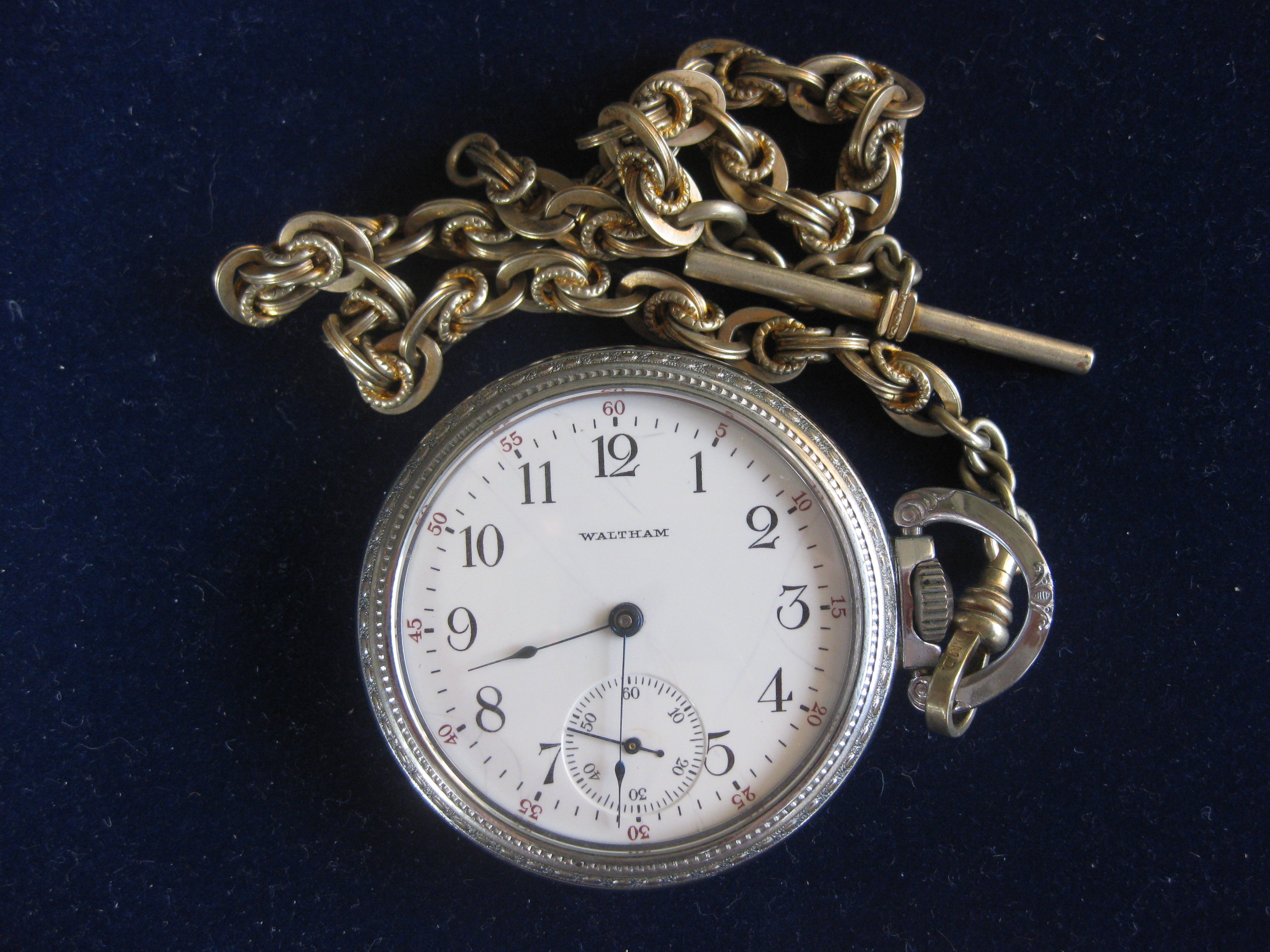

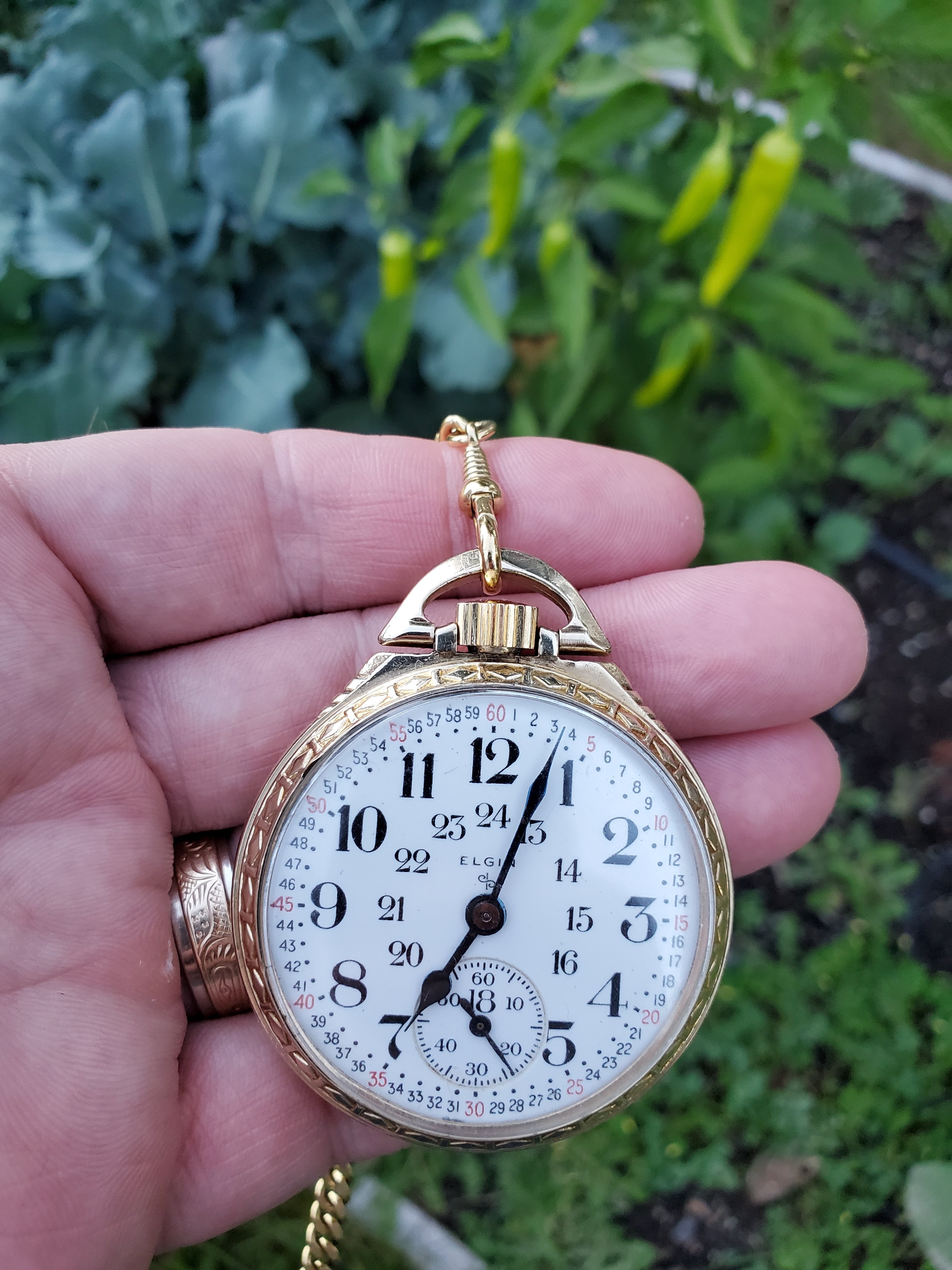

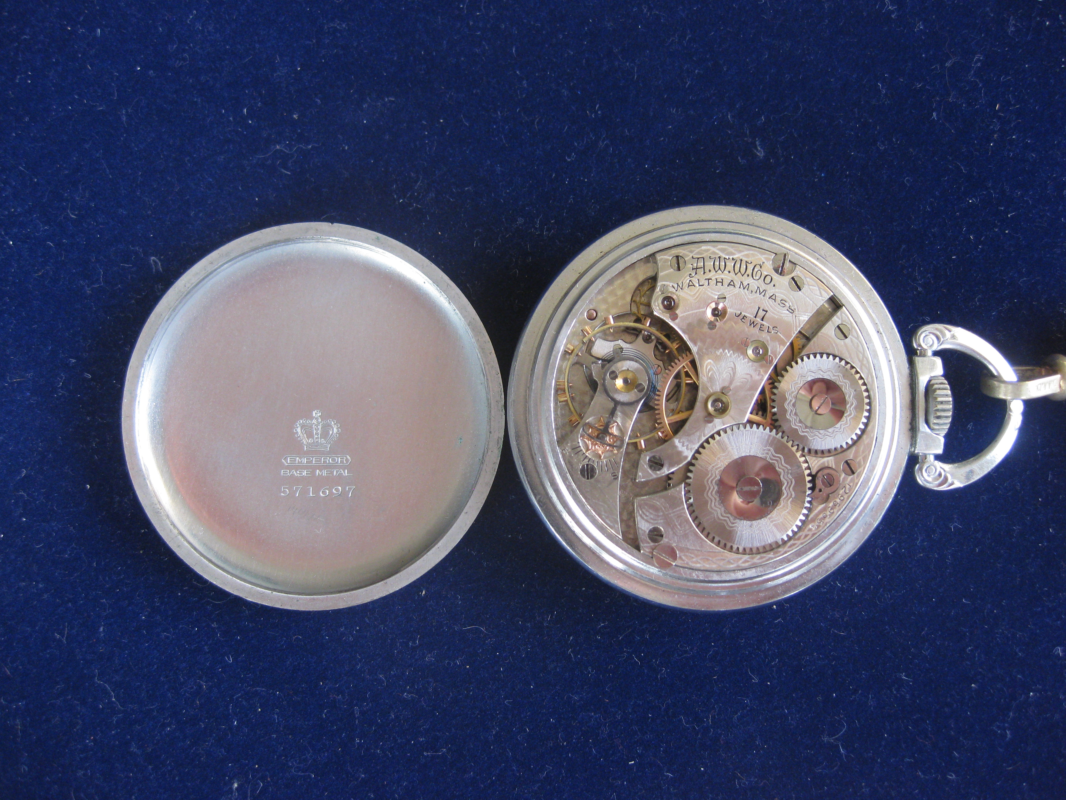

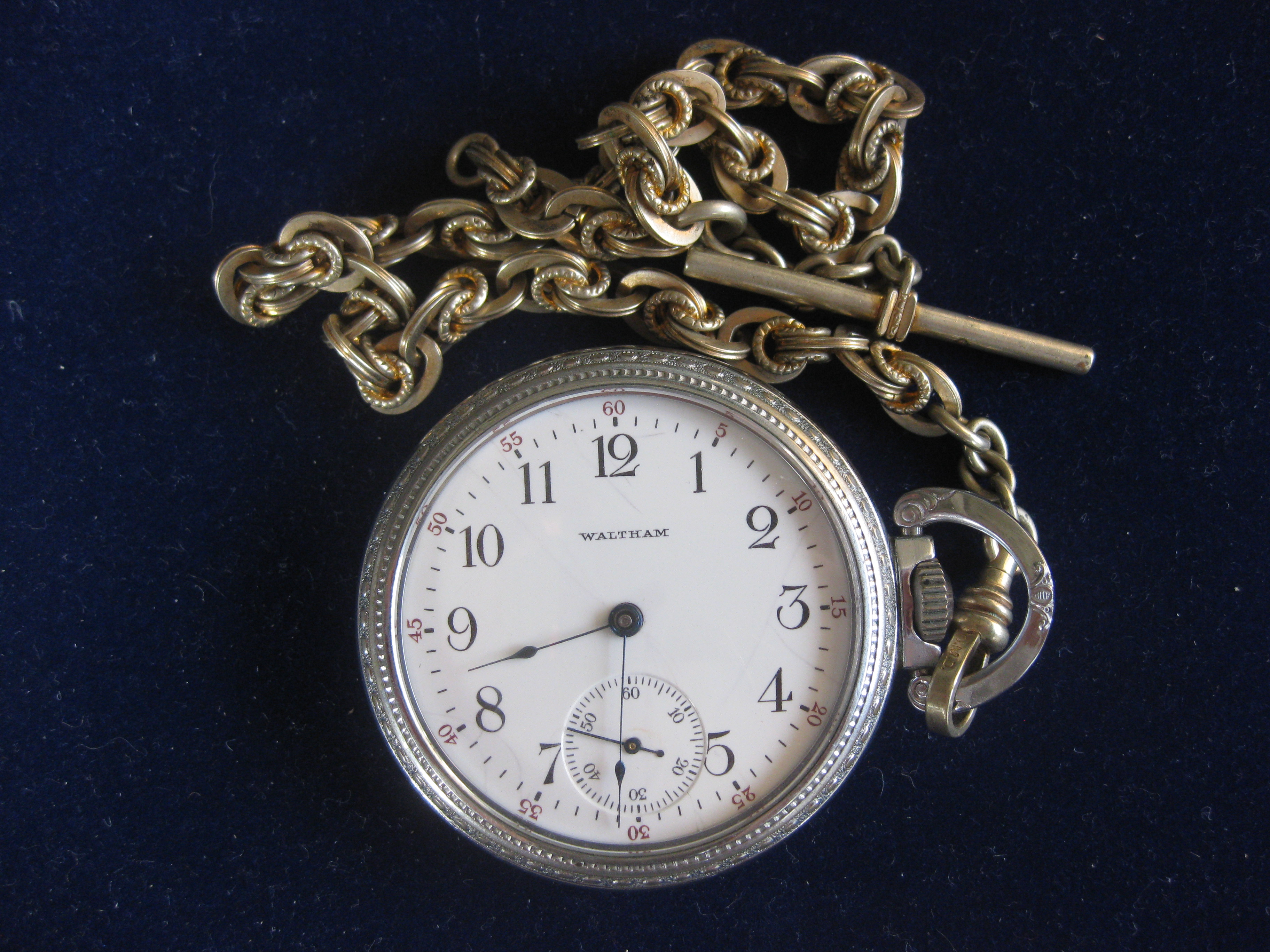

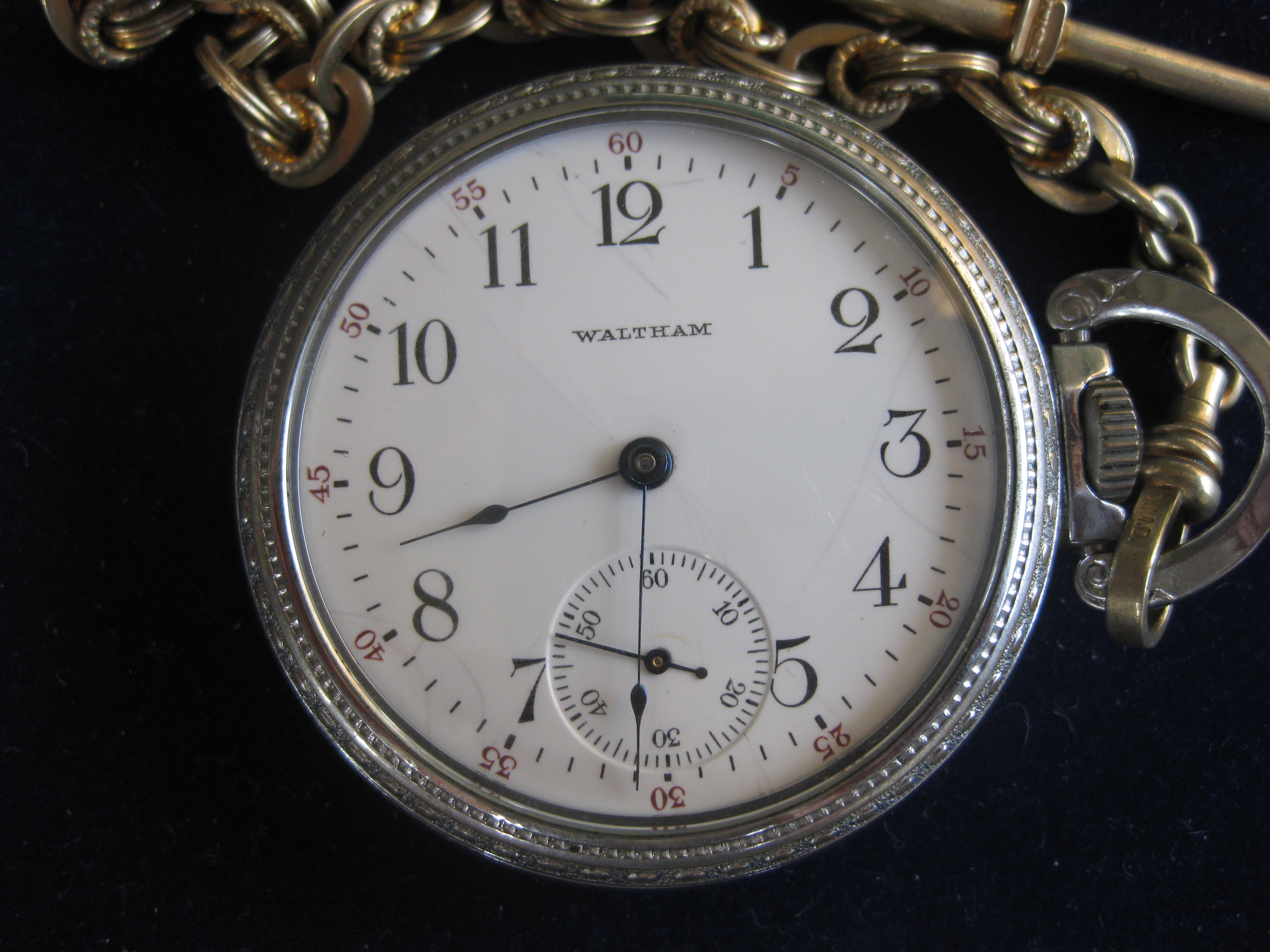

Here's one that my wife's grandfather gave me after we got engaged (engaged to his granddaughter of course, not to him) 😉
99
186

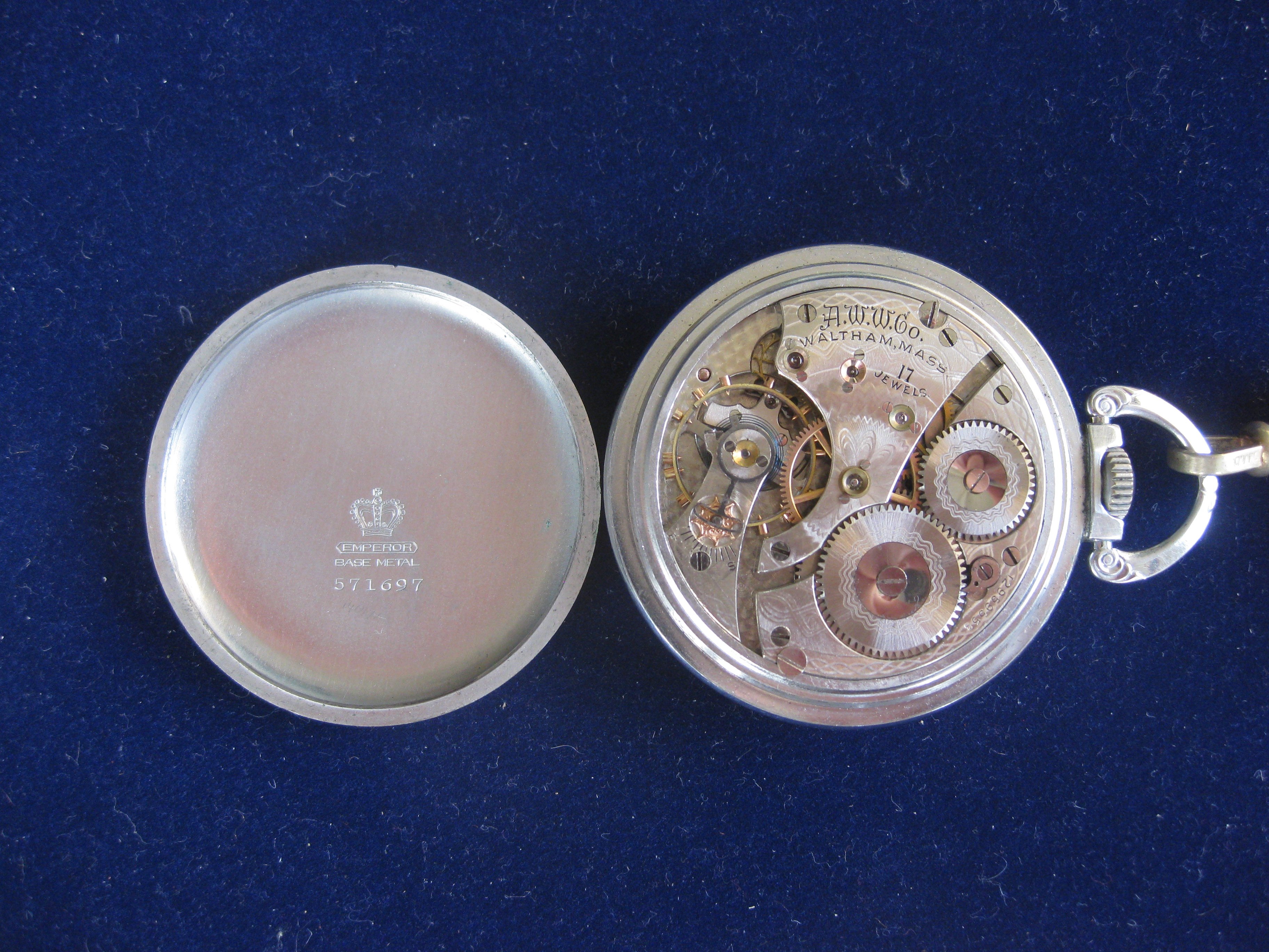

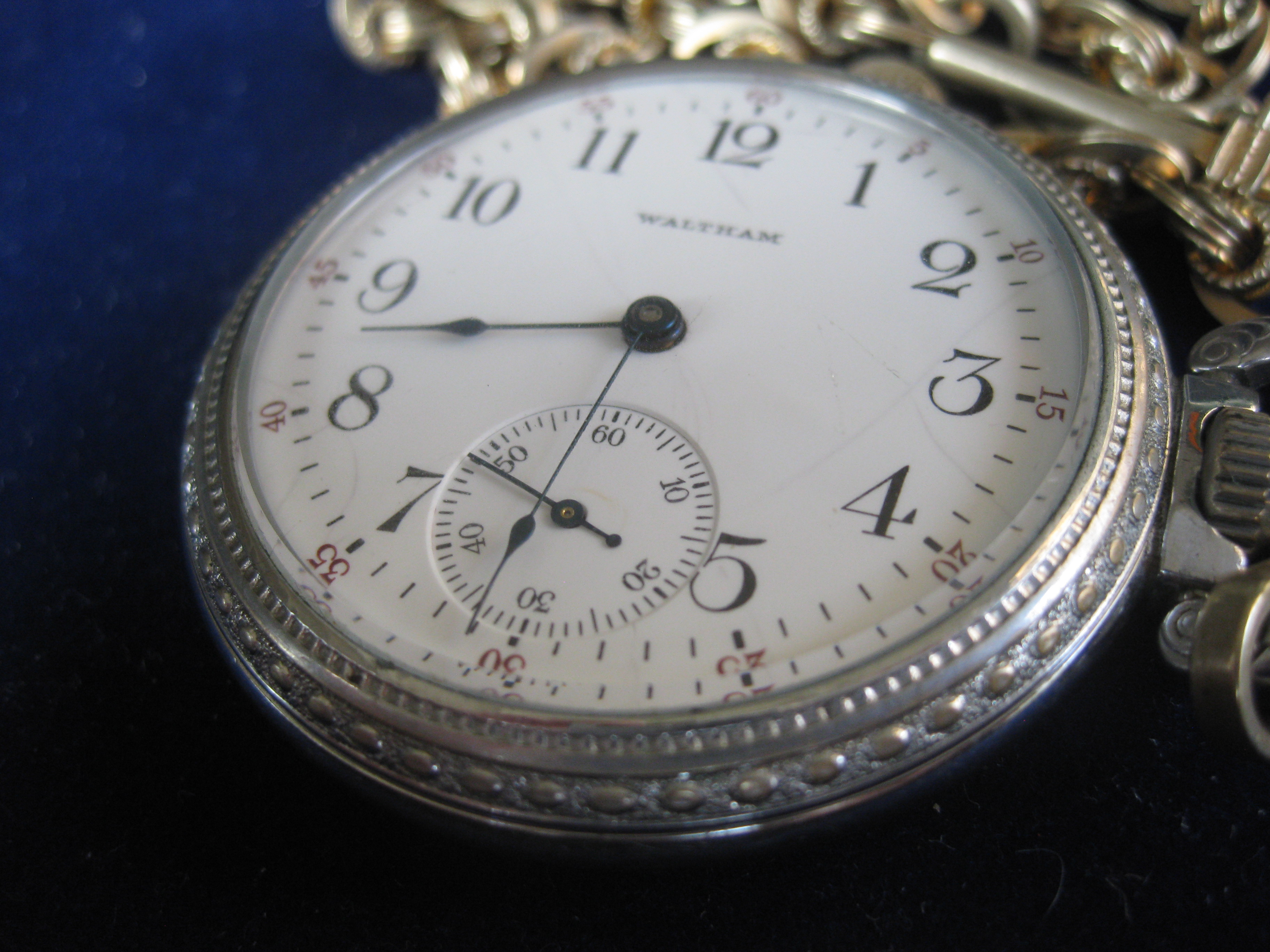

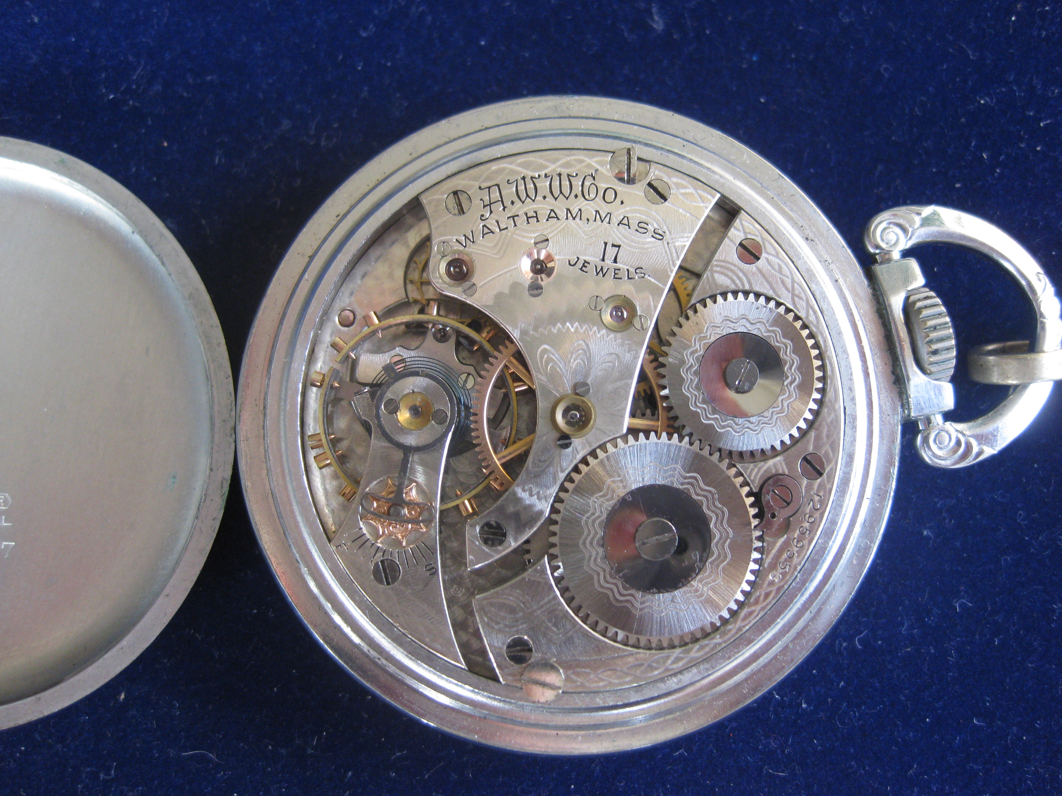

...and under the hood.
I'm new to the watch collecting hobby, so I just don't have a lot of knowledge on the subject, but I'm really enjoying learning form everyone here. So, what can anyone/everyone tell me about this Waltham that he gave me?

@amcclell That's a great looking B.W. Raymond, that dial is killer. I have one from the mid 50s and I believe it has a painted metal dial.

One of the first things to learn is that the Pocketwatch Database is your friend. You just type in the serial number and the maker and Bob's your uncle. According to their website your Waltham is a grade no. 625, model 1899, and was made in 1903.
https://pocketwatchdatabase.com/search/result/waltham/12959558
Howard, ( both E Howard and Keystone Howard), Elgin, Hampden, Hamilton, Rockford, (or Rockville?), and Illinois all produced railroad standard watches. Hawthorne, Standard, and Ingersoll Reliance did not produce railroad standard watches. You mention a NATIONAL watch. The National Watch Co. was the first name of the company that became Elgin. If the watch you mentioned was in fact made by this company, it would be an early one. Hard to say whether it might have passed as a railroad watch that early. Companies that produced railroad standard watches, likely produced a majority of their watches that were not railroad standard. To determine whether a particular watch would be railroad standard or not, we’d need to see it. Or at least have the serial number off the mechanism (not the case).
