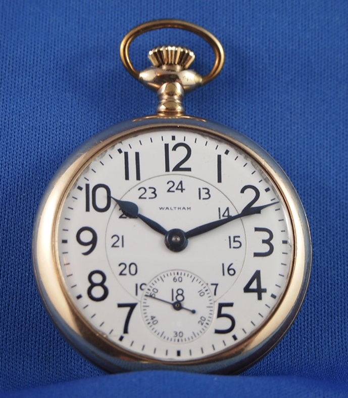

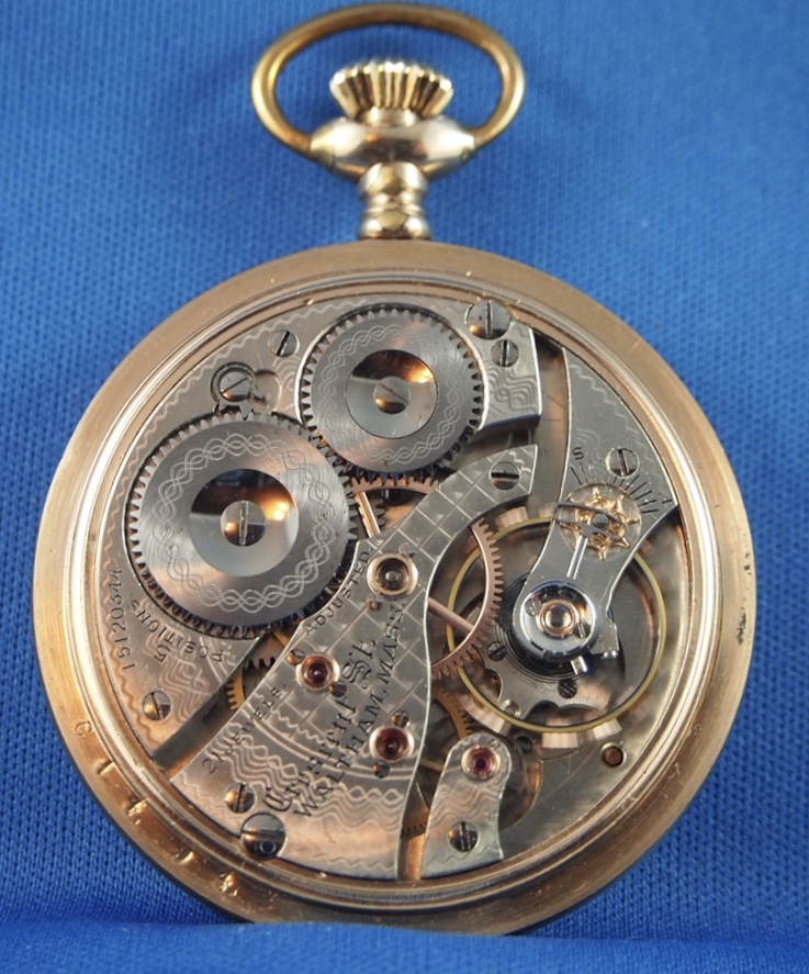

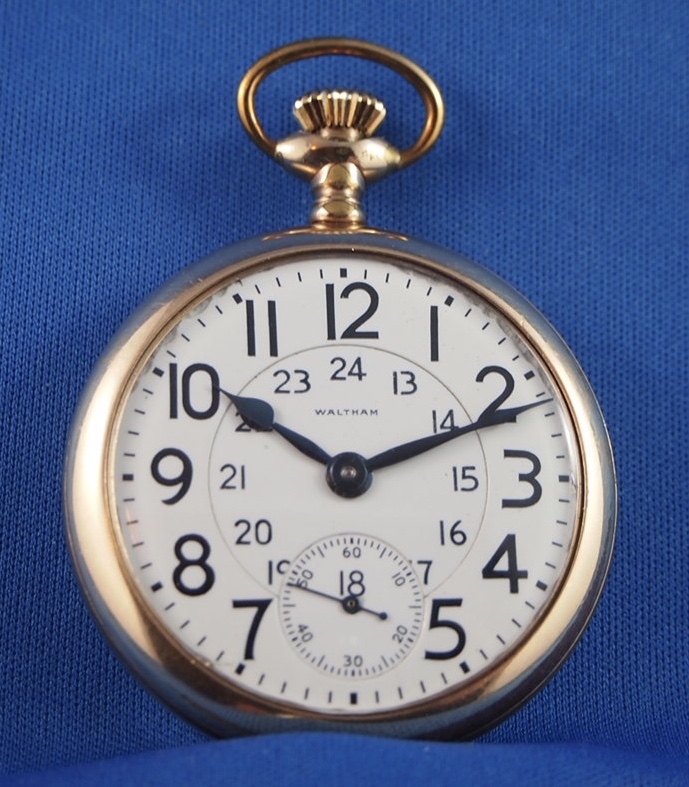

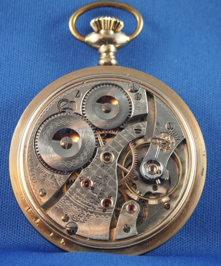

I have several Waltham Crescent Street pocket watches. The Waltham factory was located on Crescent Street, Waltham, Mass., in case you ever wondered. Waltham is now part of Boston, Mass., as I understand it. From what I have read, the buildings still stand.
The Crescent Street grade was produced in 18-size models, from 15-jewels, to 21-jewels. And in 1870, 1883, and 1892 models. It was also produced in 16-size, 1899 and 1908 models, with 19 and 21-jewels. Details on the subject watch are here:
https://pocketwatchdatabase.com/search/result/waltham/15120344
There are apparently only minor differences between the 1899 model, and the 1908 model. Differences being in the construction of the motor barrel between the two, location of the setting lever (the setting lever on the 1908 model being at the 11:00 position), and minor differences in the bridge over the train wheels. The subject watch is an 1899 model, and is railroad approved. Double-sunk, vitreous enamel, 24-hour (Canadian) dial.
The 1899 and 1908 models in the Crescent Street, Riverside, Vanguard, and Maximus grades are (in my opinion) among the most attractive American-made watch movements. Even the lesser grades in these models are good lookers.

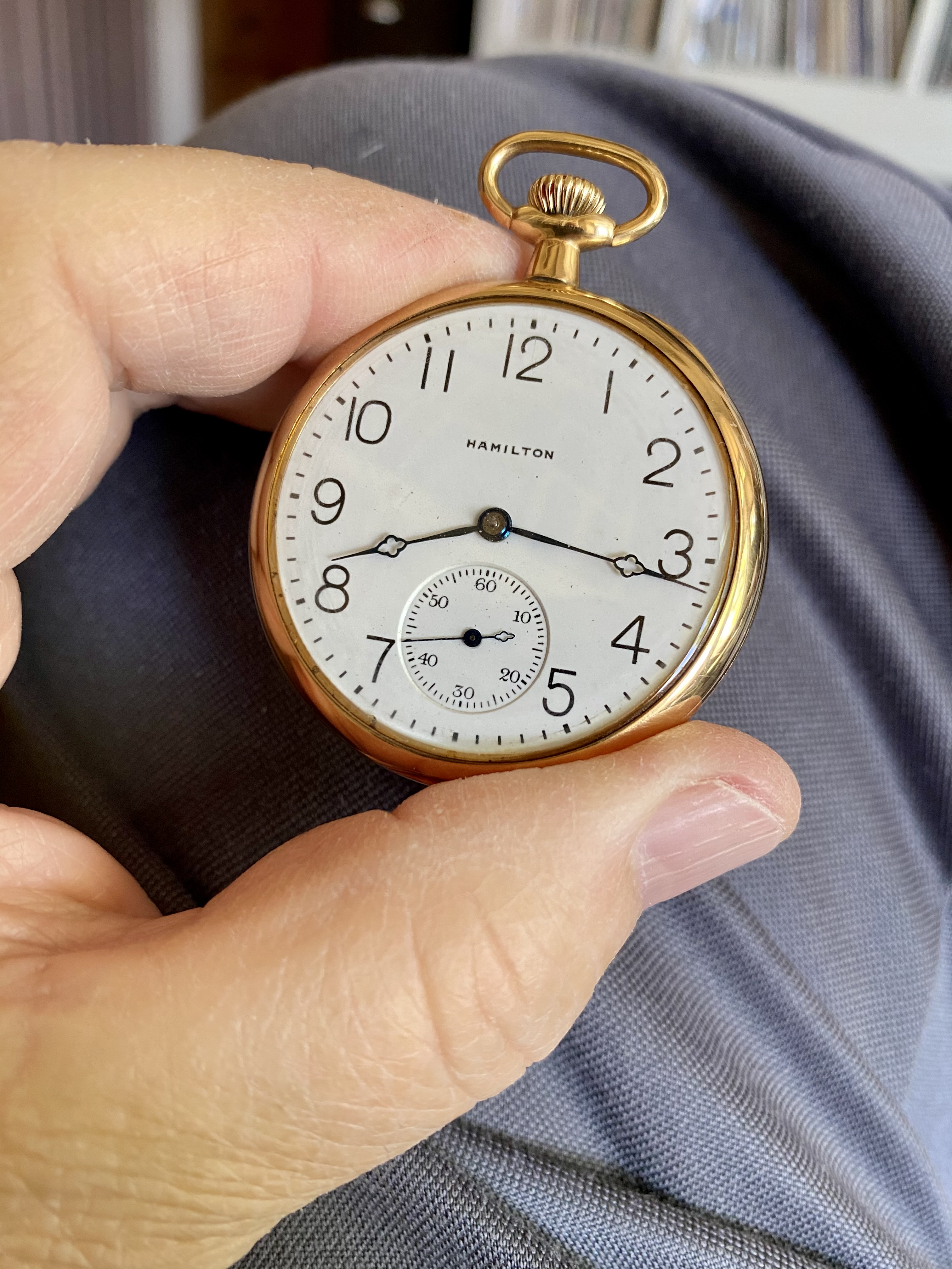

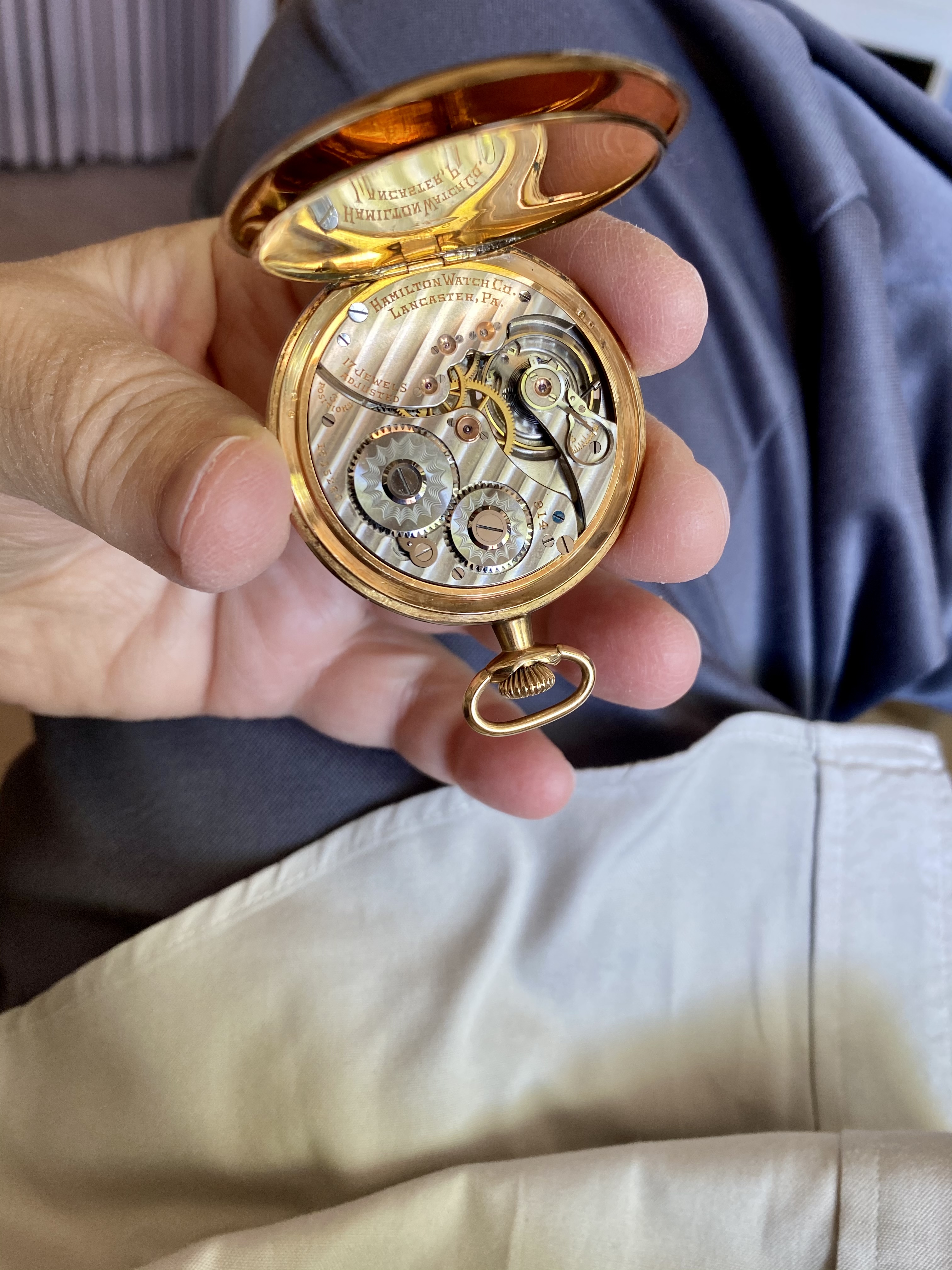

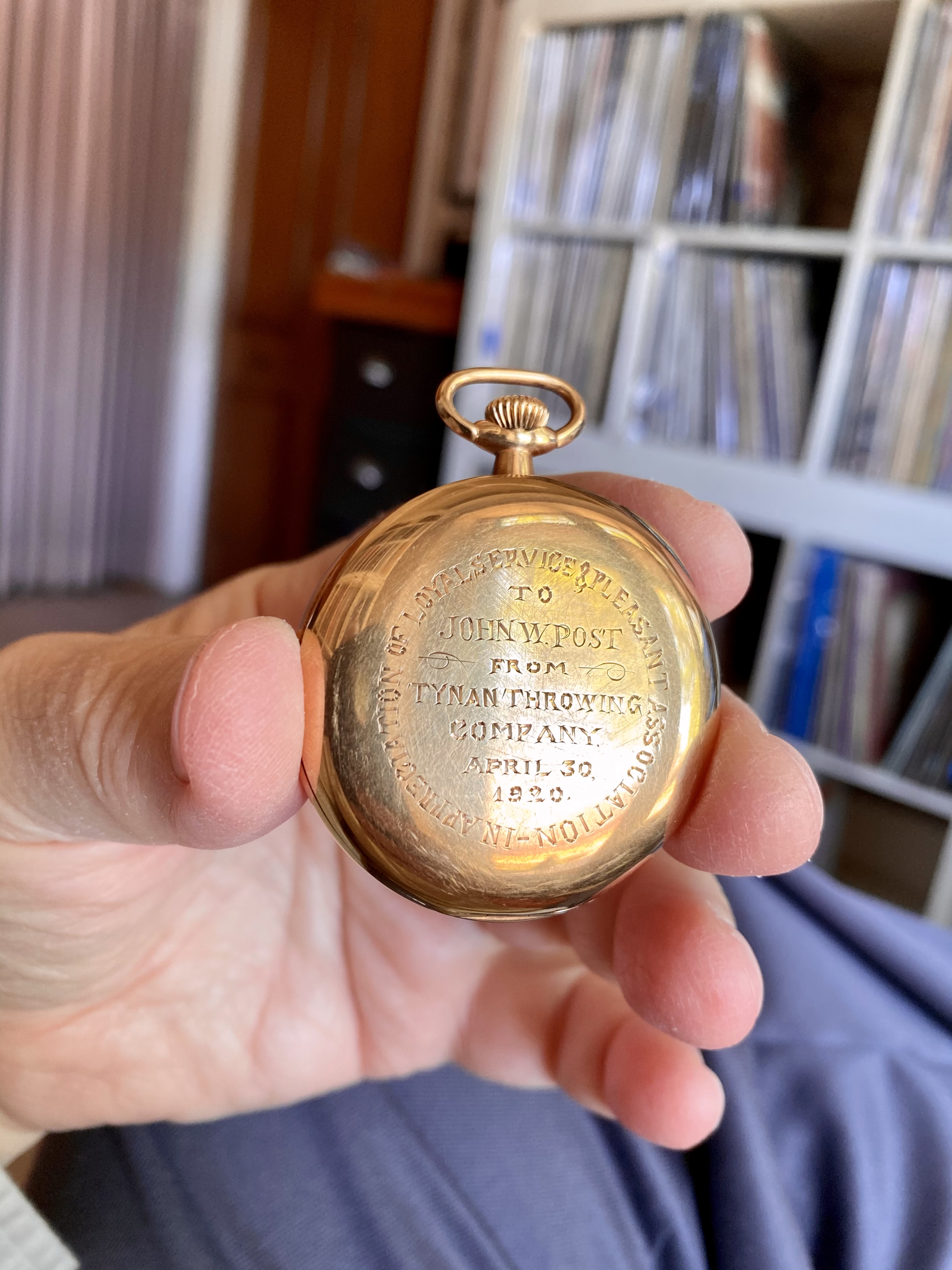

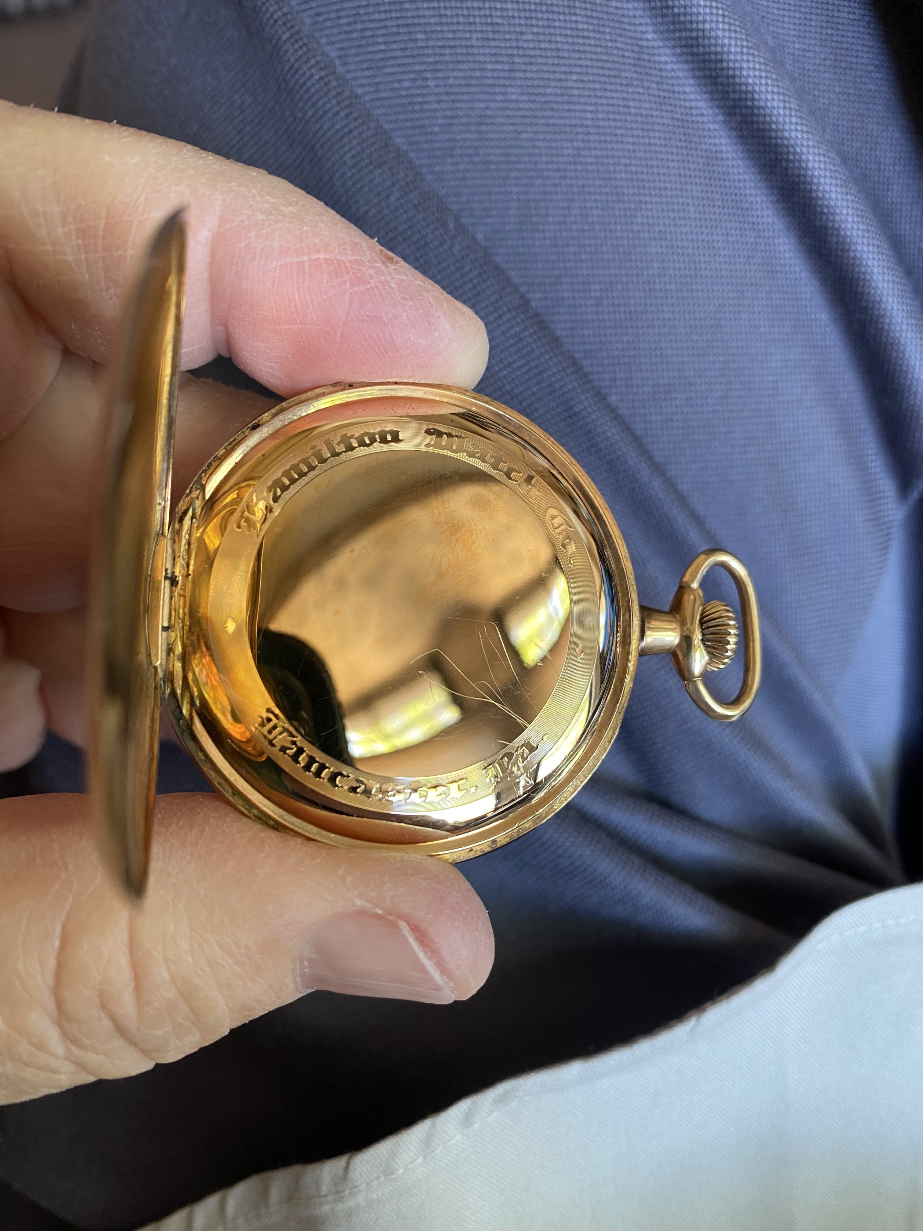

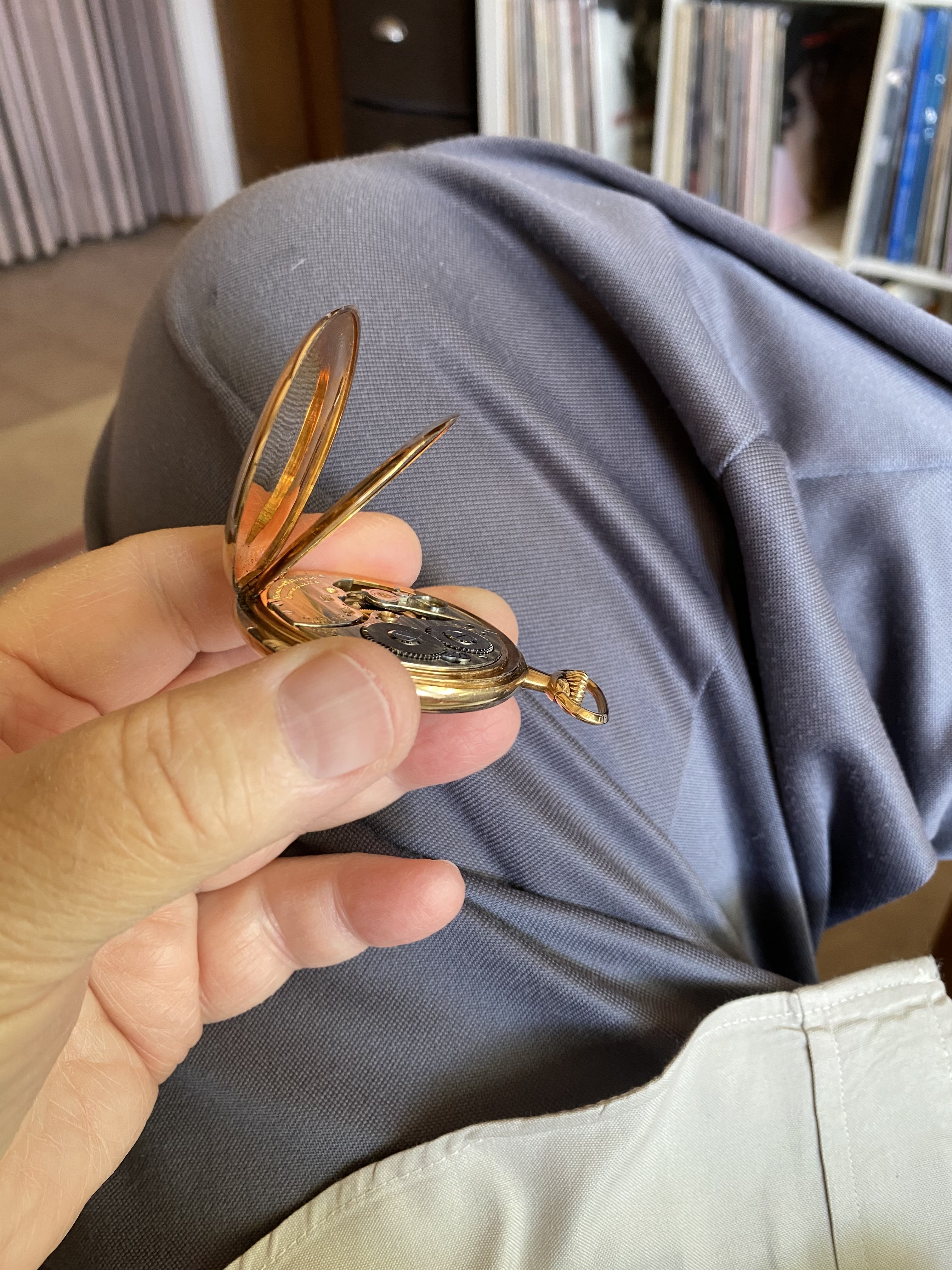

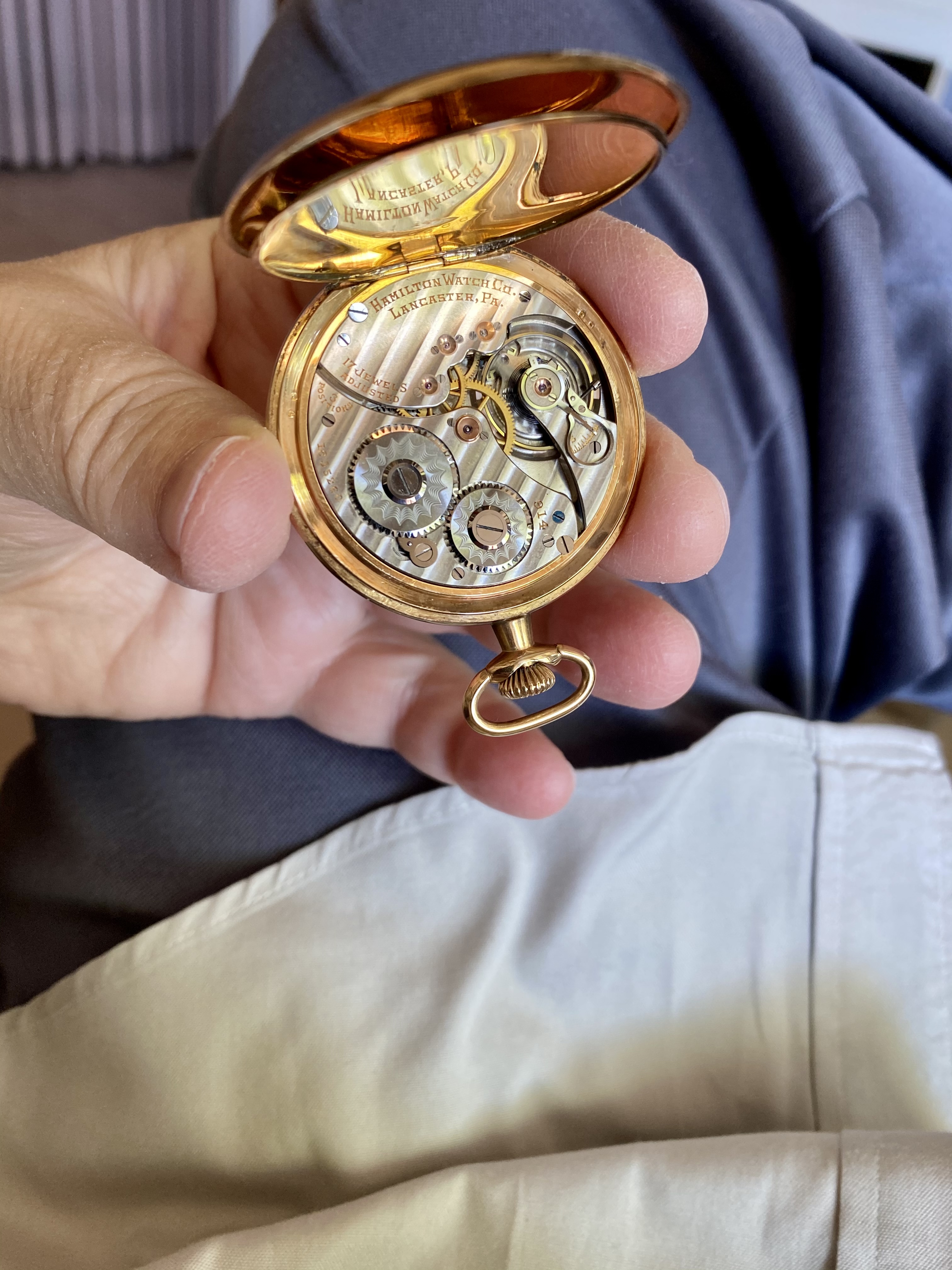

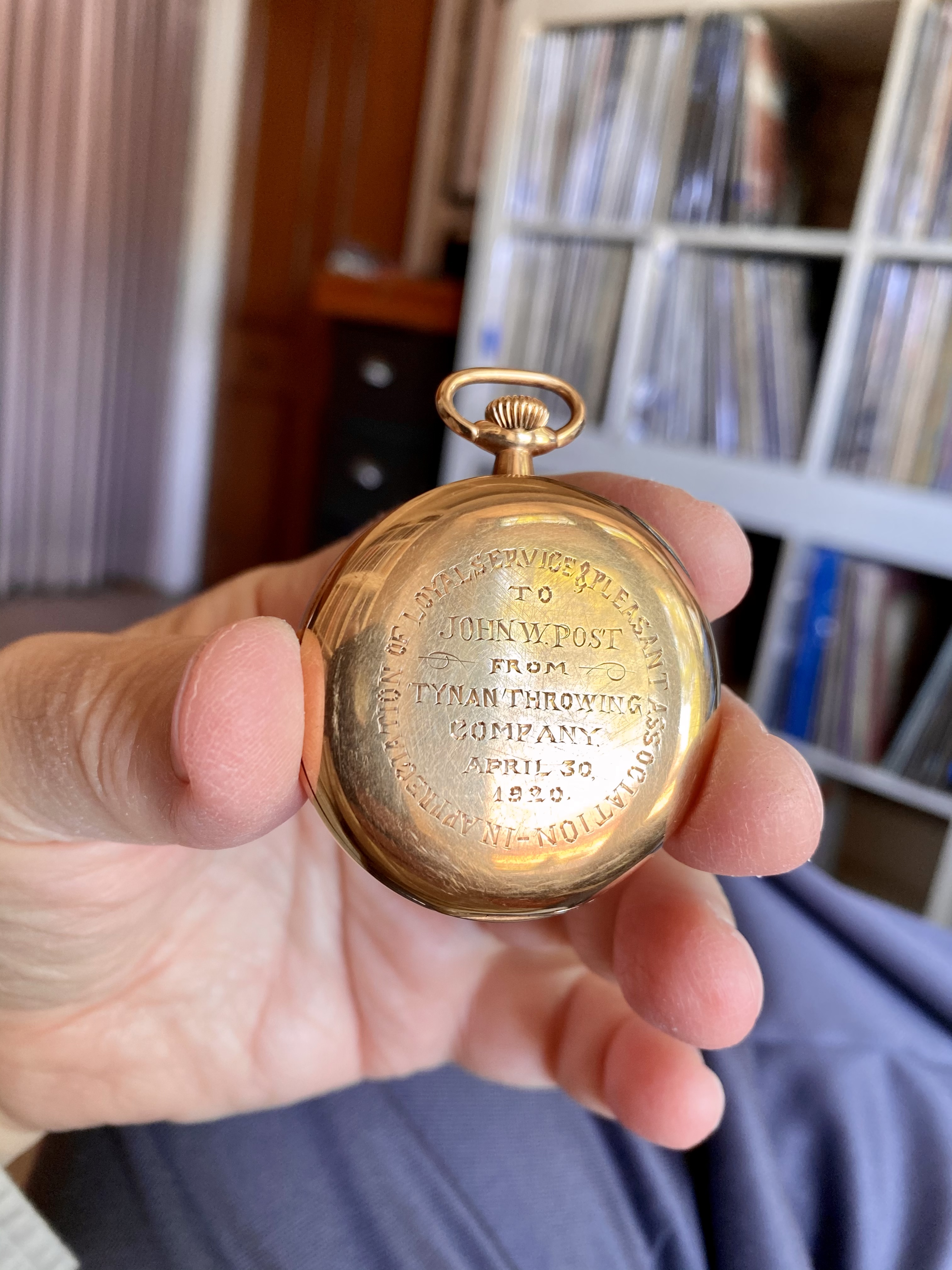

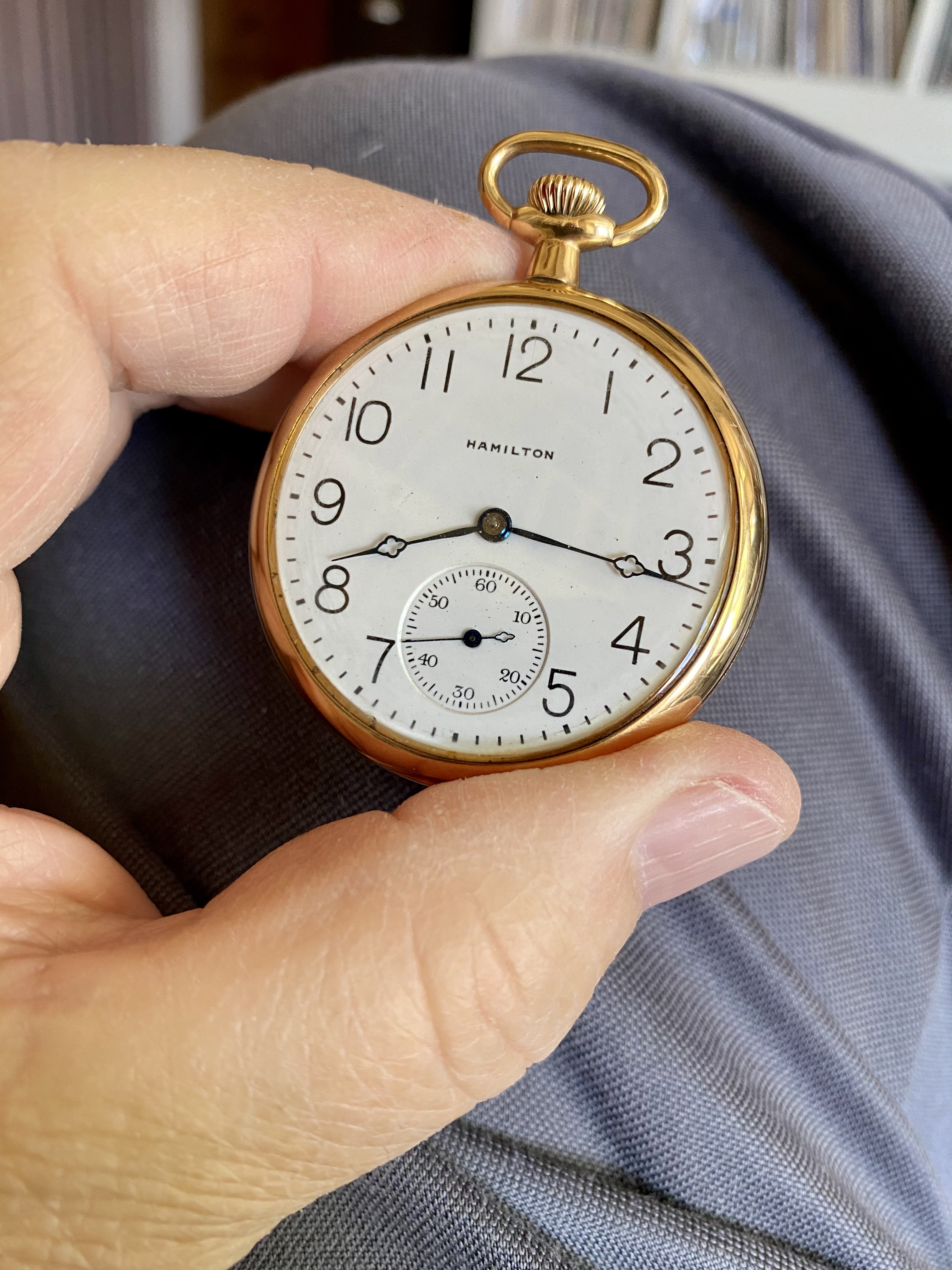

Hamilton 12s
A nicely decorated Grade 914, pendant set, adj 3 positions, 17j, circa 1918

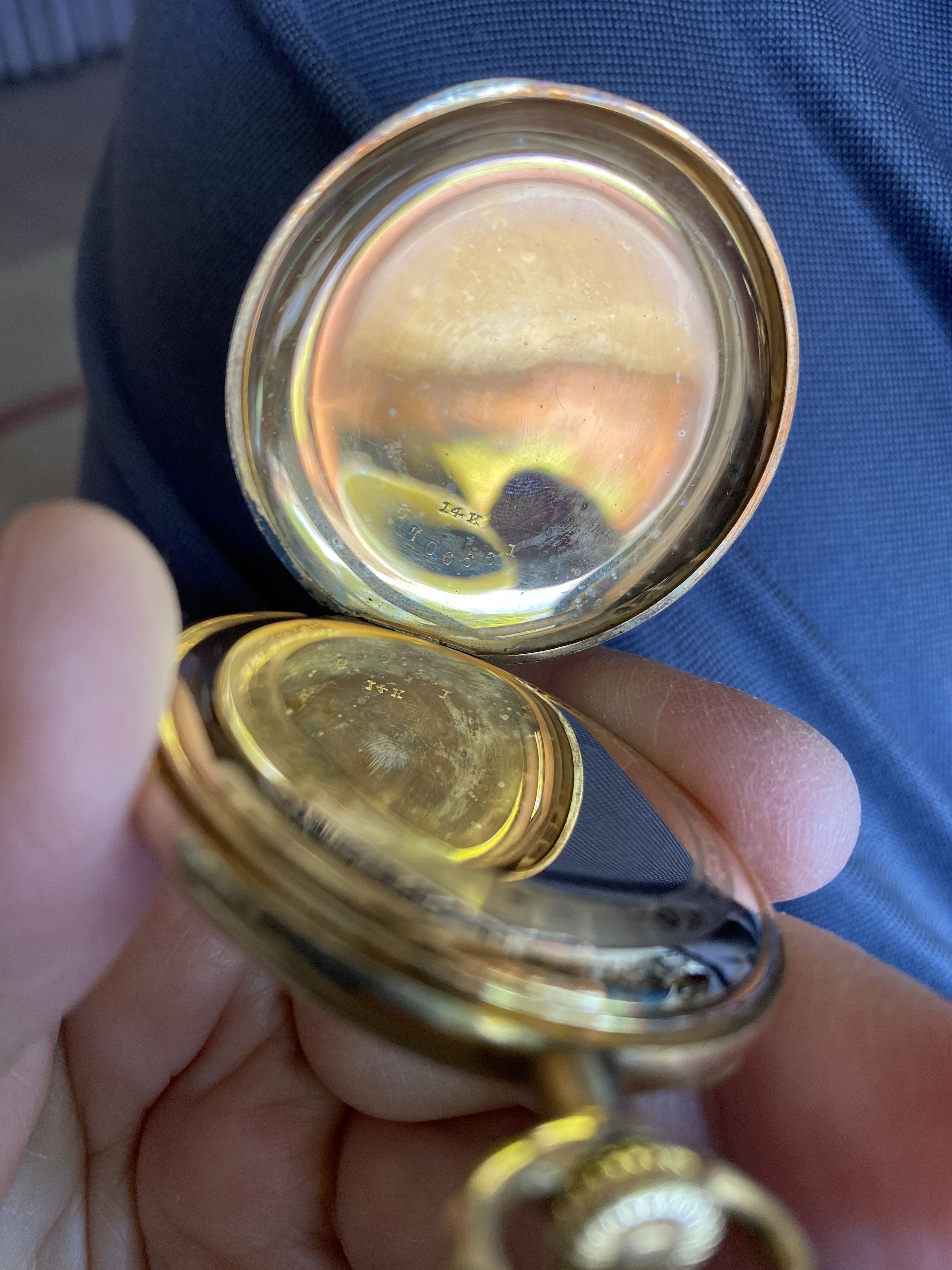

14kt Hamilton case with a nice presentation especially the " & Pleasant Association"
Gothic blued Hands
15,997
48,116
By about 1920, full-sized pocket watches had slumped in market share, in favour of the 12-size like @TexOmega ‘S fine example of a Hamilton 914. Of course, the full size (16-size) was still favoured for railroad use. And there were still lots of full size pocket watches in use, but the 12-size models were rapidly overtaking them in sales.
Doing a Google search, I have sort of concluded that a “Throwing” company had something to do with fabrics, or yarns.
Your Hamilton 914 is a few short days away from being 101 years old. The 14-karat case is in remarkable condition.

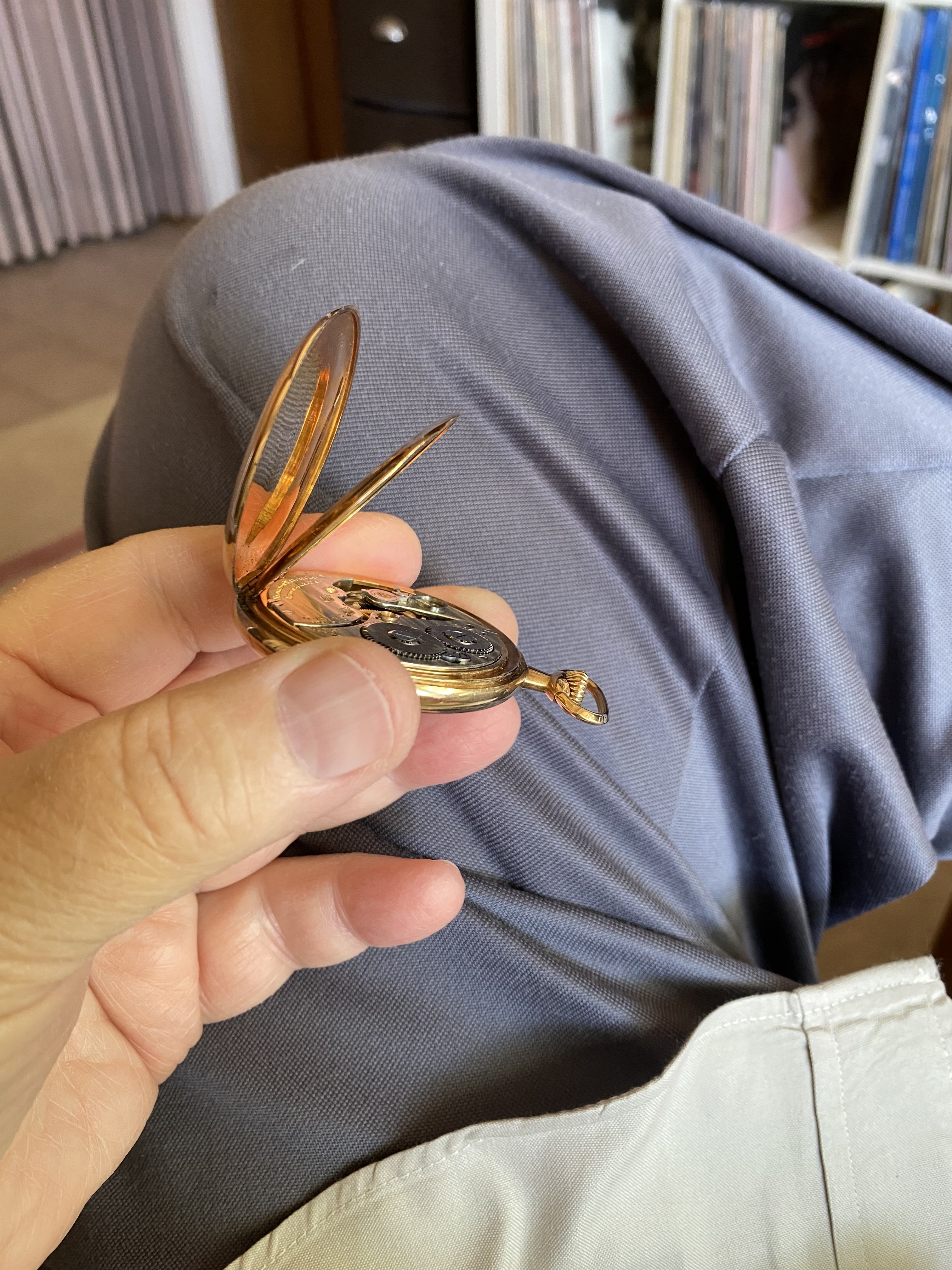

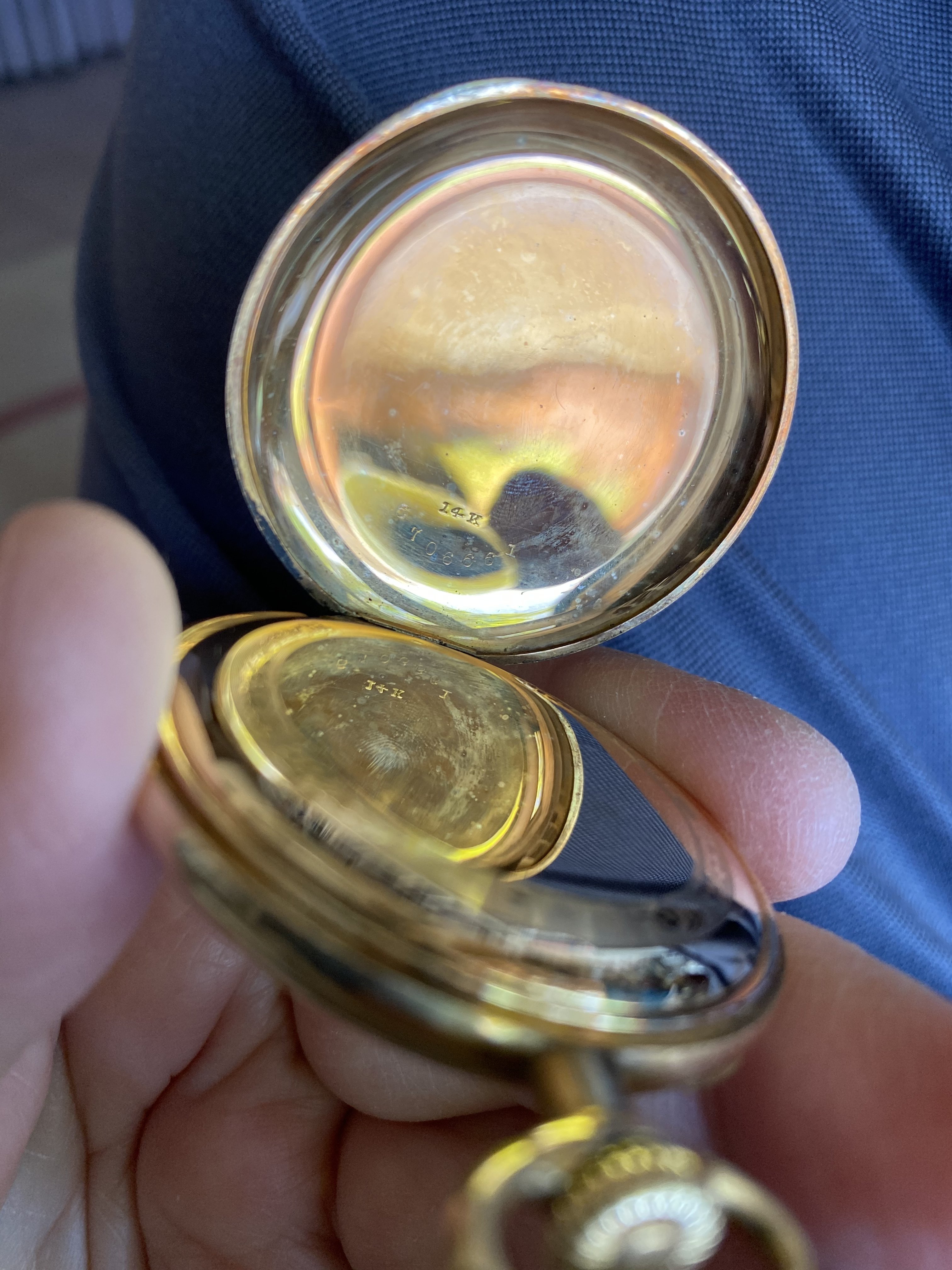

I'm recovering from the second Moderna vaccination, taken Wednesday afternoon, so am lurking online and looking at watches.
These "salesman's samples" that are found on Ebay auctions; are they for real or in some instances have the backs been damaged/lost and they've been fitted with a clear back? Seems reasonable to expect that such creations were produced back in the day. Also seems probable that they would be contrived in later times. Are "salesmans' samples especially desireable? I believe I'd prefer a standard back.

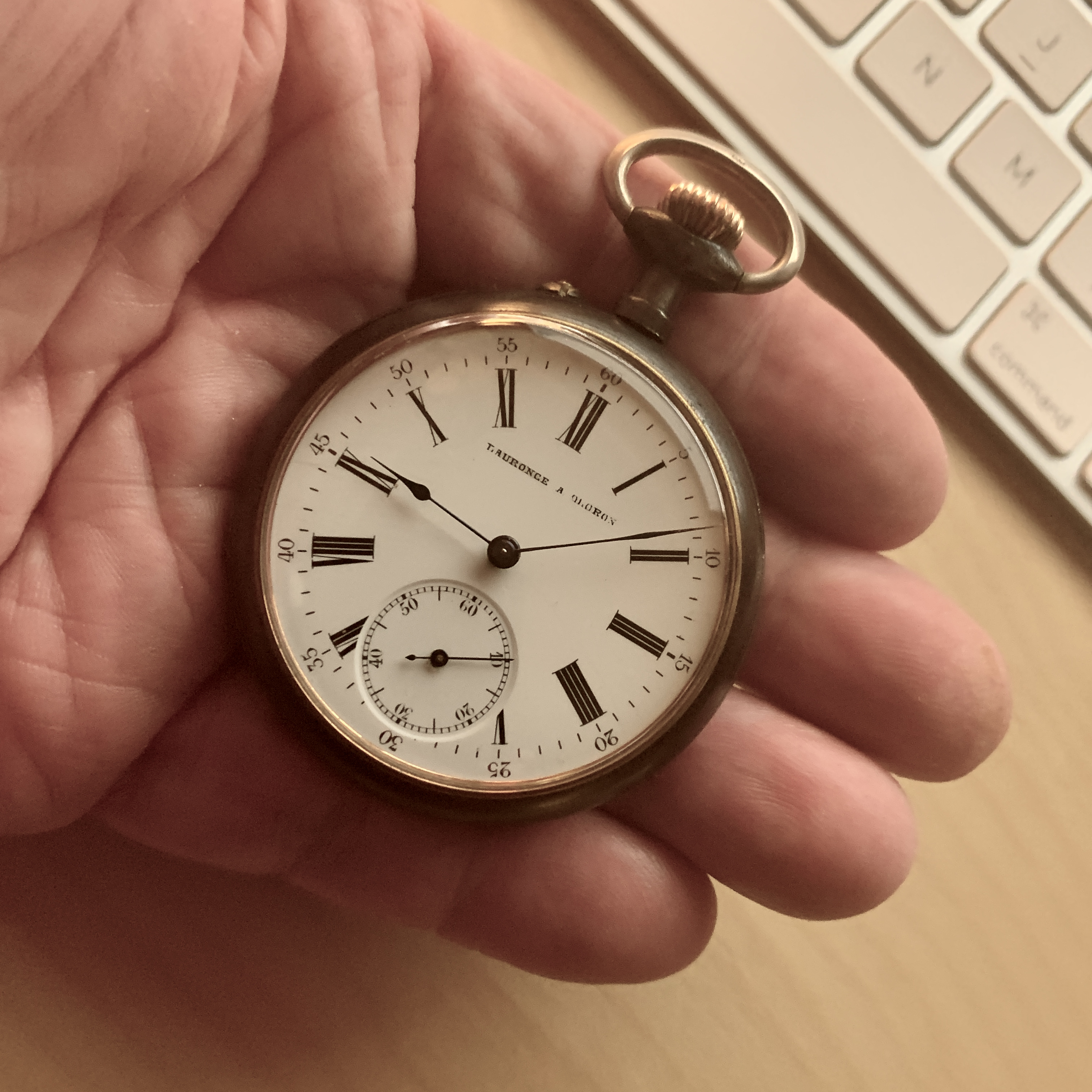

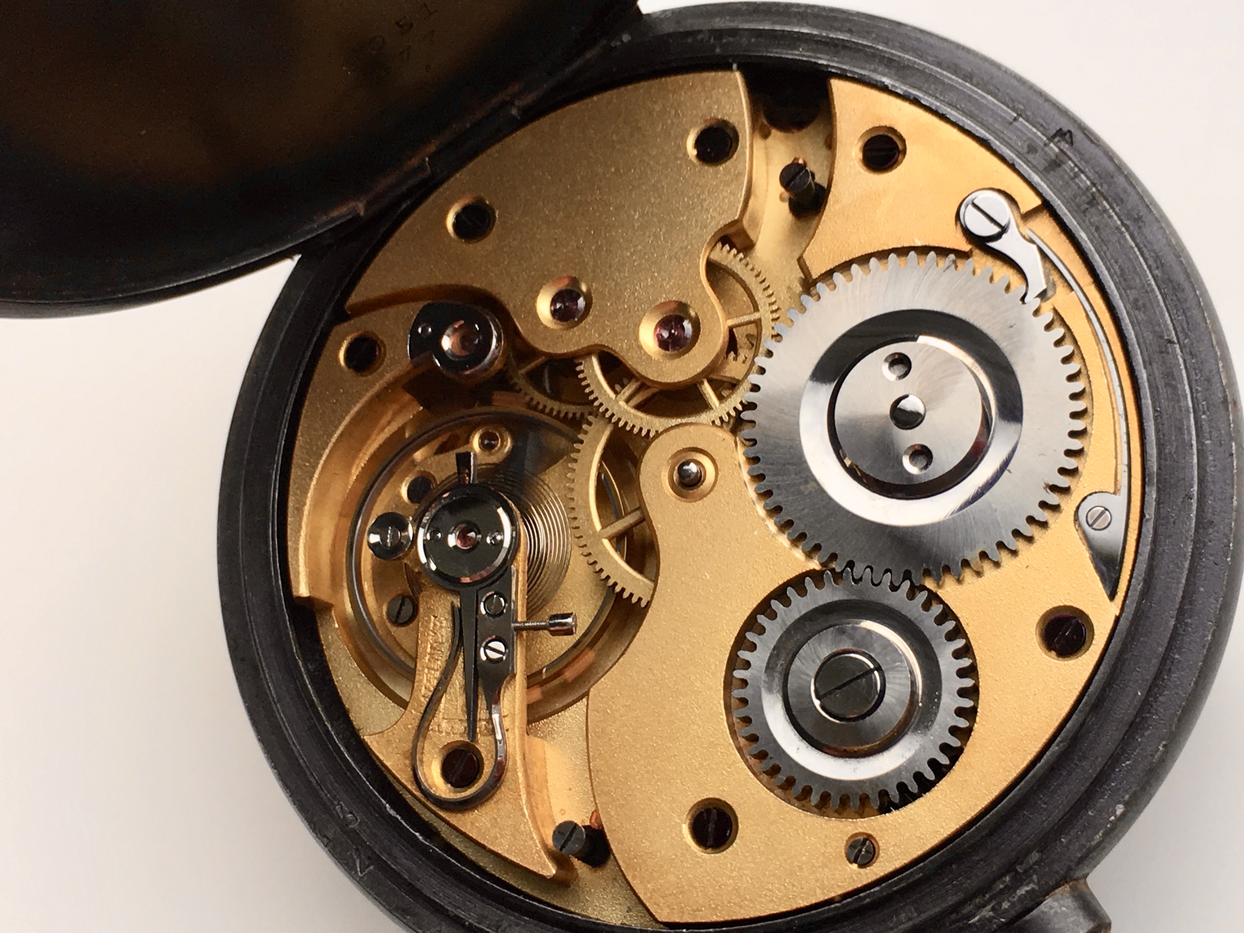

Certainly not a 'Buff' with only this one which has made an occasional appearance in the past and tonight out it comes again 😀

Appears to be a salesman's/display case to me with the snap on bezels.
Manufacture's name may be polished off.... but they could have made generics, too.
That's a high RR grade movement, so a precious metal cases were always sacrificed when recessions hit.
I think there is too much of a tendency to plumb others for their feelings about this and that. And to dither and fuddle about whether something is “original”, or not. The consequence is that a lot of collections are built that conform to what others like, or dislike, or call “mint”, “pristine” “as original”. Dammit, buy it if you like it! It’s your collection after all! As to display cases? These generally have a removeable back and bezel. If the back and bezel match, I’d say it’s about 90% guaranteed it is an original case. As to salesman’s display cases. They generally have the case embossed with the company name.

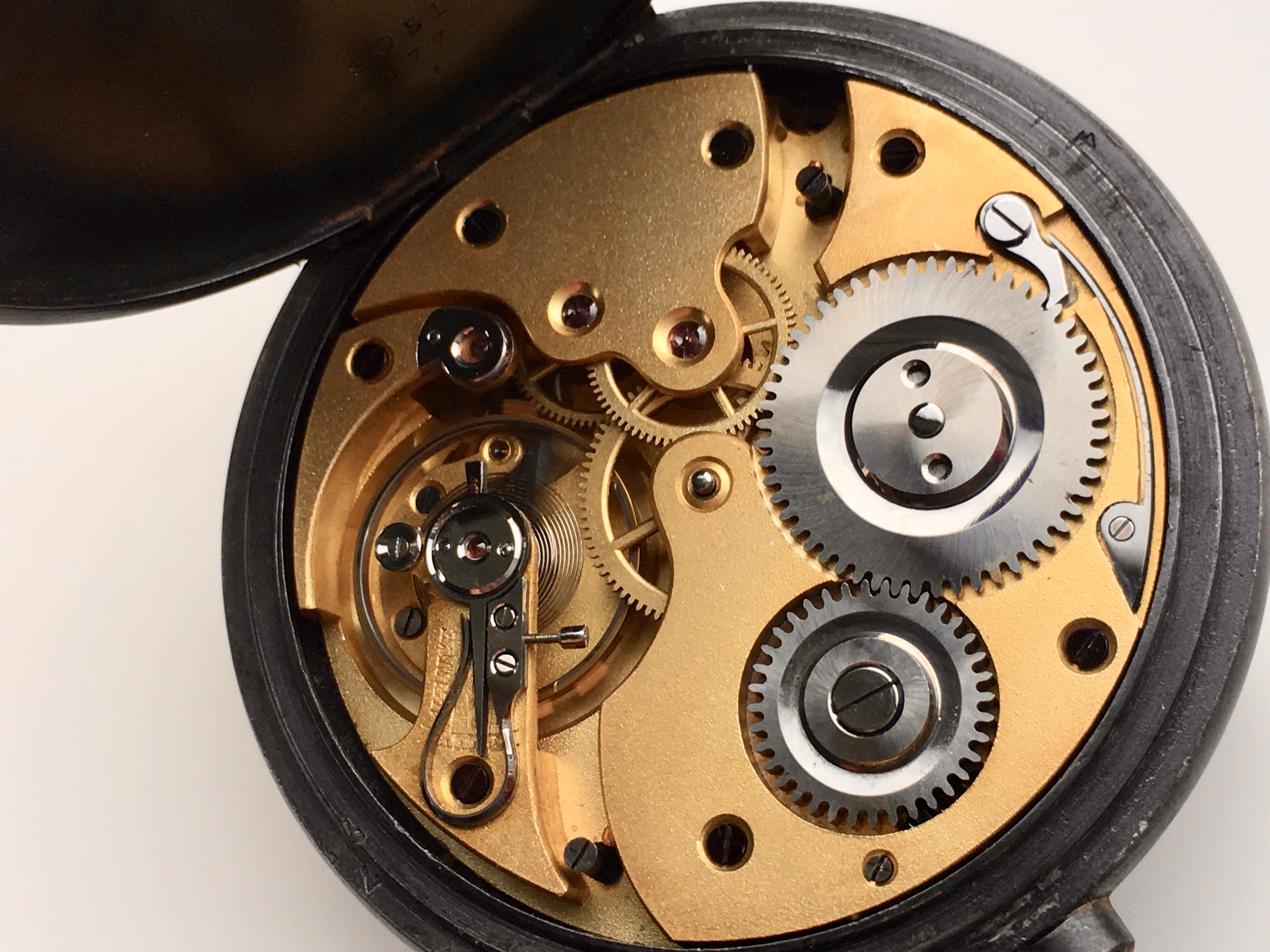

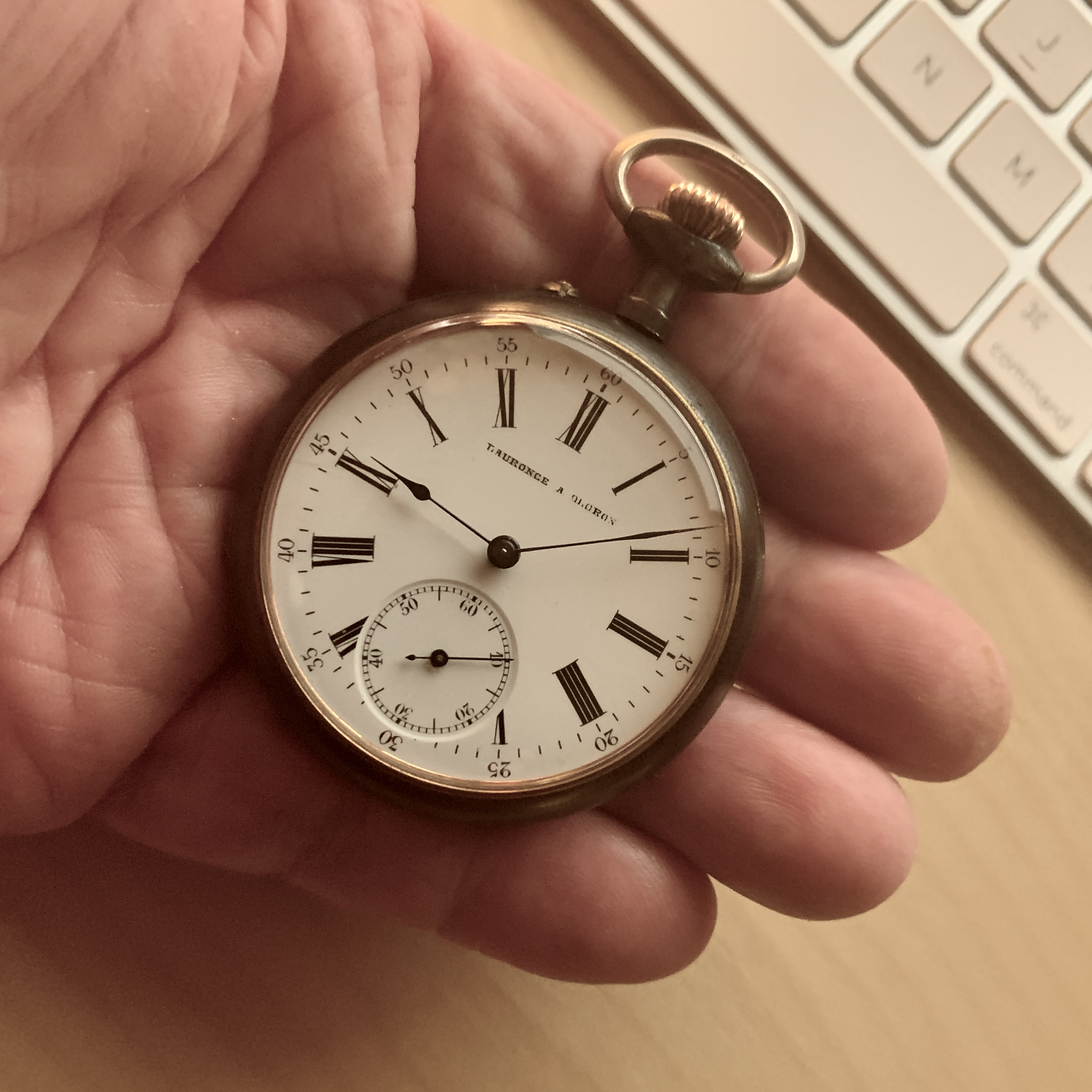

I’d say late 19th century, Swiss, pin/set, stem-wind, patent micrometer regulator, 15 or 17- jewels, Breguet hairspring, looks to be temperature compensating balance wheel, private label for a European jeweller, better than average grade and beautifully preserved. Is this a family piece? Whether you have one pocket watch, or half a gross, whether you have just one pocket watch to like, or half a gross to like, you are a pocket watch BUFF! And you’re welcome here. Thanks for showing us your unique watch!

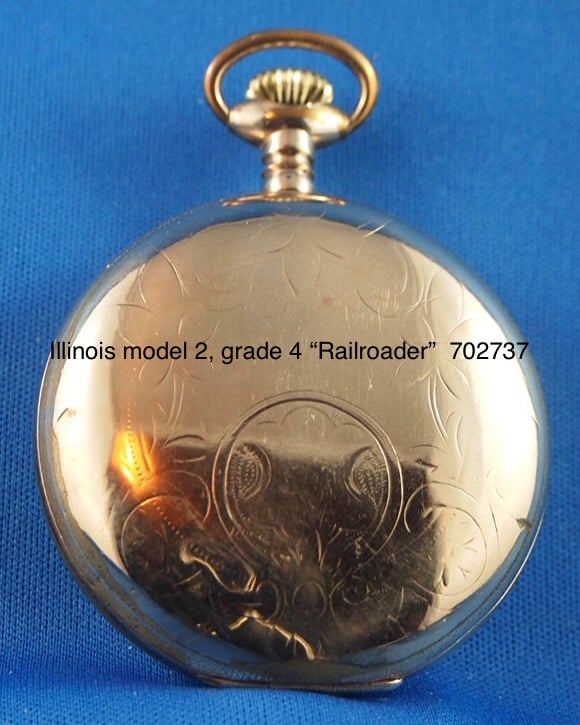

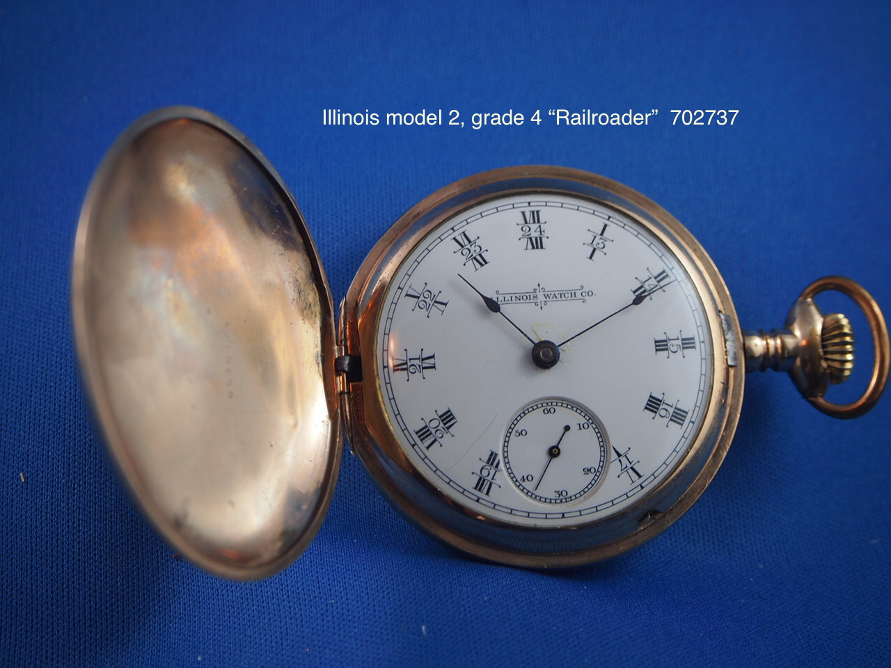

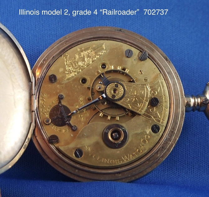

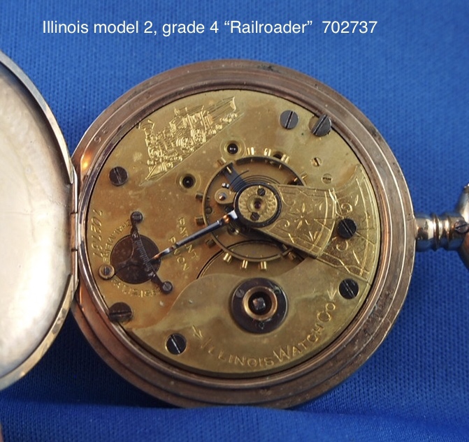

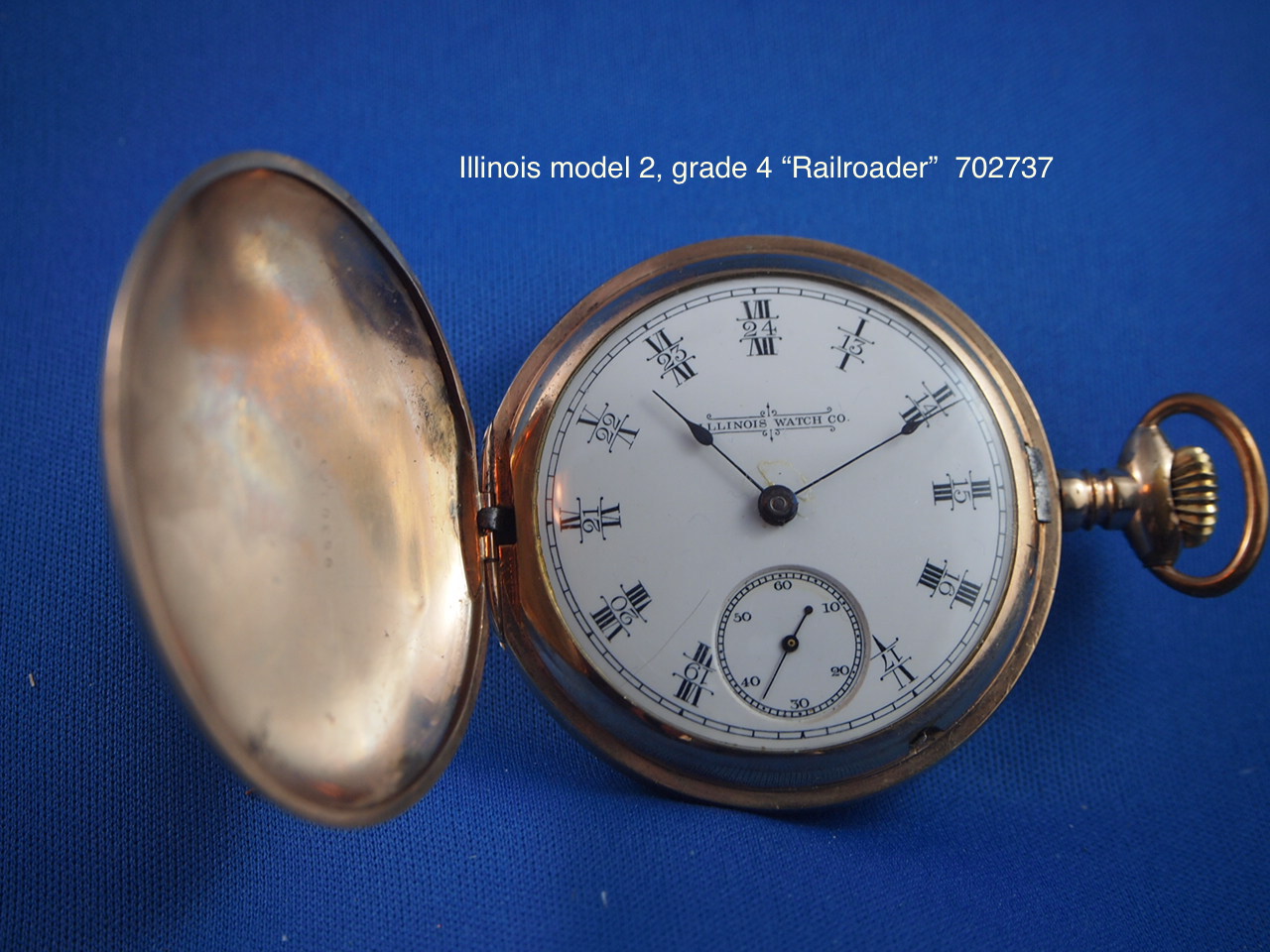

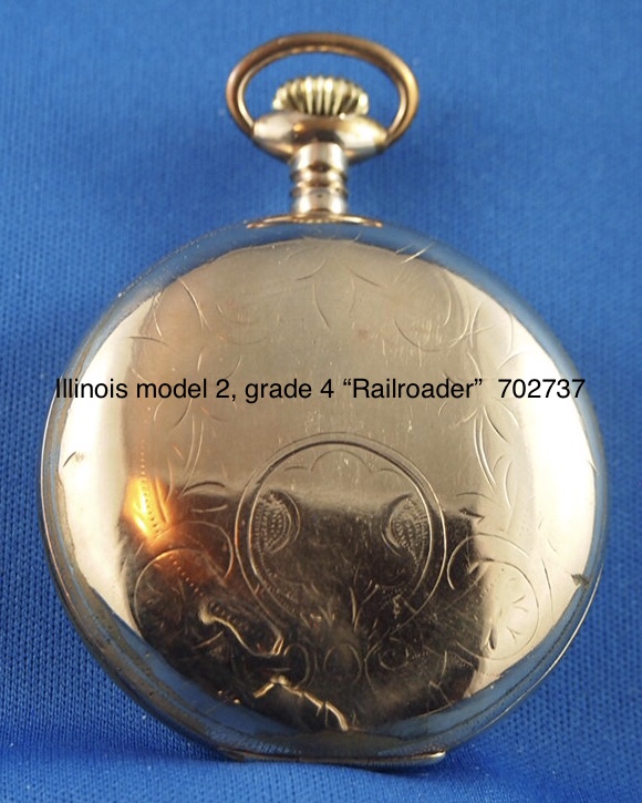

I have two model 2, grade 4, Illinois “Railroaders”. I have shown its “brother” about one month or so ago. So here is the second one. This is the only movement ever produced by Illinois that has an image engraved on the train bridge. These watches are known as “transitional” key winders in that the movement can be wound with the stem, or with a key. The type is often called “adaptable.” They can be cased as open faced or hunter cased key winders, or (as this one), hunter cased stem winders. The hand-engraved image is of a wood burning locomotive and tender. Since these were not railroad grade, one can but wonder what market Illinois was aiming this watch at. There were 4,500 of them made. This one has a scarce dial.
Here is the “skinny” on this watch.
https://pocketwatchdatabase.com/search/result/illinois/702737

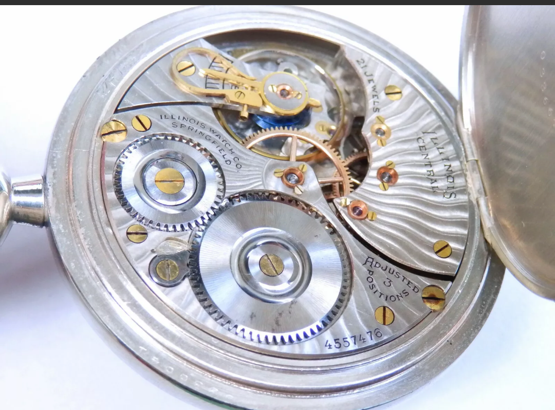

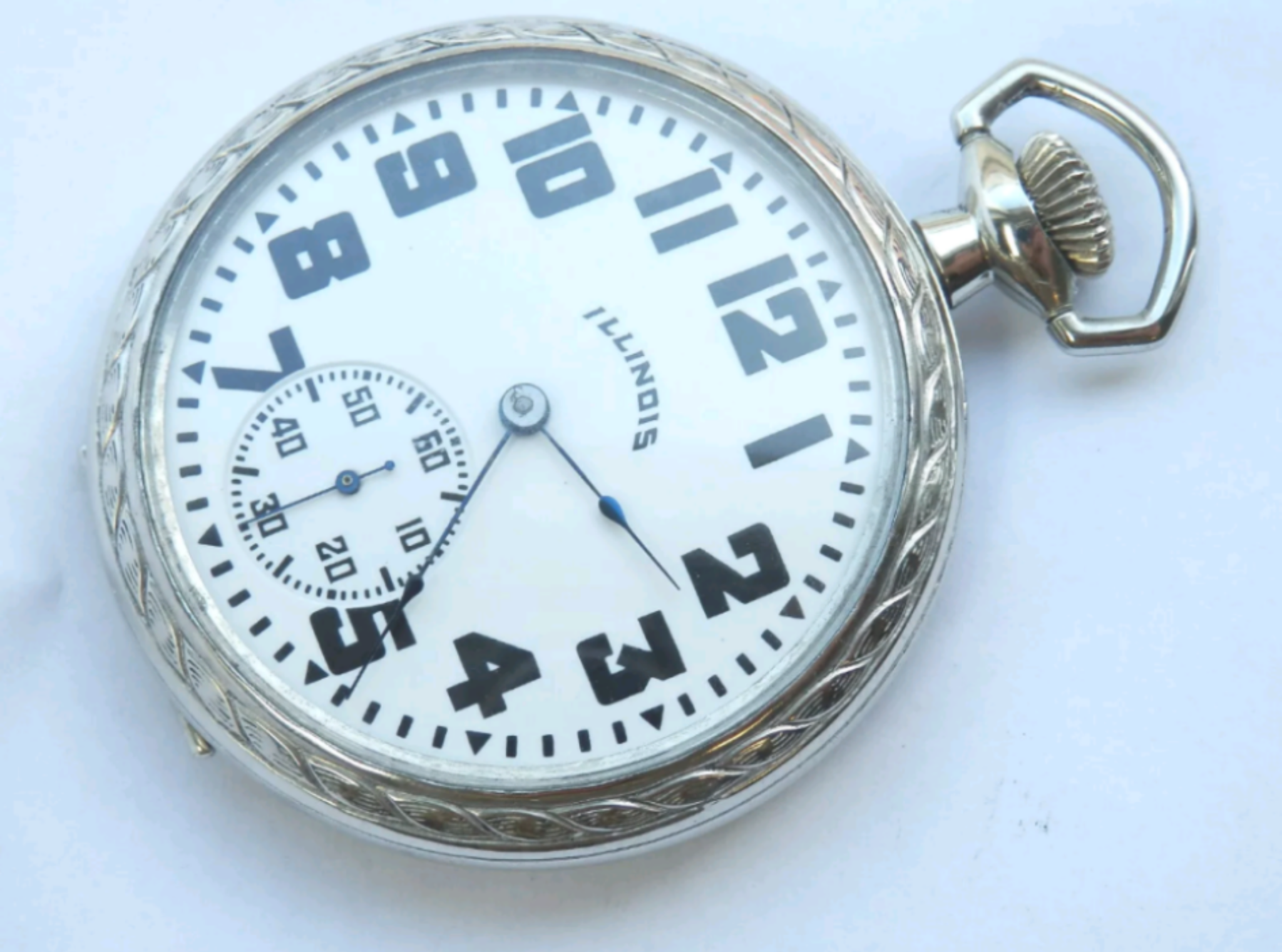

Guys,

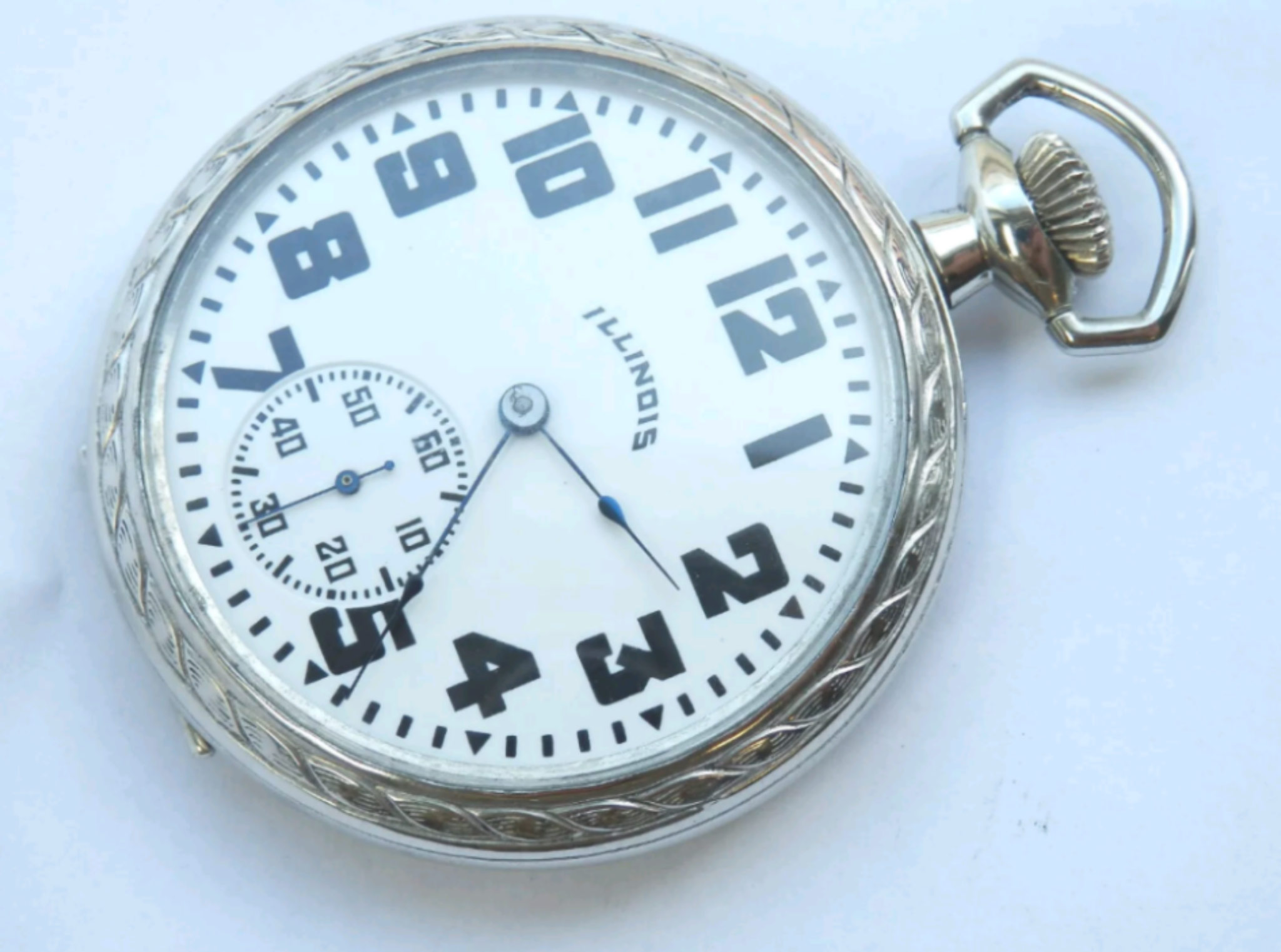

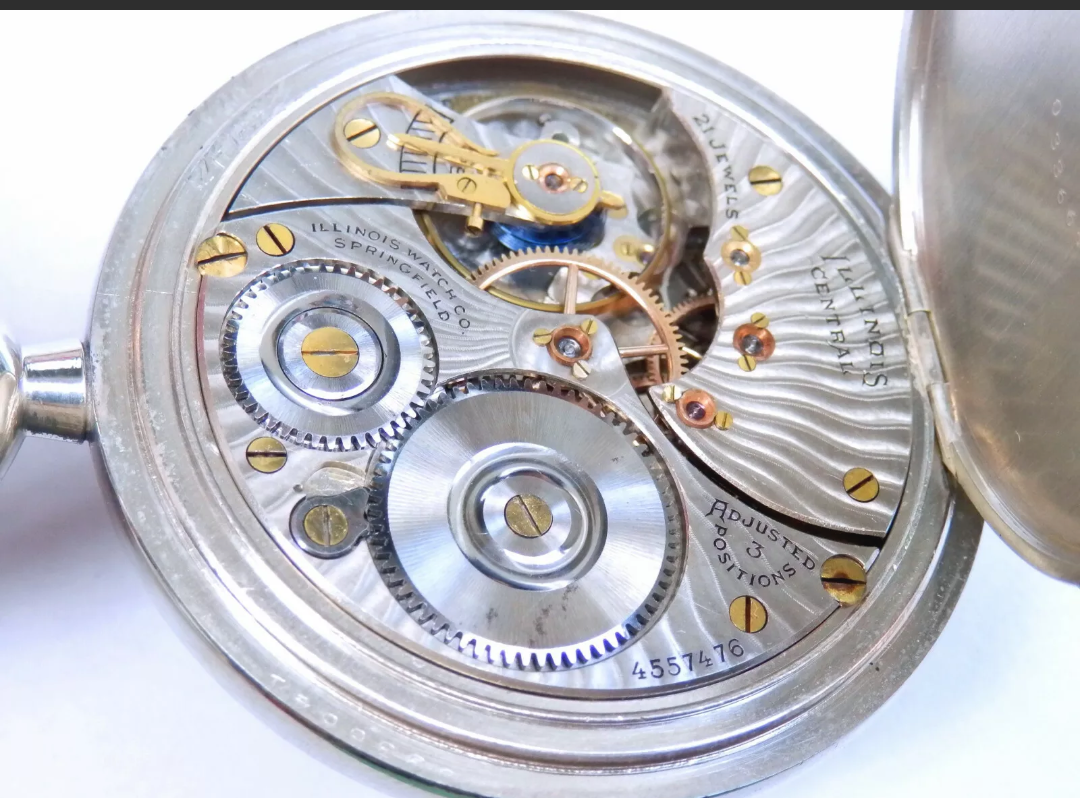

I'm checking a nice Illinois PW on eBay... It has an Illinois Central grade 606 movement, but dial only says Illinois.
Is this normal/accurate?
Thanks for your feedback 😀

@LesXL
Your PW dates past the point of a horizontal "ILLINOIS", so I say it is correct for the era.
This was the era where redials were impossible, they were fired and fused to the enamel.

@LesXL
Thanks, man!
I was more worried that it could be a dial placed on a wrong movement.
Nothing in the ads says it is a "project" watch but wanted to check with the PW experts.

Thanks, man!
Any Illinois dial with the correct feet location would "work" and every buyer could pick and choose IF THEY DID NOT REQUIRE A RR GRADE WATCH as a condition of employment.
Metal dials, enamel dials, fancy, plain.
Most of the worries with PW collecting is a swapped out case.......or as your question, is the dial correct for the era and movement.
