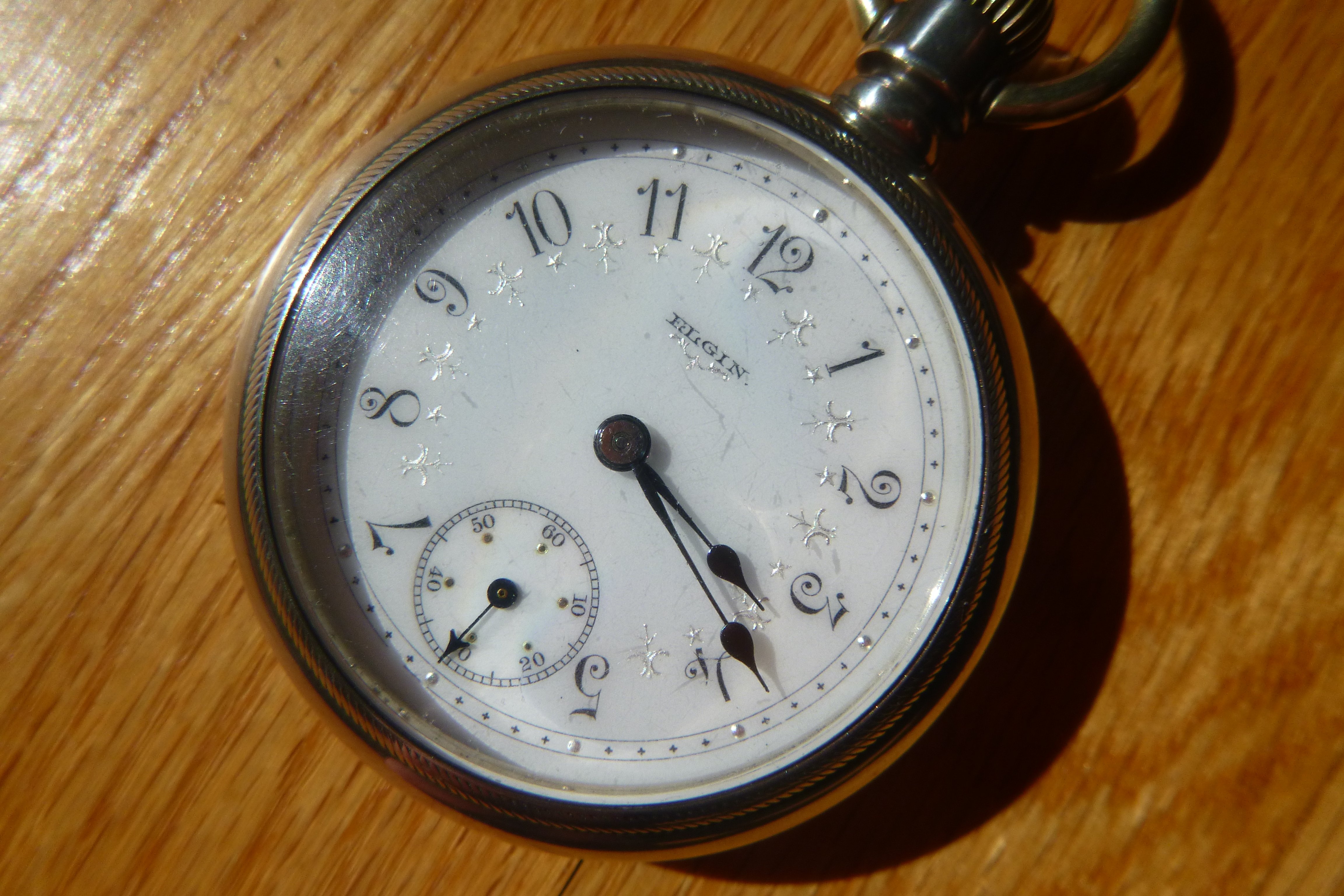

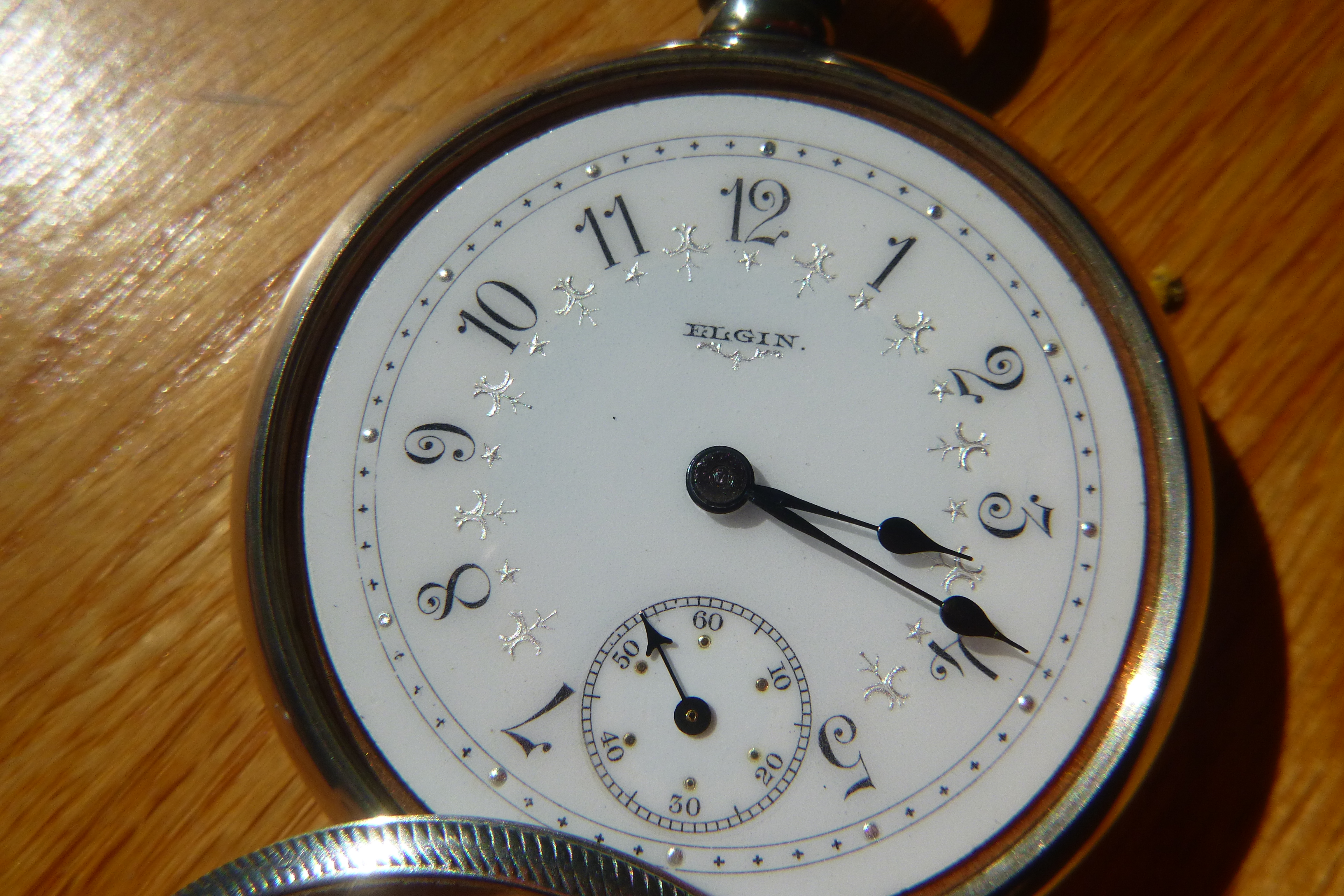

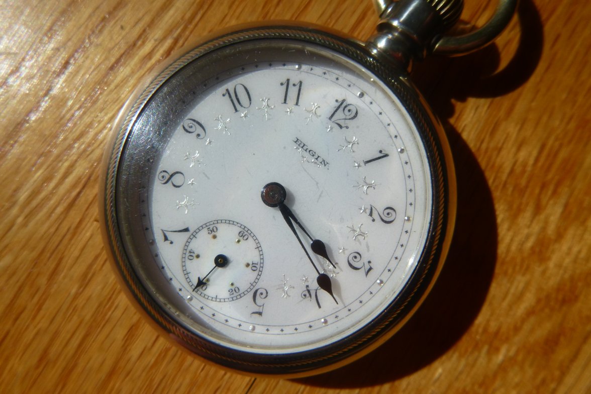

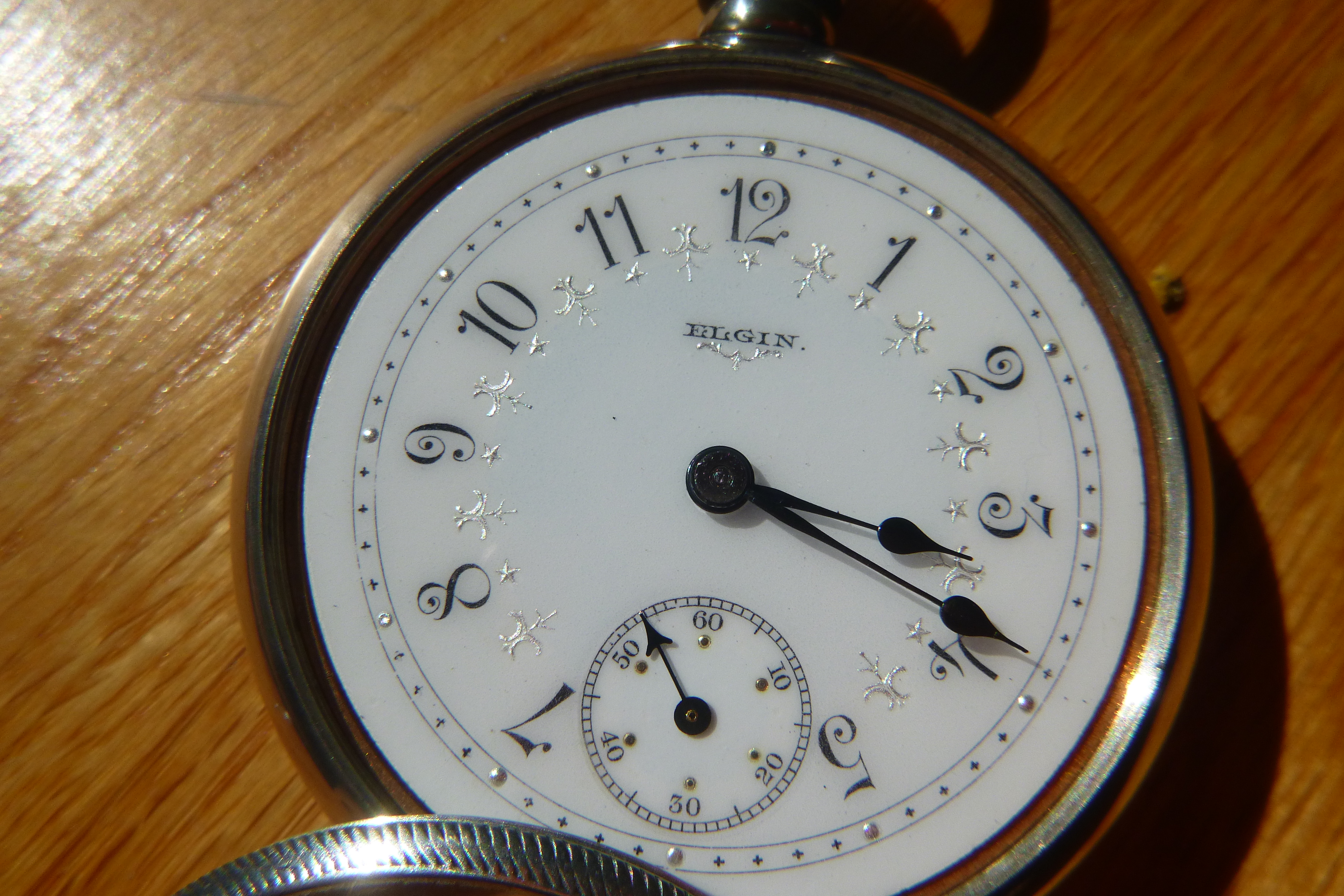

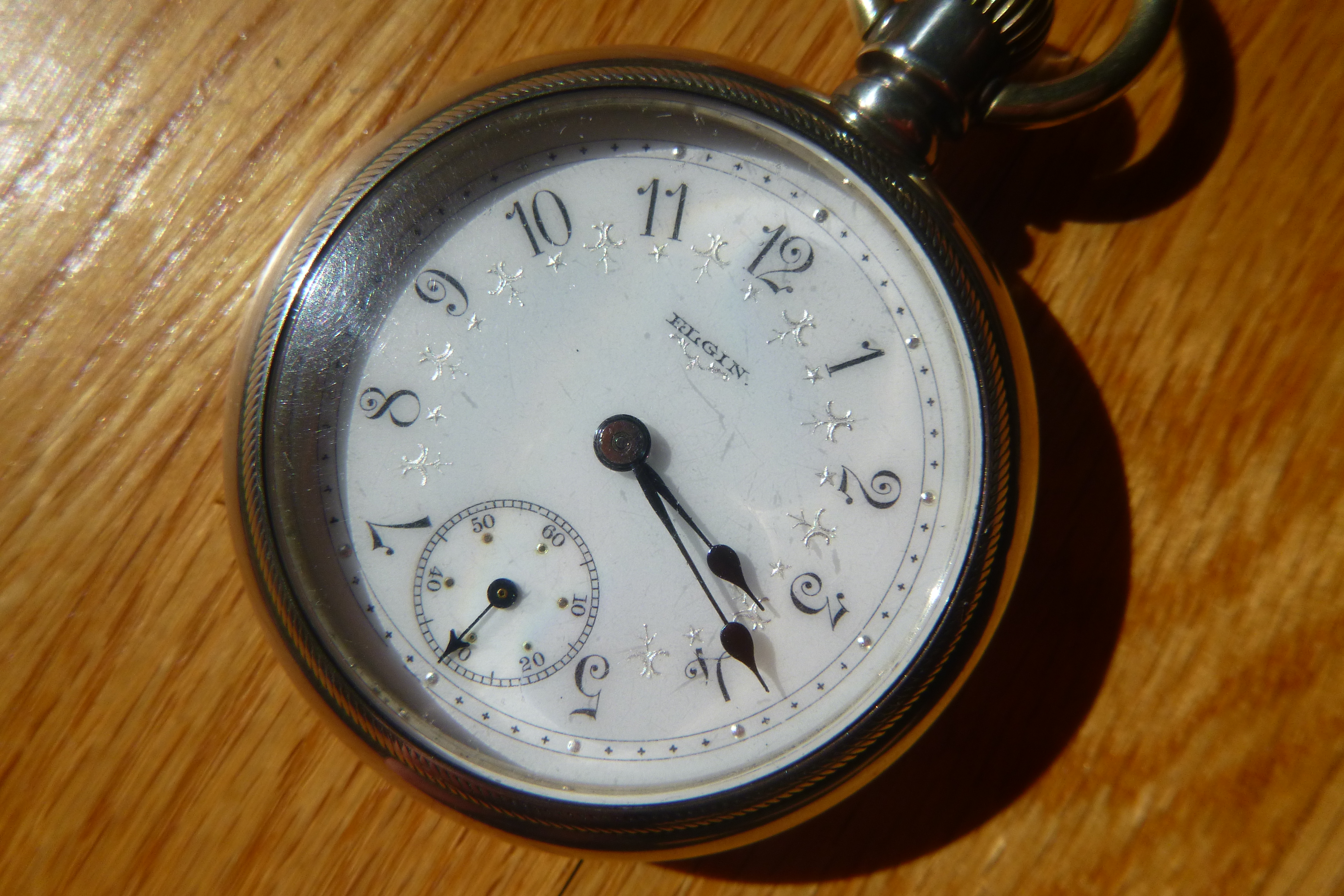

Its been a rough few days here at the Katzenjammer residence...
First this virtually NOS dial shows up in the mail, so I spent a pleasant hour fitting it to my silver cased 15j 18s Elgin movement.
Best seen with the bezel off as the crystal has seen better days (100 years ago!)

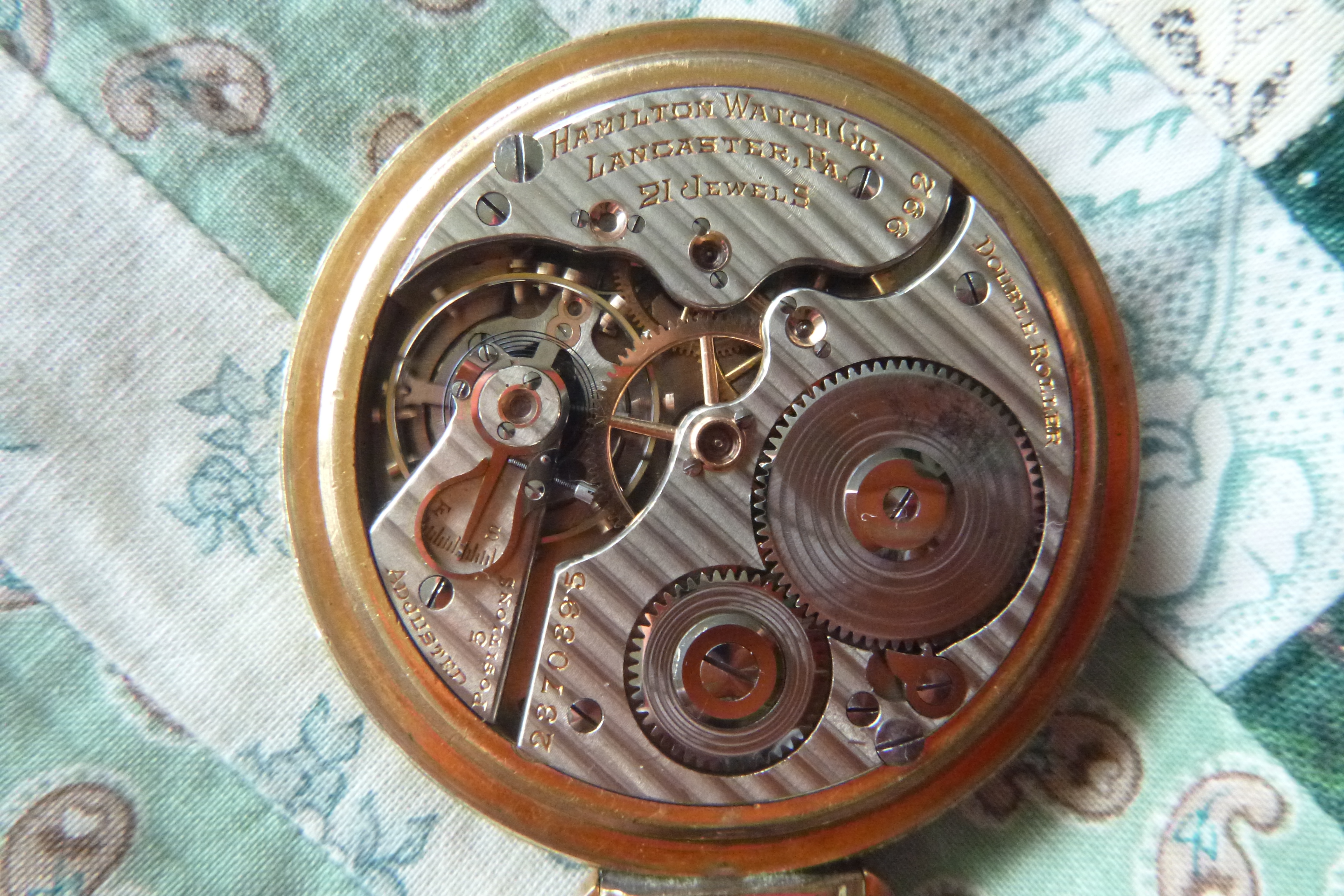

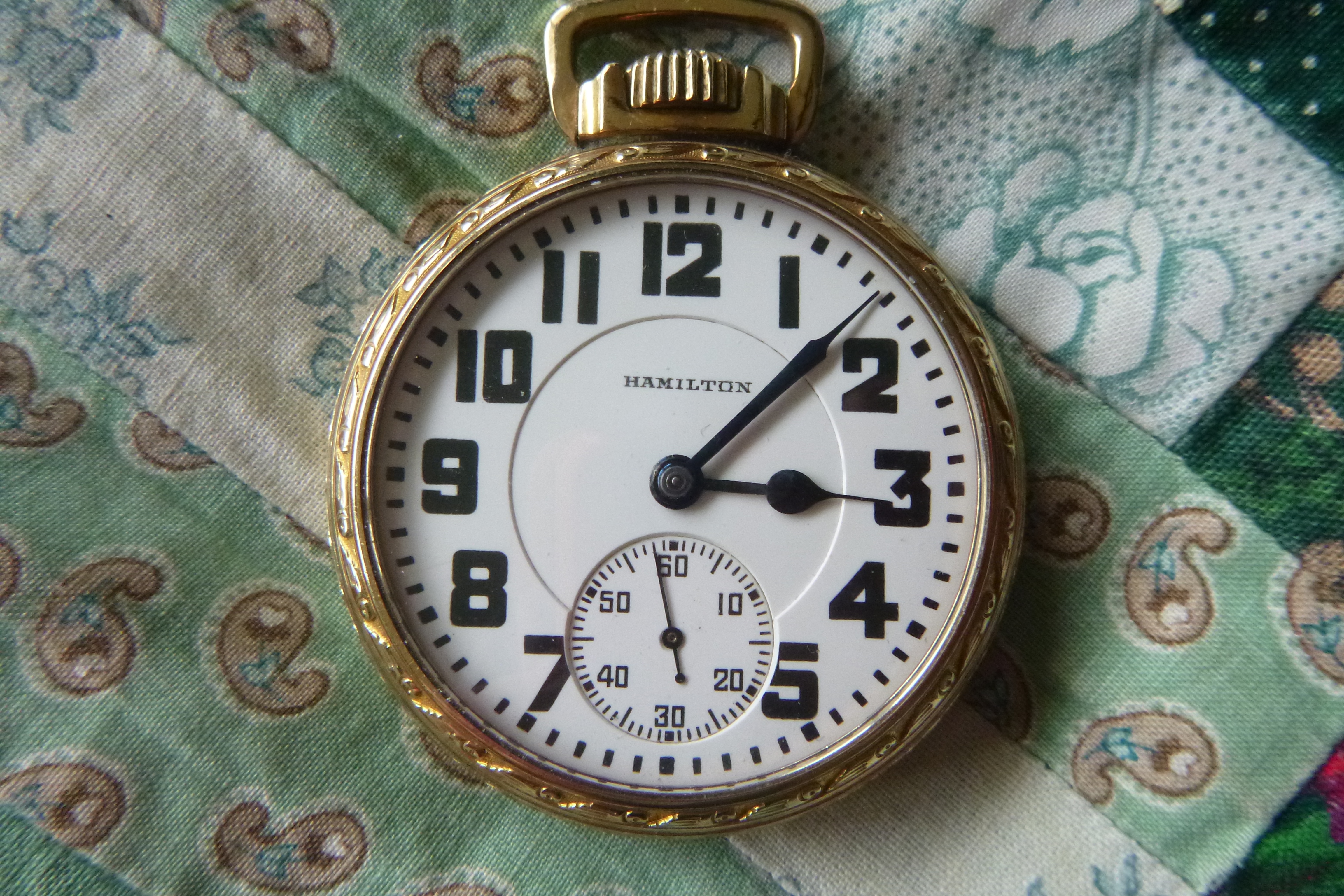

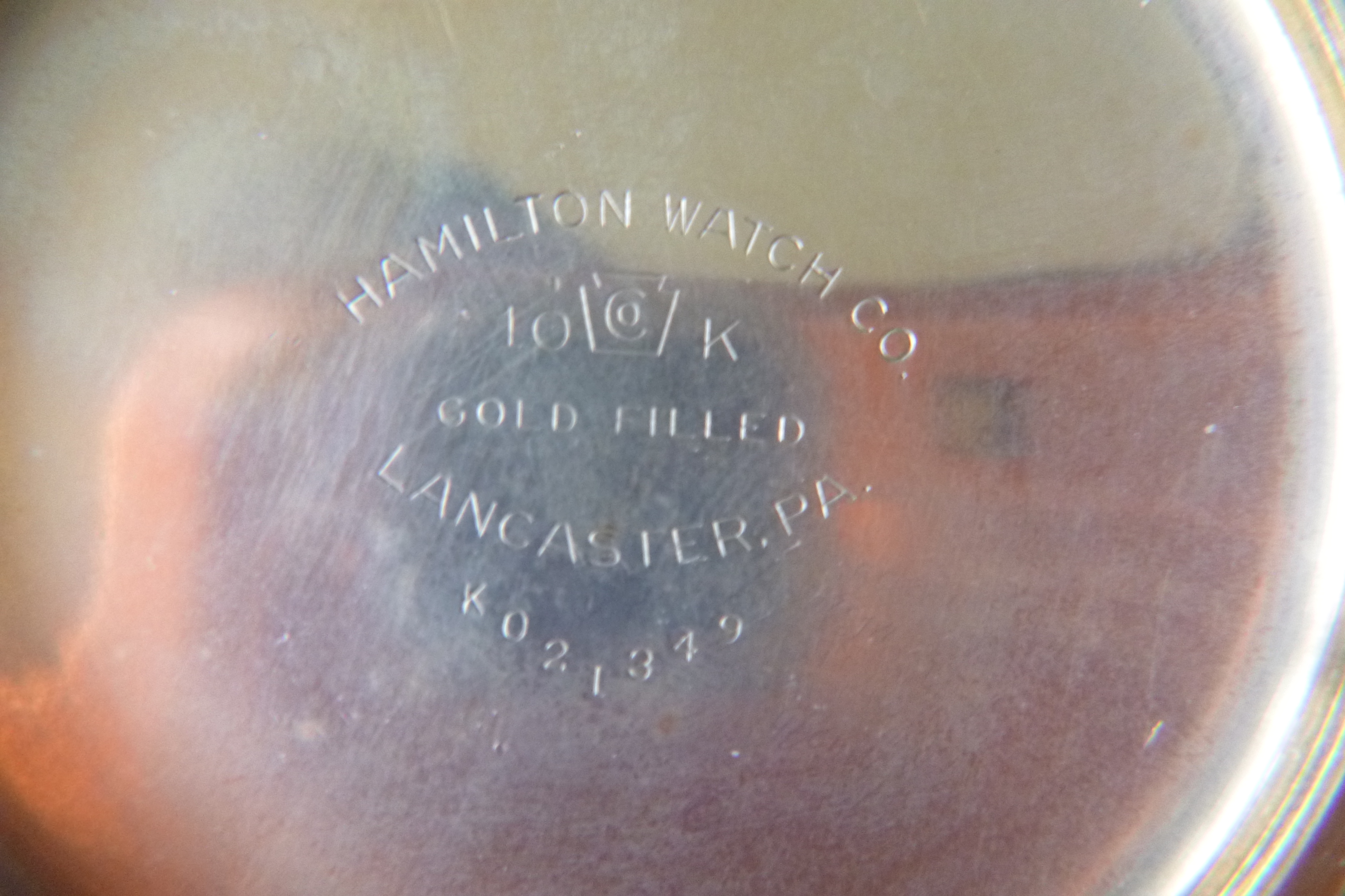

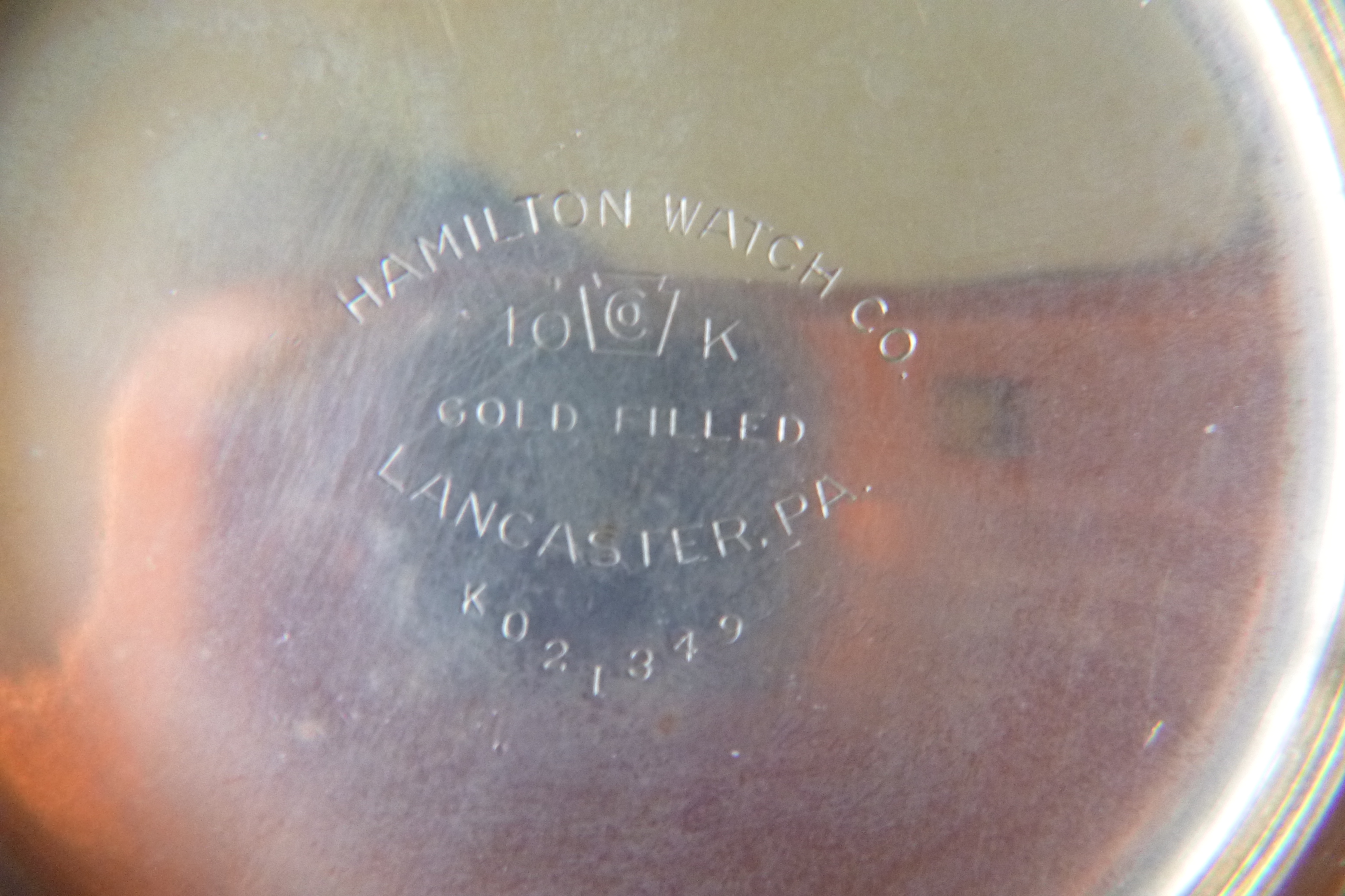

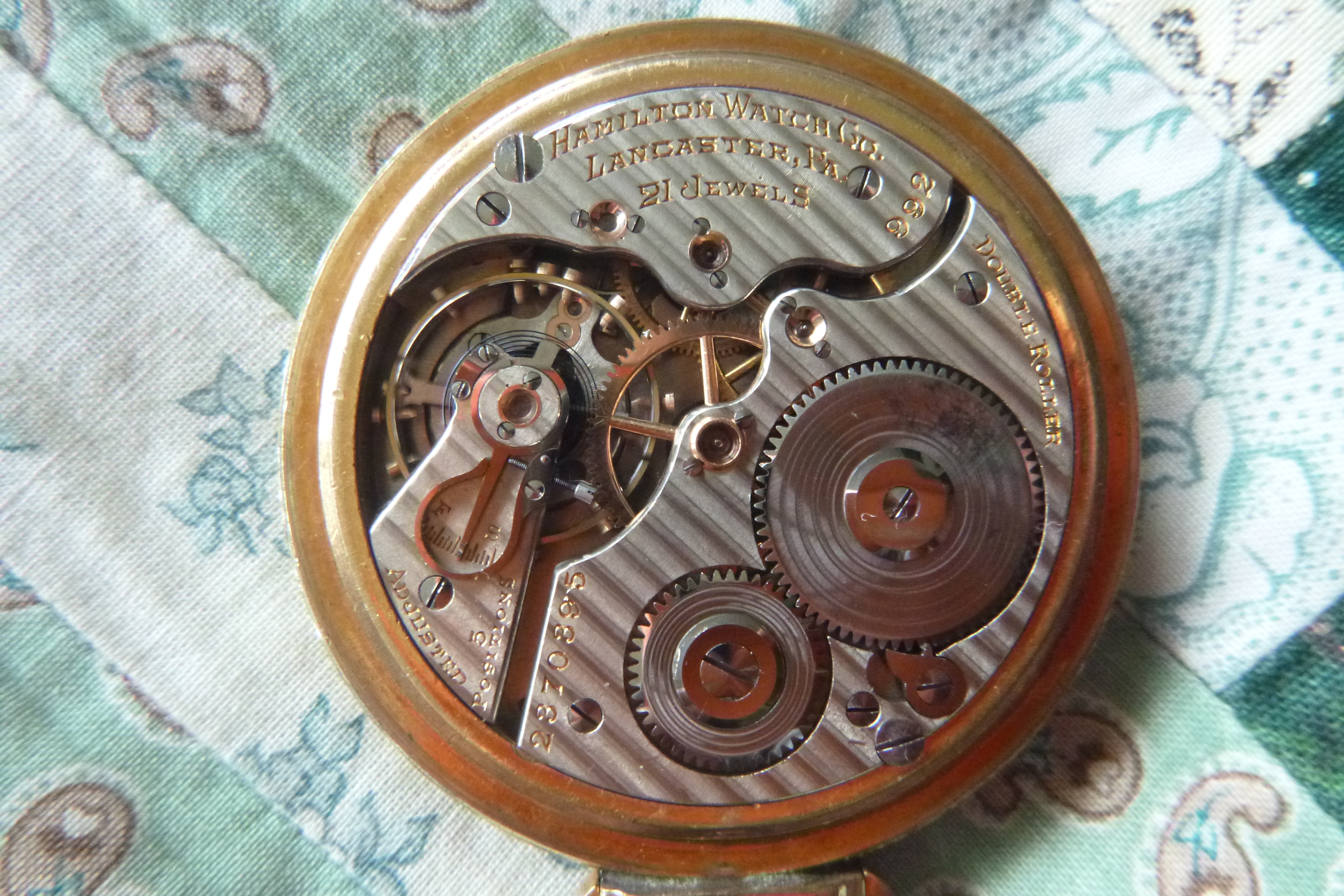

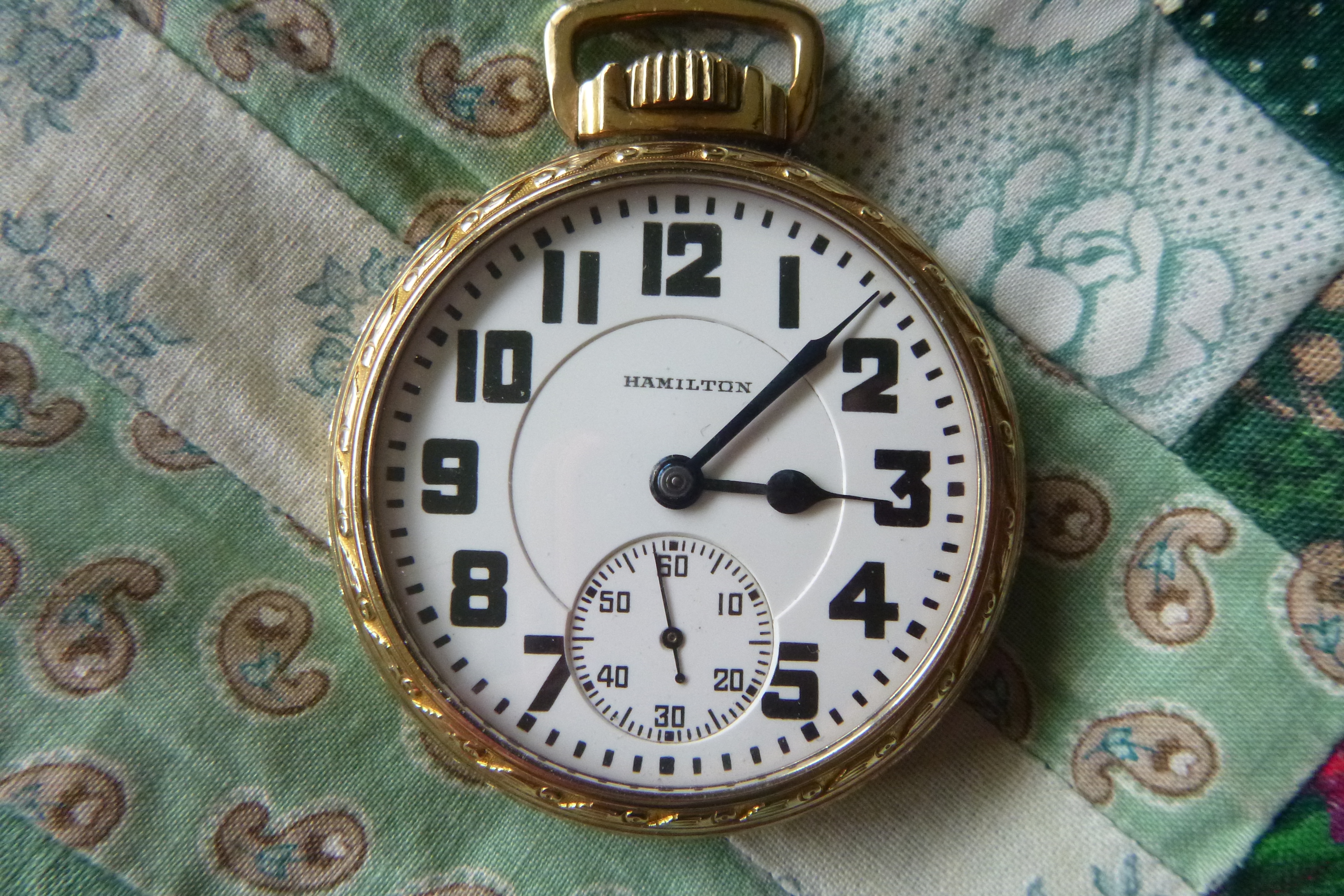

And then my watch maker says the deal he was brokering for another customer for an old Hamilton fell through and was I still interested in the nasty thing... so that HAD to come home.
from 1926 its under 100 years old, so kinda new for my taste.... but I suppose it'll do.

The dial on your Elgin. The decoration is called “jewelling”.The decorative bits are hand applied while the enamel was soft following the firing. When the dial had cooled, a coat of powdered clear glaze called “flux” was sprinkled on, and the dial fired again. If you catch the dial in a glancing light, you’ll see the decorative bits are “under-glaze.” They are completely submerged in the glaze.
Quite a decent Hamilton 992. Well done!

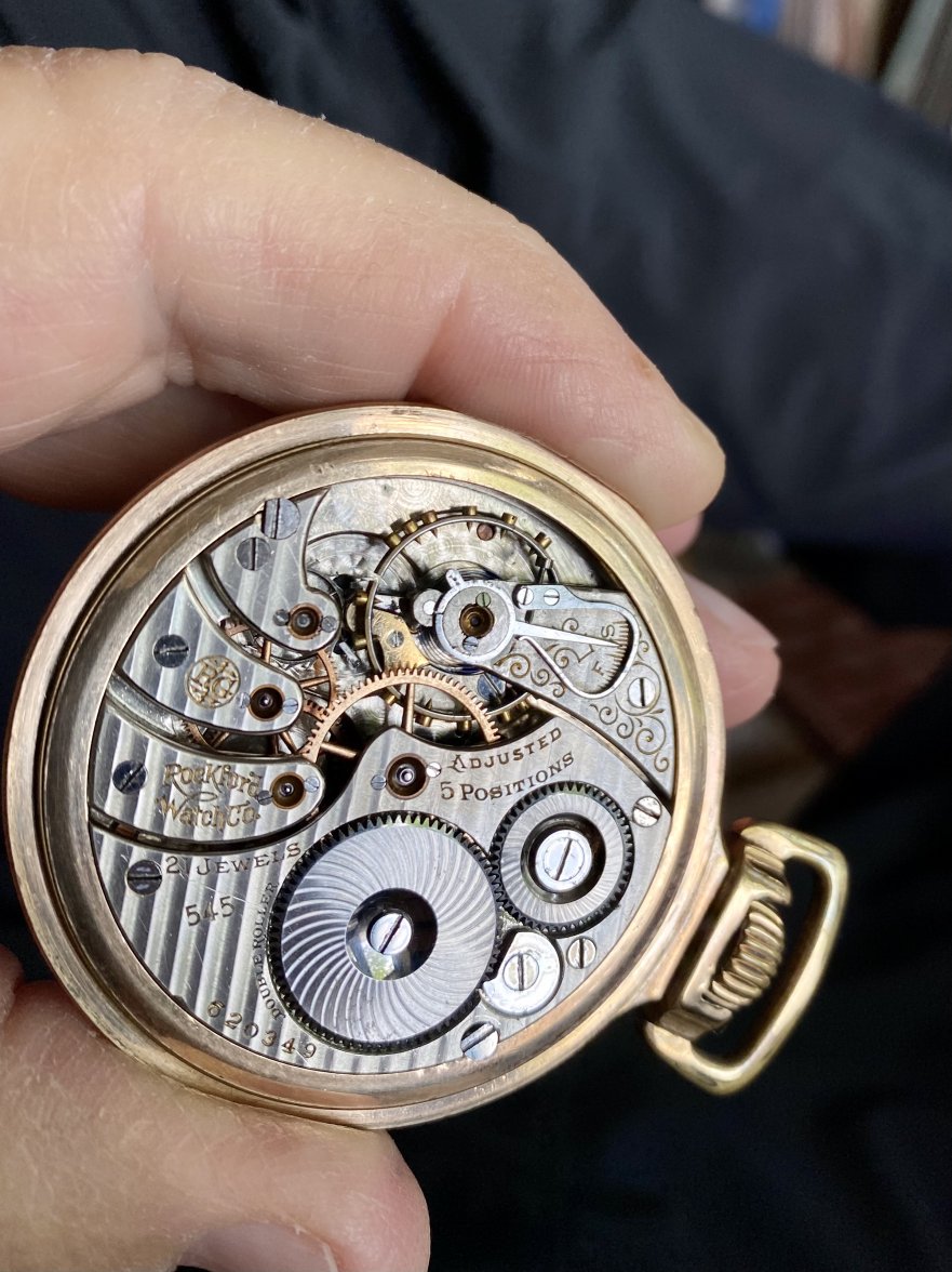

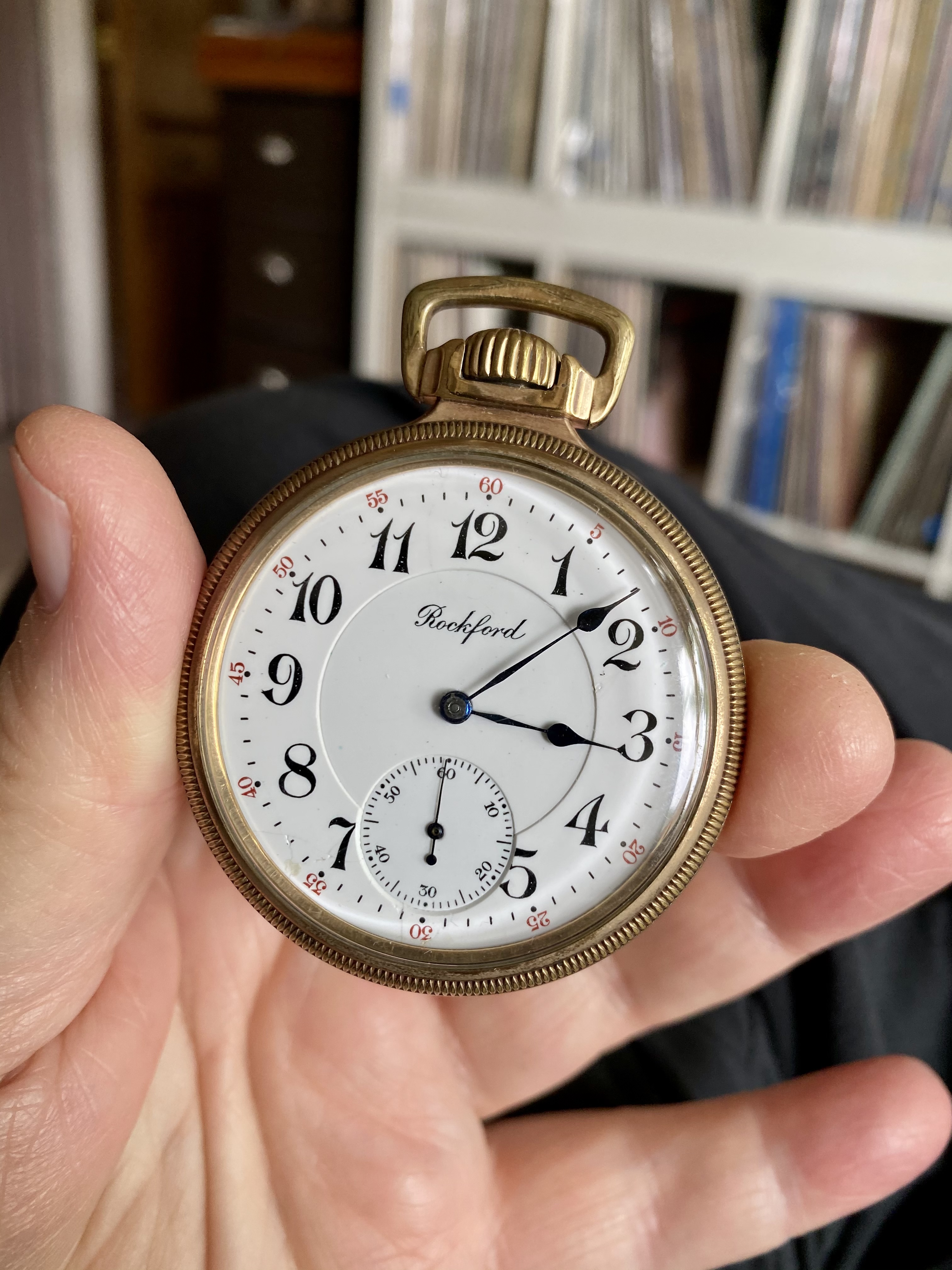

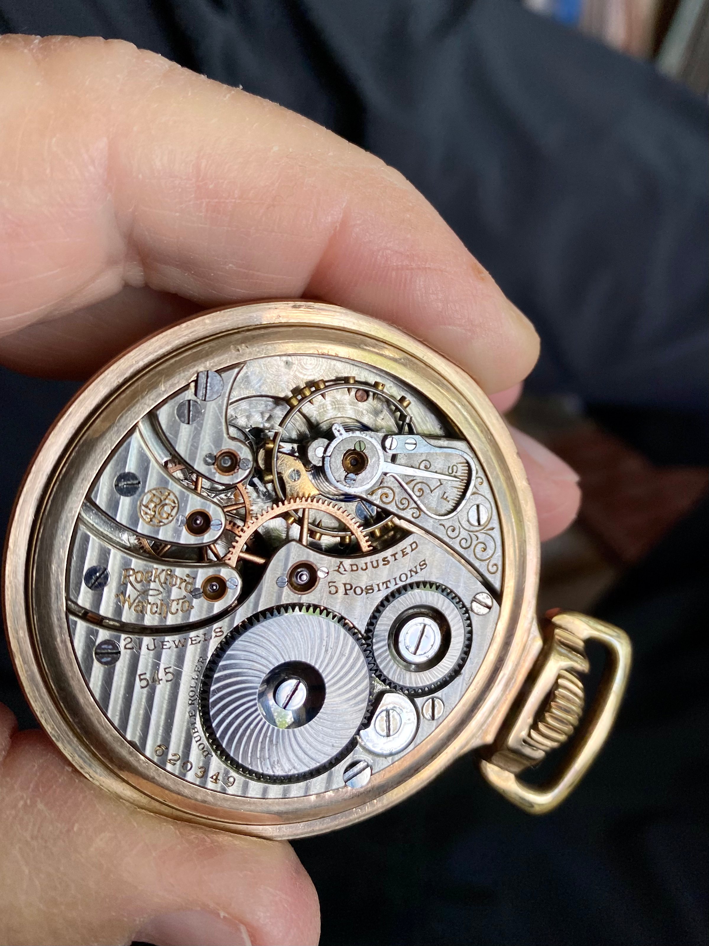

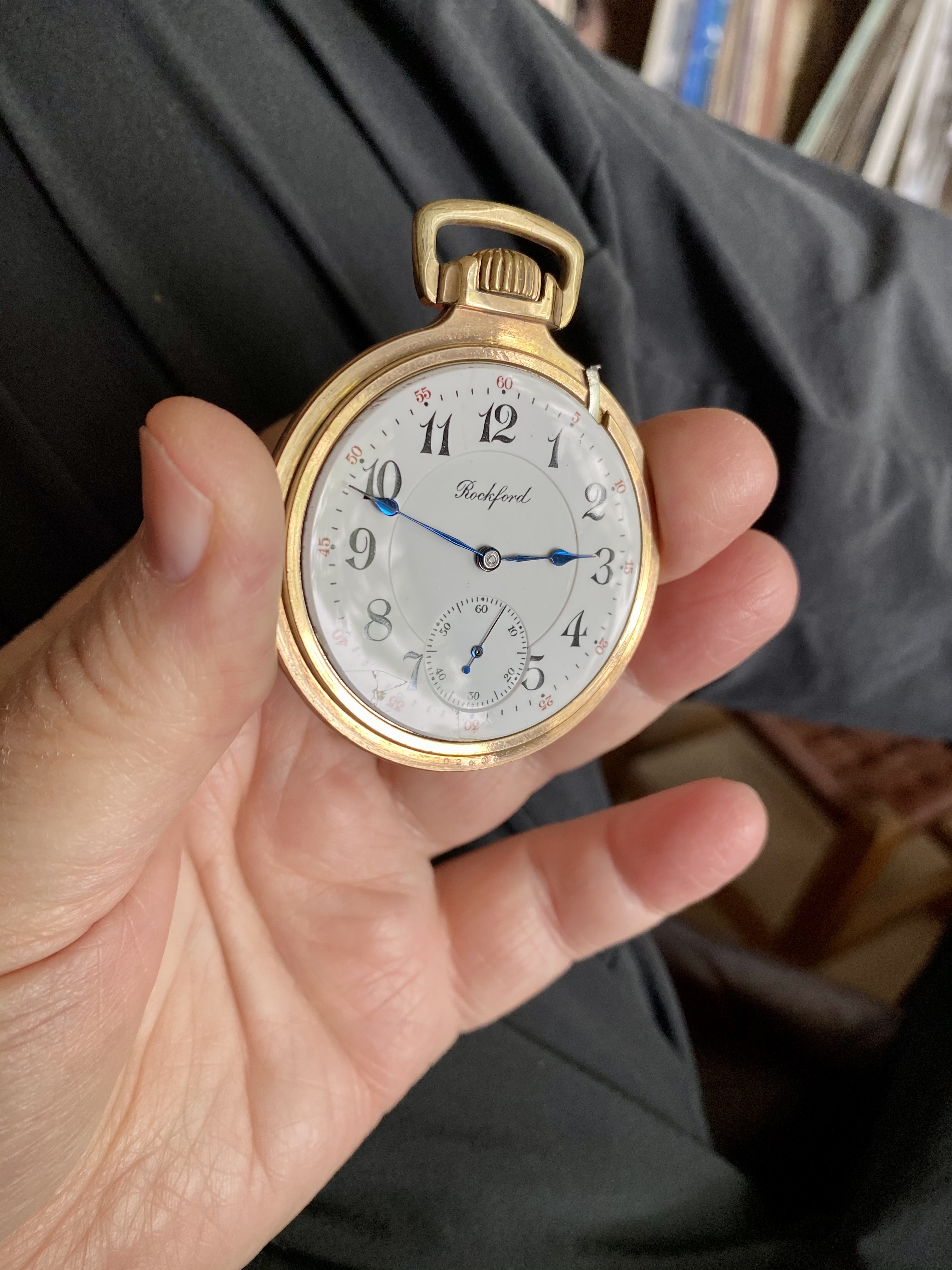

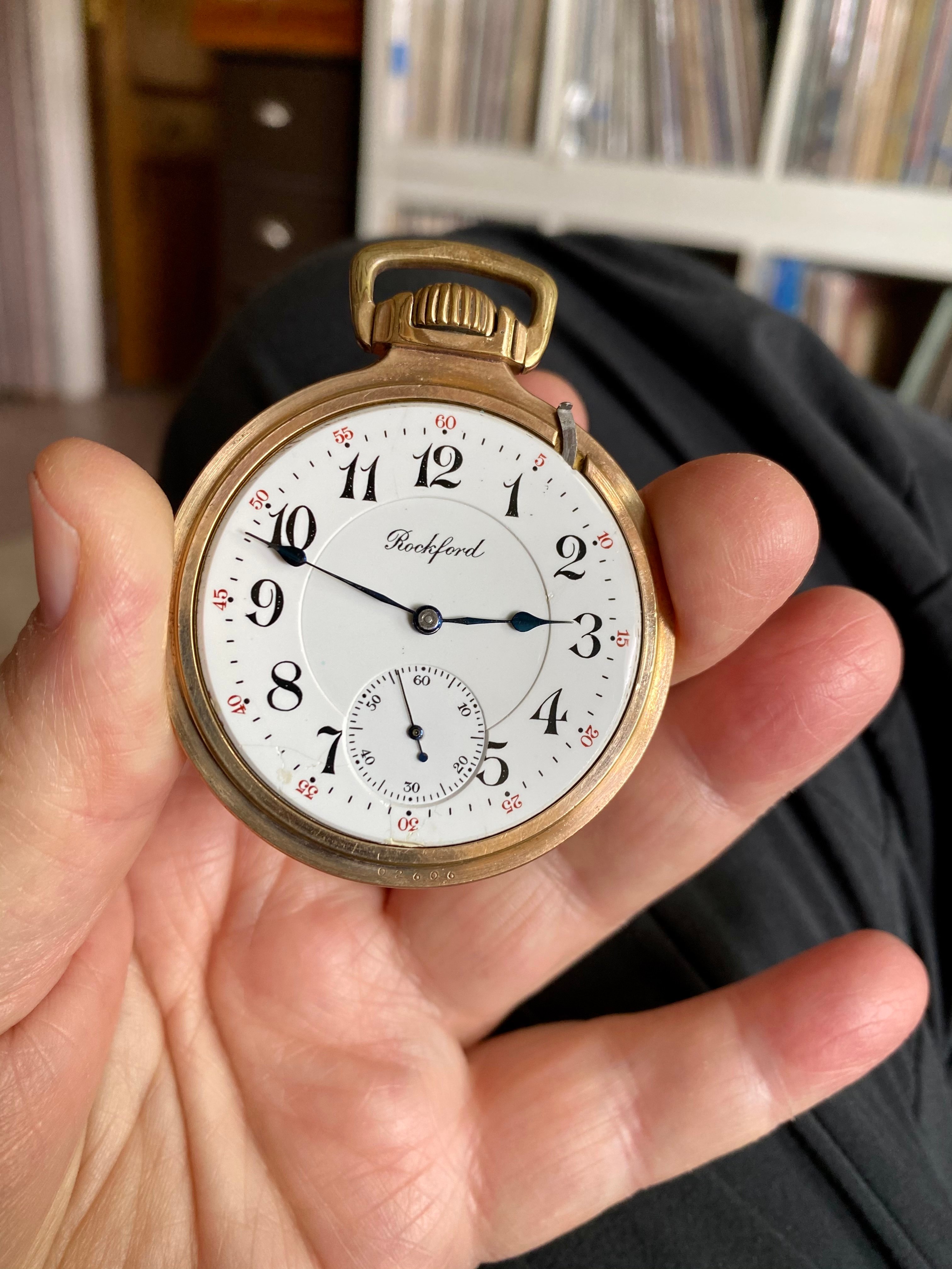

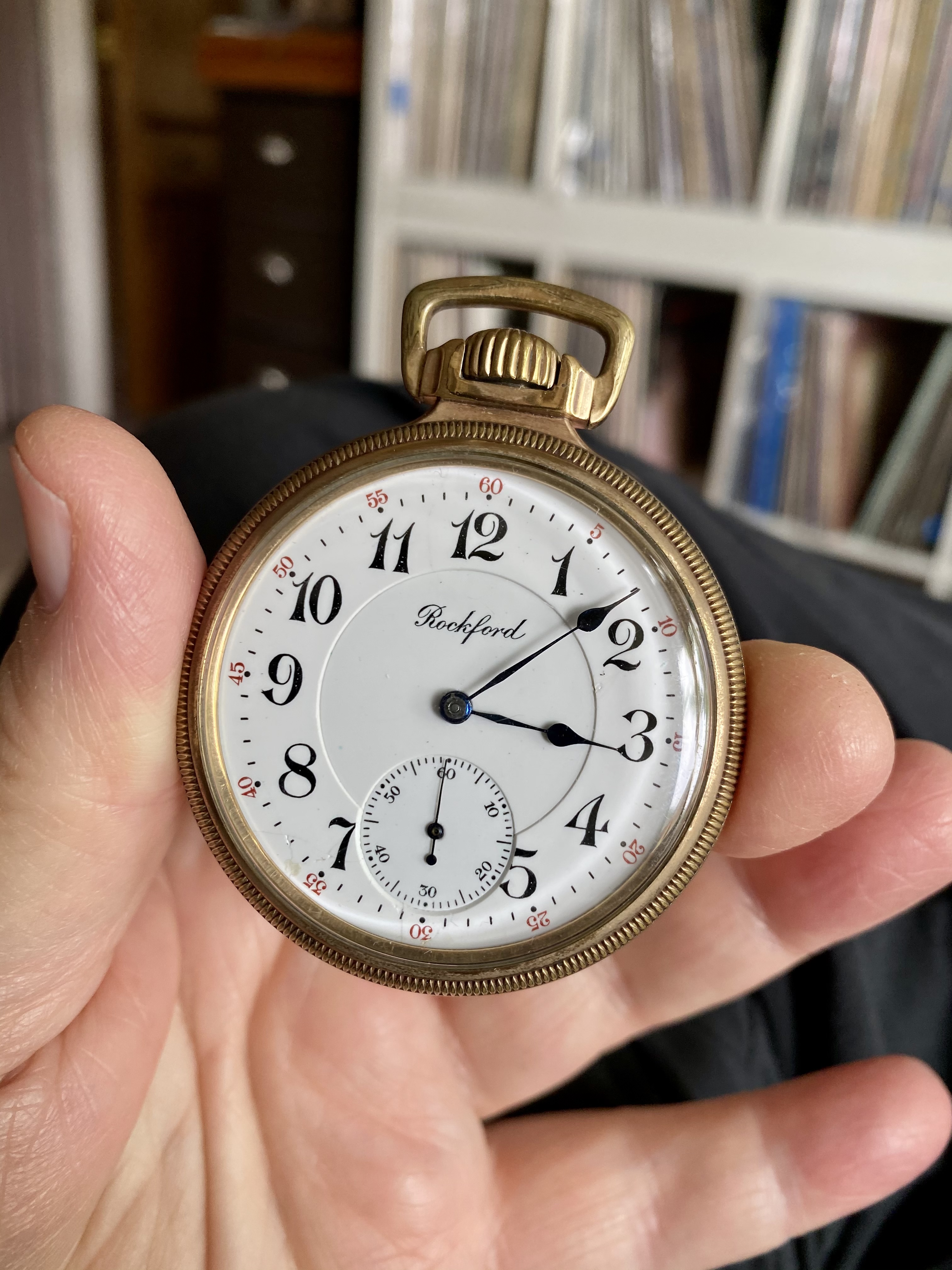

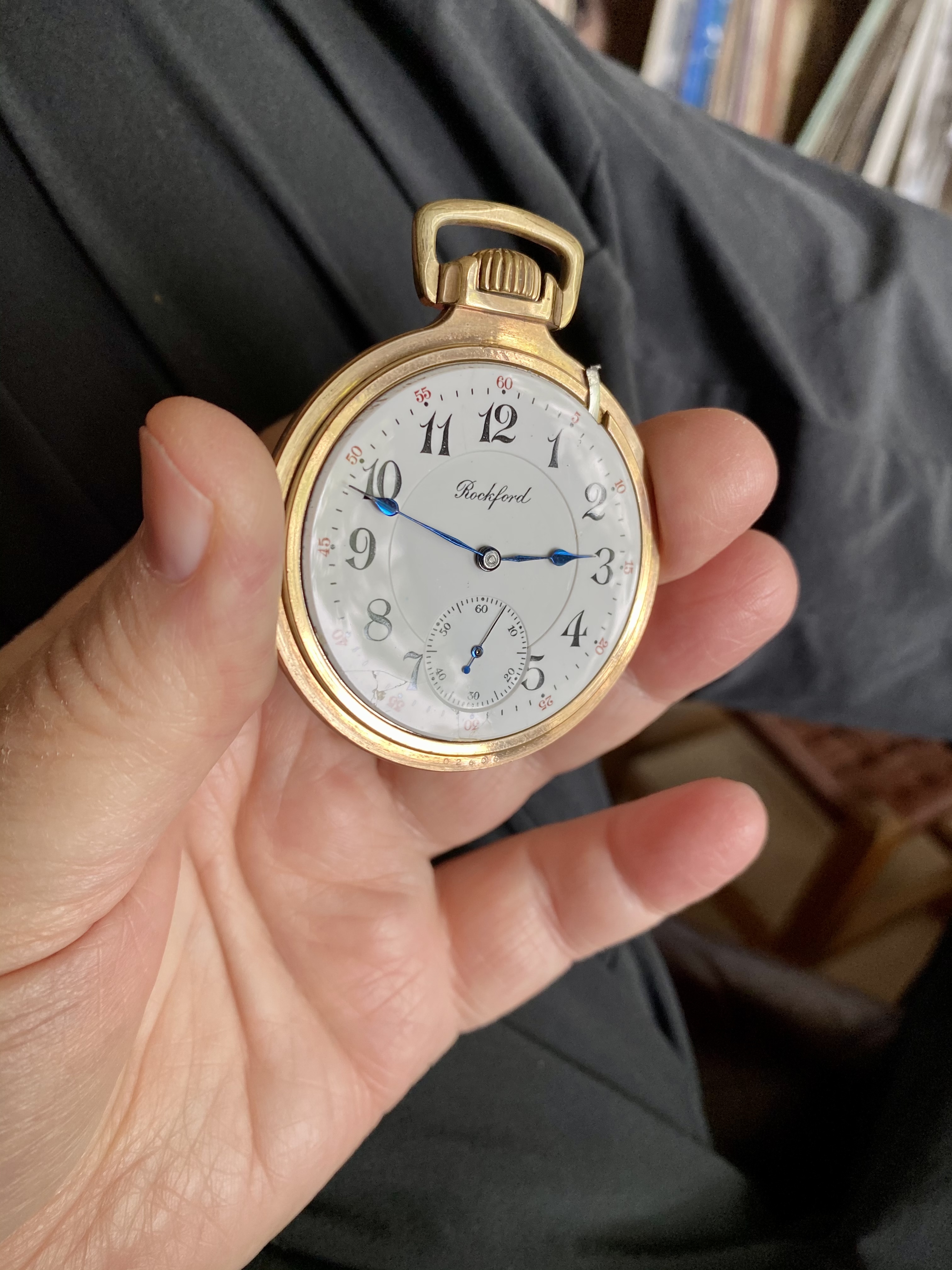

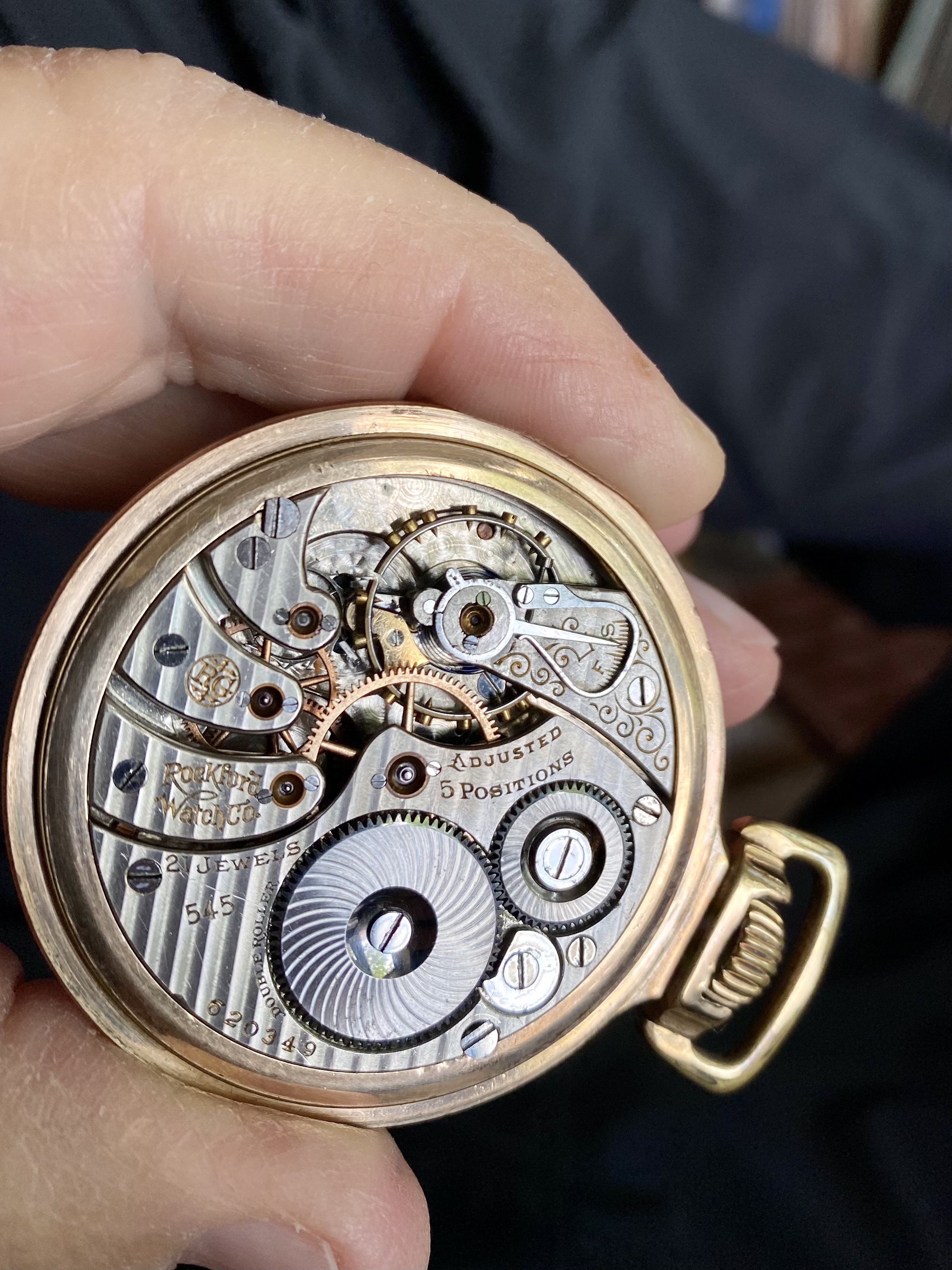

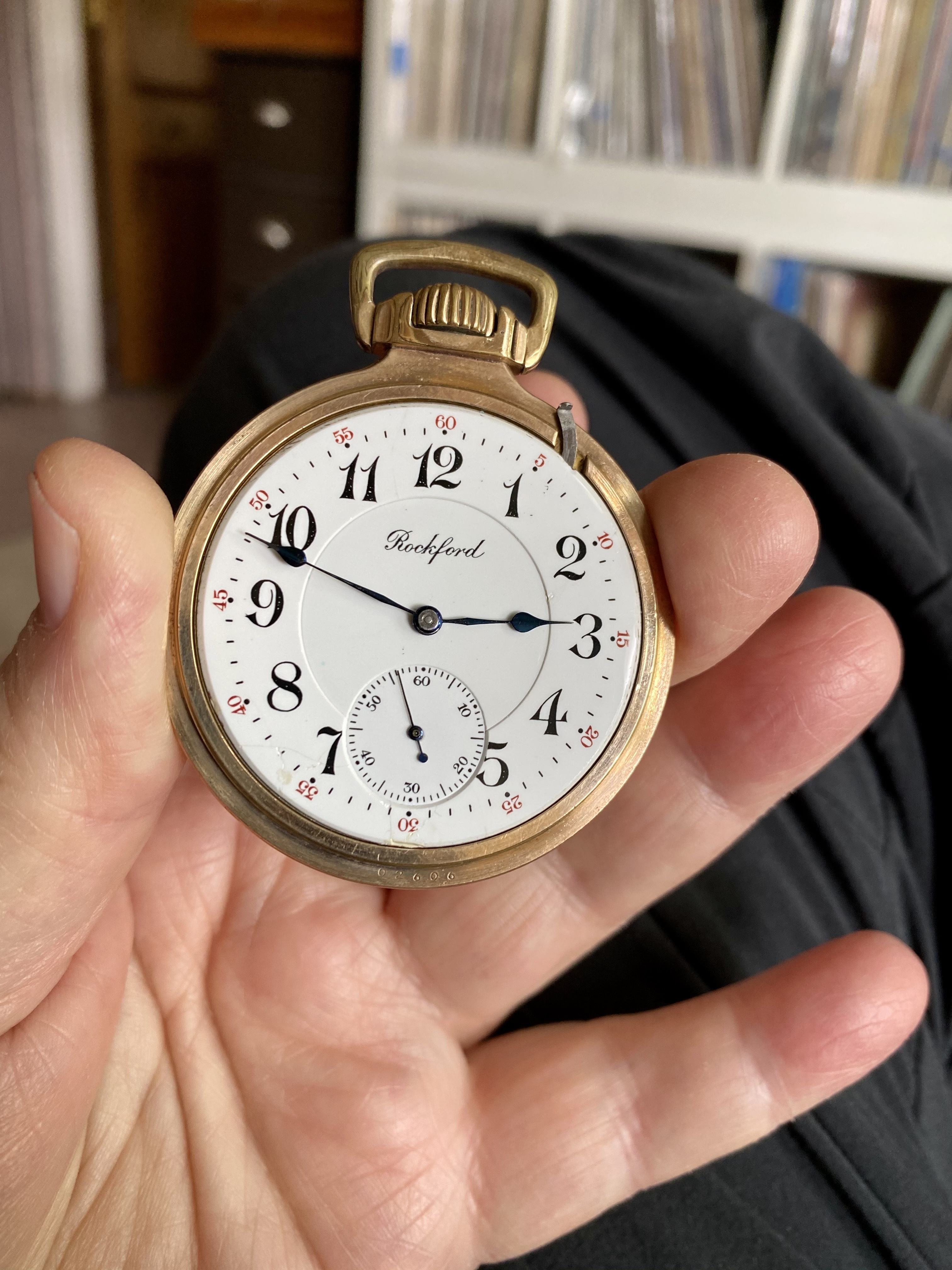

The skinny on @TexOmega ’s handsome Rockford.
https://pocketwatchdatabase.com/search/result/rockford/620349
(Quoted from Michael Harrolds book, American Watchmaking, a Technical History of the American Watch Industry, 1850-1930)
One of the few companies to last 40 years was Rockford. They maintained a business in the railroad trade but also offered average and lower grade models. Production was never high, and on the average they manufactured in two weeks what Elgin made in one day.
In business from 1874 until 1915, in Rockford, Ill.
8,881
62,899

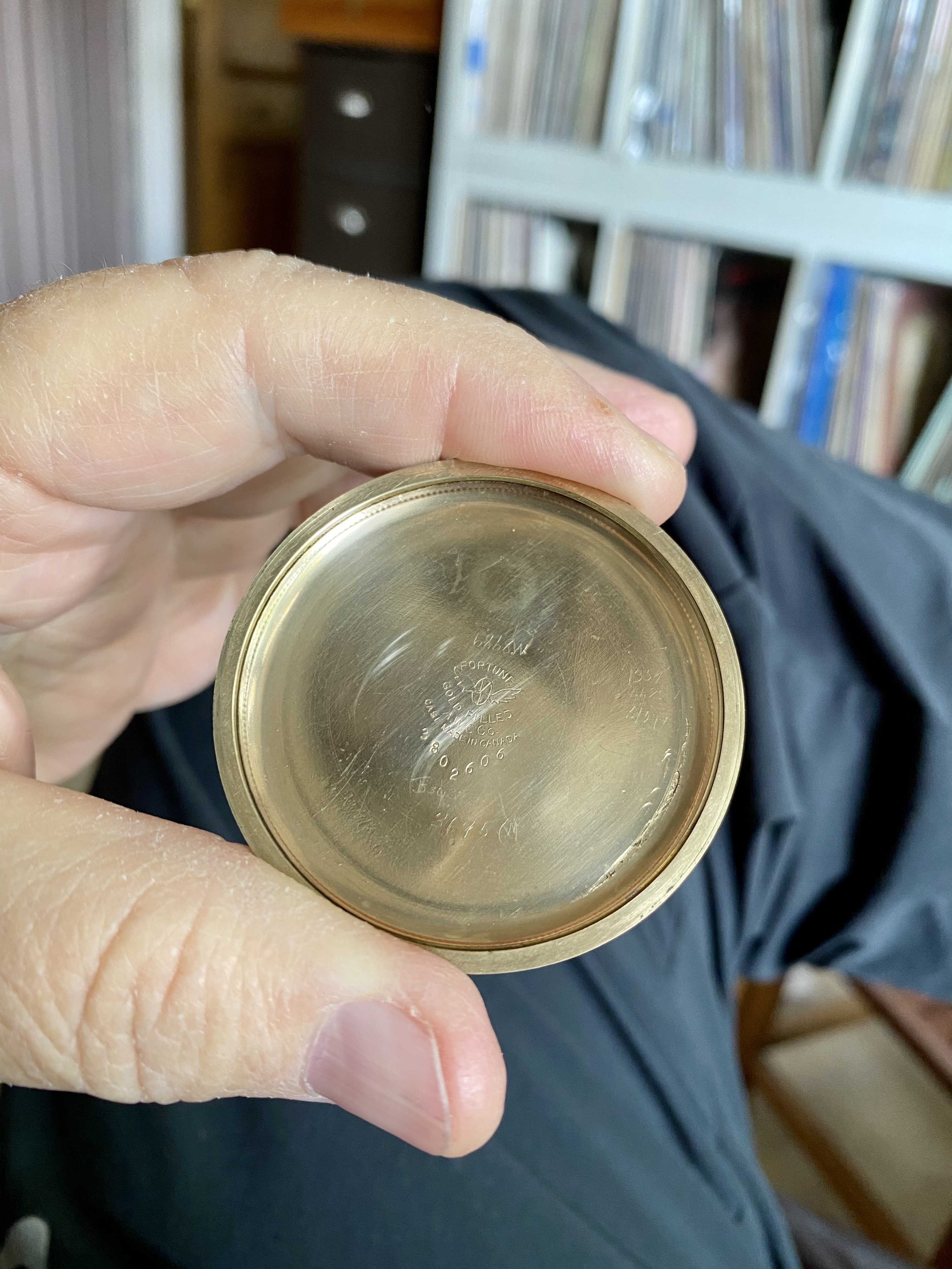

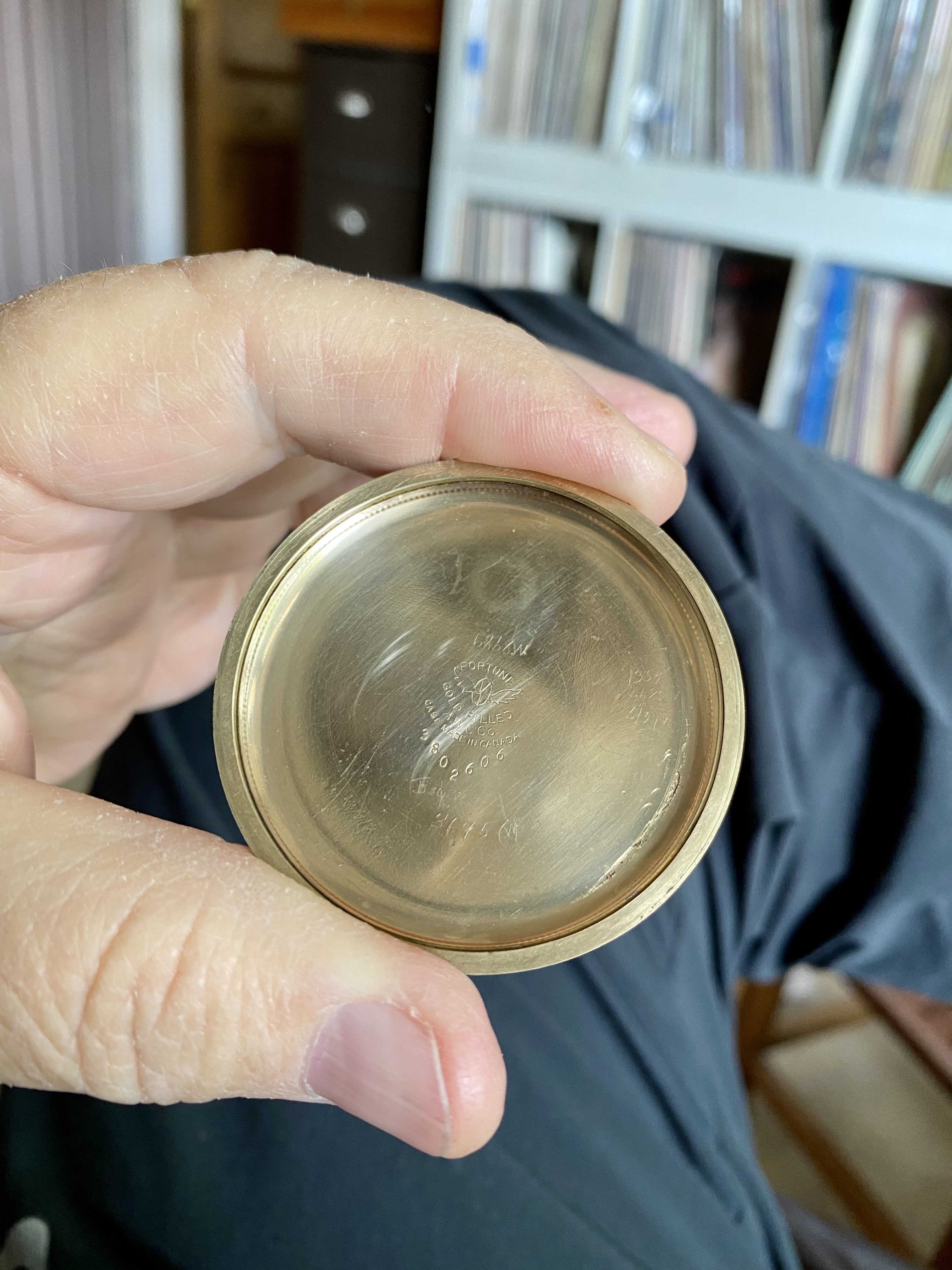

If y'all noticed, my Rockford was an Internationally sourced PW....... Case was made in Canada, but I doubt it was the original.
15,997
48,116
I didn’t see any extraneous case screw marks. Maybe the movement was exported to Canada, and then cased in a Canadian case. There was a time that many U S watch manufacturers didn’t case their movements. They were shipped in a container to the distributor or retailer, and cased when the customer bought the watch.
I look at a perfect double-sunk vitreous enamel dial such as your Rockford has, and it occurs to me that, if the case suffered to the extent that it was replaced, the dial most likely would show signs of damage, as well.
8,881
62,899
Possibly.
I never tried to learn case numbers and how to date them(maybe for the 992 and 992b)for a bunch of the manufacturers. Some on the NAWCC forum did and could quote that info.

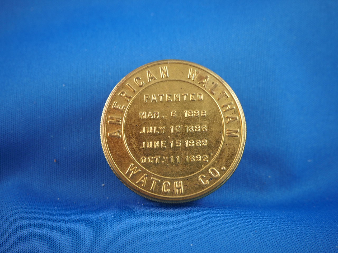

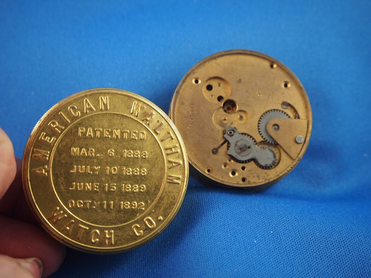

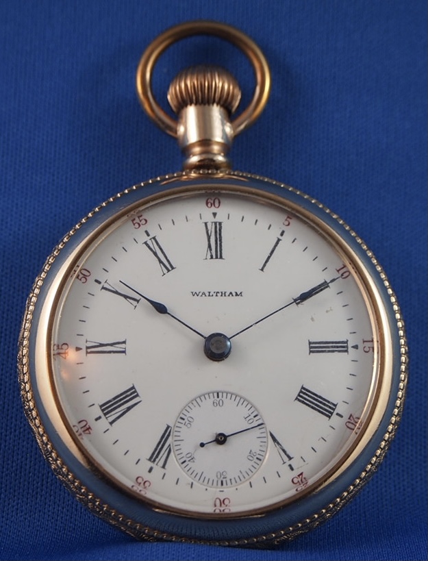

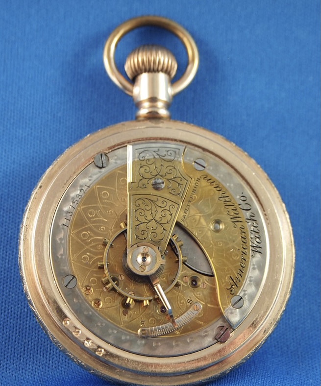

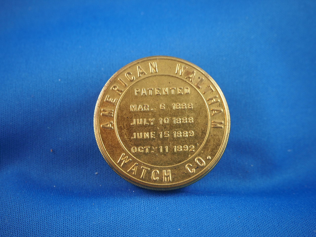

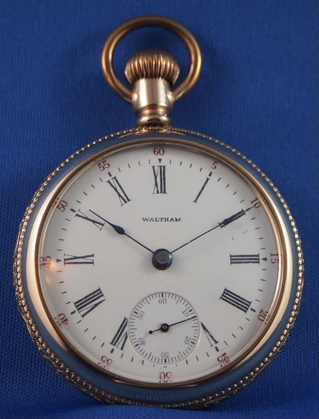

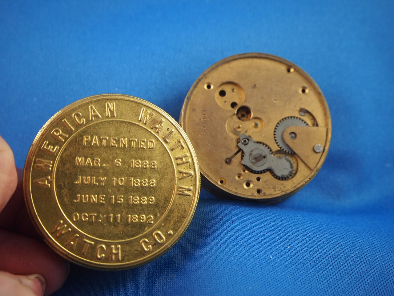

About 115 years ago when this artifact was made, when you wanted to buy a watch, you didn’t walk into a jewellery store to view a panoply of ready to wear watches, all arrayed in their point of sale display boxes, ready to be wound, set, and put in the pocket. Rather, you had to choose the movement, dial, hands, and case, after which the store watchmaker would fit the components of your choice, together.
When it came time to choose the movement for your watch, this is likely what you were presented with, to start. A box with a movement in it!
Then you chose the dial, hands, and case.

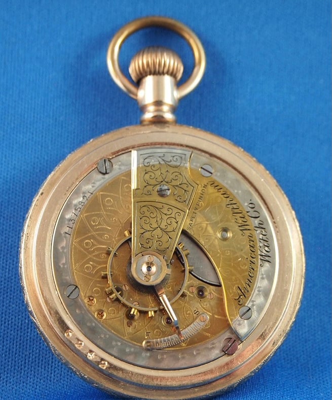

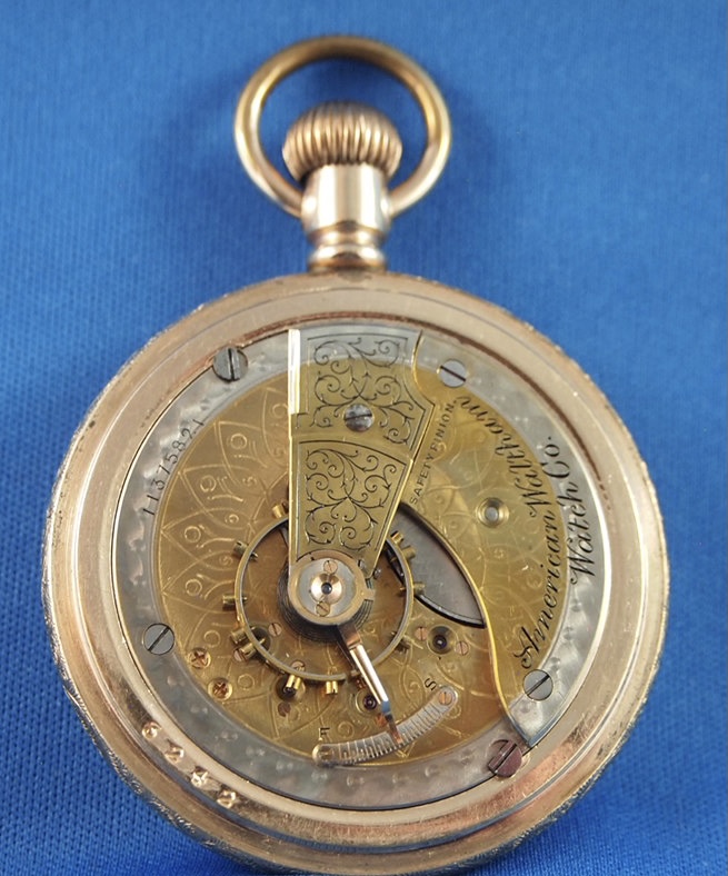

The movement in this watch might be an example of the sort of “eye candy” designed to help a customer make a choice. Two-tone, nicely damascened and engraved, but only 11-jewels, and unadjusted! Probably would appeal to someone who wanted “pretty”, before they wanted a high quality, precision time keeper. The movement is not marked “adjusted.” This is an 1883 model Waltham, made in about 1903. The 1883 model was produced in open faced and hunter cased models, in stem wind, lever set models, and stem wind, stem set models, and everywhere from 7 jewels, to 21-jewels. I have even seen them as key winders! It was produced from 1883 until about 1915, and there were millions of them made.
Here’s the skinny on this artifact.
https://pocketwatchdatabase.com/search/result/waltham/11375821
