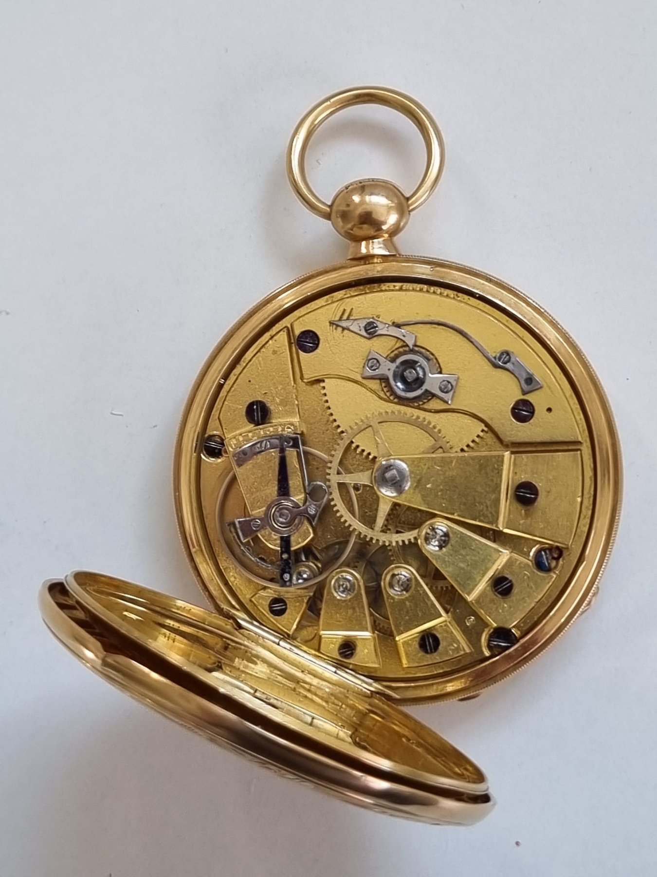

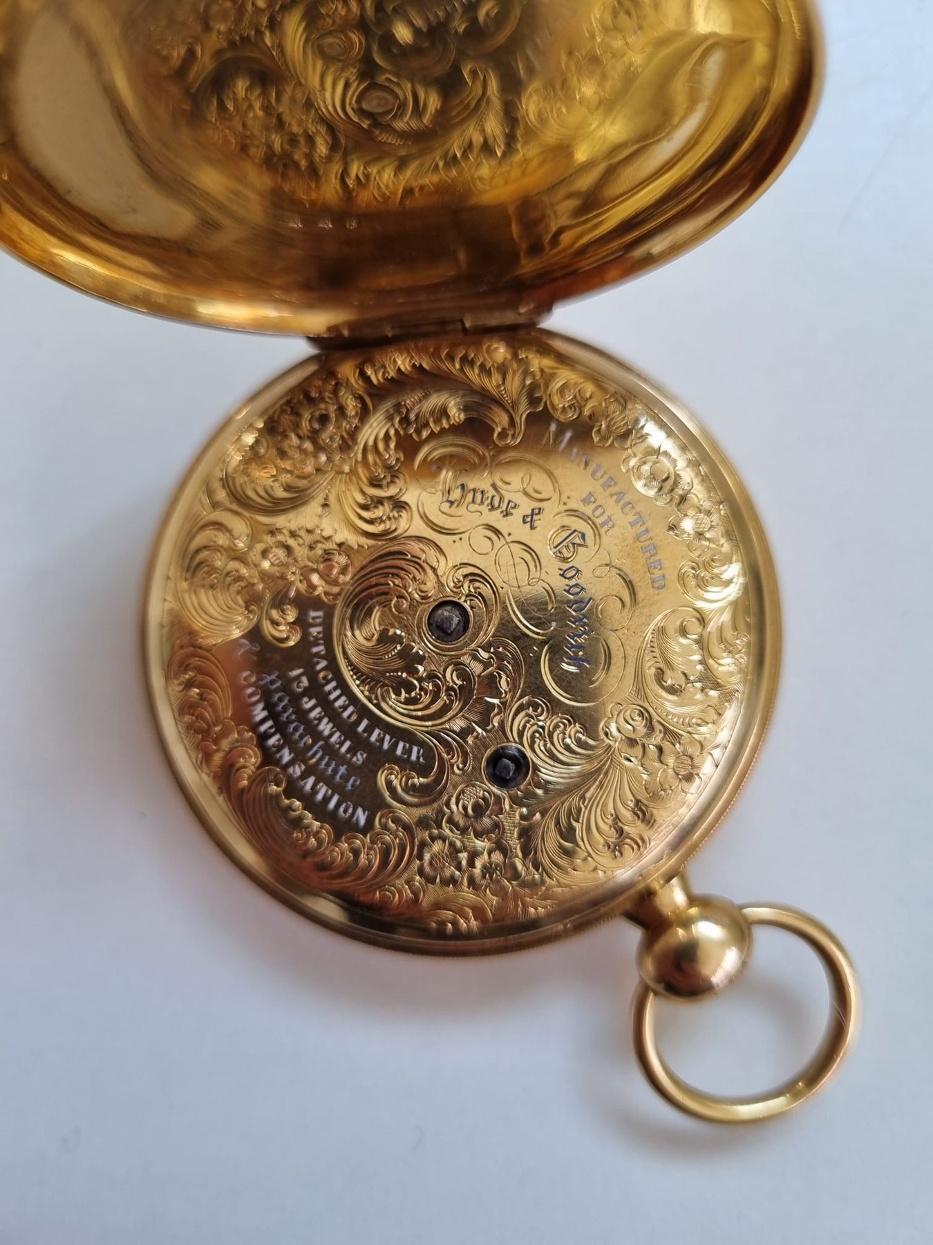

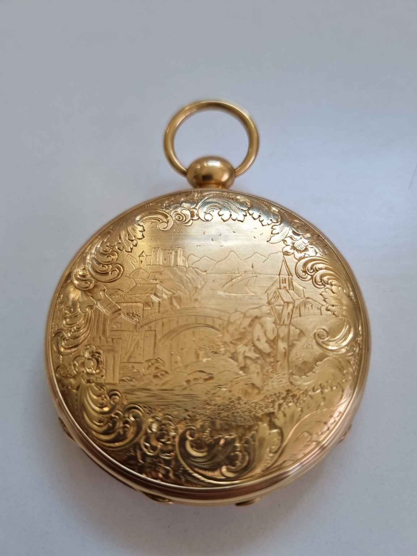

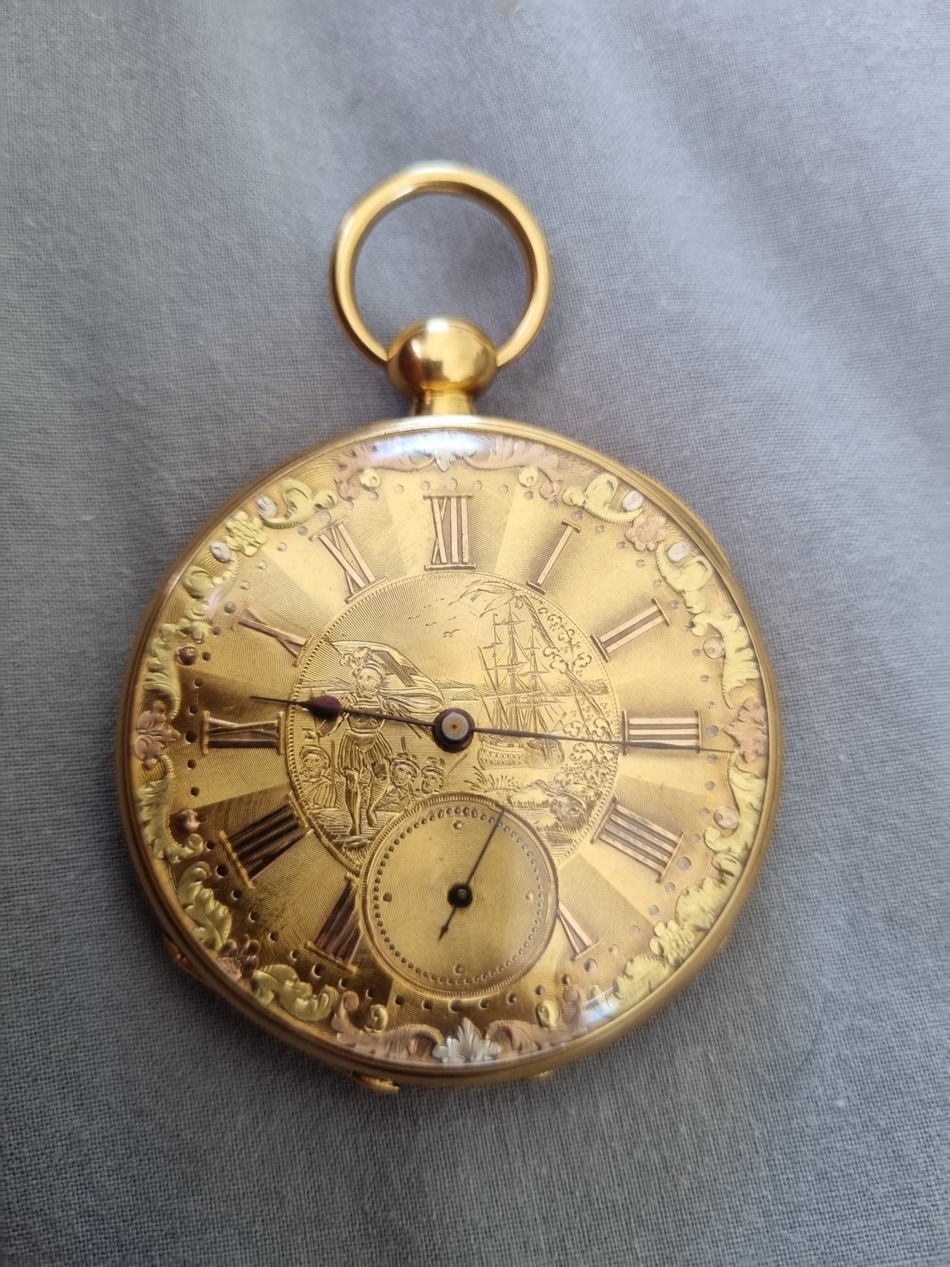

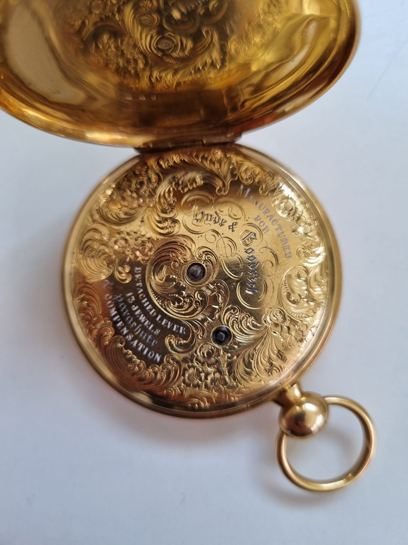

OK, I can also contribute with US watches 😉. This one made for Hyde & Goodridge, New Orleans. The movement and the 18K case are Swiss, though. To be dated around 1835.
Remarkable is the combination of lever escapement on one hand and Breguet style parachute and temperature compensation on the other hand. The latter actually "common" with top notch cylinder escapements only.

......... and Breguet style parachute ................
Was the parachute actually a shock prevention device, or did it serve another function?
632
2,137
Indeed an early shock protection device.
The jewelled bearings appear to be either pale aquamarine, spinel, or rock crystal. This early in the 19th century, most watches attributed to American makers, were imports made elsewhere. A fine addition to your collection, @Bernhard J .

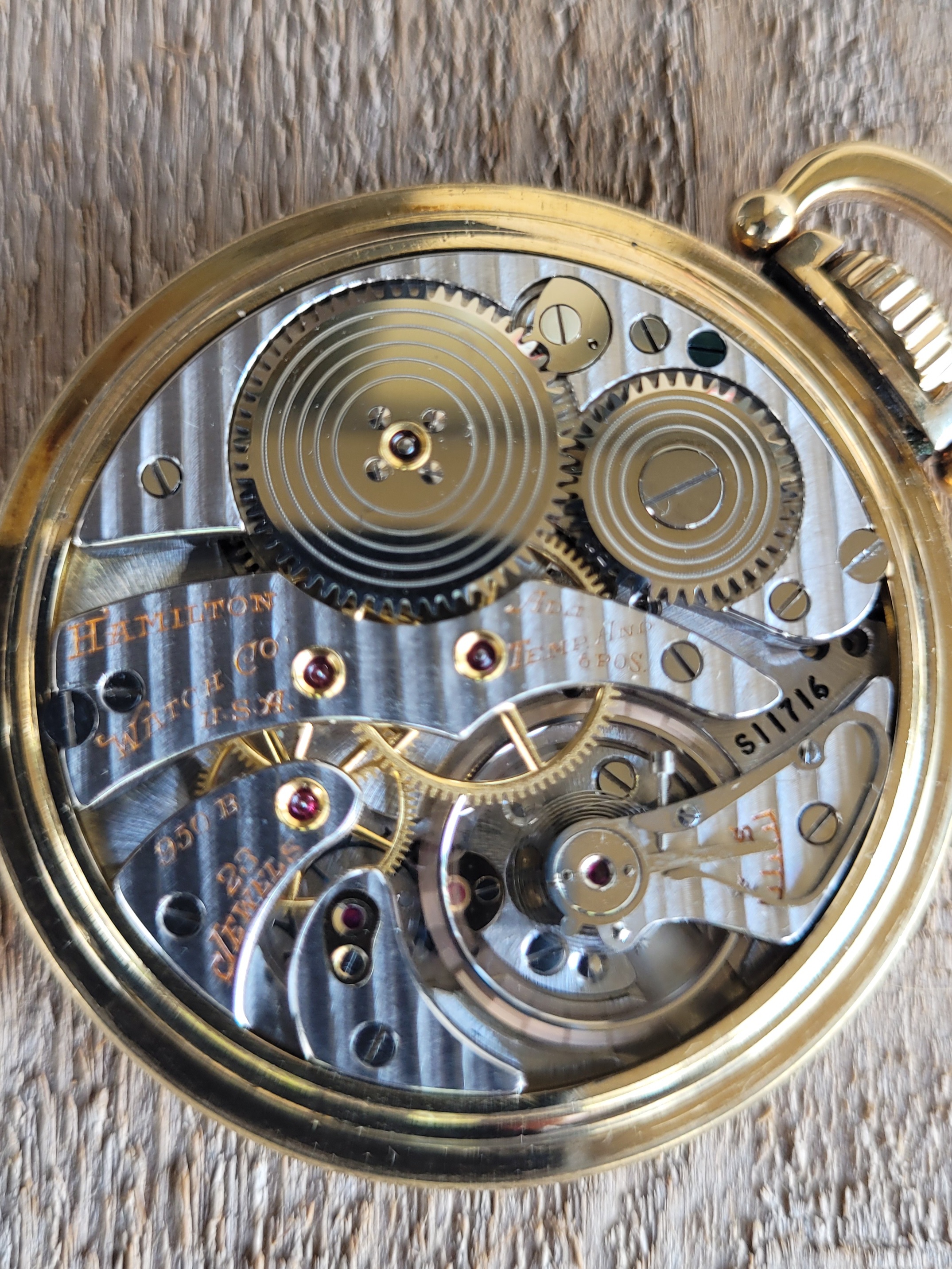

As I stated, it is a 950B, circa 1951. Here is a photo of the movement.

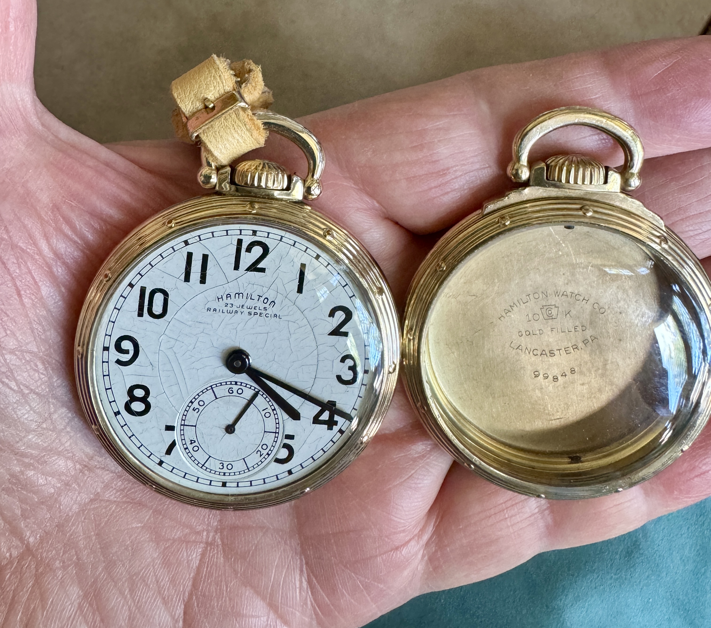

Now I know what these shoulders are that y'all are talking about.

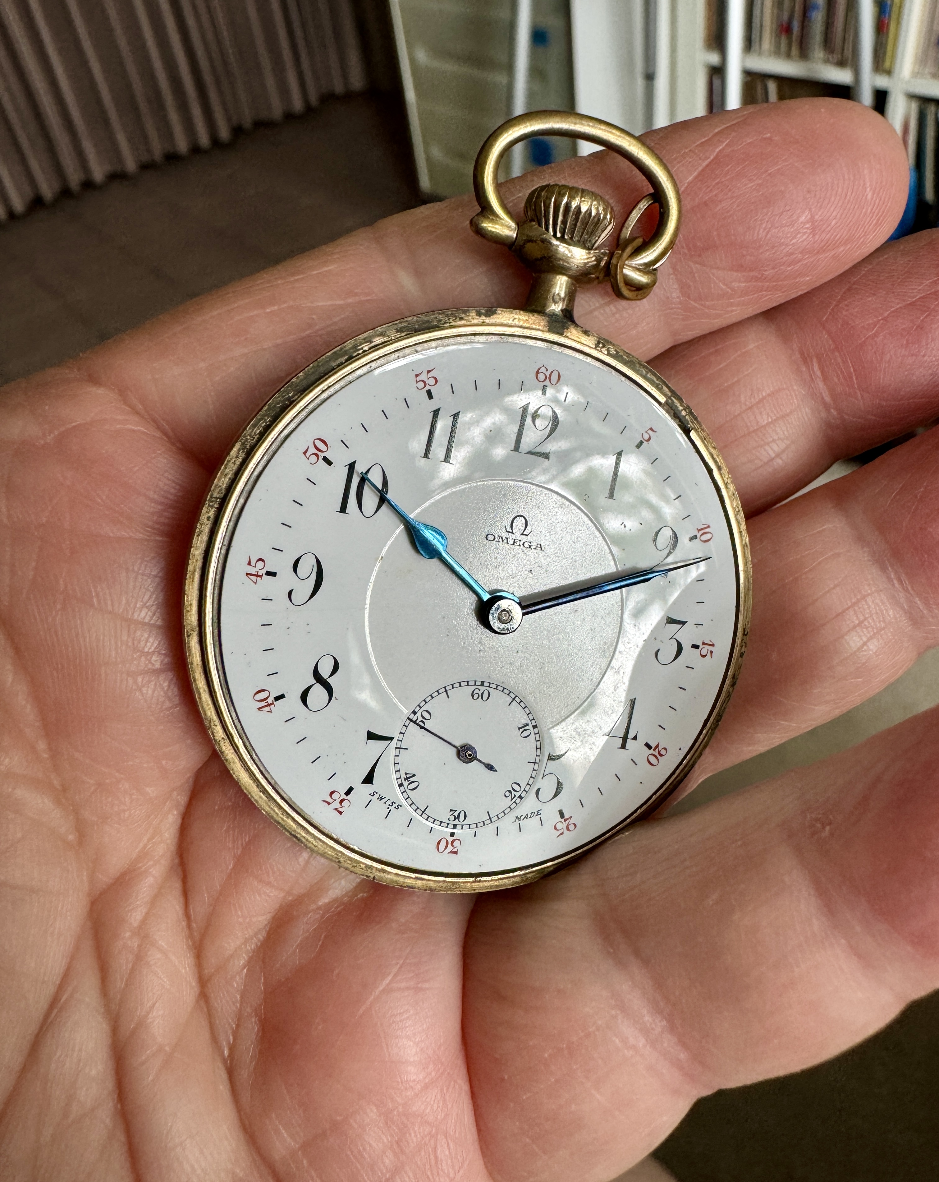

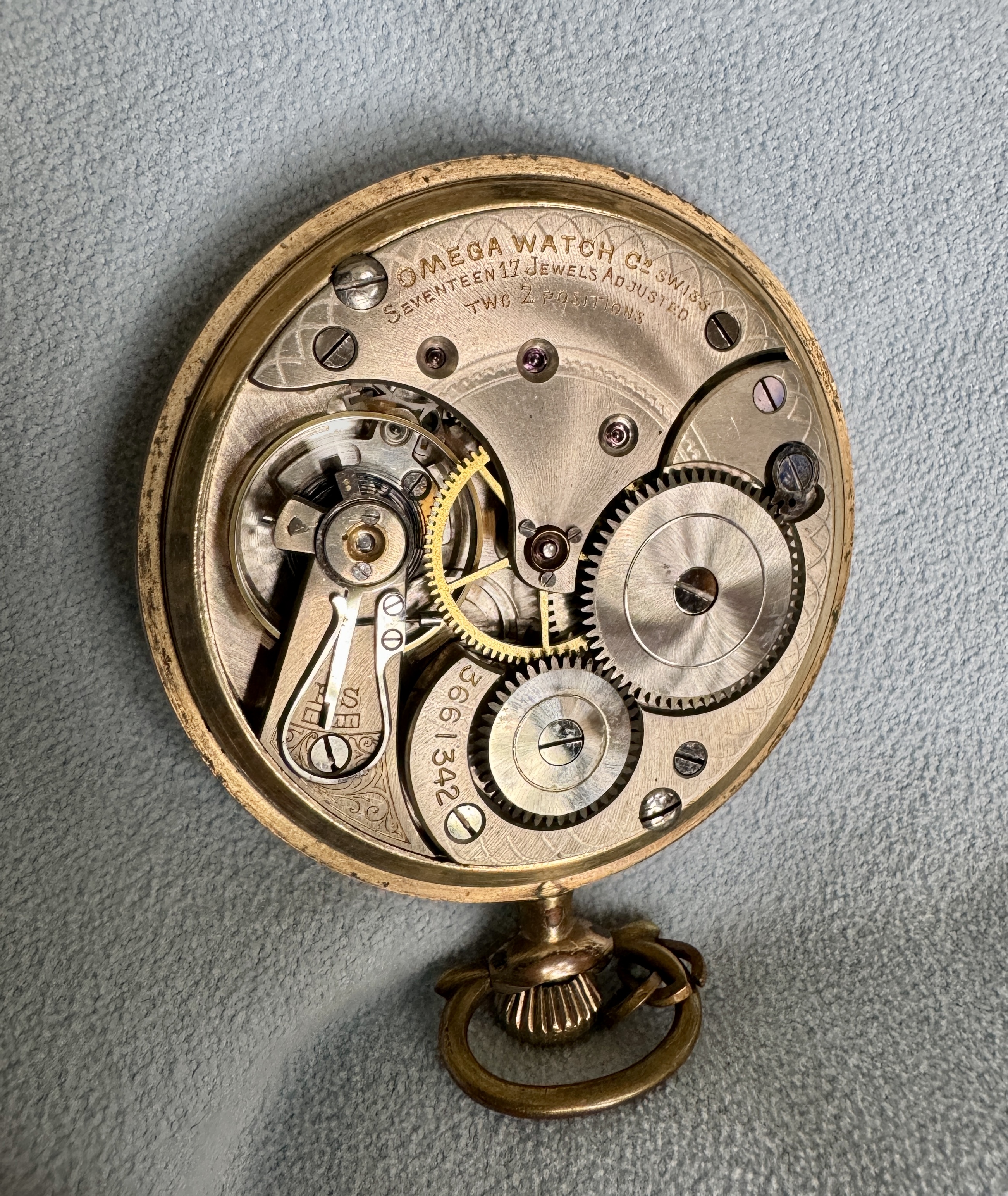

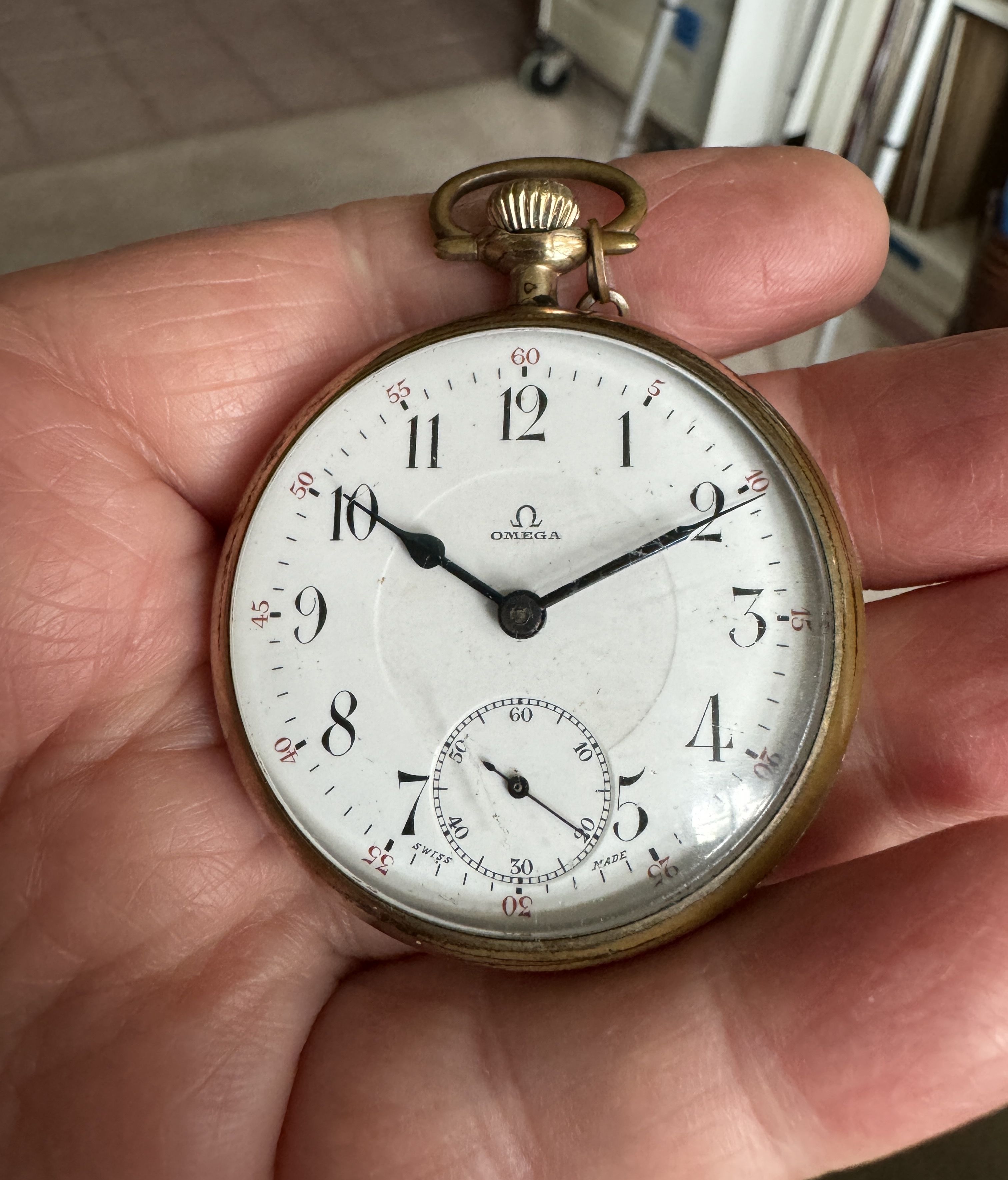

Omega circa 1908-9
17j 2 position adj and pendant set
Roughly a US size 13 at 18 ligne
At least a bit of Damaskeening, but I may be exaggerating just a hair on that point😝
Very nice double sunk porcelain dial and blued hands.
632
2,137
It is interesting that watches for the US market in most cases have hour hands, which we Europeans think are "wrong", because too long. But that apparently is to comply with American taste in the target market. That is often seen with the result that we Europeans suspect non-original hands in Swiss watches for the US market, like in case of this Omega. But that is likely not the case..
