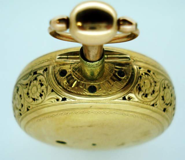

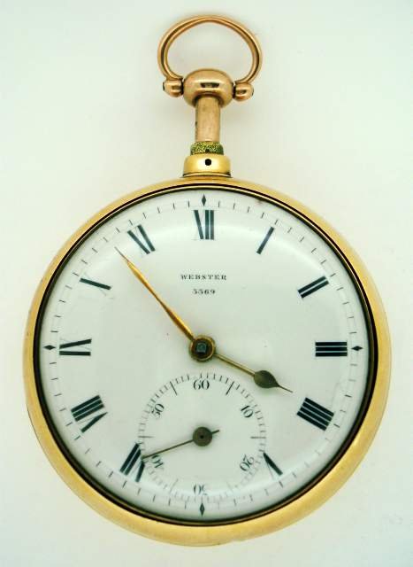

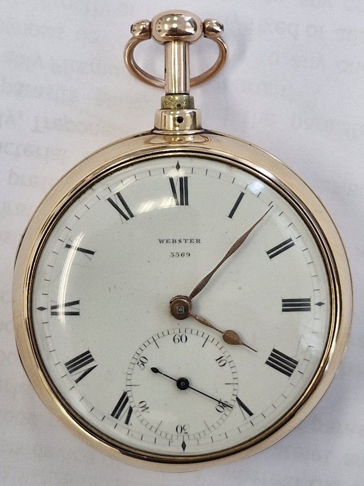

Arrived today, cylinder escapement, quarter repeater, ca. 1807. Remarkable: the number on the dial (3369) differs by 1 from the number on the movement (3370). The signatures are the same, of course. Apparently the differing numbers were "suspicious" to other potential buyers. I am sure that it is original like that.

Arrived today, cylinder escapement, quarter repeater, ca. 1807. Remarkable: the number on the dial (3369) differs by 1 from the number on the movement (3370). The signatures are the same, of course. Apparently the differing numbers were "suspicious" to other potential buyers. I am sure that it is original like that........
Somewhere on the planet there is probably a watch with similar juxtaposed serial numbers.
Diamond cap jewel?

Truly stunning Bernhard!

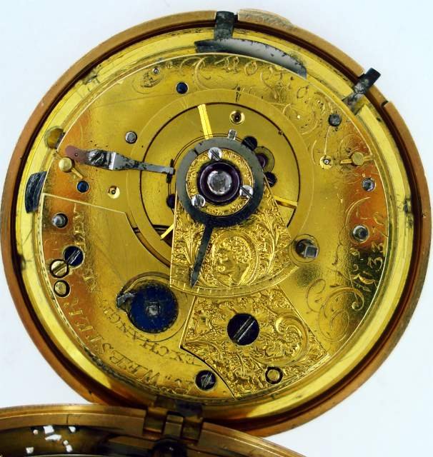

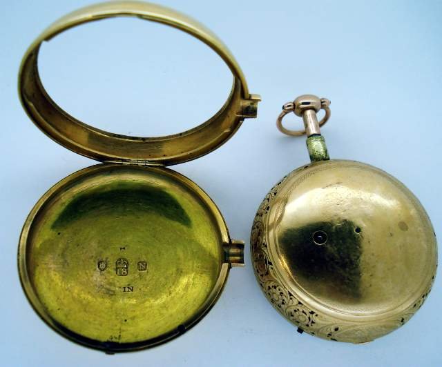

According to Philip Priestley’s compendium on English case makers, the case may be by John Nevill, 14 Cold Bath Square, Clerkenwell, and 4, Vineyard Walk, Clerkenwell. The listing shows he was in business from 1789 until 1806. Diamond end stone on the verge staff. One can but wonder how a watch that is 220 years old has survived in the condition this one is in! Nice catch, @Bernhard J !

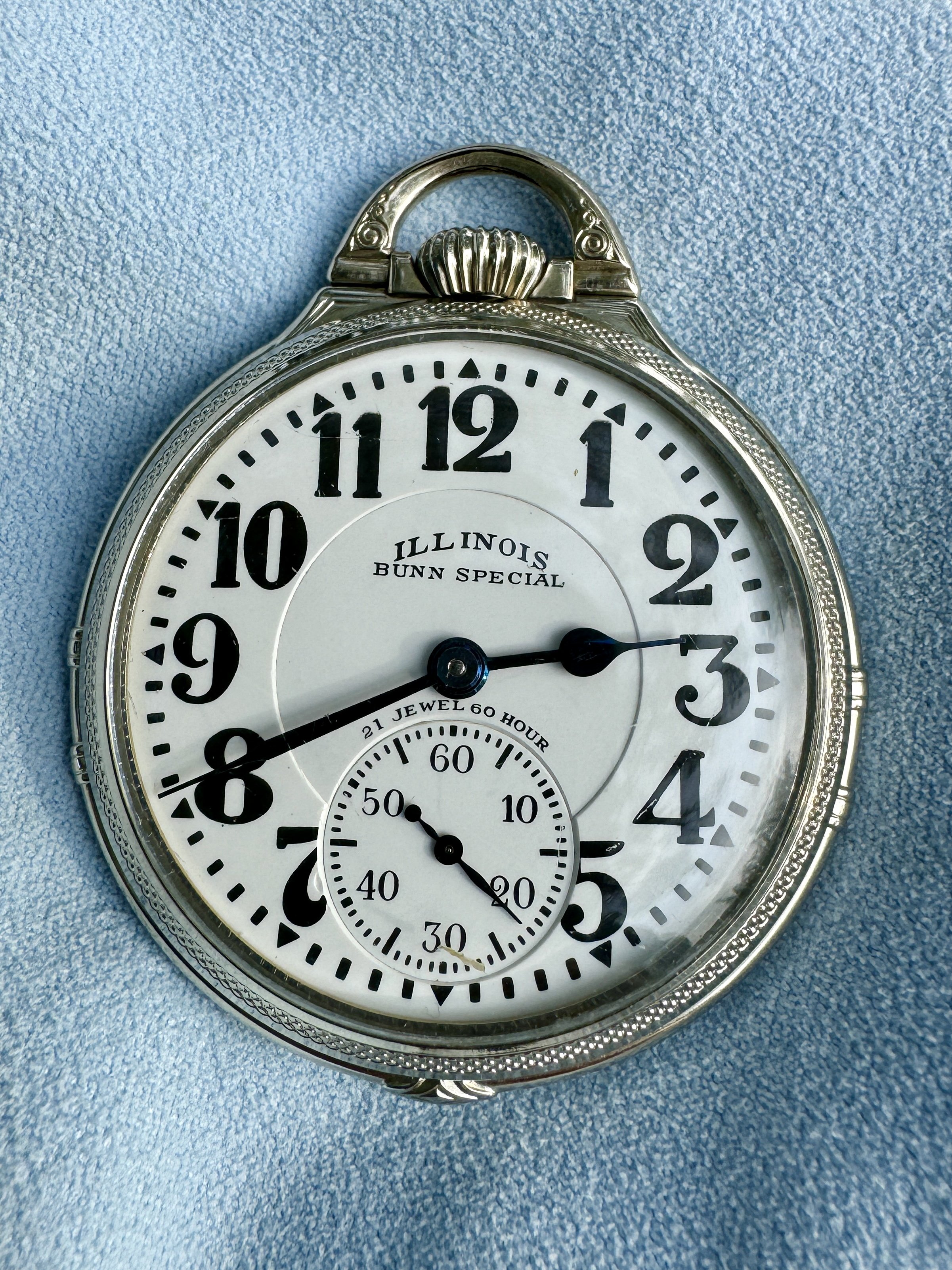

Aspirational Bunn to pair with that fine 1921 example. Keep on the lookout.
Circa 1931 with factory WGF case
That artifact around 6pm is on the crystal

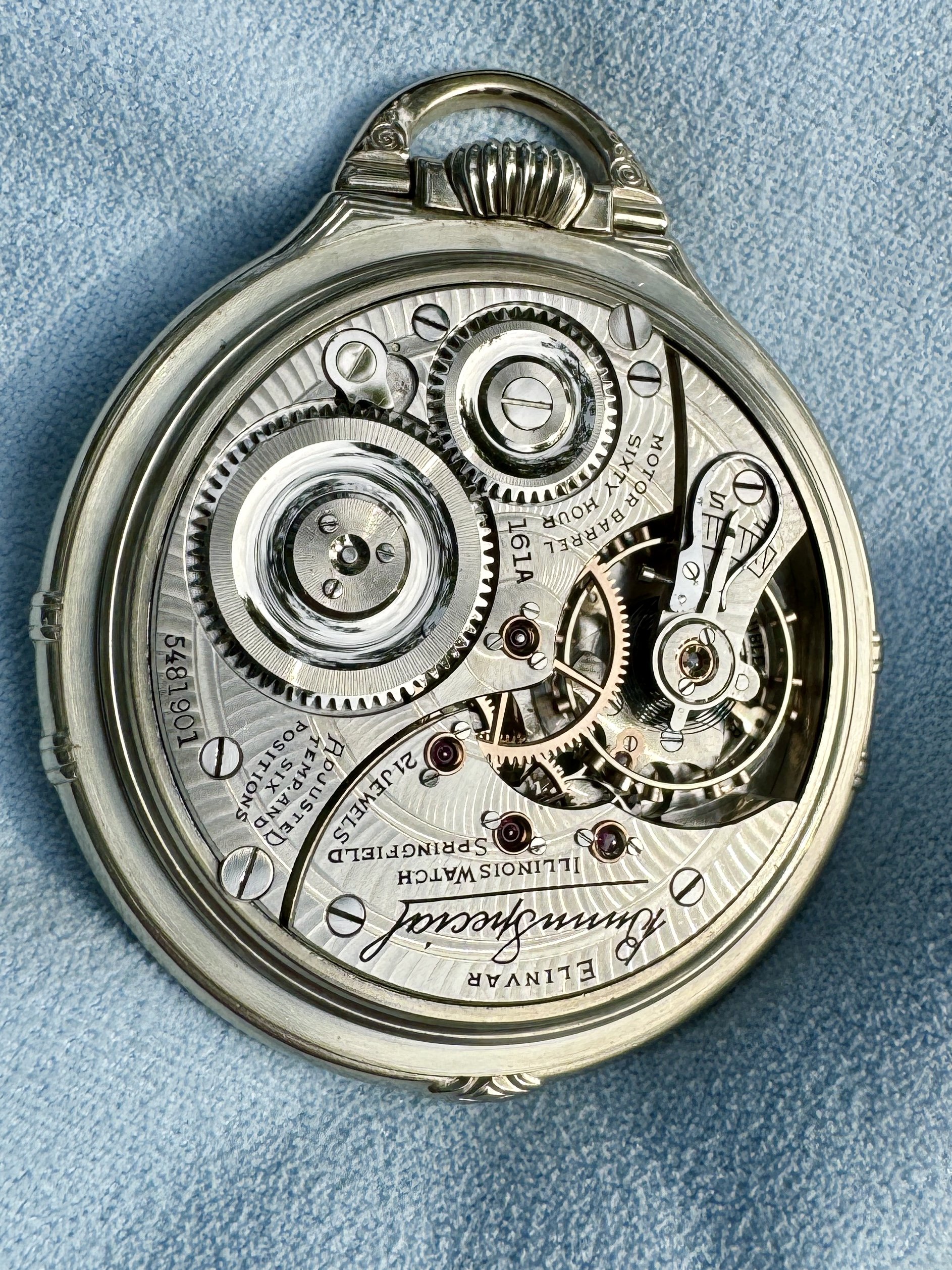

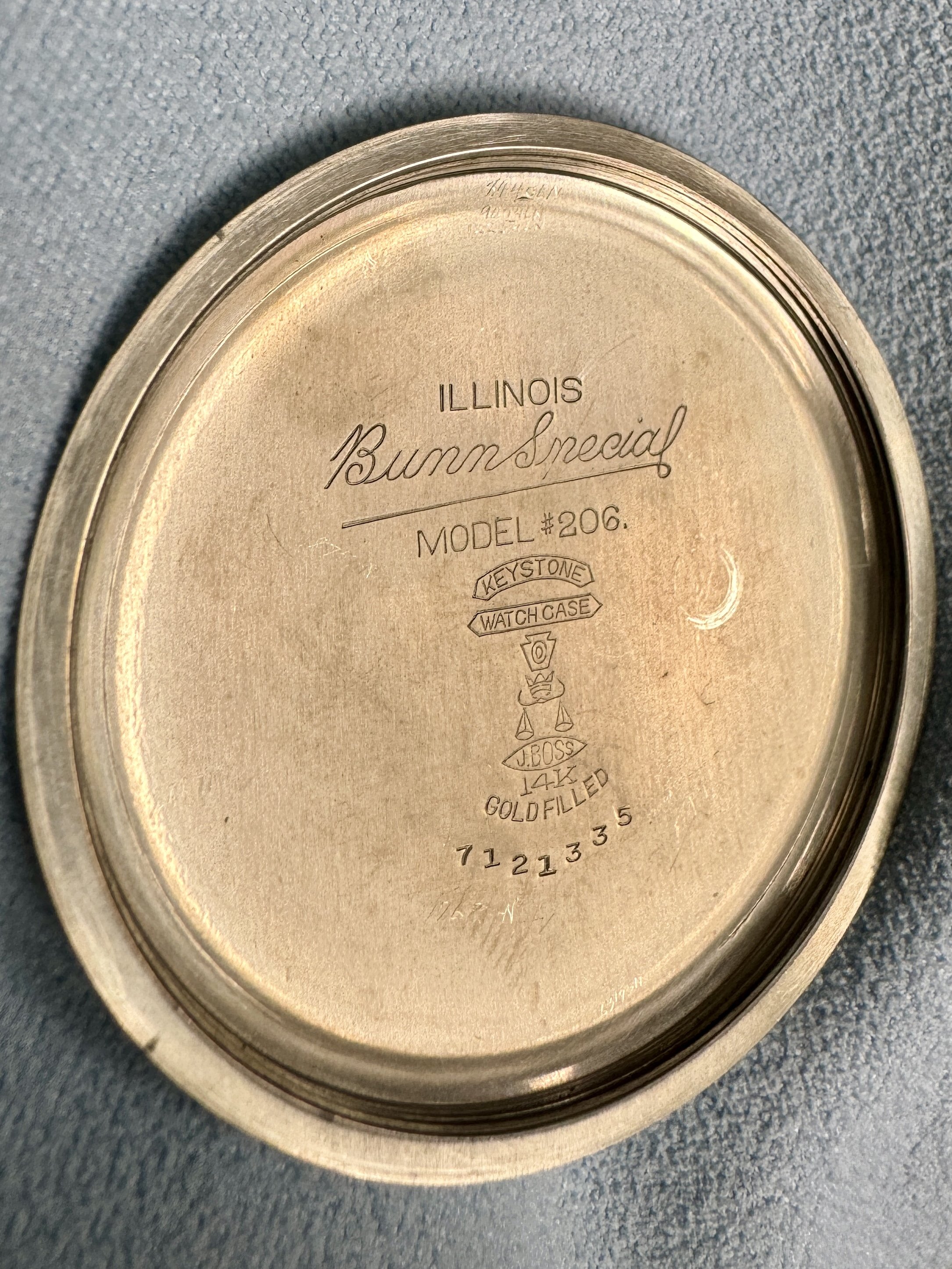

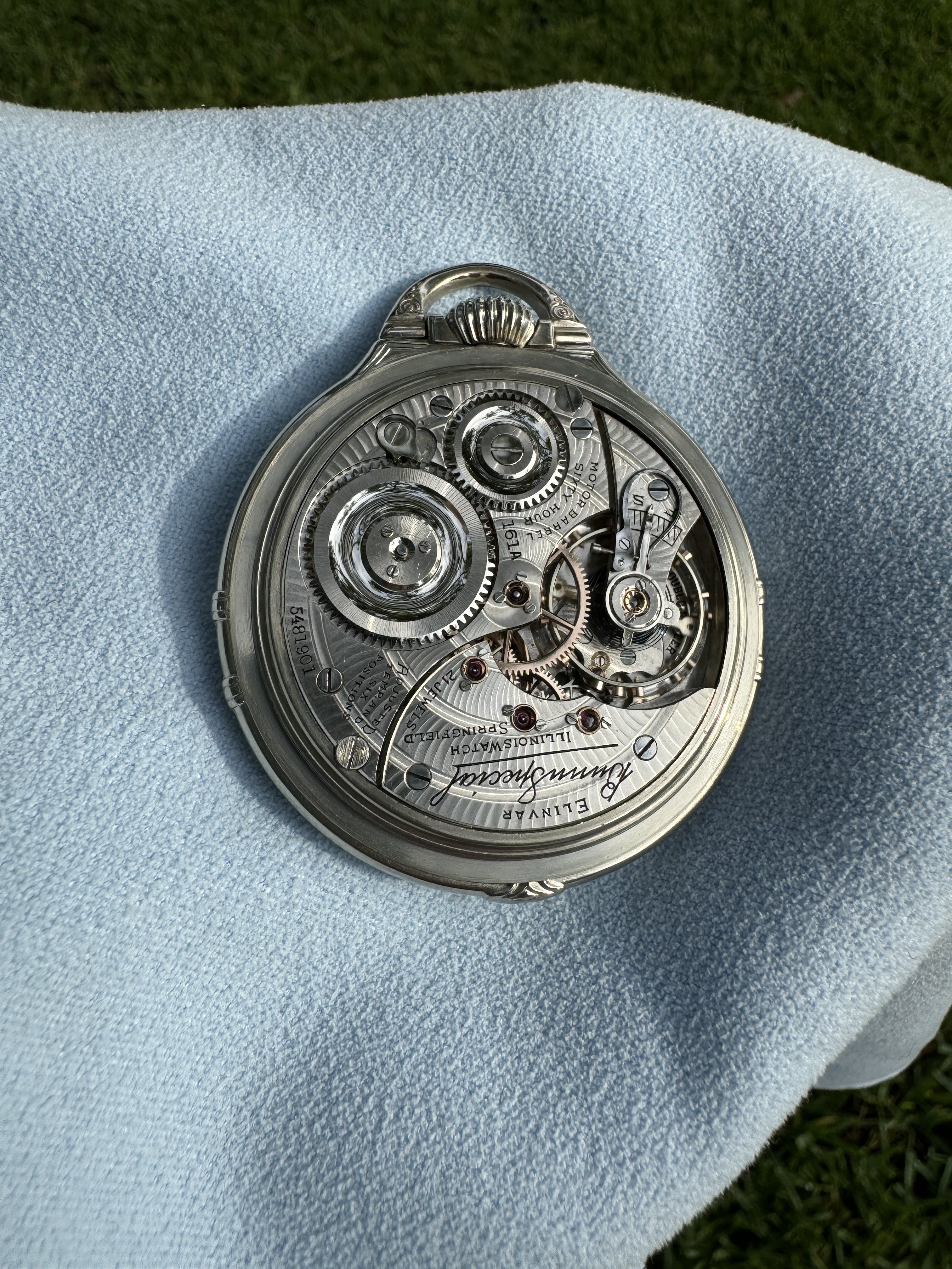

The Illinois movement is marked Elinvar. The name refers to the material used in the balance wheel and hairspring. This alloy is not affected by magnetism or temperature change. It was discovered by a Swiss physicist, Charles Edouard Guillaume. Other U S watch companies featured alloys that were the equivalent to Elinvar. Elgin called their alloy Elginium, and Waltham called their alloy Conium, Hamilton likely bought the copyright, thereby using the name Elinvar, then later Elinvar Extra. Edouard Guillaume:
https://en.m.wikipedia.org/wiki/Charles_Édouard_Guillaume
The handsome Illinois has a serial number which would indicate the watch was made after Hamilton bought the Illinois Watch Co.

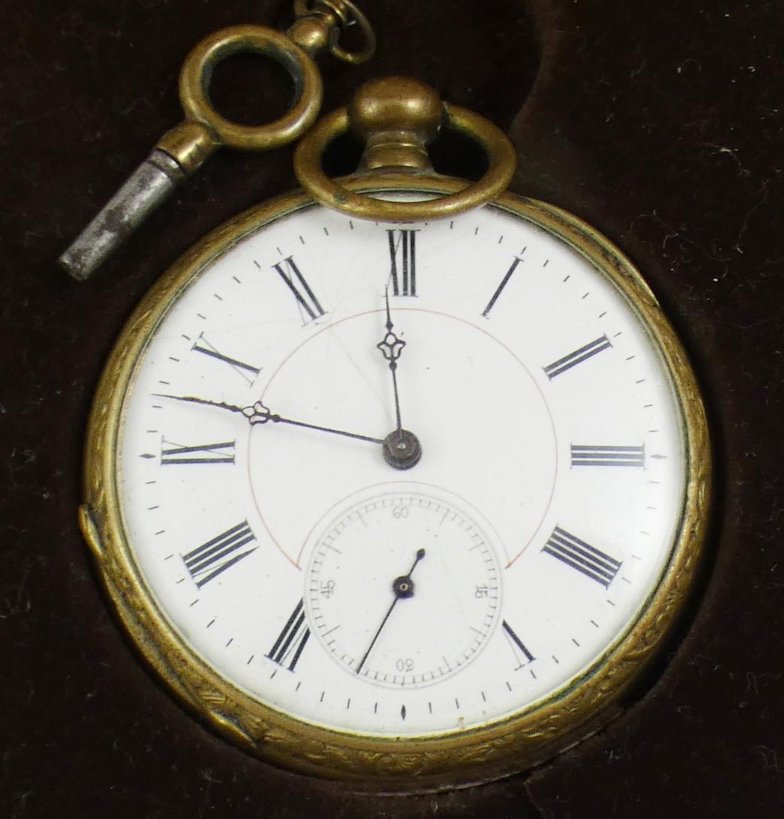

Surprise. I was wondering why it appears that this watch looks better in real than in the sales listing. Suddenly I realized that the seller had replaced the too short minute hand and the (horrible) seconds hand by appropriate ones. Without mentioning 😀. Compare
On my desk:
Listing photo:

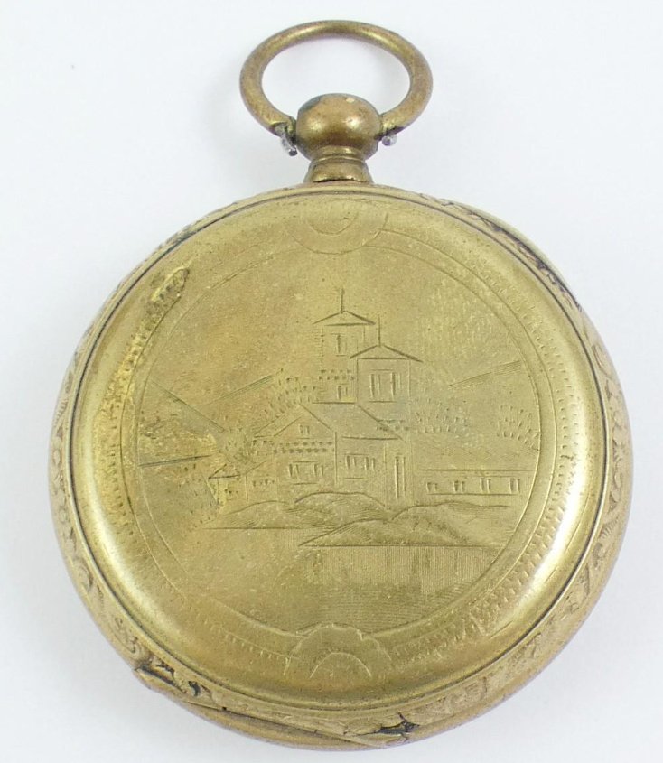

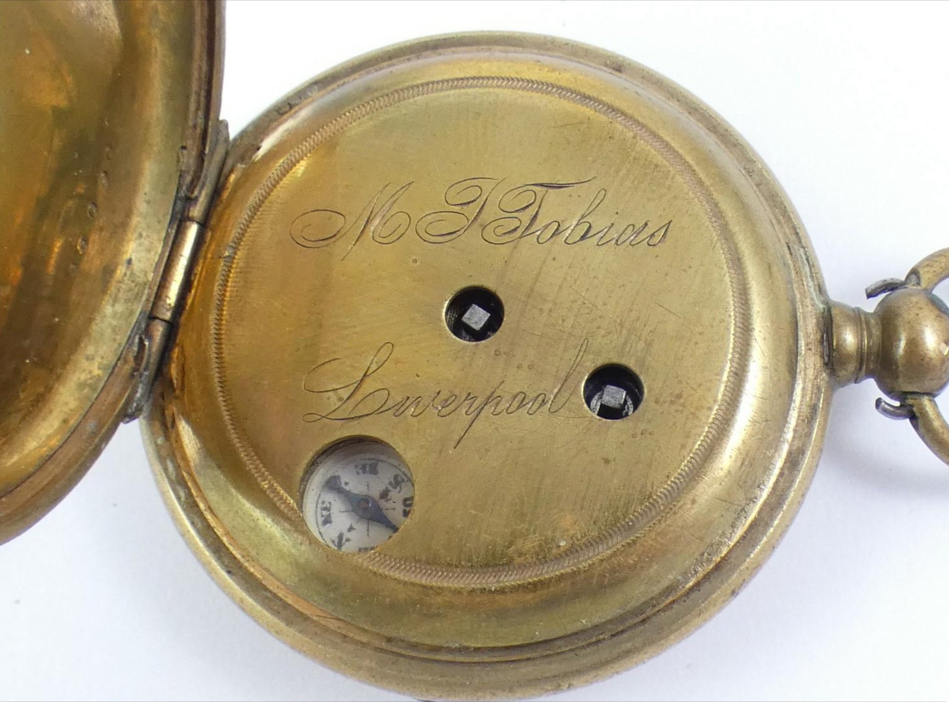

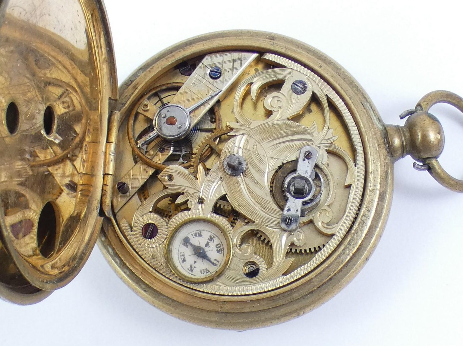

Me too, and don’t tell @Bernhard J 😉 but I have little interest in European pocket watches. This is at a local auction and the compas has me intrigued. Plus, I don’t have a key-wind watch yet.

I did not read the first sentence 😎 and concentrate on the watch. This is a quite low grade Swiss fake with cylinder escapement, intended to appear to be an English watch. During it´s production it really never even came near Liverpool. The signature "Tobias" is known for this kind of fakes. The compas is no unusual feature in these watches either, but of course attracts attention. Goal achieved 😉.
If you get it for a moderate 2-figure amount, and if you like it, go for it.😁
😲This is why I swim in my own backyard pool.👍
I was right to put a high bid of $20 on it.

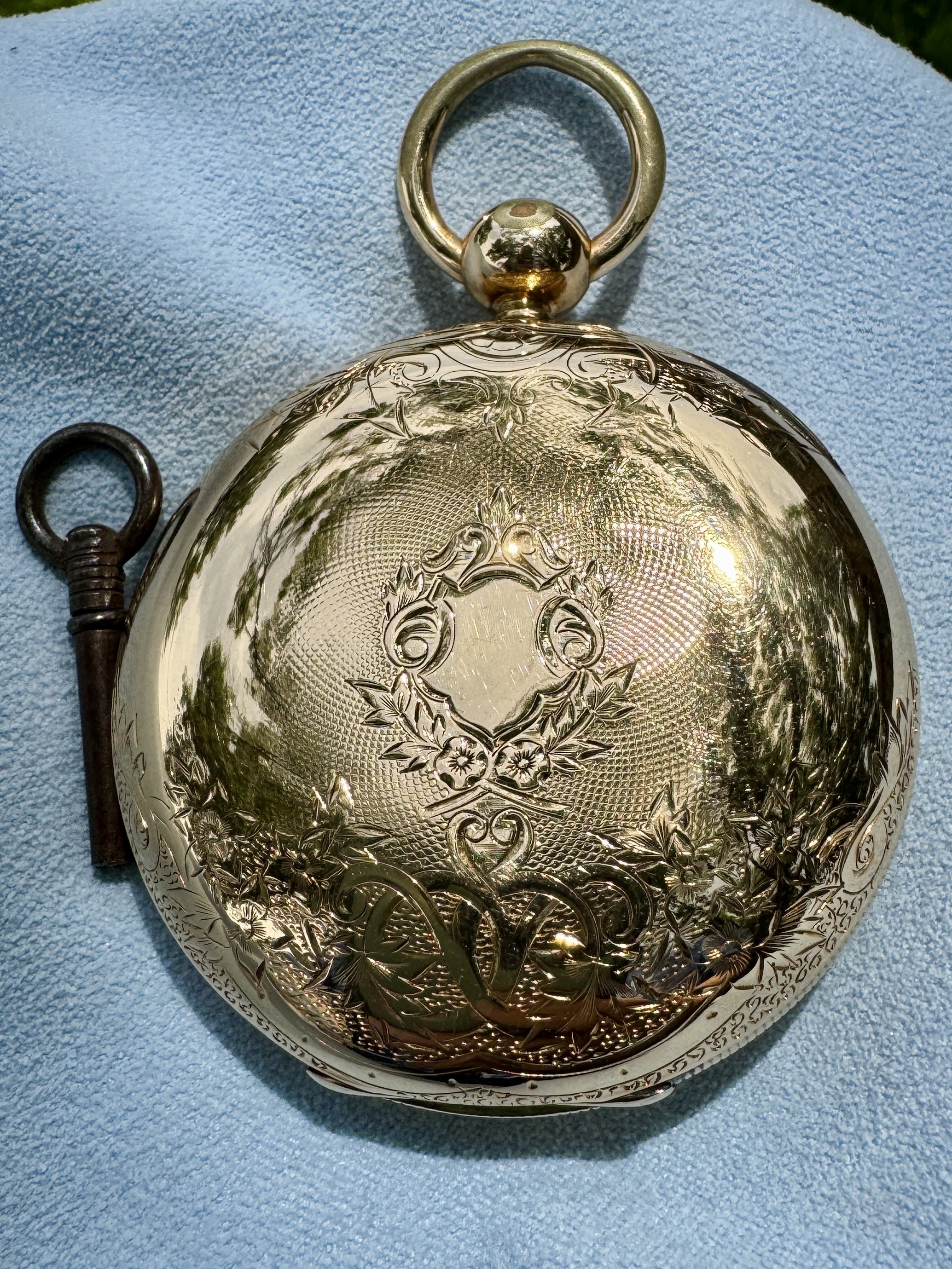

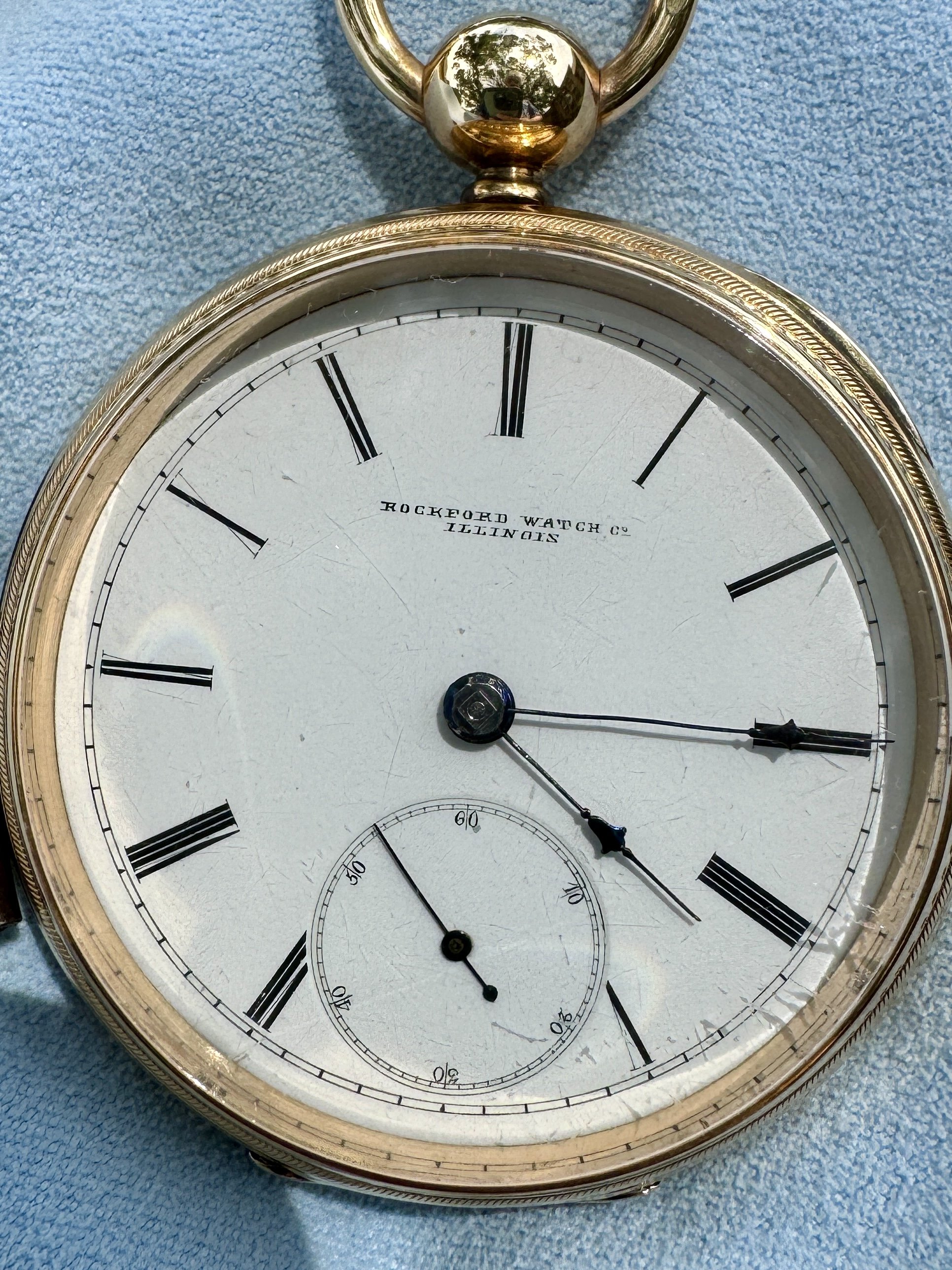

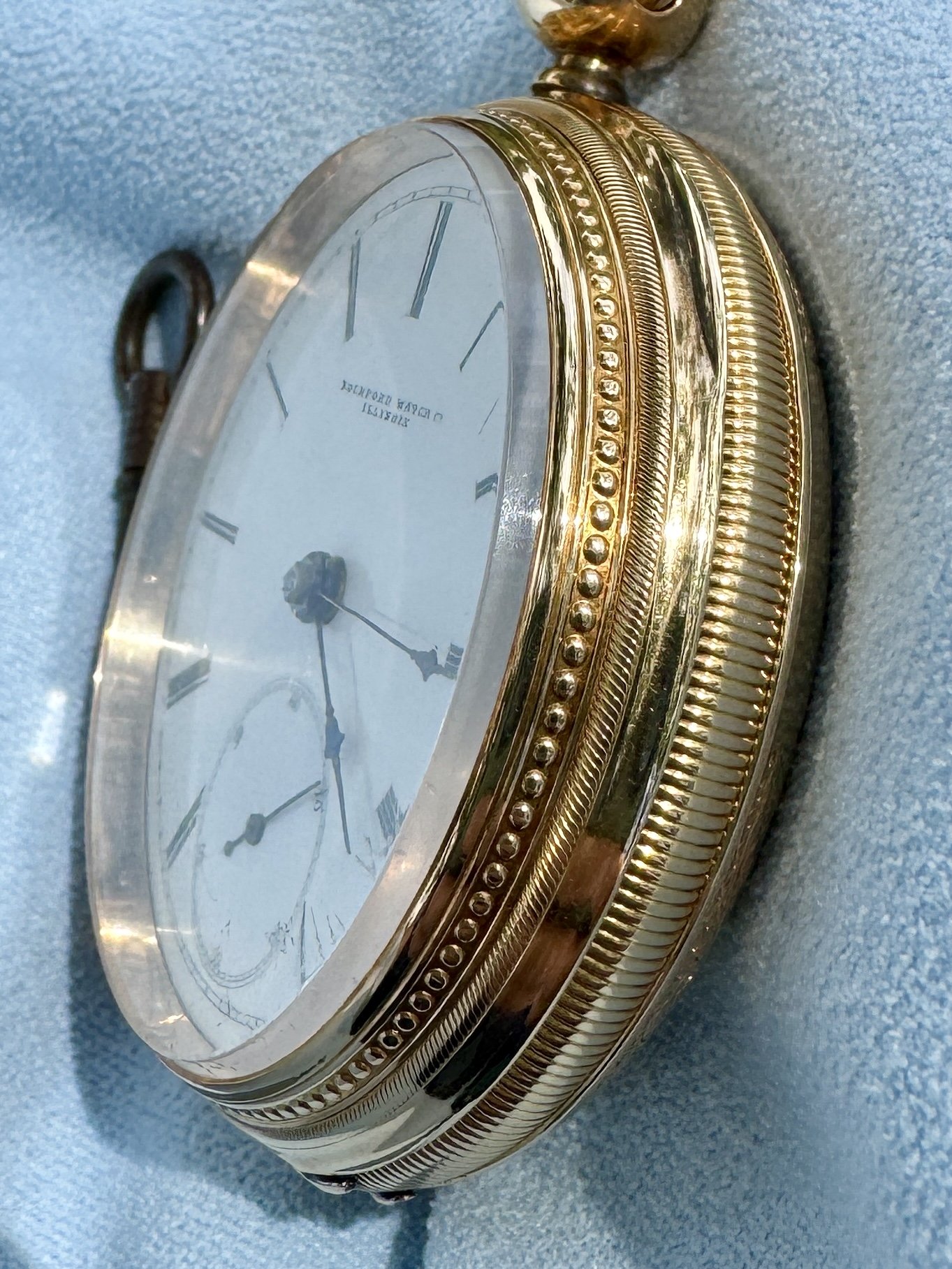

It was time😉 to engage my key wind watches and again, marvel at the beauty of GW Ladd cases.
circa 1874-5 Rockford
Artifacts are on the crystal not dial
5,414
55,554
Now that I own a couple of Ladd cases PW I can really appreciate your high (and justified) opinion of them
