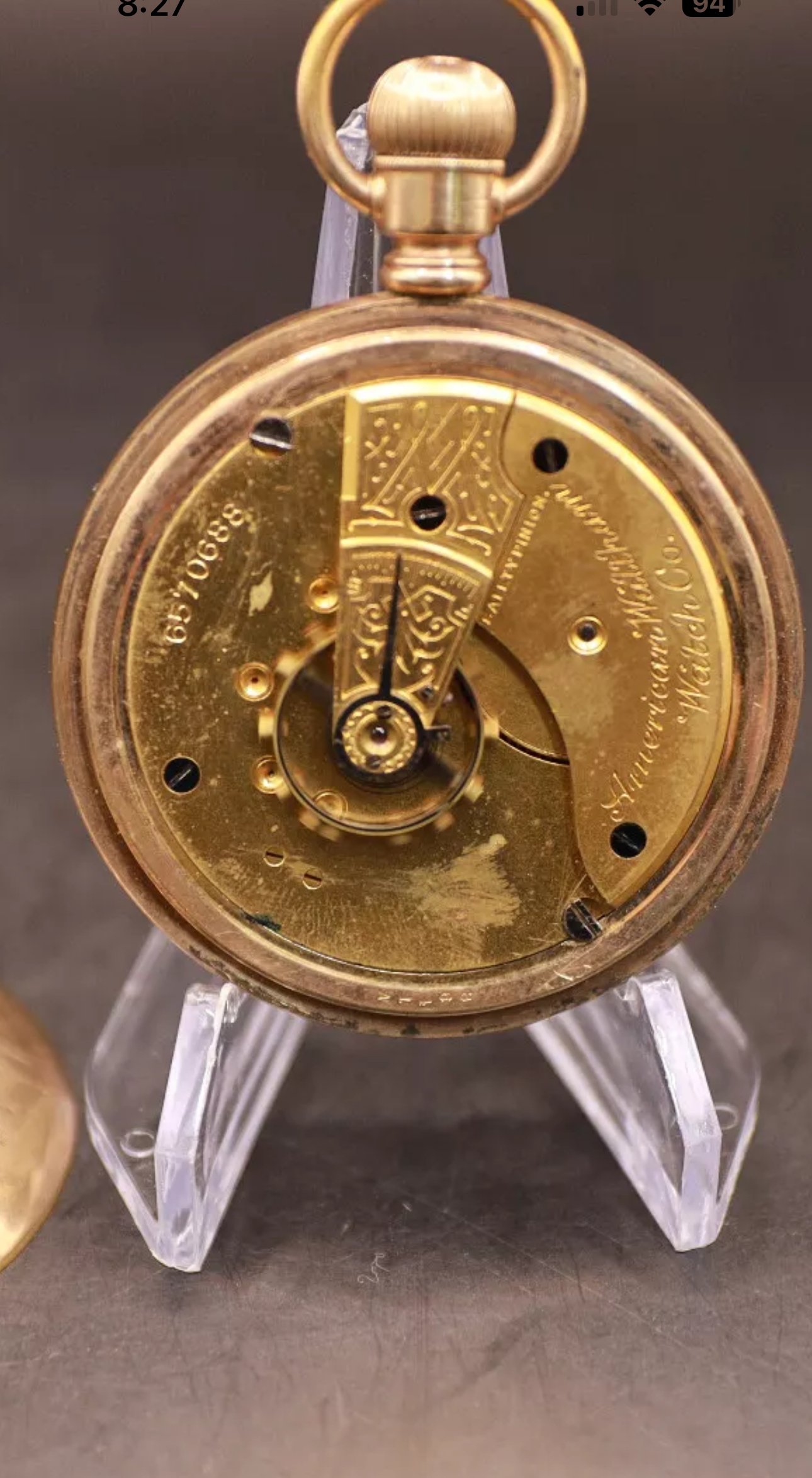

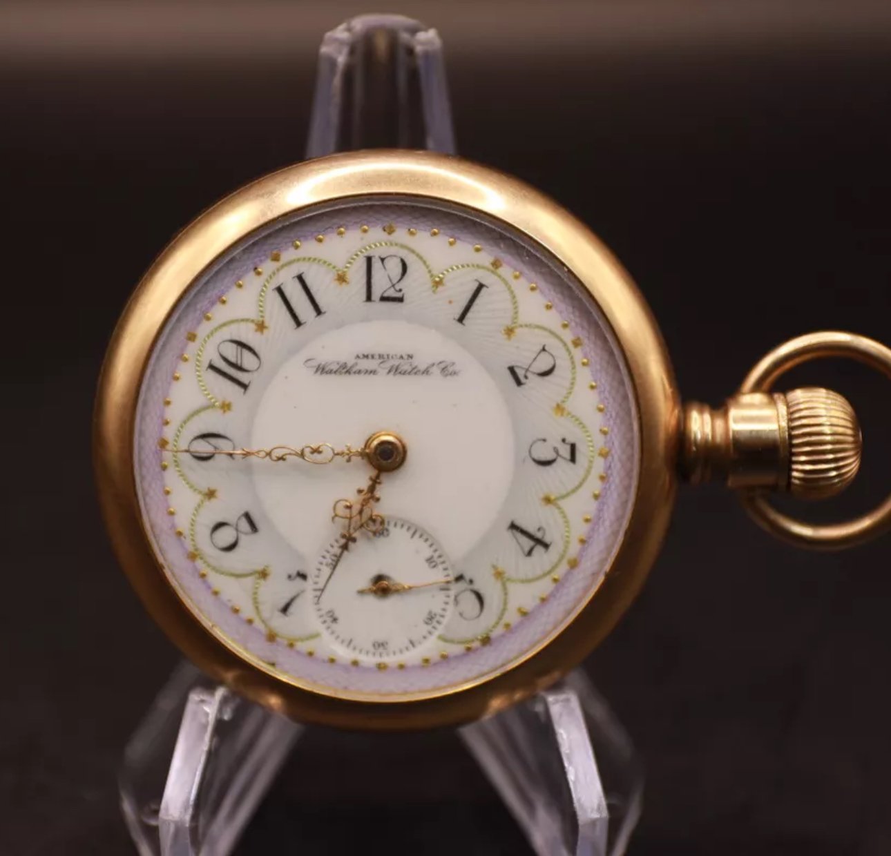

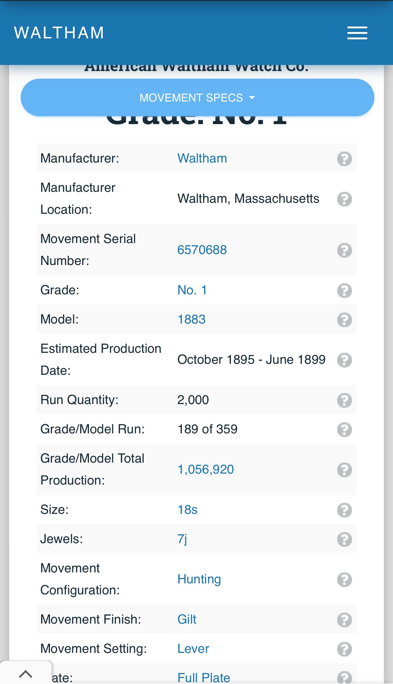

Happened upon this Waltham with an ornate dial. Best I can tell, late 1890’s. I’m not used to the stem at the 3 O’clock position so I did a bit of digging. Seems this style was not intended for a hunter case. Is that right? It is fairly cheap ($100).

. In the era of the subject watch, movements went to retailers in brass tins with a bayonet fitting lid. The buyer in the retail store chose the movement, case, dial, hands, etc., and the retailer assembled the components into a finished watch. A customer could have indeed chosen an open faced case and a hunter style movement, I suppose.

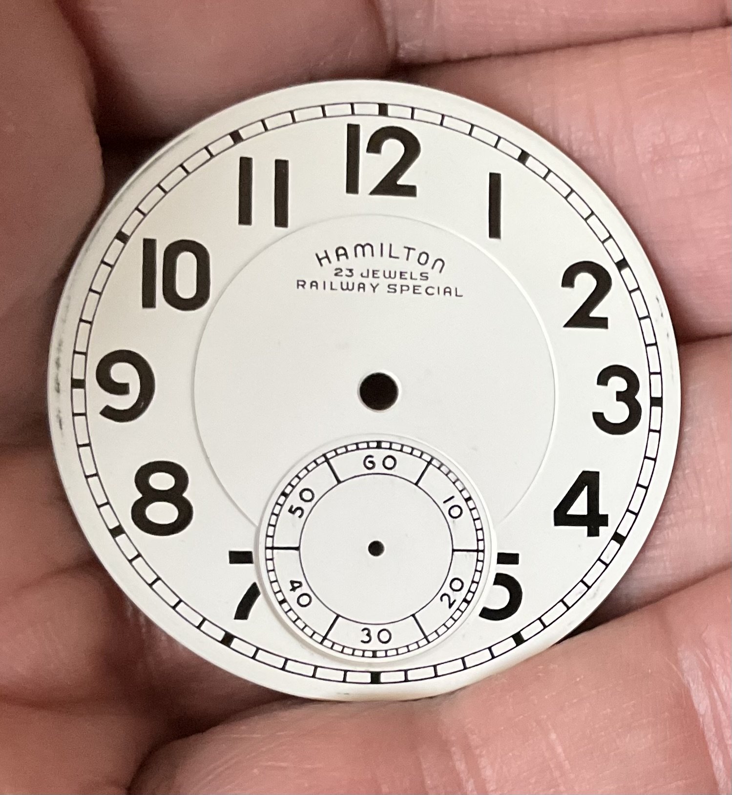

Did melamine degrade all on its own, like a Hyundai Pony did, ori is it a case of malamine + environment + care = condition? I guess I’m wondering if a Melamine dial looks good today, is I likely to stay that way?
I believe that the original melamine dials will continue to degrade regardless of the care. Whereas later dials, lile mine, hold up much better. It's all about the chemical make up of the dial.

You have to remember that when this watch was sold the buyer would pick a movement, case, and sometimes even the dial and hands they wanted, then the watchmaker or jeweler would case the watch. So, an open faced case with a hunter configured movement wouldn't have been unheard of.
Edit: I just saw that Canuck beat me to the punch.

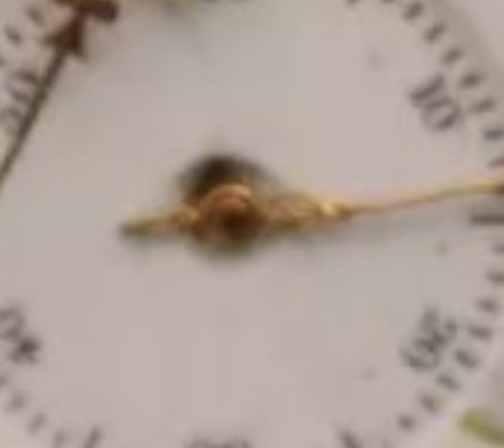

I would be more concernded about the dial not sitting centered on the movement and in the case. See the seconds hand and the varying width of the outer decoration ring. Hopefully the dial is not glued to the movement ...
Looks like possible chipping around the seconds hand as well

Thanks all. These antiquities are a minefield. That’s why I ask.

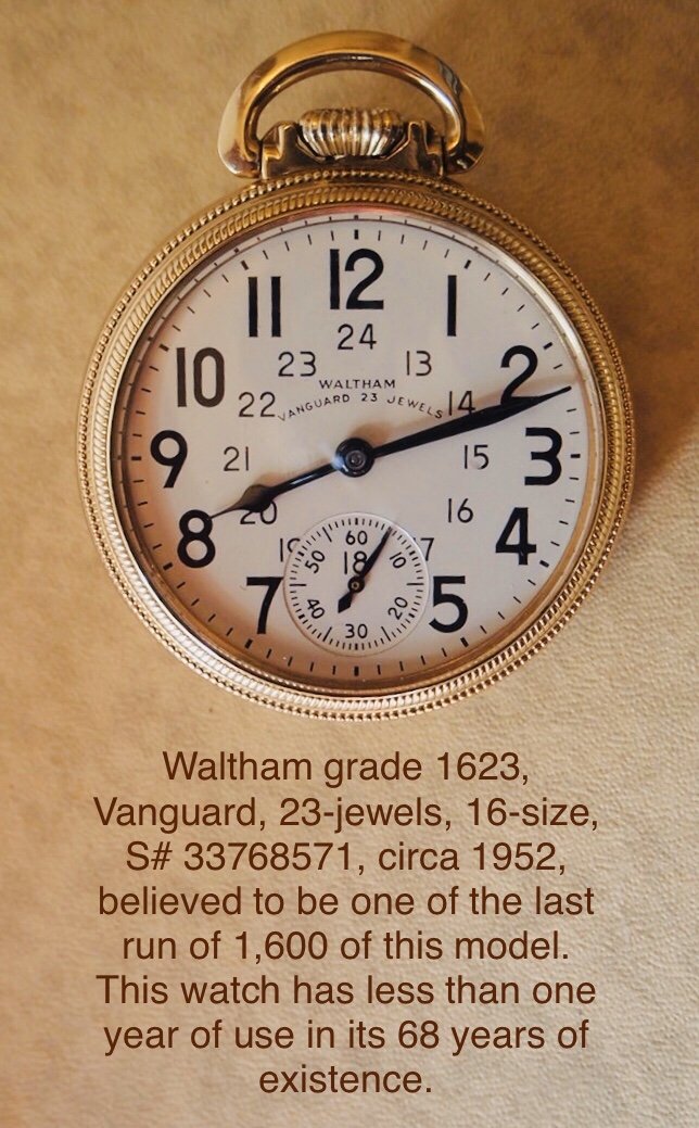

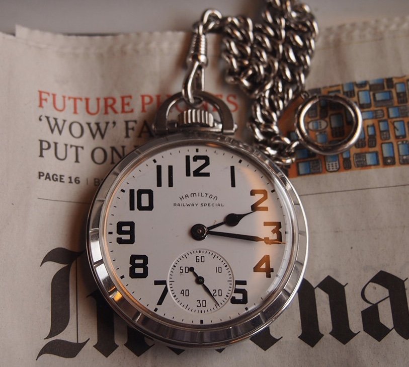

Earlier in this thread, I posted a picture of my Hamilton 950B which came to me about 40 years ago. This one is from the early 1940s. It came with the melamine dial shown in the picture. This watch was produced at around the time that Hamilton switched from vitreous enamel dials, to melamine dials. So this might be an early melamine dial. Some melamine dials cracked and peeled, while some deteriorated not at all (like mine). Or there were degrees of deterioration it appears. Later melamine resin was improved to reduce or eliminate this problem. Question: My early melamine dial is pristine, While dials such as the one on @TexOmega ’s watch were not so fortunate. Why? Ultraviolet light? Environment? Faulty production? Anybody’s guess!
My original 950B melamine dial.

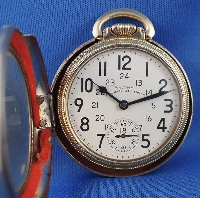

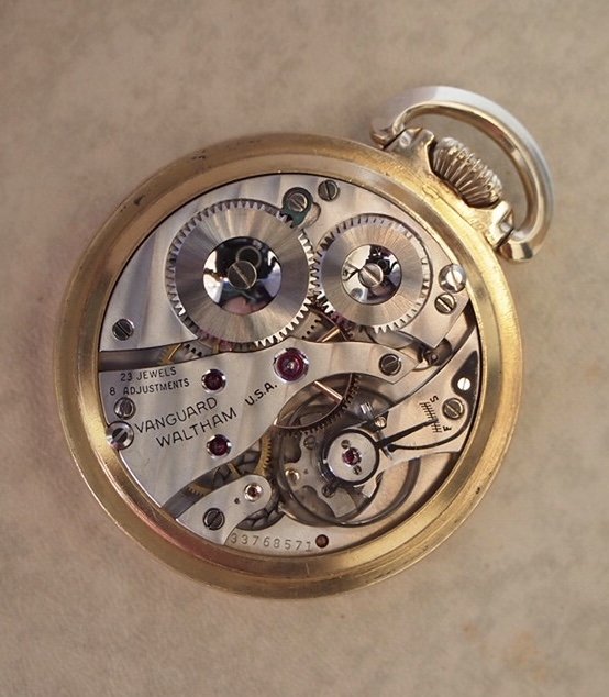

Later melamine dials such as the one on this ‘50s vintage Waltham Vanguard (which I no longer have) appear to have stood the test of time rather better. This watch was owned by two successive owners, and neither of them ever used it! I bought it about 2005, and I likewise never used it! Melamine dial is pristine.
I also have. Hamilton 992B from the early 1960s which also has a pristine melamine dial.

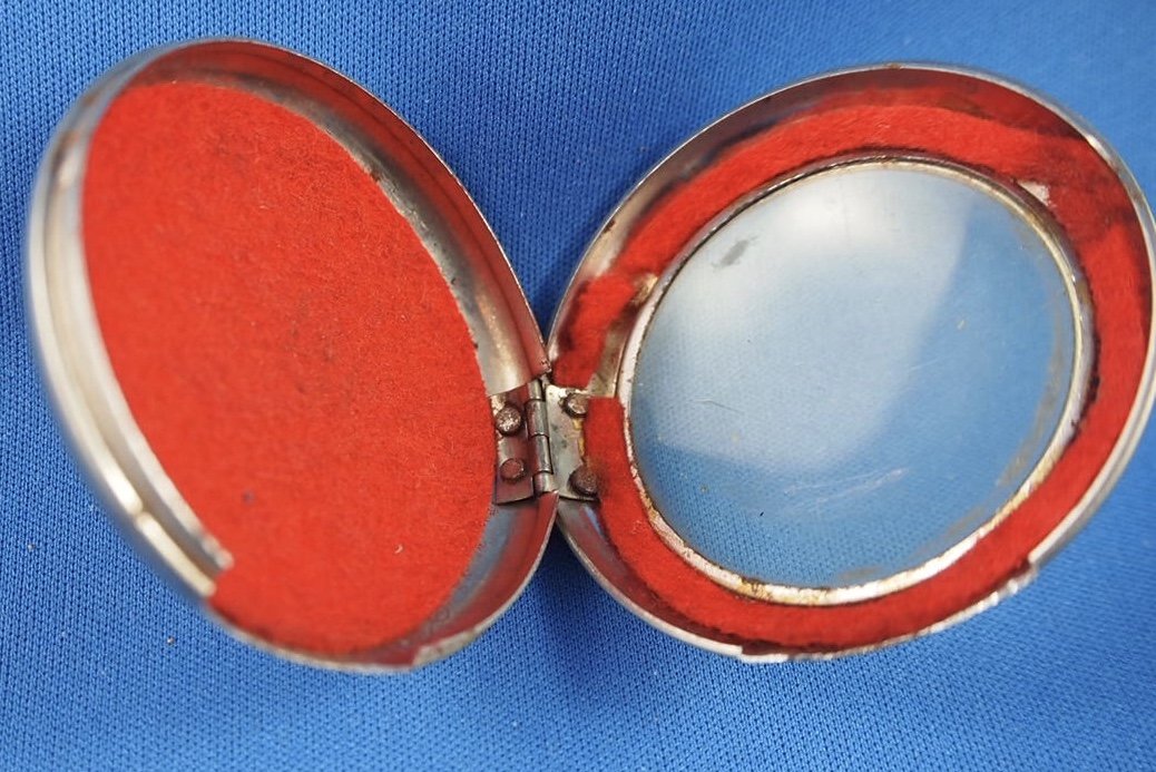

The Waltham Vanguard I posted (above) came to me in a felt lined stainless steel case as shown. The protective case was fitted by the original owner of the Waltham, and the watch reposed in the protective case for about 40 years, while being owned by the first two owners. I bought the watch and removed the protective case.
5,076
15,713
Ohh that’s nice! Is that outer case beat up from use, or did the original owner just take really good care of everything?
15,997
48,117
The watch was bought in either Coaldale or Coleman, Alberta in the 1950s. (Forget which.) He bought the protective case with the watch, and put the watch into the case, and stuck it in a drawer. Never used it! In 1971, his advanced age meant he was divesting himself of some stuff, including the watch. He phoned the guy I bought it from and asked if he wanted it. He did! He left it in the case, took it home, and stuck it in a drawer where it reposed until I bought it about 25 years ago. I bought it, brought it home, removed the case, and put the watch into a protective watch storage case where it reposed until I sold the watch in 2022. I might have used the watch a dozen times while I owned it. I sold it to a guy who is the president of a telegraphy club which regularly operates at our local historic park (Heritage Park). At last it is being used in a role for which it was intended.

My 950B was produced circa 1942-43, or at around the time that Hamilton began replacing vitreous enamel dials with melamine dials. Thereby, my Hamilton melamine dial might be considered a fairly early one. It is perfect! It occurs to me that external factors were the cause of melamine dials flaking, cracking, and peeling. I showed 3 melamine dials in a prior post. One from the mid 1940s, one from the mid 1950s, and one from the mid 1960s. All of them are pristine. All of them on watches that had little use. If there is an answer to the deterioration of melamine dials, I don’t know what it might be!

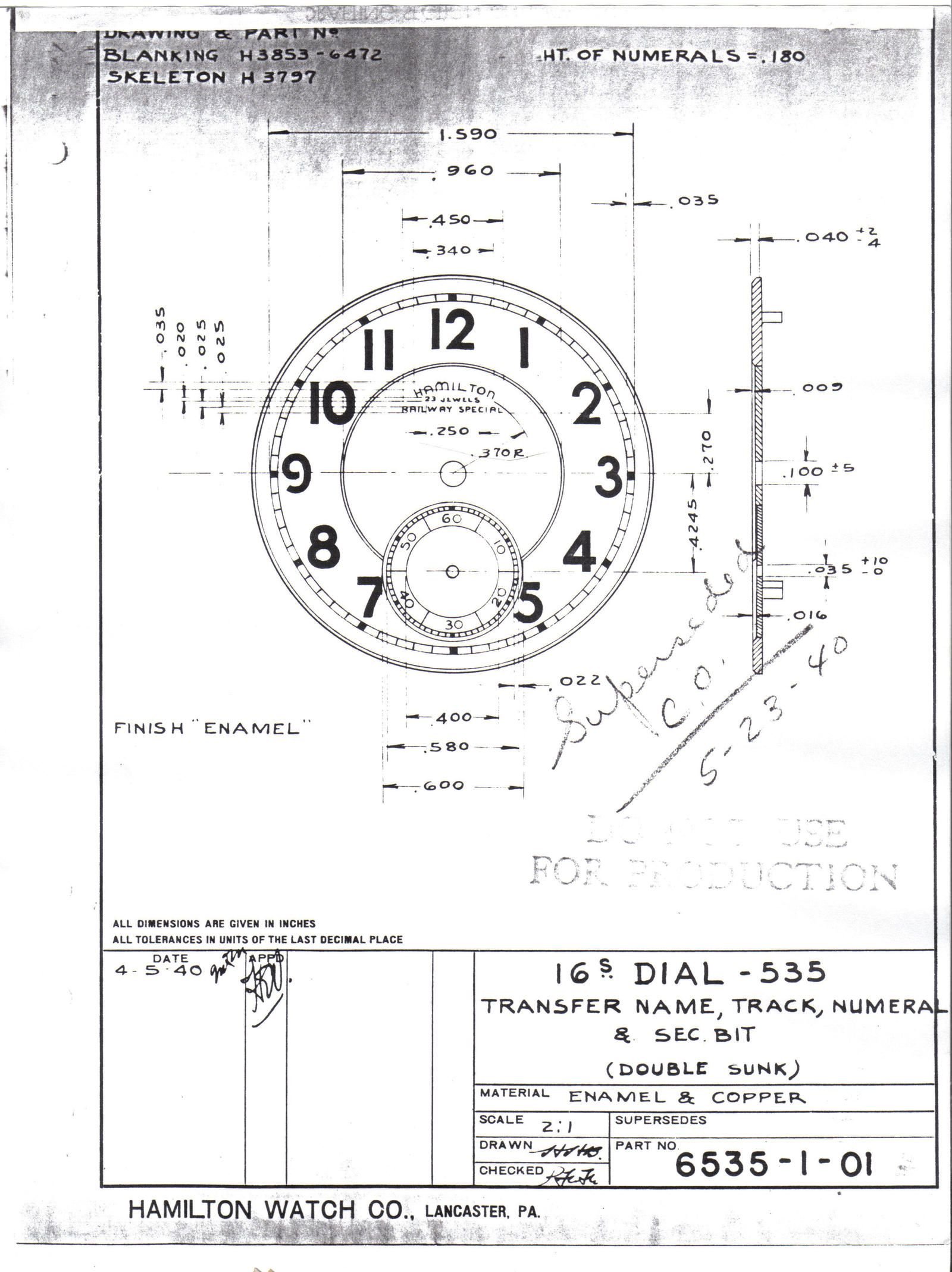

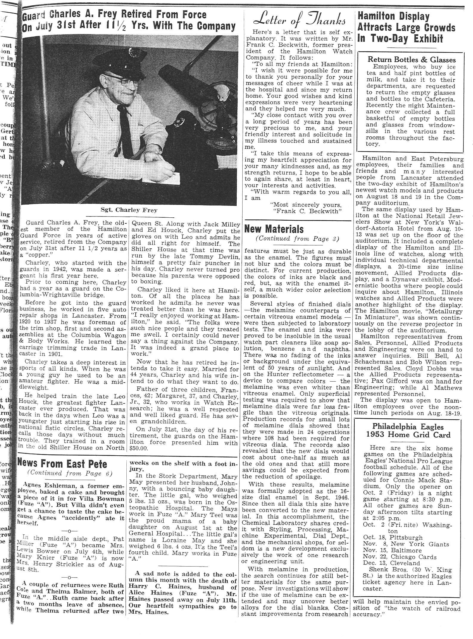

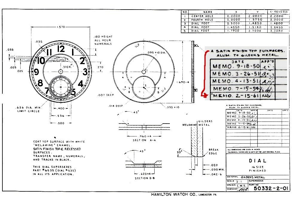

production records for small lots showed 24 operations vs 108 so would cost 1/2 as much
"AND ONLY SUPERFICIAL TESTING was required to show that Melamine dials were LESS fragile than the vitreous originals "
I would suggest a bit more rigorous testing would have shown just the opposite, unless the cost-cutting decision came first.😁.......those lucrative Govt contracts had run OUT 📖
