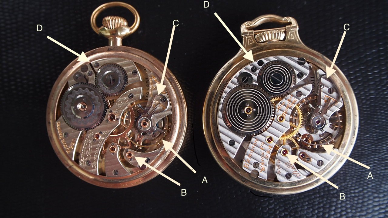

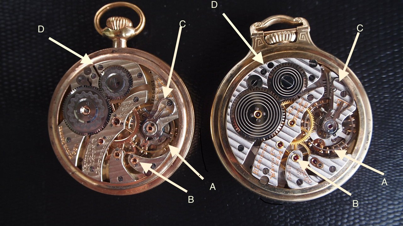

Bear in mind that modern railroad watches such as you 992B have cases with a short (or non-existent) neck, or pendant on the case. There is no room for the typical sleeve inside the pendant, thereby, the crown can’t be pulled out! Earlier models with a typical pendant on the case are different. On such older cases, there is room for a sleeve in the pendant. The case may contain a lever set movement, but the stem can be pulled outward. Such cases are adaptable for both lever set and stem set movements. So as you embark on the collection of railroad watches, bear this in mind.
I have shown two railroad watches. One is a Hamilton 950 from the 1920s. The other is a 950B for the 1950s. Both railroad watches, both lever set. The one on the left is the older 950 model. Note the case on the 950 has a pendant, and an internal sleeve. The movement is lever set, and the stem can be pulled outward. The one on the right is the 950B. Note, no pendant, no sleeve, and the crown can’t be pulled out, even though the movement is lever set. Of course, the case on the 950B is also bar-over-crown, which is a dead giveaway that the stem can’t be pulled out!

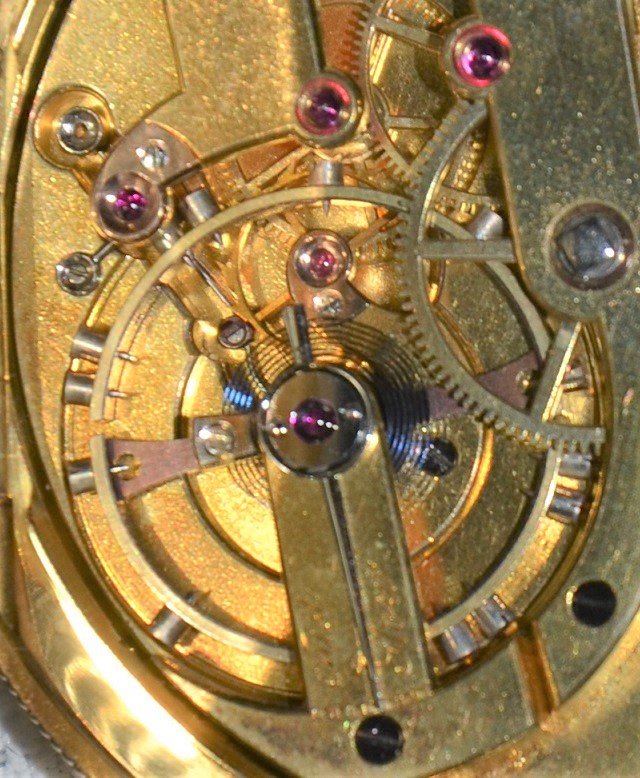

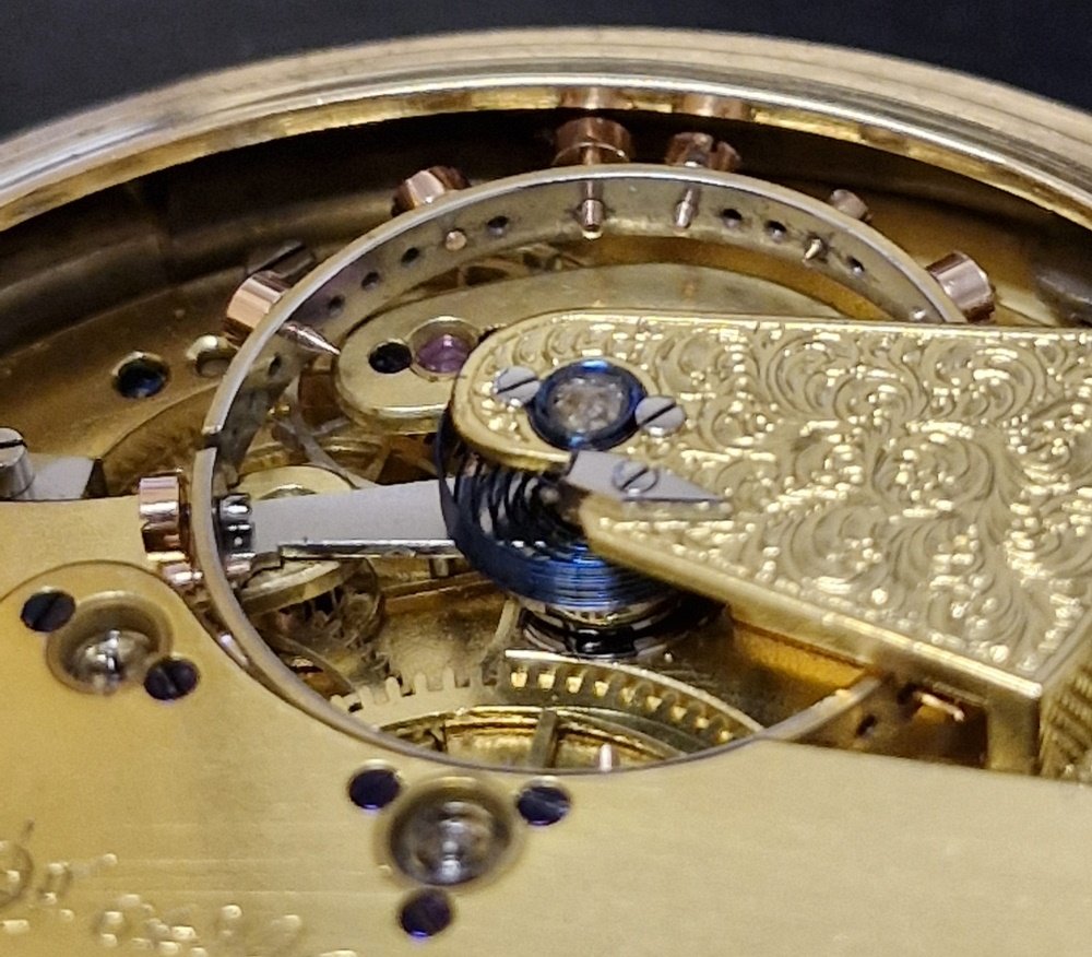

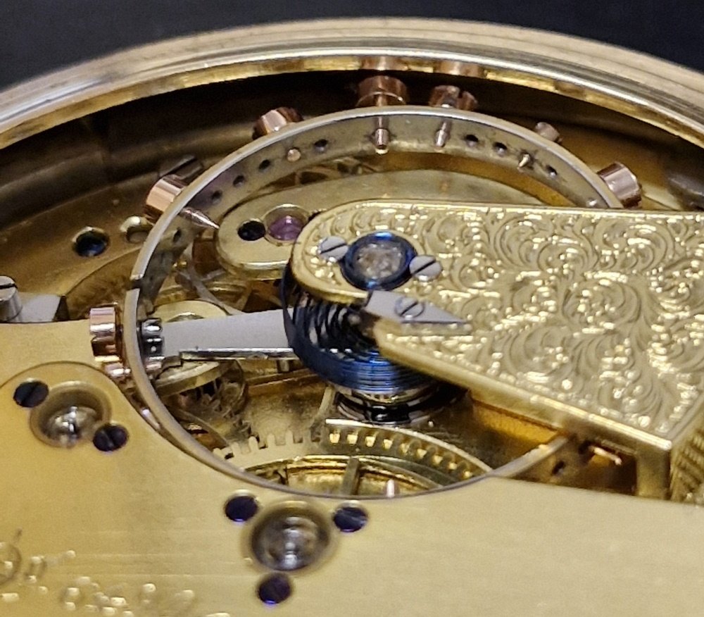

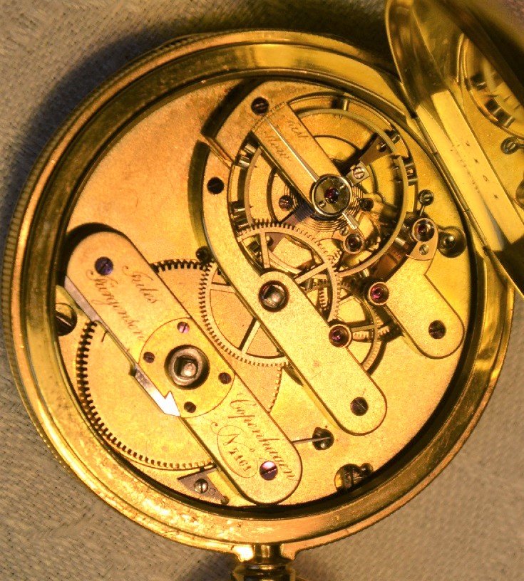

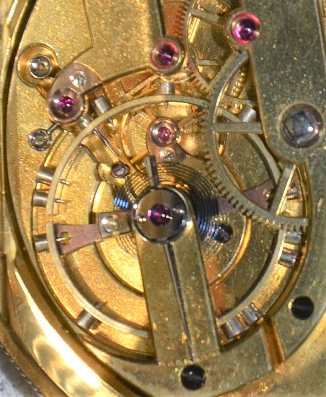

I am awaiting to get my newest purchase, a Parkinson & Frodsham chronometer, freesprung, duo-in uno hairspring, fusee with keyless winding, and up/down subdial. 😀
Today it has arrived and I am delighted! Here a detail photo of the hairspring.
15,997
48,117
I took another peek at your original post where you showed the pictures. I called this a “spring detent” escapement. A second look tells me it might be a pivoted detent. Whatever, it is outstanding! Congratulations!

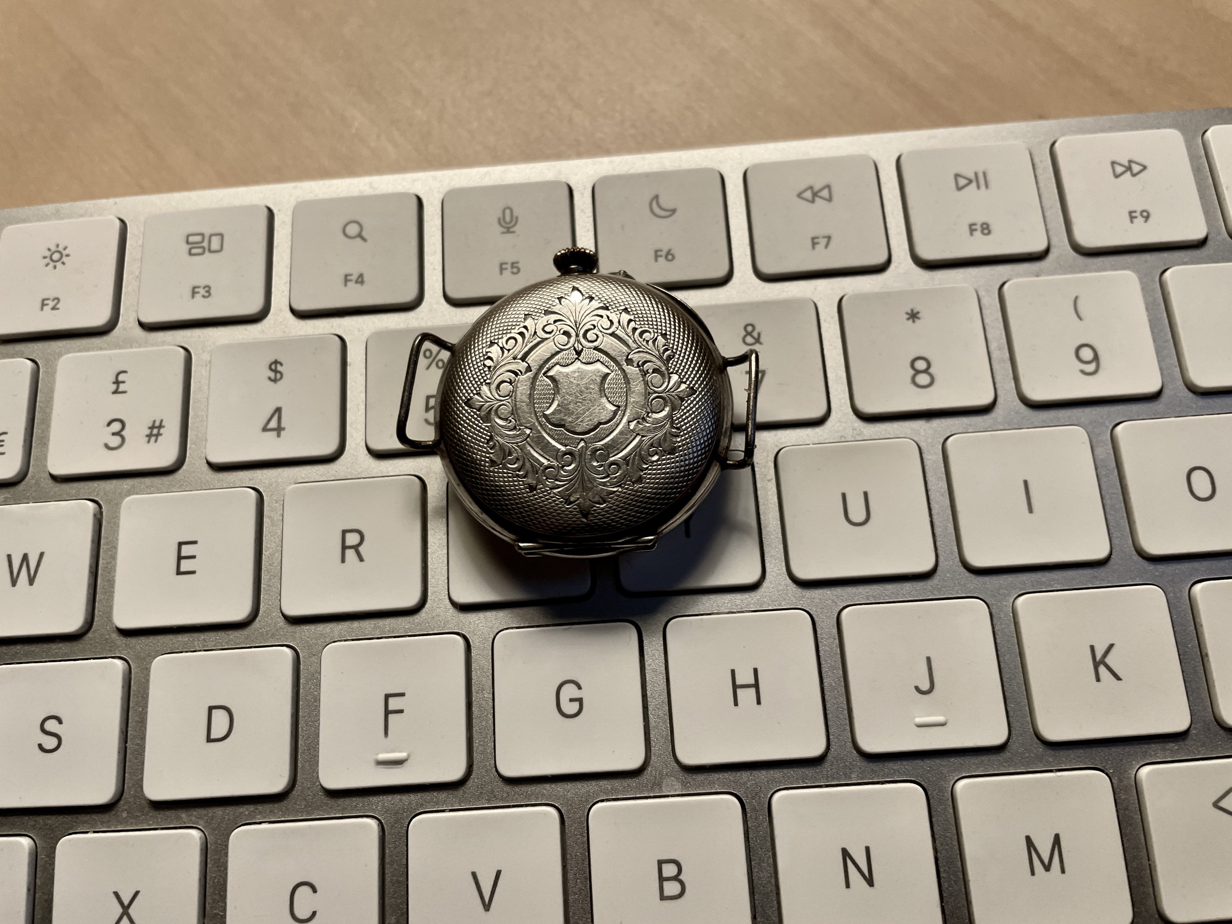

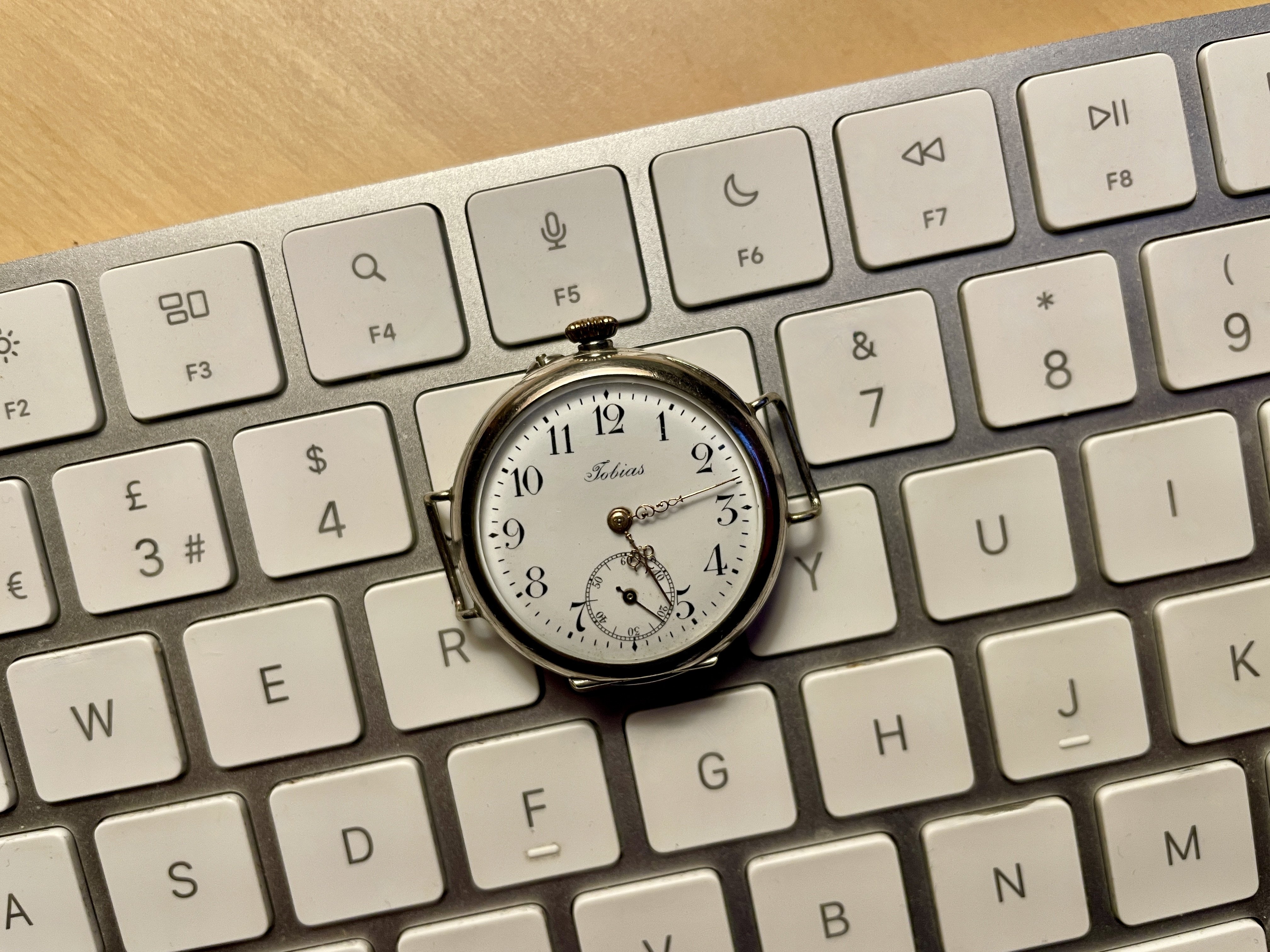

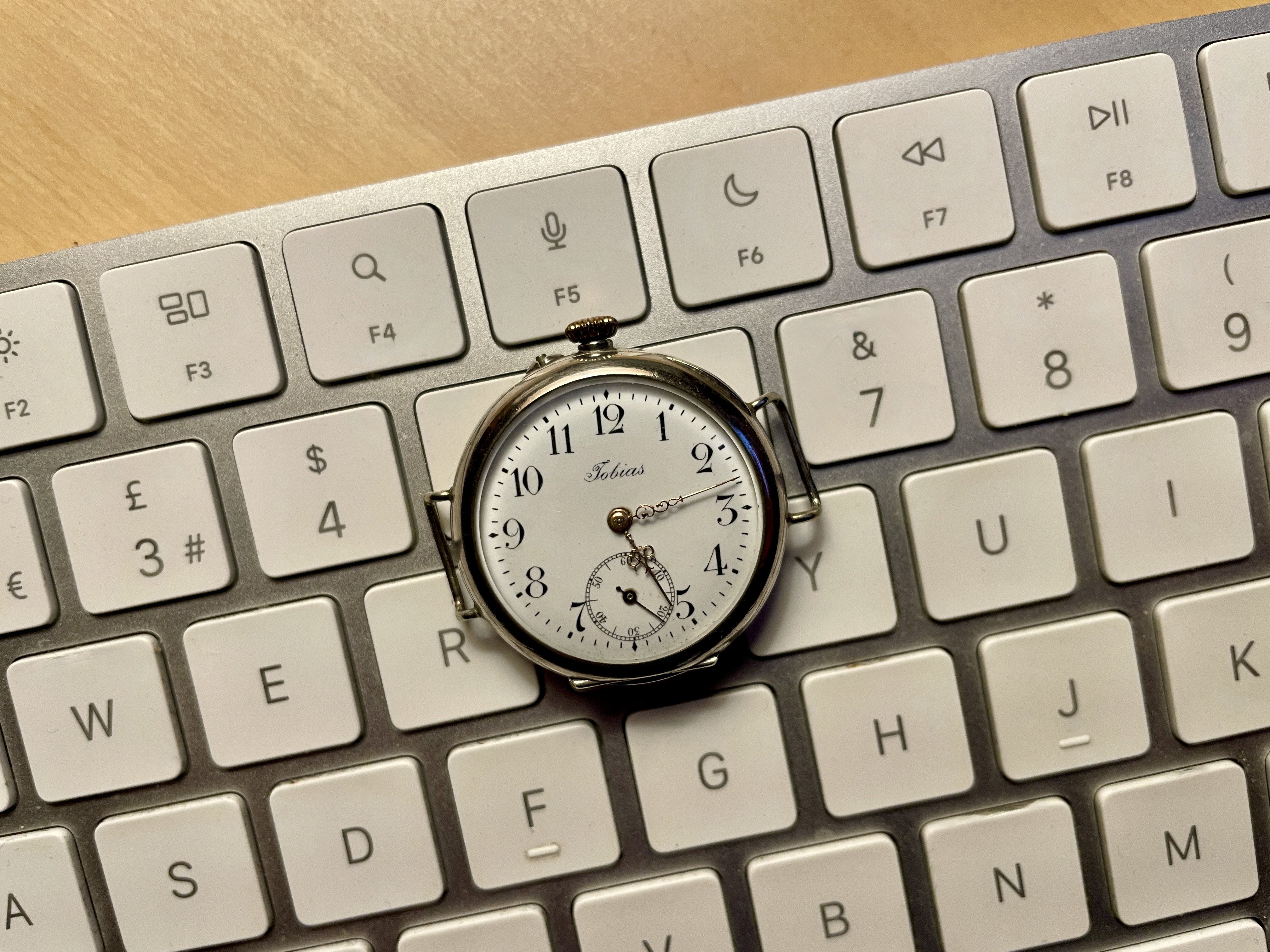

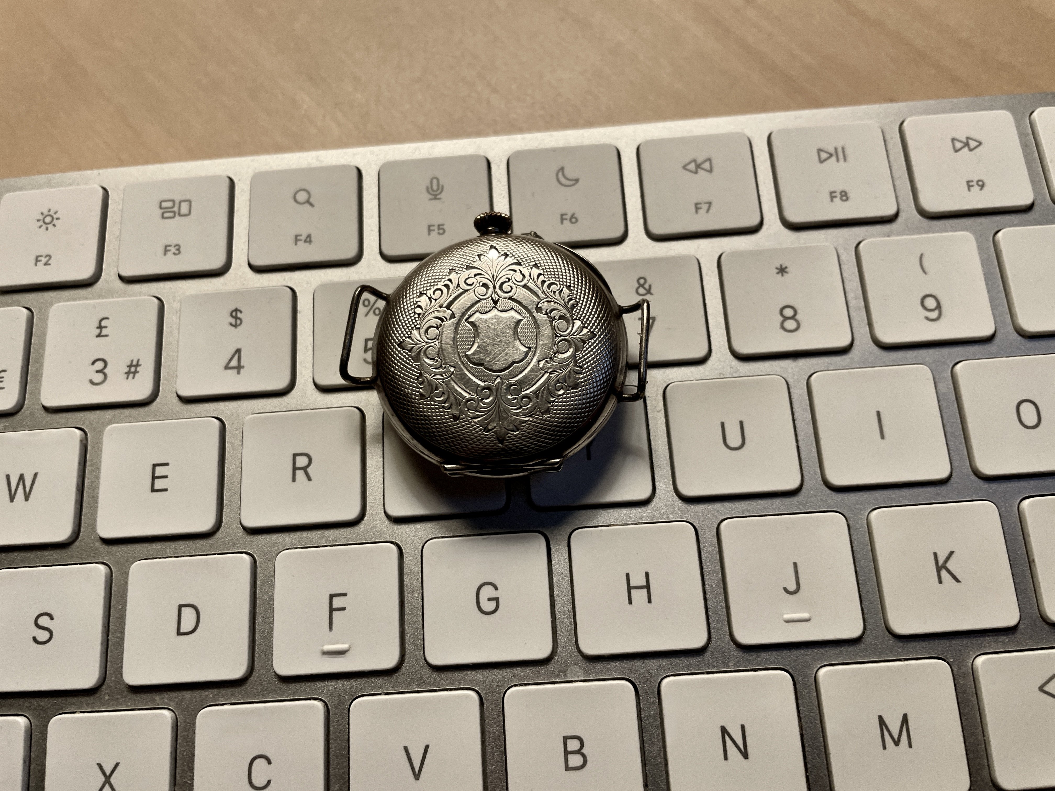

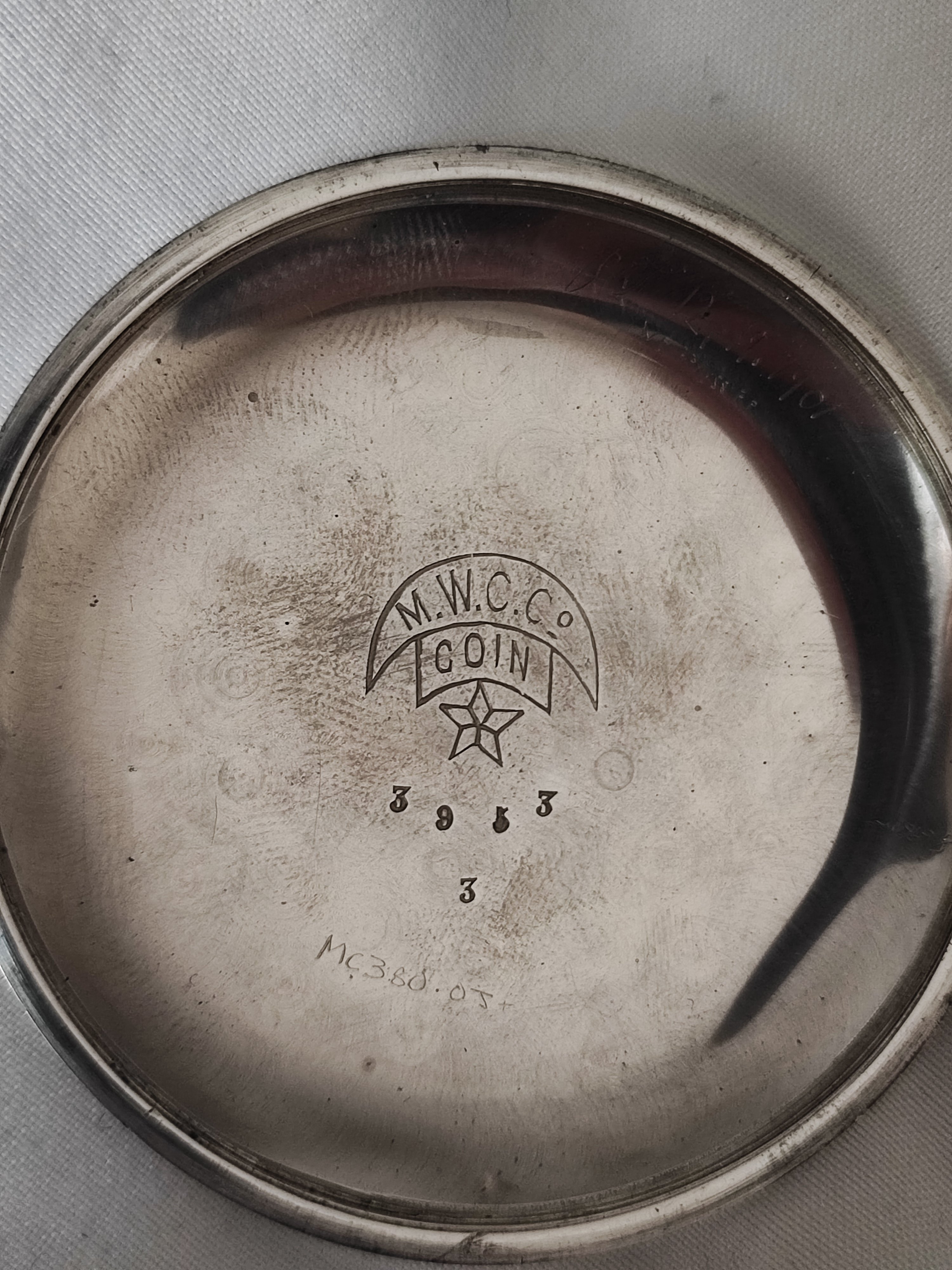

Once upon a time this was a silver cased pocket watch and then someone decided to convert it 🤦
15,997
48,117
Early in the 20th century, this was common. This was likely a woman’s watch, worn on a chain as a pendant watch, before the conversion. Hunter cased watches (crown at the 3, not the 12) were also fitted into new cases (without the cover). And you often see conversions of hunter cased watches that were done which meant the dial was also replaced. If that type of conversion was done, the conversion dial was rotated 90% counter-clockwise, so the crown would end up at the 3, but the seconds bit ended up at the 9! An early form of recycling!
It is a spring detent escapement. In the detail photo, far left, you can see the spring block/foot. A pivot detent would be rather untypical for an English watch, the pivot detent was preferred by the Swiss (and French) makers. Here a Jürgensen as an example.

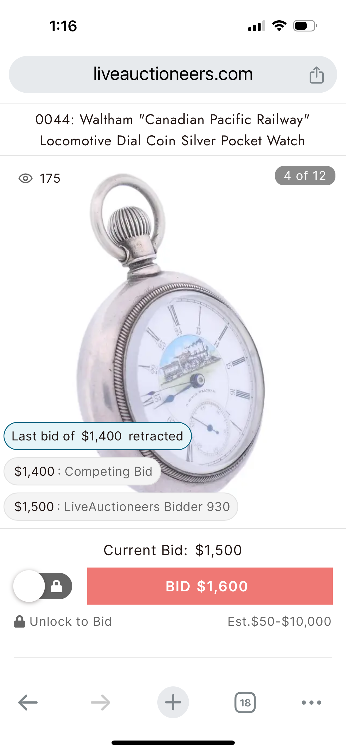

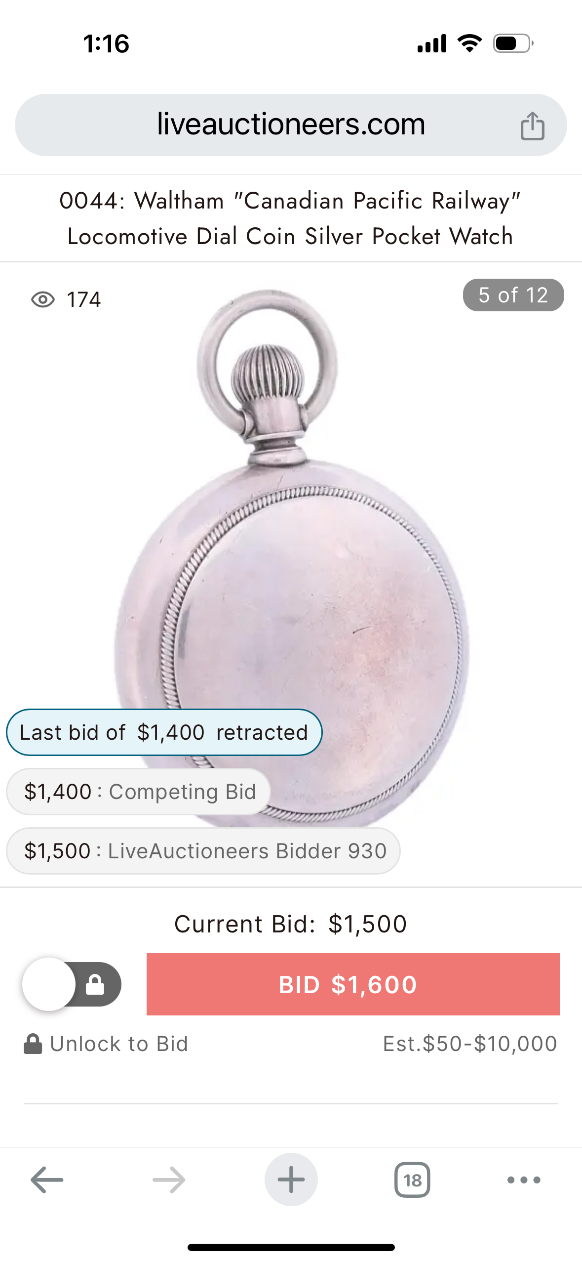

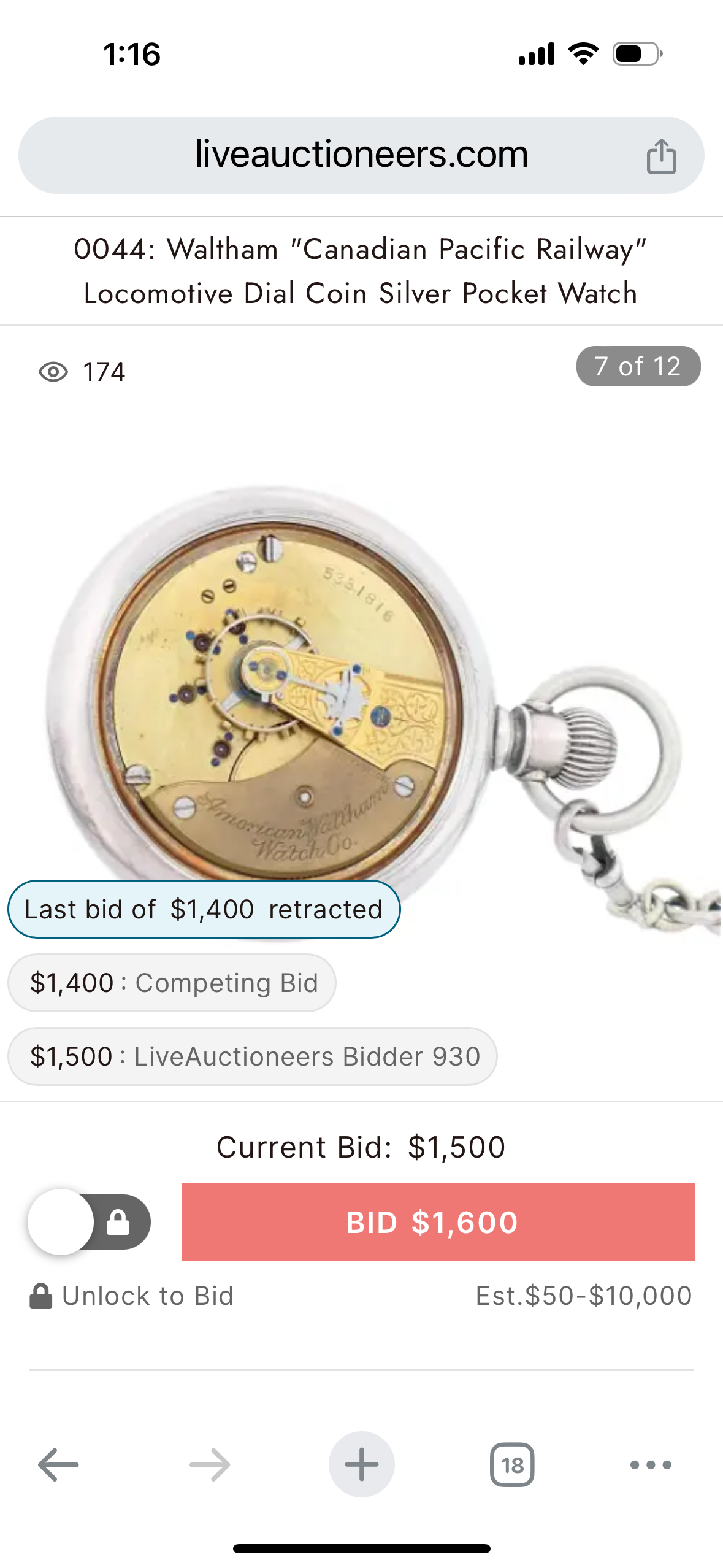

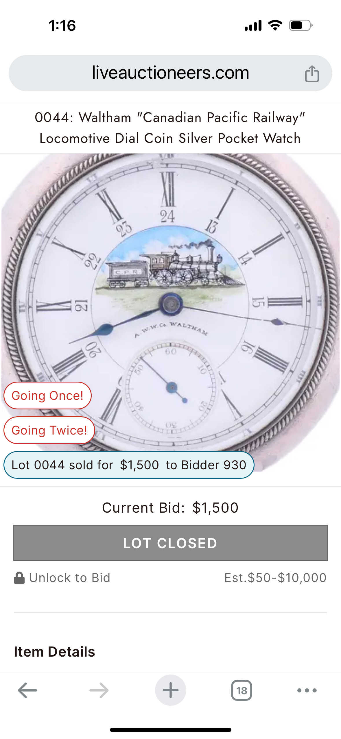

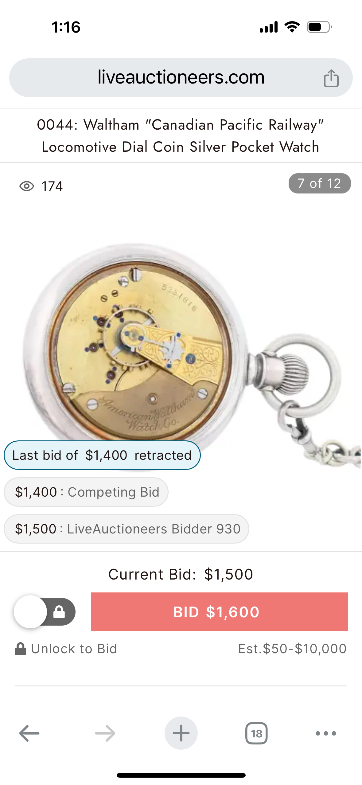

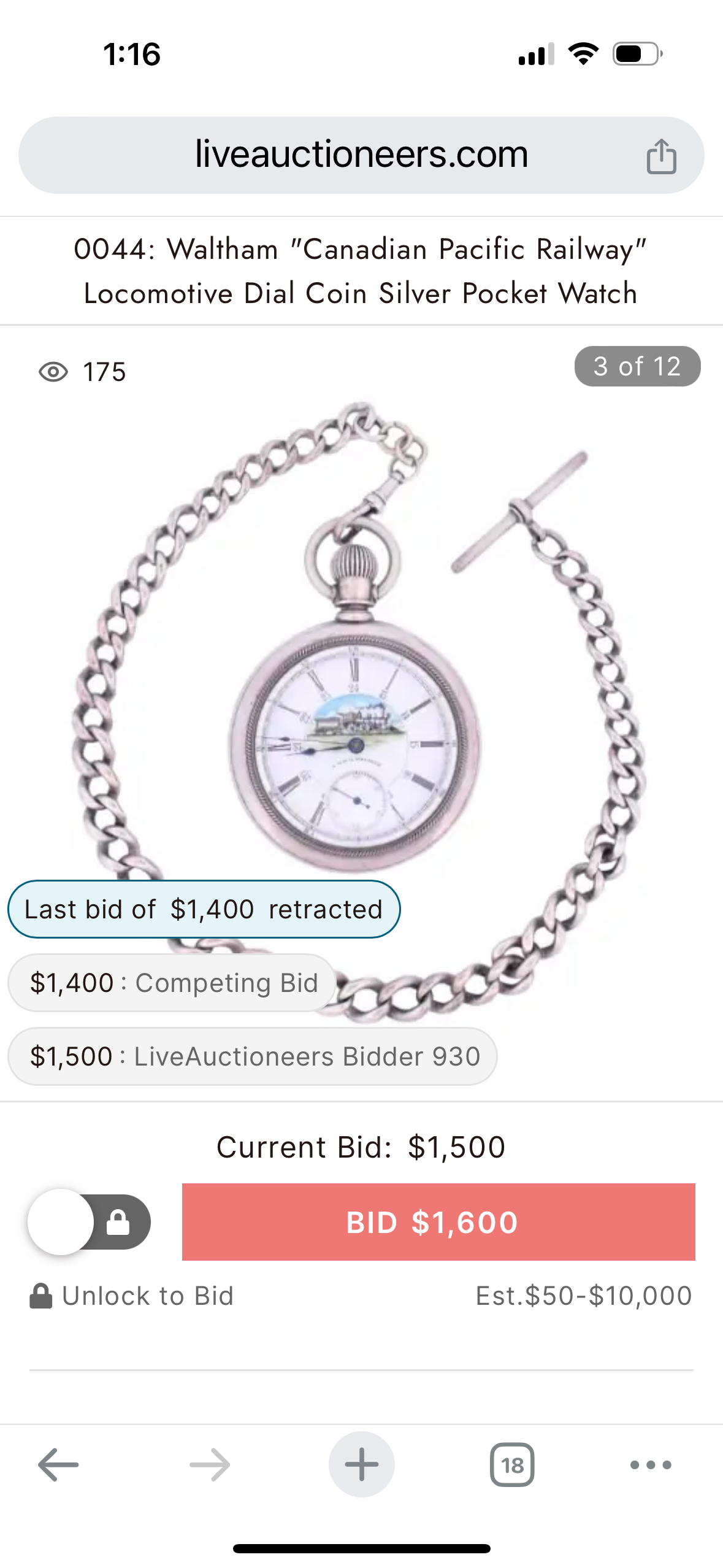

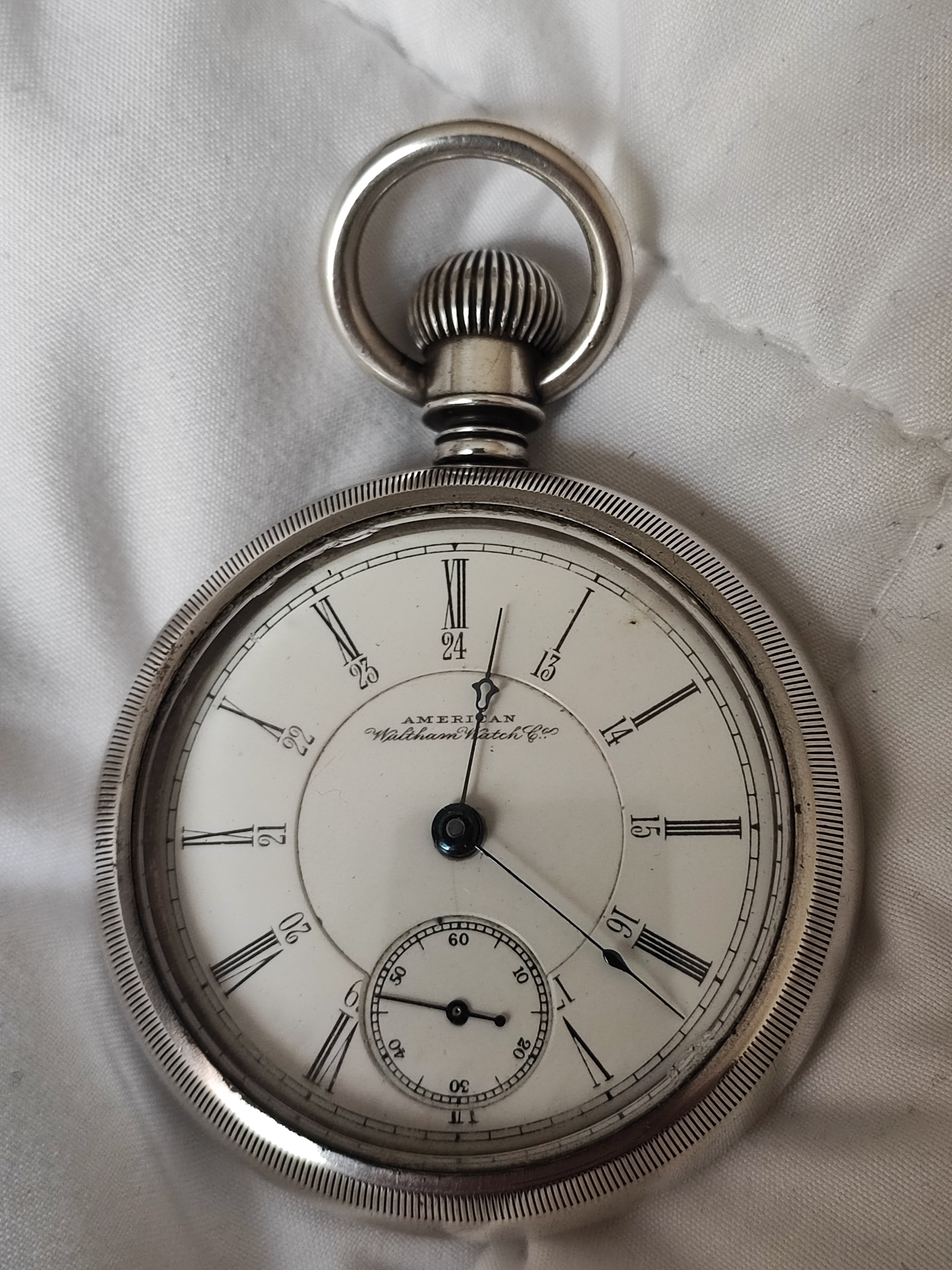

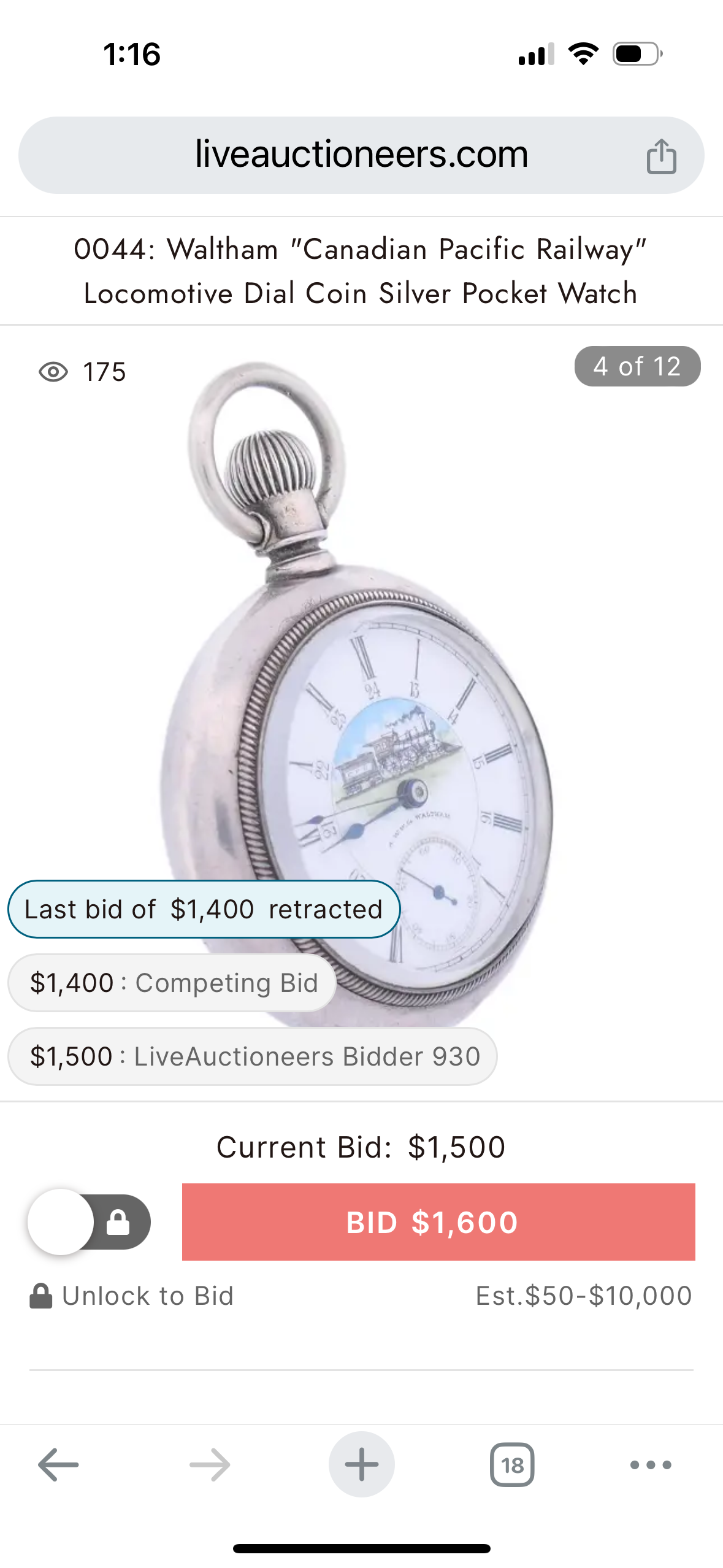

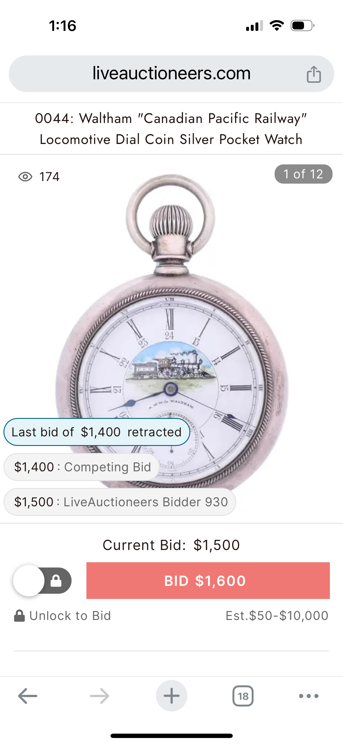

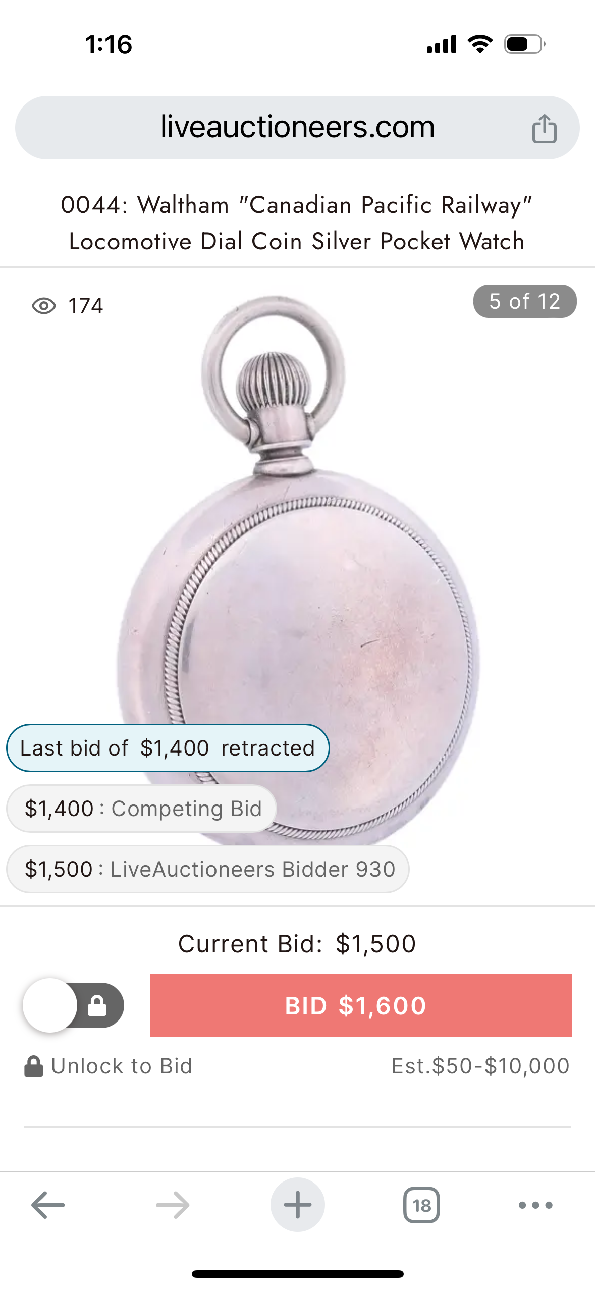

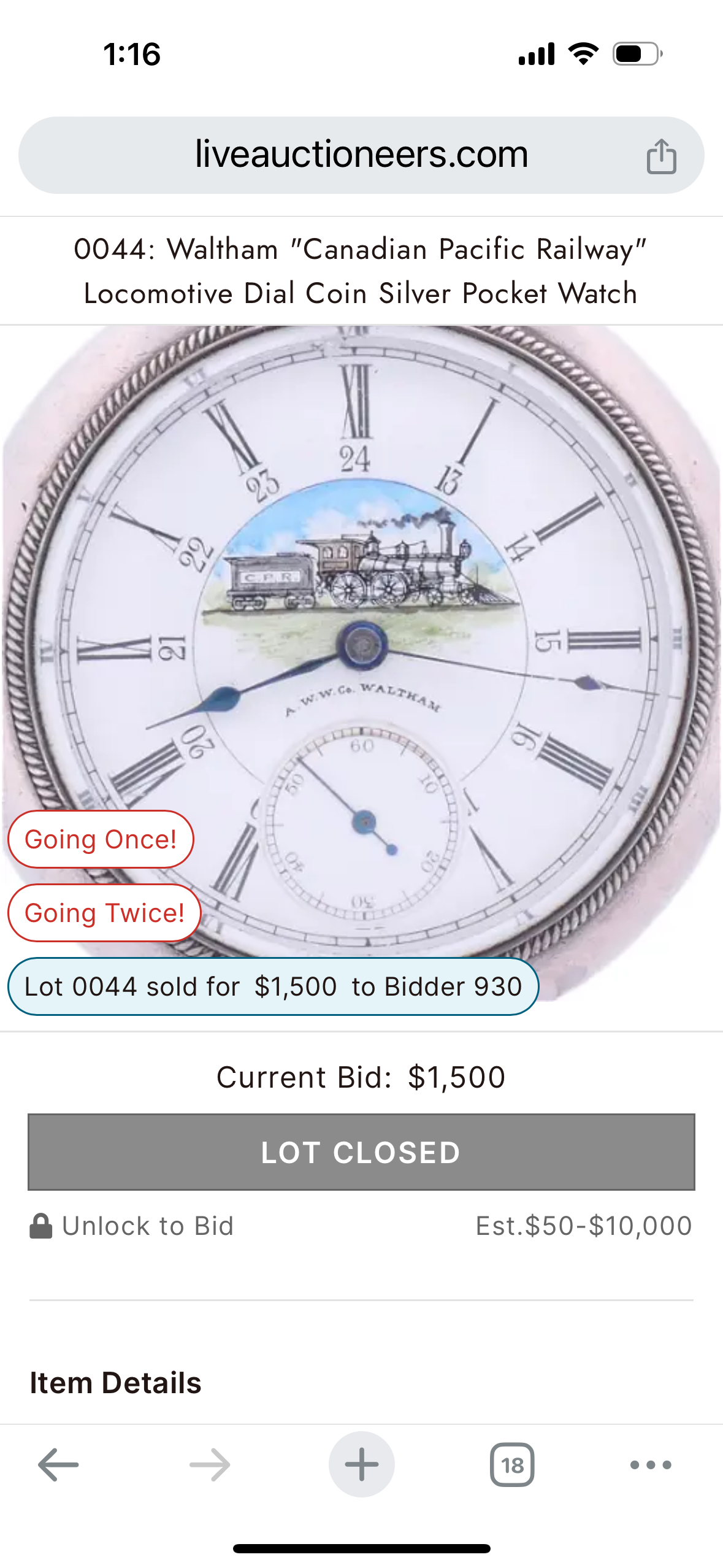

I watched an auction today and this old watch sold for a high price. Add state tax and 15% commission and it shows there is quite an interest in pocket watches with Canadian Pacific Railway (see dial for that). Hammered for US $1500. I did not buy anything.
1,077
4,455
Very nice watch, but I wouldn’t have pulled the trigger either.

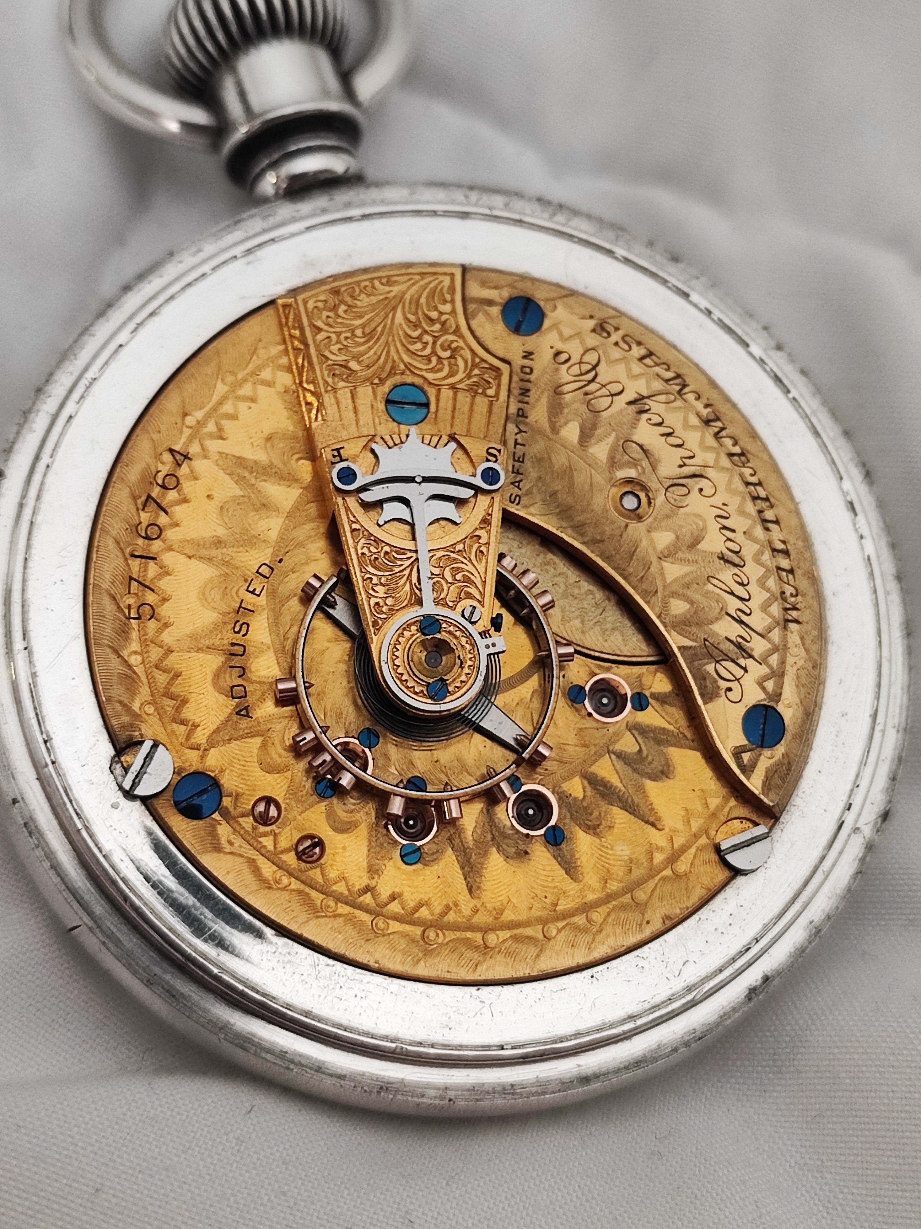

I could not live with that cheesy graphic!
But otherwise it's a nice watch.

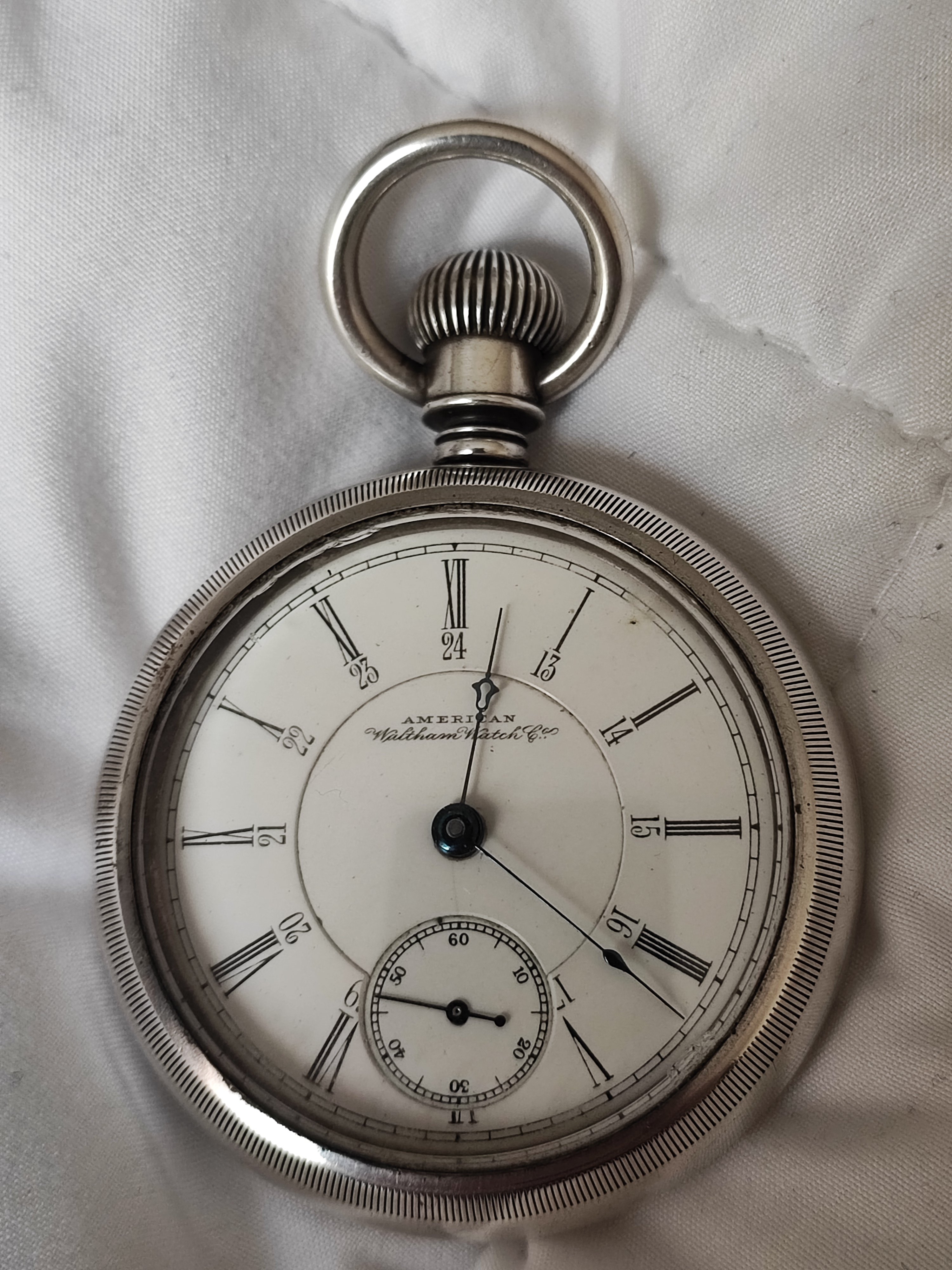

That price is way over the top given that I paid just NZ150.00 ( approx US90.00) for this example earlier last year.
PS This is my most favourite PW in my collection.

That “cheesy” graphic (@ghce ’s words) shows how much he knows about what is probably one of the most collectible 18 size Waltham railroad watches. That dial is decorated in what is known as Limoge enamel. A multi coloured vitreous enamel rendering of a wood burning locomotive circa 1885. That dial alone is the difference between your “cheesy” $90.00 “turnip”, and the $1,500.00 subject watch. That enamel was hand painted in likely four colours, fired in a kiln each time another colour was applied. The paintress used a paint brush that had a single strand of sable hair! That dial was also done in the Dominion Atlantic Railway rendering, and possibly many others. Satisfy yourself with garden variety clunkers, and leave the cognoscenti to collect the cream of the crop! I’m surprised it didn’t sell for more. So there!
Oh my. I did not have that kind of cash but good to know. The movement looks prettier on GHCE’s watch so the dial is the prize. Did the CPR add to the value or collectability?

Seriously?
Oh well I have a lot to learn about PW's.
Due to the premium put on Rail Road oriented watches by the general public and the cynical way some watch manufactures exploit that to get sales I always avoid these sort of dial decorations as being just sales gimmicks.
So engrained is that feeling in my mind knowing now what cannuck has informed me of I would still avoid that one.
Being as valuable as it is and with the likelihood of a very high price avoiding buying one of these would be easy, cheapskate that I am 😀

It is important that anybody in future who happens to stumble on the CPR Waltham, not be misled by somebody using the term “cheesy graphic” to describe a work of art! This is a significant watch as might be construed by the fact that somebody shelled out $1,500.00 for the pleasure of owning it! Cudos to them!
