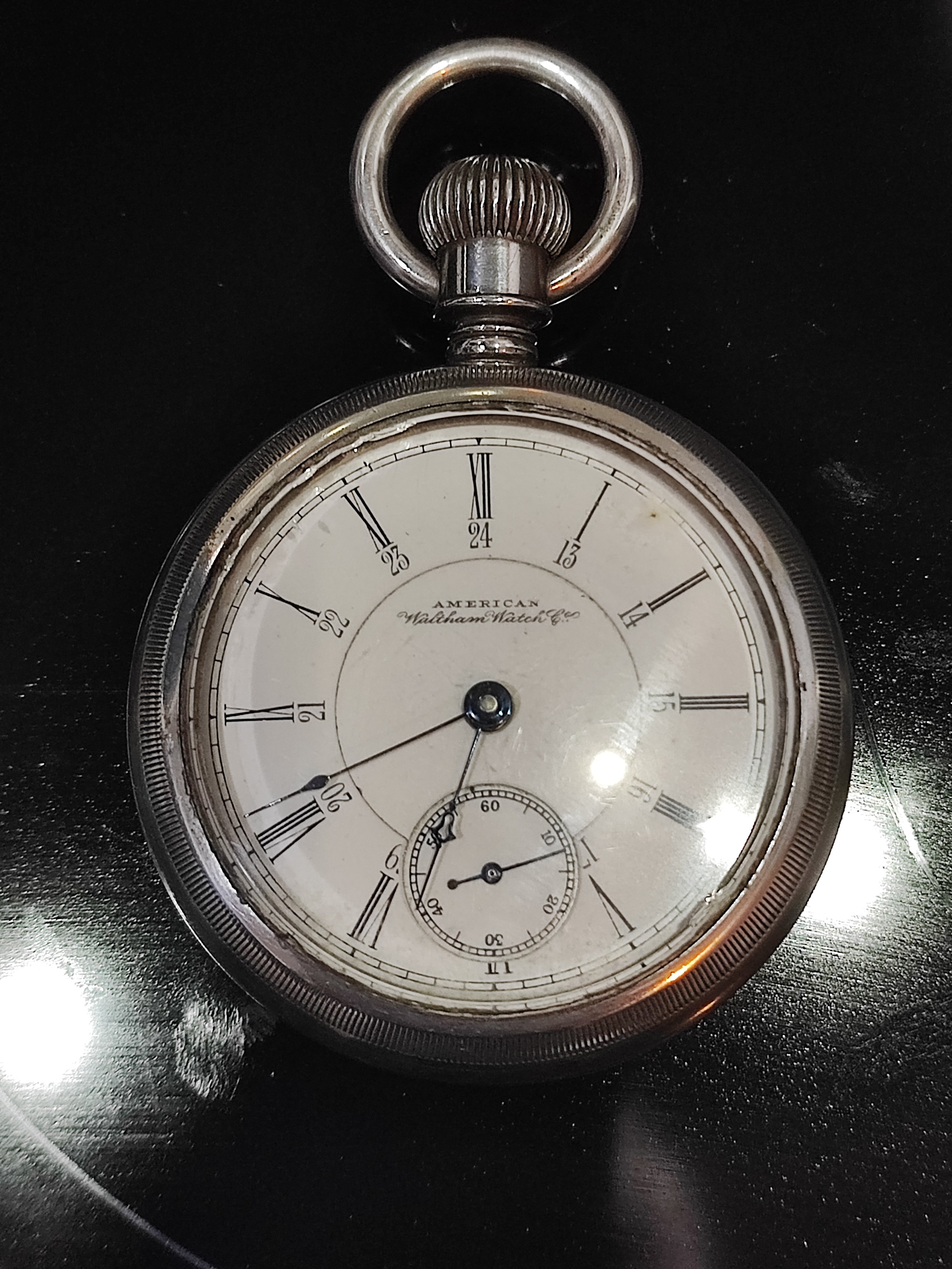

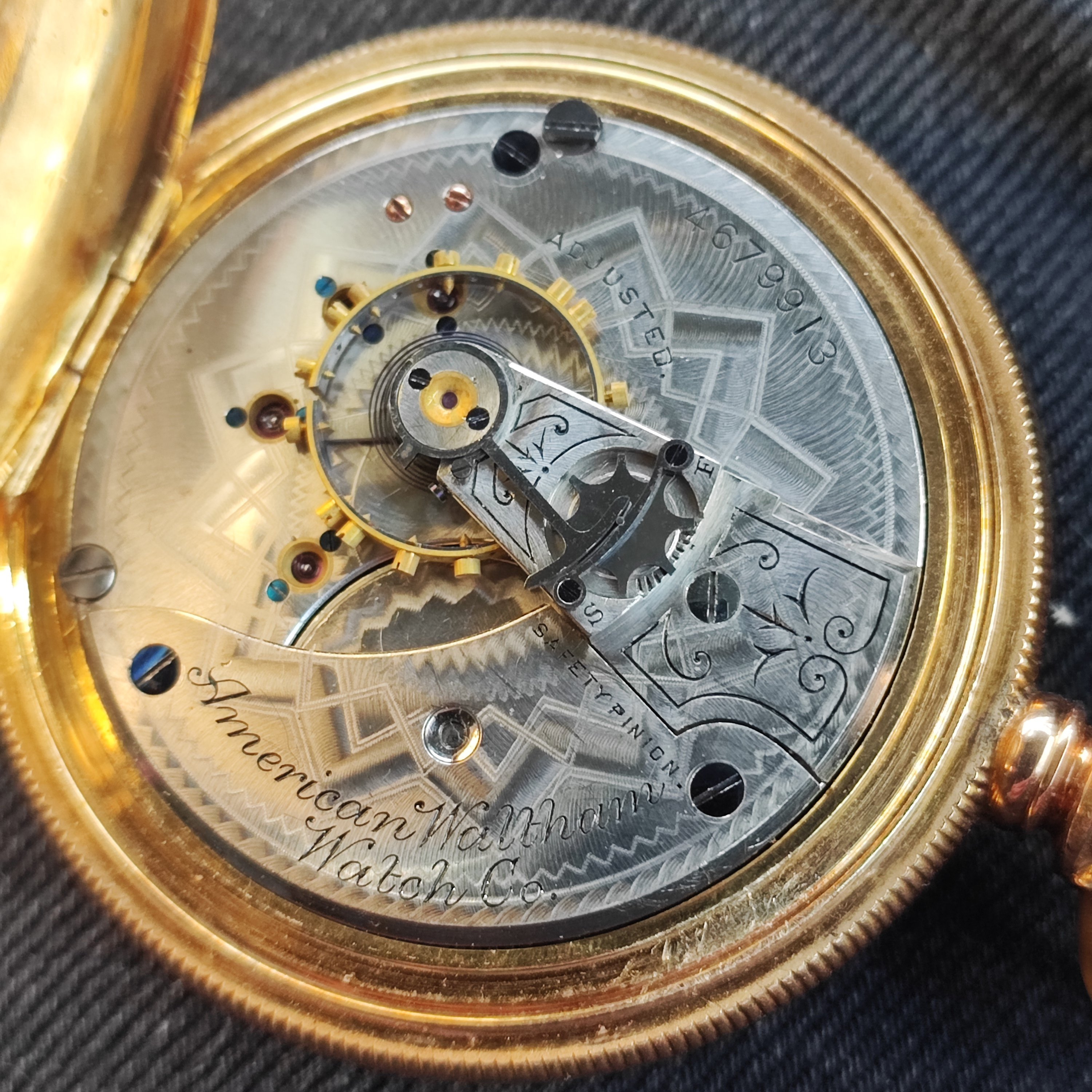

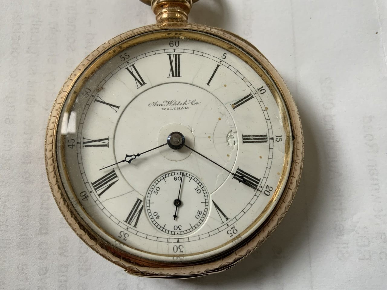

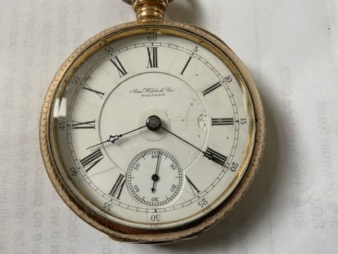

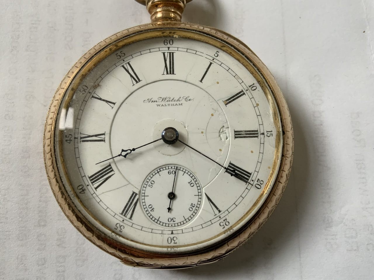

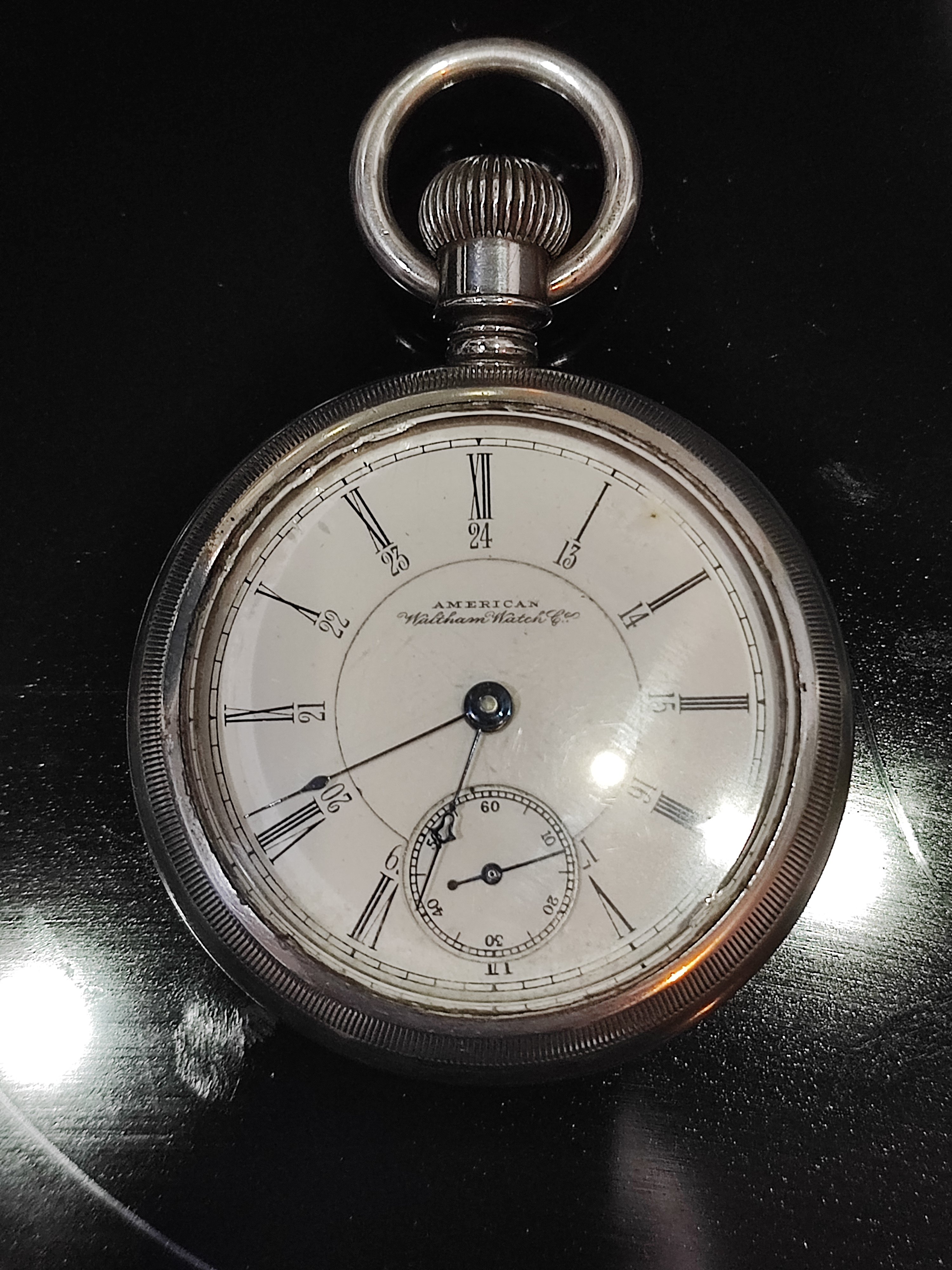

Back to the dial. The movement could be an 1877 model if that dial is original to the movement. At one time, Waltham was known as the American Watch Company. A dial from that era would have the location name Waltham beneath the A W Co., or as in the case of the subject watch, Am. Watch Co. Having thought about it, if the dial, marked the way it is, is original to the movement, the movement would not be an 1892 model. By then, the company was known as Waltham. I have two 1877 model Walthams in original cases. Both have dials marked for the American Watch Co., Waltham. Both of these have a stem retaining screw on the BACK side of the pendant, and both are lever set. The subject watch doesn’t have the stem retaining screw I would expect to find on an 1877 model. So this one could indeed have an 1883 movement in it. Interesting to speculate,
5,413
55,545
That was my thought too, that it is likely an 1883 movement simply as it has a similar dial and hand set up to my 1883 watch bought last month, though as you say the dial naming script is a little different.

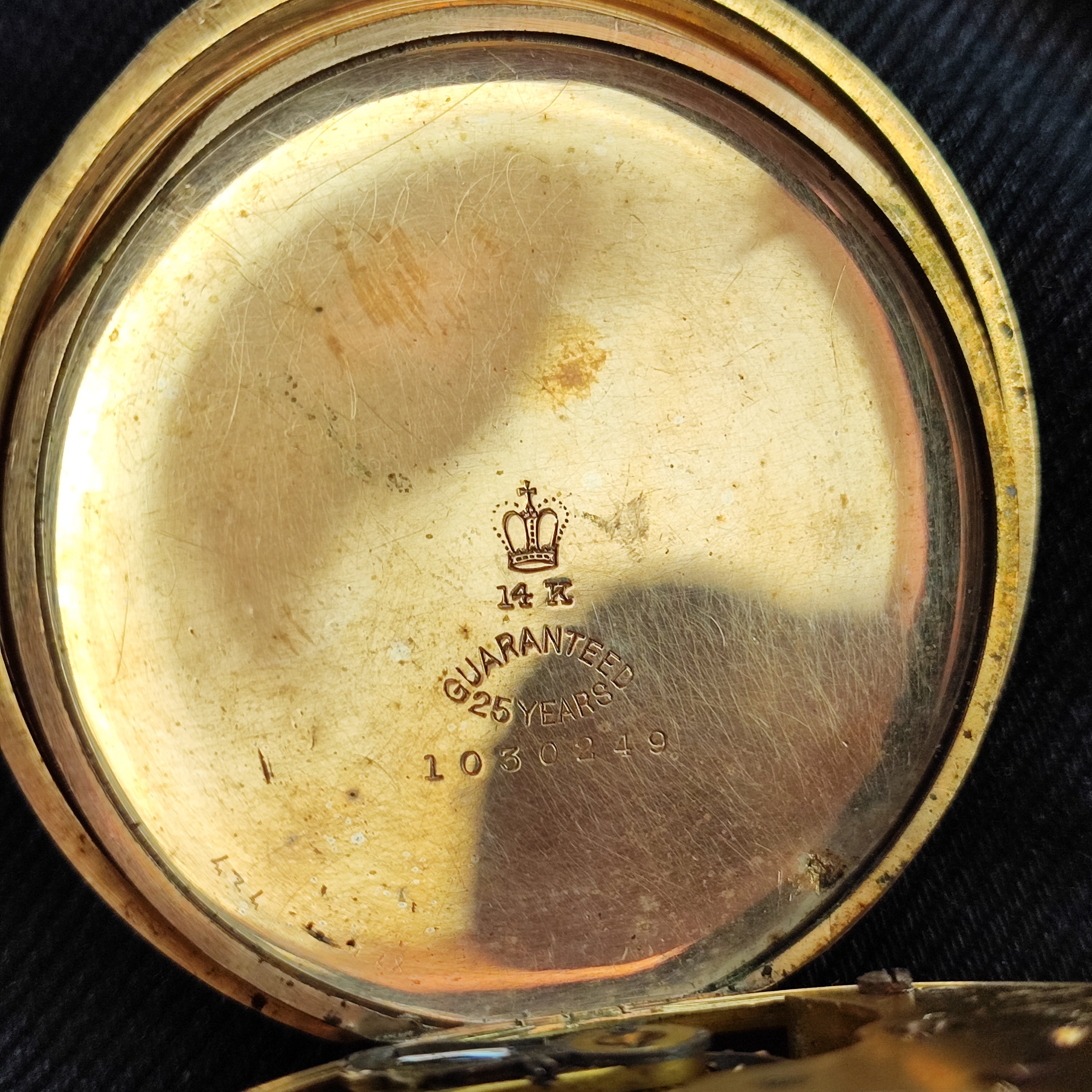

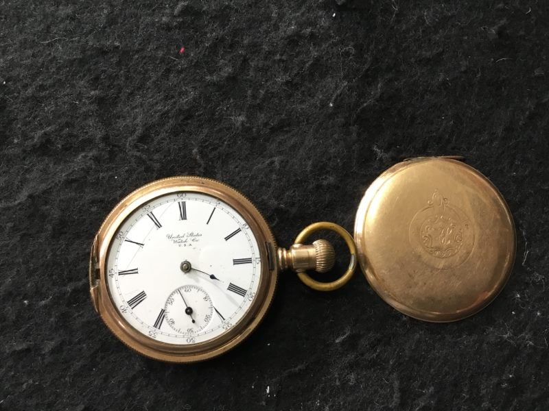

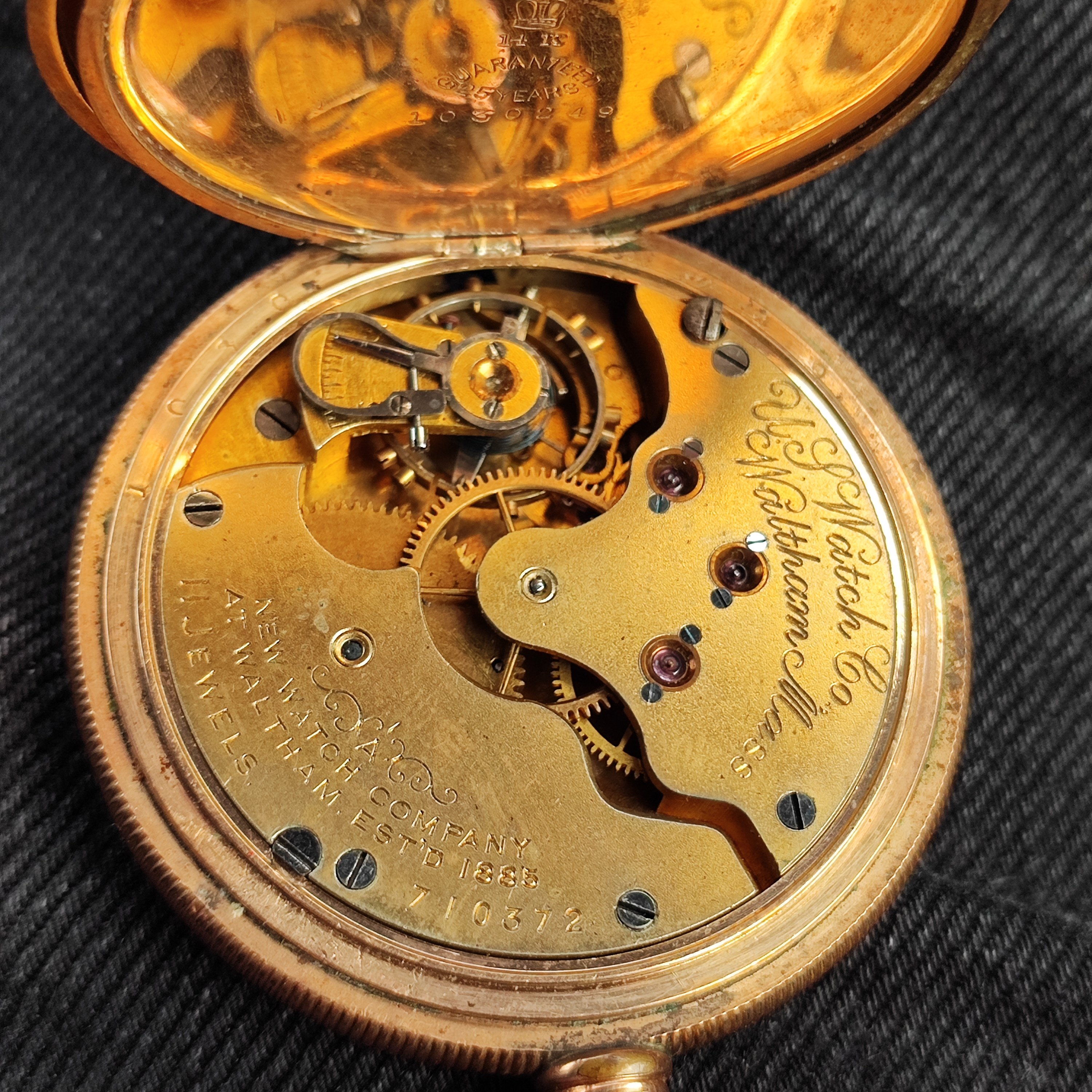

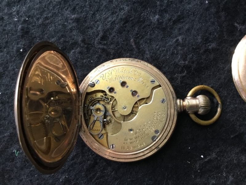

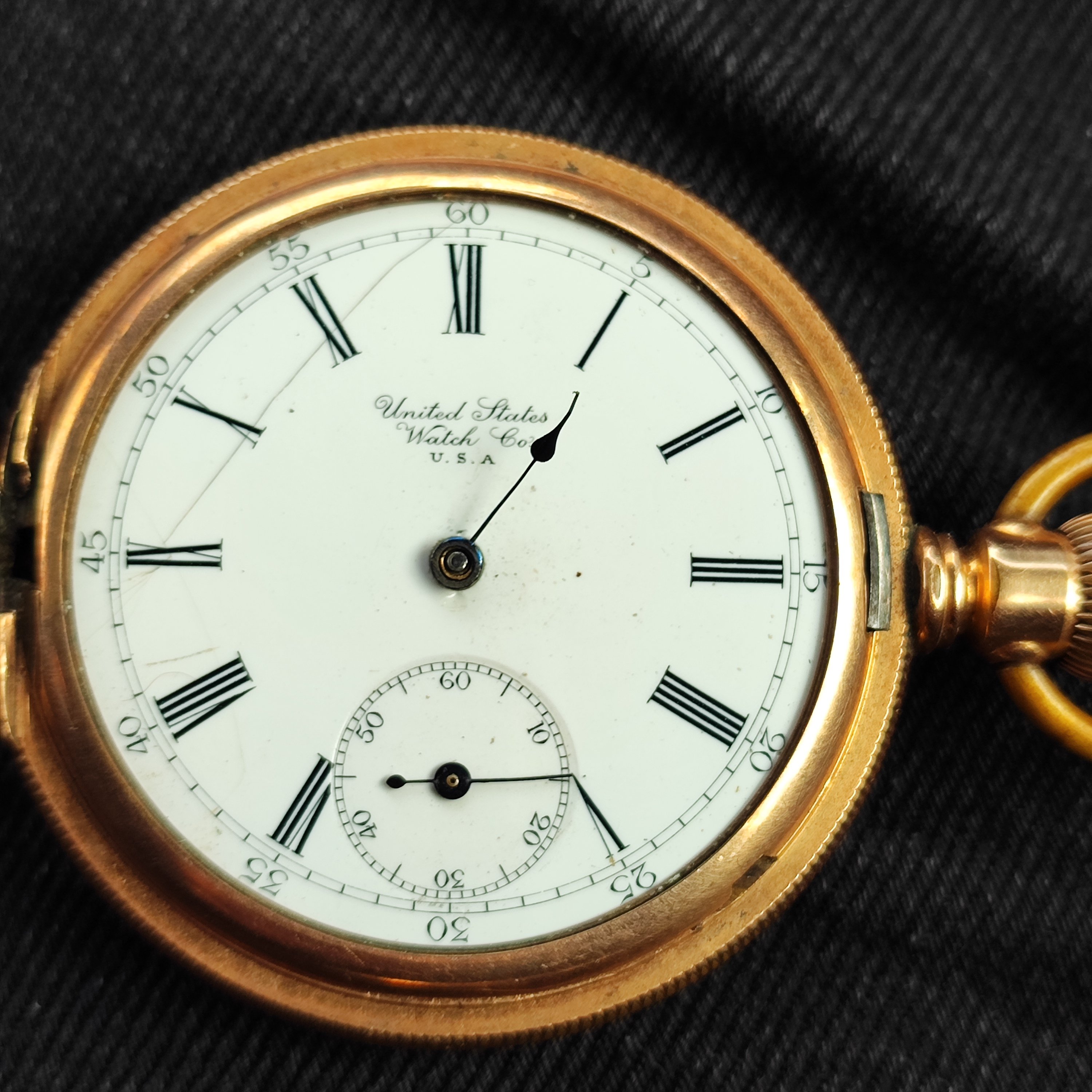

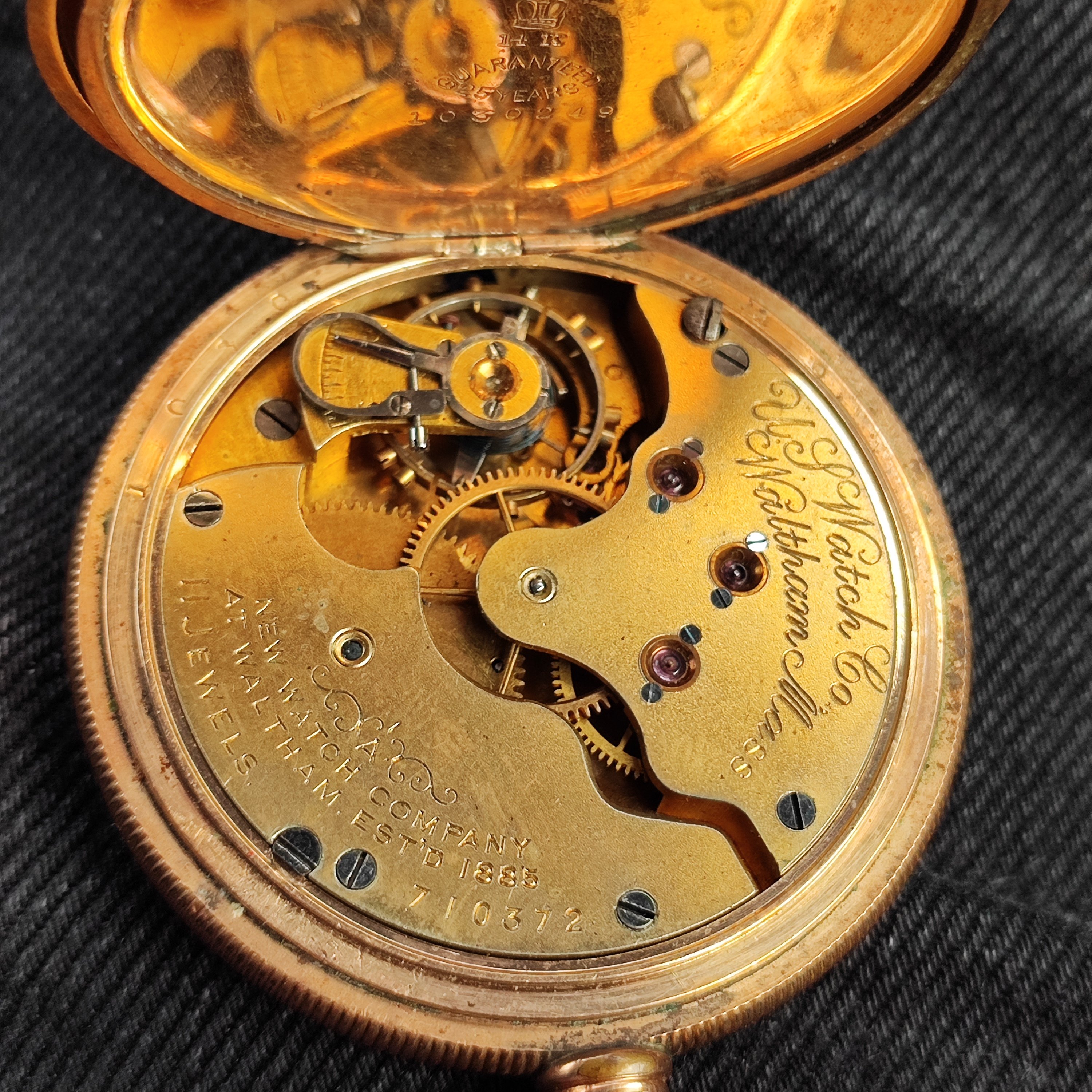

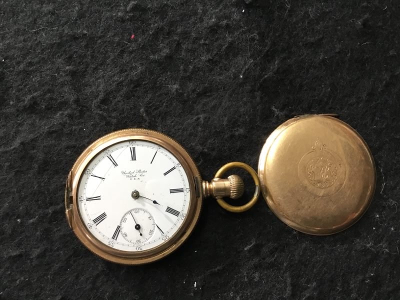

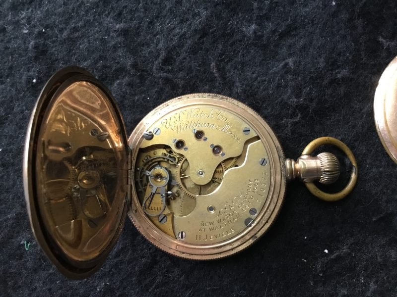

Just bought another unusual one 20 minutes ago, initially I was going to buy it for its case, mistakenly thinking it was a Waltham ( sellers Description) until I realised it was no such thing but a US Watch Co watch and perhaps somewhat rarer.
I am sure it will come back to bite me with a broken balance or an odd gear train wheel as these parts are probably a lot rarer than a Waltham.
One of the other reasons for buying was the inscription, sometimes they devalue the watch but in this case I think it does the opposite, the mentioned company is still operating today in Australia and whats more a well known one with a long history dating back to Colonial times.
https://pocketwatchdatabase.com/search/result/u.s.-watch-co.-waltham-mass/710372
Sorry for the slightly blurry seller pics.

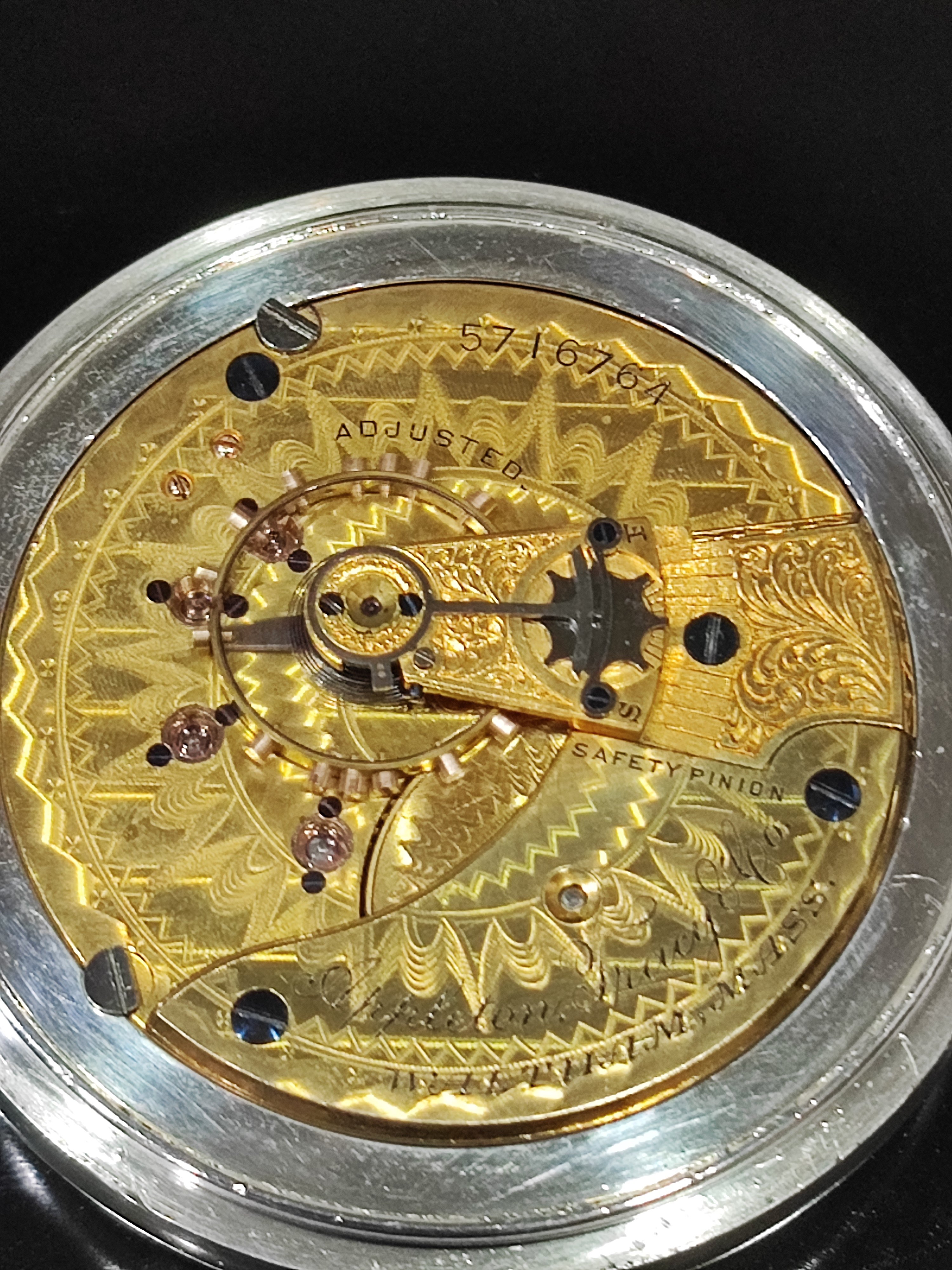

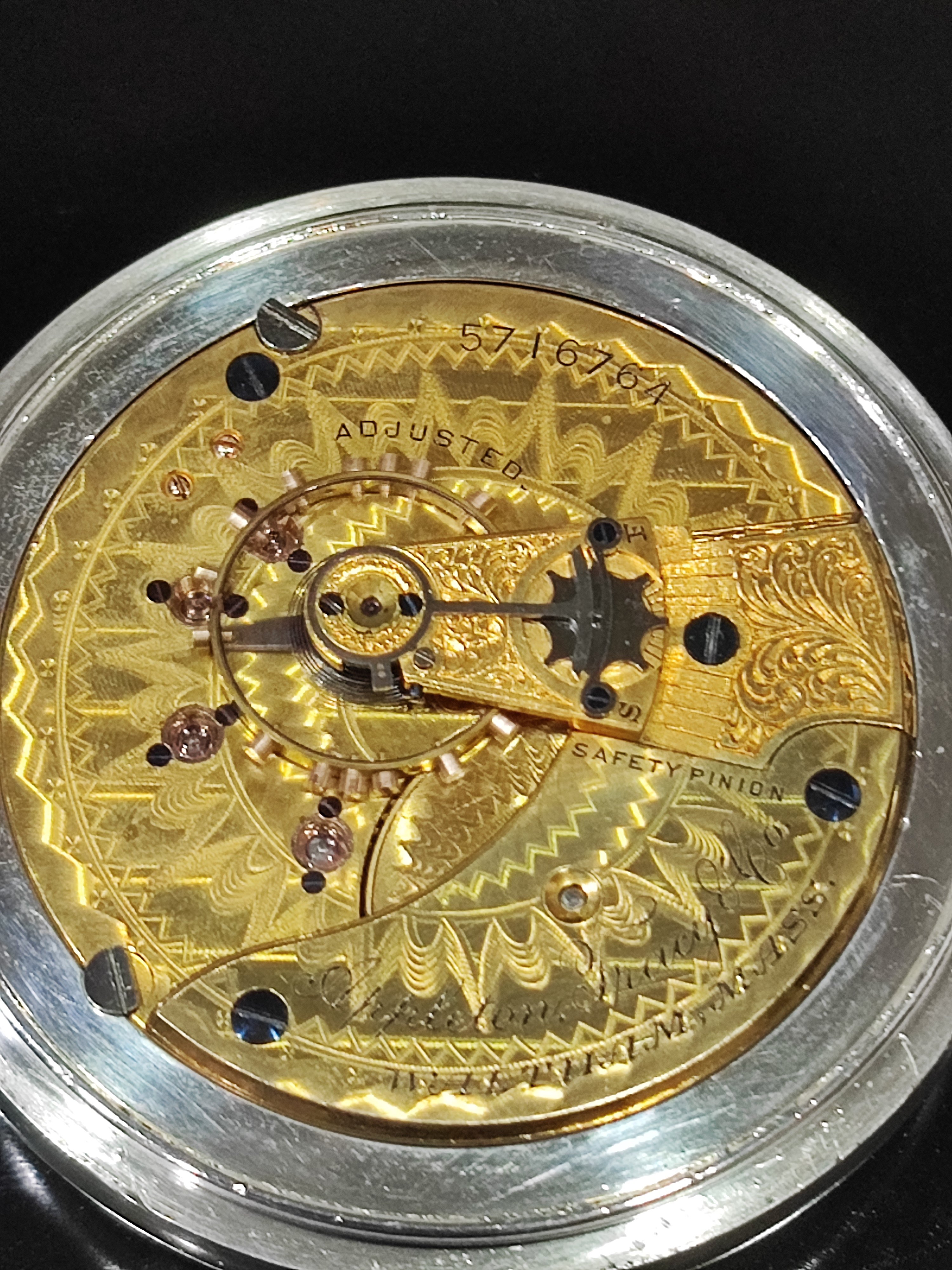

And for the money shot, just arrived in and haven't had a chance to look it up yet.
15,997
48,116
https://pocketwatchdatabase.com/search/result/waltham/4679913
The scoop on @ghce ’s handsome frostie 1883 Waltham. The pocketwatchdatabase site states that there was a private label run included in this series called “Special Railroad King “ (grade?). Looks like it could be. Adjusted to 3 positions, temperature, and isochronism. The 1883 model Waltham in all grades was produced in the millions. But this grade has a fairly low production. The double sunk dial seems right for it. Good looking watch.
5,413
55,545
Looks even better in the flesh, my wife took one look and said "Wow, that looks much better than the photos!" And I have to say I agree, it has real presence just a shame for the wear thru of the gold plating on the back of the case.
Hopefully my Watchmaker will have a mainspring to hand.

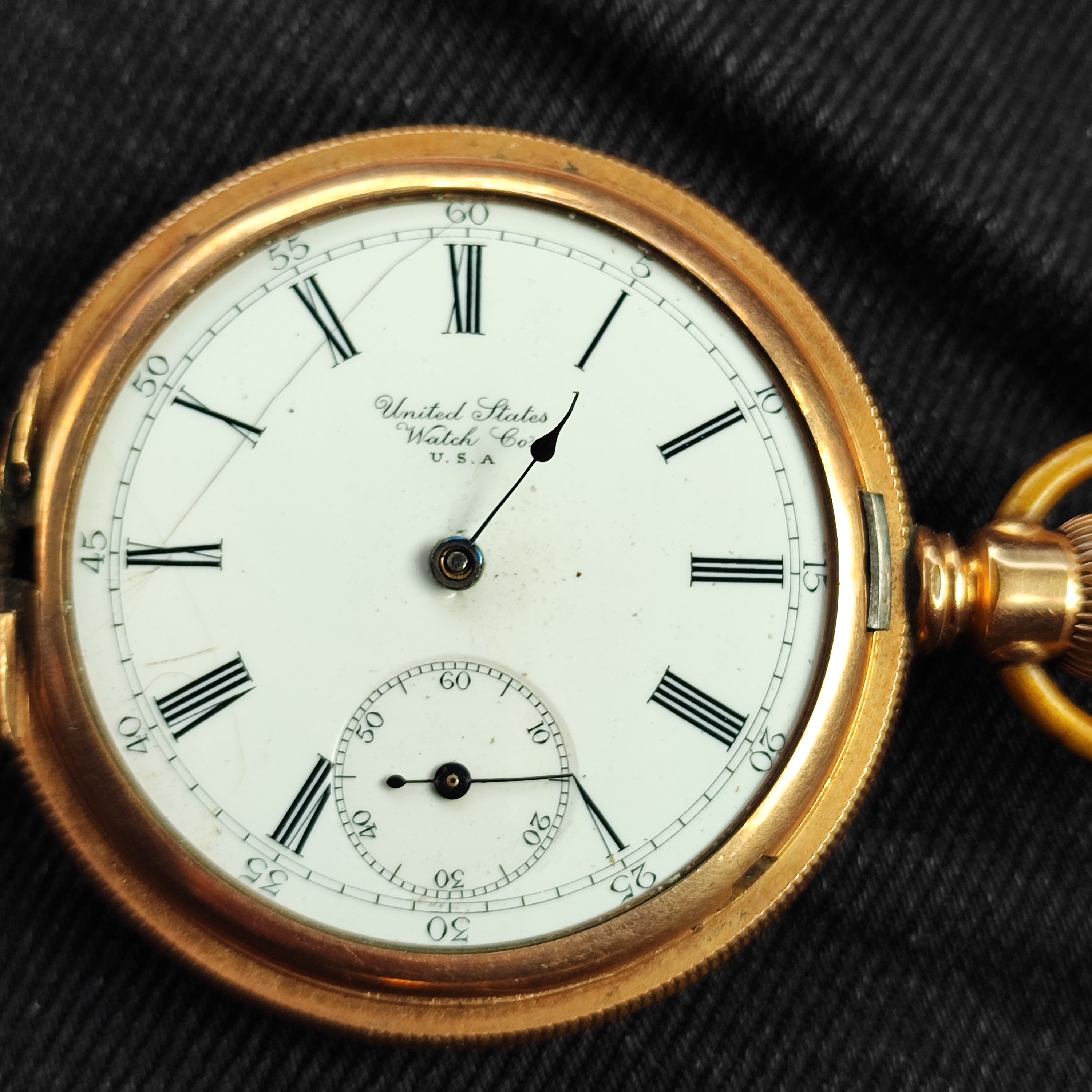

Also picked up the US Watch Co PW as well this morning, the balance wheel looks in great order and the movement looks pretty clean so I am hoping for a successful resuscitation.
New hands, glass and a service and this rare bird might yet fly.

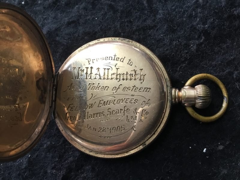

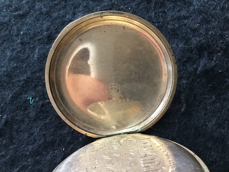

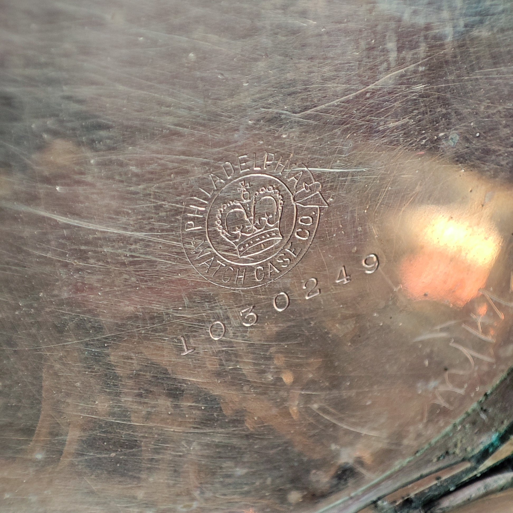

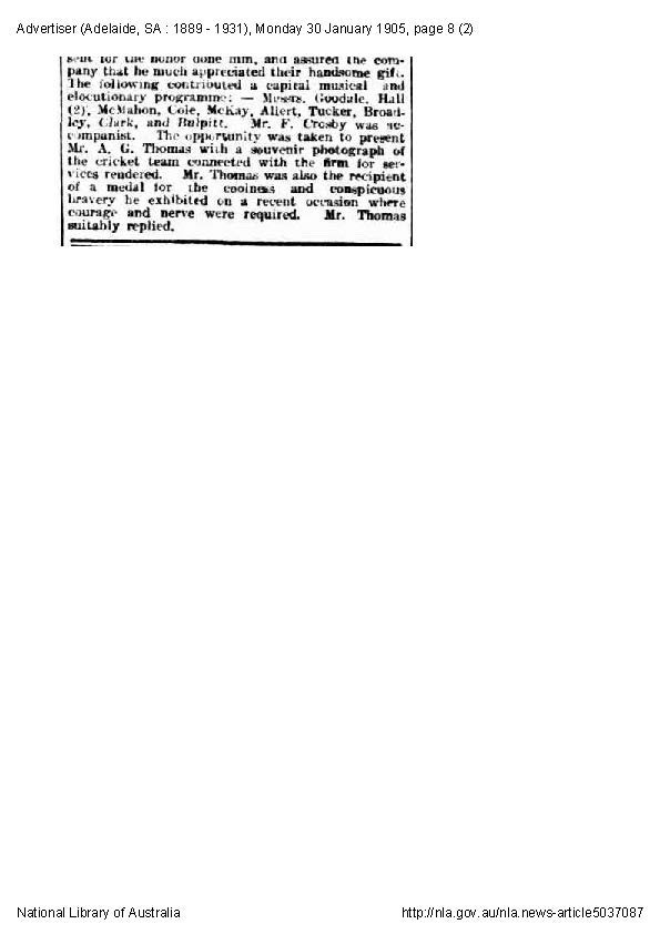

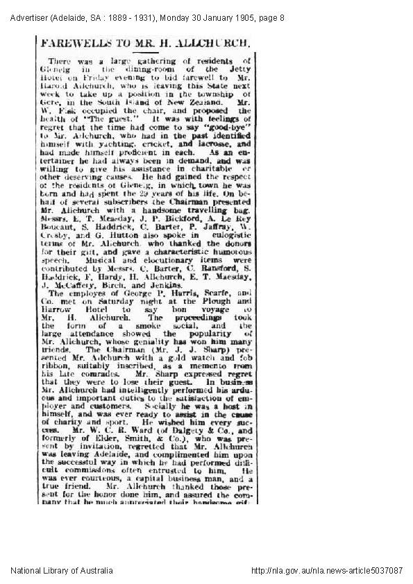

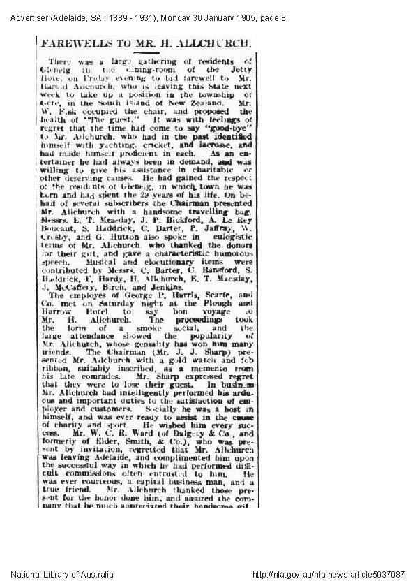

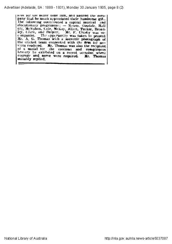

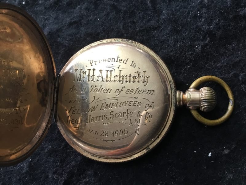

Well look and Ye' shall find. Talk about hitting the jackpot with this watch!
All the details of this newspaper article dated 30 January 1905 2 days after the presentation of this watch detailing both the owners name and the presentation of the watch are included along with his history and imminent departure from Adelaide Australia to the South Island of New Zealand where I purchased this watch yesterday.
Can you get better than that?
18,840
39,184

Its all a bit of a small world isnt it, always shopping here in NZ at Bunnings lol.
I've done a bit more research on the owner of the watch Harold Allchurch and it appears I am related to his family by marriage, hmmm small old world!

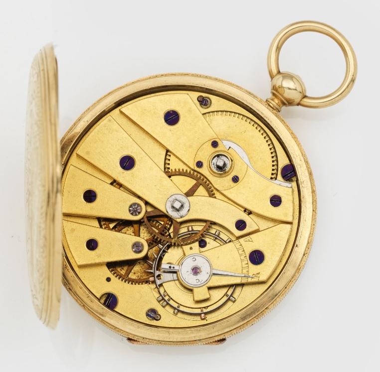

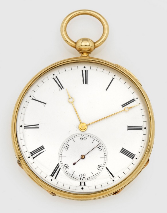

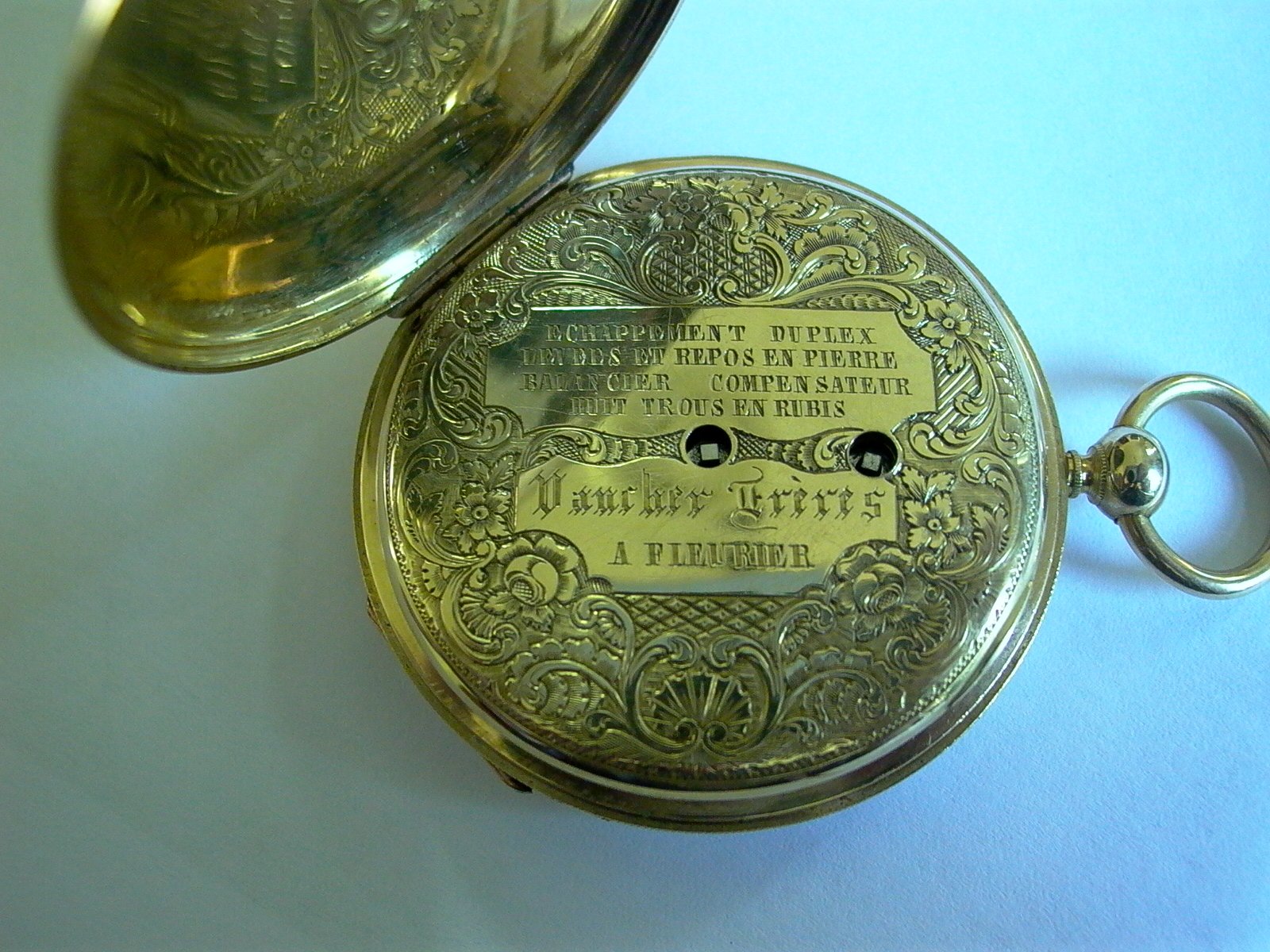

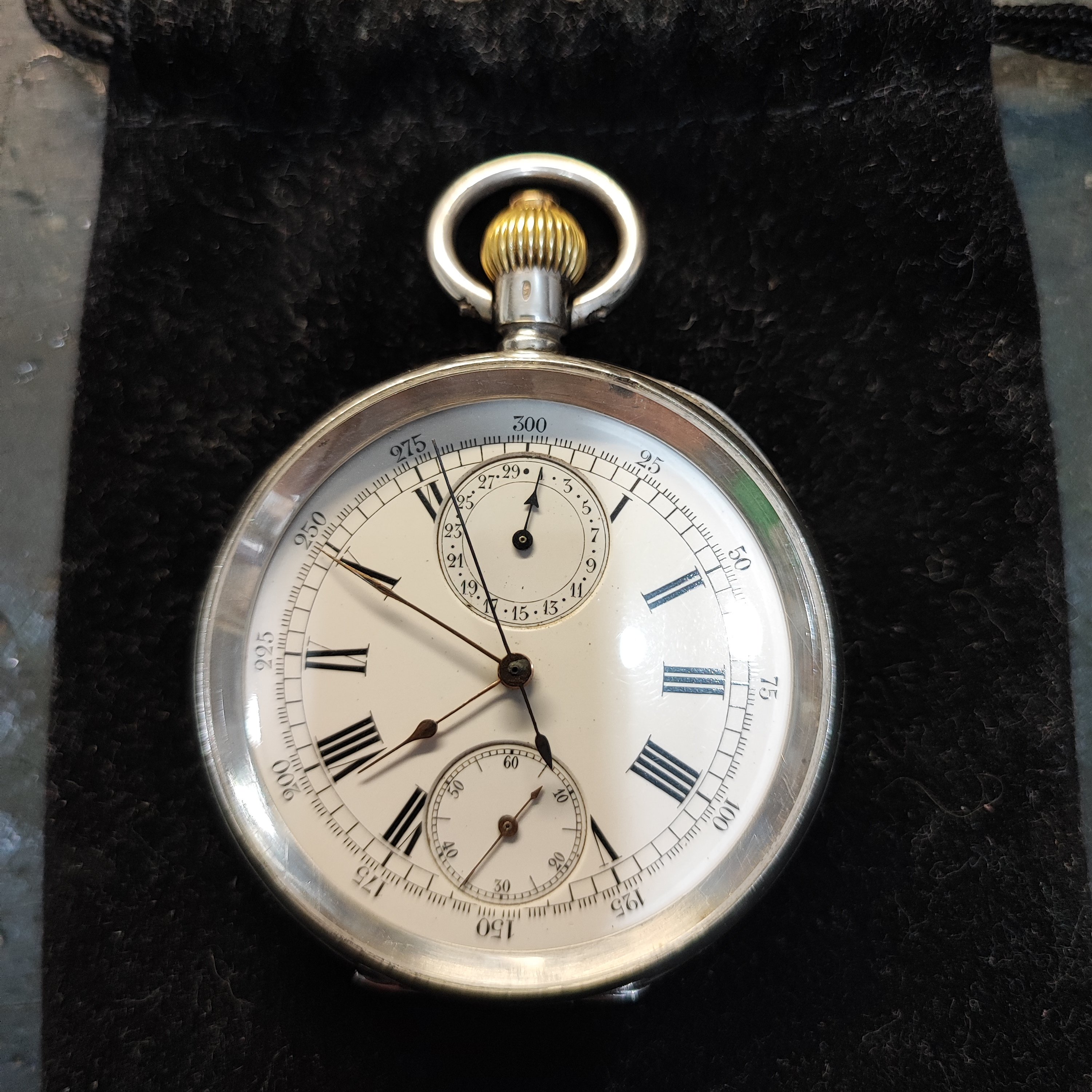

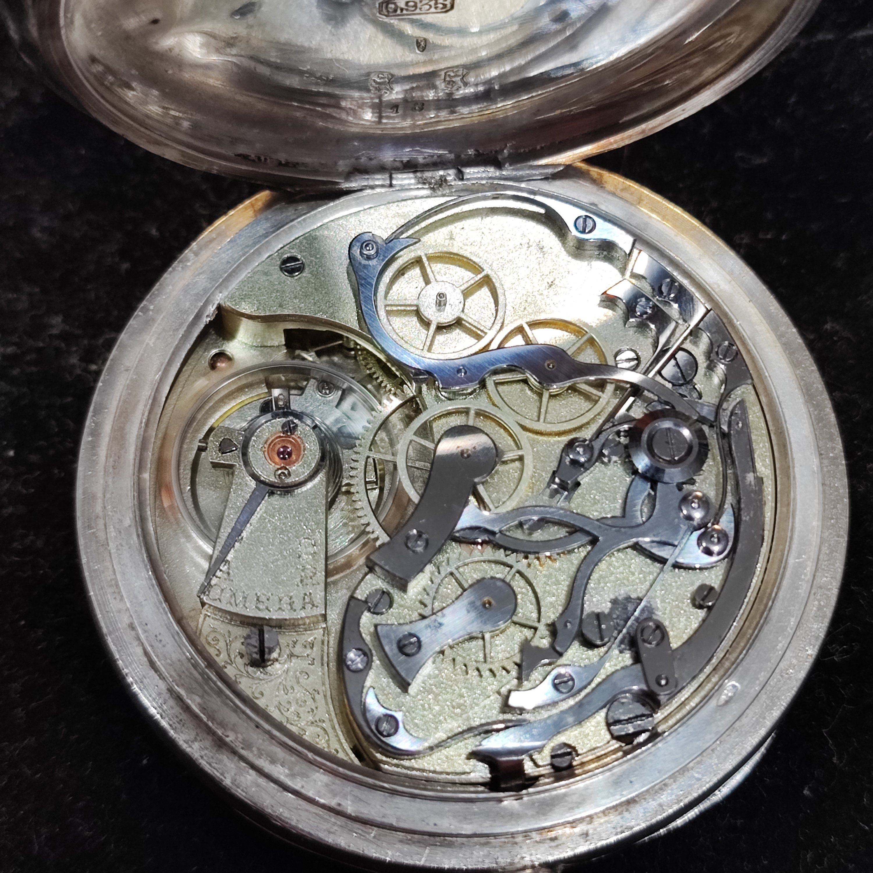

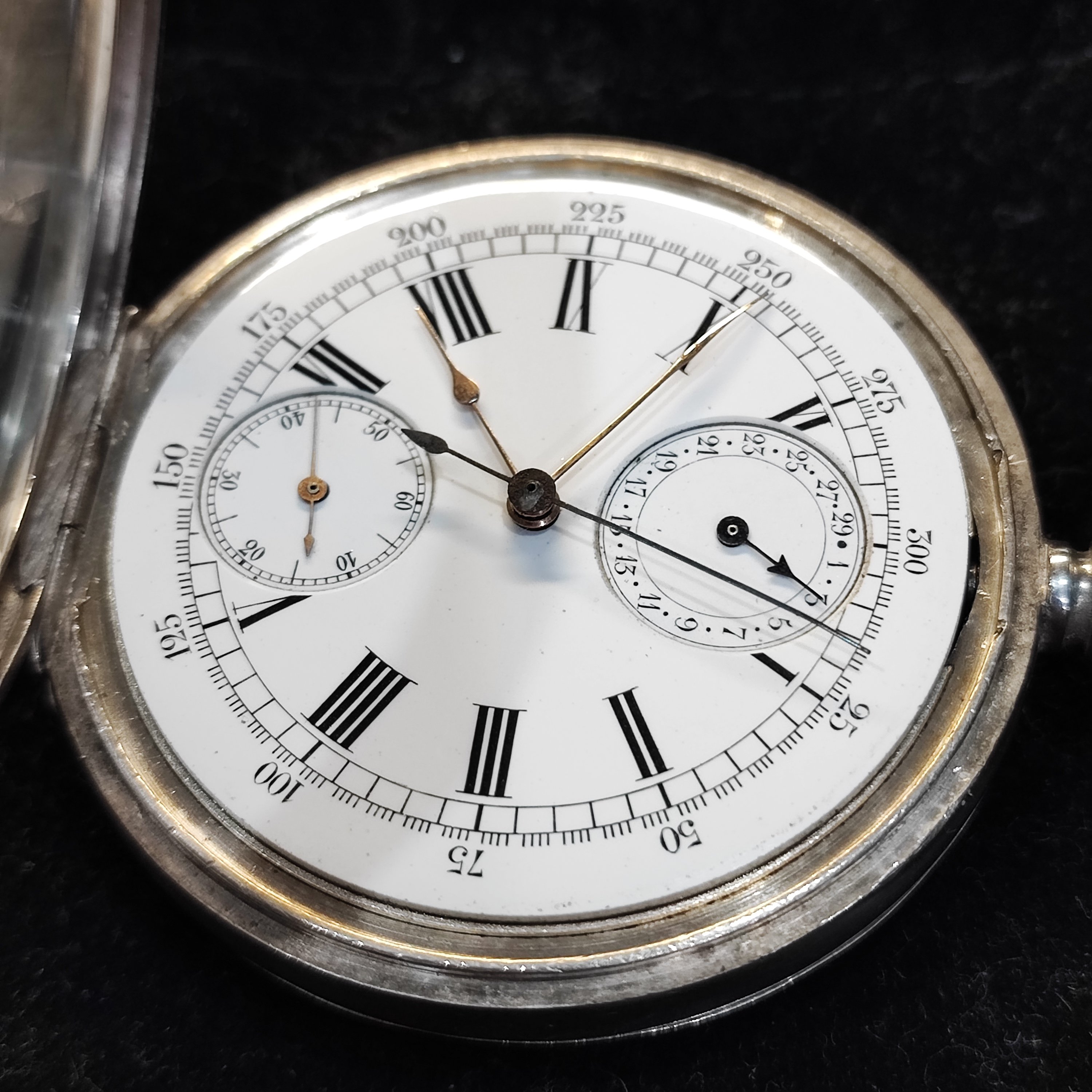

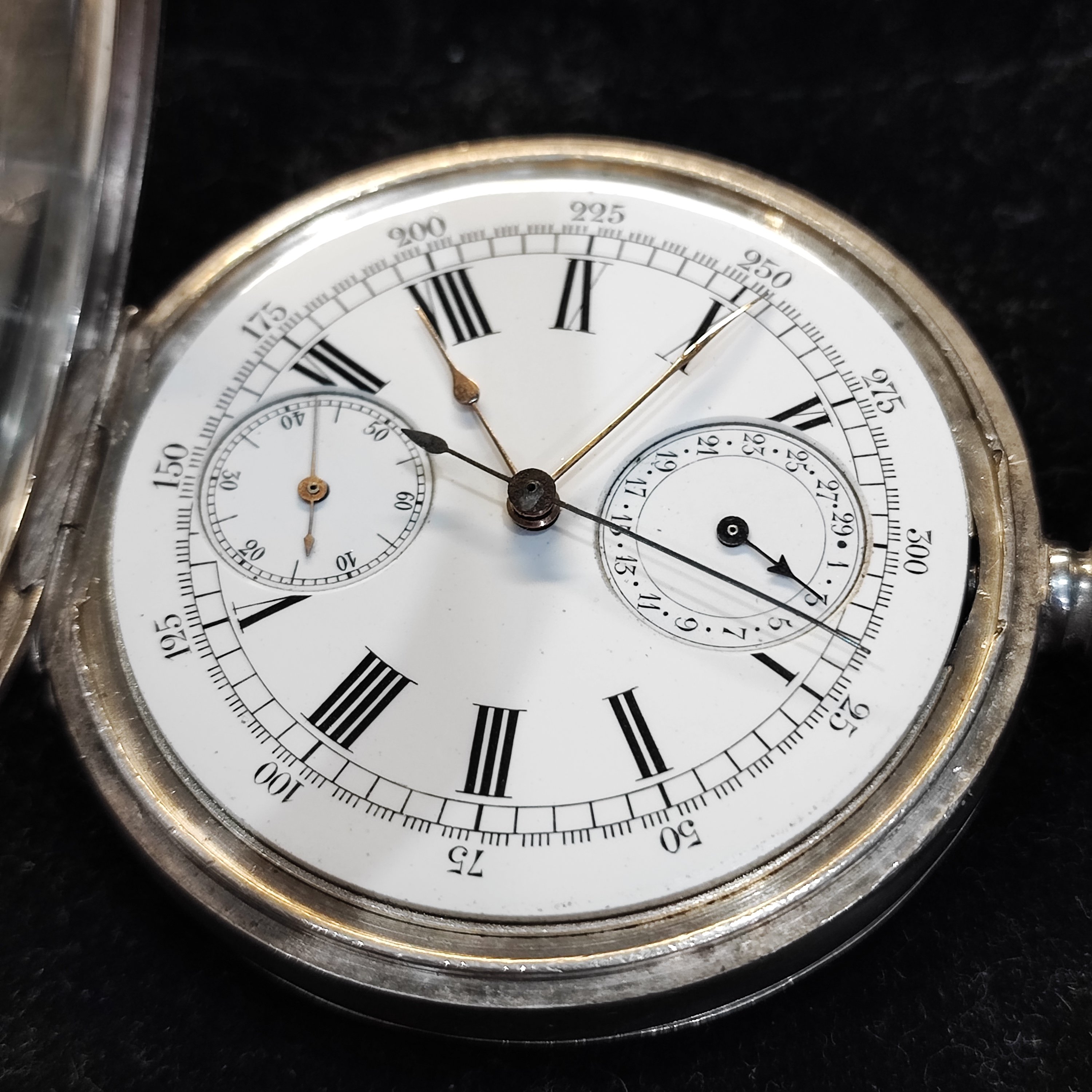

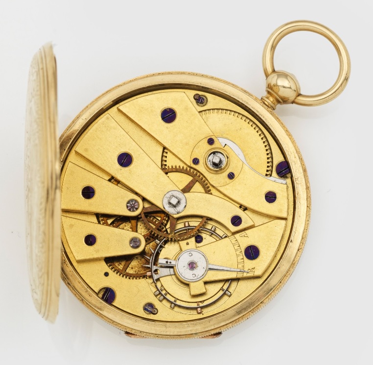

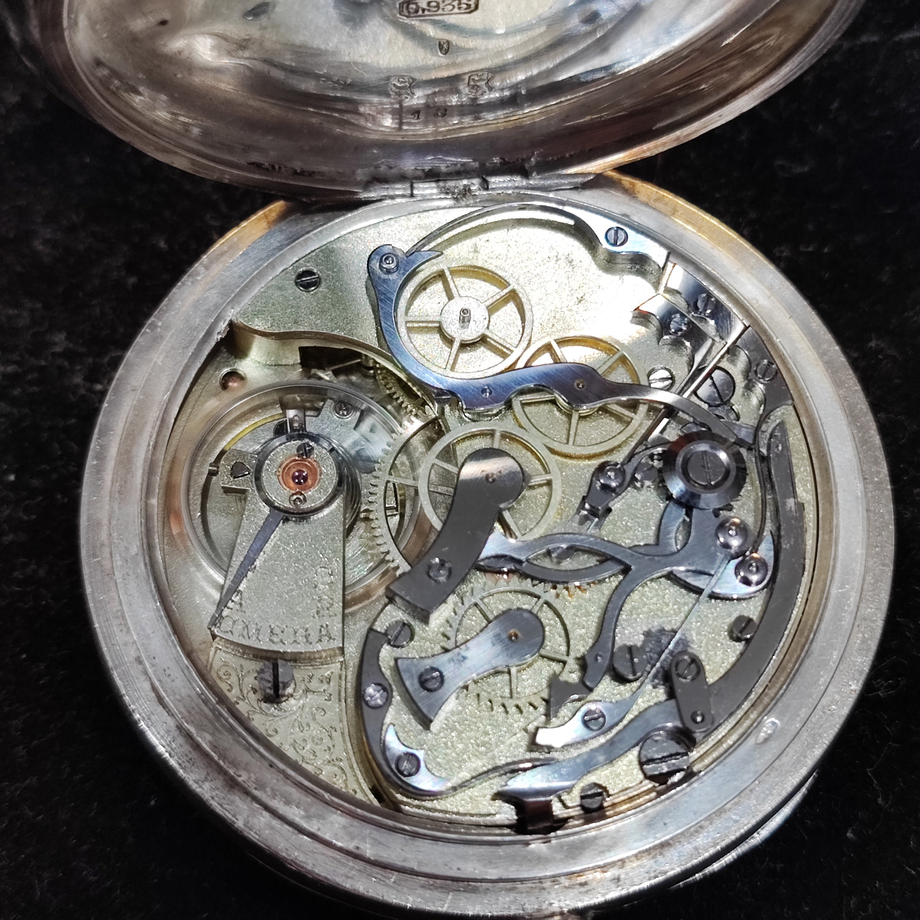

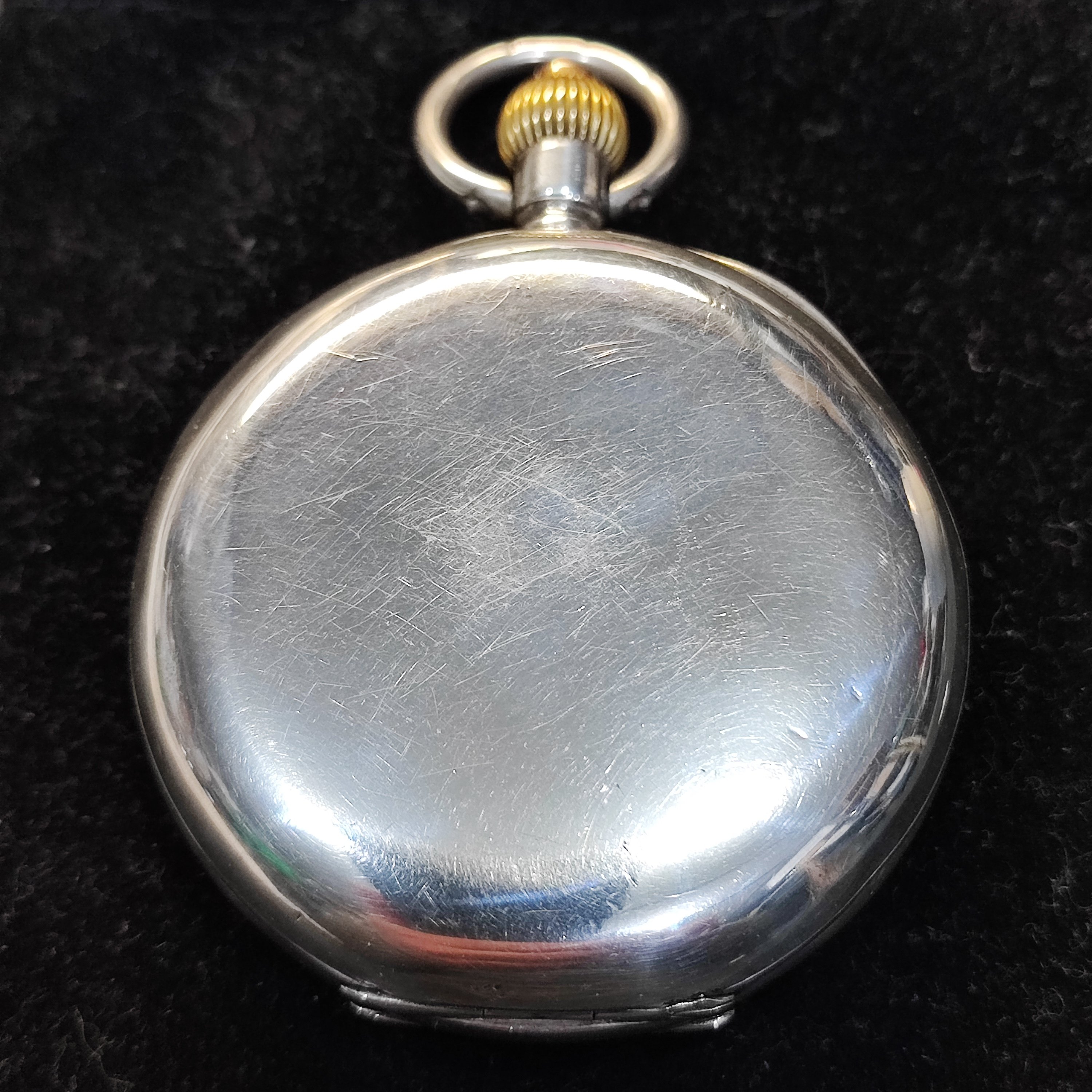

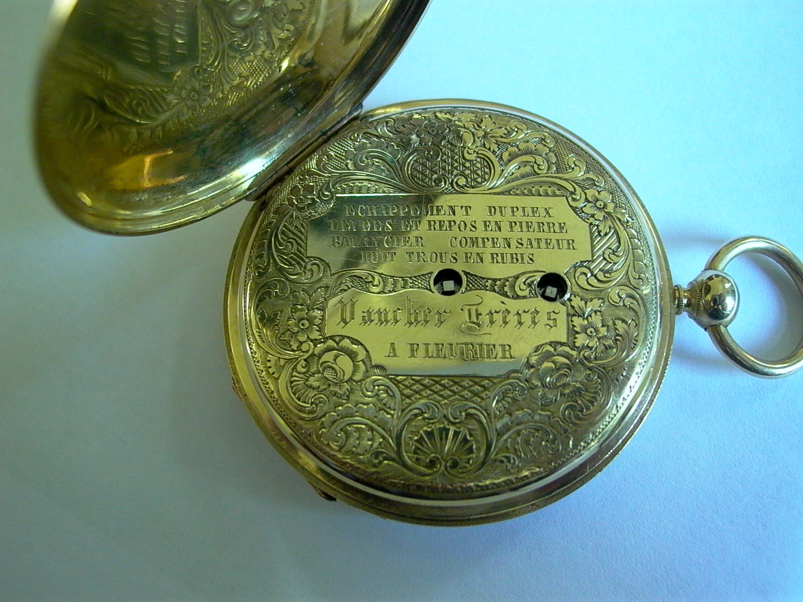

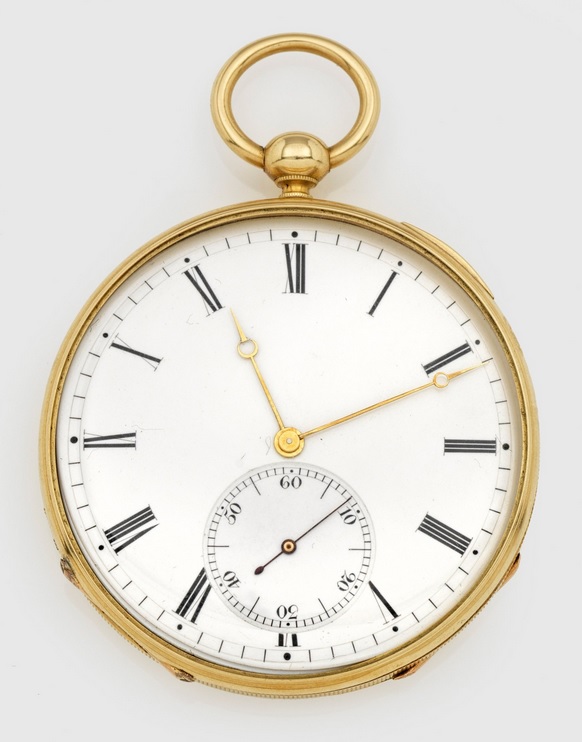

Here is a "bycatch" from last weekends auction. Vaucher Frers, about 1830. What I had to pay, including premium, was the gold scrap value.
It has several unusual features. First, it is a duplex. Second, the duplex wheel is steel. Third, the hairspring stud is on the "wrong" side, Fourth, the gaps of the compensation balance are on the "wrong" side of the balance spokes.
I really wonder how other could have overlooked this watch. Other pocket watches did well.
Now I have it in hands. And see what the cuvette inscription says. Fully jewelled duplex (roller and impulse stone). And it runs well. I do not know why the auction house did not include a photo of the cuvette.

How different to the pocket watches I collect. I am always intrigued by such ancient and well preserved examples of the watchmaker’s art. Very rarely do I run into such watches in this part of the world. If I did run into such examples, I’d have to think hard when it came to whether I would add them to my collection or not. Great to look at, thanks for showing it.

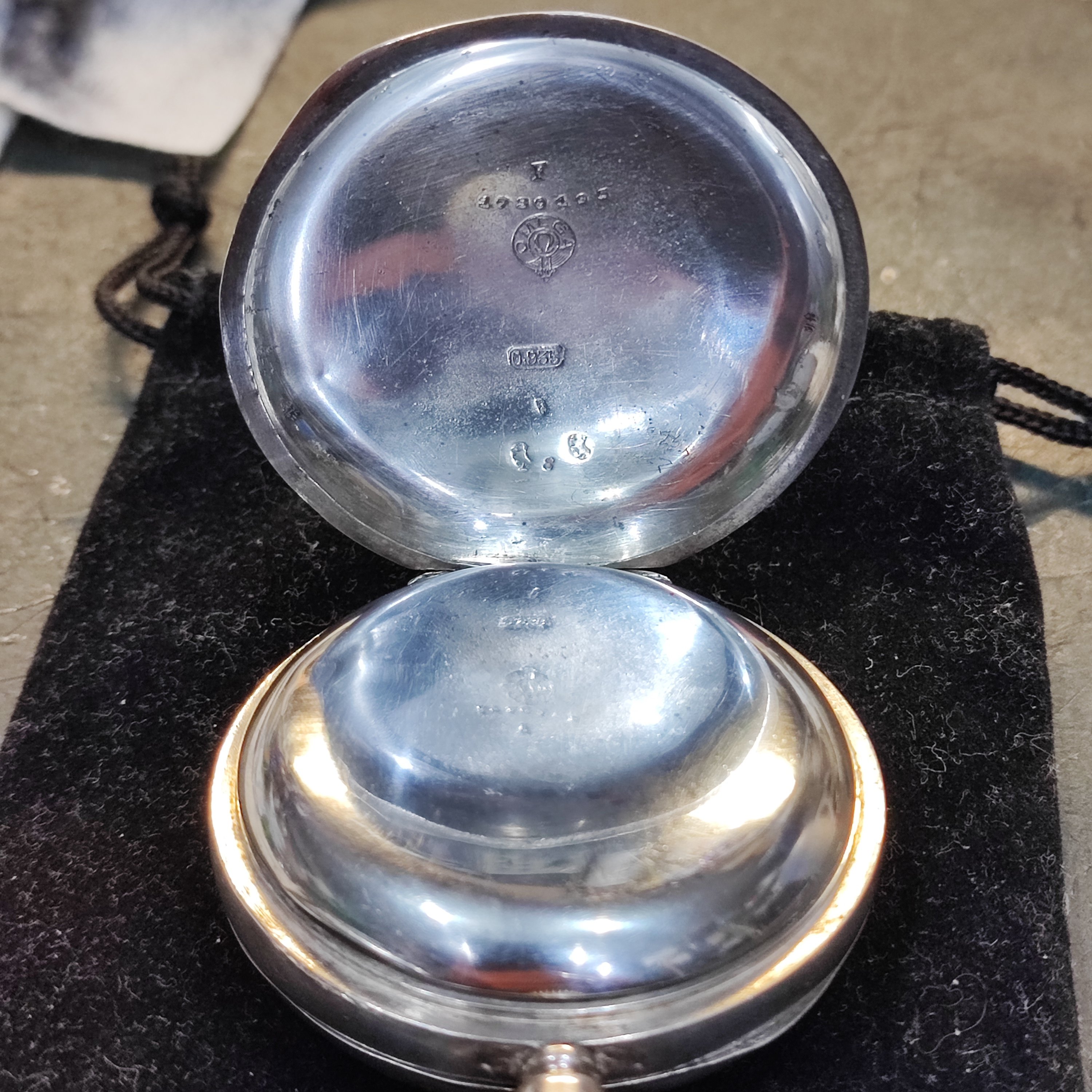

Hm, the "full service" apparently does not include proper installation of the hairspring, as evidenced by the regulator being totally off? Was it done by Omega?
I personally would complain ...
Aside this, lovely watch with a perfect dial!
I agree that the regulator being all the way advanced is a red flag. I would not entrust a watch like this to Omega though, not with some of the horror stories we've had on this forum with Omega service on vintage pieces.
Yes he made mention of the regulation not being very good so he must have spent a bit of time on it.
He had issues with some of the Jewels which he could not find replacements for, ideally he would have changed them however they were serviceable, this may contribute to the regulation not being as he would have liked.
I will have to see if he can have further investigation of it.

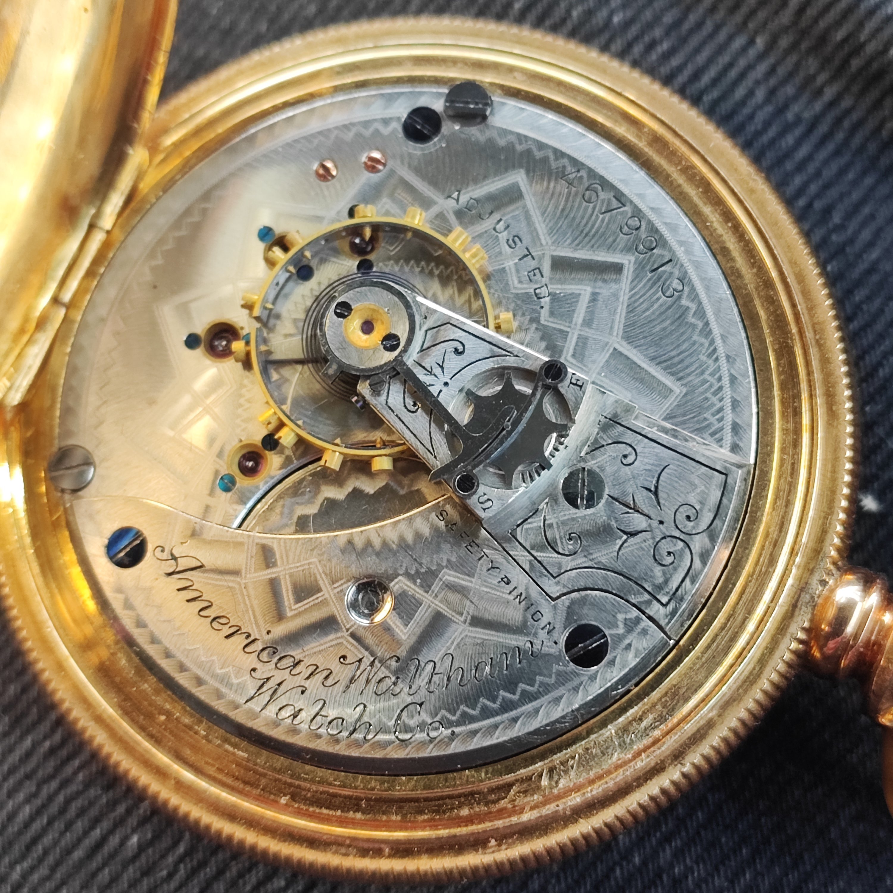

@ghce
While you are talking to whoever did the repair, he has also overlooked the fact that one of the two screws that holds the jewels in the balance cock is broken! The shank is there in the balance cock, but the head is missing! I wonder if he even tried to remedy that.
