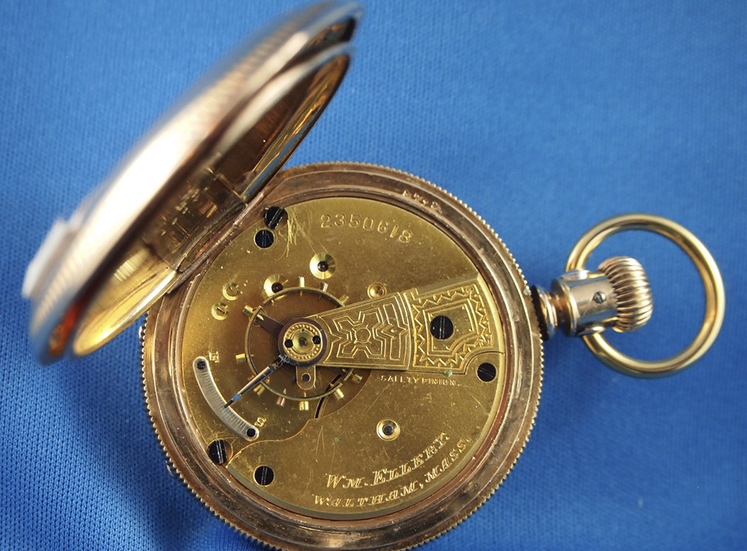

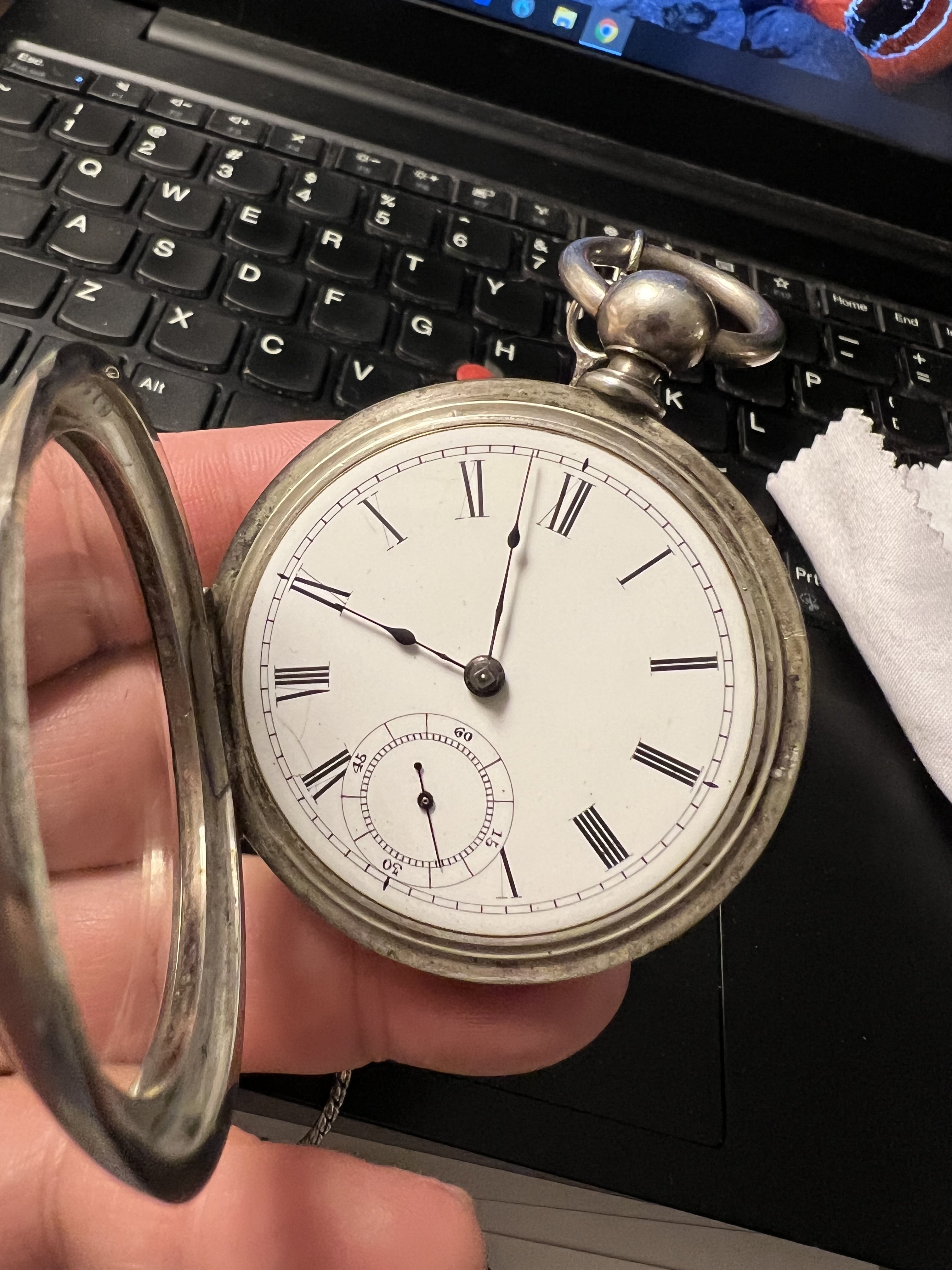

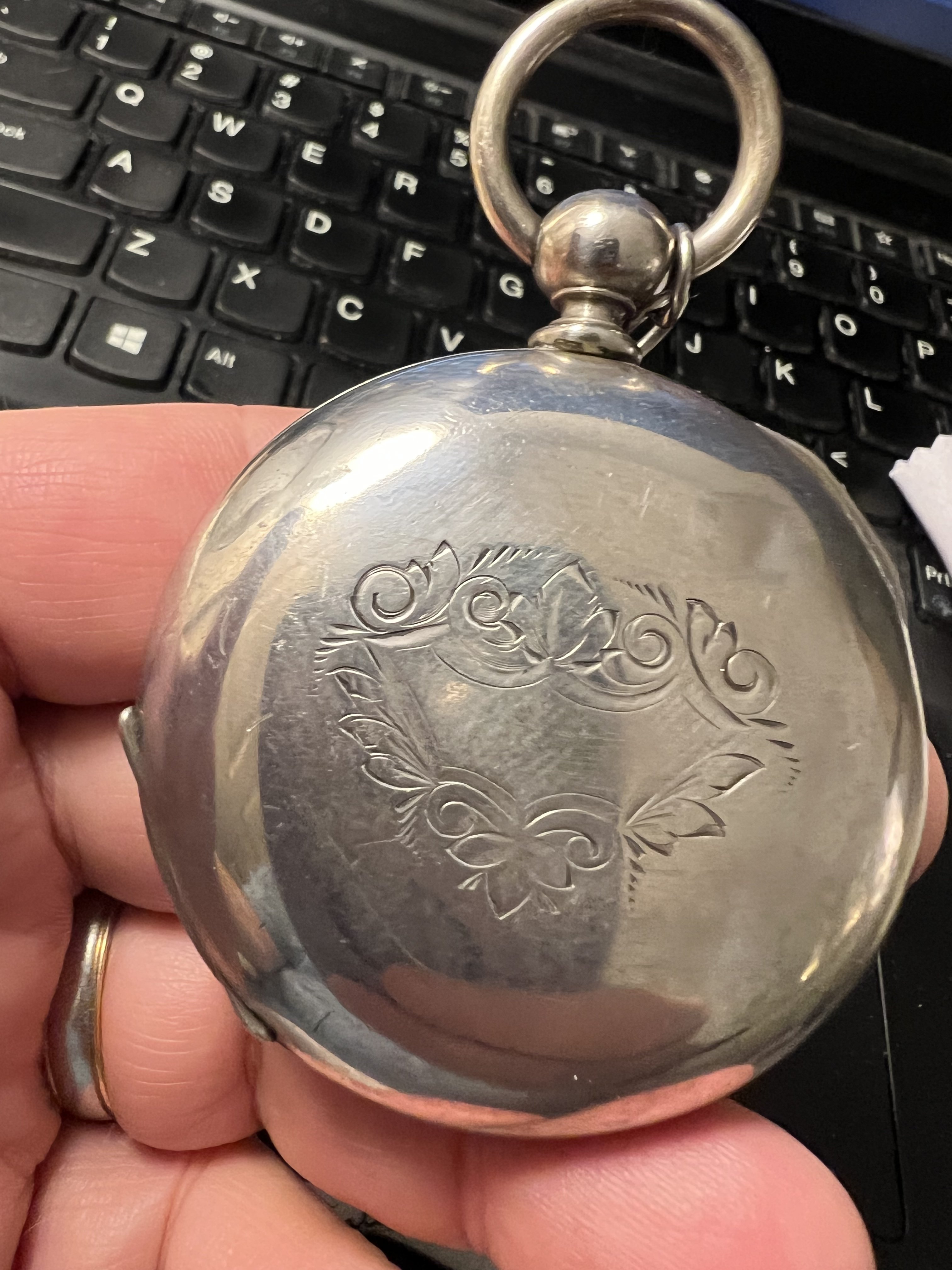

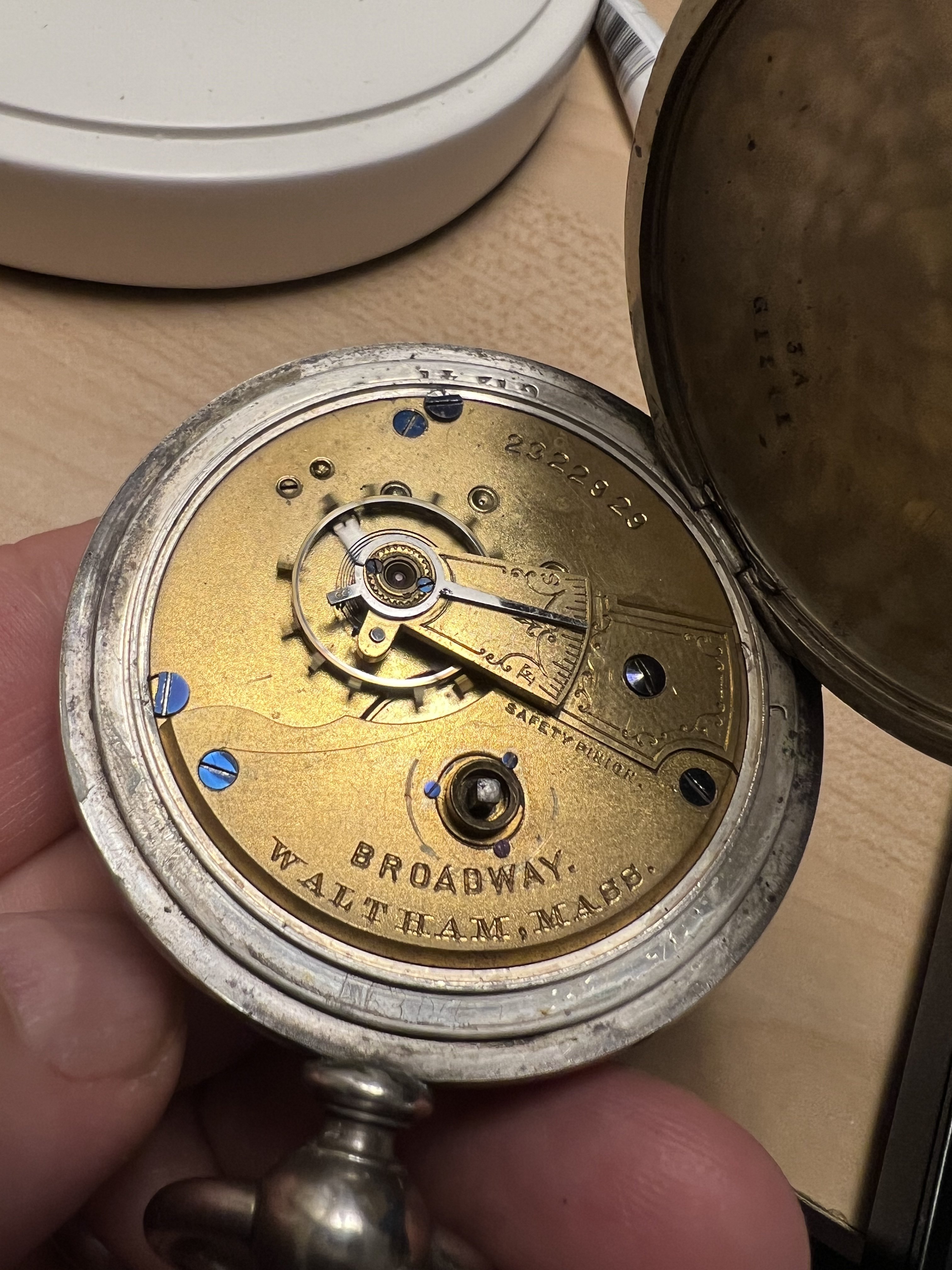

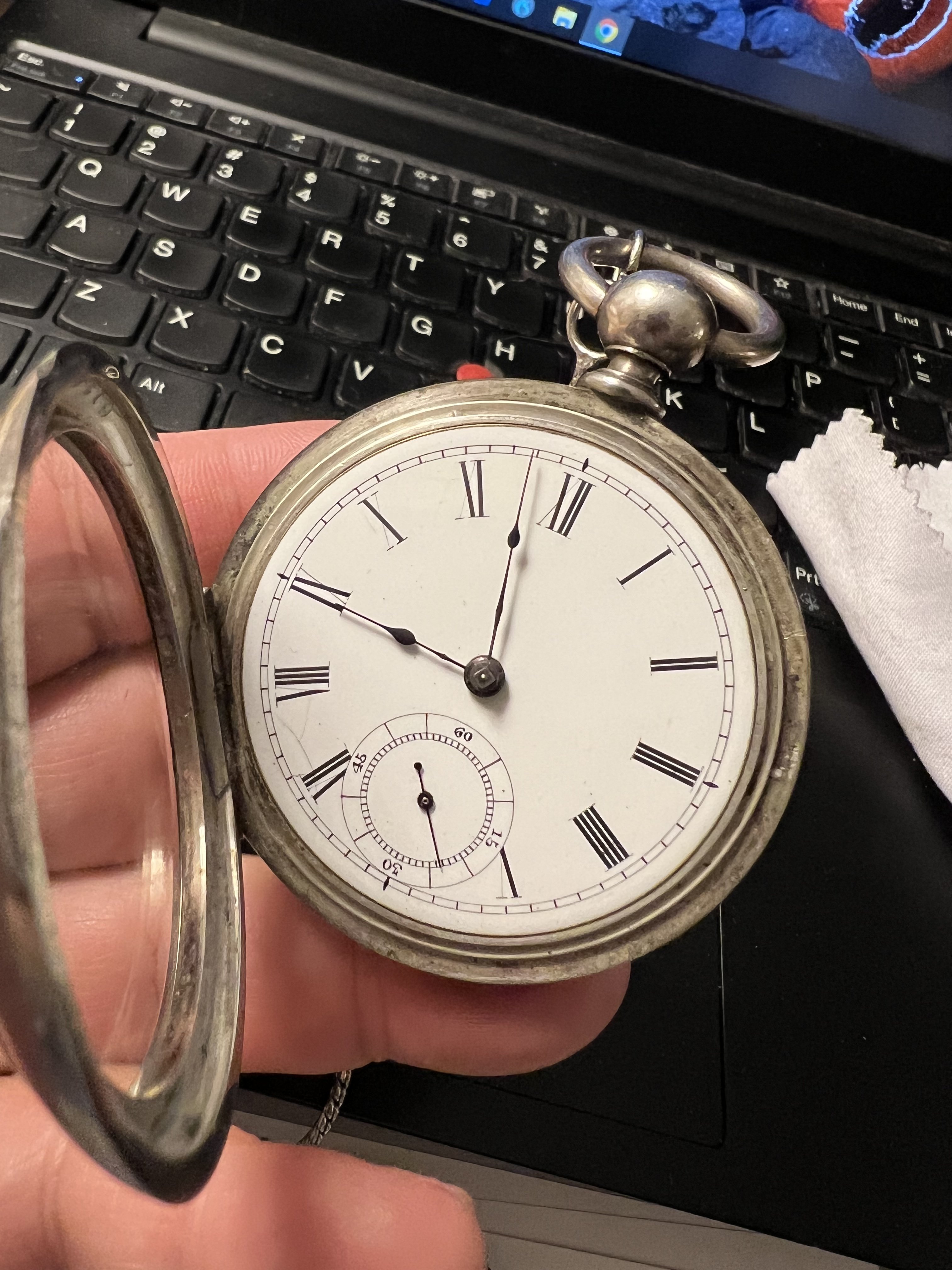

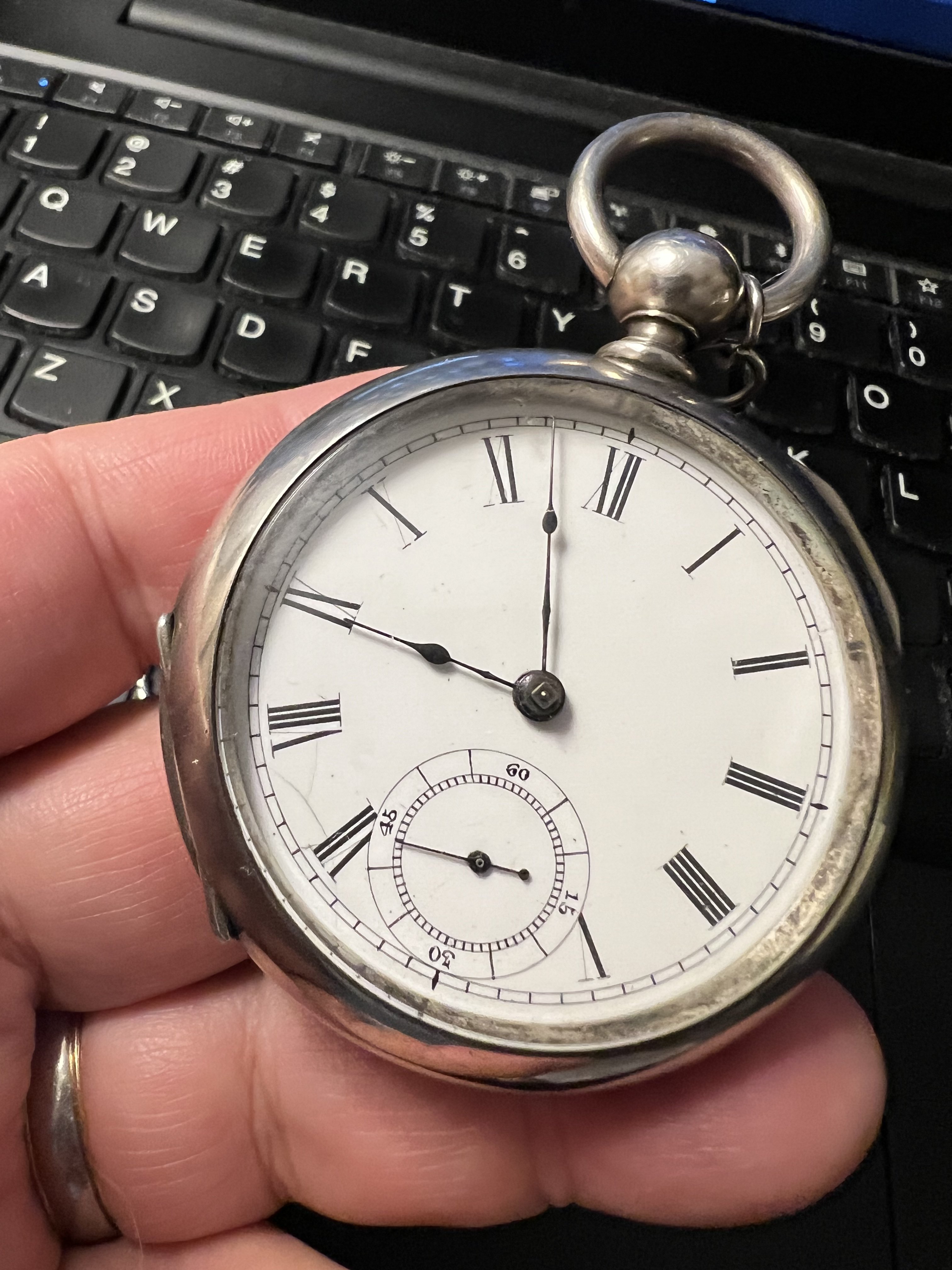

Impulse buy the other night- Waltham Model 1877 key wind/set. 18s coin silver case in pretty good shape snaps shut nicely. Few hairlines but pretty good overall functioning well. Have a thing for these! Not bad for $103

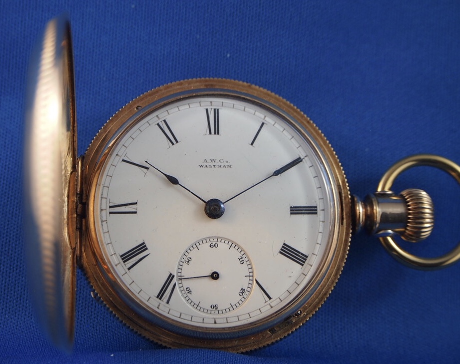

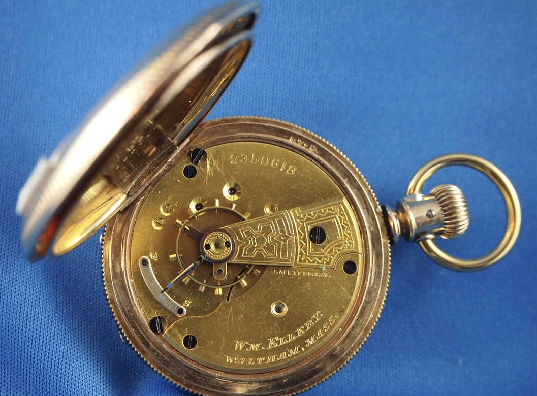

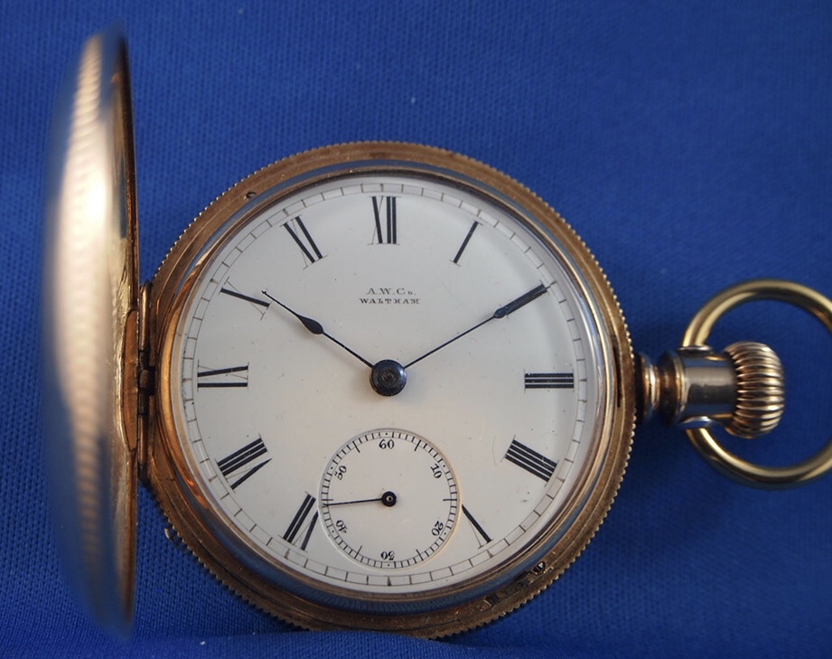

The 1877 model, 18-size Waltham was also,produced as a stem winder model as seen in the example I have uploaded. The subject watch is open faced, with the pendant at the 12:00 position. My 1877 model is in a hunter case with the winding crown at the 3:00 position. The stem winder 1877 model was only suitable for a hunter case, while the key winder could be made as open-faced, or hunter.
Here is the pocketwatchdatabase information on @SOG53 ’s Waltham
https://pocketwatchdatabase.com/search/result/waltham/2322929

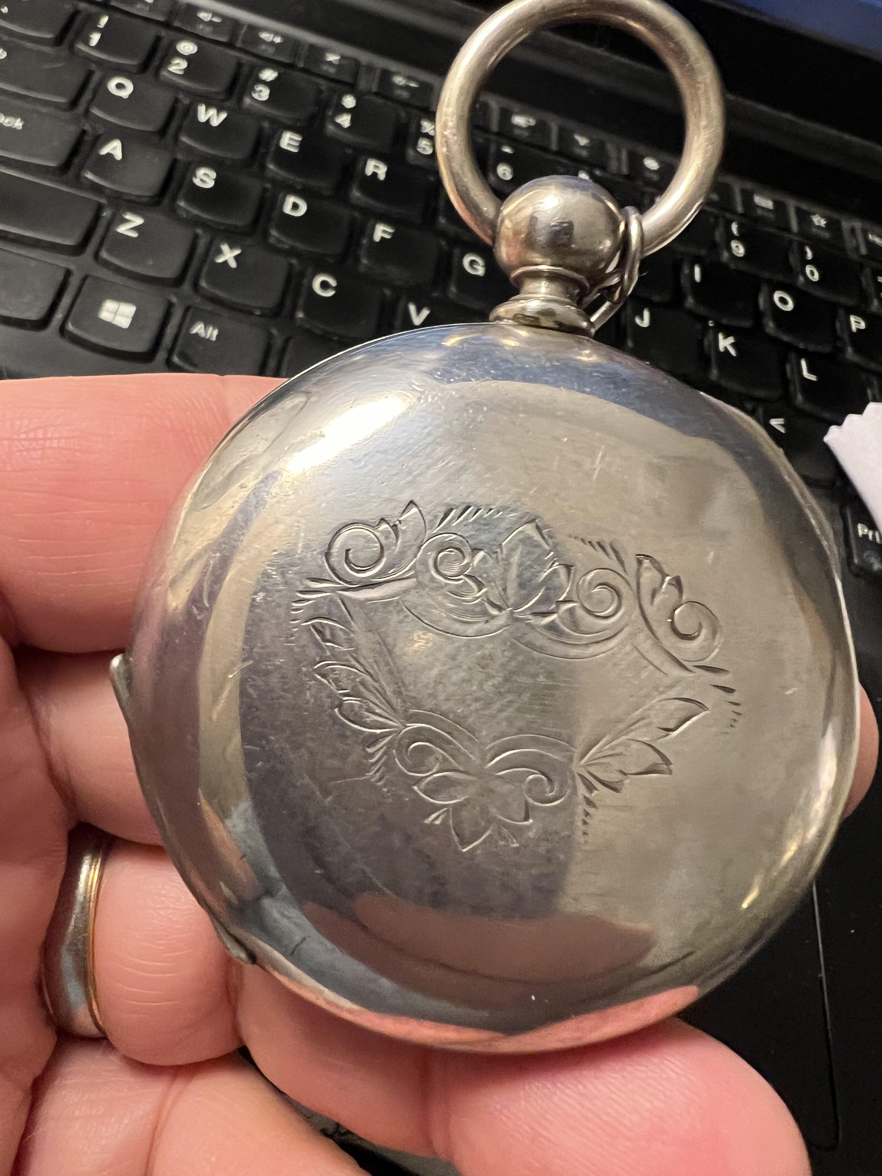

Here’s mine.

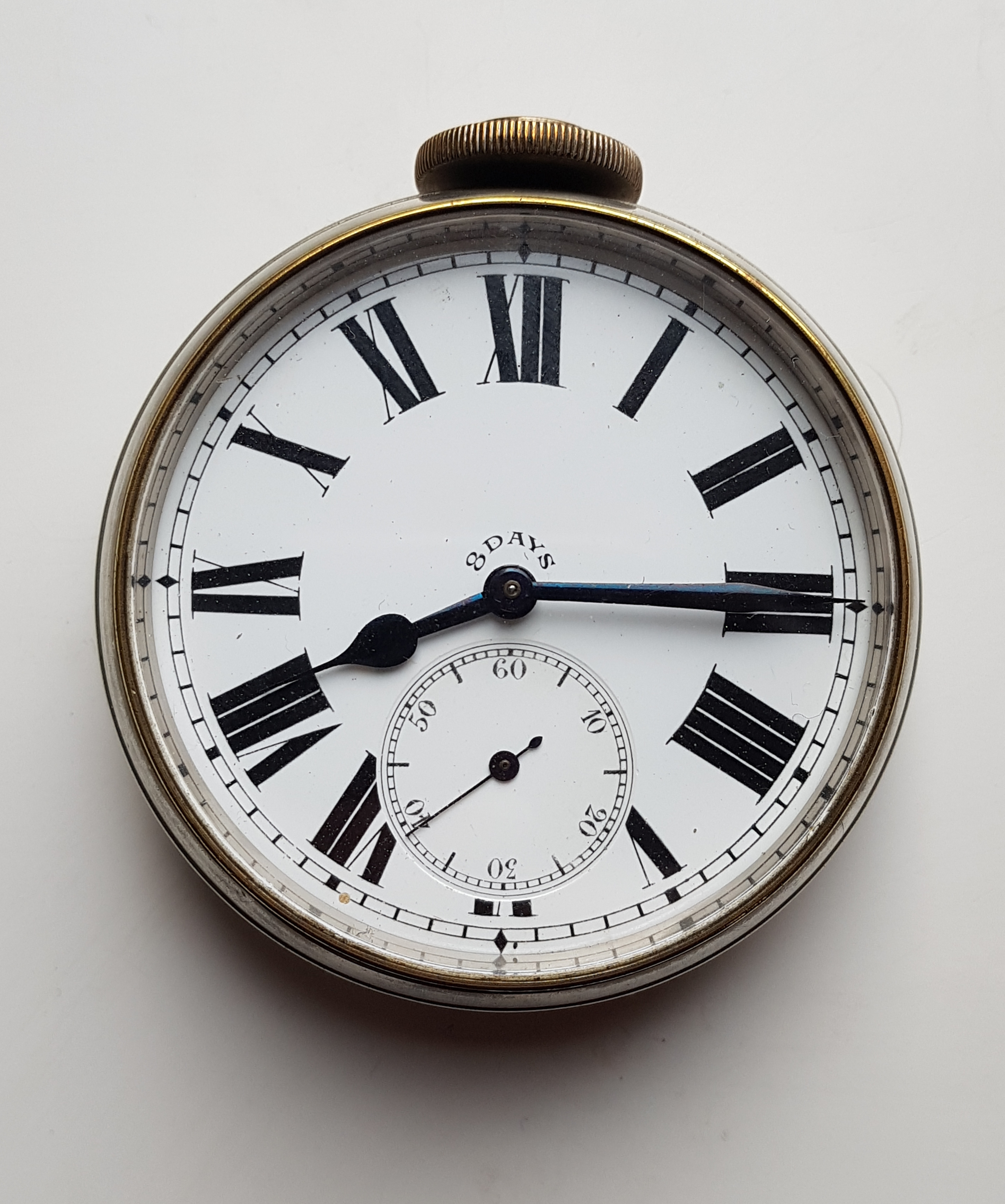

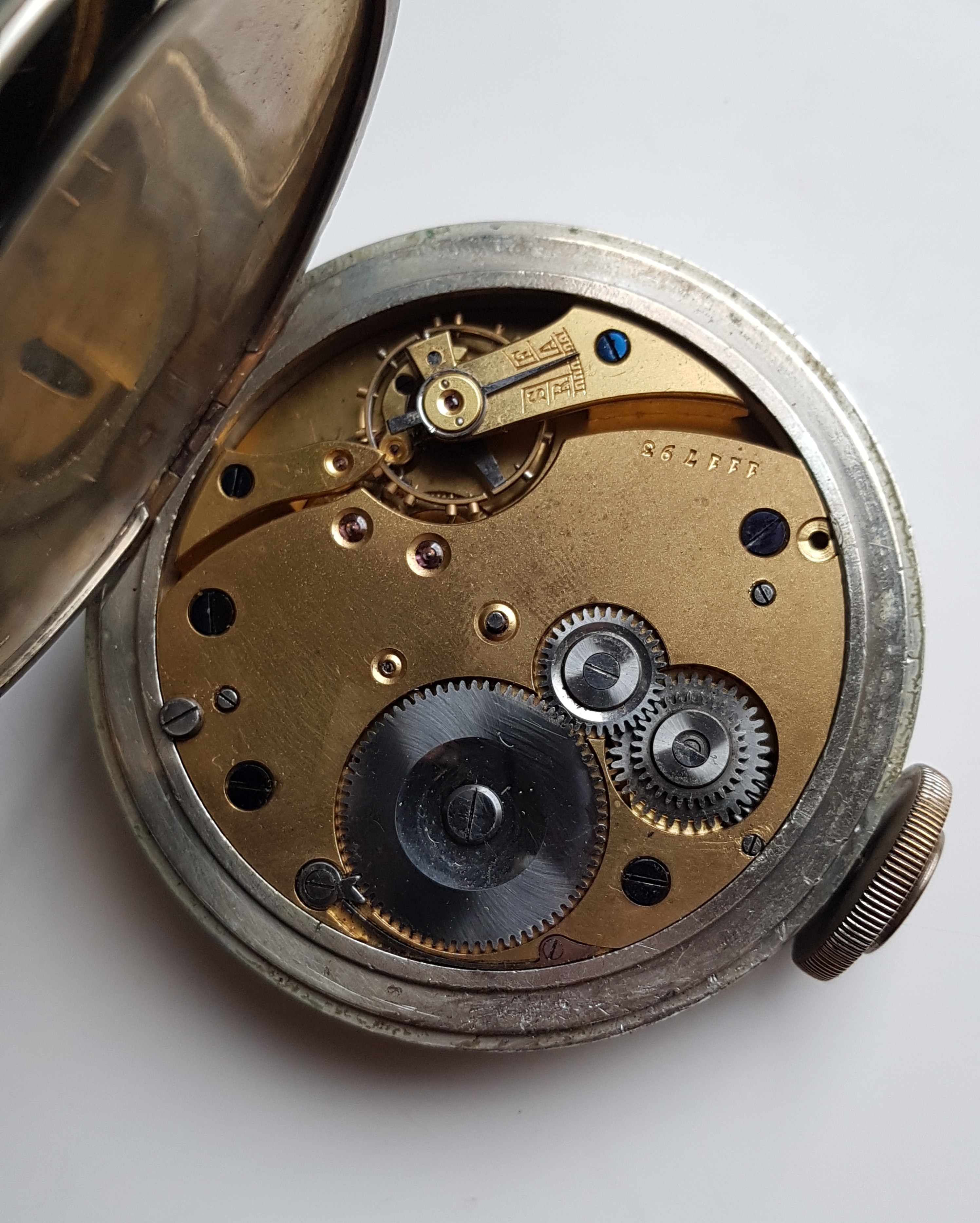

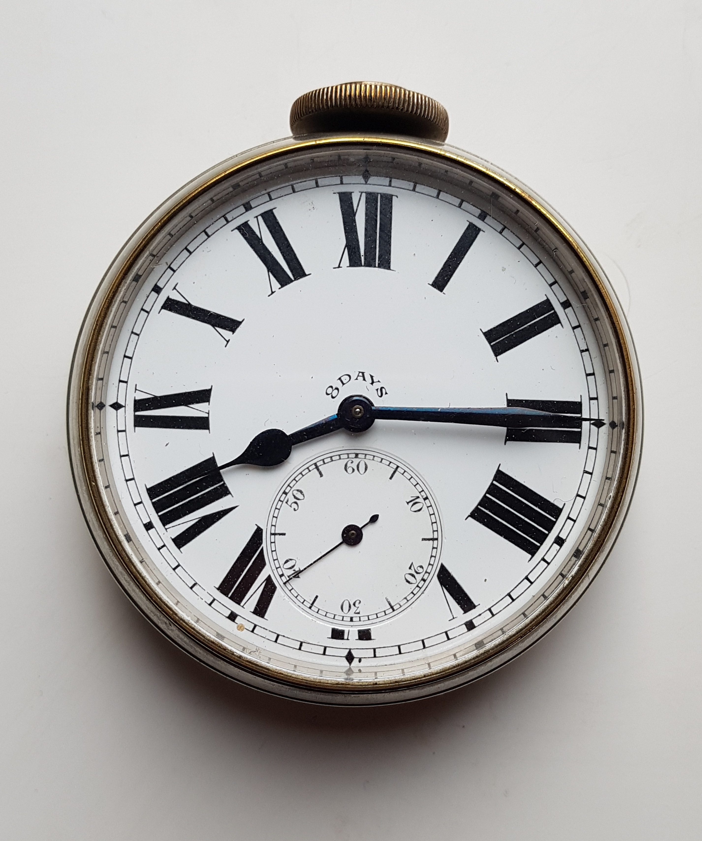

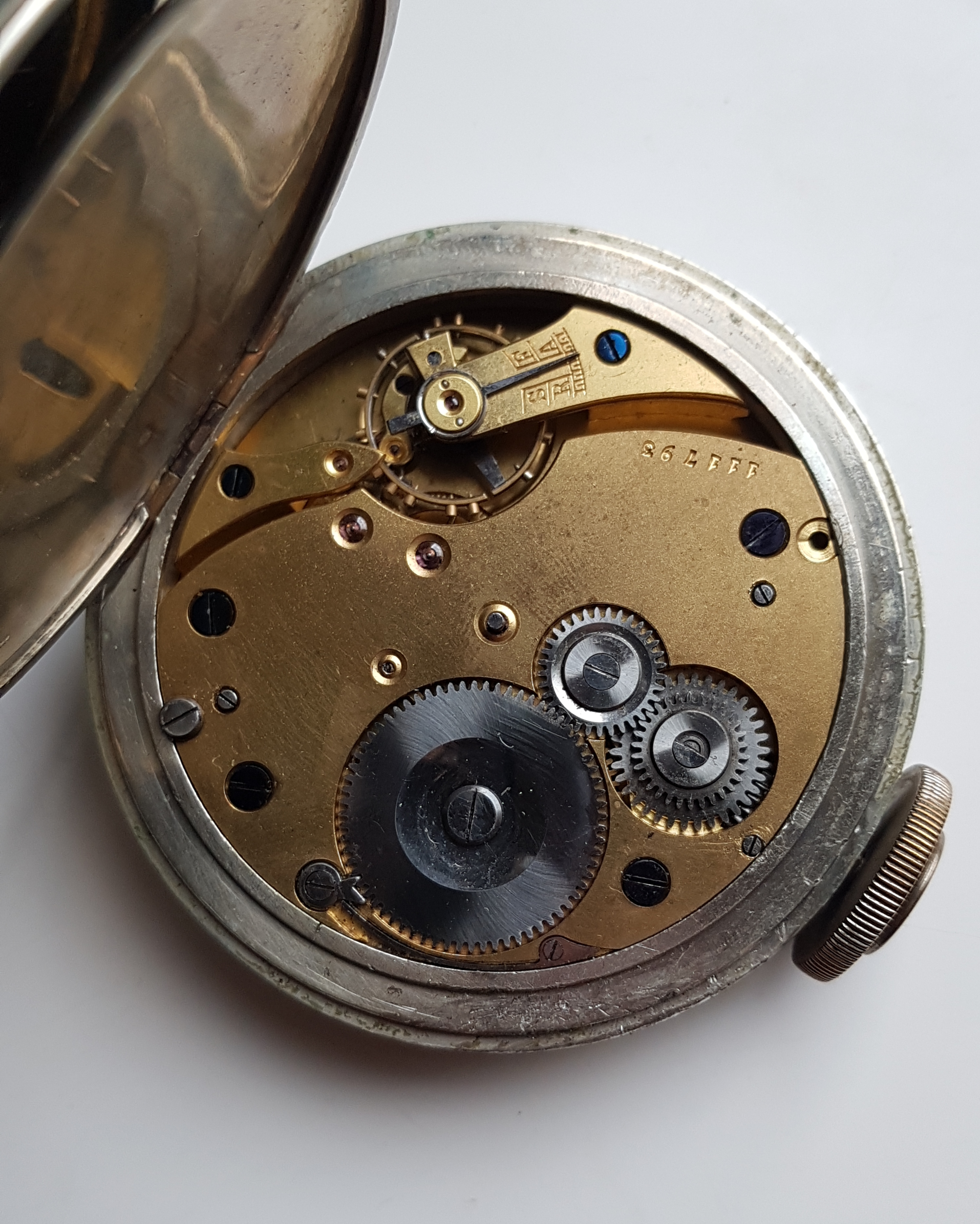

A recent addition. Maybe it is nothing special, but it looked a bit different from other pocket watches. Is there anyone who can tell me anything about it?
15,997
48,115
Perhaps someone will see your post that can tell you more than I can. These huge 8-day clock/watches were never intended as pocket watches to the best of my knowledge. Some were intended as car clocks. Some were intended as boudoir, or parlour clocks. Some were intended as carriage clocks which might have been transported in a fitted leather case. Adaptations on the basic watch would have been made in order that it could be adapted to many different uses. Somewhere in its past, the subject clock/watch might have been fitted into a case which meant it could be used as a parlour clock. The subject clock/watch appears to be without trade marks or means of identification. Swiss made by my reckoning.

Thank you #Canuck that is a very good start.

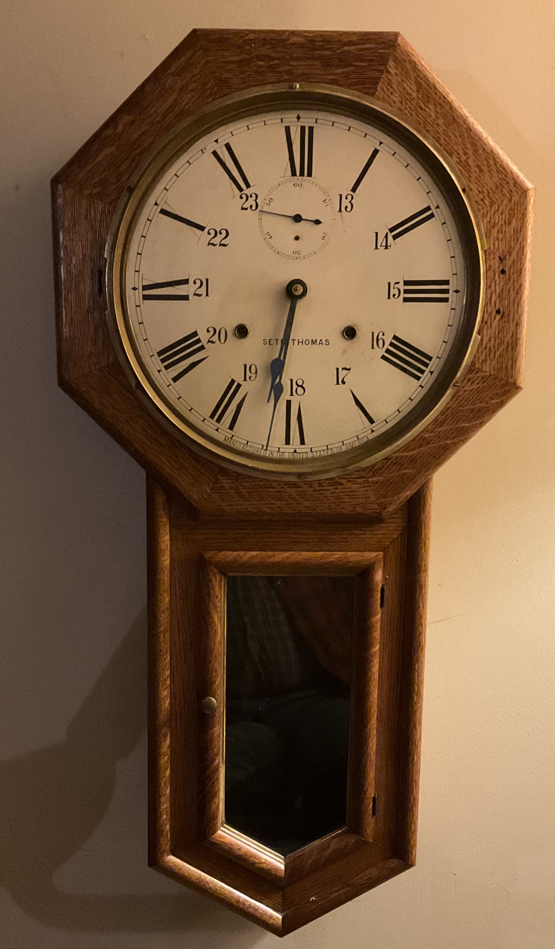

I only have one pocket watch running at the moment. My Hamilton 950B on my @DaveK lanyard, and in my pocket. I just finished major work on a Seth Thomas World railroad standard, octagon drop wall clock, for a friend. Many new bearings, trimming, polishing, and burnishing several scored pivots, replacing both mainsprings, replacing the glass, , cleaning the rusted hands and heat bluing them, and reconditioning. The 950B runs within seconds per day, and I am regulating the clock.

I’d love to see the clock
15,997
48,115

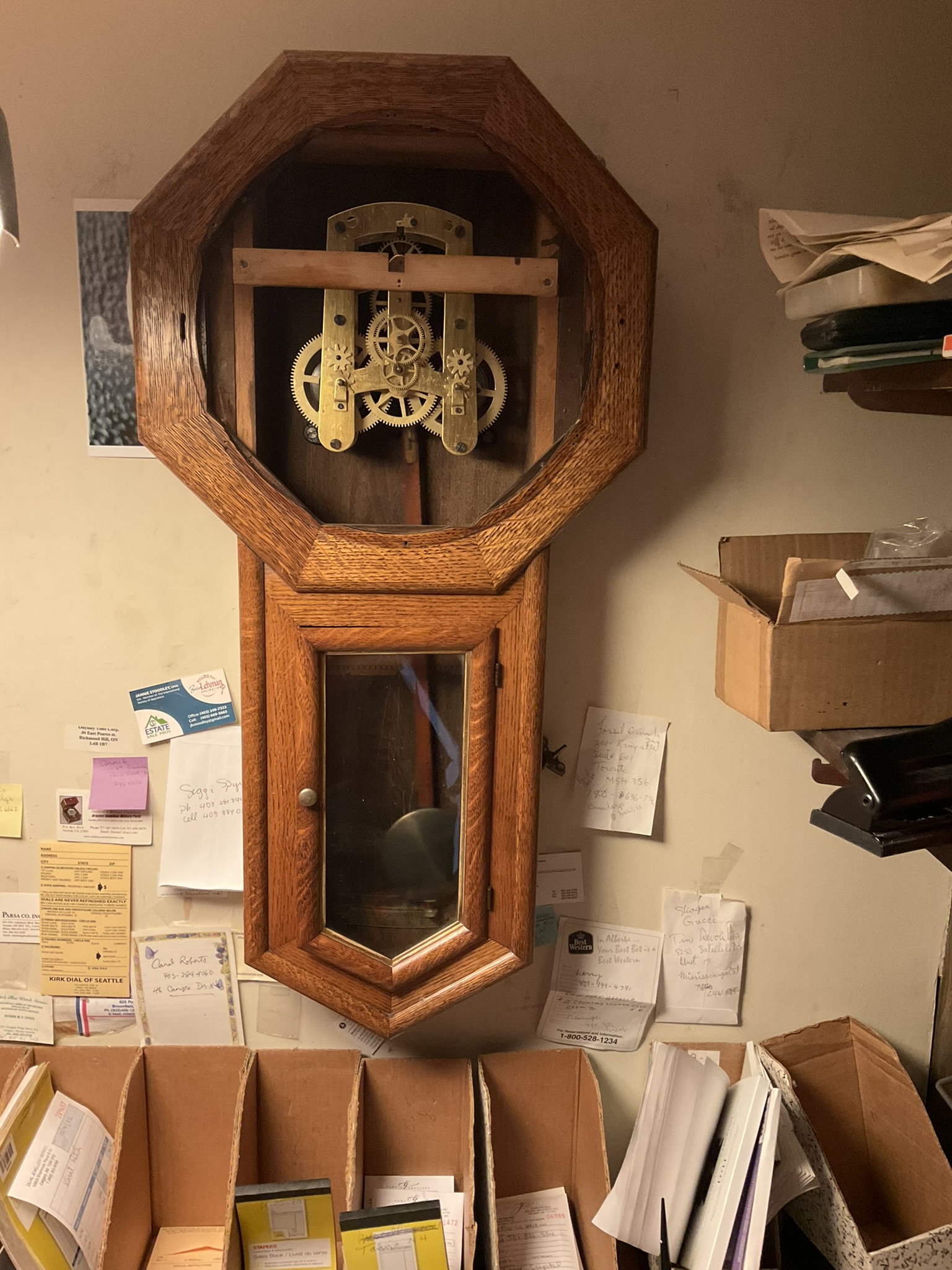

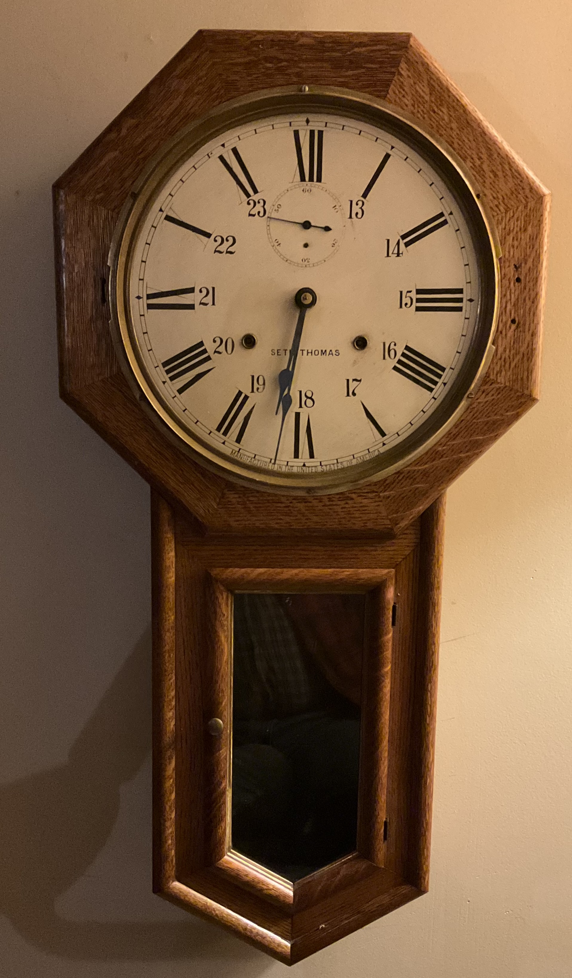

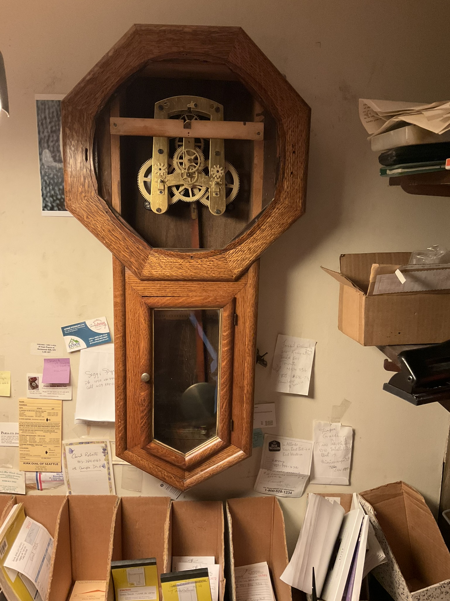

The Seth Thomas World, 15-day model, after servicing, but without the bezel and glass which I am presently having cut. Circa 1920, having not been serviced for decades! Original 24-hour dial. Canadian Pacific Railway had hundreds of these. They started decommissioning them during the mid 1950s. At one point, you could see dozens of them on a luggage wagon at a CPR station. Your choice, $25.00. A nice one now brings up to about $1,500.00! The 30-day model which is rarer, will bring quite a bit more. Seth Thomas was originally located in Plymouth Hollow, Connecticut. The town was renamed Thomaston in honour of the firm.
Lovely! I will spend the next weekend servicing an English double fusee drop dial clock. Complete tear-down and seems to need some work to the fusee conus´.
Is the glass of your Seth Thomas originally flat or domed? I would love to see the movement, if photos are at hand.
Cheers, Bernhard

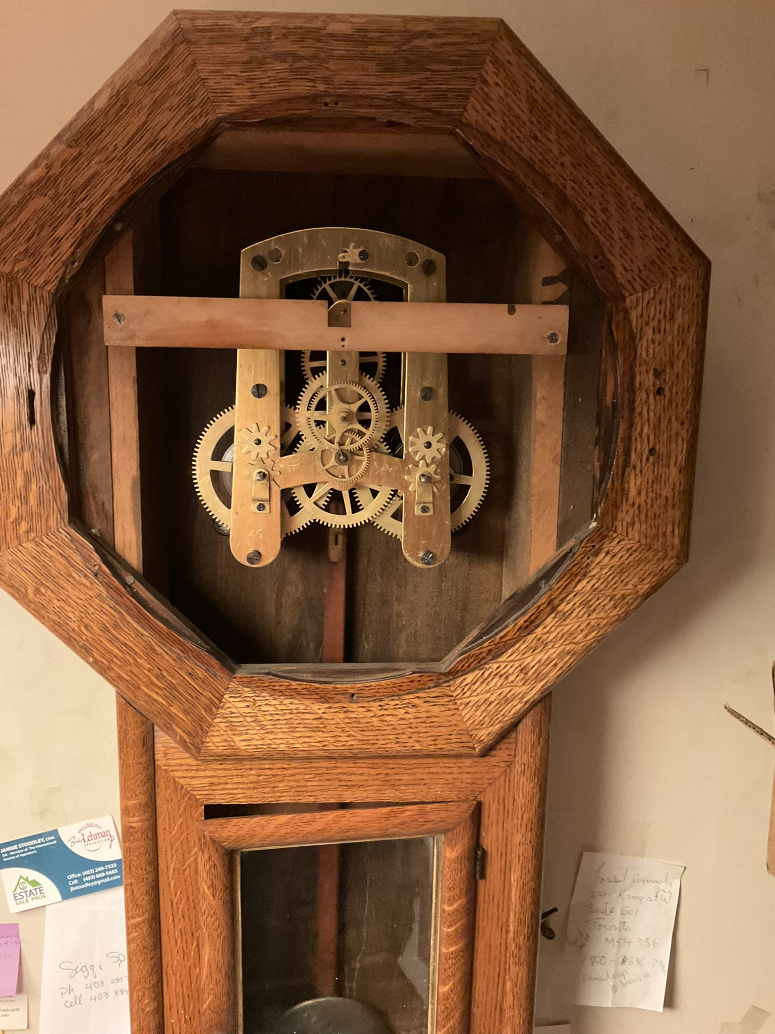

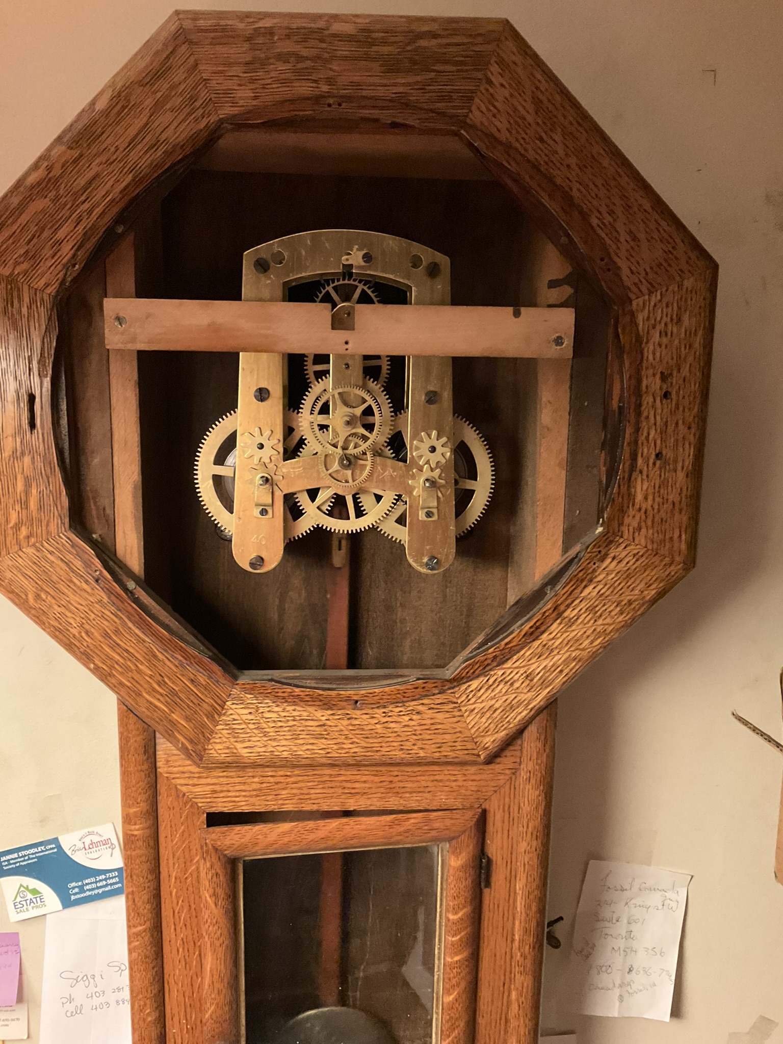

The glass on a S T World was flat, originally, and the bezel is deep enough a domed glass was not necessary. I’m fitting a flat glass. I’ll have the clock for another two weeks. I’ll pull the dial and post a picture of the movement. These clocks are time only, in spite of having two mainsprings.
Interesting, so one needs to wind both main springs separately through the two winding holes? And both barrel wheels jointly drive the single minute/first wheel?
Yes! Both main wheels mesh with a single pinion. That is the second wheel, and it meshes with the centre wheel which carries the minute hand. You must wind both mainsprings. Both main wheels have stop works on them. If both springs run down simultaneously (as they should if the two stop works are set up properly), if you only wind one spring, the stop works on the other main wheel will be engaged, and it will prevent the clock from running. This arrangement (two mainsprings) effectively operates as maintaining power. The clock will continue to run as each spring is individually wound.

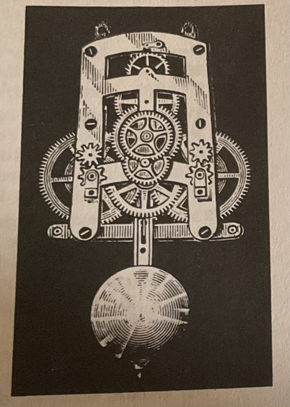

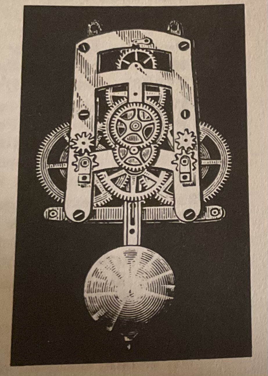

This image of the S T World movement is out of the Tran Duy Ly Identification and Price Guide book on Seth Thomas. This same basic movement was used in numerous wall clocks which were designed for a variety of applications. This basic moment (with a short pendulum as shown) was also used ITR (International Time Recorder, [I B M]) punch clocks used to track employee hours.
Ah, that does really make sense. Finally, are the springs wound both in the same sense, or opposite to each other? I believe to recall that in a similar Hamilton clock with two mainsprings one is wound clockwise and the other counterclockwise.
Cheers, Bernhard
Since both first wheels mesh with a common pinion on the second wheel, both first wheels must turn in the same direction. Thereby, both spring arbors are turned counter-clockwise. Being open springs (as opposed to springs in barrels), the first wheels travel clockwise, the second wheel, counter-clockwise, third wheel (carries the minute hand), turns clockwise. Etc. Two wheels that turn in directions opposite to each other cannot mesh with a common pinion.
In case you are compelled to ask, springs in barrels drive the barrel from the outer end of the springs, hence the barrels turn in the direction of winding. Open springs like the World has, drive the first wheels from the inner end of the spring. Hence the first wheel travels in the direction opposite to the winding direction. Clear?

I should have anticipated there would be requests to show the movement of the Seth Thomas World railroad standard clock.
- Time only.
- Fifteen day model (runs 21 days on a full wind.)
- Dual mainsprings. Both must be wound.
- Graham dead beat escapement.
- Eighty beats per minute.
- Both great wheels fitted with stop-works.
- Oak veneer over pine case.
- Canadian Pacific Railway had hundreds in service across Canada.
- Built by Seth Thomas in Thomaston, Connecticut (originally known as Plymouth Hollow).
- Built circa 1910-20.
