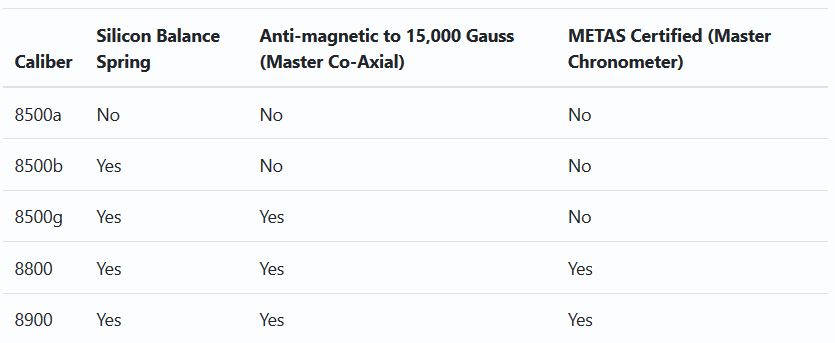

I have model: 231.10.42.21.01.006
It says "Master Co-Axial Chronometer" on the front and "15000 Gauss Anti Magnetic" on the back. Which 8500 is it? The product sheet does not specify.
986
3,009
8500g
