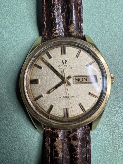

I recently won on Ebay a Cal 750 sparkle dial ( gold on gold filled ) Seamaster. This is my first "real" watch and I purchased it as a project.

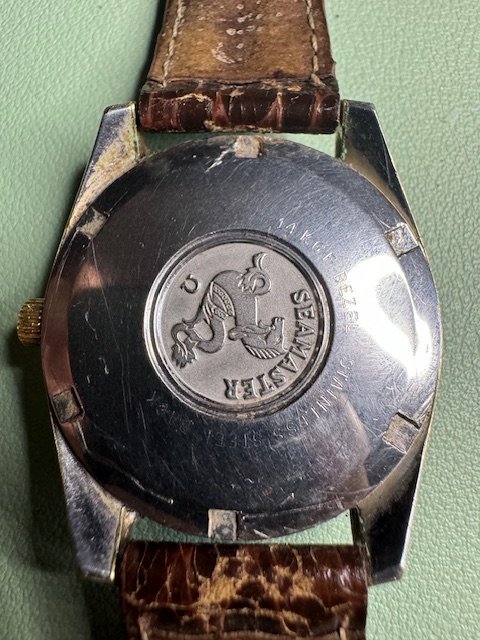

Overall it is in nice condition. The watch runs and the day / date and quickset work. The omega on the crown is very well defined. The etching on the back is still deep and legible. The worst damage is the scratches made by someone attempting to open the caseback (not me).

5. Is there supposed to be lume in the dark stripe in the middle of each index? Is there a little spot of lume at the end of each index ?

5. No lume in the black areas. It’s meant to be painted black.

Although few pictures are not showing too much detail looks like case isn’t bad. After you clean case and put it through ultrasound it may look much better and a light buff with jewelers cloth may be enough. Can always go back later
If you want water resistance then you should consider replacing crown with service one with proper seals.
Good luck and show us the finished result

Thank you sir. Yes it is pretty good except a few dings in the gold cap. I wanted to remove them but I am unsure how thick the gold "filling" is.
