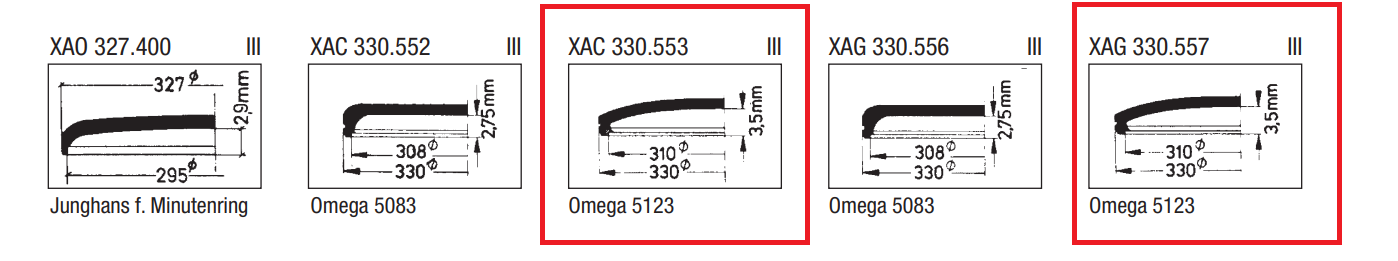

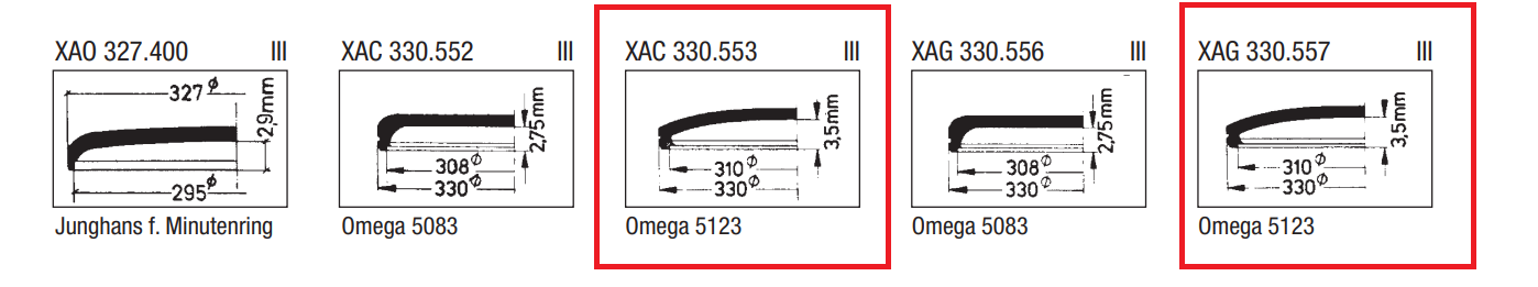

You need a special crystal for these as there is a groove all the way around the circumference to take tool 107. Obviously the Omega crystal has it but you can't fit just any generic crystal because of that. However, Sternkreuz (who make a lot of crystals and are based in Germany) make a specific crystal to replace the Omega one. I've never tried these specific crystals as have always fitted Omega ones but, there is no reason that they wouldn't be excellent and about 10% of the cost of the Omega one.
They are shown below and one has the steel colour ring, I believe the 553 (as it is XAC). The other is gold coloured and I believe that's the 557 (as it is XAG). You should be able to see the groove around the circumference.
Good luck, Chris
