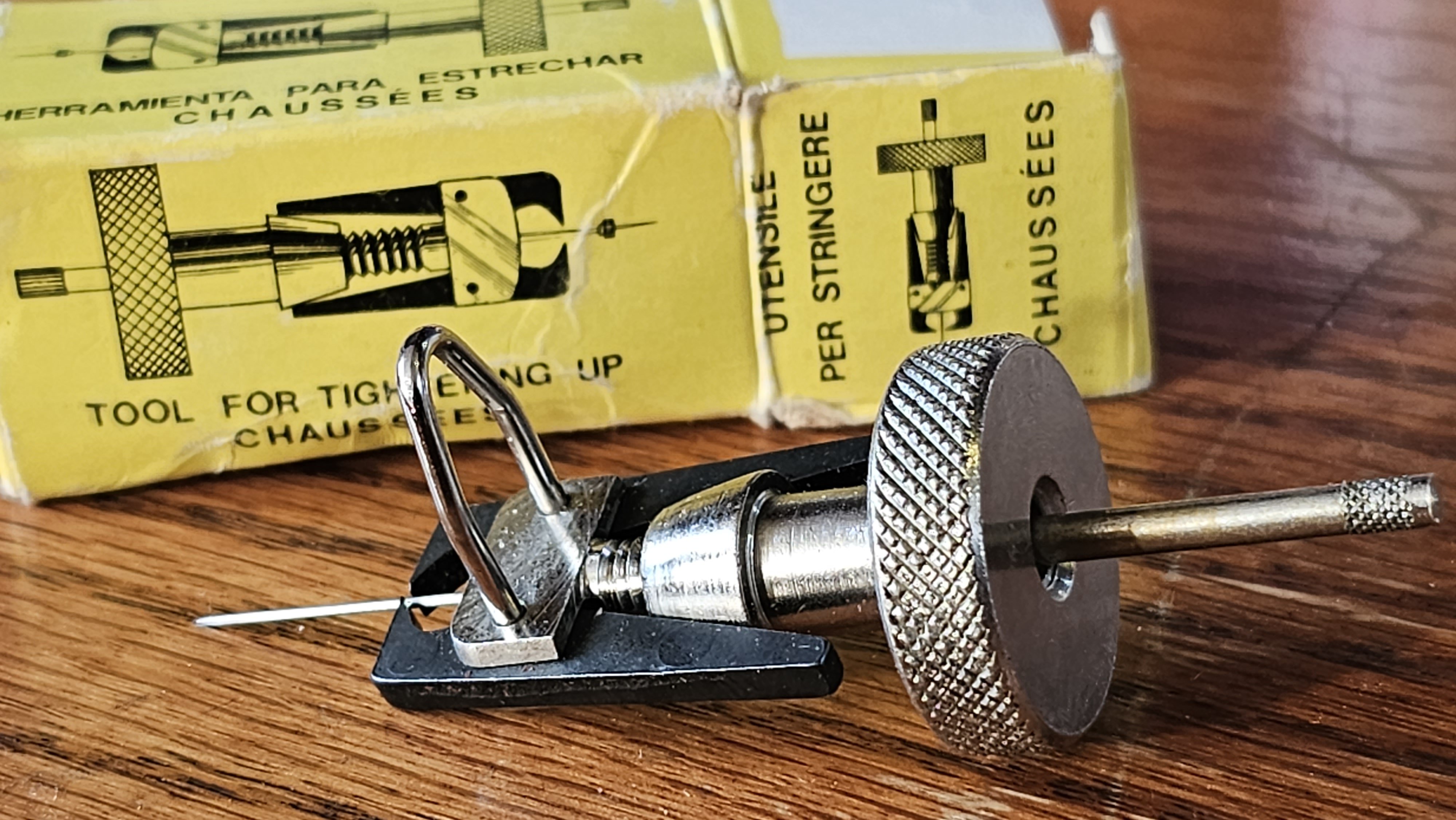

You need to remove the dial and hands. Get access to the cannon pinion and this tool.
Agreed, to be honest I’d rather fix a quick set date issue. Most of the time it’s just a misaligned part etc.
Bergeon will make a tool for just about anything, even turning a simple job into a complex one needing a special tool like this...🙄
