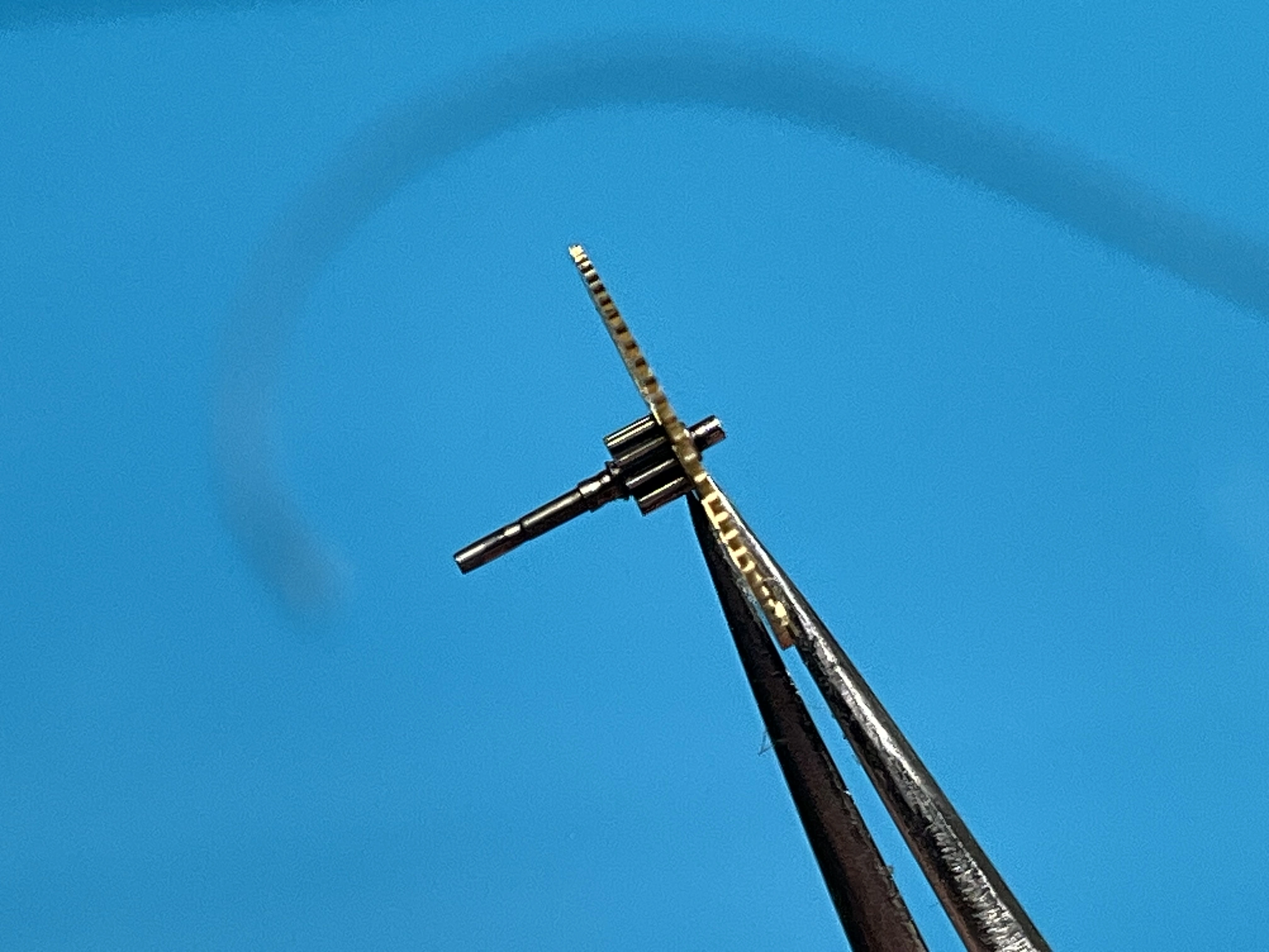

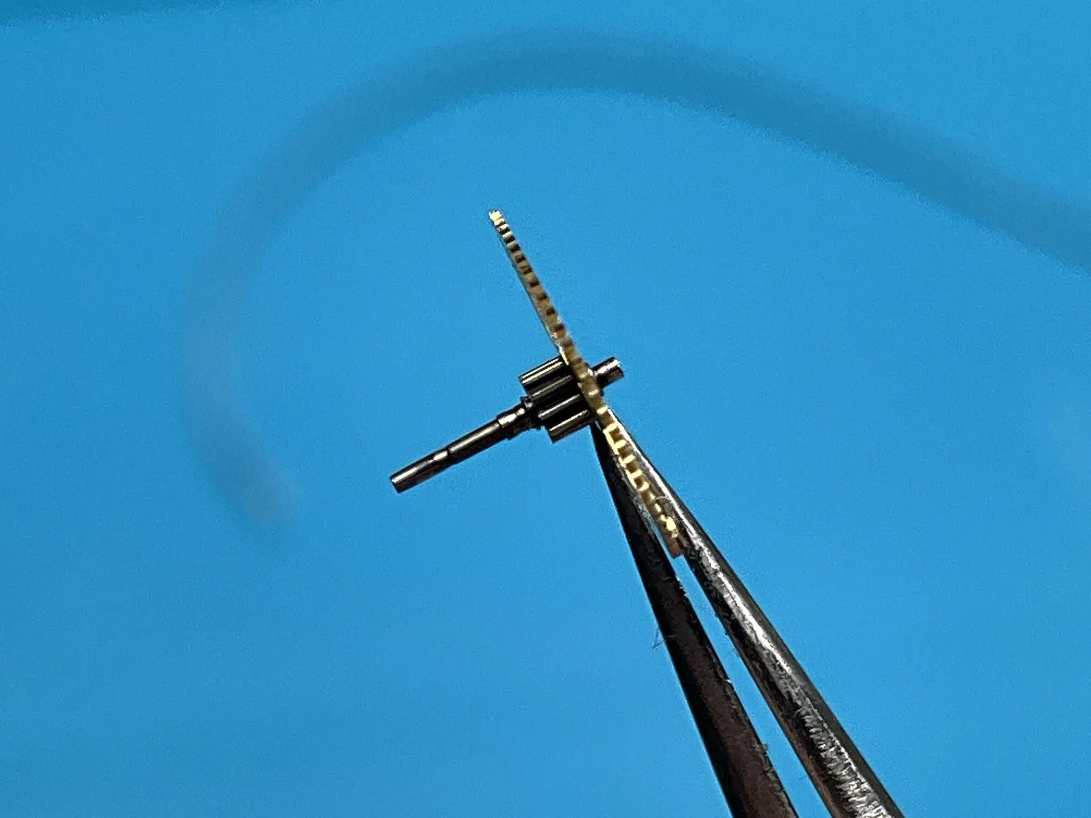

A broke escape wheel pivot would be extremely difficult (if not impossible) to see with the naked eye, or even low magnification. With a 15x-20x loupe it is obvious.

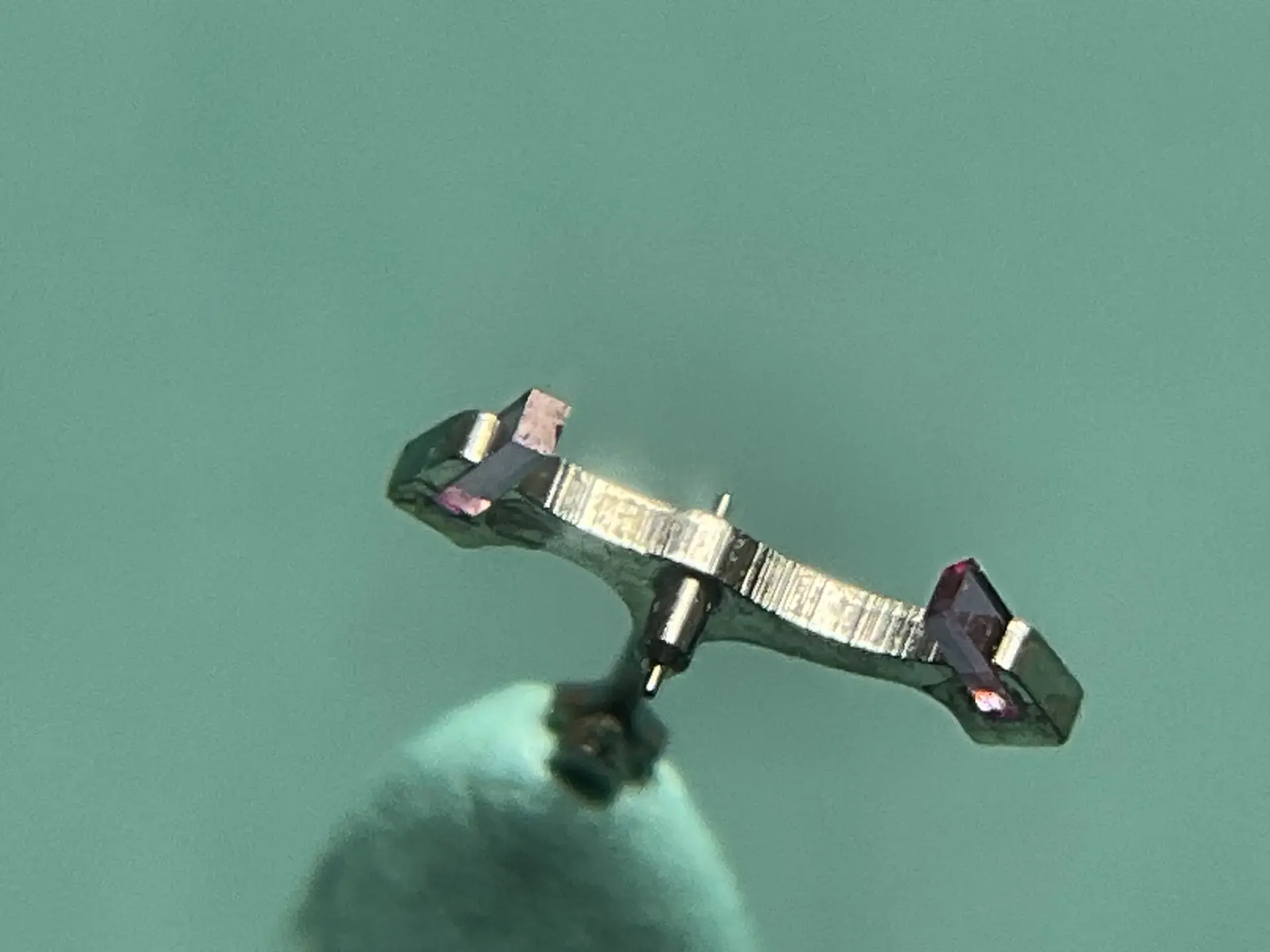

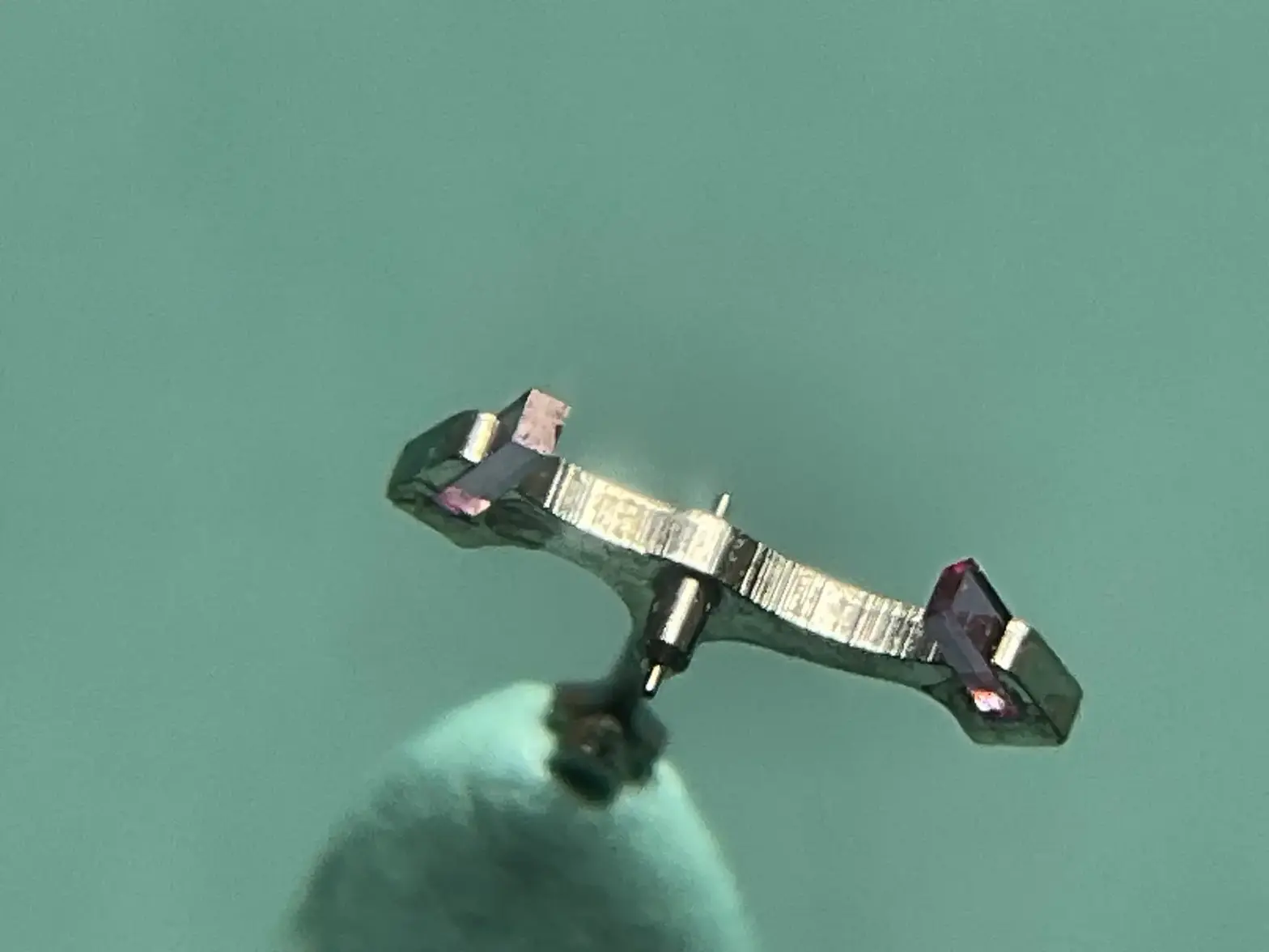

If you don鈥檛 have those and want to check right now, a very tight zoom on an iPad or high quality smartphone camera might get you there. For even more zoom, you can press a loupe up against the camera. This a pallet fork I photographer from my 2020 IPad mini 6 with a 20x loupe against the camera lens;
And here鈥檚 one taken with only the iPad camera at full zoom;
FWIW, I鈥檇 put my money on a broken pivot. I also recommend taking a look in the pivot hole on the bridge/main plate to make sure it鈥檚 not stuck in there. You shouldn鈥檛 need much magnification to see that if you hold them up to a light.
