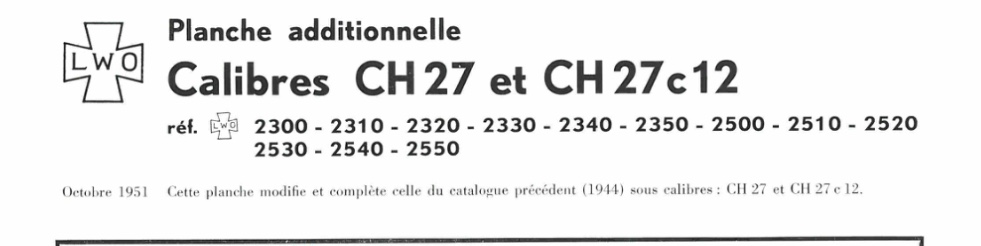

In order of reference.
Omega cal 320/321 was based on Lemania CH27/CH27c12 and entirely made by Lemania.
This design spawned a number of variants, all based on the same base movement.
List below complete as of late 50s/early 60s (Lemania designations).
There was also a budget version with cam lever called the 12xx / Lemania 105.
This shares some more components with the CH27.
As for the later Omega 861/186x, Lemania 187x, this was an entirely new development.
The same man, Mr Albert Piguet, head of Lemania technical development, was responsible for developing both the 321/861, however there is about 25 years separating the two designs.
