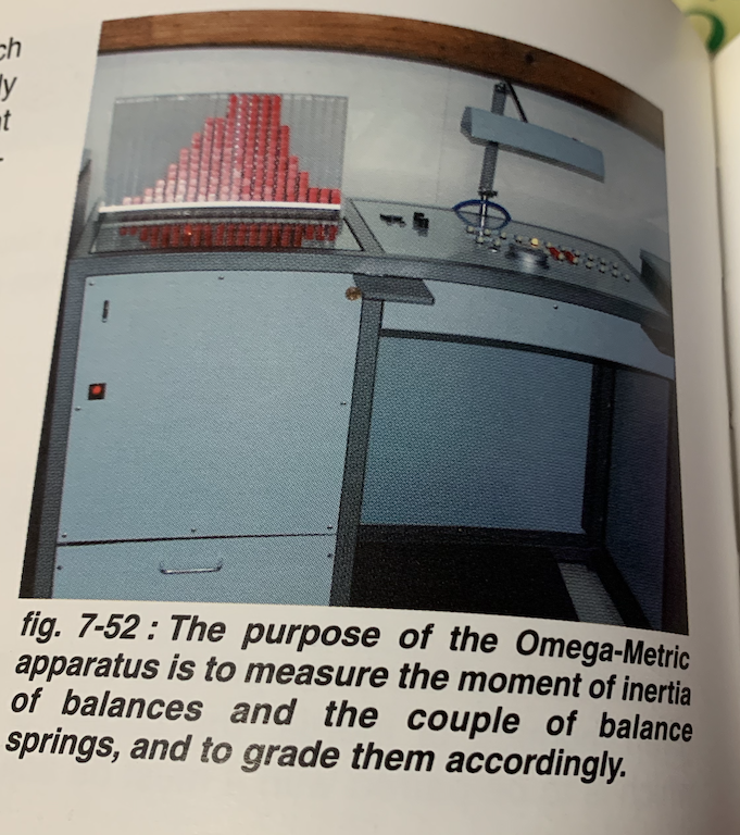

buy a broken balance and nick the hairspring?
That is the same as the OP option 2. Hairsprings are statistically matched to the balance.
Personally I would do option 1 and 2 (when needed.) while seeing if option 3 makes economic sense.
The repair probably just involves replacing the collet which is tricky as there is a taper pin filed off which has to be pressed out without distorting the spring. The books show this being done. That probably works on pocket watches such which used traditional materials. When one gets into the 'space age' alloys all bets are off.
This is exactly what my watchmaker said. He’s done it on many pocket watches.
