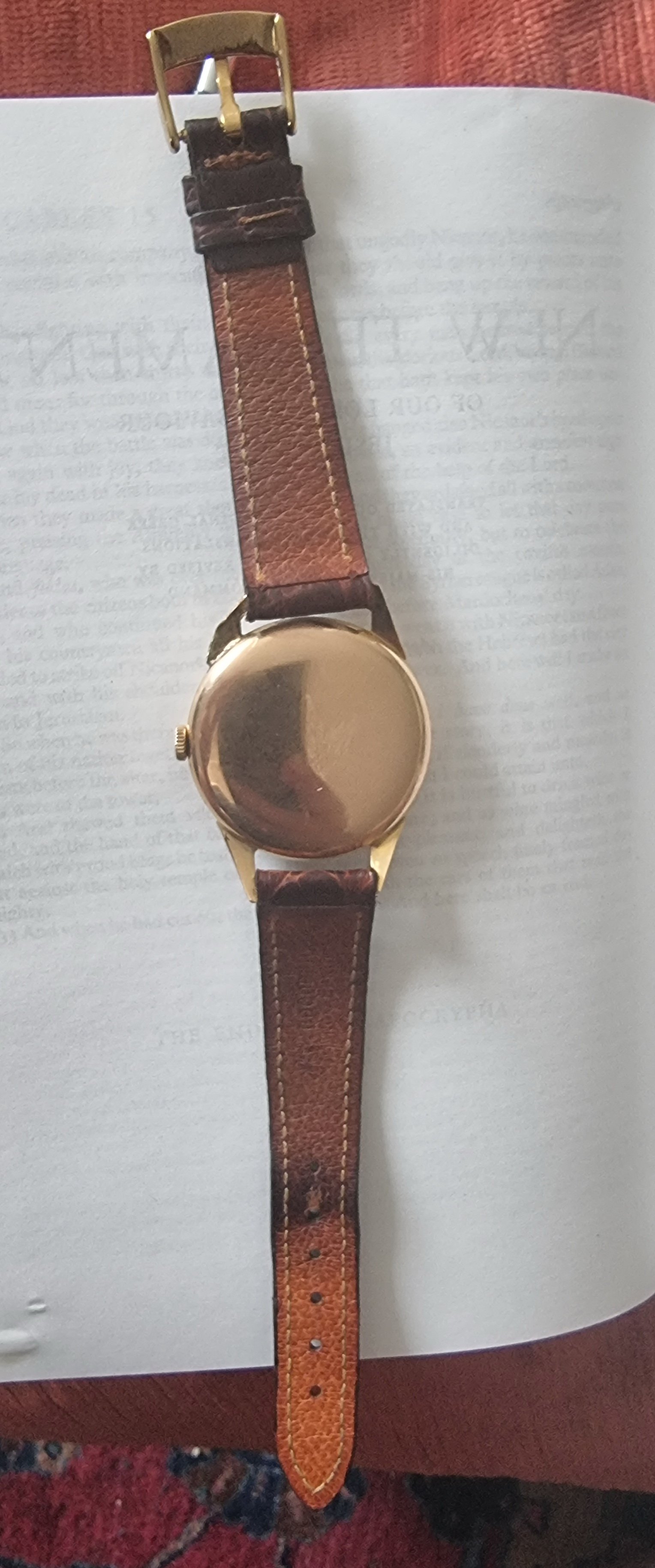

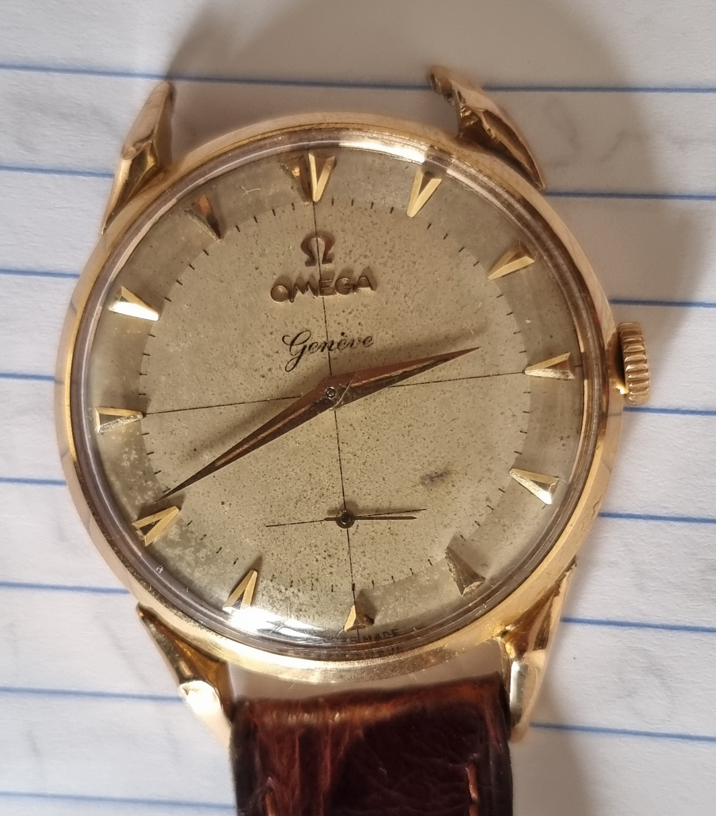

I bought an 18K 1964 Ref 111.007 Omega from ebay recently. The watch was described as good condition, light marks to lugs from normal use.

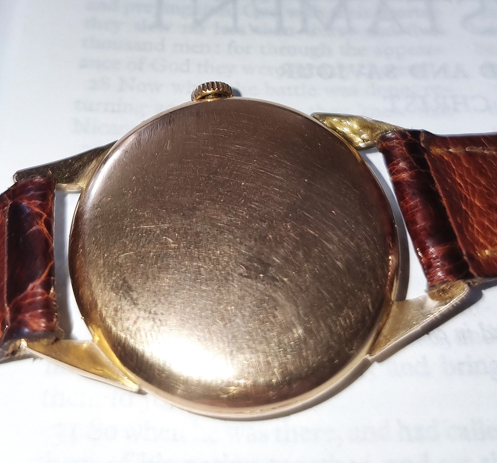

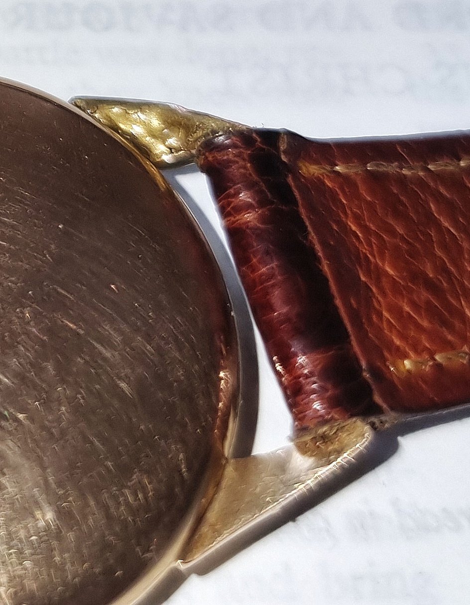

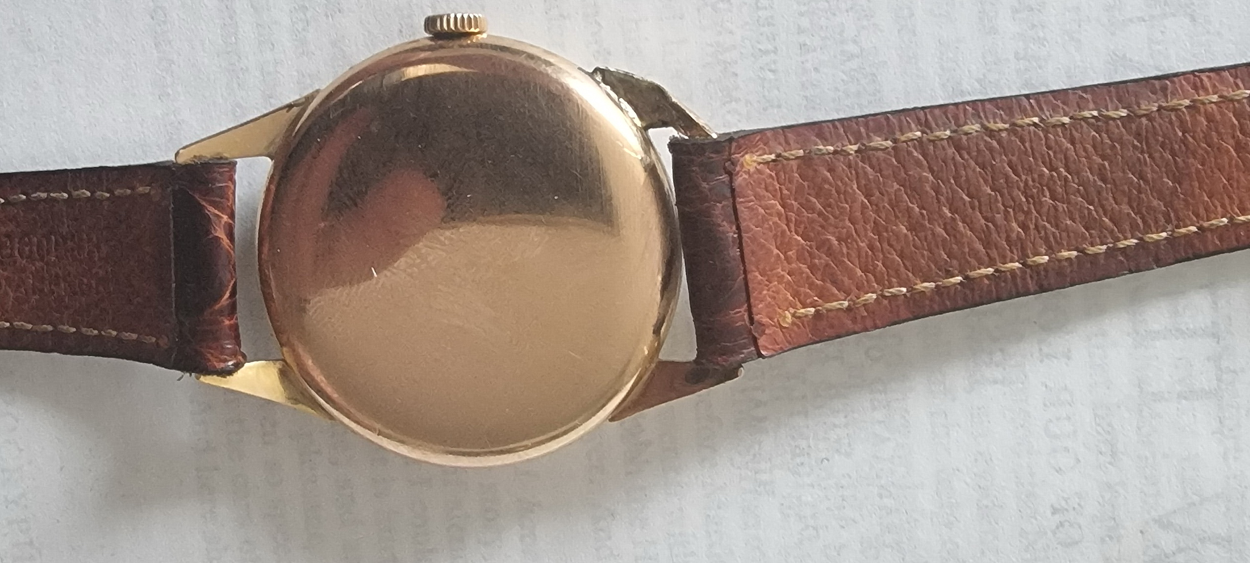

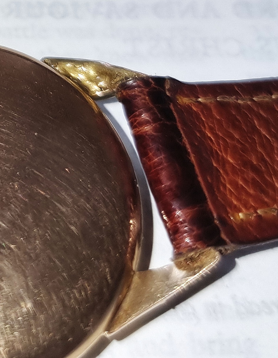

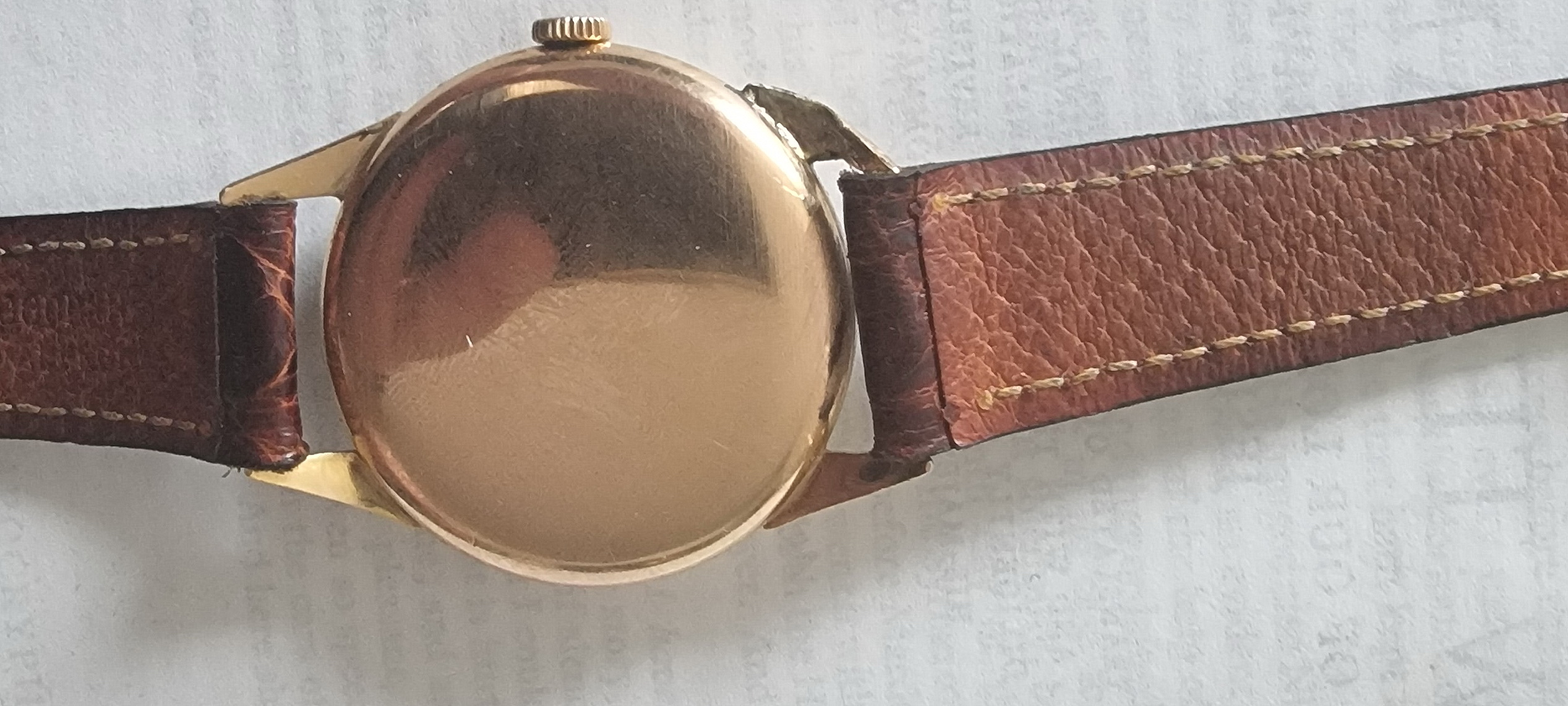

On delivery, one of the lugs had a dent, but the other appears to have been re-soldered back onto the body and melted! It looks like then someone deformed it to make it fit the 18mm strap bar.
The strap bar fits into it, in a newly-made hole, but this side of the strap is held closer to the watch body. The aesthetics are bad and the grip of the strap bar is unreliable.
I think that the lug needs removing, reshaping and refitting.
Is this something anyone has experience of? Is the watch irrevocably damaged and salvage-only value? The mechanism works.
It's a nice watch and the ebayer is strangely refusing to acknowledge that the damage is more than his description of 'light marks'.

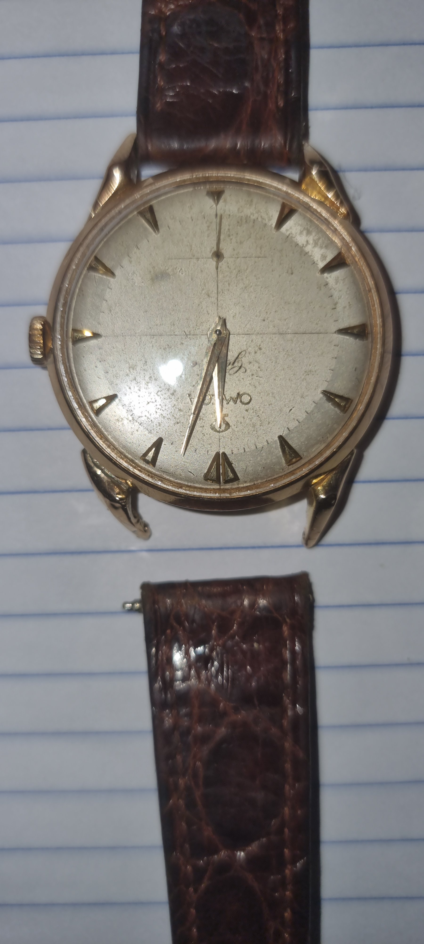

51
20
The lug damage from the front (a bit less obvious). Such a shame, as it's an 18K watch. I guess I'd see the watch itself as looking a bit tired and the face has some 'patination', but I don't mind this so much.
I don't think it would have been expensive for a watch without the lug damage, but I don't know how difficult/costly this is to repair?

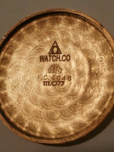

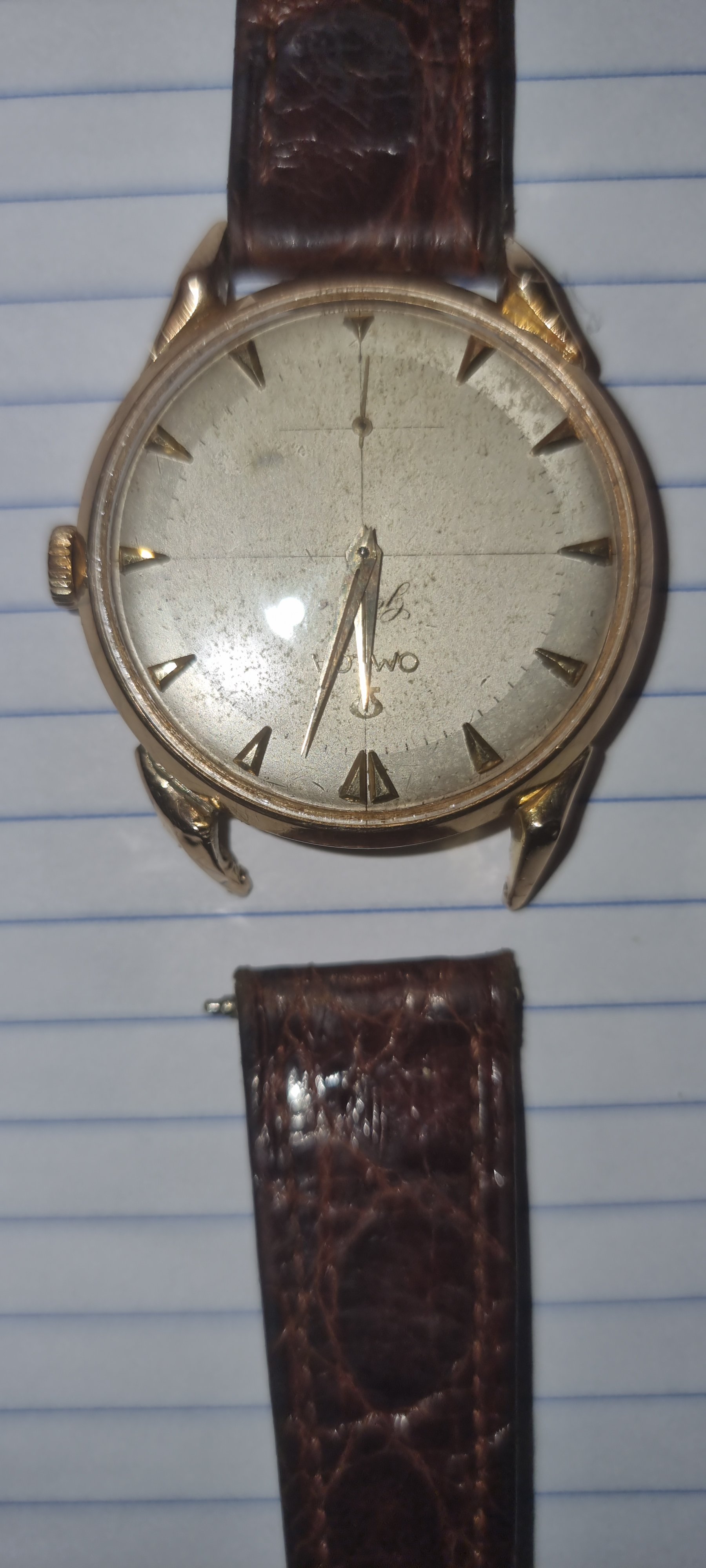

Return it. This won’t be an easy fix, rather a quite expensive one. Also, the dial doesn’t belong in this case. It’s a 50s cursive writing Genève dial, while your ref is from a DeVille, I believe. Even after a repair it’ll still be a Frankenwatch.
4,402
13,115
A good goldsmith could fix that easily enough, finding a good goldsmith though...
I'd return it, it is not in the condition it was described as and has the wrong dial.
