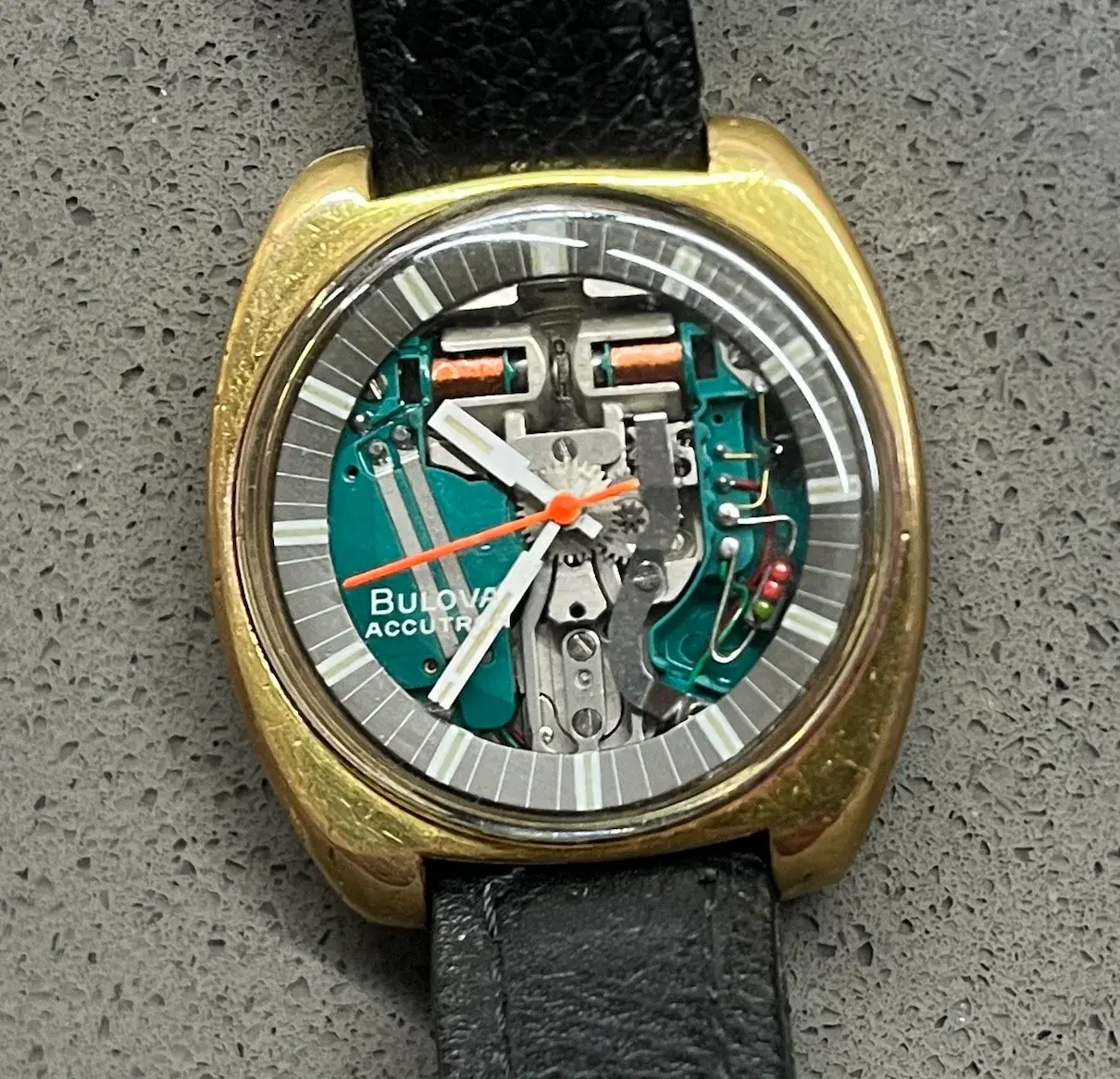

Hi
My first post.
I own a 1969 M9 Spaceview - factory model I believe.
The hands are out of alignment and sometimes it appears that they maybe loose.
Can anyone advise whether this is an expensive repair and also who in the UK could do it.
The watch keeps good time.
Thanks in advance.

If it’s just that the hands are loose that’s a job for any good independent watchmaker, you don’t really need a tuning fork specialist for that

Thanks for your reply.
I've shown it to a couple of repairers who claim lack of spares coupled with very high estimates.
I found this online:
If an Accutron's hands are loose or misaligned, it's usually due to a loose cannon pinion or a bent hand, often requiring professional repair by a watchmaker specializing in tuning fork watches.

The Spaceview models can have a problem, primarily because there is no dial. If the clearance between the top of the hour wheel and the underside of the minute hand is too great, the hour wheel can lift, become disengaged with the pinion on the minute wheel, rotating a bit, re-engaging, the result being the hour hand alignment is lost. If a watch has a dial, a dial washer can be placed over the hour wheel, preventing this problem by holding the hour wheel in engagement. Can’t use a dial washer on a Spaceview. This is not a difficult problem to solve, but most in this trade today are gun shy with Accutrons. Re-calibrate the hands, and make certain the minute hand is low enough to prevent the hour wheel lifting, once the hands are back on.

Thank you for you response, that makes perfect sense, I'm a clockmaker but watches are a mystery to me!
I'm getting it serviced and recalibrated by an Accutron repairer.

I spoke to Rob, he's really backed up at the moment, looking at three months with shipping.
I have sent the watch to Alan Lazarus who has a good reputation, I spoke to him and he explained everything to me, I'm confident
he will do a good job.
7
4
Very happy with Alan, as mentioned my Spaceview had intermittent loose hands, the problem fixed and the watch serviced for
£250 + postage, fast turnaround.
