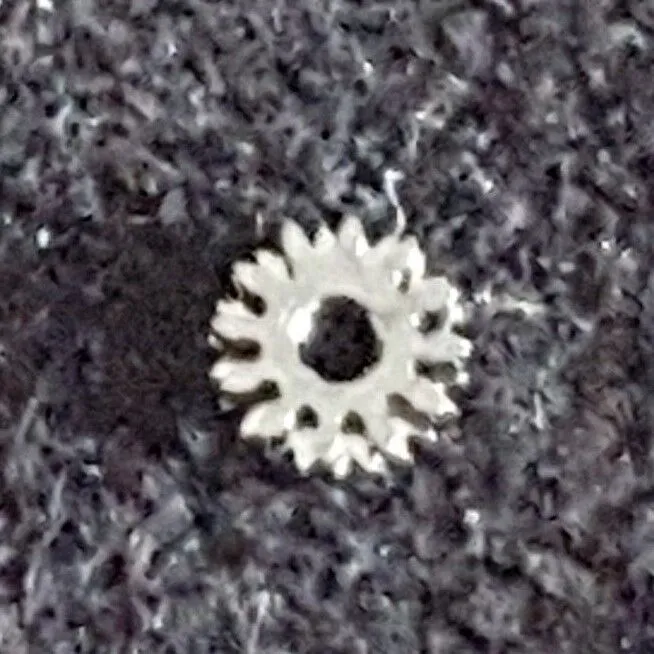

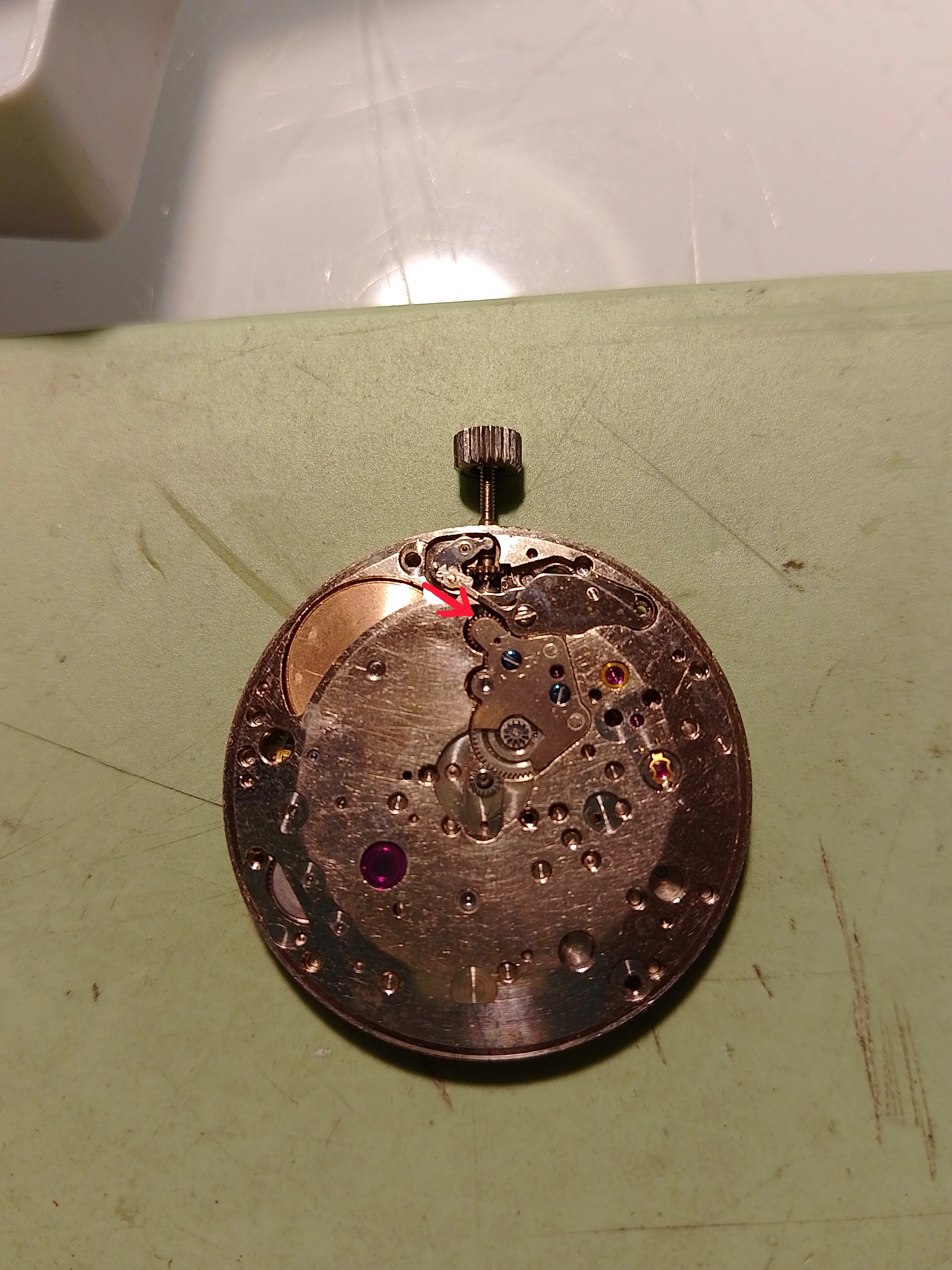

I recently bought a Bulova Ambassador and gave it to my watchmaker for service, but there is a problem with a wheel in the time setting mechanism (tooth broken). He cannot find this part. Caliber is Bulova 12EBAC or Buren 1280. Any help would be greatly appreciated, thanks!

Hi,
Would you please give the specific name of the part needed or a pic?

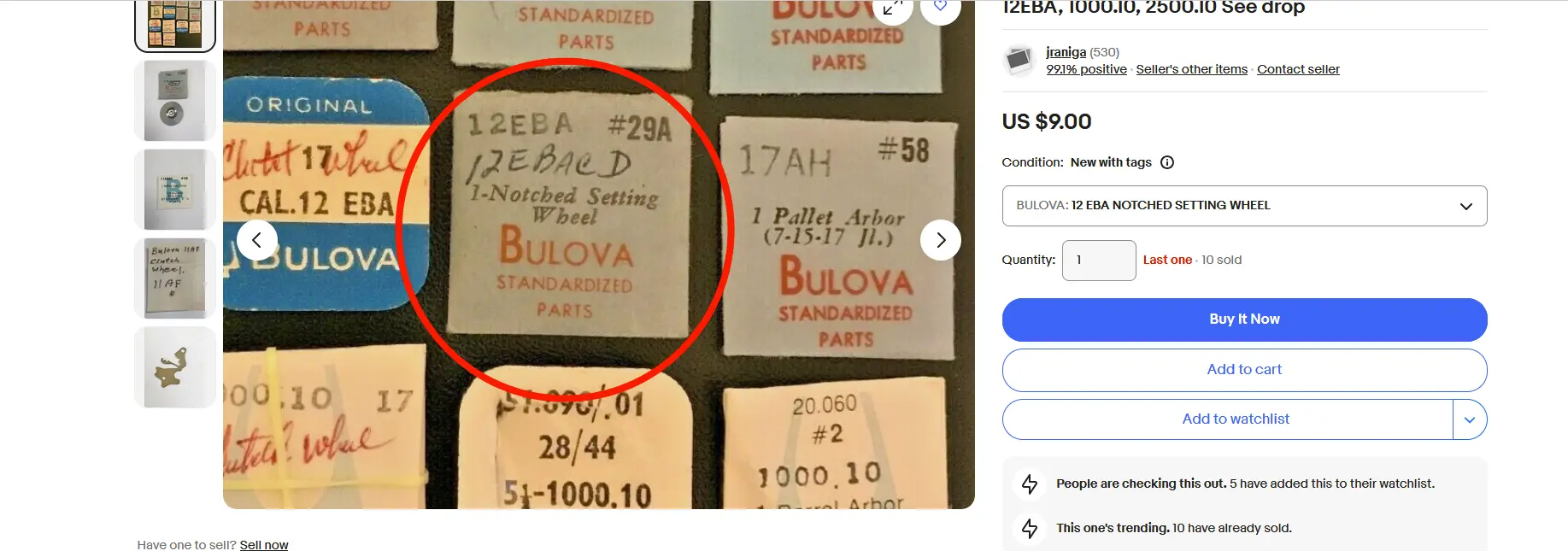

This might work
Alternatively, reach out to Dave. He saved me many times...

There is also a setting wheel for the same movement that is doubled. I'm not sure which one you need.
I think it is this one. Thanks again!
