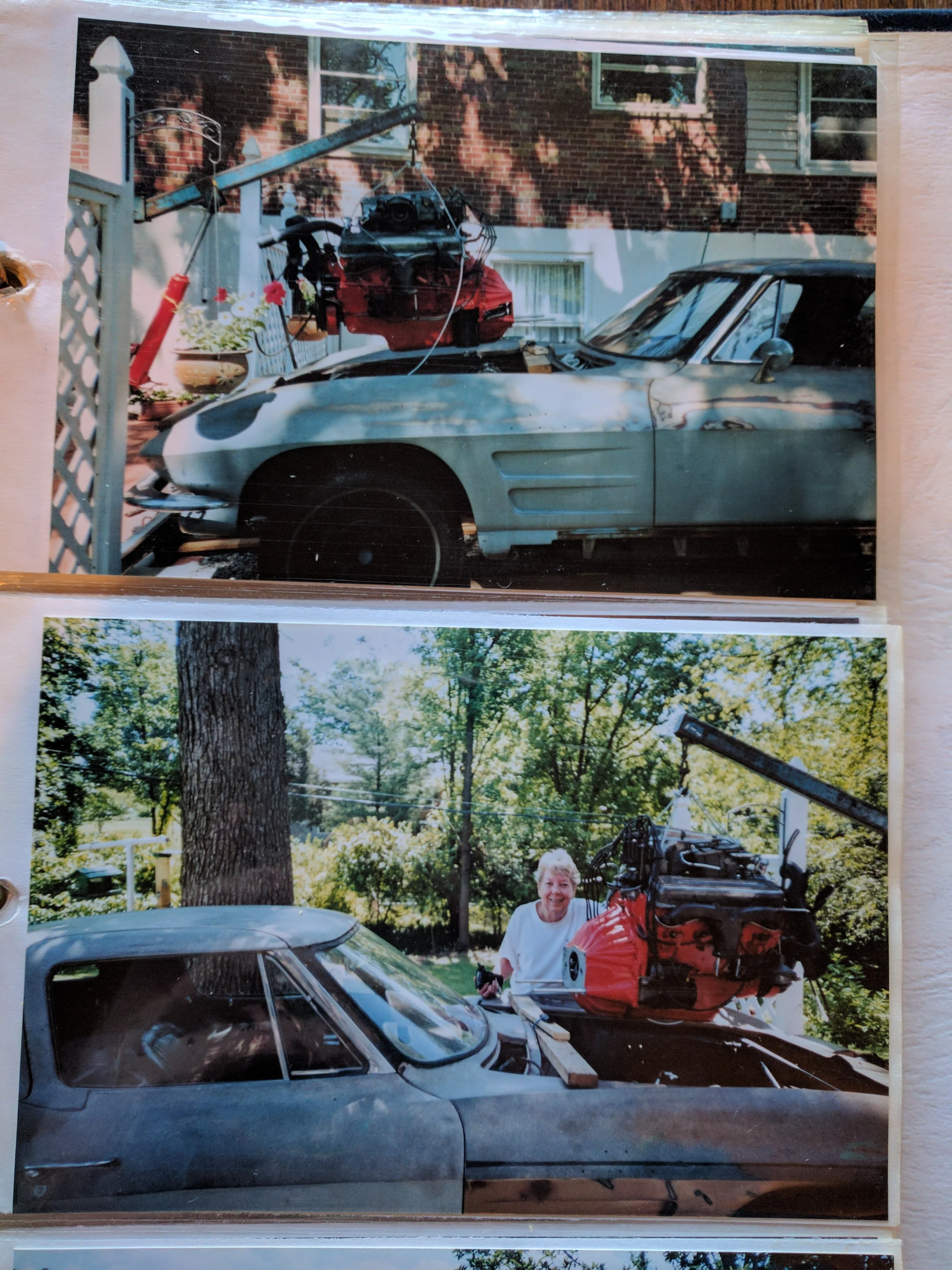

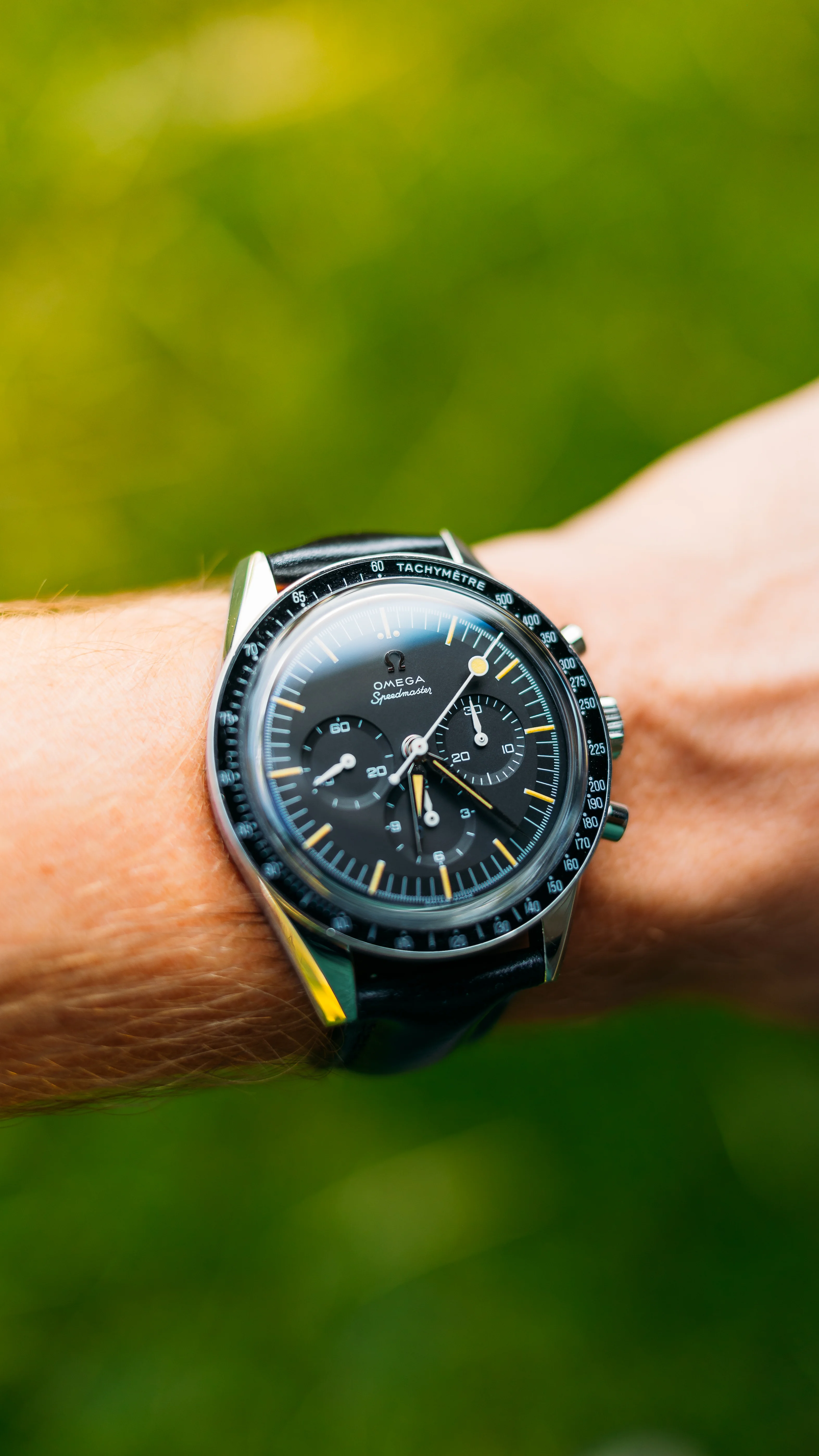

Last year I purchased a First Omega in Space in remembrance of my best friend.
My best friend in the world, my biggest inspiration, was my step grandfather. He treated me as if I was his own son, was project supervisor for the Mercury and Gemini space capsules. As a kid, I would sit listening to him for hours telling stories about working with the Mercury 7, Gordo and Gus stealing his 63 split window fuelie Corvette, putting water skis on Jackie Kennedy.

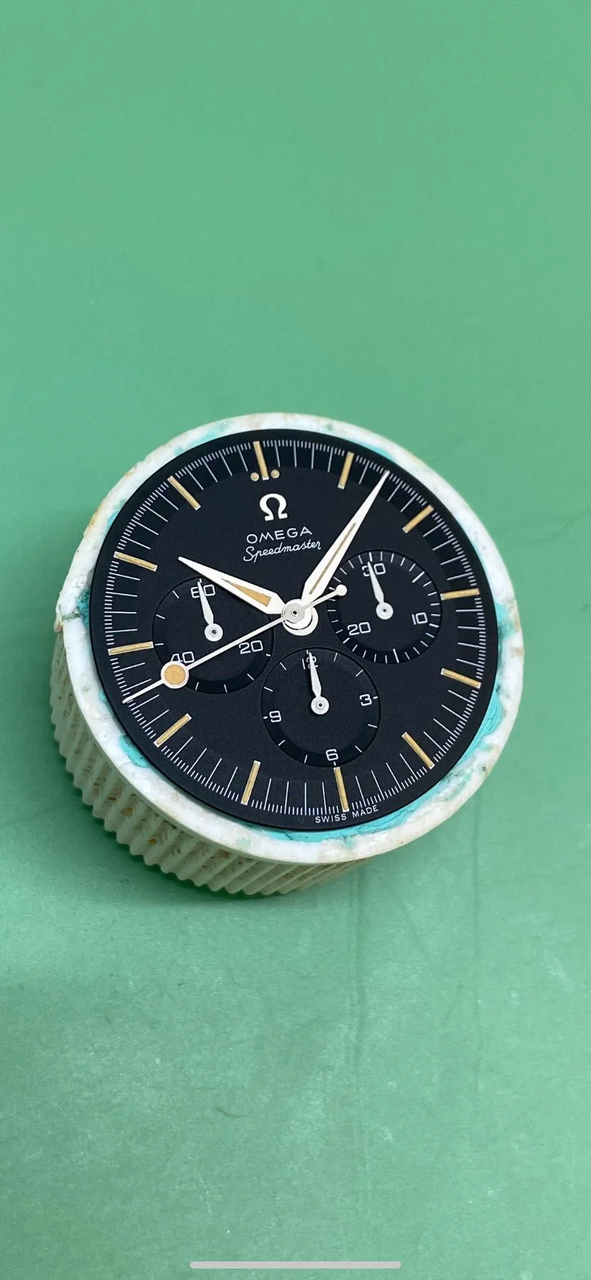

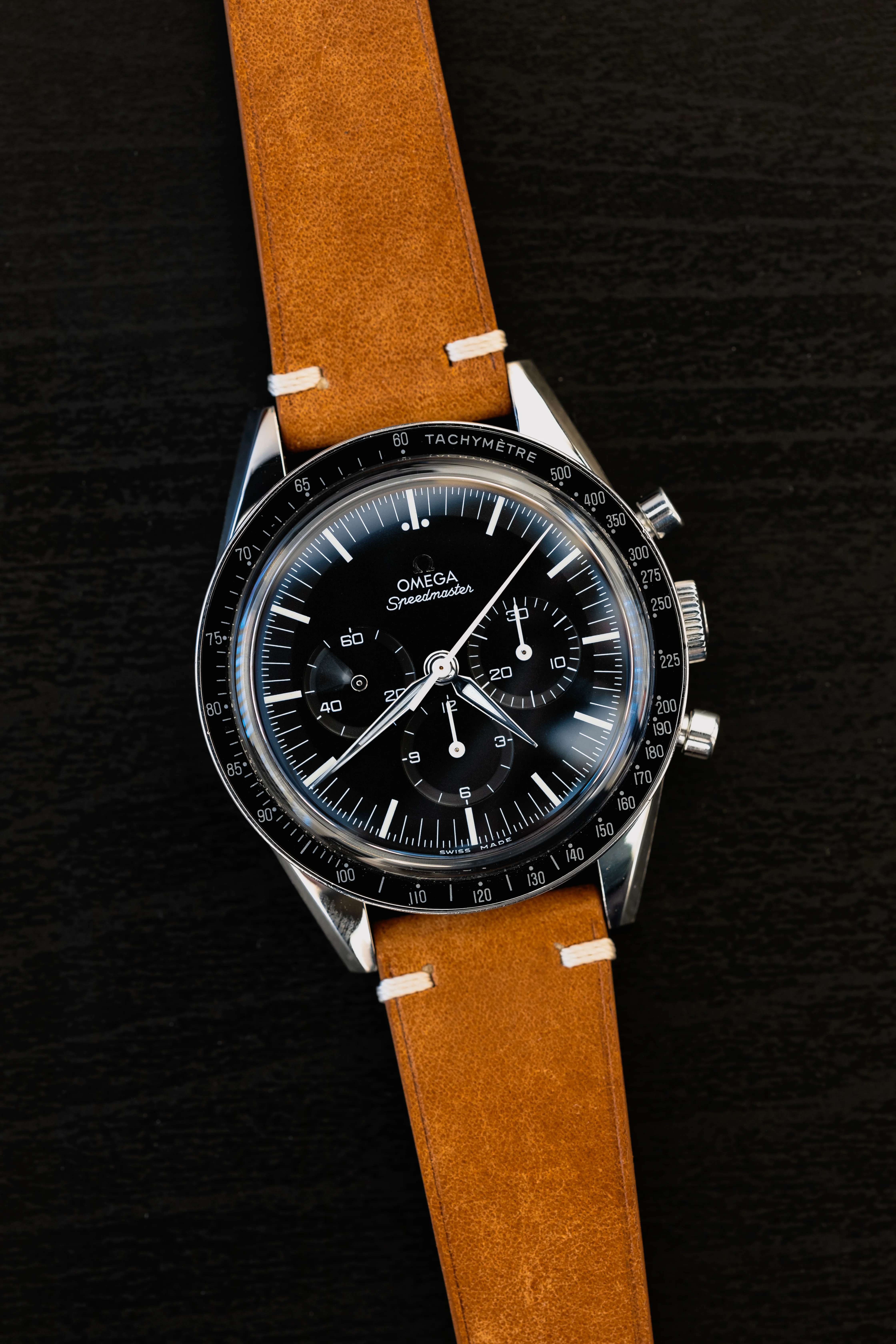

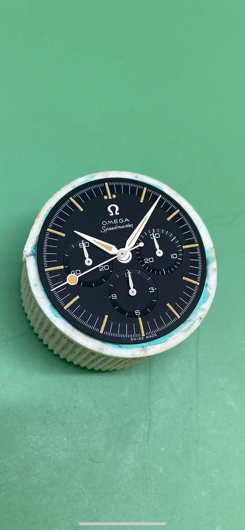

While I do enjoy the standard 2012 rendition of the CK2998, I did want to make some changes to the watch.

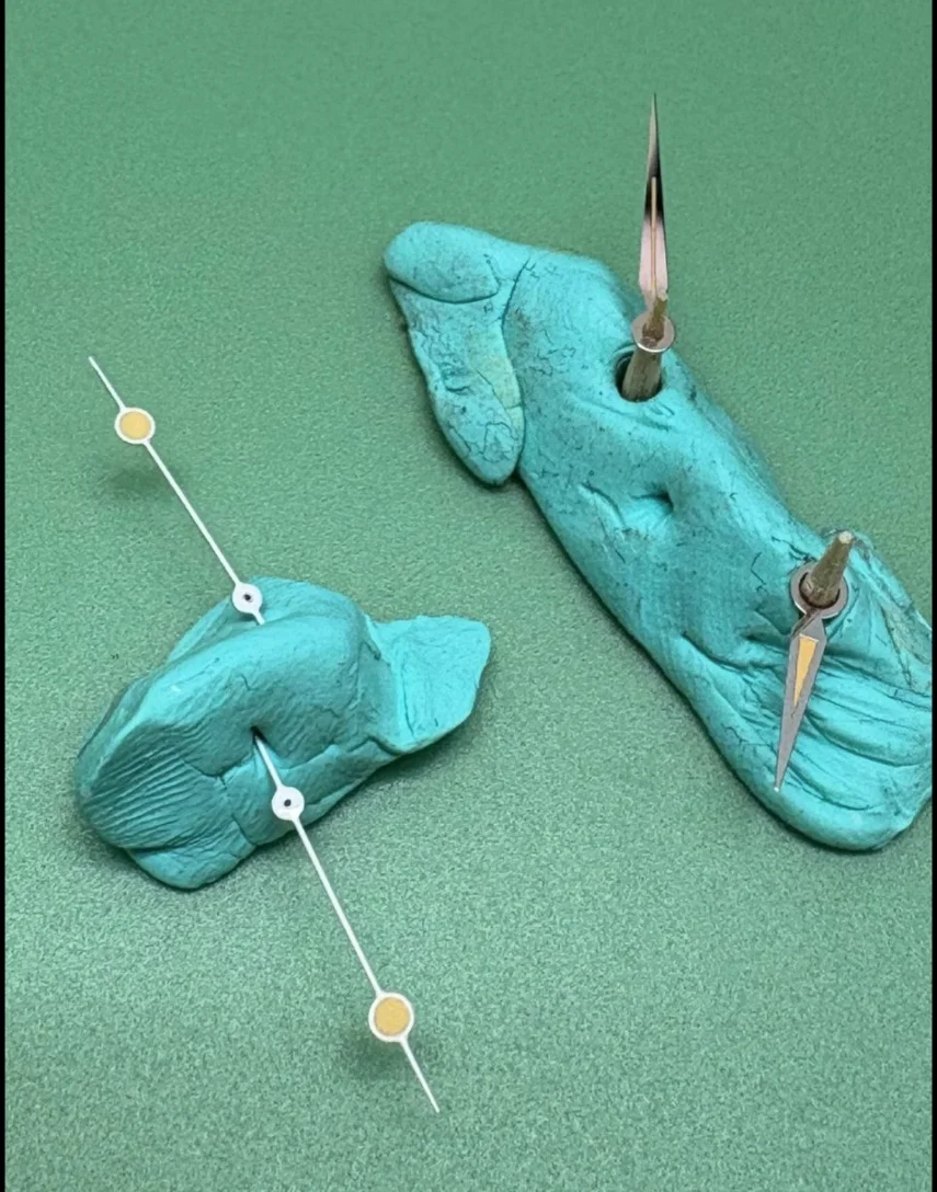

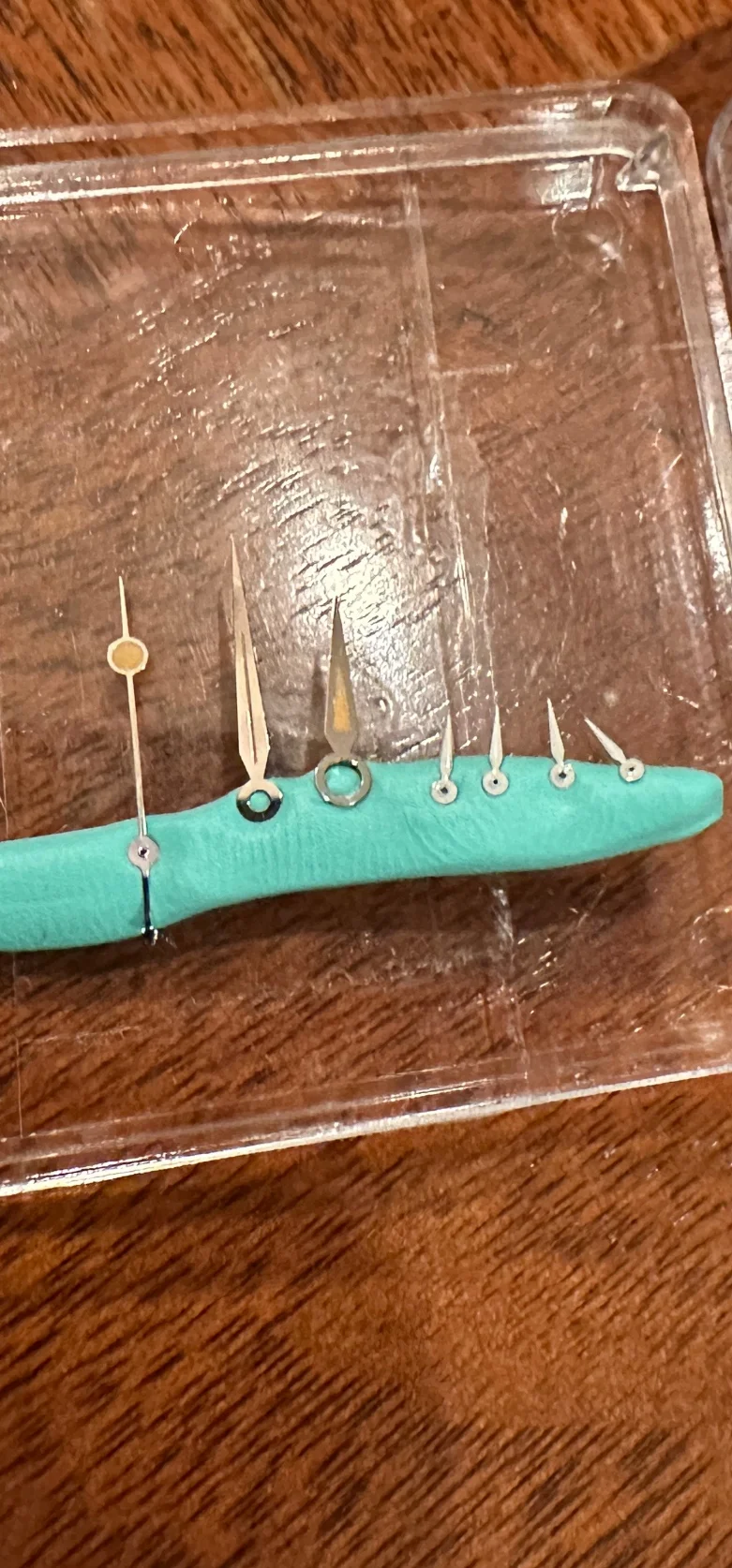

Changing out the dial for one with the old Omega logo, replacing the subdial hands with white leaf hands, adding a lollipop, and Naiad crown. I wanted to go for a more vintage look and while I know it's not to everyone's tastes, add some fauxtina. I was able to get my hands on the parts and sent them to James, Alchemist relumer.
I also changed out the Delrin block for metal 861 parts and added a Spiralwinders sapphire caseback, though I am on the hunt for a hippocampus caseback (112st1450012). All the parts are at a watchmaker being fitted now. Looking for a LWC black base 1000 bezel, but after that, I'll have my dream Speedmaster. And don't worry, all original parts were saved, could be brought back to stock.

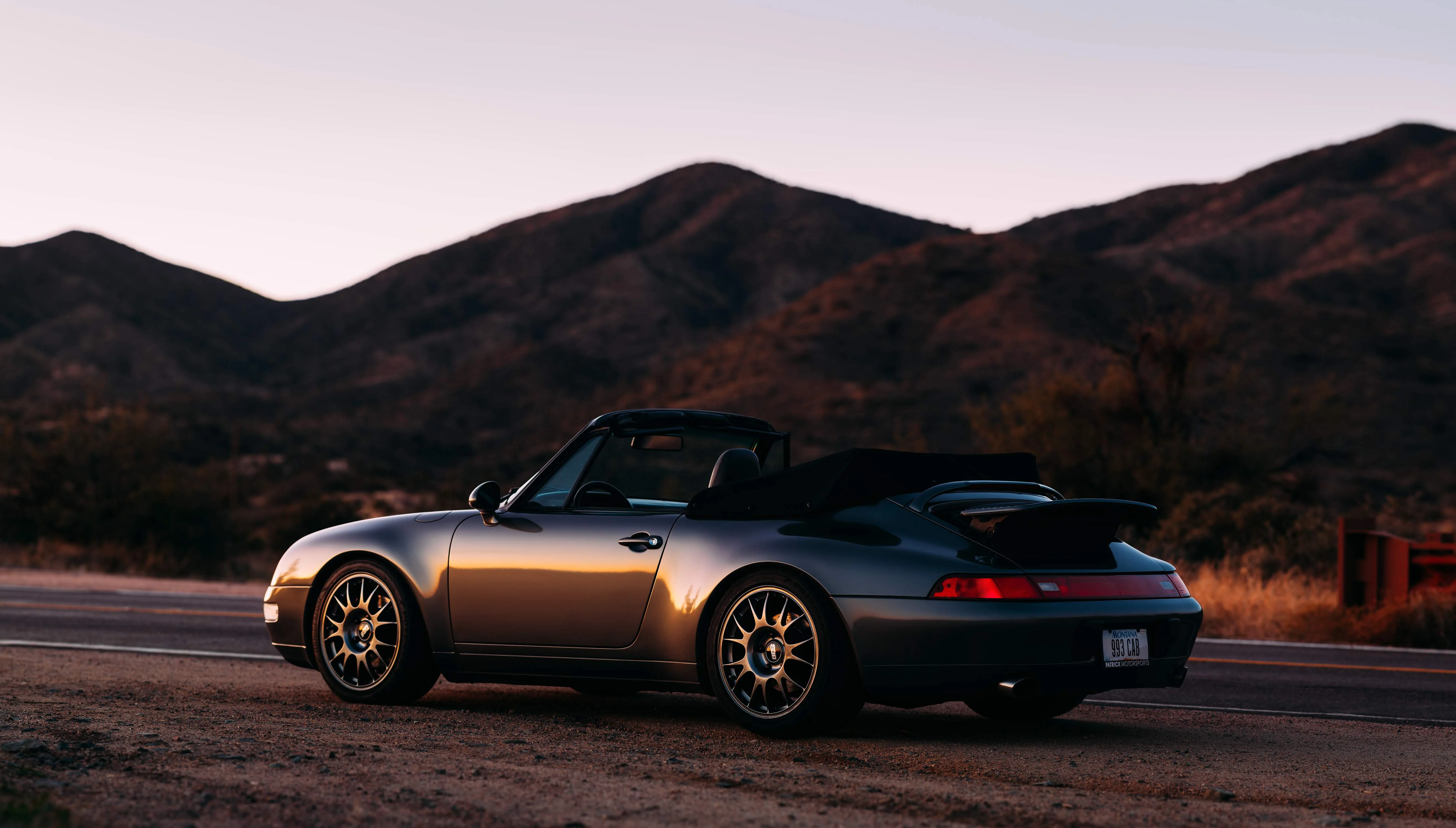

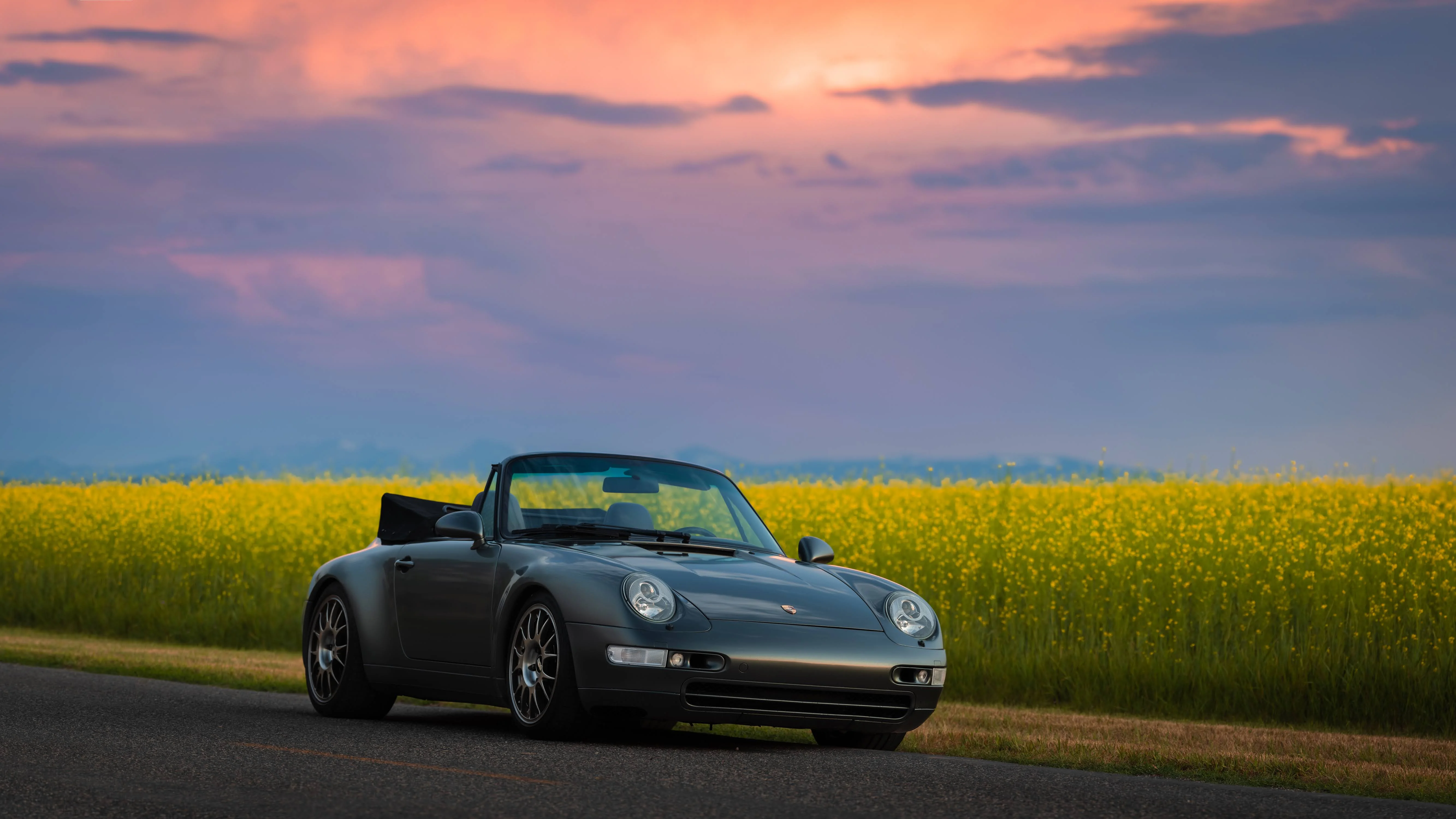

Curious about that "993" too
I remember him teaching me about how the Rochester fuel injection worked as a ten year old.
That's my 993, 1996 C2 Cabriolet. Tons of modifications done to it, wrapped, all new suspension, exhaust, ect.
My major passion is air cooled Porsches, I've help restore a number of them.

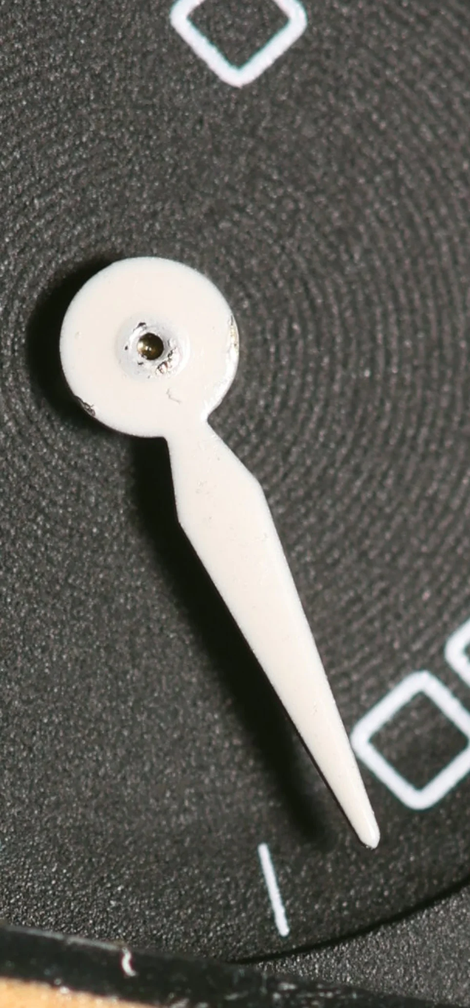

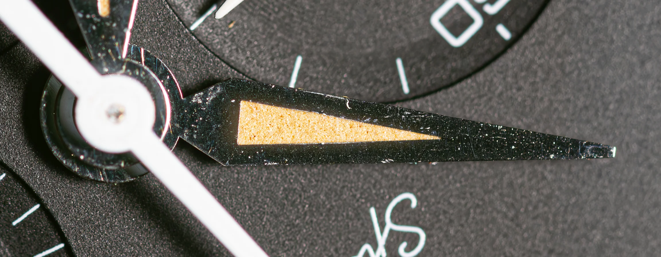

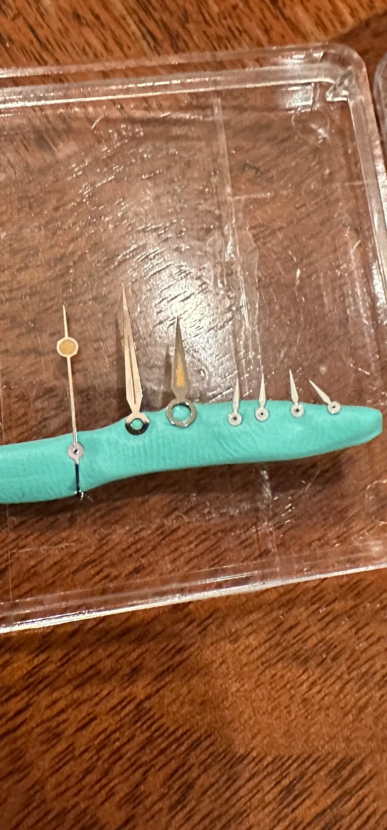

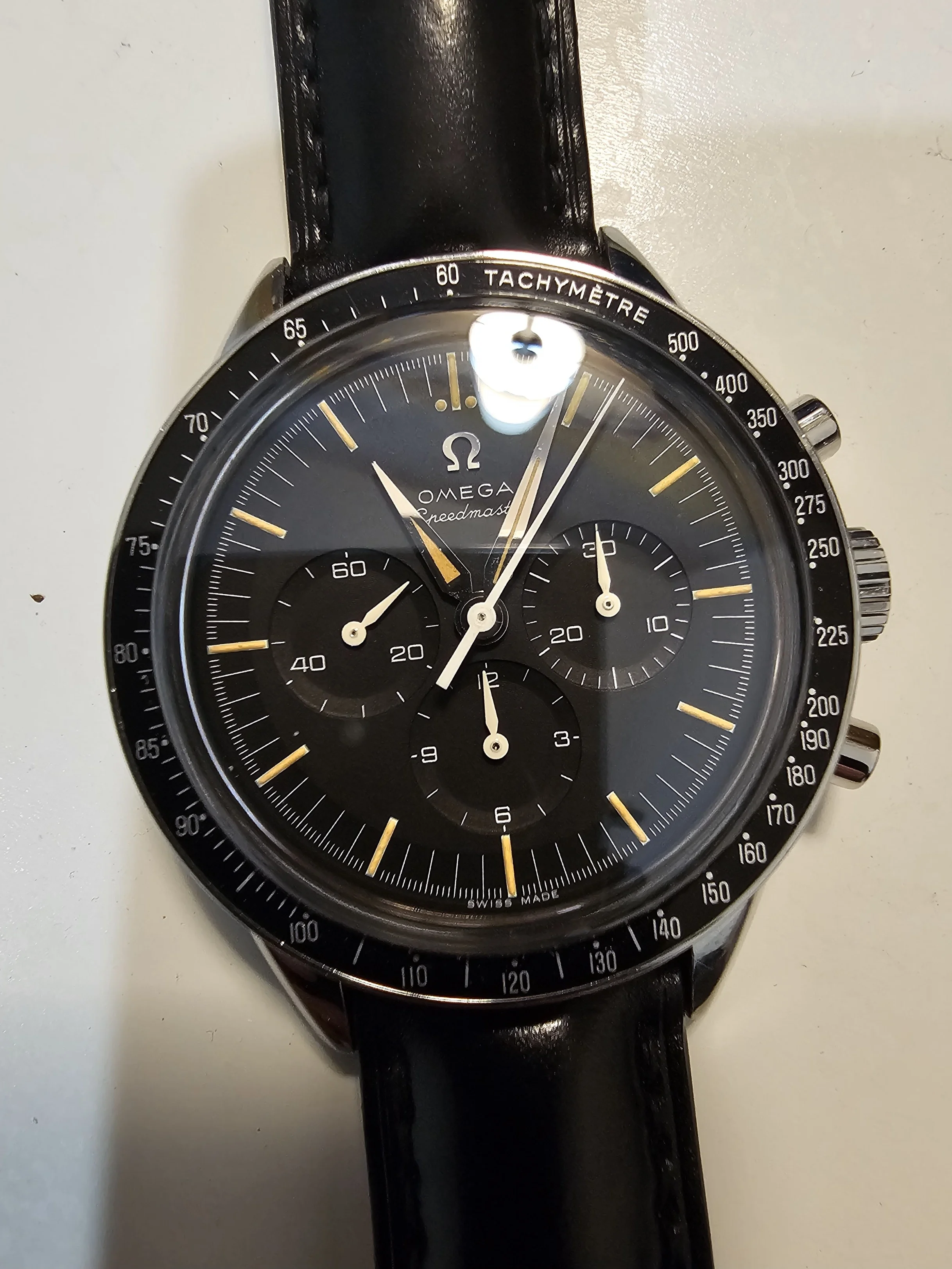

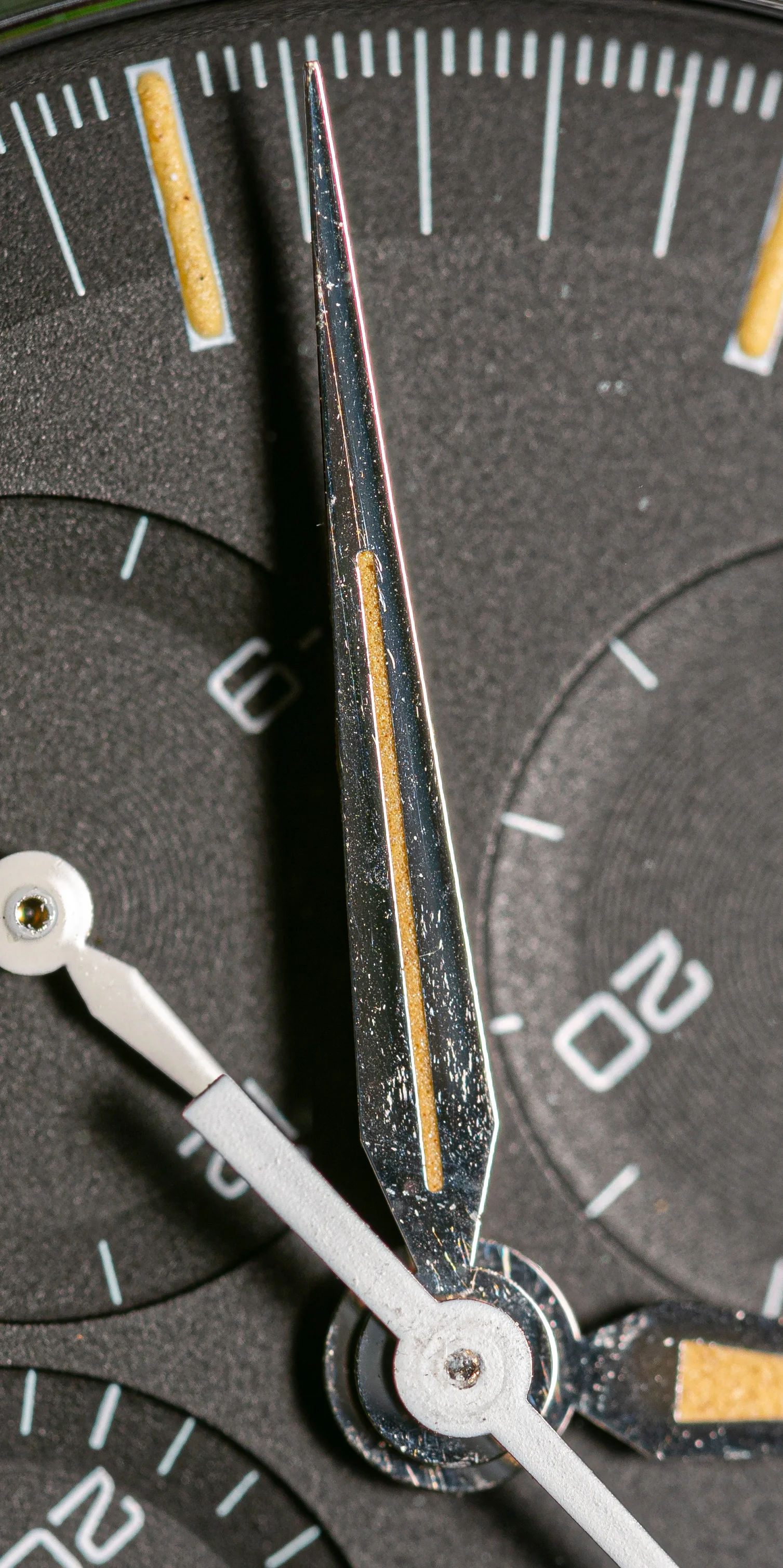

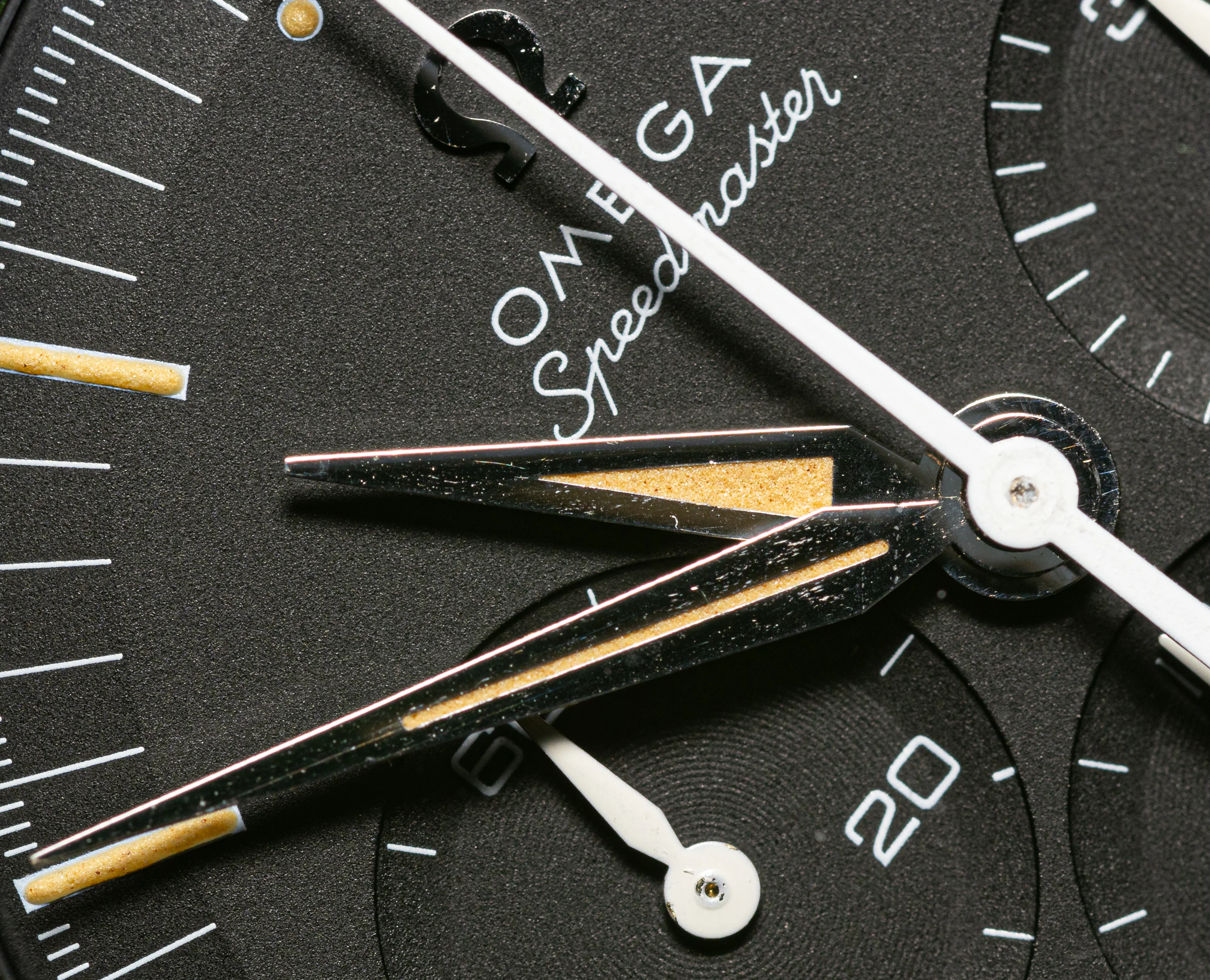

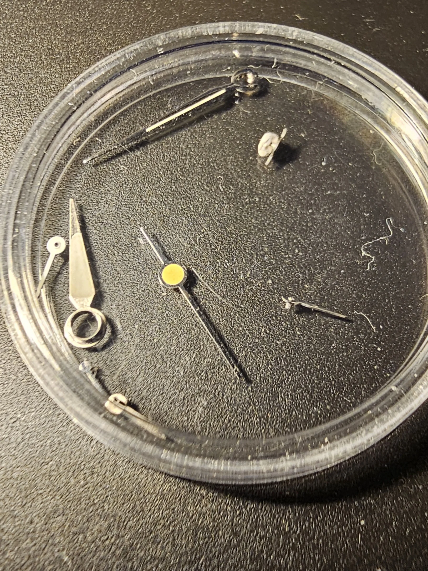

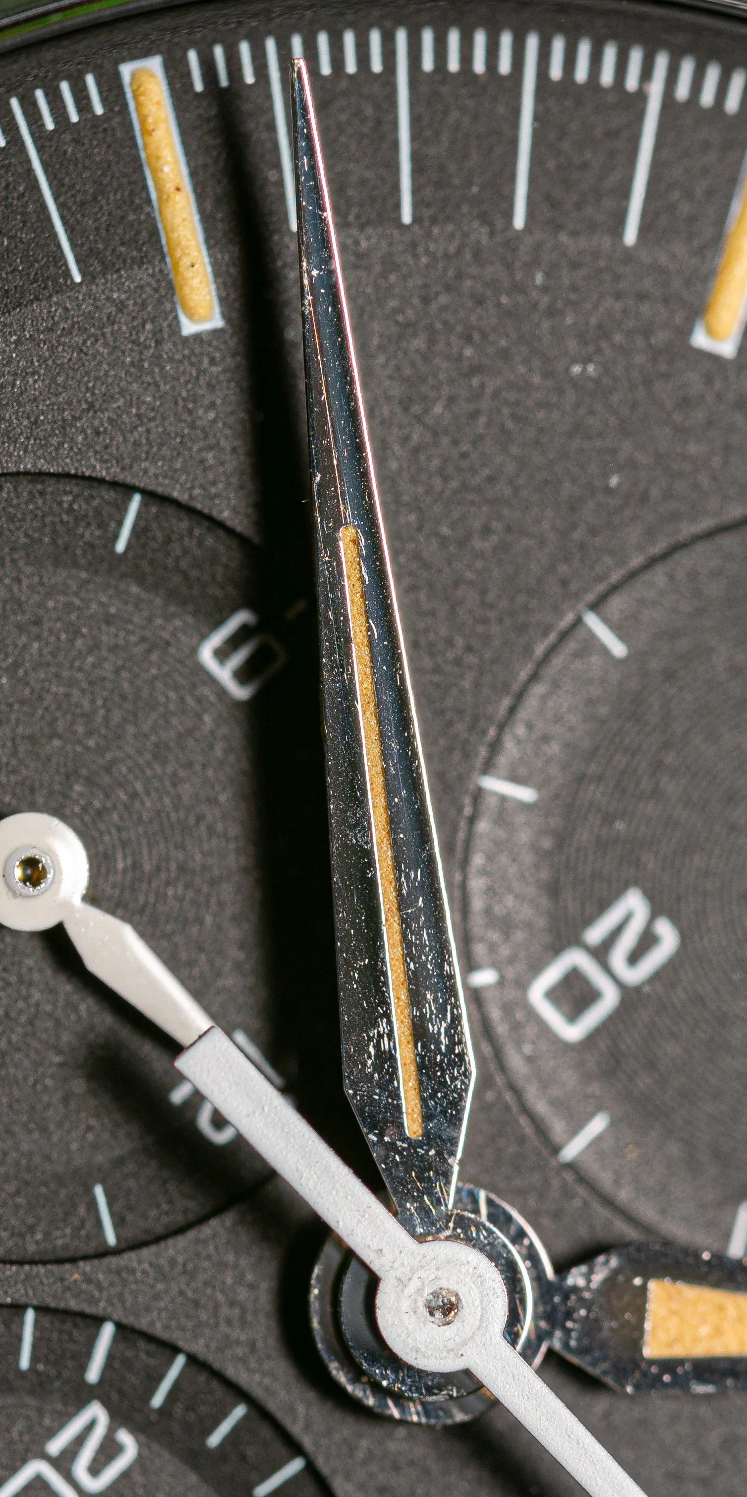

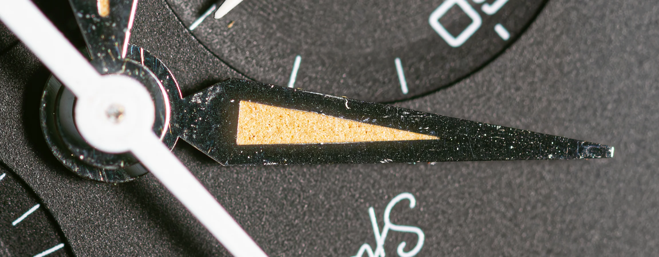

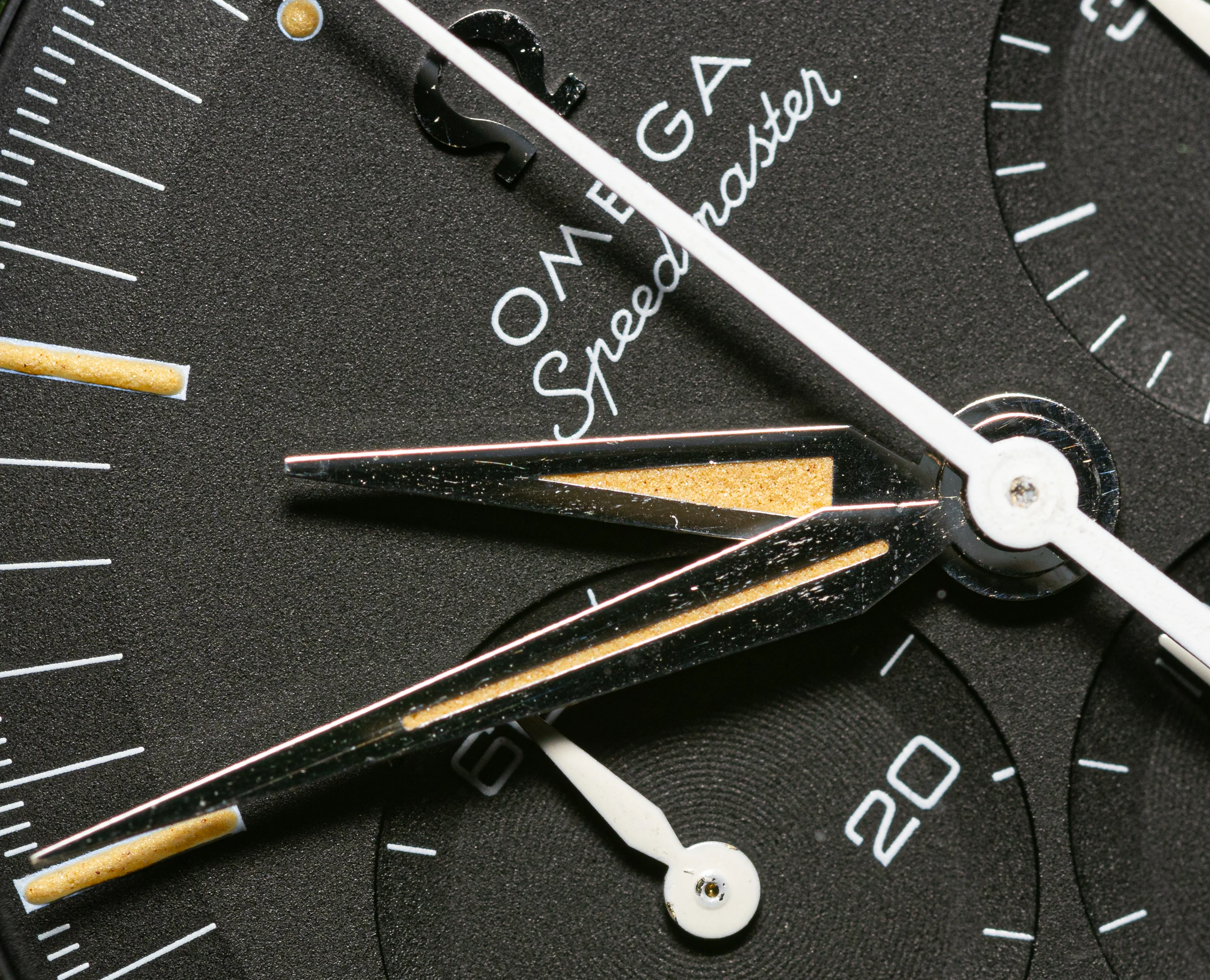

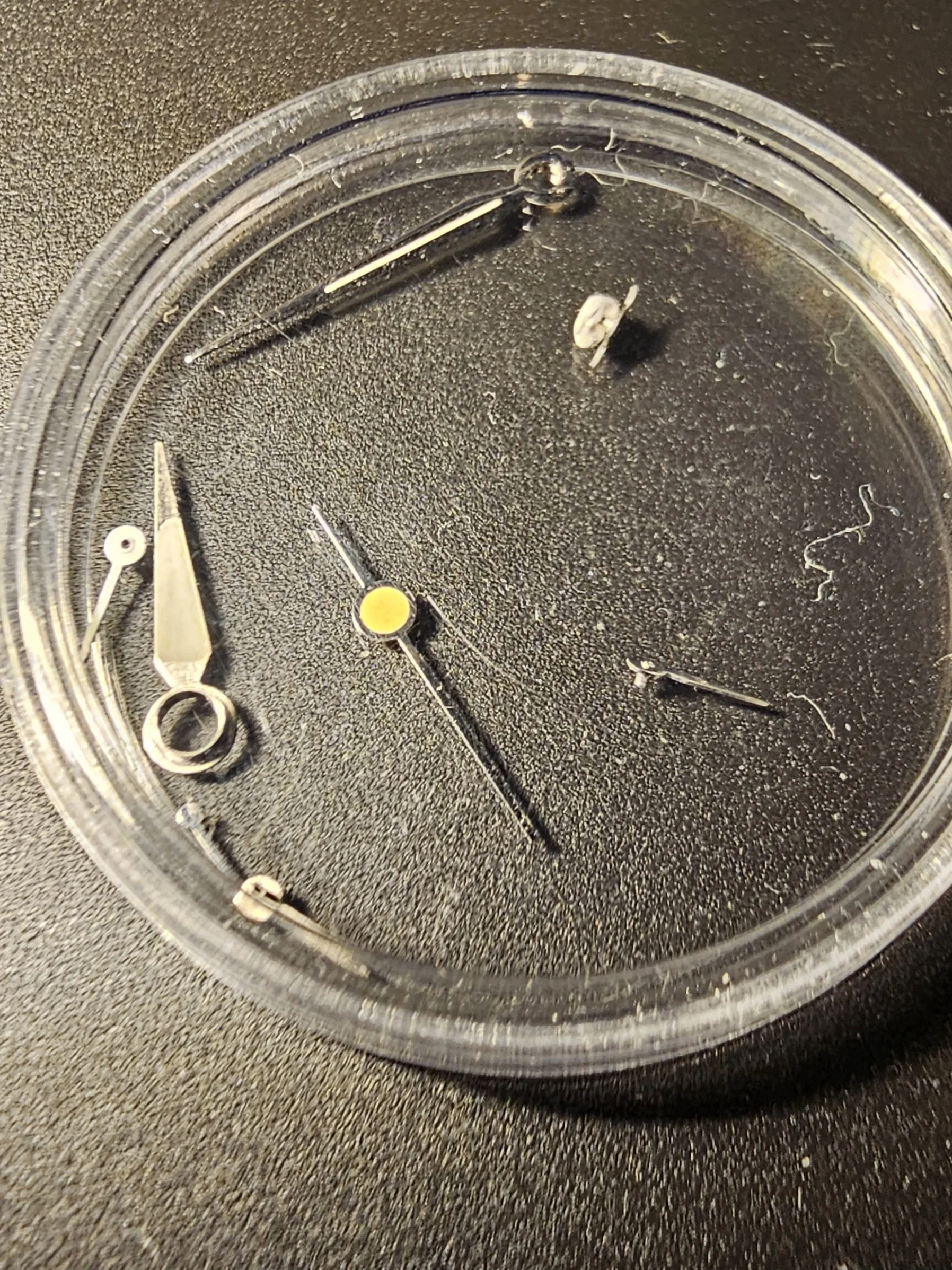

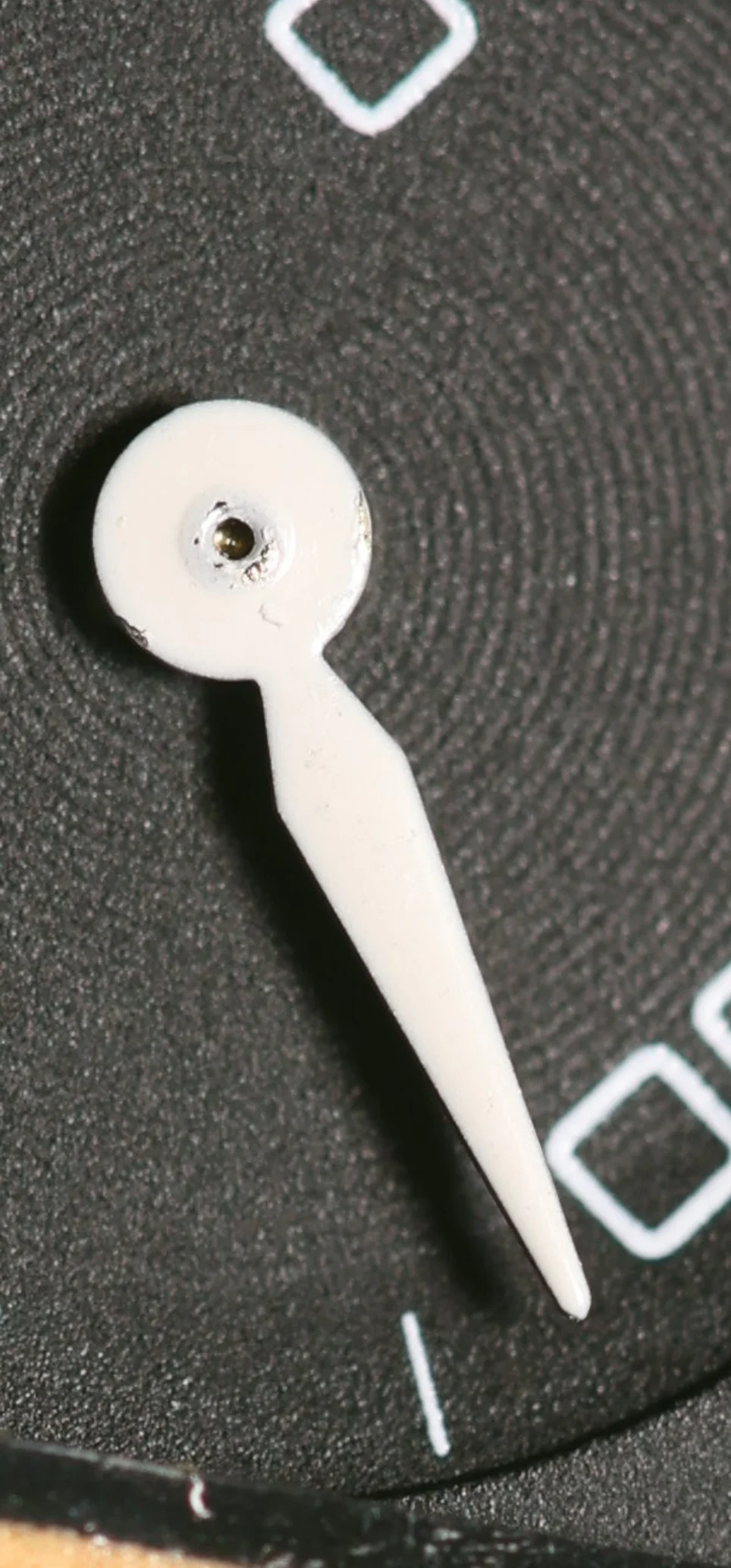

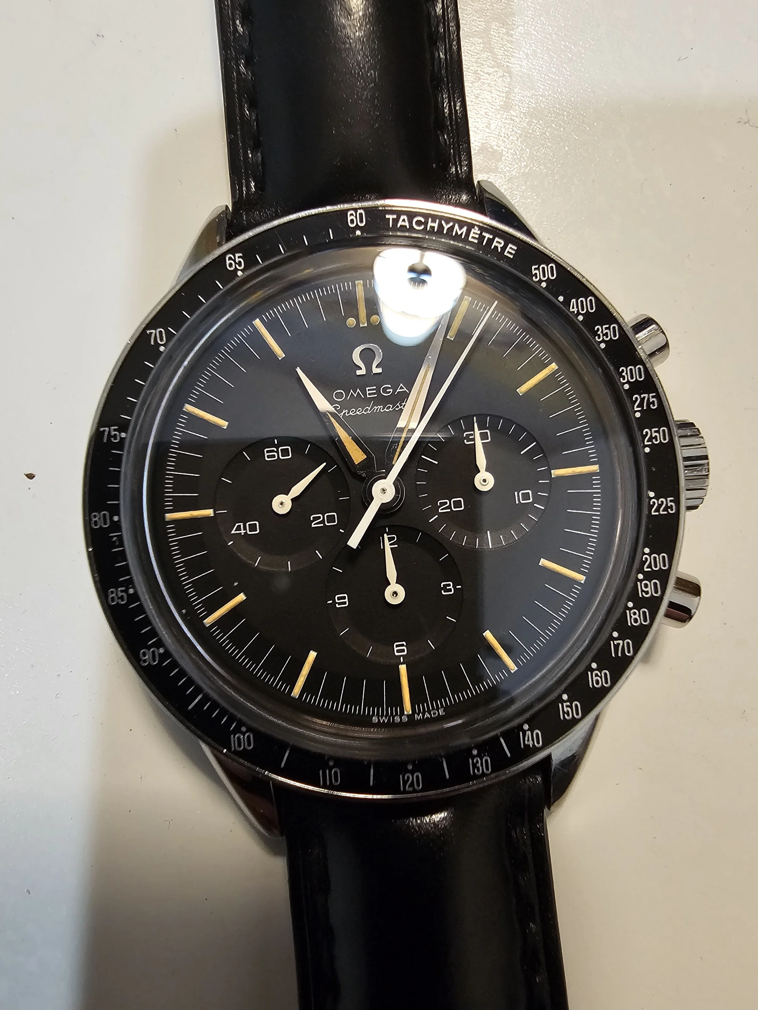

So I got my watch back from the watchmaker I have used before. He serviced my watch last year and thought he did a good job. This time, I have to say I am incredibly disappointed and am looking for some advice on next steps. When I dropped it off, I had told them to take their time and let me know if they had any issues. They had the watch for about 3 weeks, and they emailed me to come pick it up. Upon arrival, I came to discover that they had broken the lollipop, scratched up the hour and minute hands, the hour counter is misaligned, and the old hands were all just put loose into a container.
I had delivered the hands in container with Rodico so they wouldn't rub up against each other and assumed they would simply put the old hands back in the same place. The said they had difficulty installing the few hands which is strange as they are Omega parts for the 1861, it should have been pretty plug and play. I emailed them expressing my dissatisfaction, I'm just trying to figure how to move forward on this. This project started 5-6 months ago and to go through it all again feels brutal.

Real shame about the broken lollipop hand.
The macro photos really make the scratches look bad but they should not be too obvious when the watch is actually worn.

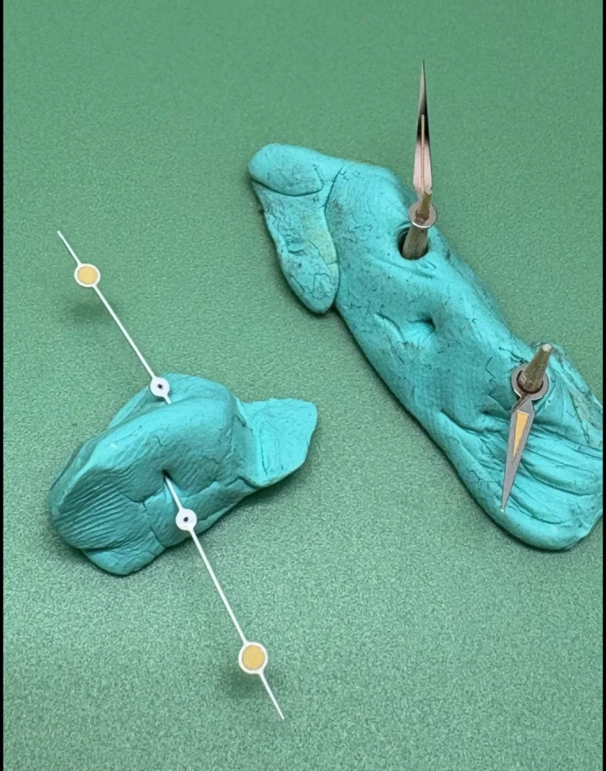

Update on the project. Working with the watchmaker to cover some of the expenses.
I was able to procure more hands and have them sent back to the Alchemist. Will be receiving the hands in the mail next week.
My brother has been a huge help in all of this. He has a huge passion for watches and I am hoping he will be able to install the new parts. He was one of eight chosen this year to study at the Nicolas G. Hayek Watchmaking School in Miami as part of Swatch Groups Watchmakers of Switzerland Training and Education Program.

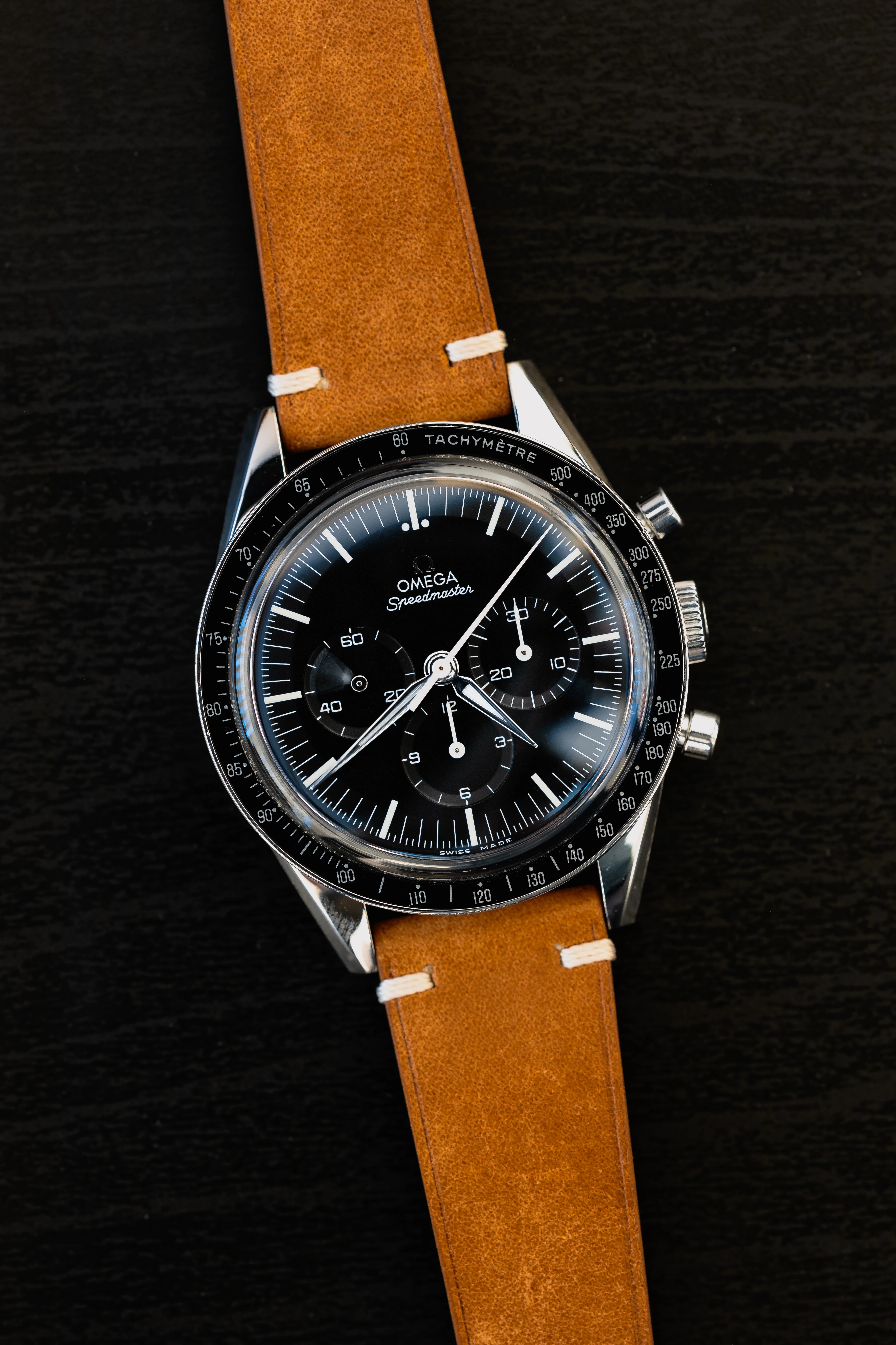

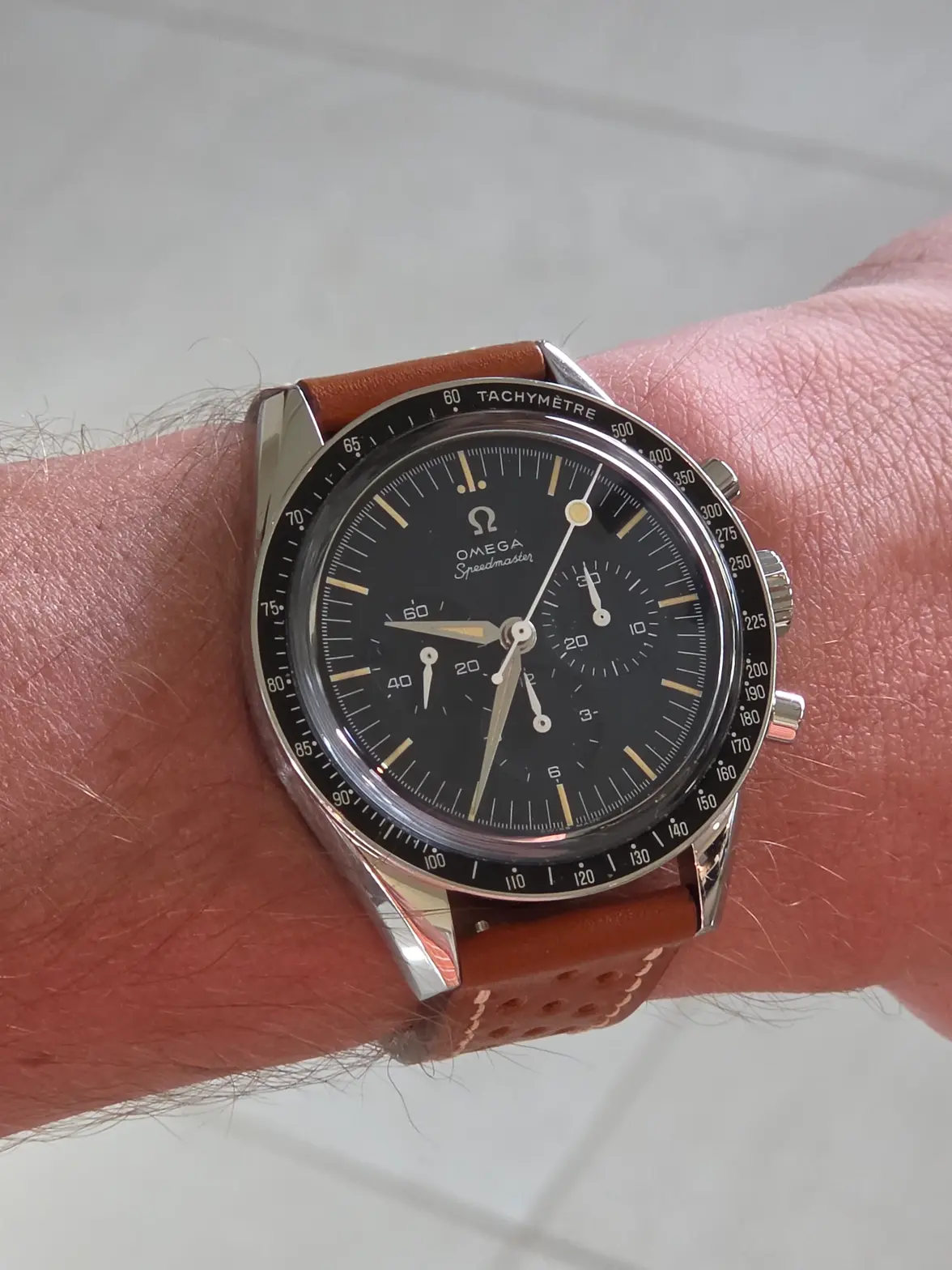

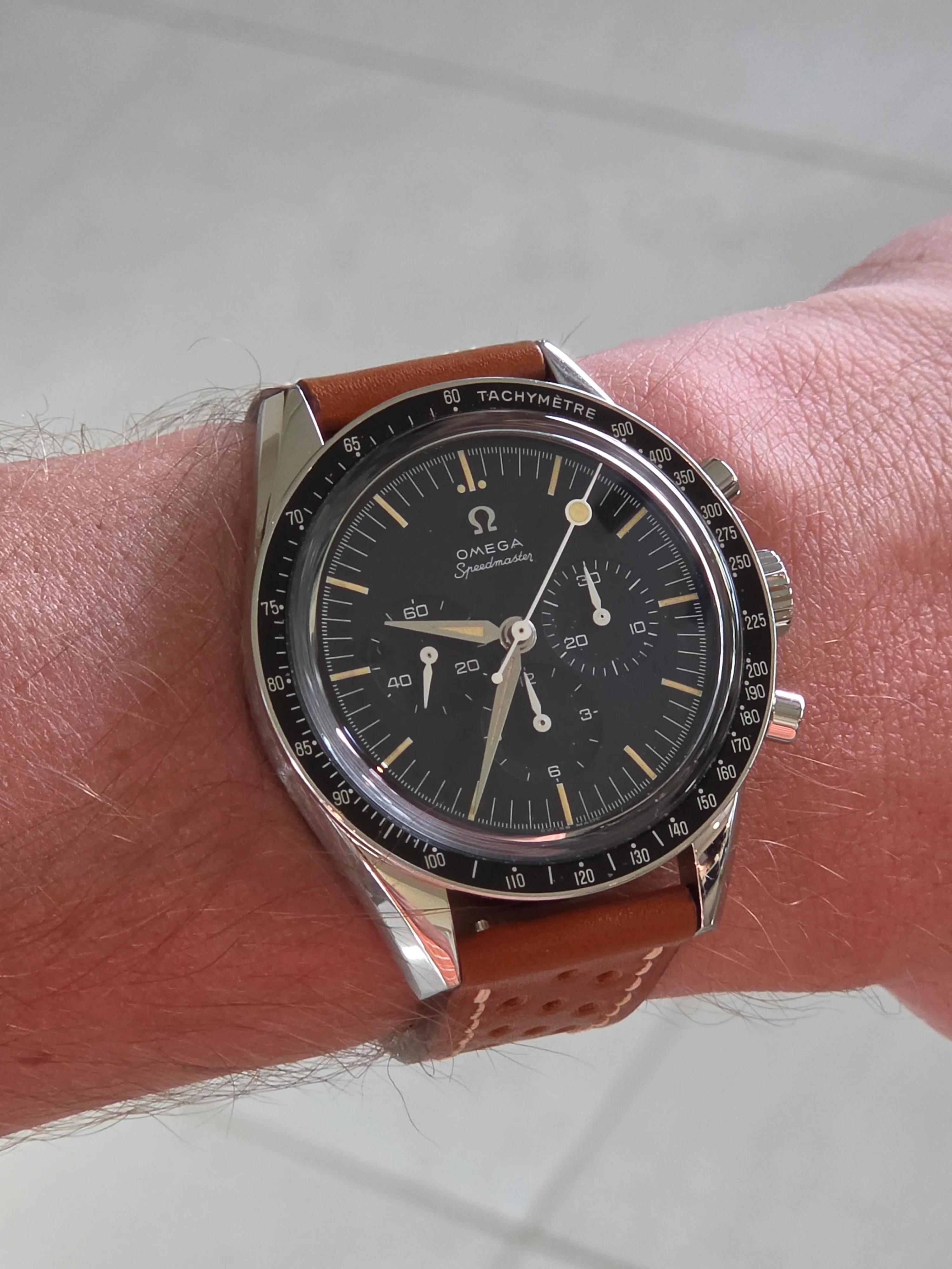

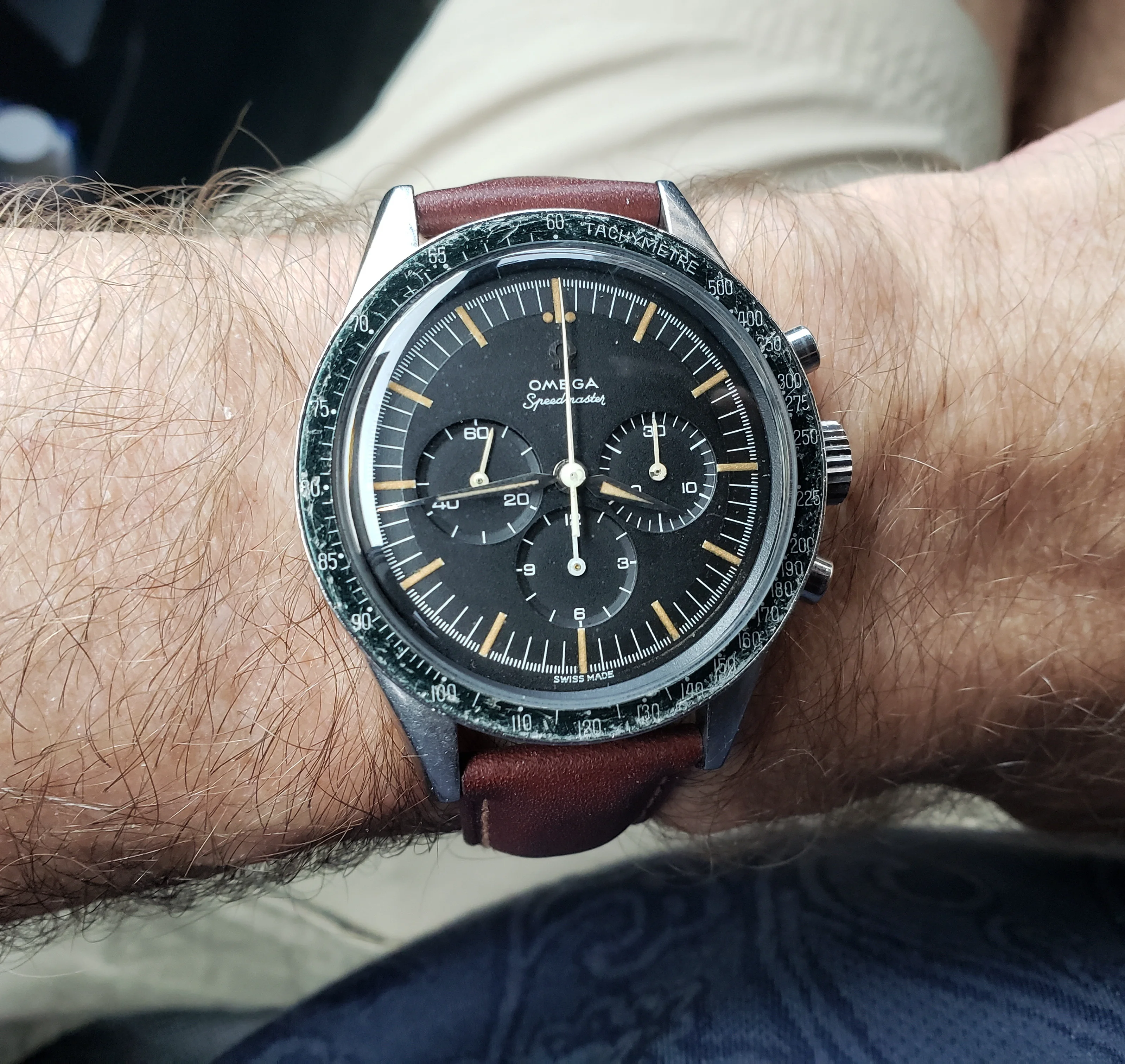

Was down in Miami for a job interview and my brother installed the hands while I was down there. He was in a rush so the alignment could be a bit better on the minute counter. He also found that the previous watch maker didn't support the seconds bridge and bent it during their attempted installation of the lollipop hand the broke. So he will probably go in and replace some things and clean it up but for now it's nice to have it back.
Great to see an update on this - your watch look absolutely beautiful!
808
2,449
Looks like a totally different watch and ove all the pictures and background about you step grandfather. Enjoy your new vintage piece and for another strap idea, when I got my Ck2998-5, grabbed a FOIS brown leather one which matches the lume and hands.
